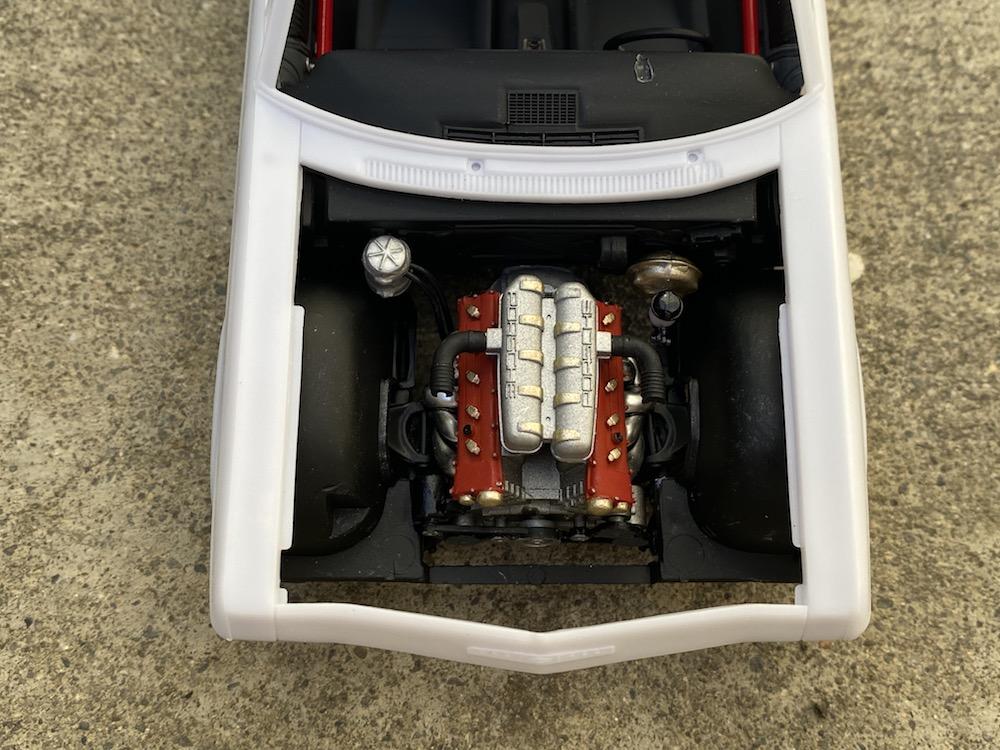

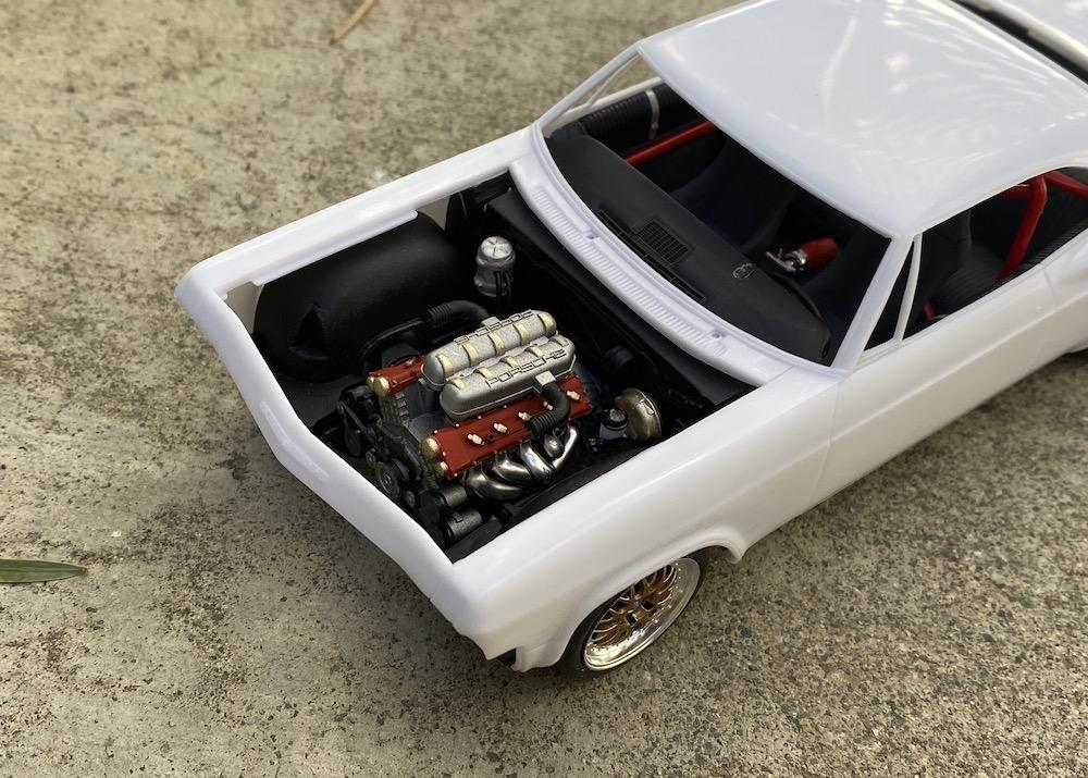

  7. Good thought for sure, but it worked out fine. Put the engine in and I'm happy with the way it sits. Much Dremeling required on the top of the transmission to facilitate! The Carrera GT's engine has really long intake runners that I had to sand down considerably to get the hood to fit. I still need to rig the cold air induction tubes from the plenum to holes in the radiator support. I repurposed a fire canister to make a dry sump tank...it still needs a cap!

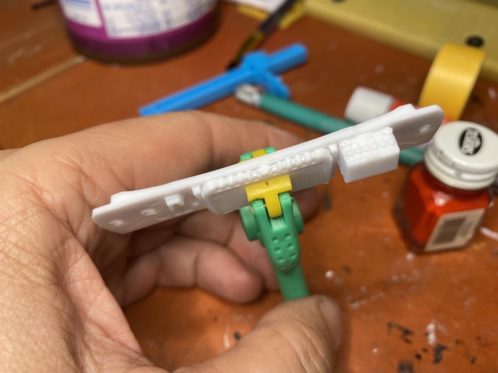

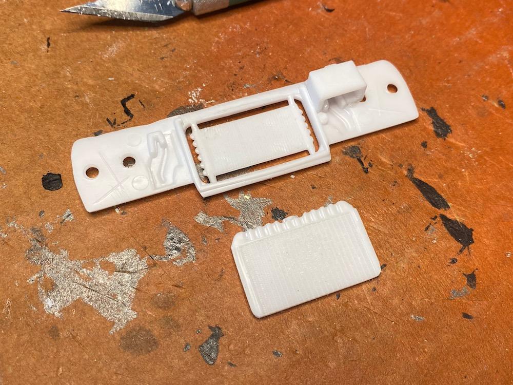

  10. More puzzle pieces. Predictably, the longer V-10 engine is a tight fit fore/aft, and also between the suspension control arms, because I want to get it low enough in the chassis to use the stock hood. Here, I recessed the radiator quite a bit, shaving off the fan shroud on the other side and taking about 25 percent off the bottom. Then I shaved the top of the rectangular recess so the header tank nests in there, and the radiator is pretty much right up against the a/c condenser (which I don't need, because racecar ?) but it does make a nice bit of structure to support the radiator. I probably freed up a couple mm, which is just enough.

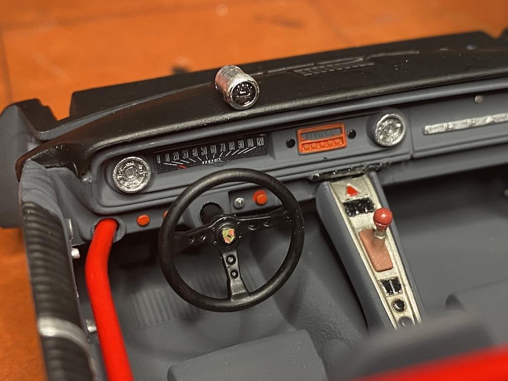

  15. Added an aftermarket tach on top of the dash, and a fire extinguisher between the seats. I just have to put the chrome piece in the rear seat and the interior is finished.

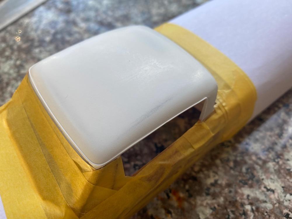

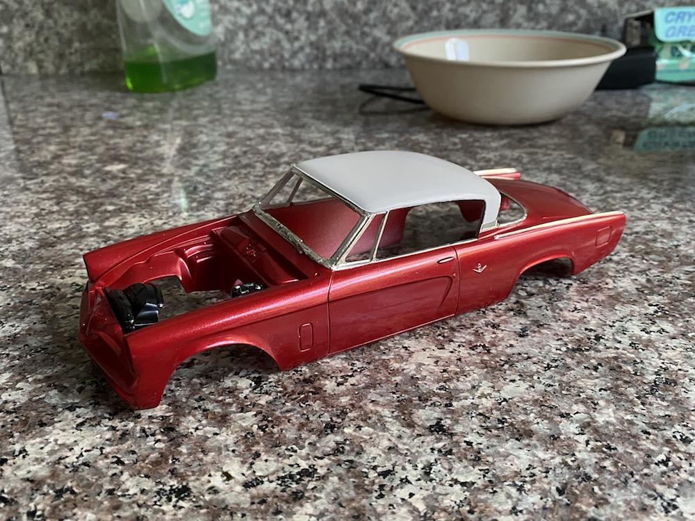

  23. Thanks for that tip, Gregg. I will have to experiment with that. Shot the exterior paint, and it's not quite what I expected. It looked better on the spoon! The red is a little brassy, but the more I look at it, the more I like it. The paint went on ultra smooth (Tamiya acrylic white for the roof, Tamiya rattle-can Mica Red lacquer for the body, both over Tamiya light gray primer). Impatience got the better of me and I masked the roof while the paint wasn't fully cured, so it had some tape imprints. Fortunately, it looks better now after color sanding with 2000 grit. I'm so pleased with the gloss that I'll forgo the clear coat on this one.
  24. Interior is mostly done; just gotta do a few paint touch-ups and add a couple more things...aftermarket tach on dashboard and a fire extinguisher.

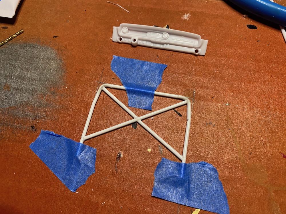

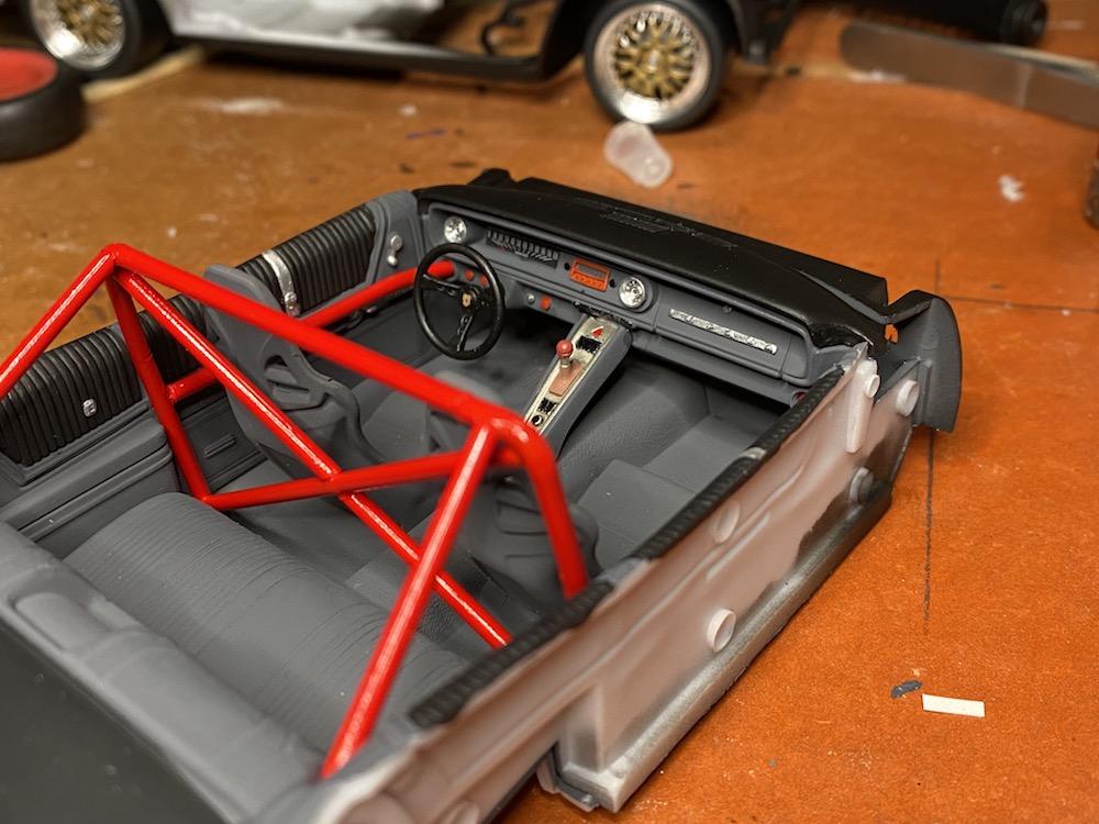

  25. Some progress on the rollcage...here's the main hoop. The door bars line up perfectly with those lower dash vents. Hey, no HVAC needed in a race car! Or drip rails or emblems, for that matter, so that will all be shaved.
