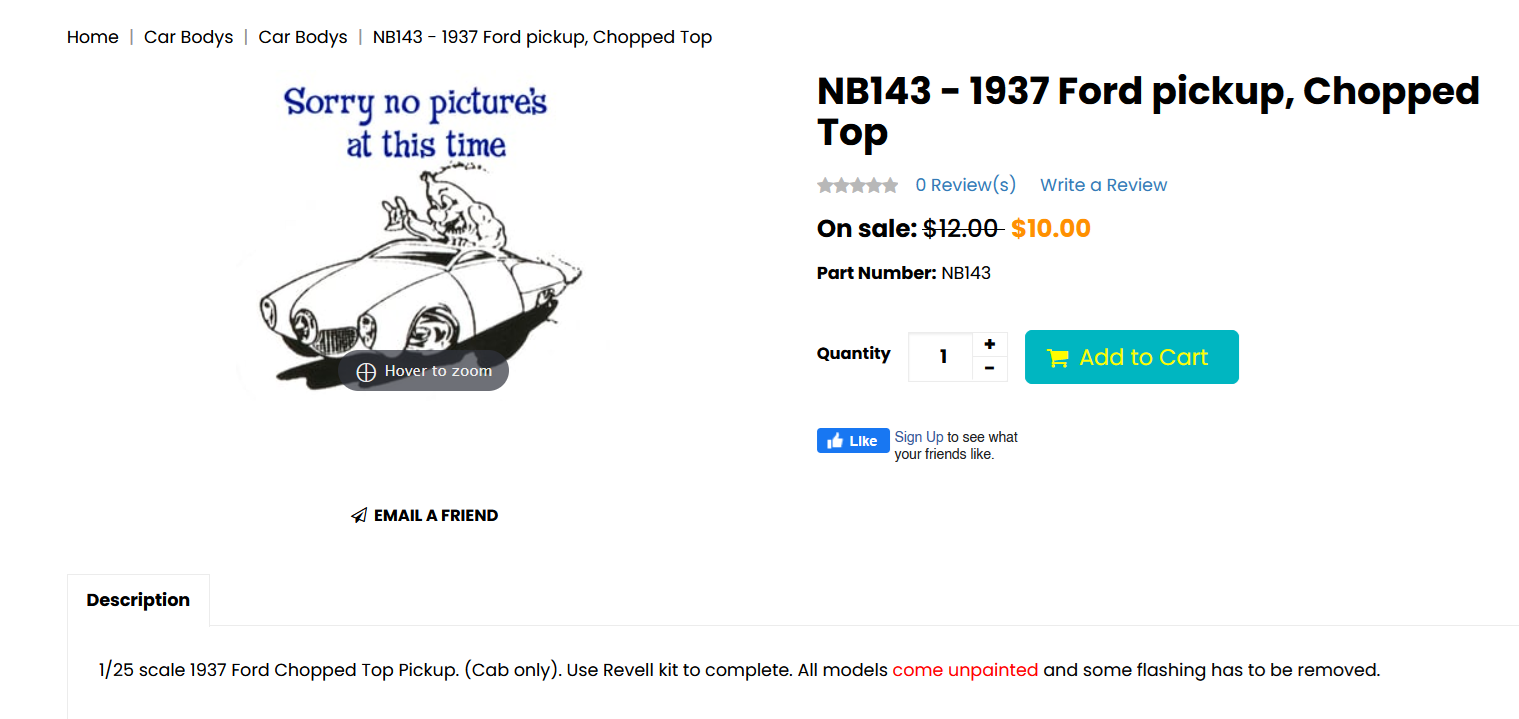

There were a few diecasts from Autoworld and Danbury Mint, among others. R&R Vacuumcraft and Ron Cash offered some resin bodies/kits a while back. There might have been more, but I can't recall any others at the moment. I don't believe there has ever been a full on plastic kit of one. Jimmy Flinstone still offers a chopped resin body. https://jimmyflintstonestudios.com/NB277--1948-Divco-Chopped-Delivery_p_344.html
