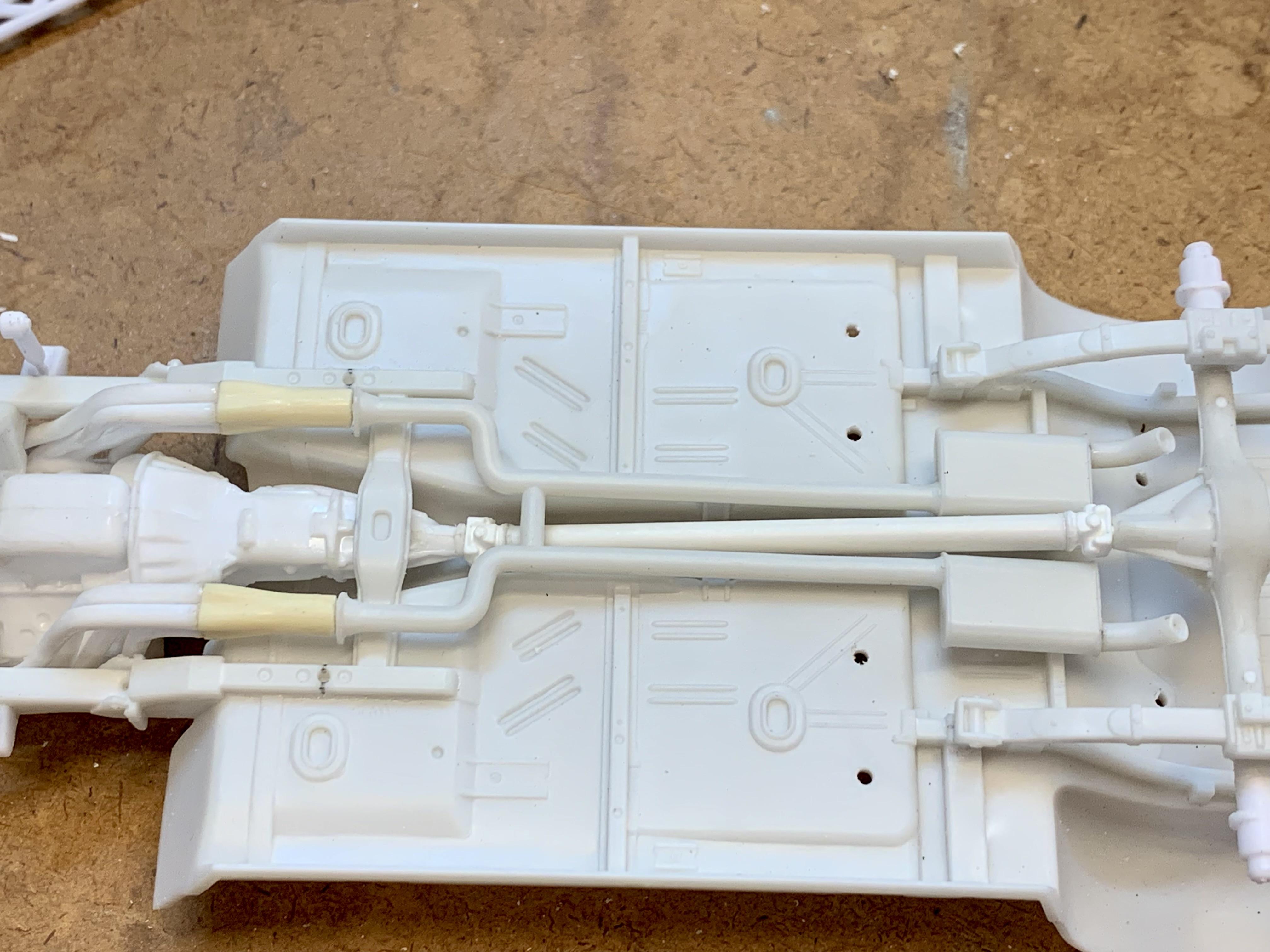

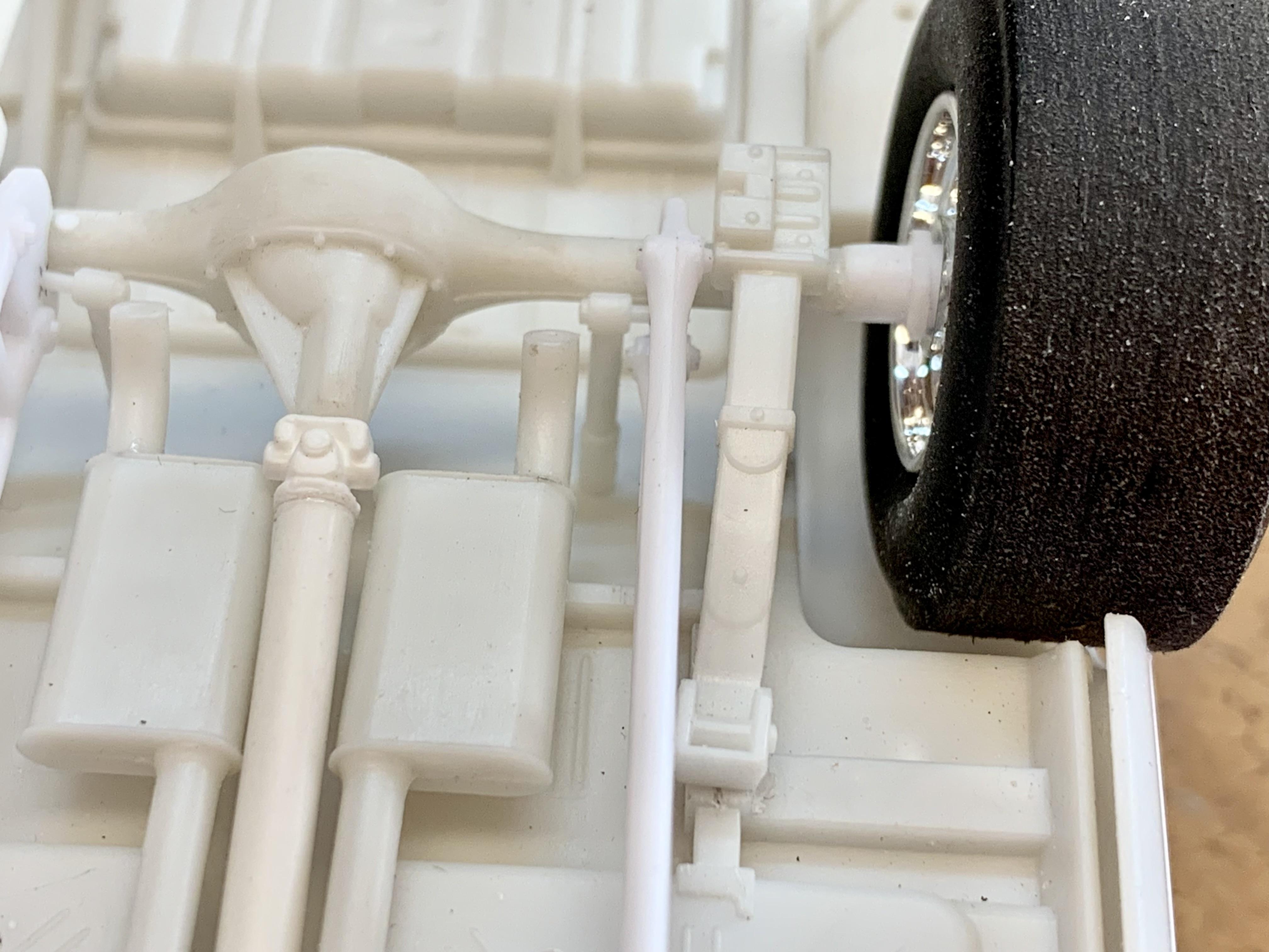

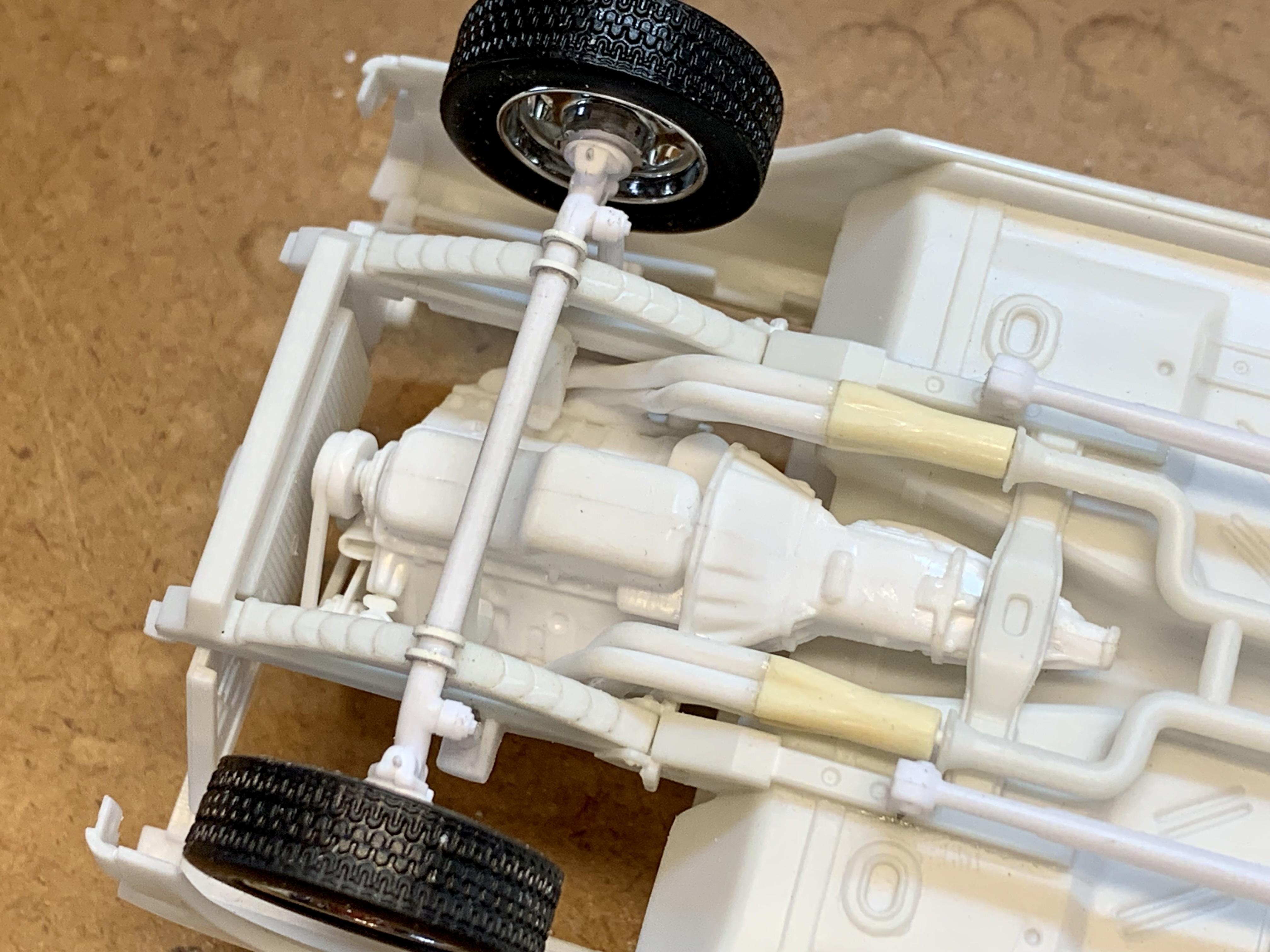

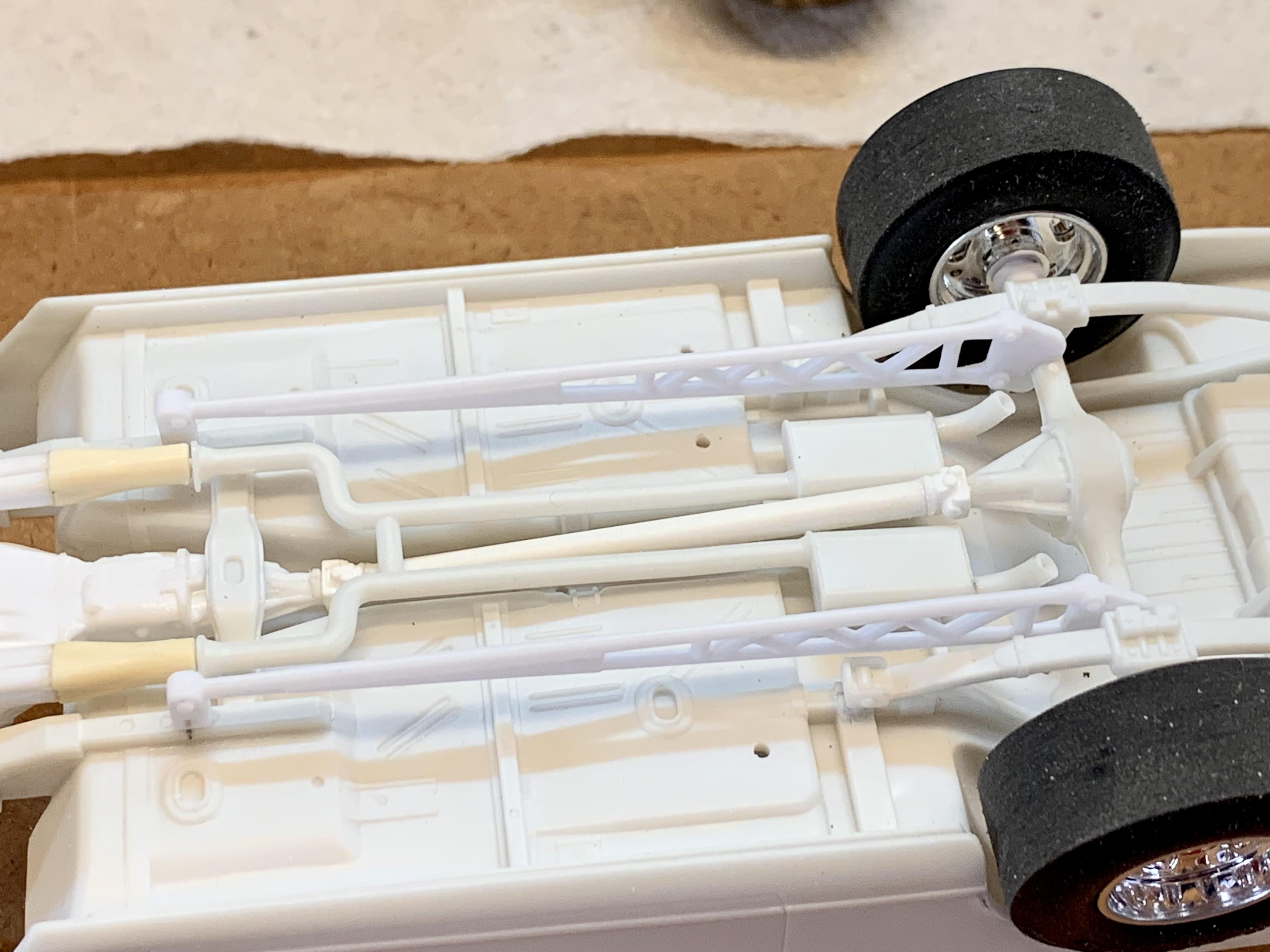

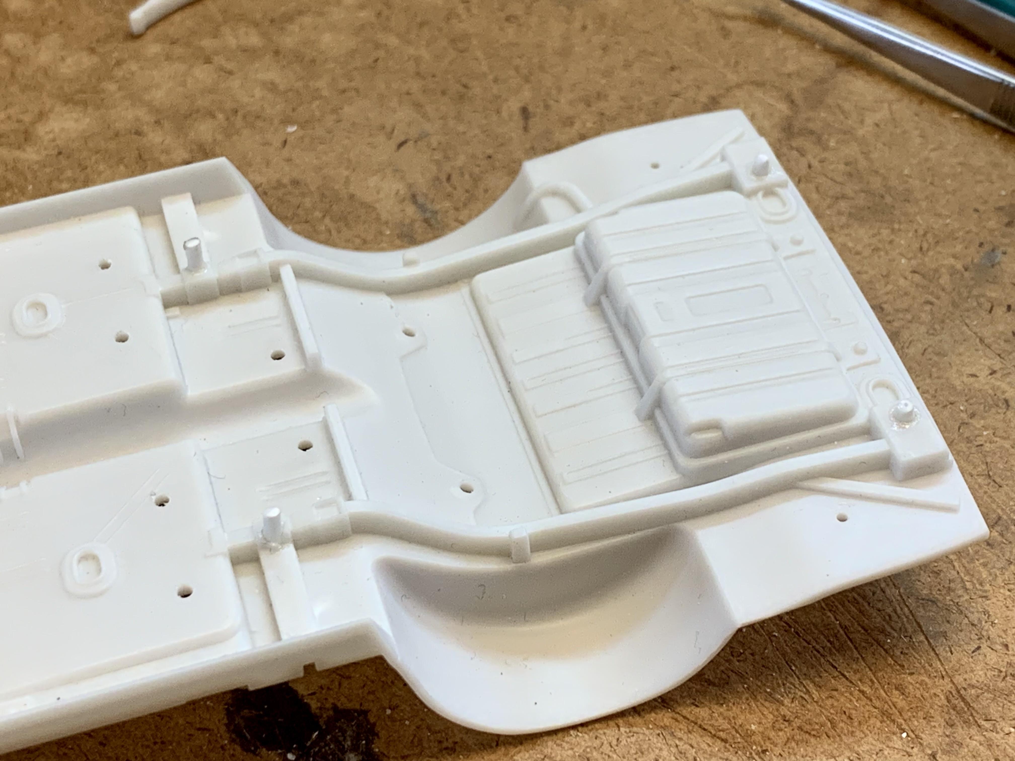

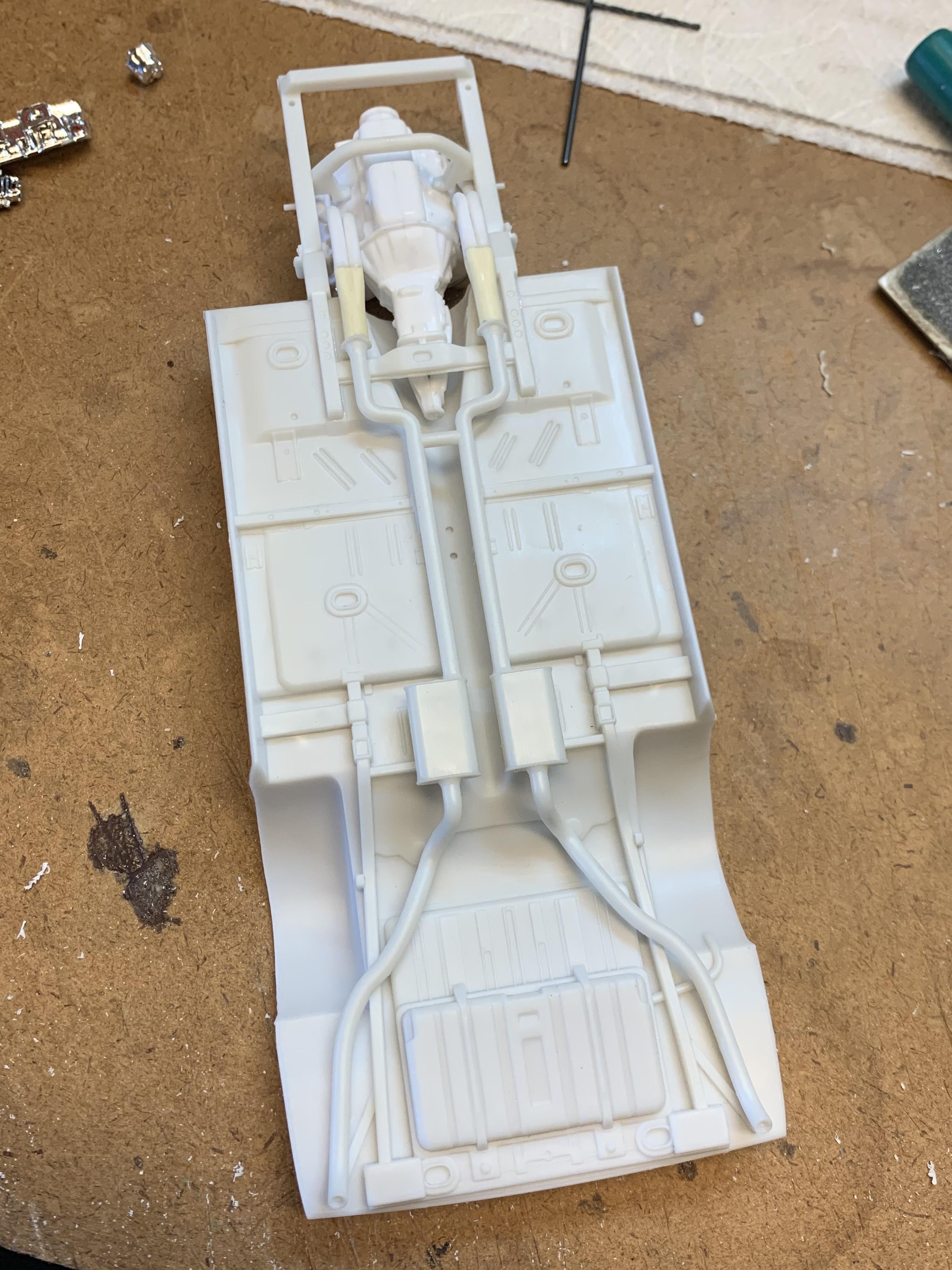

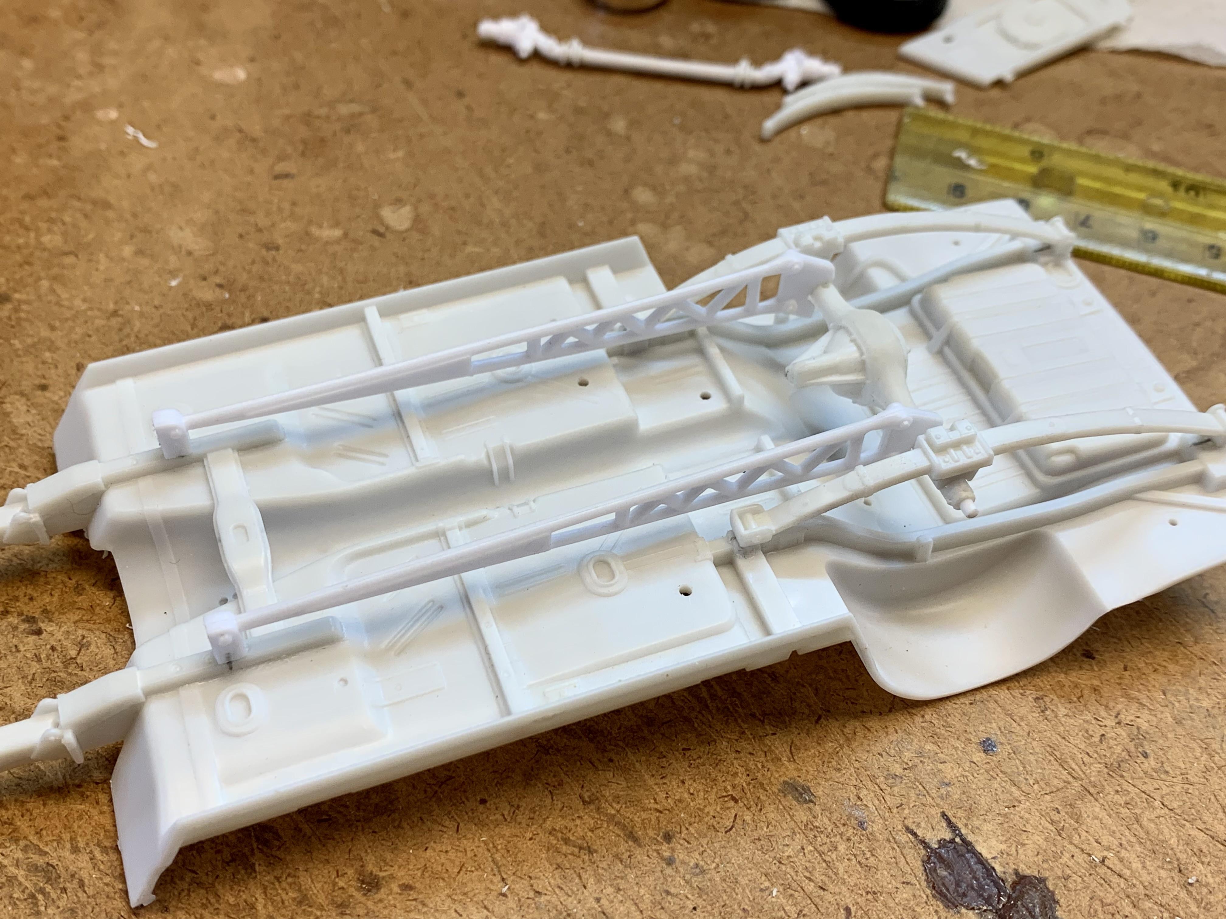

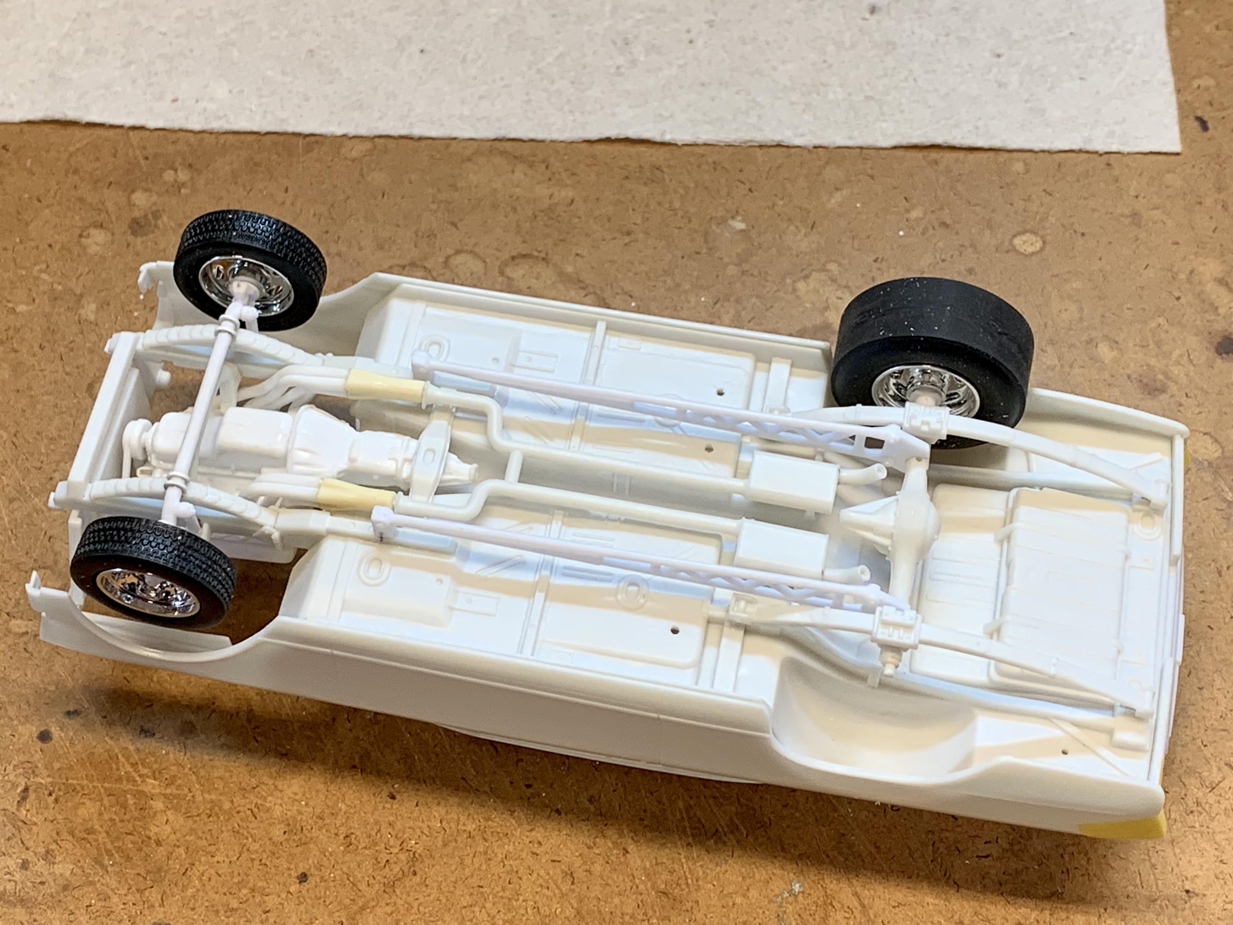

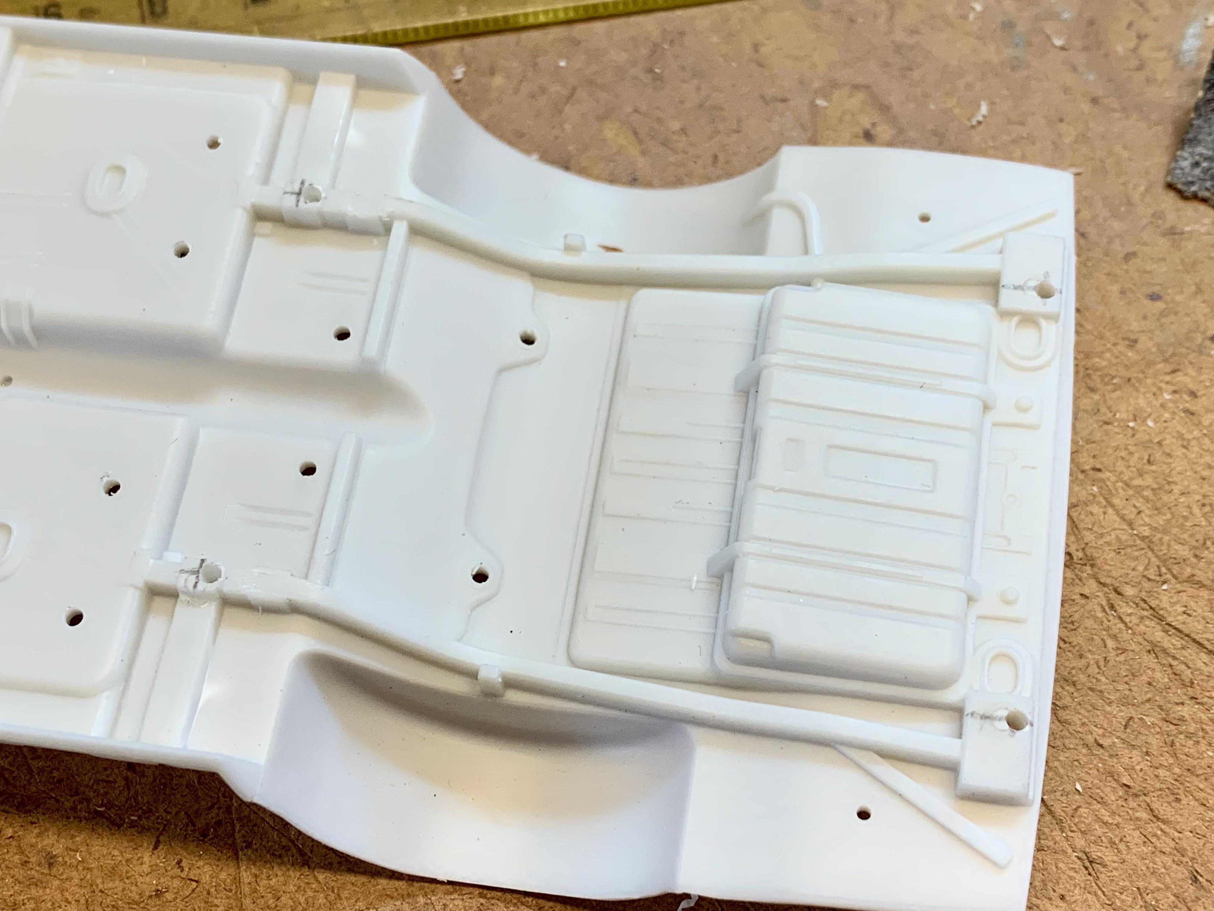

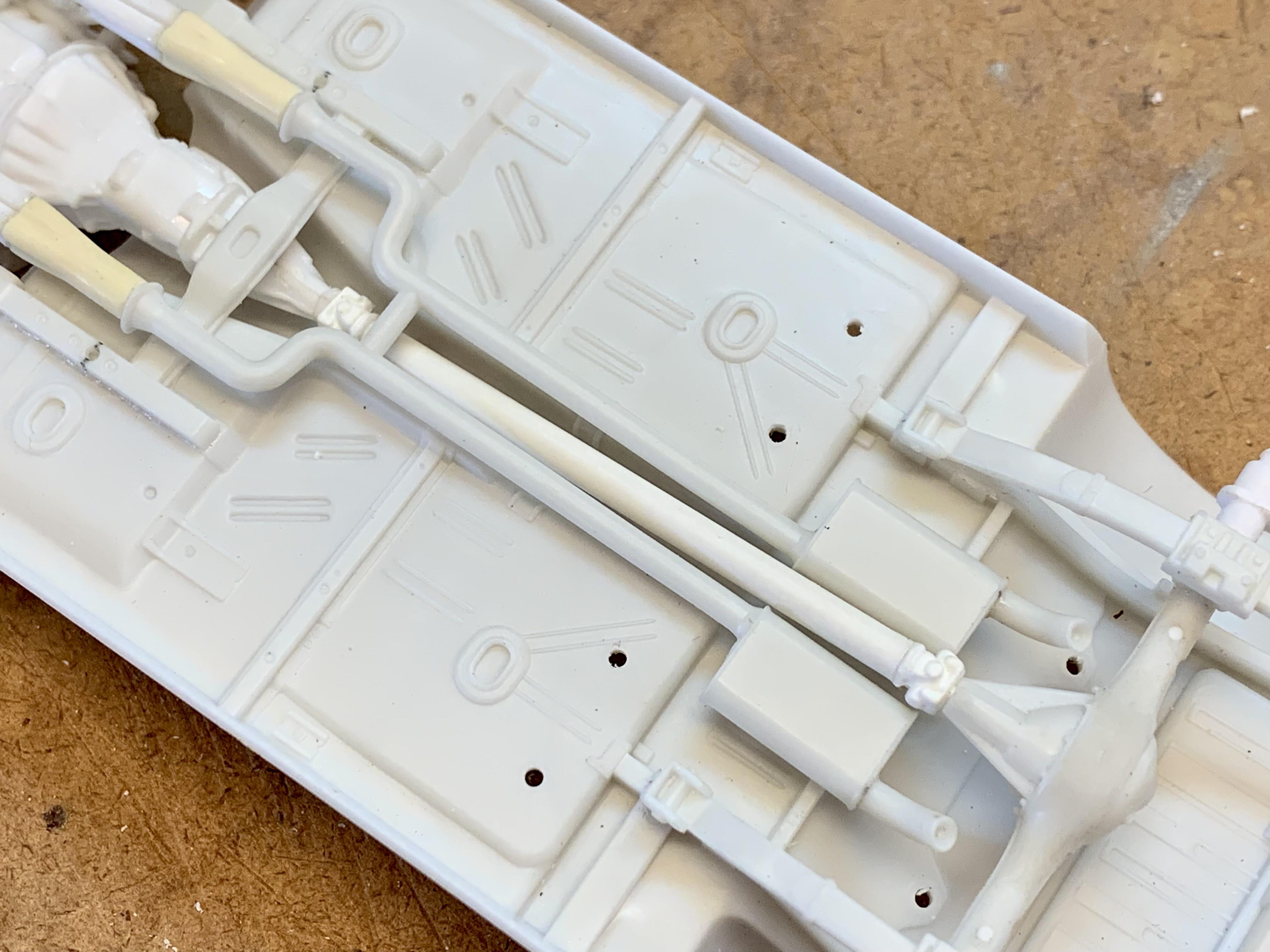

Finally found my way to the workbench for a few hours last Sunday. Previously I had roughed-in the exhaust but it needed finishing such as blending the glue joints on the tailpipes and smoothing all the mold seams. The tips were drilled out to make the tube thickness more realistic along with a shallow angle cut. The big mounting notches in the gas tank for the kit exhaust were smoothed and some discrete .040” mounting pins installed. Thats about it for the fab work so I spent the rest of the time starting to generally sand and get things cleaned up moving towards primer. It’s been unusually cold and wet this winter here in SoCal so hoping for some good paint weather soon! Still undecided on main and accent color, tossing around some ideas…

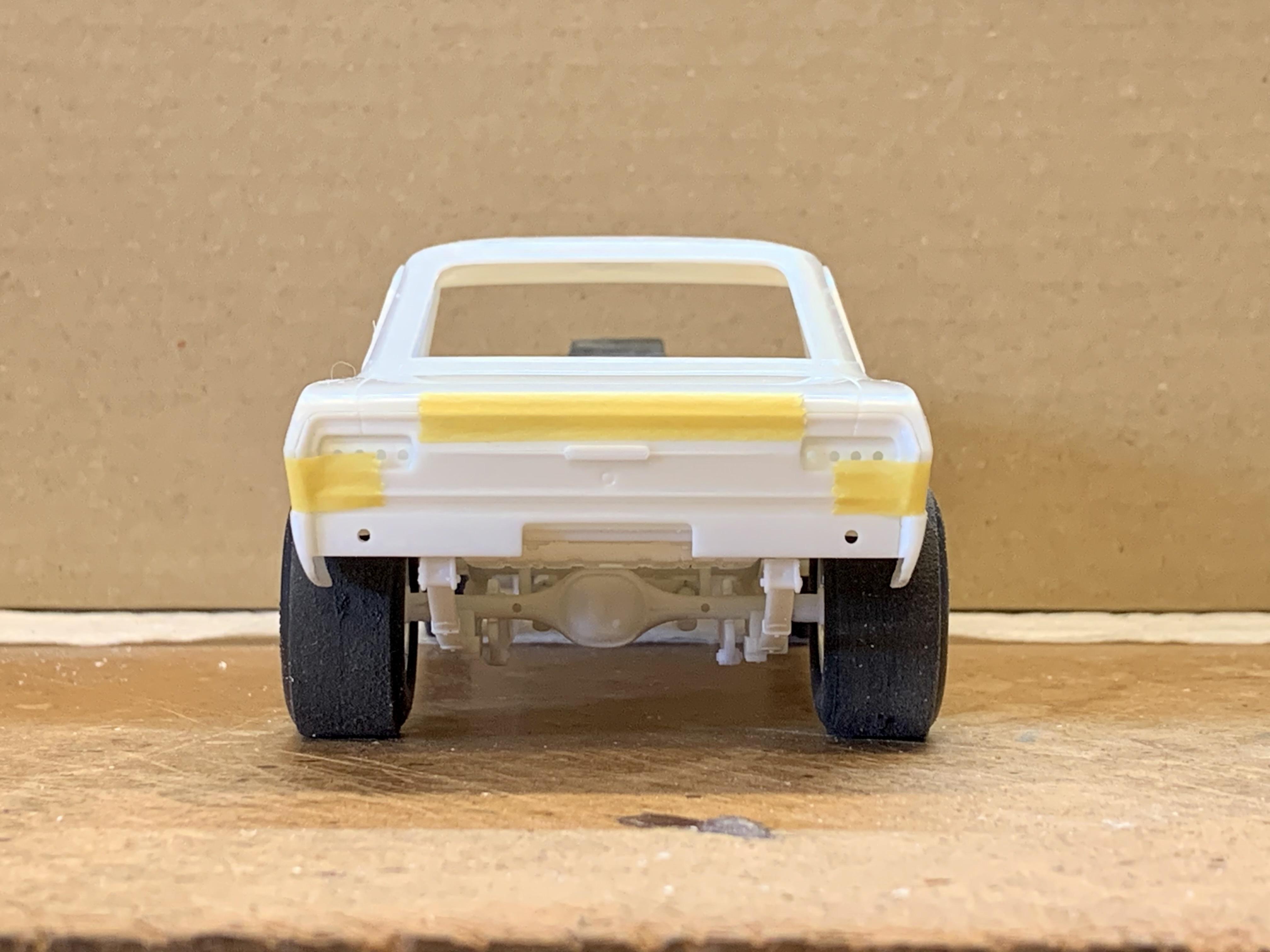

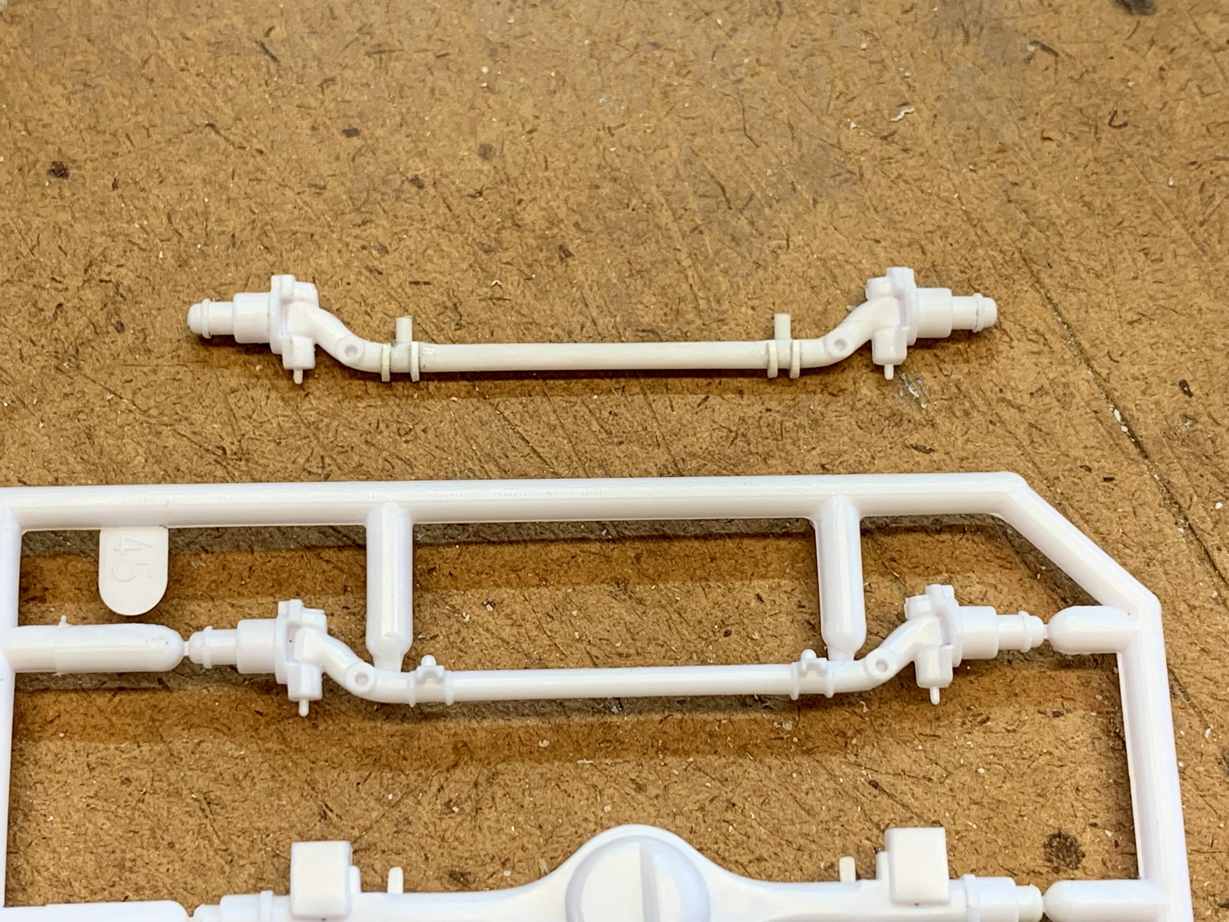

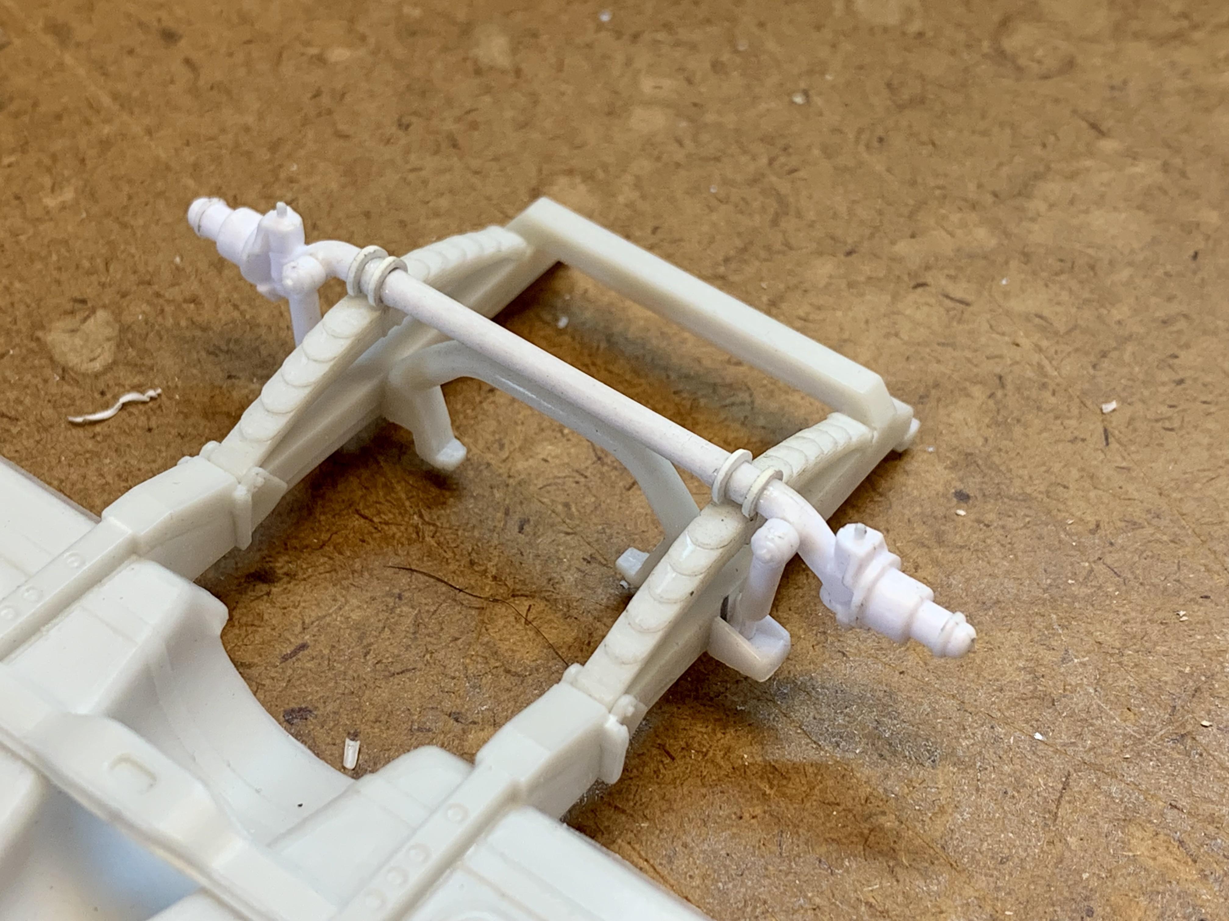

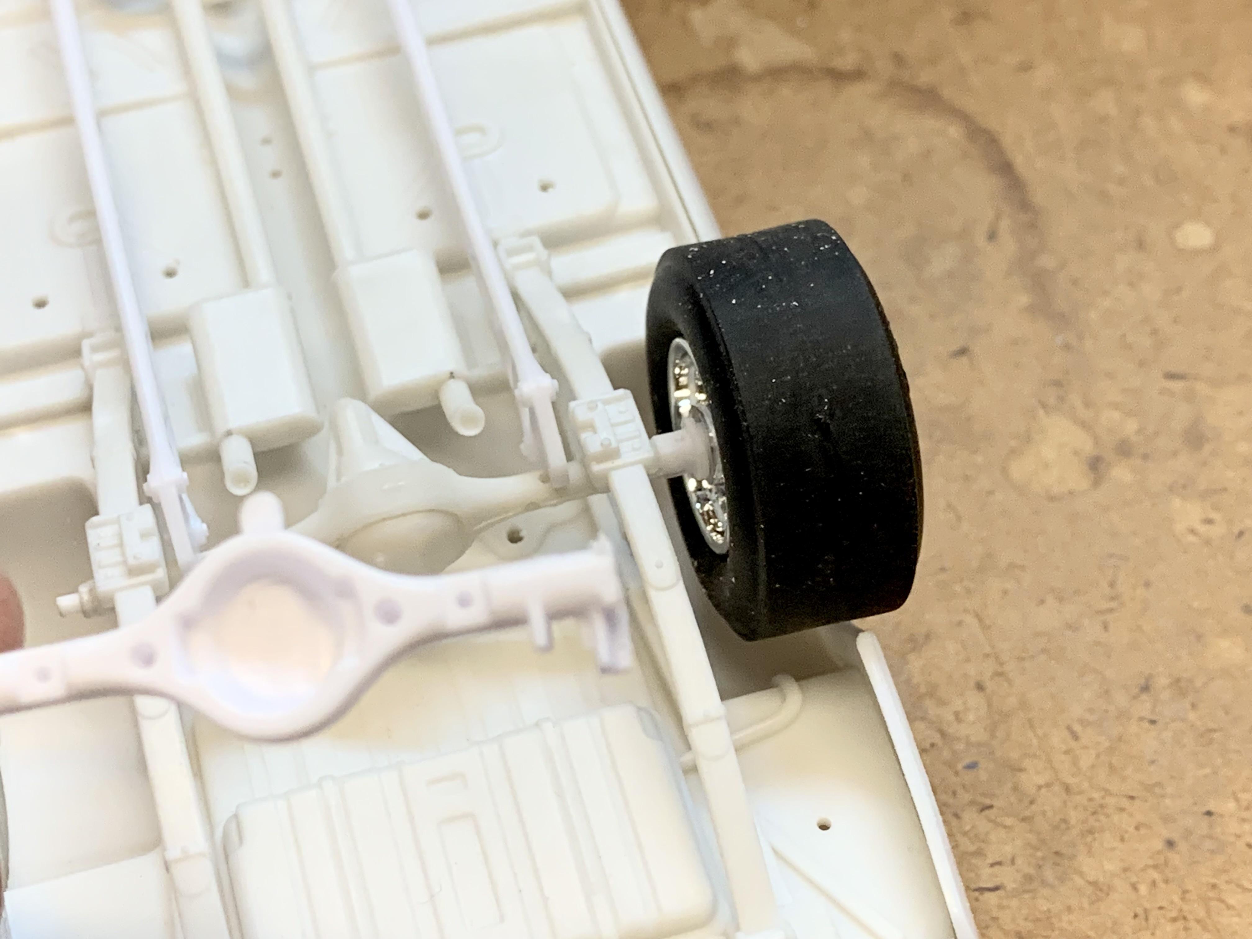

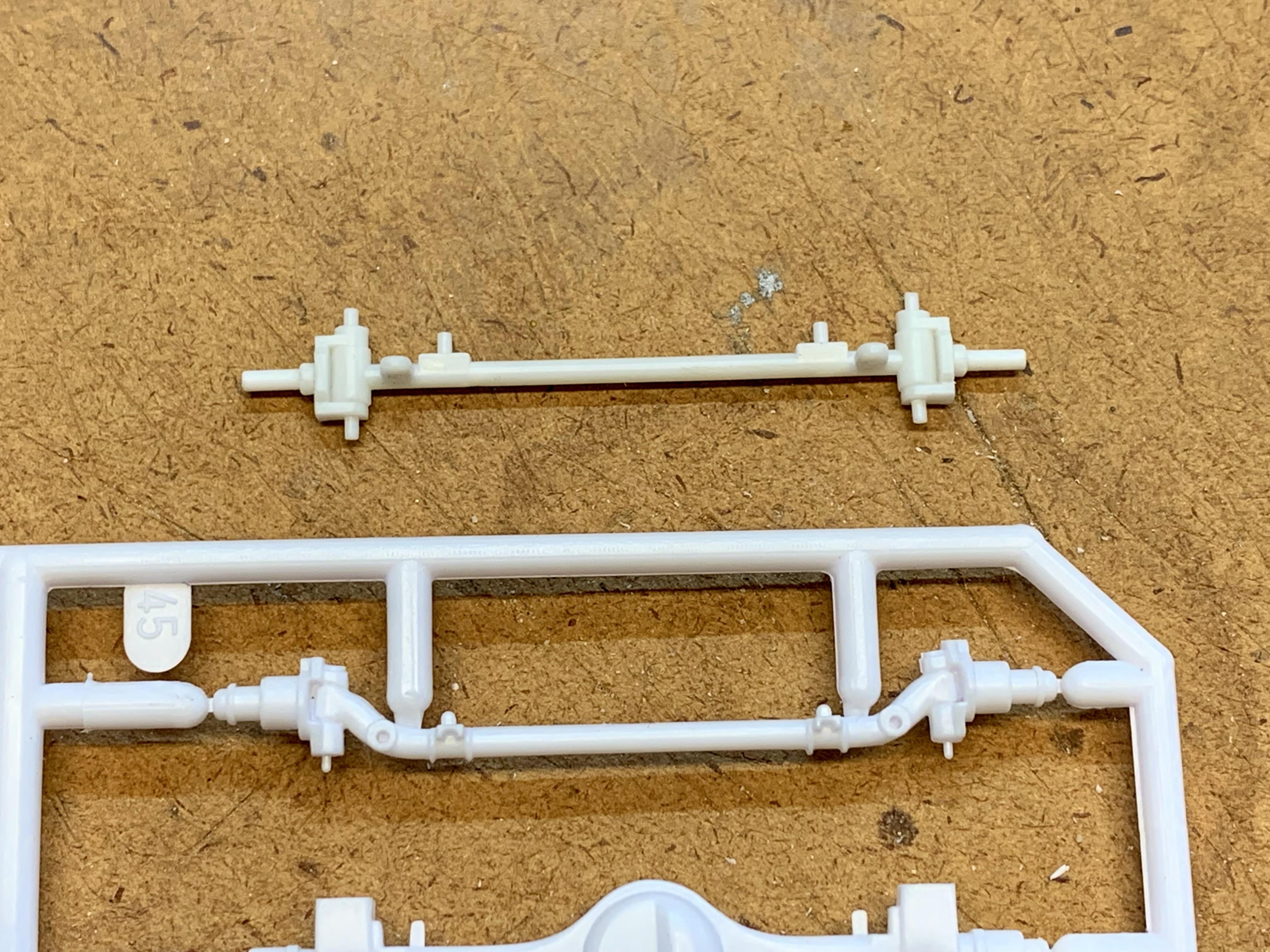

That’s a nice solution you came up with. The consistent “pipe” size and fully enclosed mufflers look so much better. The thing about lowering this kit is that it also requires modifying (or changing) the wheels to tuck them in because the way the kit builds it puts the tires poked and under the fender edges. The front axle I changed to is a good bit narrower.

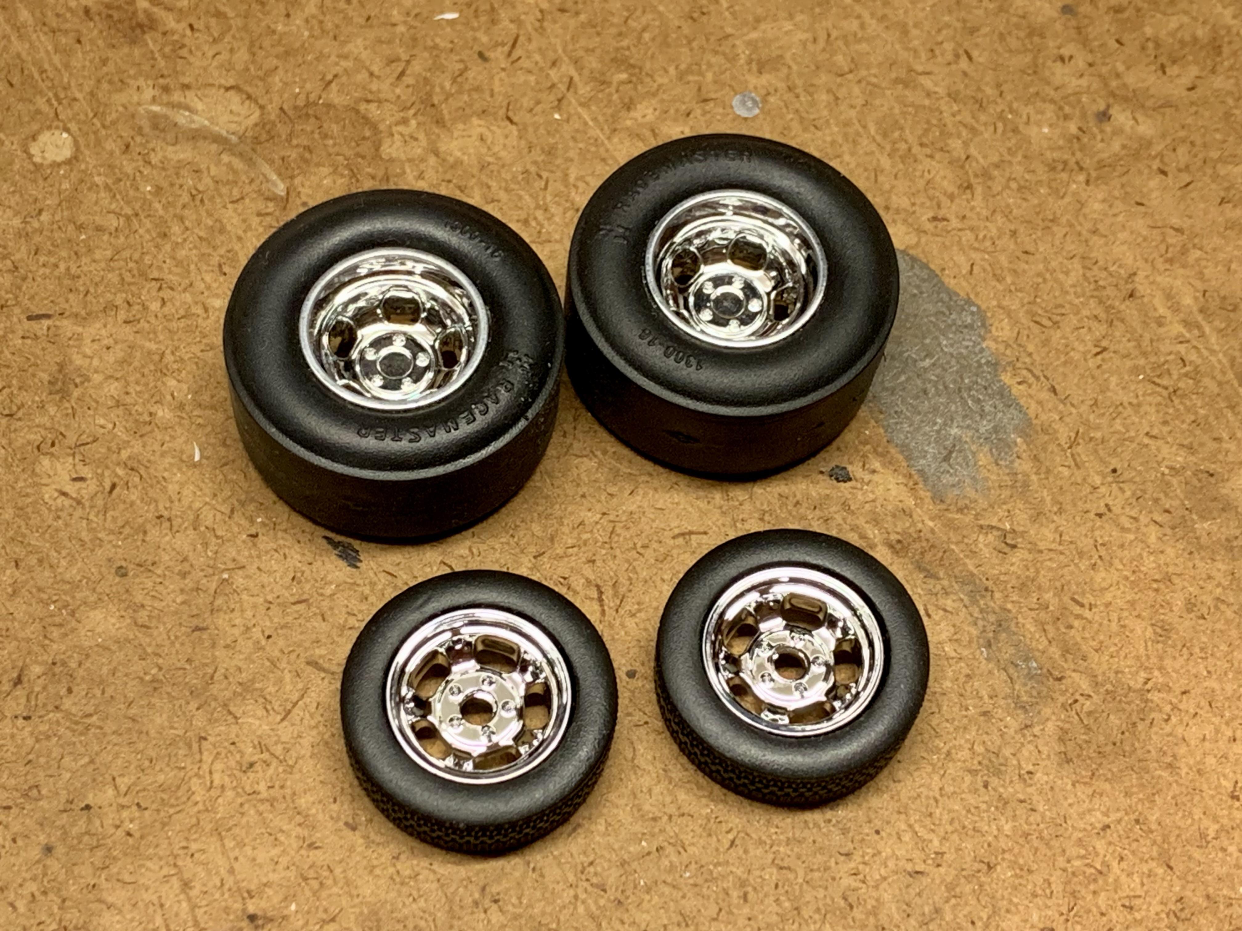

No surprise there, Phil! I imagine you’ve built your share over the years. Thanks, Jason. I hear ya on the wheels. IRL I don’t think I’d put them on anything but I thought some 70’s vibe might be cool in this case. I actually started with the same tires but the Kelsey Hayes style wires from the ‘30 Woody. Unfortunately the way they are made wouldn’t allow for tucking in under the fenders enough. Couldn’t modify for enough back-space. Hard to go wrong with Lil’ Deuce tribute. I’m sure it’ll be bitchin’ when you get to it.

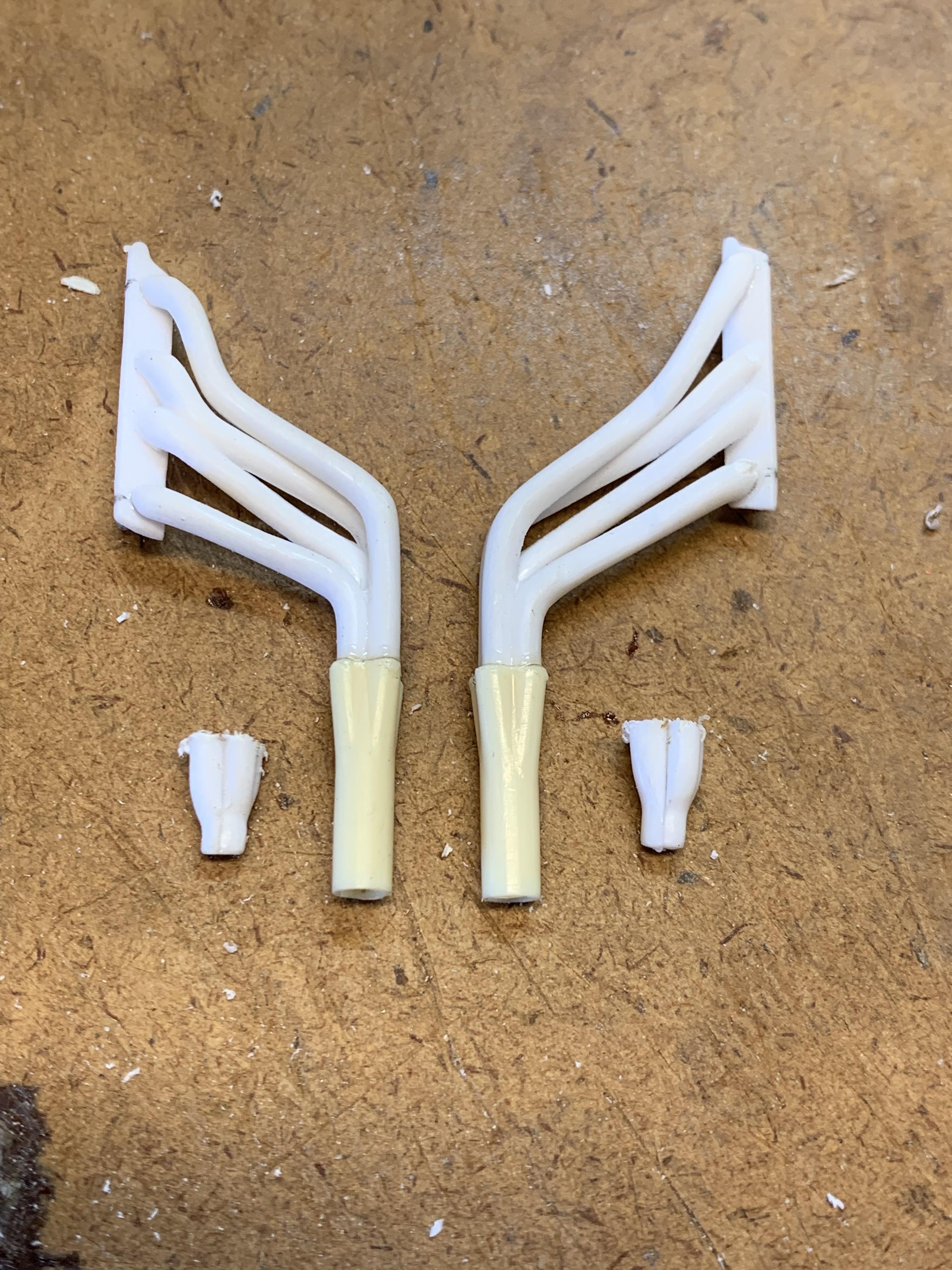

HA! That’s because it can be a pain the ass! Most of the time my scale exhausts end up being made from a bunch of pieces cut, pasted and blended together, not to mention pinning every joint for strength. Then multiply x2 because most everything I build has dual exhaust. I tend to dread it. Not very different from scratch building full scale exhaust systems…
