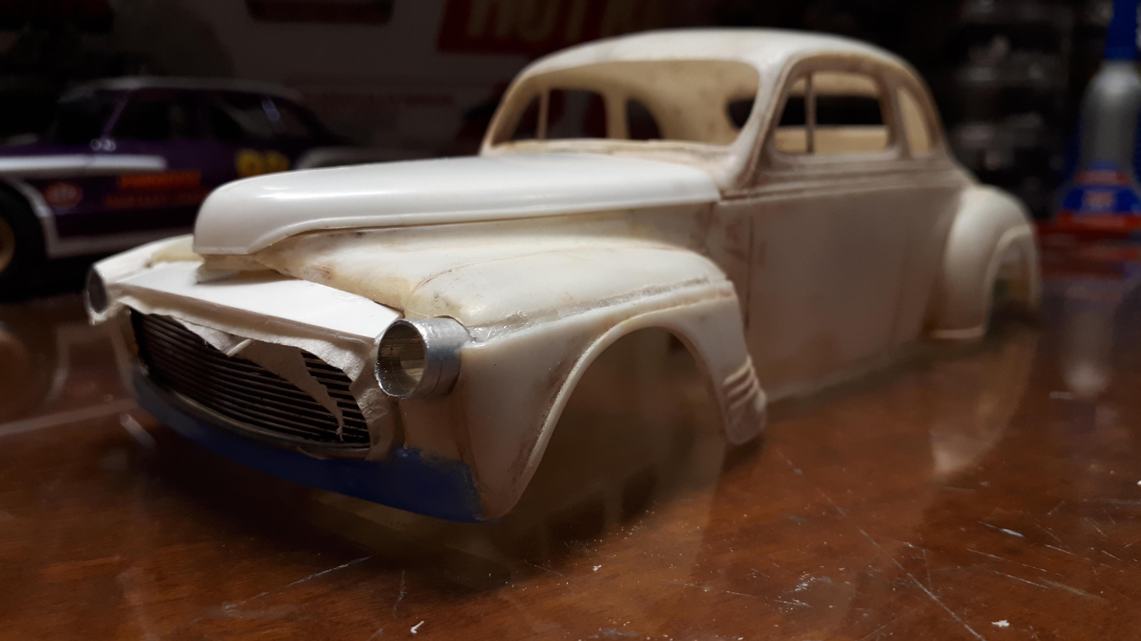

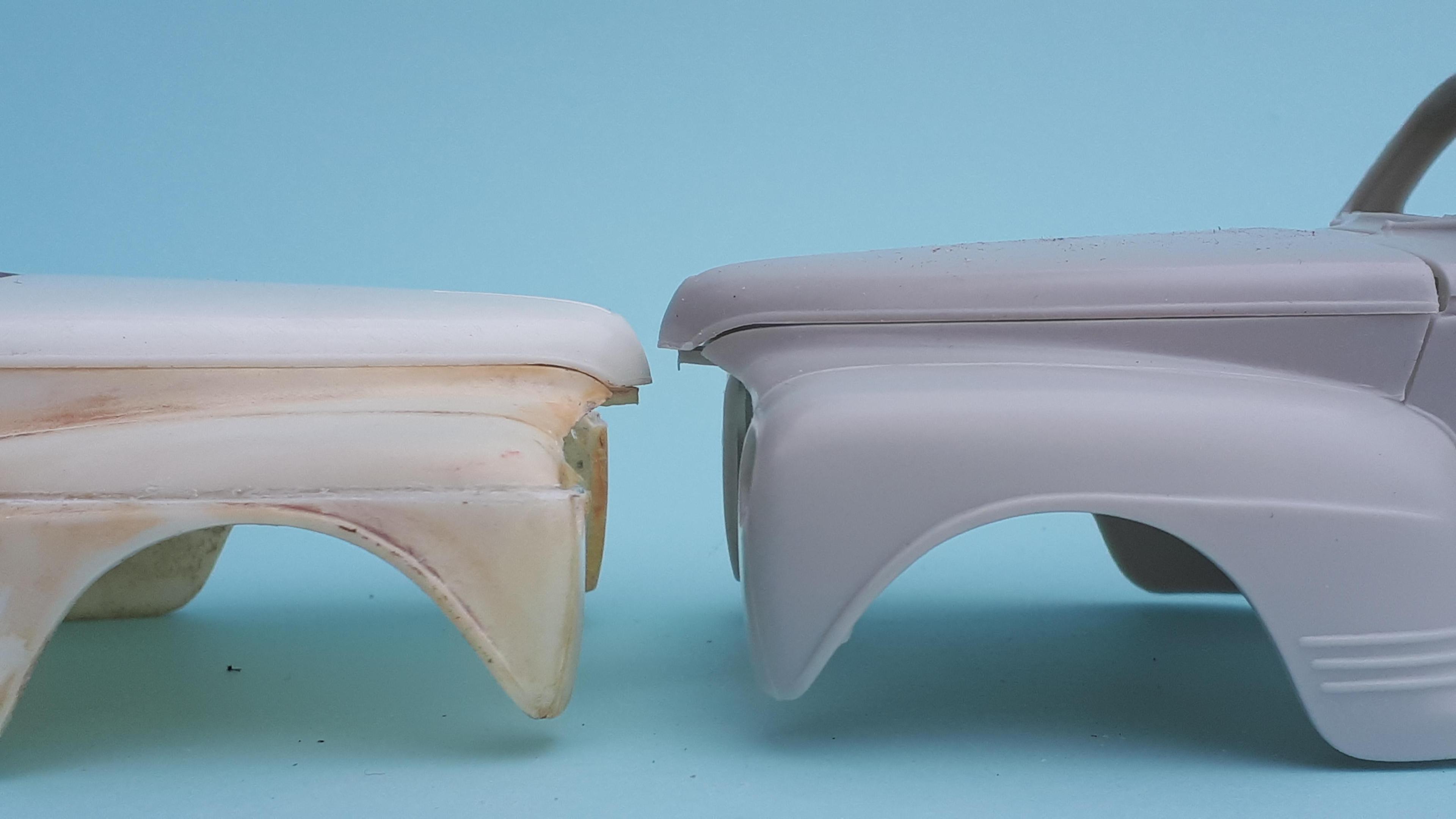

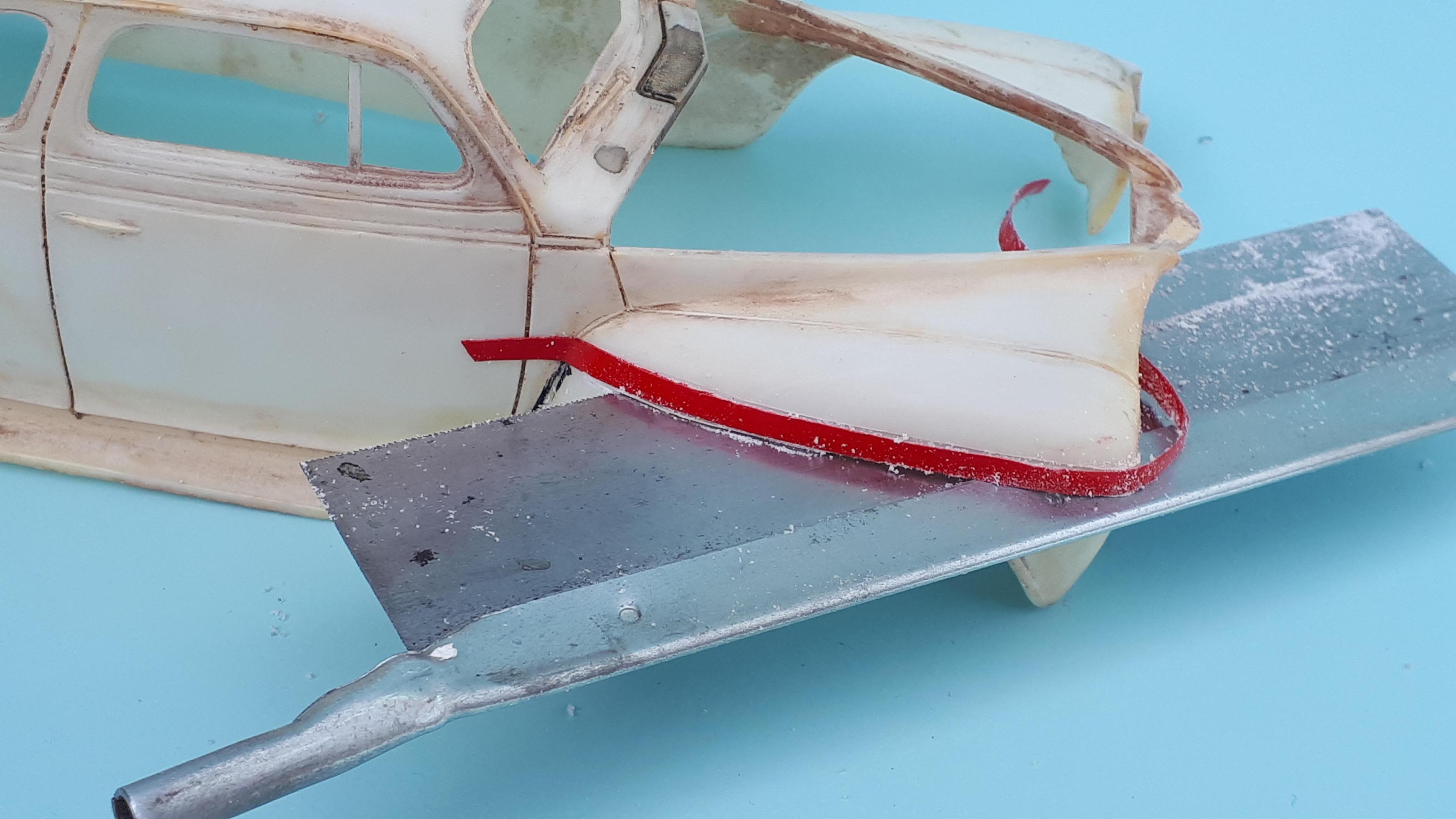

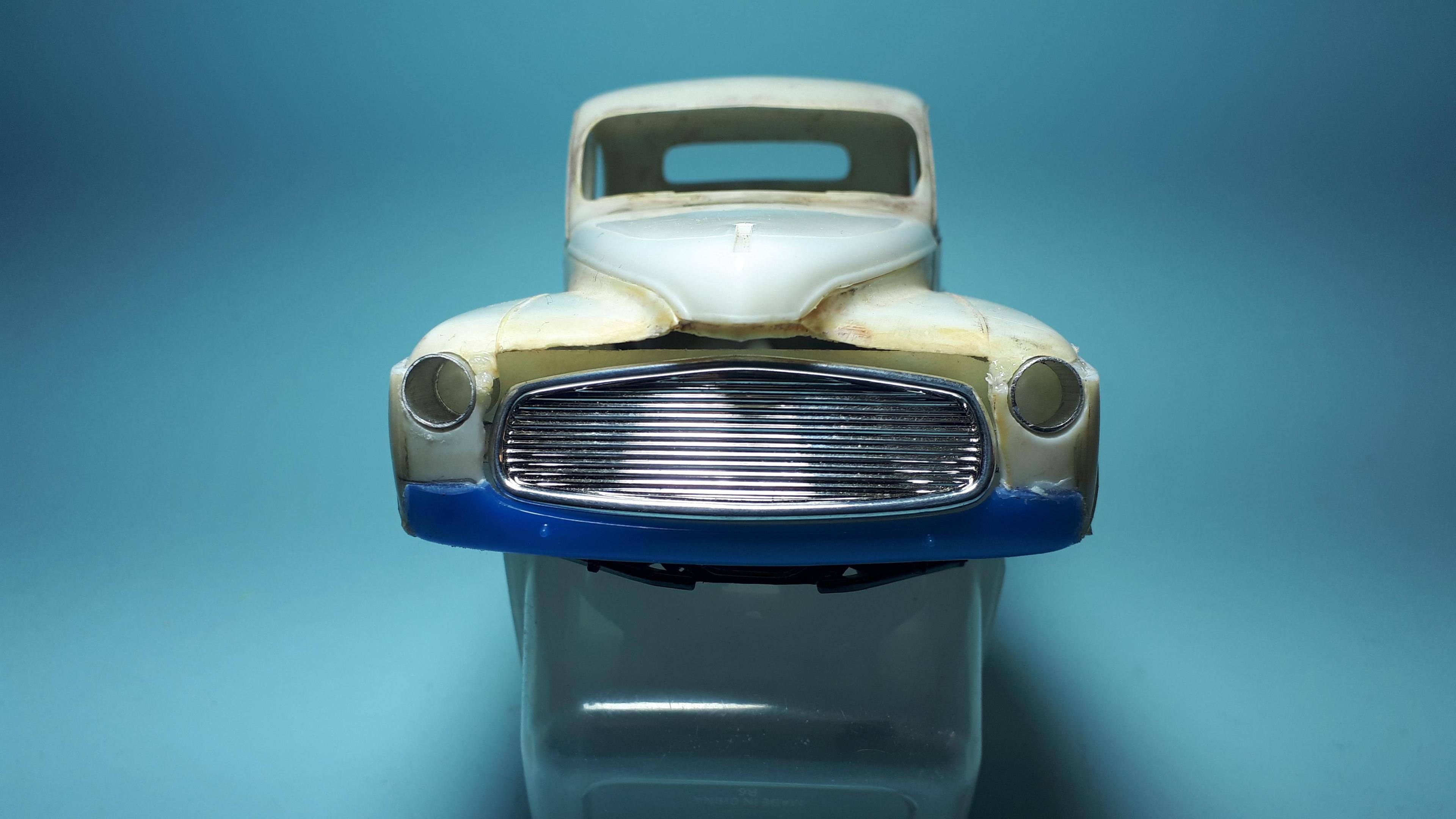

I'm not going to pretend that this is pretty or refined bodywork - it's not. I just let the car talk to me as I progressed and sometimes I had to go backwards to go forwards. You will see a lot of bog in the next bunch of photos ( you say Bondo, we say bog) but most of it ends up on the floor anyway! This first overhead shot shows the beak of the hood contrasting with the absolute flatness of the front grille panel. The other two Plymouth posts currently on this forum are spending a lot of time correcting this area and I am indebted to them for detailing their work as they go as my planned Plymouth conversion will need a much improved grille area. But our affluent teenage owner wants none of that boredom on his ride so we are going for a full custom front. I needed to establish some integrity in the front end before getting into the styling so I glued in place the rollpan of an AMT 51 Chevy. If nothing else it gave me a solid foundation to work with. The next step would be to install frenched headlights. I have seen this technique used before for frenched headlights but this is the first time. I have tried it and I must say it works very well. First, select the headlight lens you wish to use. Then, find a diameter of K&S aluminium tubing that the lens will sit in snugly - this will later become your frenched headlight ring.. You then need two more sizes of tubing, one the next size larger than this tube, the other the next size smaller. K&S tubing telescopes beautifully so we will be taking advantage of this feature. Cut two lengths of the largest size of tubing about 12mm or 1/2 and inch long. This will form the fender housings for your headlight. After all the sectioning work the front of the fenders are pretty fragile so I cut the opening roughly to size with a sharp X acto and then filed it to nearly the correct diameter. Finally I used a drill bit by twisting it in my fingers to ream it out to the accurate diameter. I took this opportunity to move these holes inboard as on the kit they are way too far out to the edge of the fender even if you were going for a stock look. Having done that I started to wonder if the custom 51 Chevy grille would work. It is very similar to the grille in an old Valley Custom creation called the Polynesian so would suit the period but it is very flat and one thing I wanted to get rid of was the flatness. It needed somewhere to sit so I roughed up an armature of sorts out of sheet plastic and glued everything into place. No going back now! -

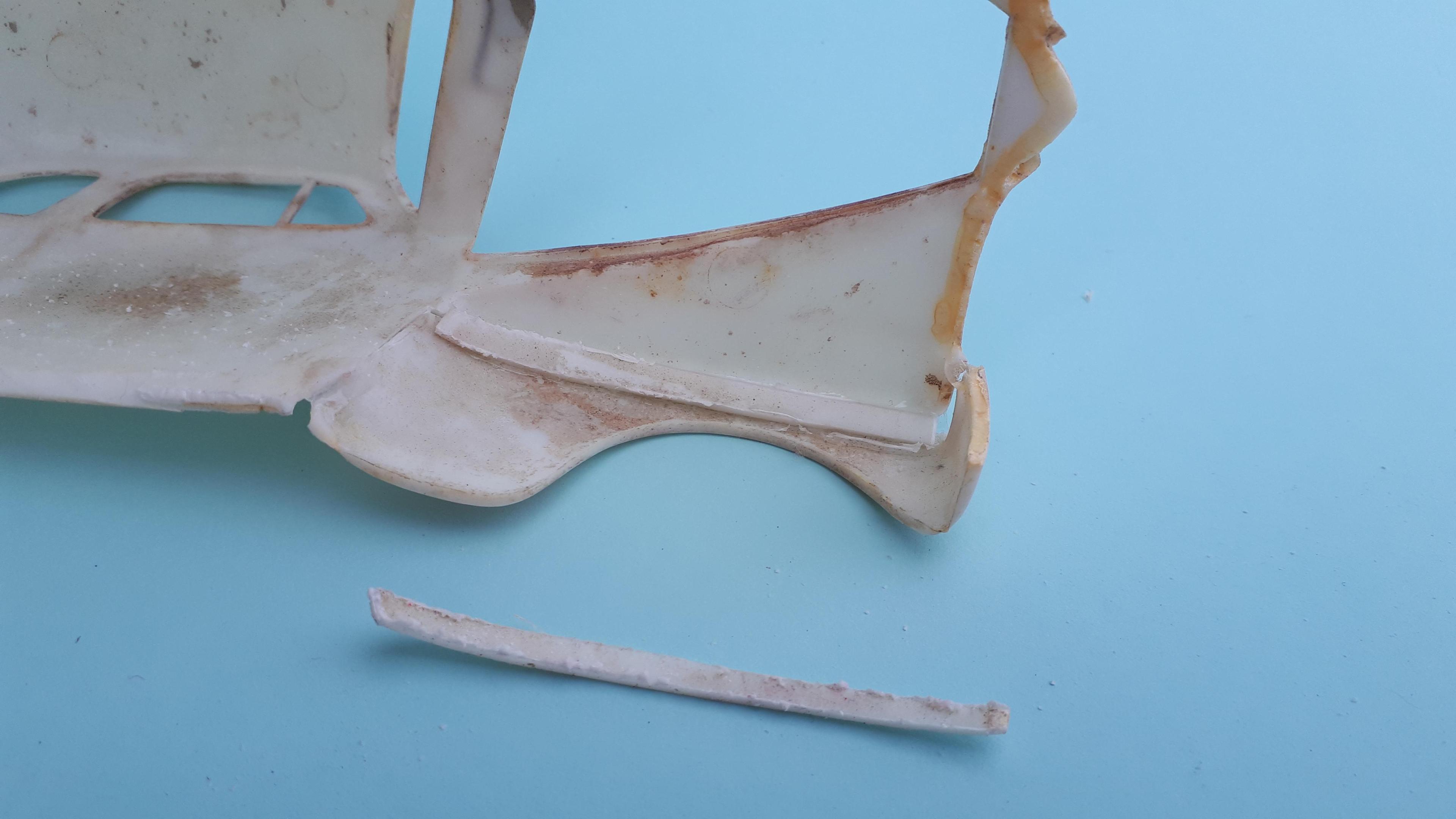

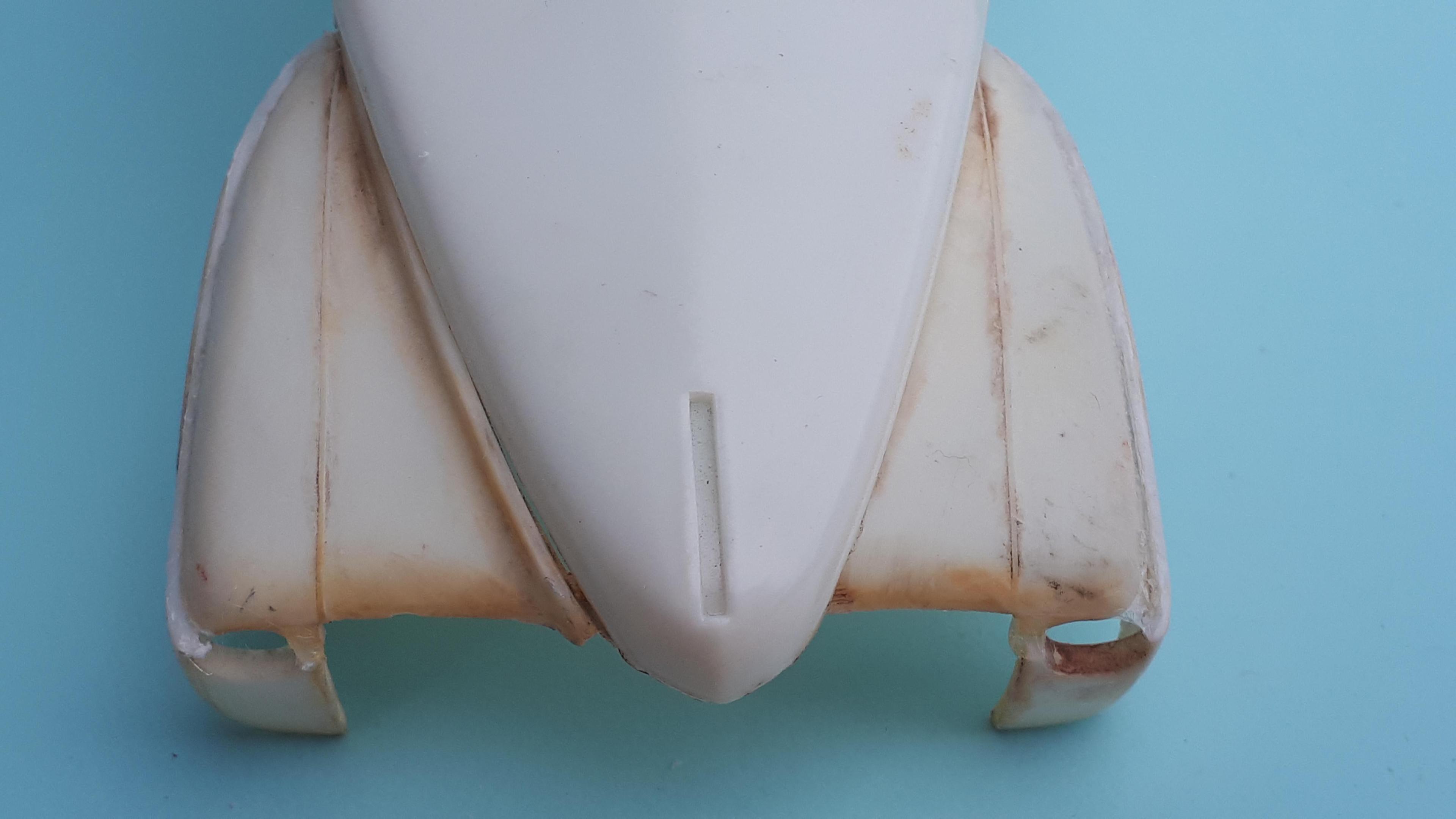

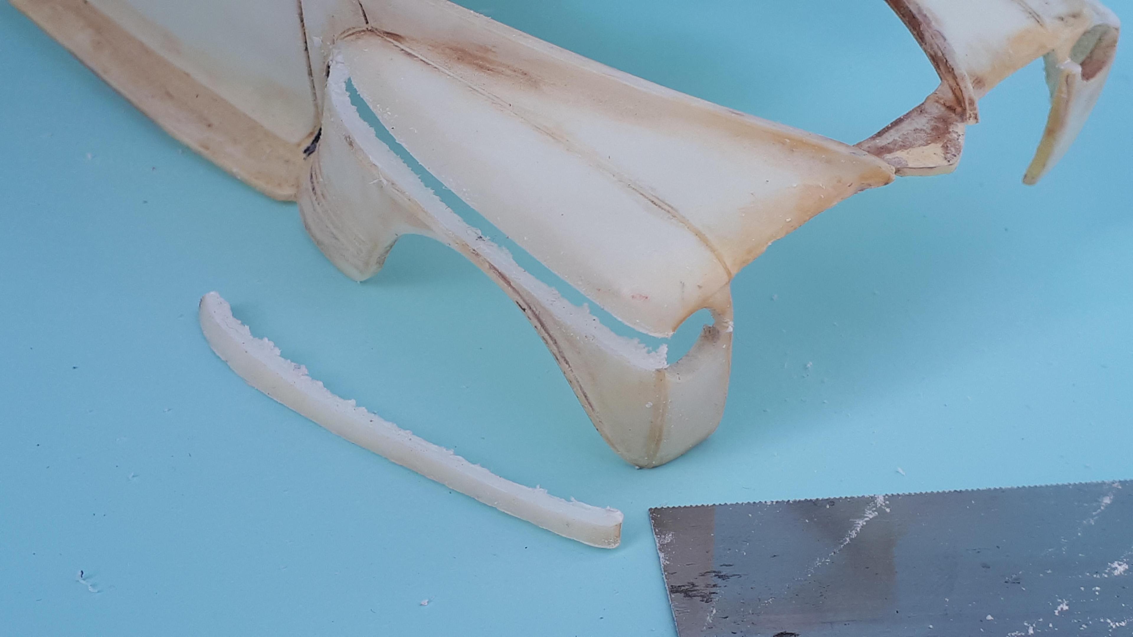

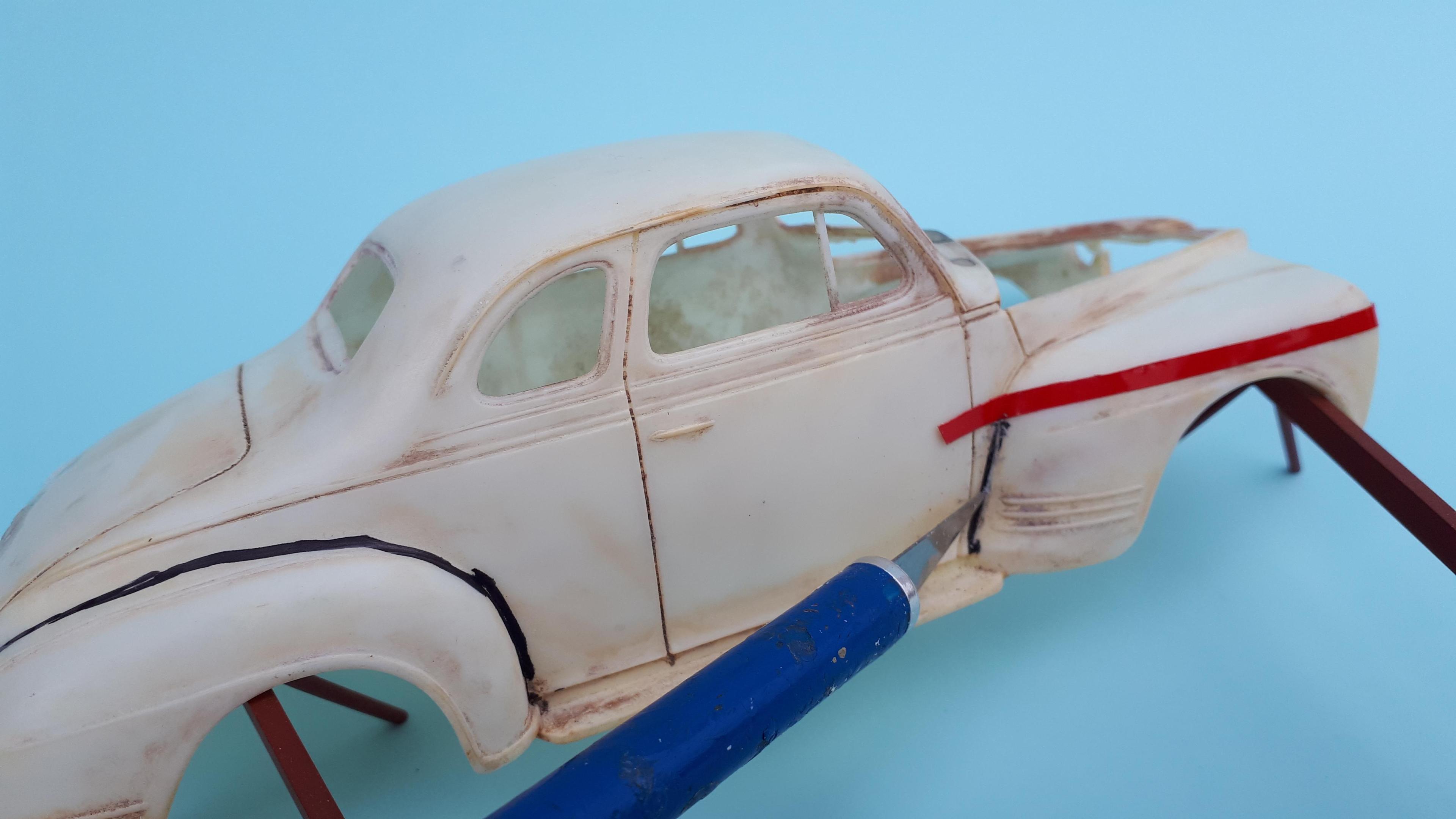

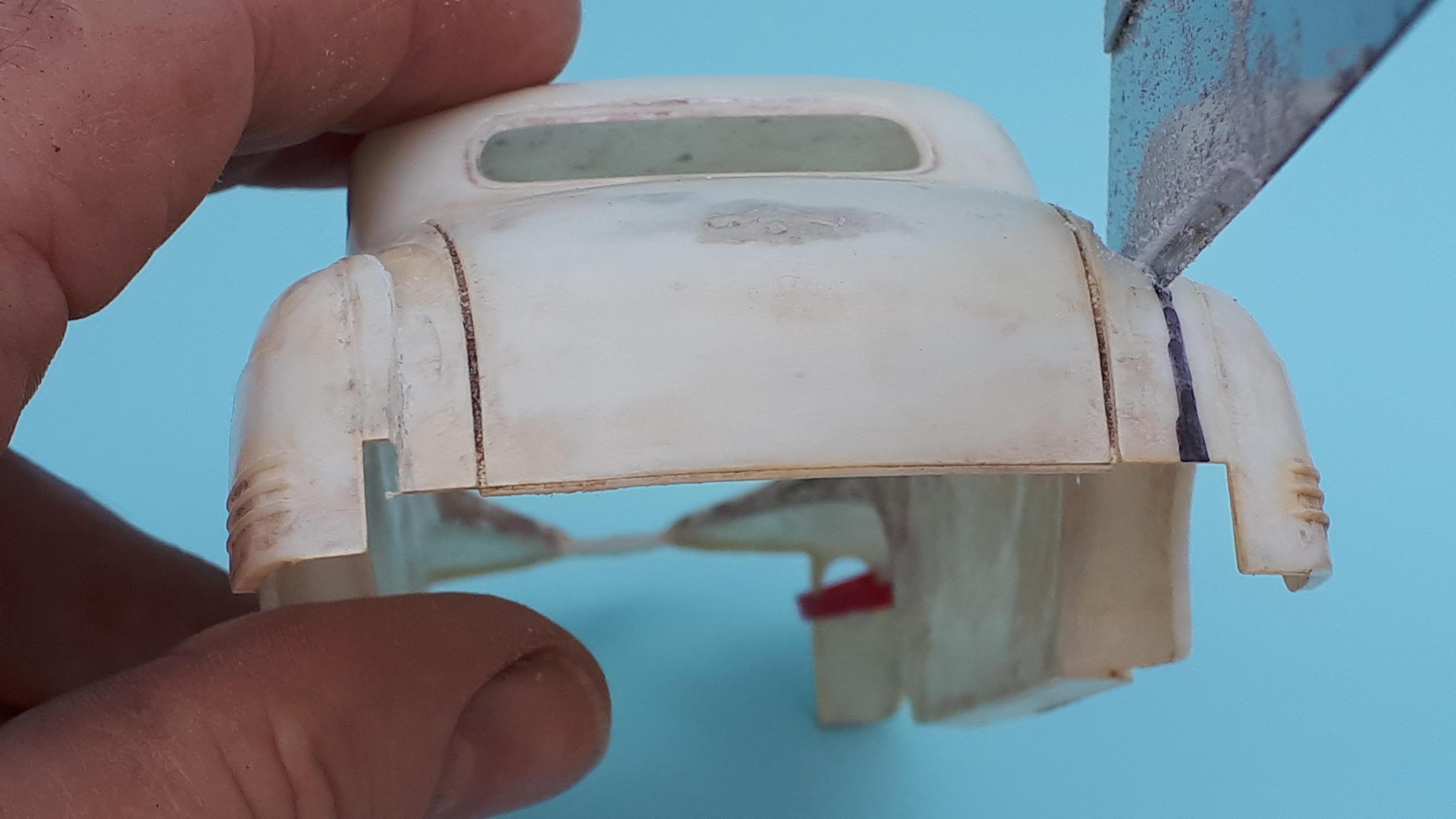

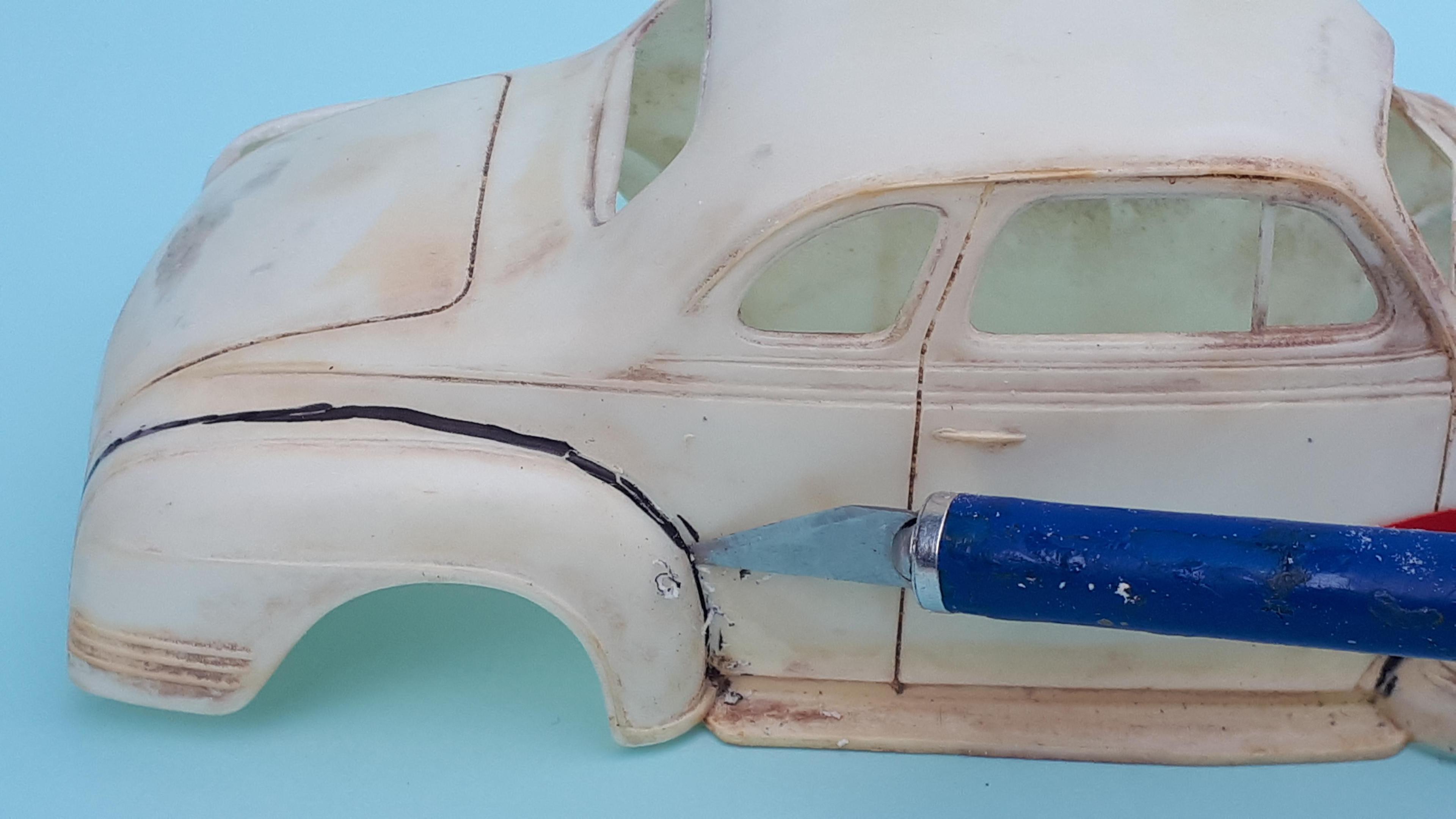

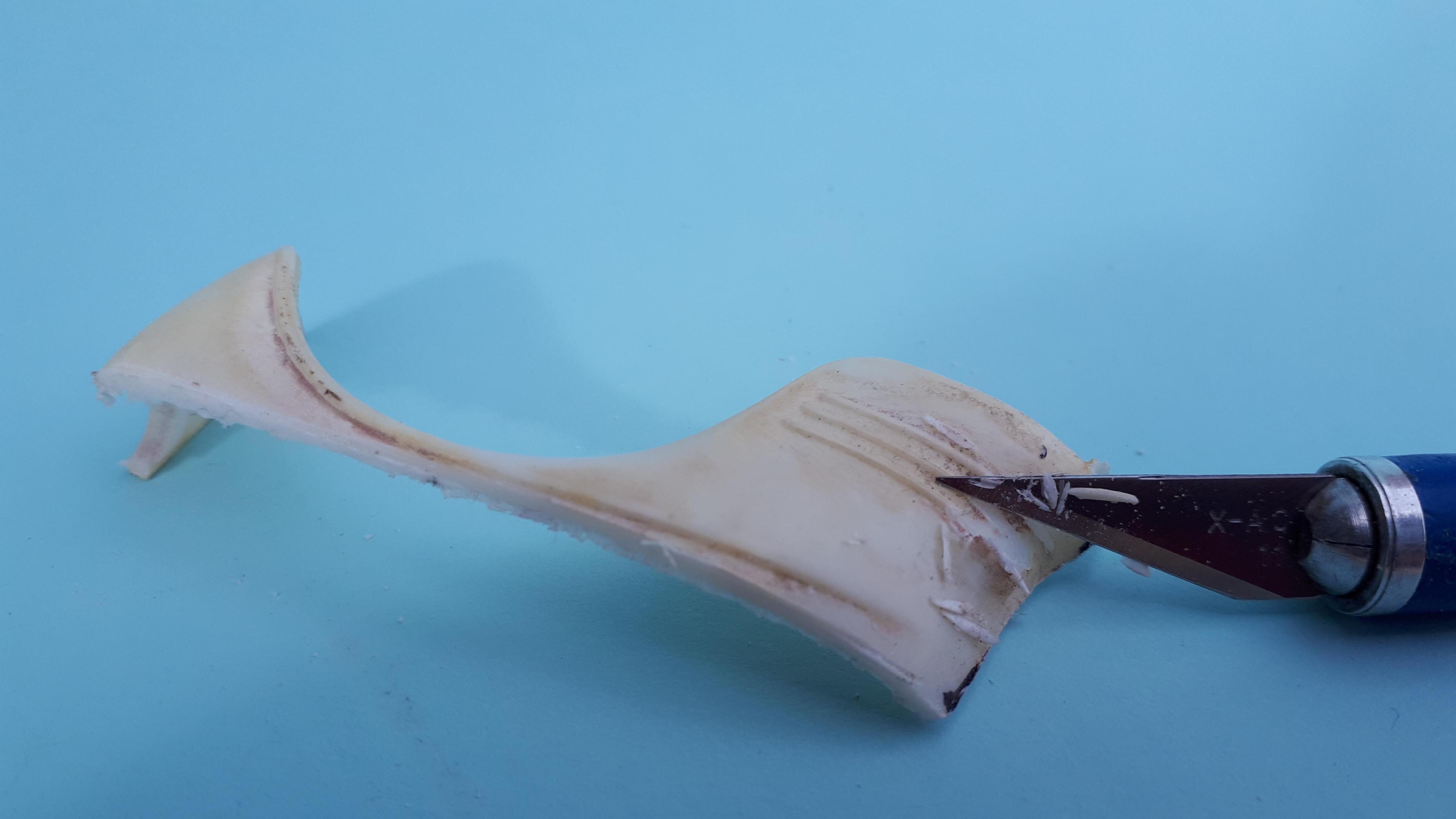

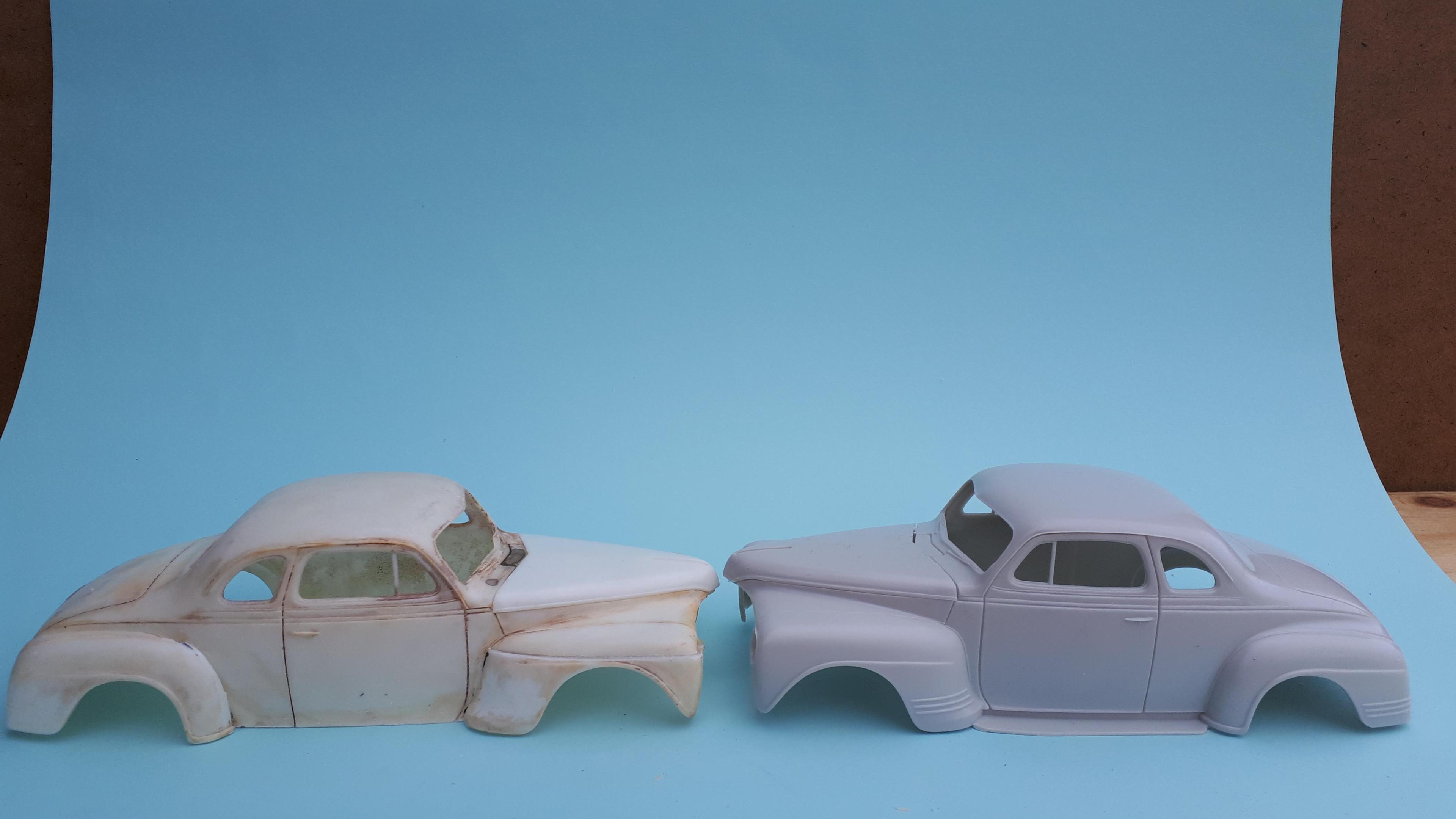

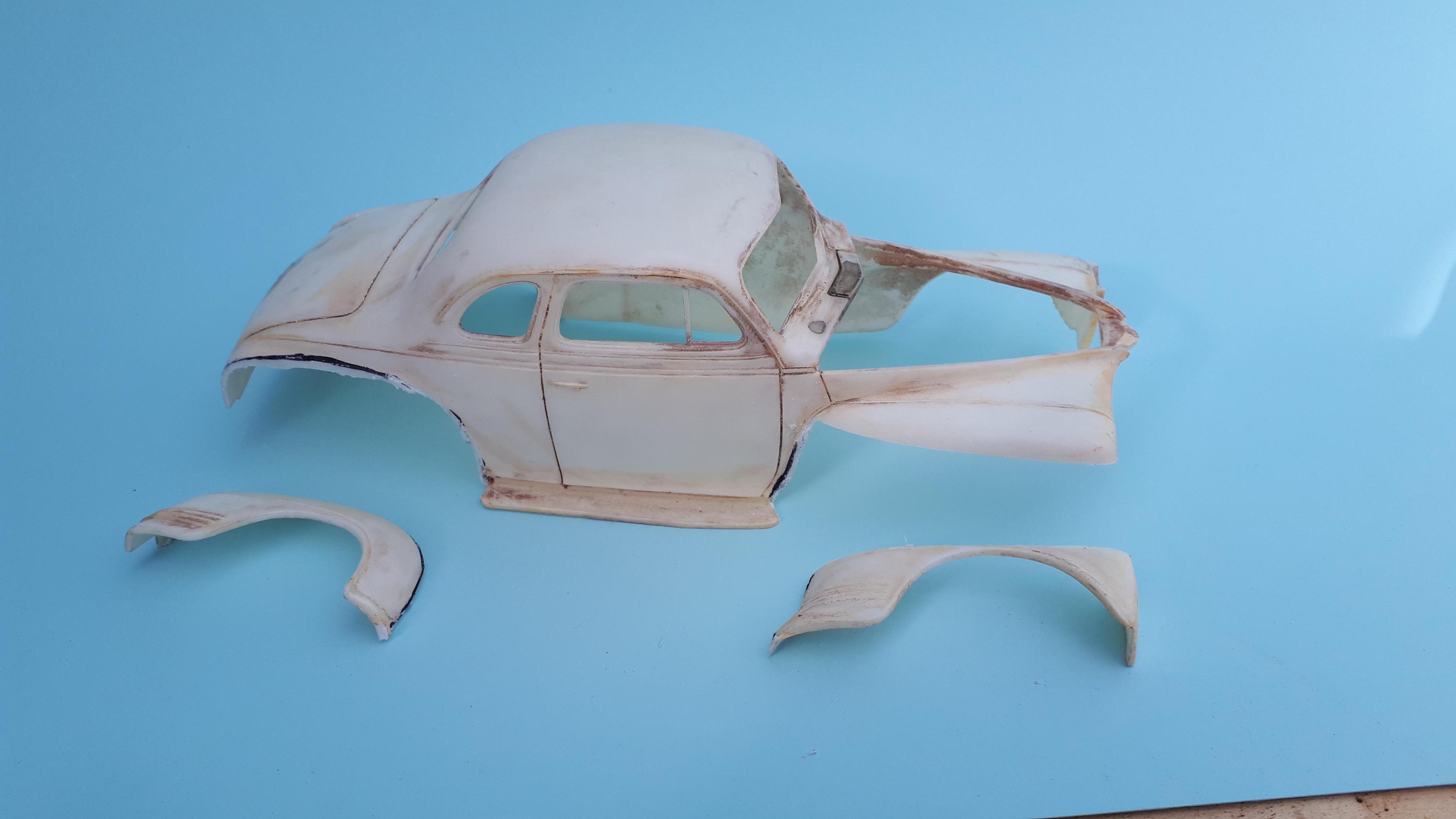

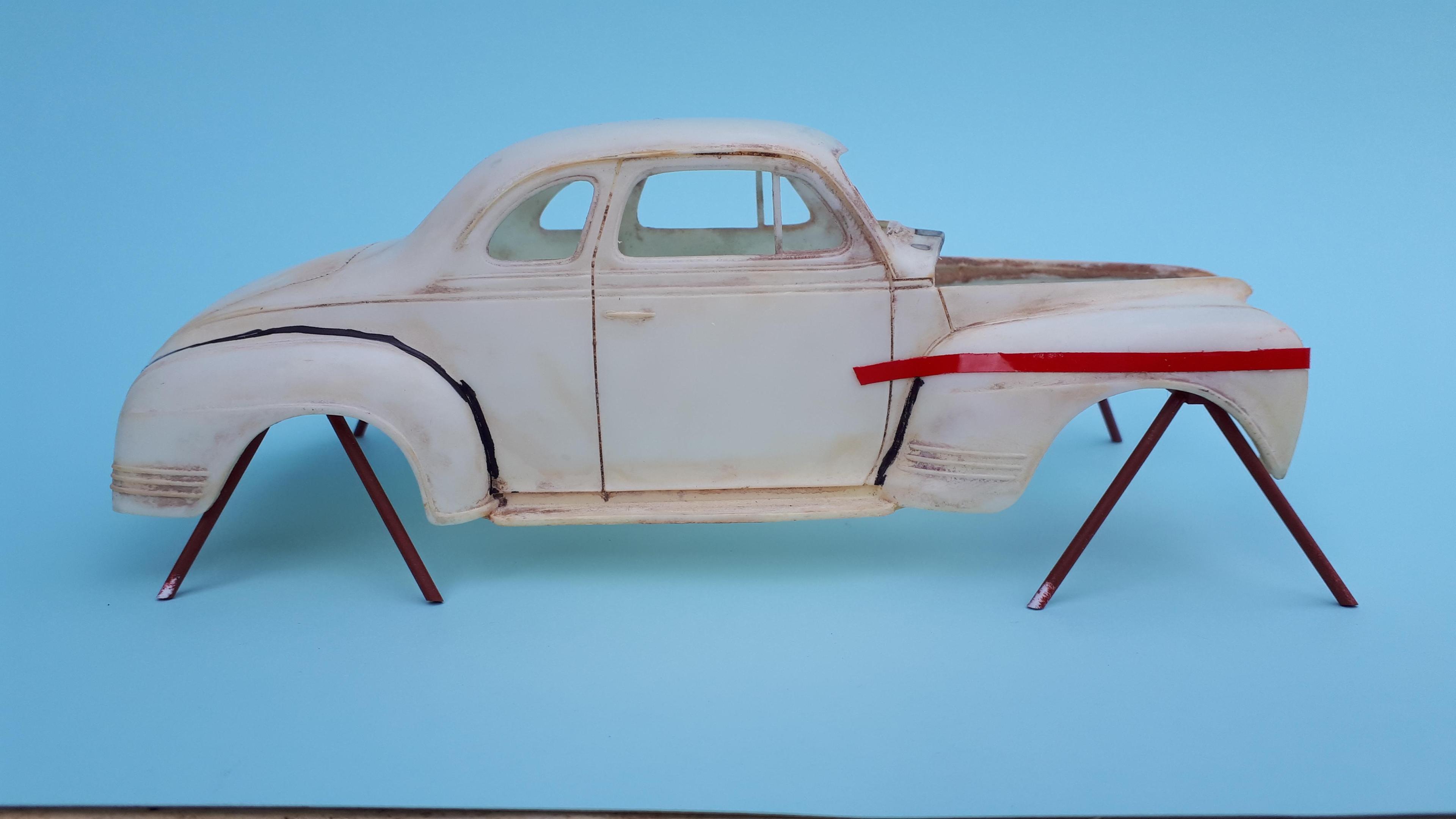

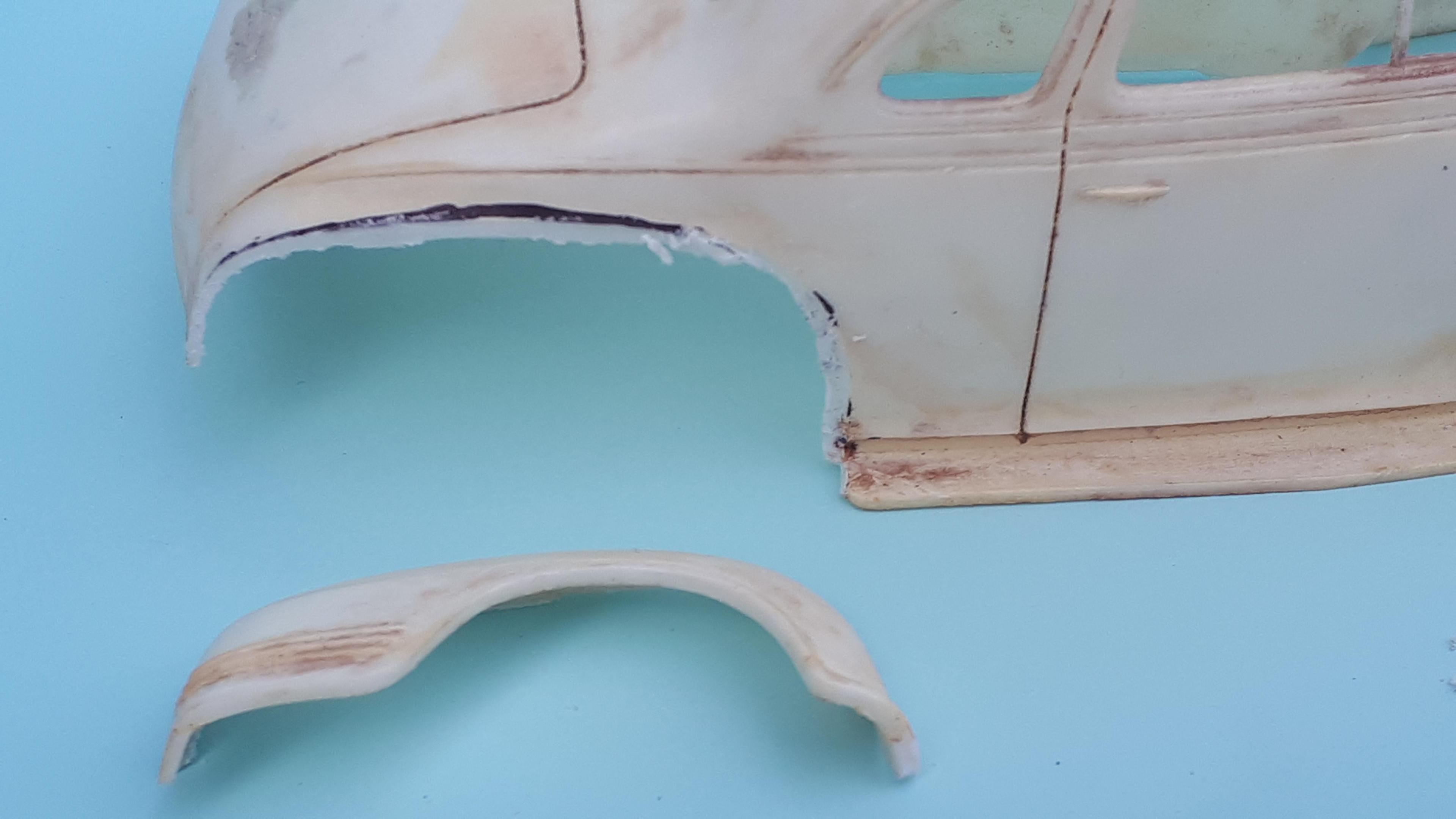

As my ideas developed, I figured that if I removed the running boards so that the doors became the bottom edge of the body, like a 48 Ford, I could then move the fenders up to match. That is pretty straight forward at the rear of the car but the front has a hood design that does not lend itself to having the engine bay messed with. Instead, I sectioned the front fenders so that the bottom edge of the fender was level with the bottom of the door. While the fenders were off the car, I carved and sanded the triple swage lines off the fenders, again to lighten things up. I used the piece removed from the front fender to reinforce the seam when I glued the pieces back together. The last two photos give you some idea of how dramatically this work has affected the profile of the car. -
