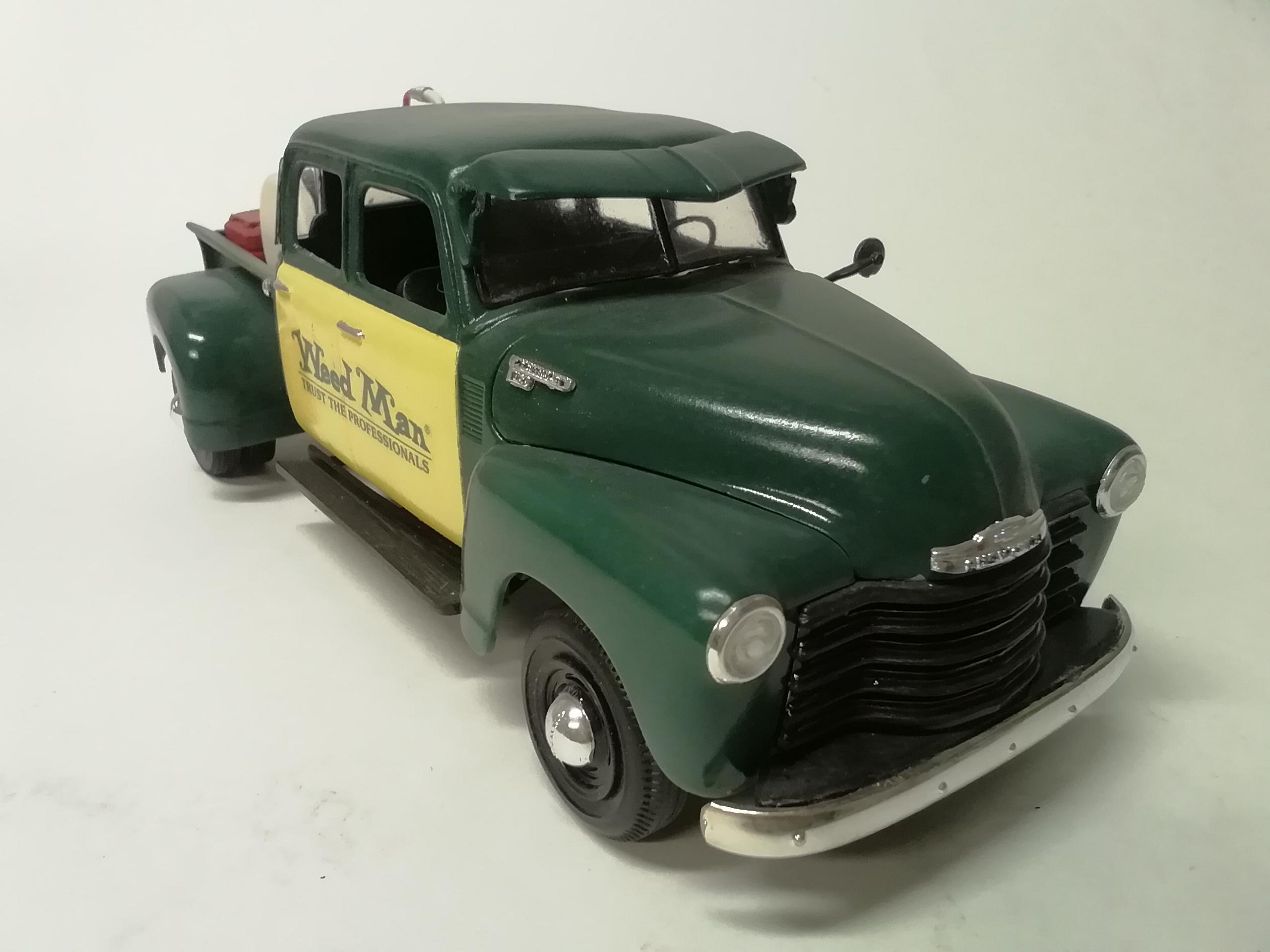

Another 3100...4 door duallie
Farmboy replied to Farmboy's topic in Model Trucks: Pickups, Vans, SUVs, Light Commercial
Thanx Greg. Its done, but now I think I may add a few details and then some wear n' tear. We'll see when I get some bench space. -
Thank you Zippi -
Yer right Tony, too clean for a work truck. I was thinking thinned oil paints for chemical stains, lots of paint chipping and dirt. It'll happen. Thank you Happy, sometimes I get lucky and a model mod works out. -
Well Kurt, the majority of parts went to the parts box, a grille ended up on a custom '49 Merc, one of the xtra curved windows fell victim to a dachshund spite attack, the 2nd truck box is around somewhere, I have another parts box I've yet to find since the move...and the beat goes on lol. I finished this awhile ago but I didnt post it till now. Thanks much for the shout out. -

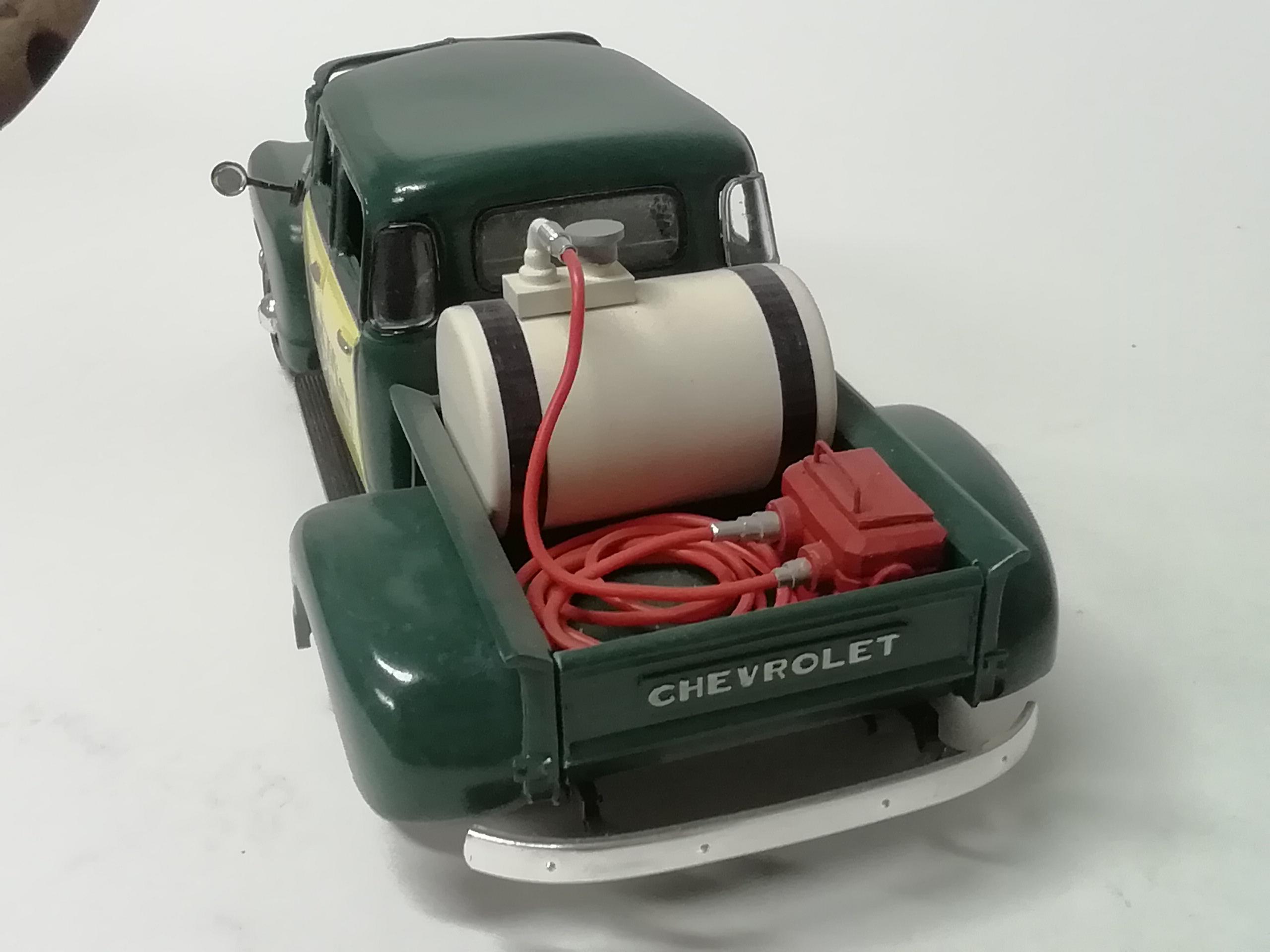

This was a clearance item at Walmart, bought 2. One day I got the idea to merge them. Decals home made from an actual invoice. Spray gear fabbed from a 35mm film canister, sprayer assembly from wire and circuit breadboarding post, and a modified backpack from a dollar store figure makes the pump. I'll weather it someday when I learn how. Comments and observations welcome
Mike, at times I felt like Henry Ford himself lol. Thanks Tony. It was an enjoyable build.

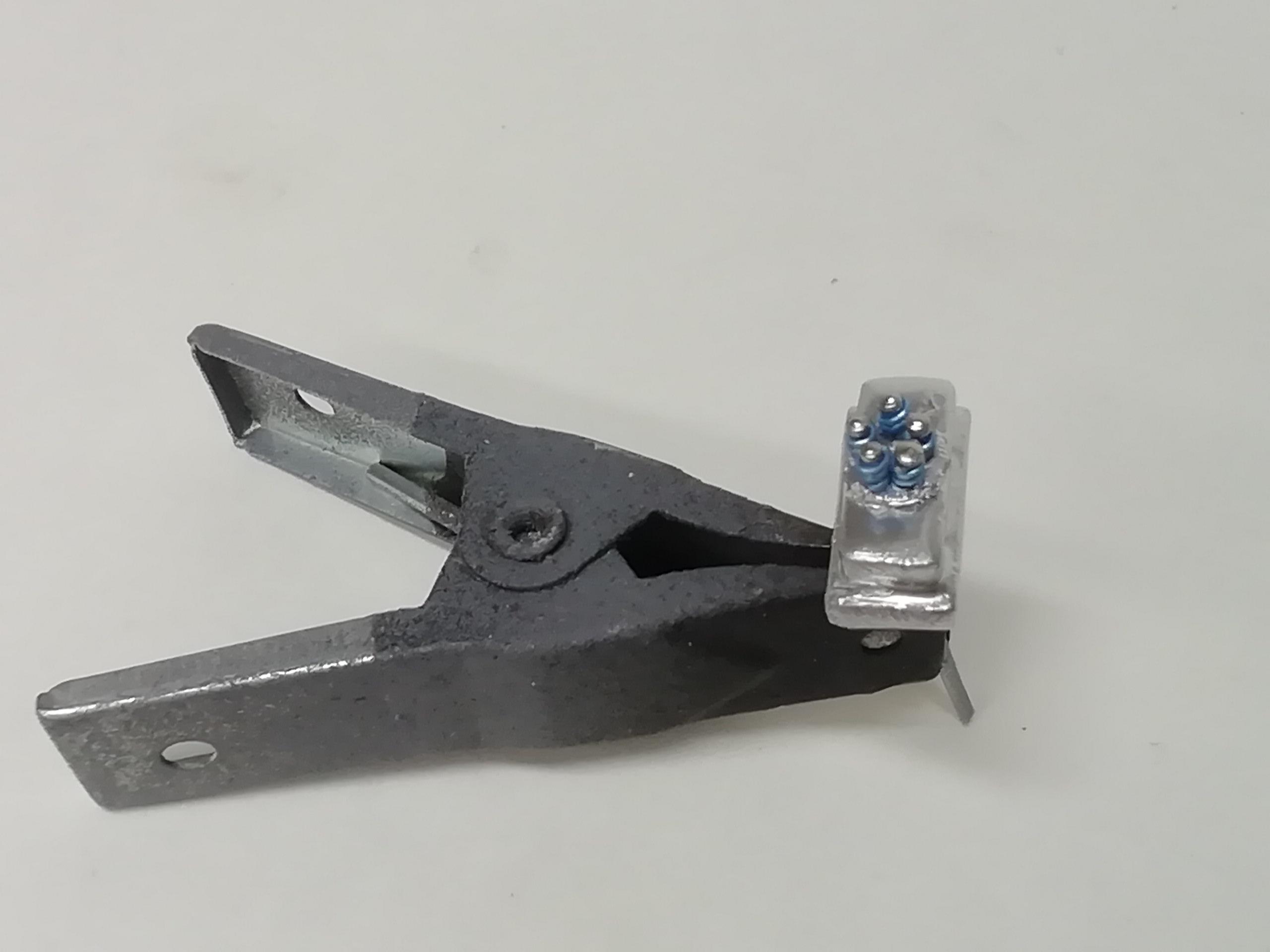

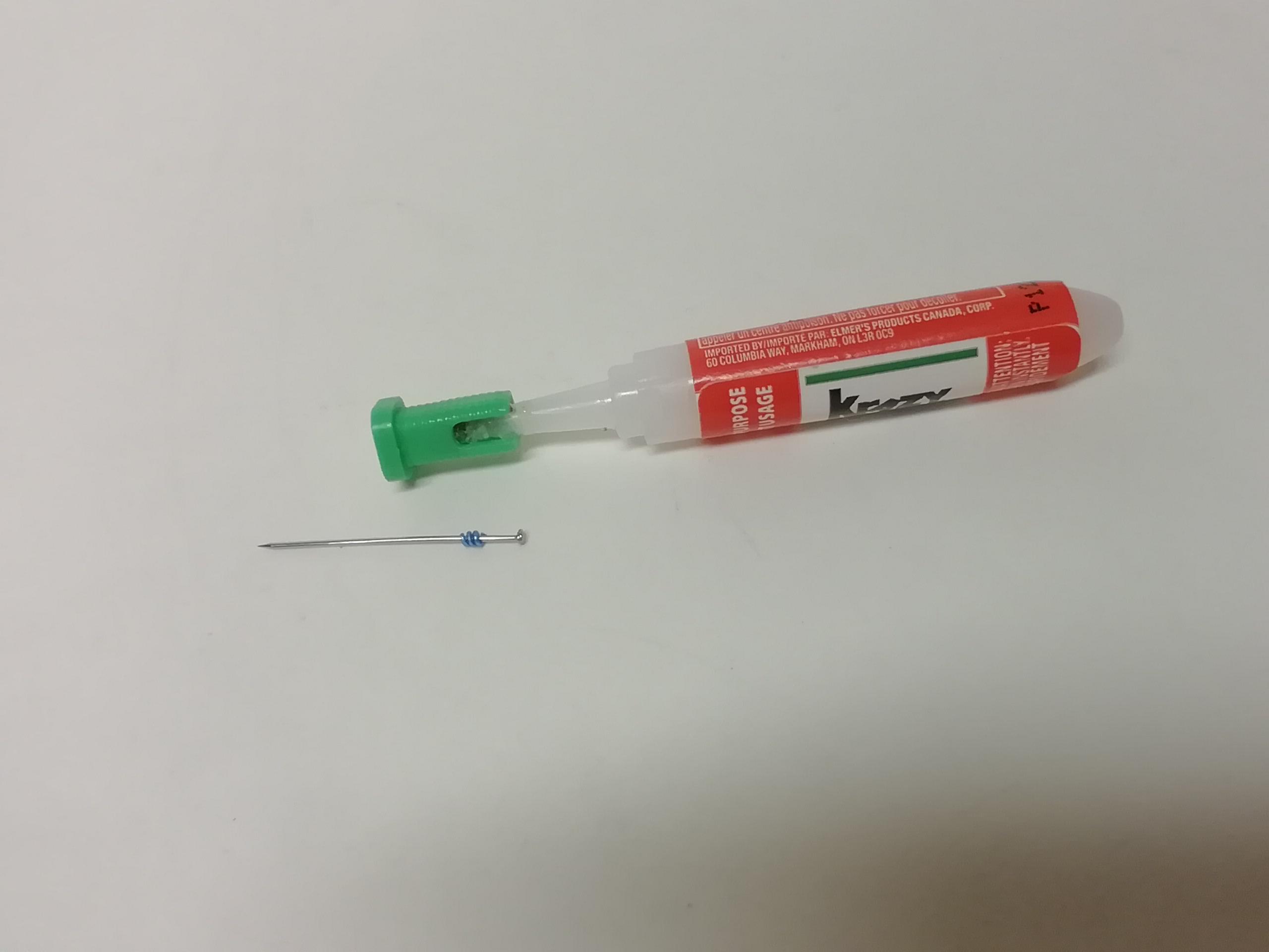

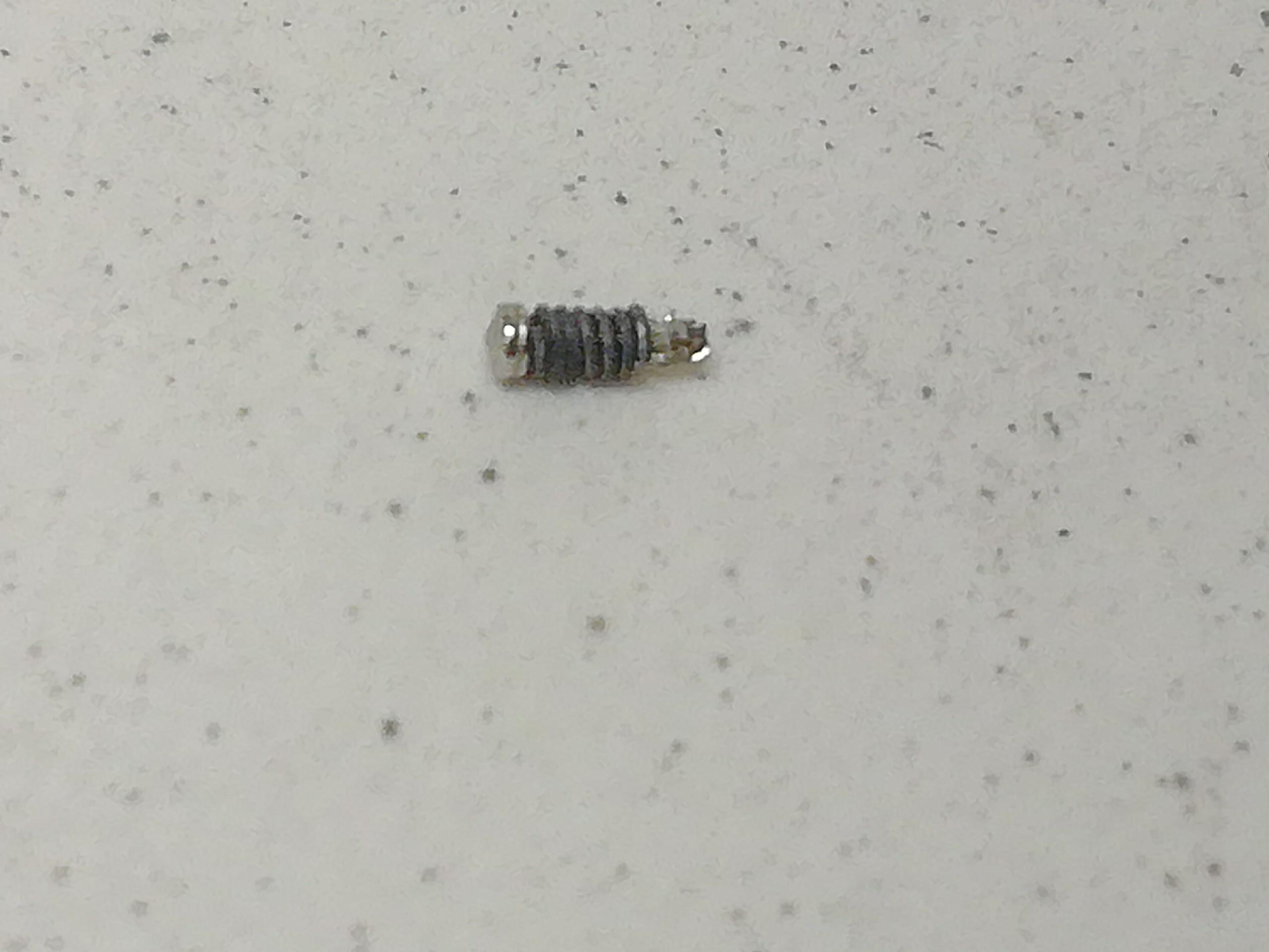

Decided to re-do the pressure plate assembly so, as the process worked for me, I thought I'd post a short tute on how I did it. Tools used were pliers with side cutter, manicure scissors, both gel and thin ca glues of your choice, straight pins, and wire. Wind the wire around the straight pin quite a few times so you have enough to make all the spring units and a few xtra Three turns were enough for my application so using the manicure scissors I snipped off as many 3 layer coils as I needed Slide the coil on a straight pin then add a touch of thin ca just under the pin head Push the coil firmly up against the pin head. It should set almost immediately. Snip the pin to length. I eyeballed the tail length so all were approximate length but drilled the mounting holes deeper than this so the coil stopped all the units at the same height. Try dry mounting each spring unit first, then, add a touch of your choice of gel ca to the tail of the unit --not the hole -- and install in place. I found (for me at least) that this sequence allows for a cleaner mount and also allows last minute minor adjustments before it sets. This is the revised pressure plate assembly. Some minor touch ups from previous work on the case sides and were good to go. One of I'm sure many ways to achieve the same results, thought it may make life a bit easier for some of us. Comments and observations welcome.

This is the first attempt at the pressure plate. I may re-do it if I look at it too long at hi magnification, time will tell. By the time the engine busy's up a bit, and the piece being so small, it probably won't even be noticed anyway lol. Comments and observations welcome

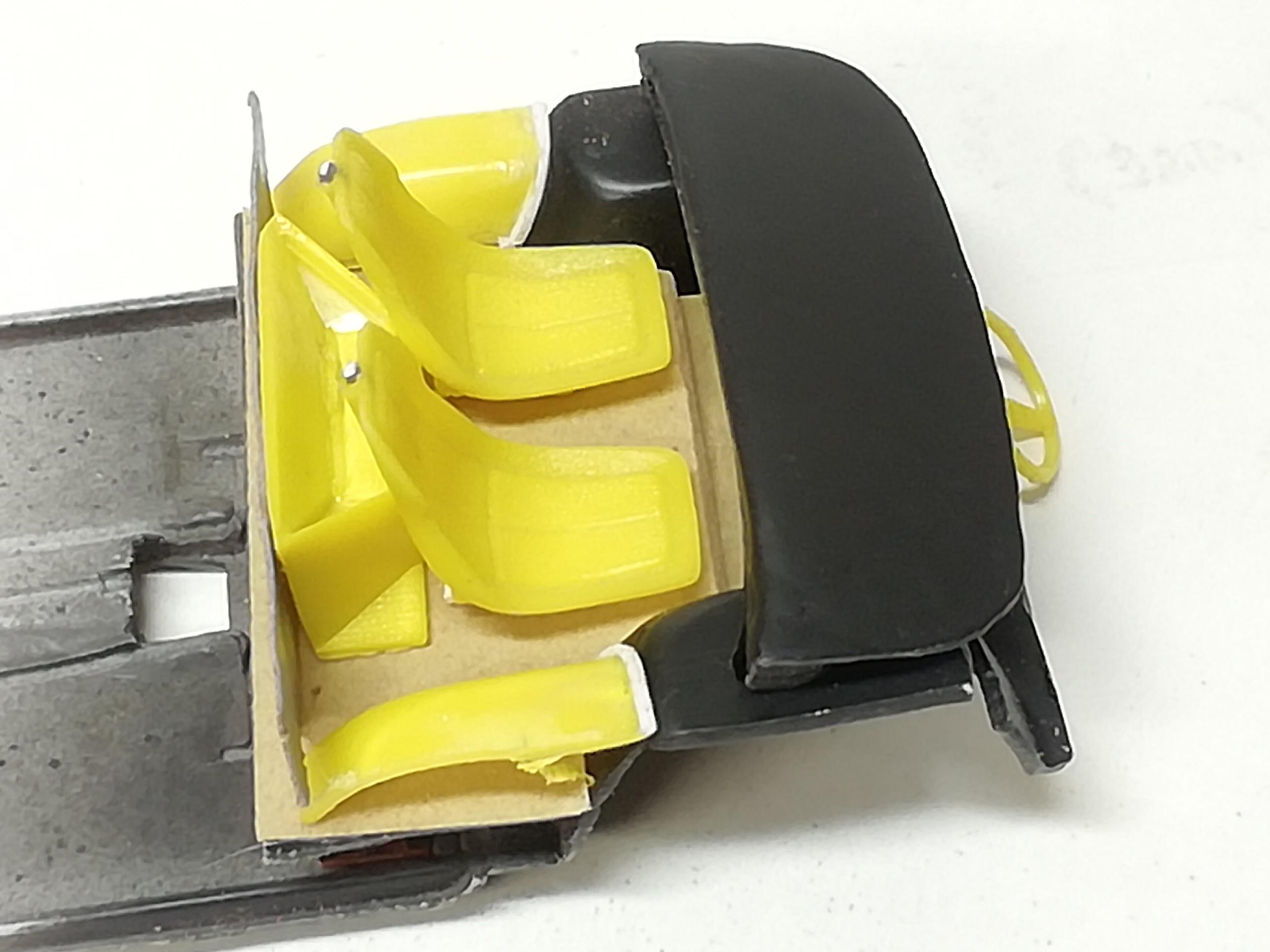

Also got a good part of the interior done. I took the original dash and cut it to fit between the wheel wells. I then added styrene sheet and filler to make it take up the larger space to the windshield. The floor was rebuilt and carpeted with my floor covering of choice, 150 grit garnet sandpaper. The yellow pieces are cut from an actual Deora kit (glue bomb). I honestly don't know how it got in my parts stash lol. Anyway I drilled the seat backs for headrests, we'll see if that happens as the build progresses. The yellow pieces are part of the door assemblies. They were part of the fender well in the Deora kit interior bucket. I cut them away and reversed them to suit their new home. I'll be modifying the Deora steering wheel to suit also. The interior will be tan and black. The box behind the seats would be where the hoses from the flathead in the bed enter the cab to travel down under the floor to the radiator up front. I gutted the dash and replaced that area with a strip of styrene and woodgrain vinyl. The automatic floor shift, gauge panel for the dash and a few other things arent in the photos. More to come. Comments and observations welcome.

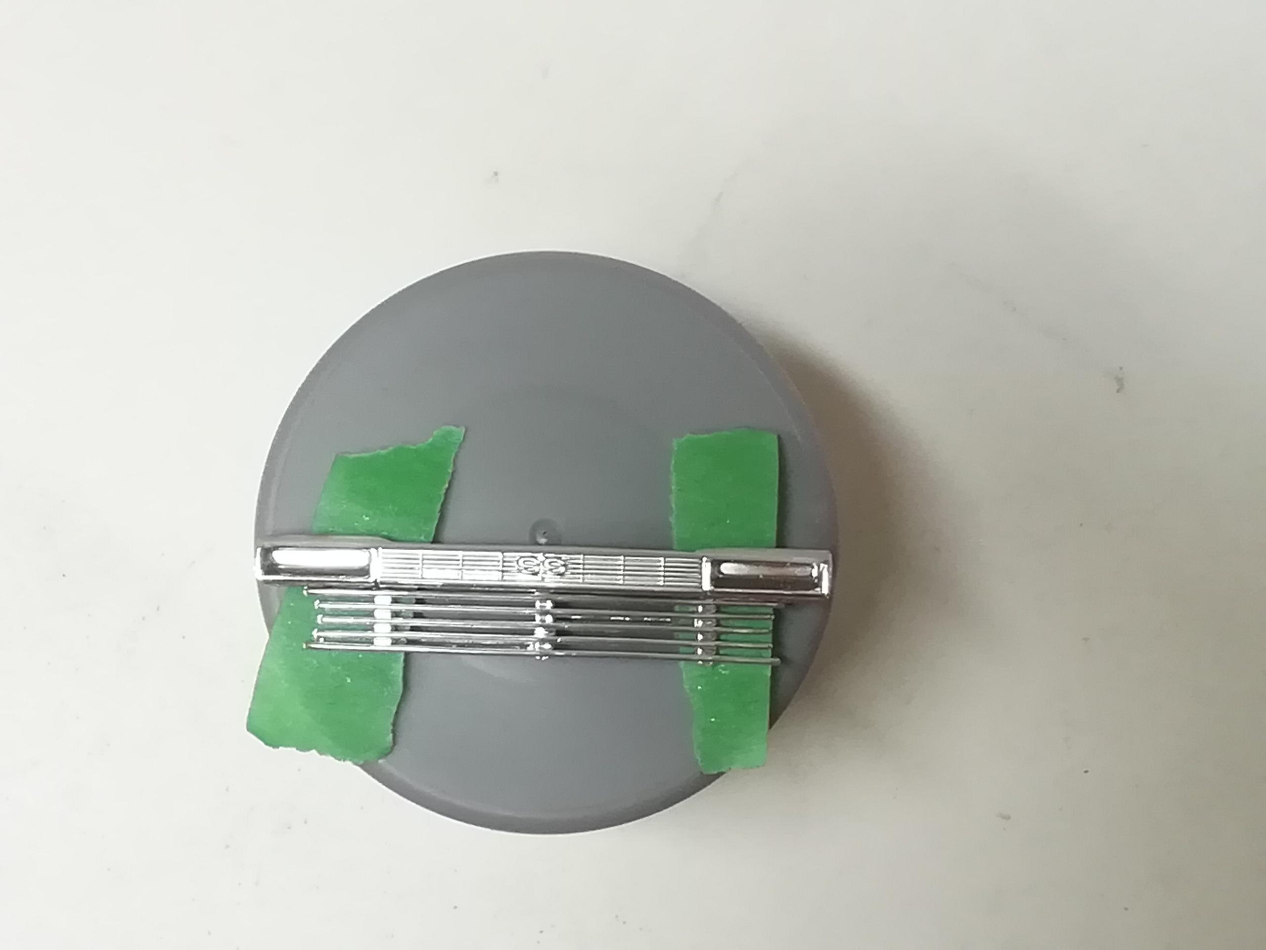

This is what I have in mind for the grille. The center piece is the rear tail light assembly from the Ol' Pro Nova kit. I sawed it awaway from the bumper. The SS will be replaced with a blue ford oval decal. The thin horizontal bars piece is from the amt Pontiac Catalina. It'll be separated into 2 pieces to fit the upper and lower openings I should have it cut to fit soon for a mock up photo Comments and observations welcome.
Meatman, its been an itch needing a scratch for a while. Hope it turns out. Many thanx slotto. Still a lot of small things to do before paint but it'll get there. Slusher, there's space to park a flathead with direct drive potvin and short drive shaft in the bed. I've kicked around the h.a.m.b looking for ideas and I think I can make it work. The 4 hoses will enter a plate on the front wall of the bed. An imagineered interior 'case' would be how the hoses get routed under the cab and forward. The rad front will be visible thru the grille. The header pipes will go thru mating holes in the bed. That's the plan anyway.

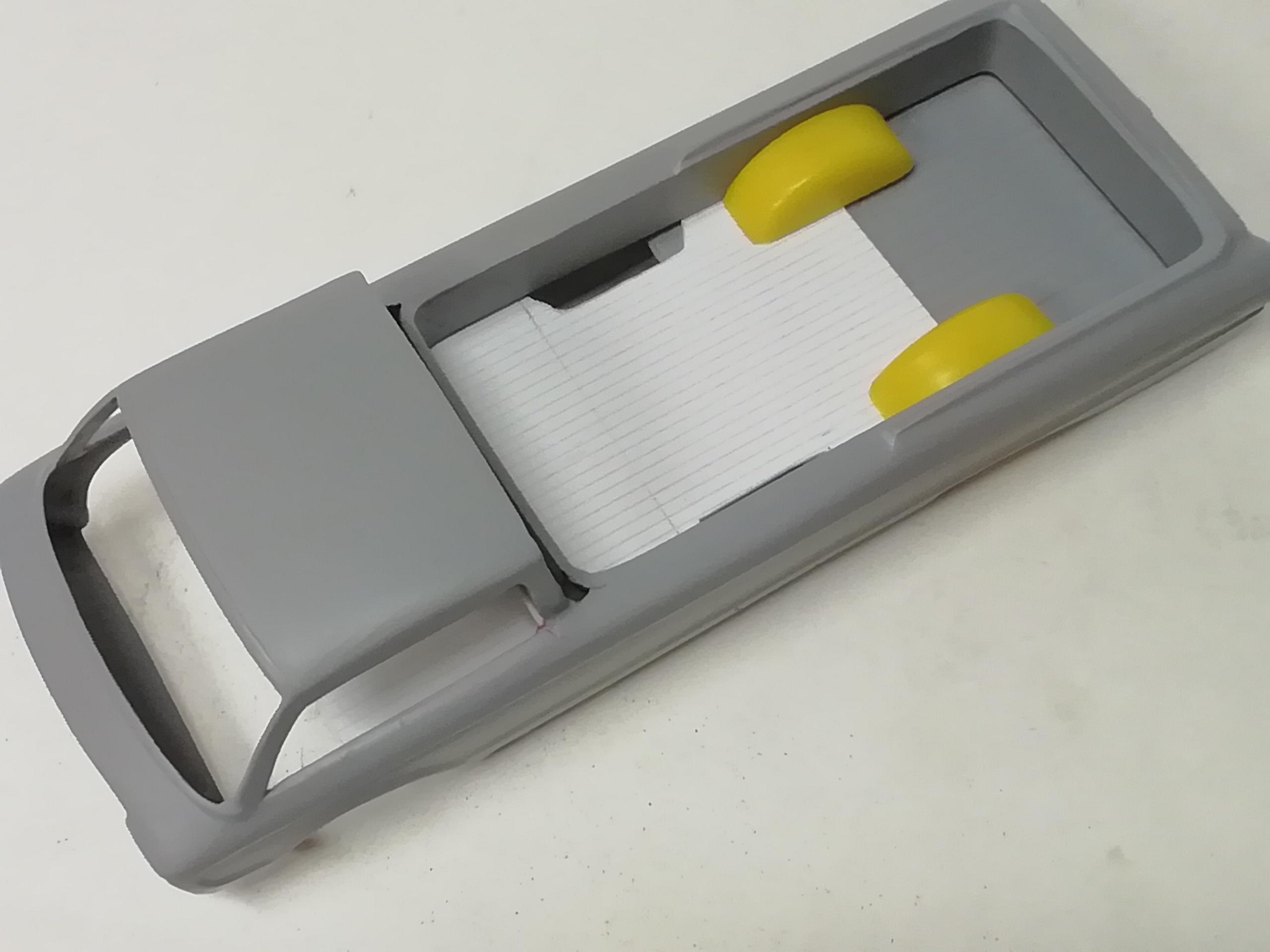

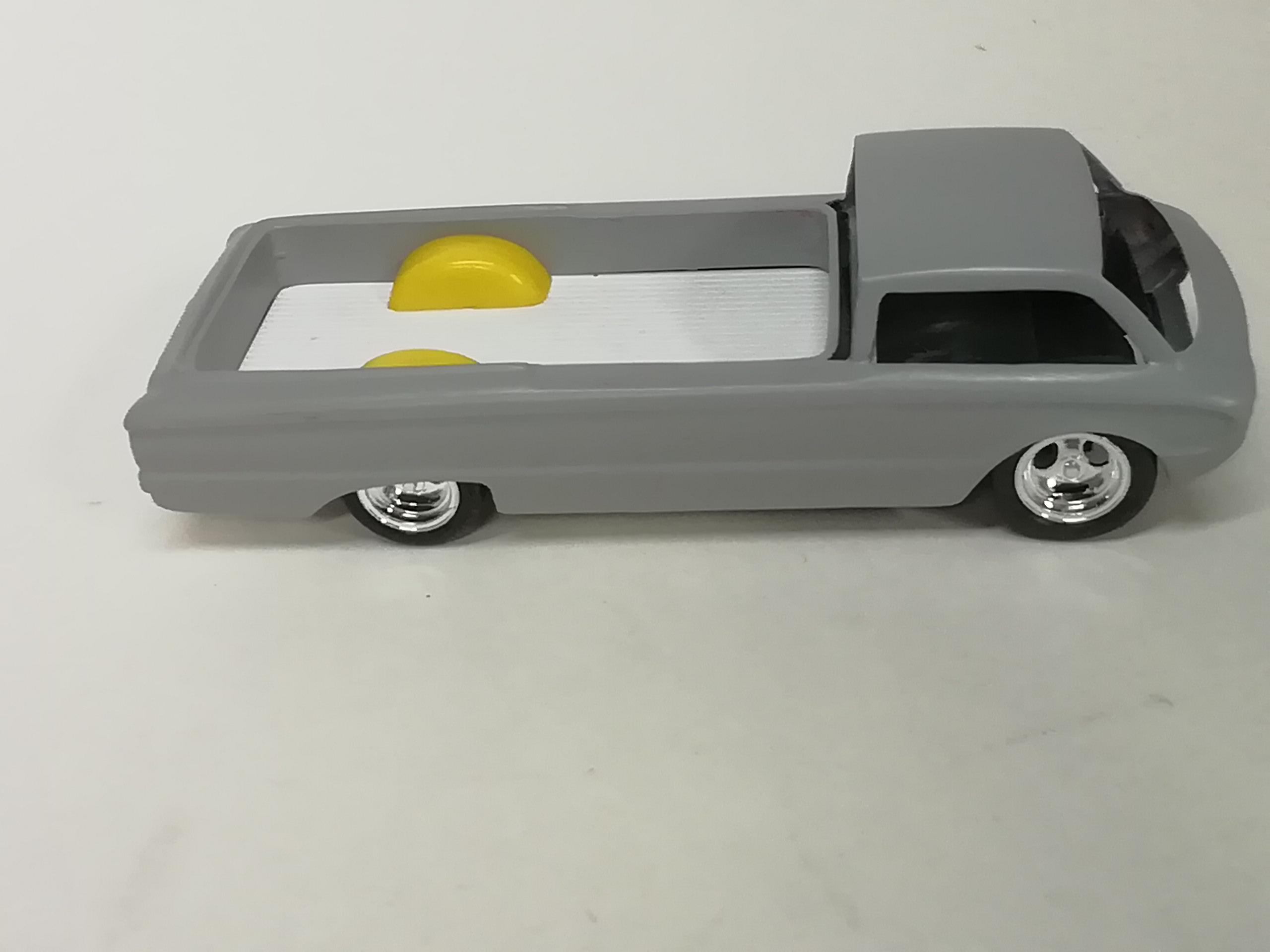

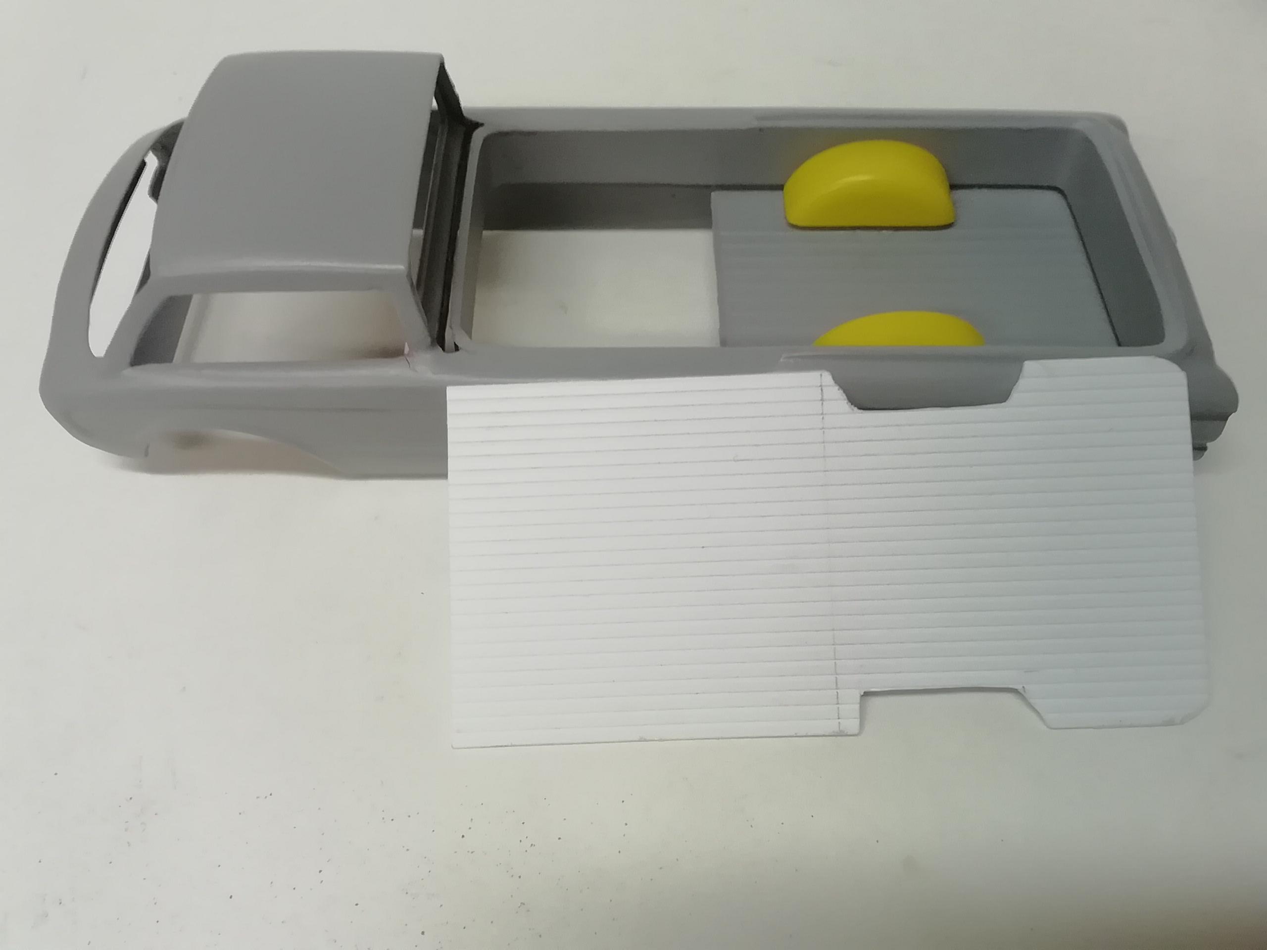

A couple of things. In the shot below, the smooth bed walls are made from a single piece of styrene strip. Once the cab was in it's new position, I went around the new box interior with it, test bending to make sure the bends were in the right place and applying heat to make them permanent, one bend at a time. The ends met in a butt joint with a tiny amount of overlap. I sanded a little at a time between them with a double sided sanding stick, test fitting till only the smallest amount of friction made the rectangle fit snugly in the bed. A small dab of filler and some primer makes the joint invisible. The half bed is the original, ending where it met the cab. The new bed floor was made with evergreen siding styrene sheet. I measured the inside length and width of the opening (before the new wall was installed) for a close fit. I then cut out openings for the new wheel wells, having sawn off the originals. Notice the shadow under the wheel well. The new floor was dry fit on the bed. The wall was then cemented permanently to the sides resting on top of the new floor, and the wheel wells (cut from a Deora glue bomb) attached to the walls, also sitting on the new floor. Nothing was attached to the floor. As shown below, I was then able to slide the floor in place or remove it easily as there will be some cutting to do for engine mounting. Seamless without a whole lot of fuss. Comments and observations welcome
Lol Slusher. Full reveal, the yellow wheel wells are from a partial glue bomb Deora kit I somehow acquired from...somewhere. I'm also using the Deora seats for the Fedora's interior. The Deora was a cabover, the Fedora is a cab forward.
Thank you all for the shout outs everyone, much aprecated. Lunajammer, the idea just presented itself with no forethought to where I was going with it so unfortunately no earlier still-in-pieces-pics.

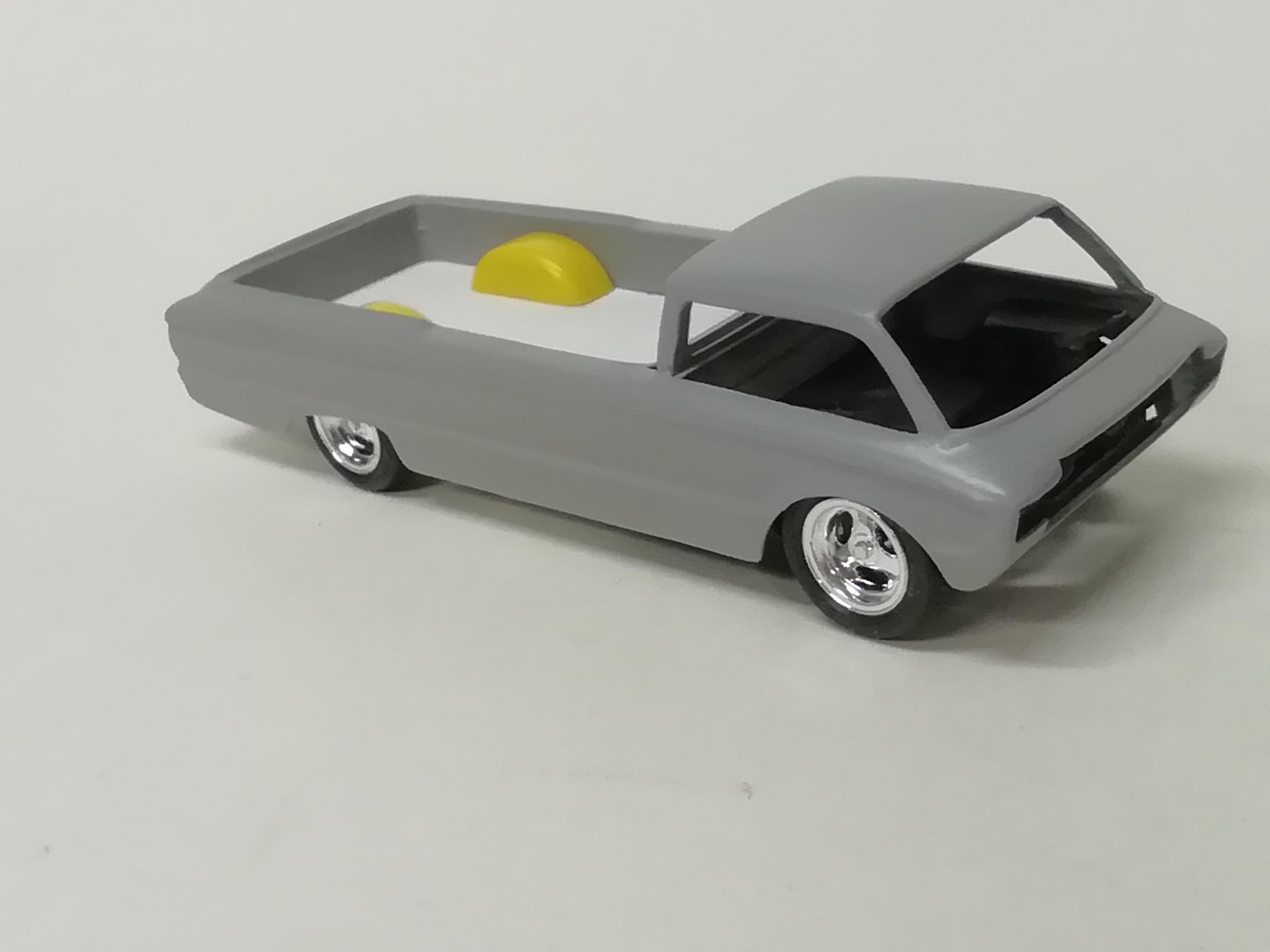

Thank you guys, glad you like. Should be a fun build. The Dodge Deora meets the Ford Fedora!
Took a bit of head scratchin' to work out the interior due to the wheel wells taking up real estate in the cab but got it sorted out. More photos to follow as assembly progresses. Still working on the body, mostly sweetening up the rough stuff. The grille area is all planned out, so's the engine and placement. I think even the kit wheels look ok for this version. Comments and observations welcome
