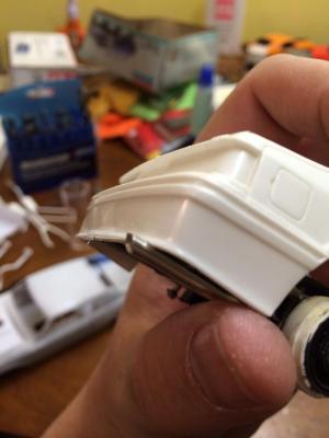

Looks better. Revell got this bumper sooooo wrong. The cutouts should barely infringe on that lower lip. Lx tips were used on the cobra. You can see how it should look as on this beauty

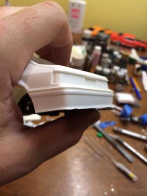

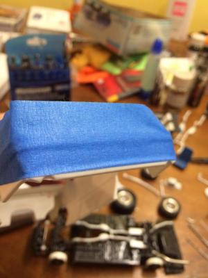

Also the 93 cobra bumper needs help. See where I taped? All that below has to go. They quickly added that to get the look. Here is how to roughly fix it in 5 minutes. Lol. Cut that off. The lightly recut the cutouts in higher up. Tip needs to be shorter but you get the idea? Hope that helps but now you have put a 93 cobra on my bench....

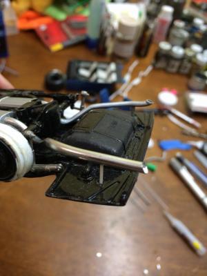

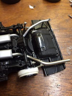

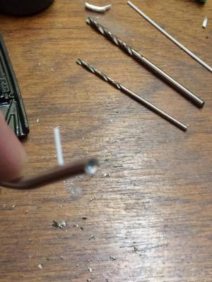

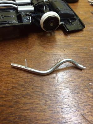

Here ya go. I used silver solid core lead free solder. 3mm which is about the same as 3 inch tailpipes in scale. Roughly bent it up same as stock pipe. Drilled the slash cut end. I would paint that black inside if it were on a model. Measured where kit hole was for mount and figured out length. Added a pin to mount in muffler. Took me 10 mins tops.
