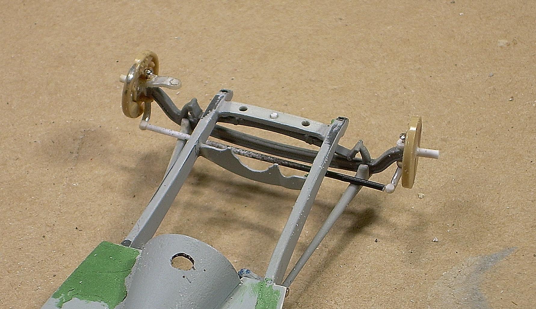

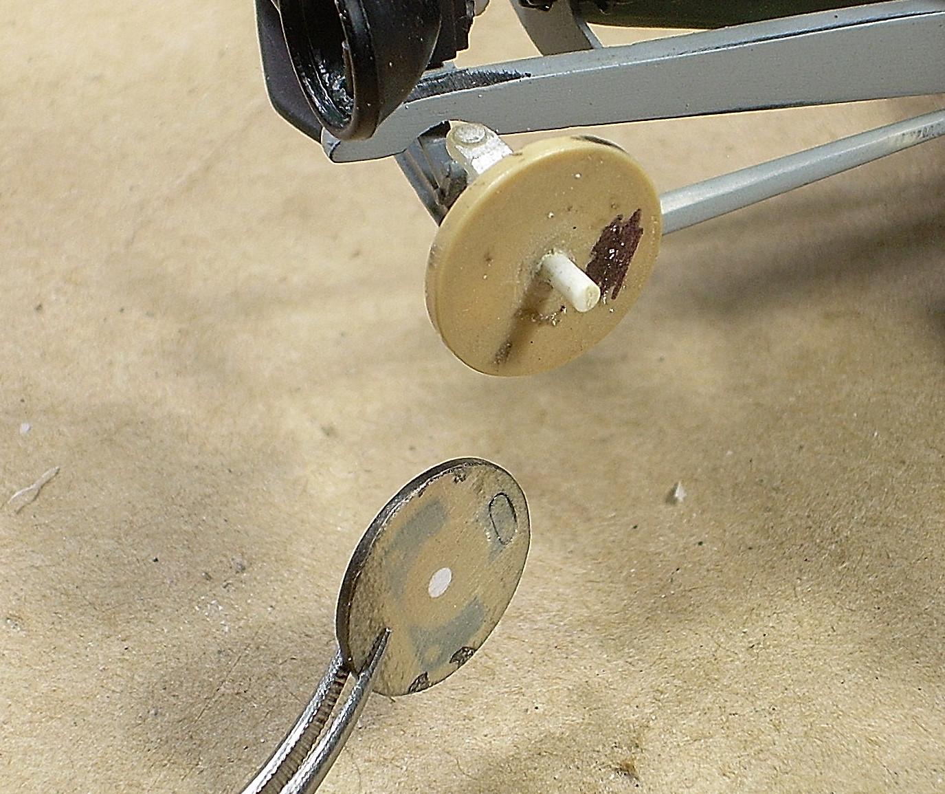

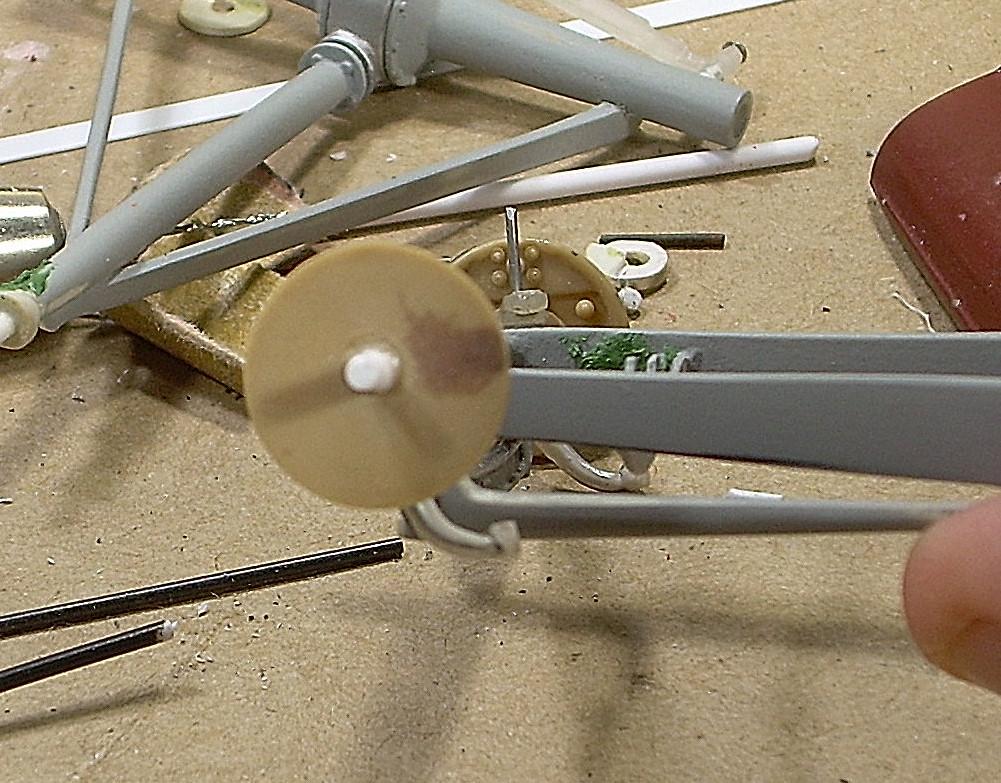

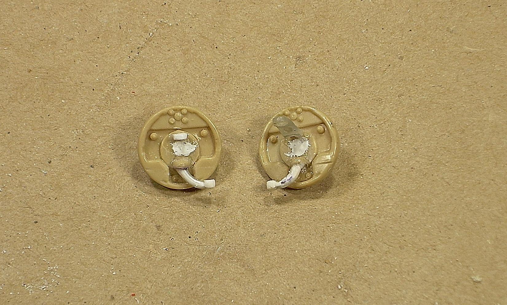

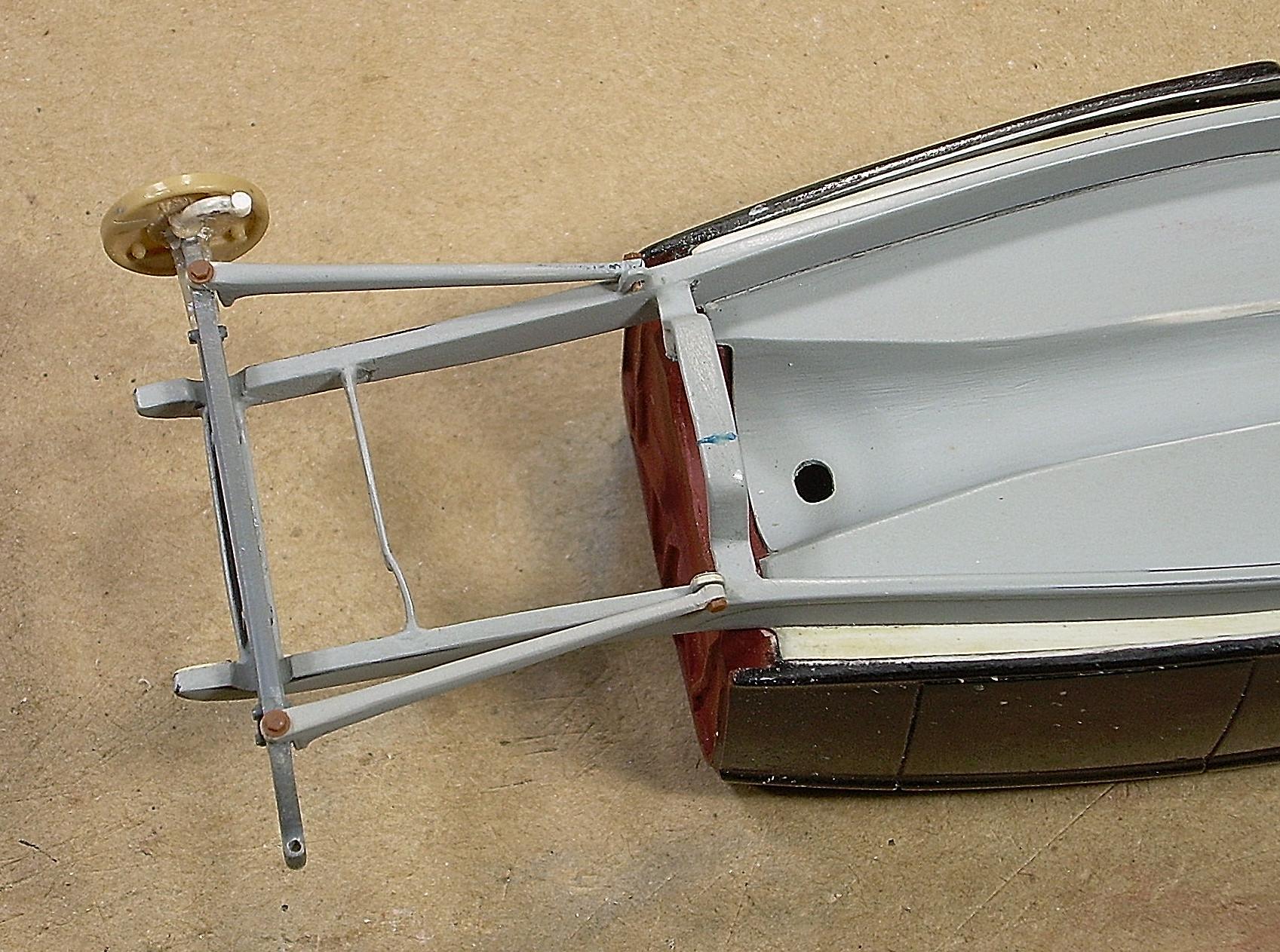

JAN 5, 2020 UPDATE 1) Biggest thing accomplished was shortening and reversing the steering arms on the front spindles. 2) Front suspension got bolts in place of the shirt pins holding it together previously. Shank diameter of the plastic bolts is .030", so they're actually fairly stout. 3) Steering arms were positioned so the tie rod would just clear the split wishbones, pretty common on cars like this. Several things to measure and get dead on here. Just as on a real one with this front end setup, suspension travel is limited, clearance between the frame rails, wishbones, and tie rods is very tight. 4) Tie rod mocked in place, verifies steering arms are correct now. Clearance was also checked at the engine crank pulley, is OK. Steering linkage will be functional. The attachment of the wishbones to the axle isn't entirely prototypically correct, but I'm going to leave it pretty much as Revell made it in the interest of finishing this model before I die. 5) Last part of this job is thinning the front backing plates, so the wheel offset will be right, as well as the fit of the drums. The finned Buick drums I'm using are a little underscale to work with the '40 Ford backing plates as in real life. A little optical illusion will make everything appear about right, though. With so much of the mechanical stuff visible, I try to get everything looking like a real car built by somebody who knew what he was doing. -
