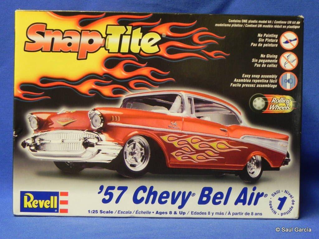

This looks terrific so far! With the level of craftsmanship you're clearly capable of there's no reason in the world you shouldn't be able to tackle a foil job! maybe you could practice on junk body or a simple snap kit – Revell's '57 Belair hardtop snapper is the perfect practice piece.
Don't Fear the Foil!

I have a couple of those Monogram snappers I bought pretty much for the wheels, so I guess i'll take the suggestion and make the plunge.

I foiled an earlier issue of the Belair that was molded in light turquoise. Took it out of the box in the hobby shop and started foiling and didn't have a problem. But it couldn't to give the body a wash and dry in warm water with a little dish soap.
Remember, let the weight of the knife do the cutting. Have fun!

I like the idea of practicing on a snap kit, and that pictured Revell Bel Air would be a great one to start with.
