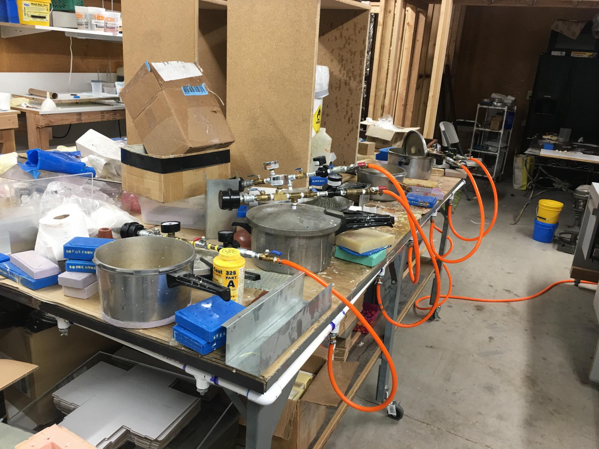

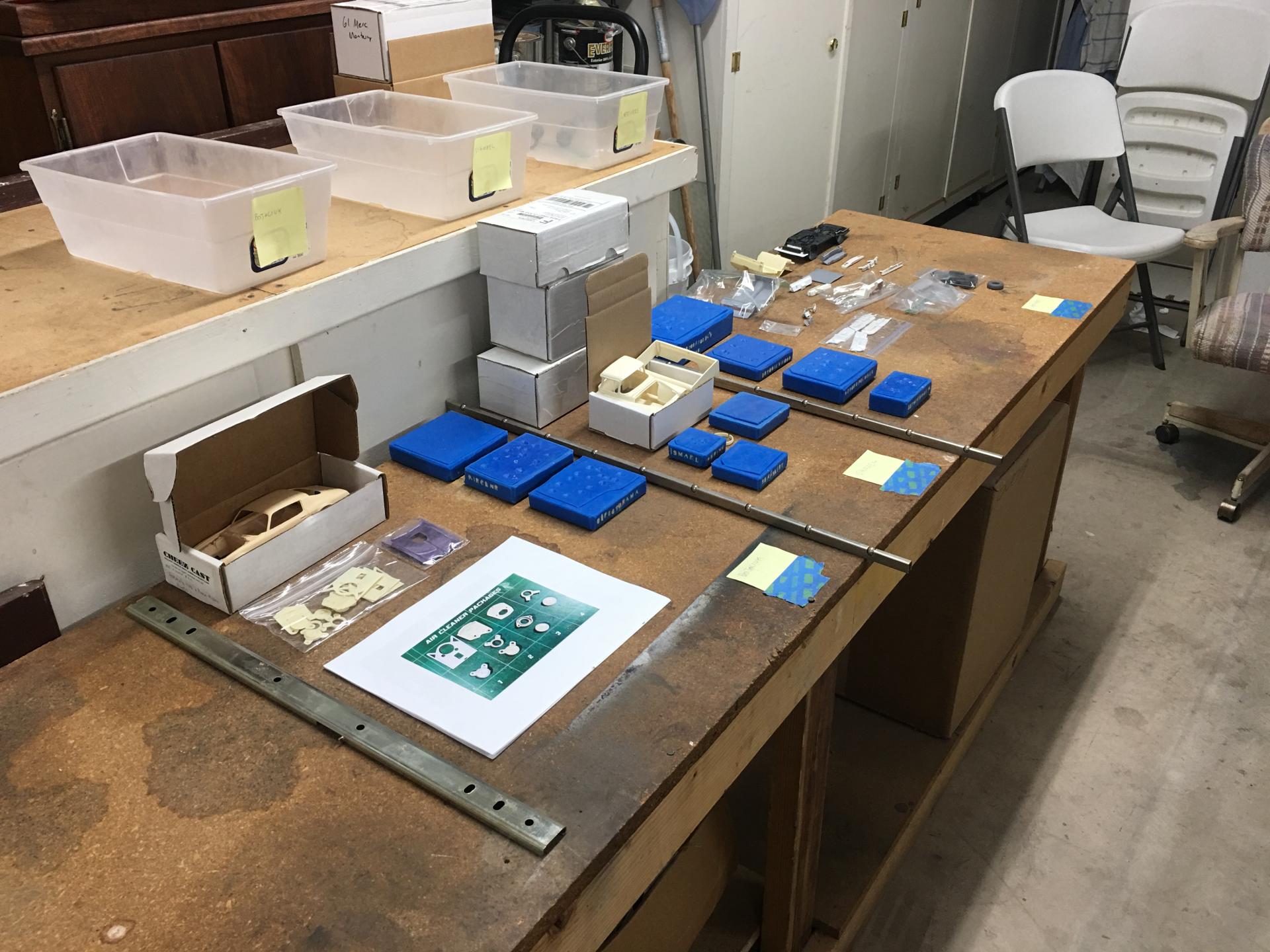

Maindrian Pace Posted July 9, 2018 Share Posted July 9, 2018 I spent all of Sunday at the Master Caster Remote Desert Outpost. The mission was to set up the new shop, organize the many projects, and pre-stage them on a long counter divided and labeled by project and in order of when received. We got a lot done, almost half of the shop is now organized, and casting can begin again in the new digs. In the number 1 spot is the Crown Victoria, followed by three other jobs, as we felt that four jobs on the table at any one time should suffice. Casting is all about organization, and without it things can get confused quickly. Greg has also been working on a new, large center island table that the actual casting takes place on, with an encircling high pressure pipe array that has chucks for the many surrounding pressure tanks, powered by a new large compressor. A new industrial style A/C system has also been installed with exposed duct work and vents, and you can make it cold enough to hang meat in there. A lot of work has gone into this shop, and it's going to do very well. A few pics: Quote Link to comment Share on other sites More sharing options...
peteski Posted July 10, 2018 Share Posted July 10, 2018 The shop looks good, but I have to ask: Are the air lines plumbed using standard water/sewer PVC piping? If yes, You might want to rethink that. Please see https://www.pvcfittingsonline.com/resource-center/using-pvc-pipe-for-compressed-air/ and other online warnings about not doing that. Friend of mine used such pipes for compressed air and we had one burst after coupe of months. Fortunately it did not injure anybody, but I would never do that again. Quote Link to comment Share on other sites More sharing options...

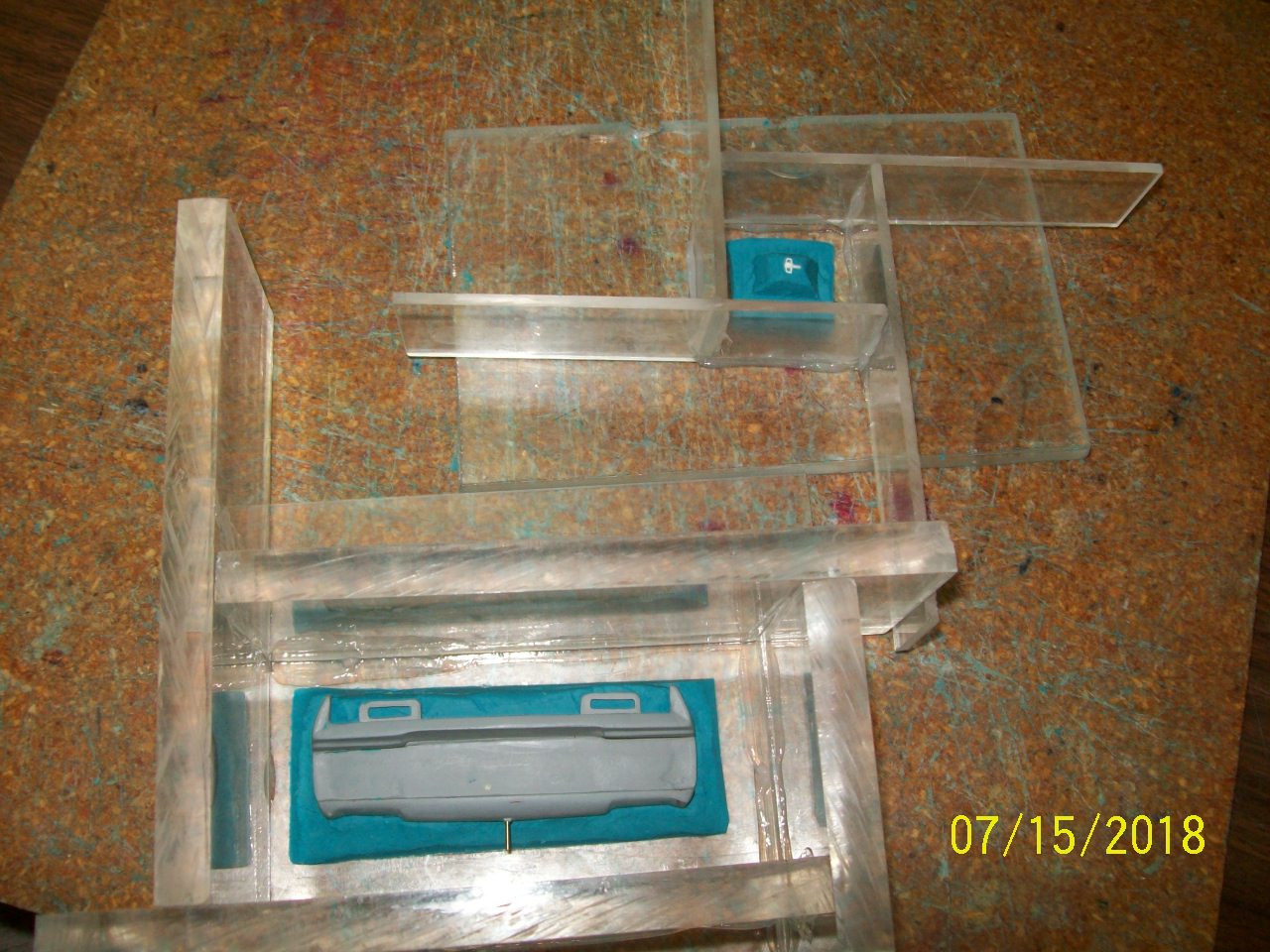

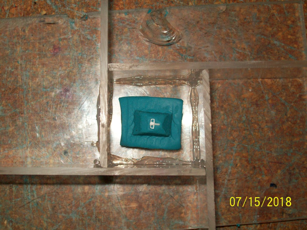

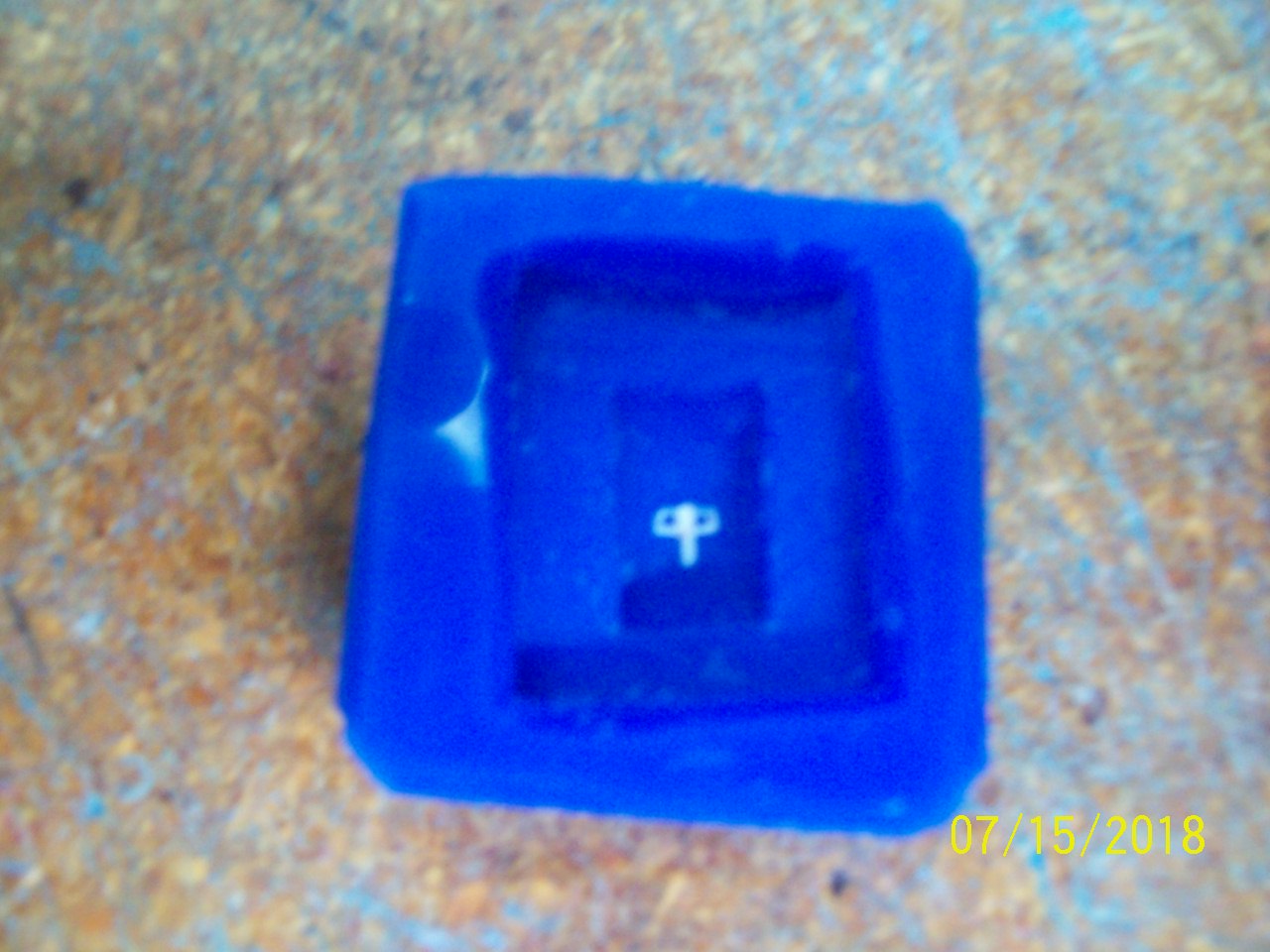

Greg Wann Posted July 14, 2018 Share Posted July 14, 2018 (edited) It has been awhile. Mike was helpful in organizing, something I am just not good at, Thank you, Mike. I can become quickly overwhelmed! Here is the front grille part that Dwayne made. It is a work of art unto itself. Dwayne's detail is just over the top for me and for Mike as well and Mike is a very detail oriented guy. I mixed up some silicone and poured it over the grille and then put it in the vacuum chamber. I have found doing this is very important. Vacuuming the silicone will remove air from the silicone that is mixed and remove moisture that can be drawn into the resin components. Anyway, vacuuming insures that the silicone material becomes well seated into the tiny detail of this grille part and other parts. Otherwise the silicone may trap air over the detail surface causing a bad mold to be made. If you are attempting to do something like this you can do something with a brush called stippling. I think this is the term where you use the bristles to sort of poke at the surface that would have silicone poured over it. It would break up the surface tension and allow the silicone to settle into the detail. A good use for one of those cheap acid brushes from ace hardware found in the plumbing soldering area of the store. An old toothbrush might work too. Edited July 14, 2018 by Greg Wann Quote Link to comment Share on other sites More sharing options...

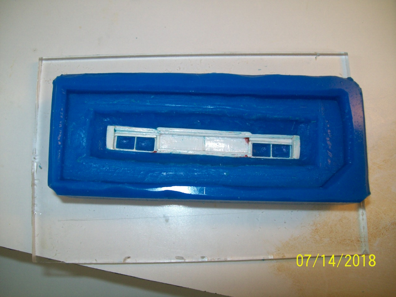

Greg Wann Posted July 14, 2018 Share Posted July 14, 2018 (edited) Here is the front and rear bumpers, front clip and hood ornament ready for the mold making process. There is a small brass rood inserted where the hood ornament goes. This will become part of the mold to keep the hole open. Edited July 14, 2018 by Greg Wann Quote Link to comment Share on other sites More sharing options...

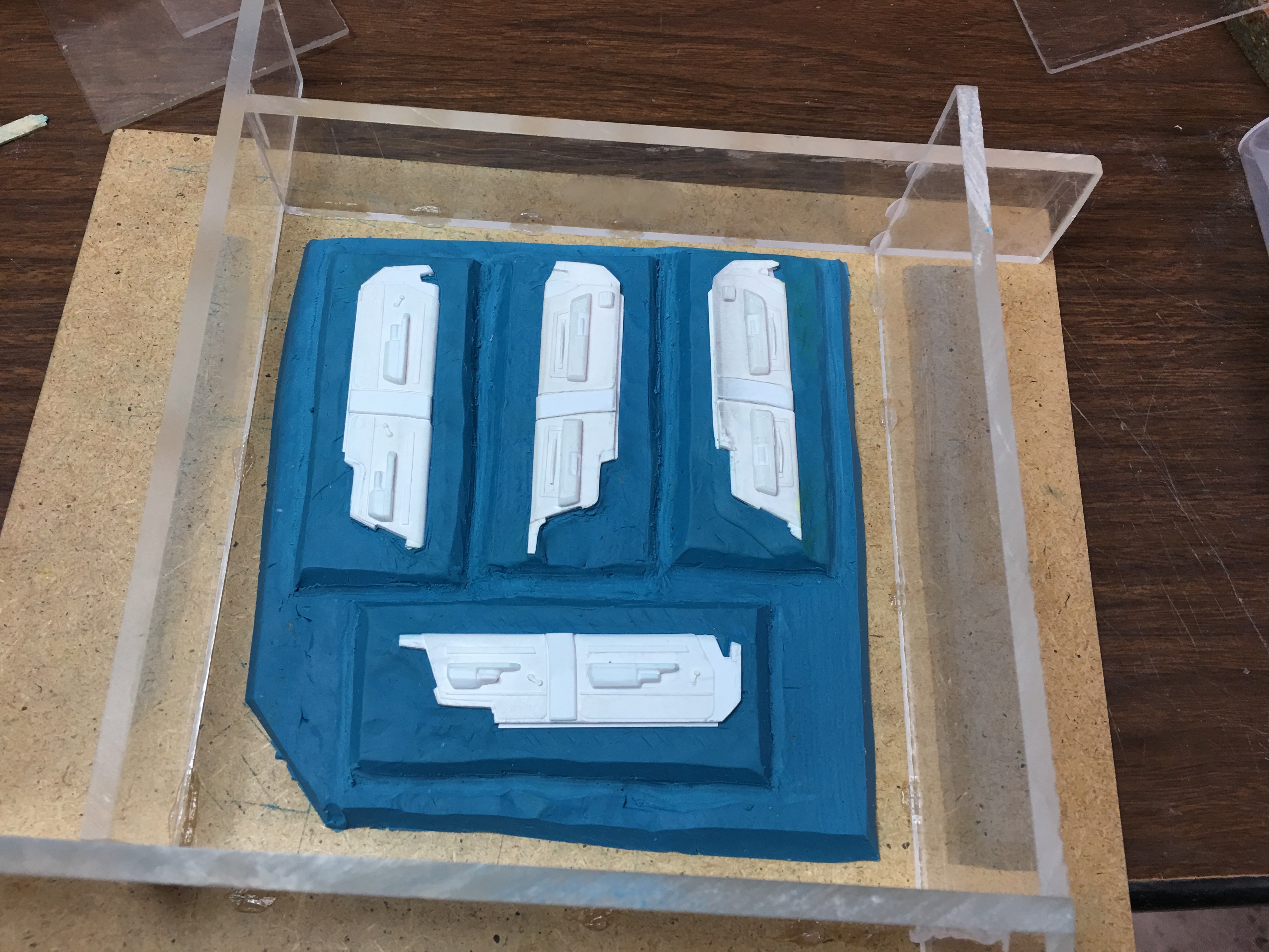

Greg Wann Posted July 15, 2018 Share Posted July 15, 2018 Here are the two dash parts. Quote Link to comment Share on other sites More sharing options...

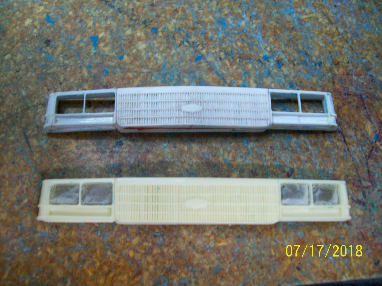

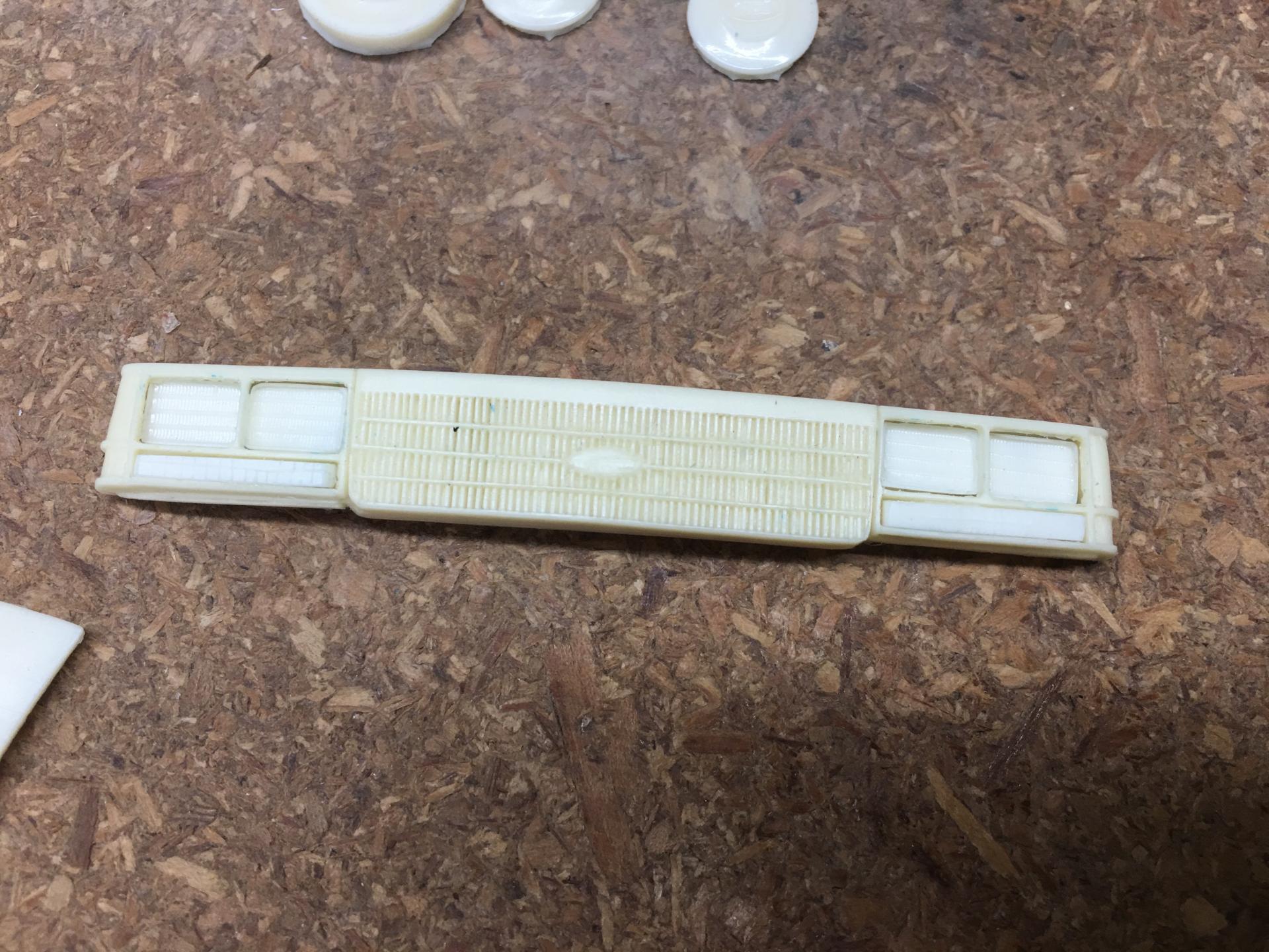

Greg Wann Posted July 17, 2018 Share Posted July 17, 2018 (edited) Here is the hood ornament. The pic is a bit fuzzy. It was nice that it stayed in the silicone and not stick to the clay when I pulled it out. Here is the front grille. It did OK for a first pull. The flash is very thin and I like that. I would still like a photo etch part. Dwayne, you did an amazing job creating this part! Dwayne, you should move here to Sun City. You would never get bored here. With learning resin casting and three recreational centers where you could make other cool stuff this is where you could be and you could join a couple of model car clubs too. Edited July 17, 2018 by Greg Wann Quote Link to comment Share on other sites More sharing options...

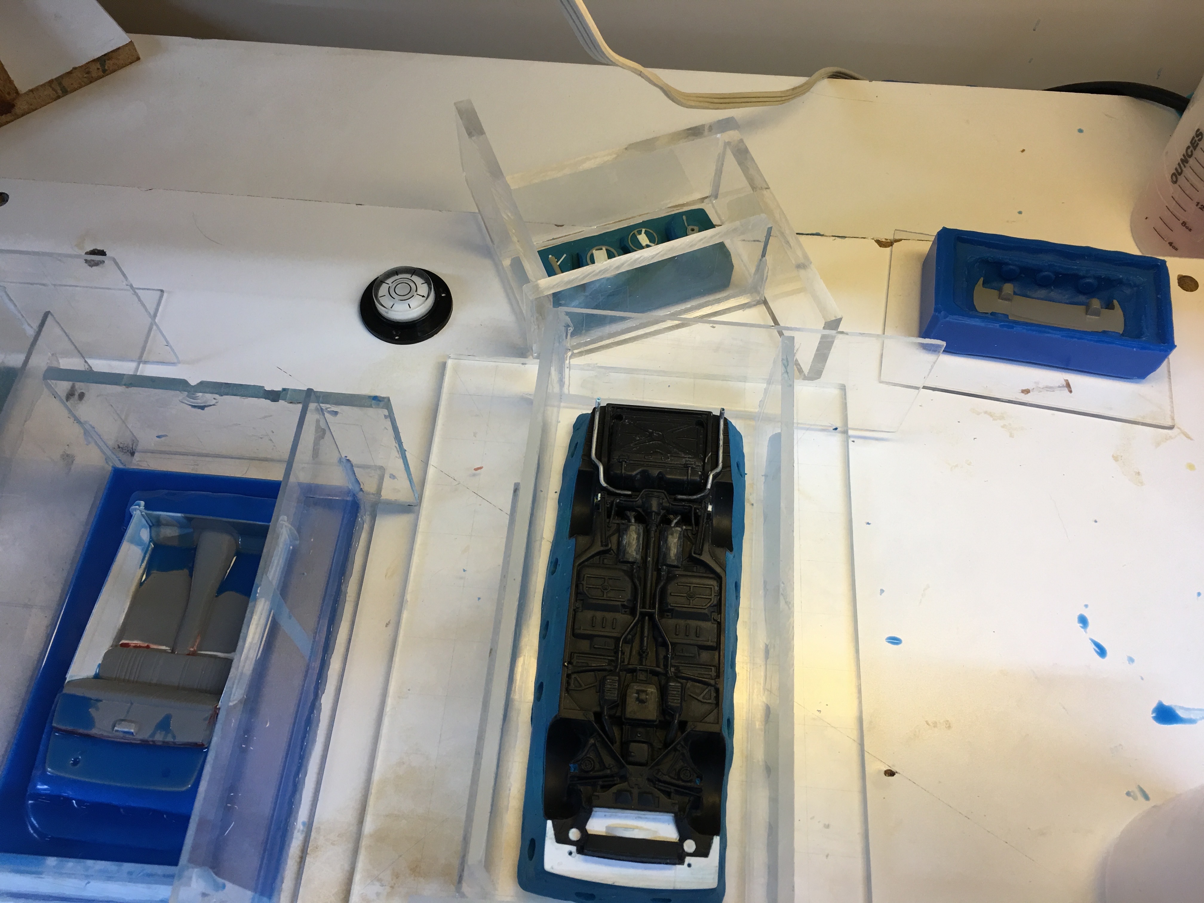

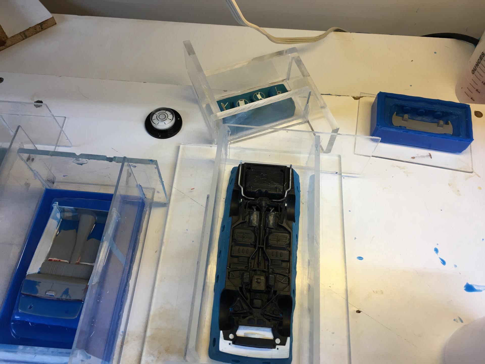

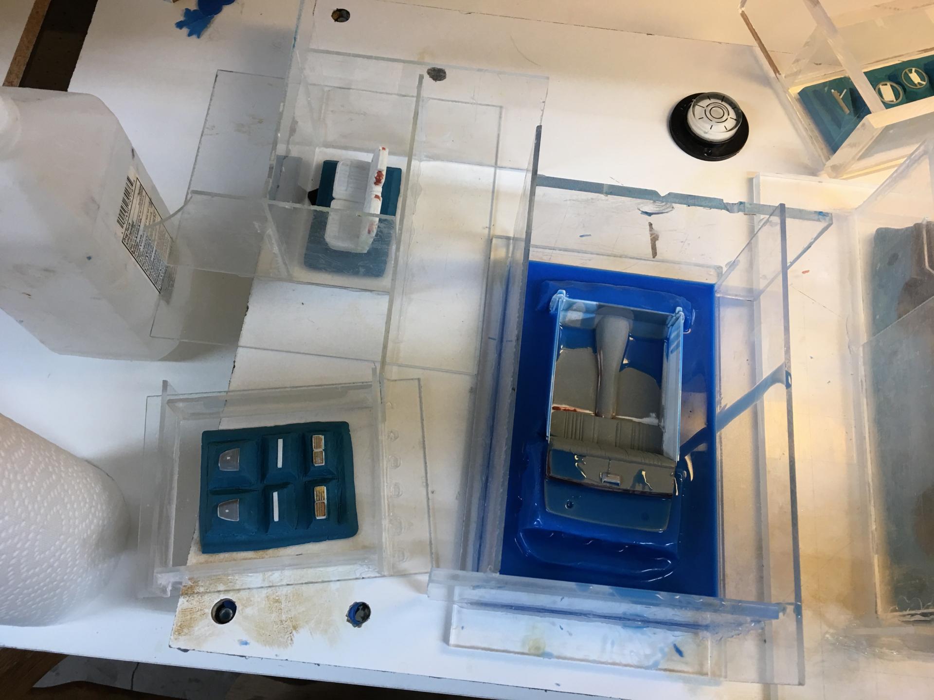

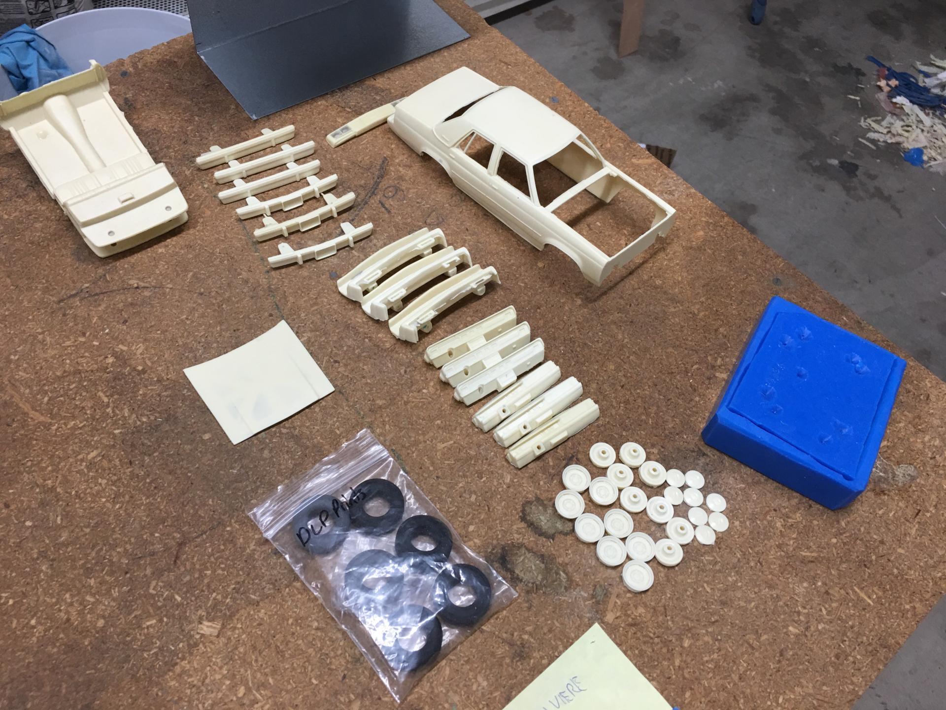

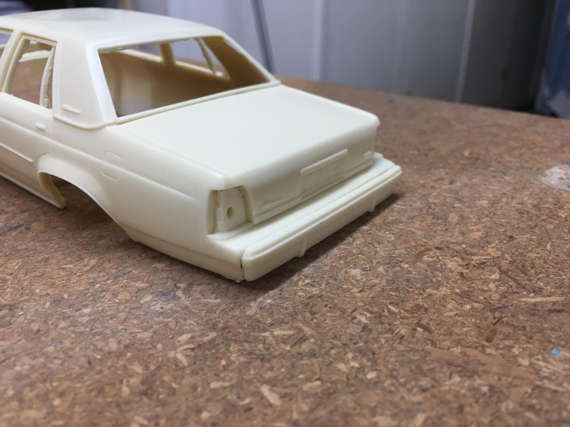

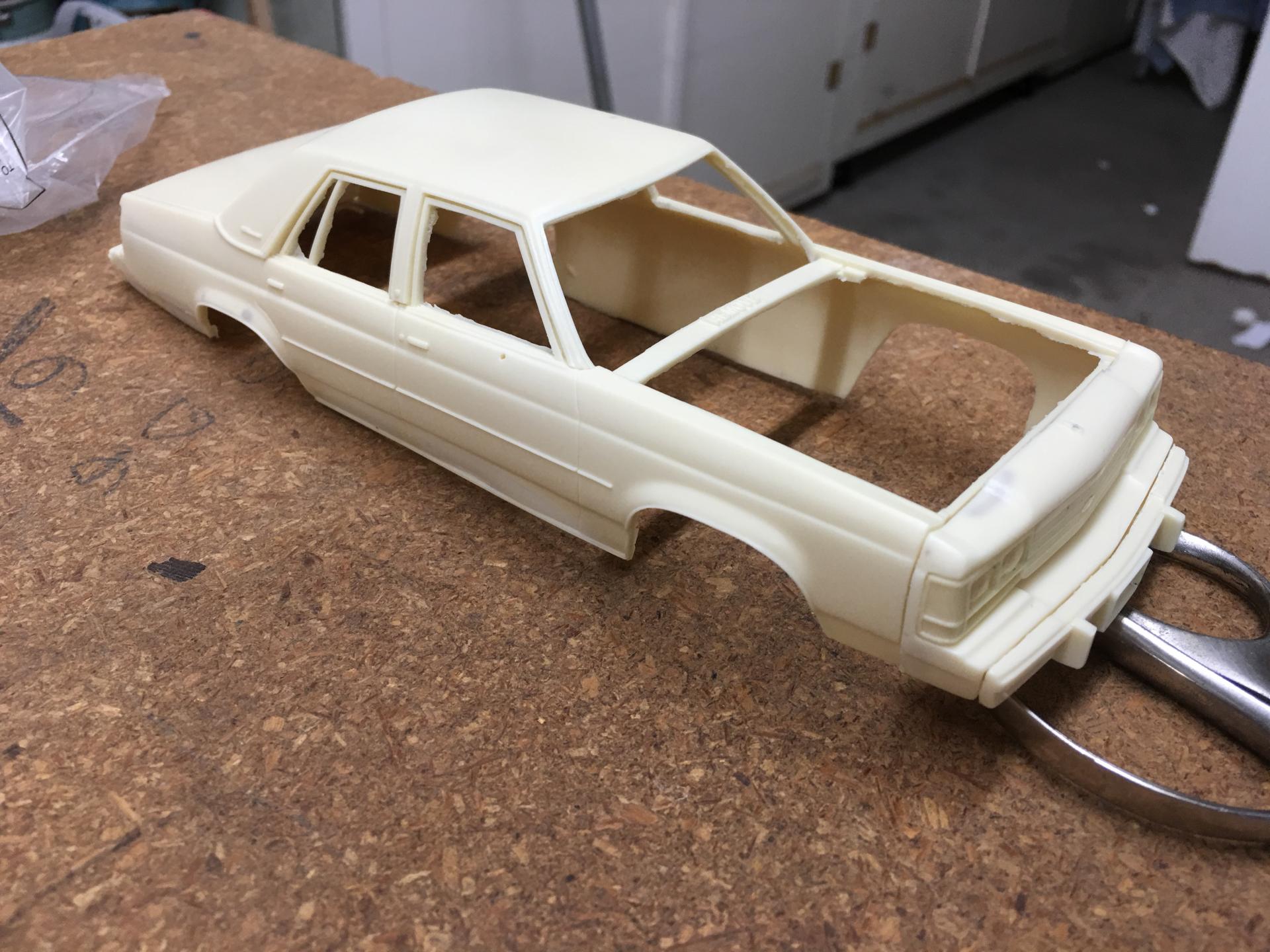

Maindrian Pace Posted August 7, 2018 Share Posted August 7, 2018 Update: All molds are made, some had to be re-made because there were strange air bubble problems in the resin castings. It's a weird thing, what works well on some parts will fight you tooth and nail on other, very similar parts. The only thing to do is try molding in a different way that splits the part in a different configuration in the silicone. If that makes any sense. Molds in process: Some finished castings: Test fitting of parts to body: Lots of great progress made in the last few weeks, shouldn't be much longer. Thanks to everyone for your patience. Quote Link to comment Share on other sites More sharing options...

peteski Posted August 8, 2018 Share Posted August 8, 2018 (edited) Looking good! I wonder how much shrinkage there is (as compared to the original master pattern) when you make a copy of a copy? Don't both RTV and urethane resins shrink as they set? Edited August 8, 2018 by peteski Quote Link to comment Share on other sites More sharing options...

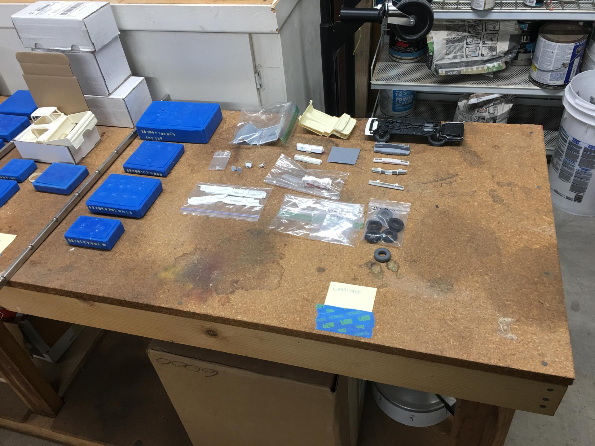

Greg Wann Posted August 20, 2018 Share Posted August 20, 2018 I made some really nice tires. Figuring out how to get the best out of a mold has a learning curve. The table is filling up with good parts for kits. Getting closer. Quote Link to comment Share on other sites More sharing options...

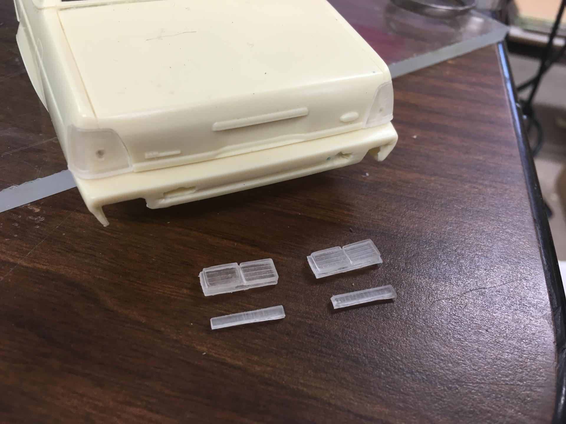

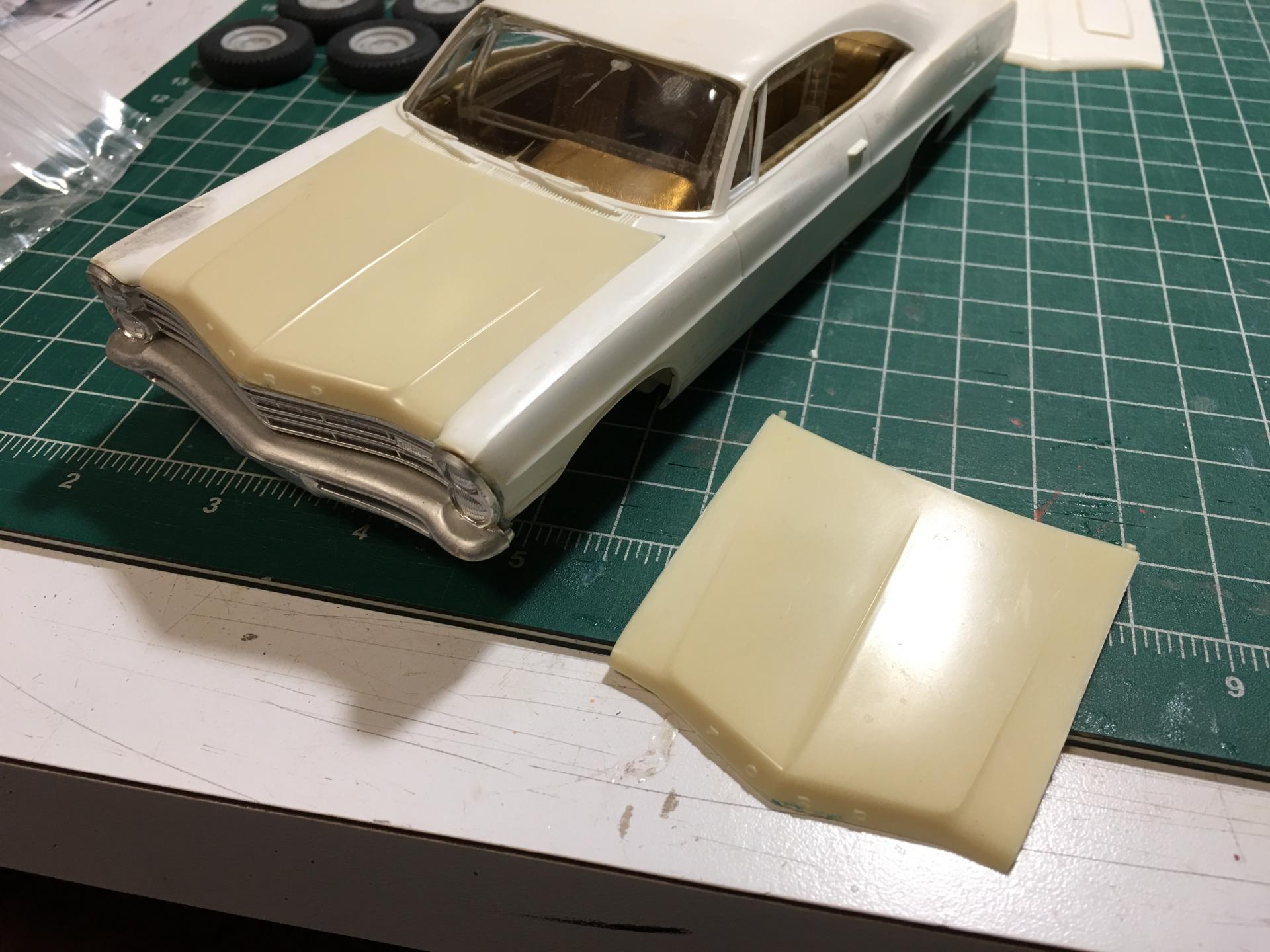

Maindrian Pace Posted August 27, 2018 Share Posted August 27, 2018 More test fitting - lenses this time. These are test lenses in opaque resin, all lenses in the kits will be in clear resin. The bottom part of the taillight on the 1:1 is the backup light, so do the top portion in Tamiya or equivalent clear red, front turn signals are amber on '88-'89, clear on '90-'91. First round clear lens test shot, a little milky but putting the resin in the vacuum chamber pulled the air and moisture out of it, and the production lenses will be more clear. (Clearer?) And here's the very first part that I made from start to finish, a '67 Galaxie hood to replace a missing hood on a kit. I did the clay-up, mold making, and resin pouring all under the supervision of the Master Caster, with quite good results. Quote Link to comment Share on other sites More sharing options...
