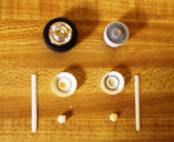

Greg Wann Posted September 7, 2018 Posted September 7, 2018 (edited) Hi All, Here is a tire mold that Mike started Sunday and I finished during the week. This is the second batch in this mold. The first batch was four really nice tires out of six. The second batch after a little more venting gave me six out of six. This is Polytek PT flex 60 with a little black dye added. This is really good. I can only hope it will perform consistently. Notice the fine dark lines in the mold? Those are lines I cut with a exacto knife to help vent the mold. I use 70 PSI with lots of weight on it. In the first photo, the part on the right is the molds lid. Mike clayed up to the line on the tire. I'm uncertain what that line is but most all tires have it. That part started out as clay with the tires setting on them. With this in mind, kit production can get under way. Terry Jessee Got his and he was impressed. Most likely it will get magazine coverage. Mike and I decided to send each kit with the two different styles of door panels, dashes and steering wheels so the builder can decide what year they want to build. So...the kit I sent to Terry weighed just under 12 ounces, I thought it would weigh much more. It cost $5.15 to mail it to him from here in Sun City. Edited September 7, 2018 by Greg Wann

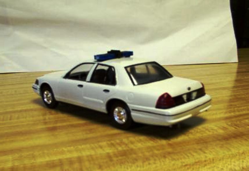

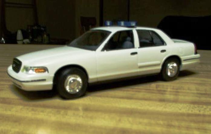

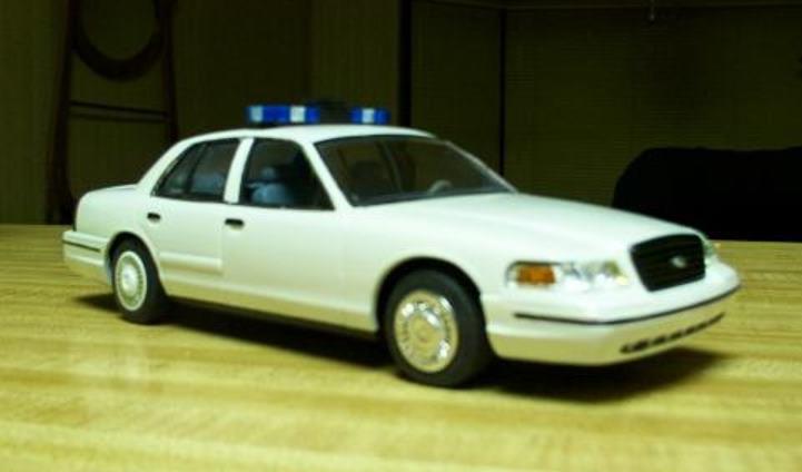

DEL Posted September 7, 2018 Author Posted September 7, 2018 (edited) Beautiful work guys! I liked the tires you sent me that last time, couldn't find anything to complain about. Those look gorgeous! As nice as any tire in any standard styrene kit I ever built. Those tires are something else, they really are.. PS: for those reading this Greg & Mike sent me a couple of the mostly done kits to examine and I have to say I believe those of you interested in this one are going to be knocked out. This is no slush cast irregular slapdash junk here. Greg & Mike believe as I do that if you aren't going to produce a solid reputable product you would be happy to display on your shelf right along with the big kit maker's stuff, then it should not even be done at all. They've put a LOT of sweat equity into this one. I believe those who choose to get one will be very pleasantly surprised. I keep meaning to post pics but this week has been unusually busy for me. Perhaps over the weekend. Thanks to all interested. Edited September 7, 2018 by DEL
