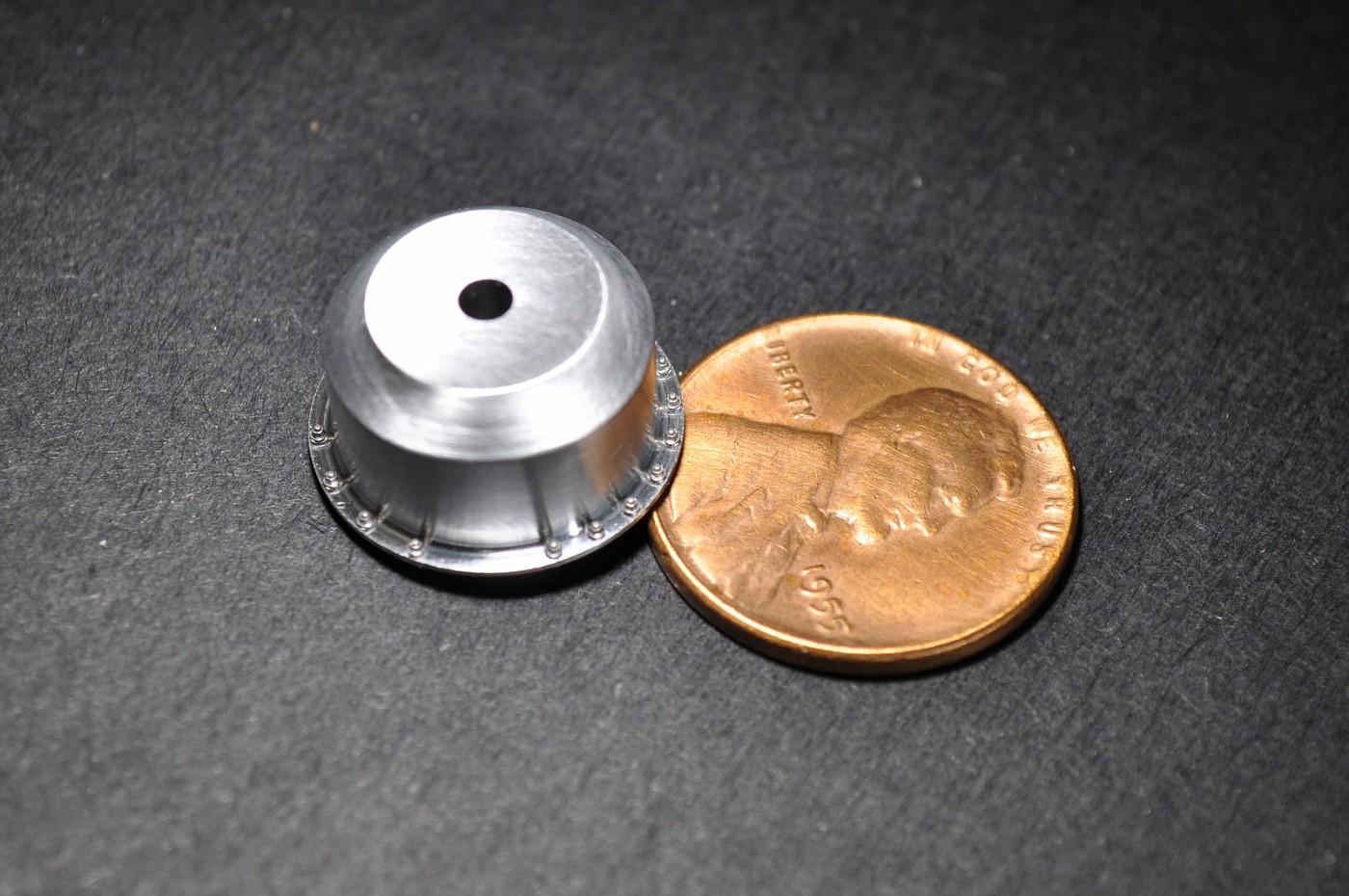

Codi Posted November 8, 2016 Author Posted November 8, 2016 (edited) Clutch can 1st, next will be the motor plate then the trans. Have to add the clutch inspection plate and this is done. The trans will be a 2 speed lenco with reverse. The can is modeled after a mid 70's Lakewood. The bolt flange is 1.1mm wide as an fyi. Cheers, tim Edited January 14, 2019 by Codi

Randy D Posted November 12, 2016 Posted November 12, 2016 Beautiful work on that can Tim !!! Is that all one piece or is the bolt flange separate ?Randy
Codi Posted November 12, 2016 Author Posted November 12, 2016 Thank you Dan! Hey Dave, yes a 2 speed with reverse. Mid-plate is done, now just fiddling around to get the tabs soldered onto the chassis, then drill the clutch can for the pedal assembly before moving onto the Lenco. Today I went to the Bruce Larson Dragfest and had a great time. Met Dave (GoatGuy) there too and the special guest was Don Garlits himself. Hard to believe I grew up just 2 miles from Bruce's place. Pics are posted on my fotki for anyone interested. Hi Randy, all one piece. Turned the can on my lathe, parted it off, flipped it upside down and drilled the holes into the flange from the backside on the mill. I'm not sure you could put a cats whisker between the bolt head and can it seems that tight to me. cheers
