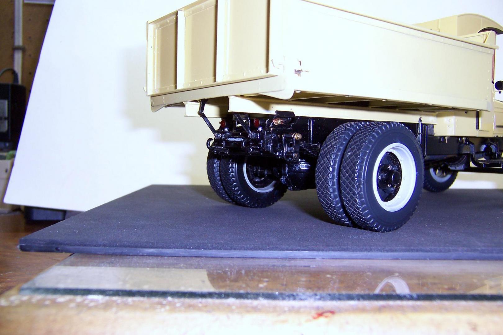

Ace-Garageguy Posted August 12, 2016 Share Posted August 12, 2016 (edited) Great OP tip above. I've been doing exactly that for over 50 years, but my grit of first choice is 180.Often, drag slicks and other wide tires will present a sunk-in-the-middle appearance. This technique also allows you to create a more realistic flat tread surface...though on a treaded racing tire, it will obviously remove the tread on the outside edges first...which can make for a very good looking used-up appearance.You'll find that different "rubber" materials respond differently to sanding though, so pay attention before you ruin a rare tire. Some "rubber" will fuzz instead of becoming dull and worn looking.Using wet-or-dry paper, as mentioned by the OP, WET, will often alleviate the fuzzing problem, as will going to a finer grit.Tire treads look more realistic if the edges are slightly rounded off after you get the treads uniformly dulled.Scrubbing tire sidewalls with a paste made of an abrasive cleanser like old (pre-scratch-free) Comet and a stiff toothbrush takes the shine off nicely and leaves a realistic dull rubber surface...without the danger of sanding details off.If you have access to a glass-bead blaster, that also works very well, but you have to be careful. Edited August 12, 2016 by Ace-Garageguy Quote Link to comment Share on other sites More sharing options...

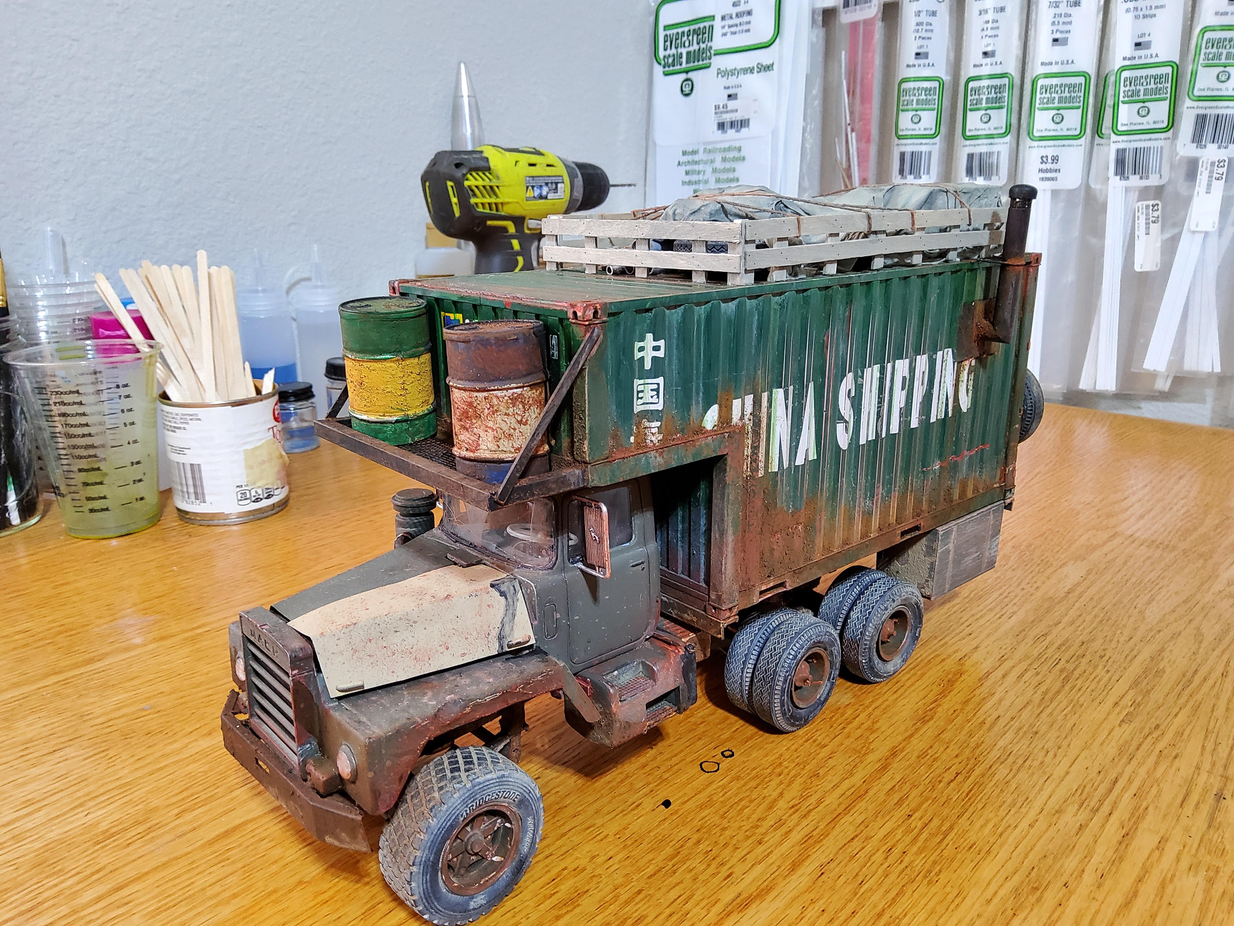

Oldmopars Posted January 24, 2022 Share Posted January 24, 2022 I have found acrylic craft paint works really well due to the dead flat look. Brush some "pavement black" into the treads and sand off the tread after dries. I have also used more sandy/dirty colors to get the weathered look like seen in the picture below. BTW, the truck in the picture is not finshed, I have a way to go, but the tires were painted and simply rubbed off with a rag leaving "Dirt" in the treads and dulling the side walls. I know this will be too extreme for a normal show/street car, but if you are doing a beater or old truck it works well. Quote Link to comment Share on other sites More sharing options...

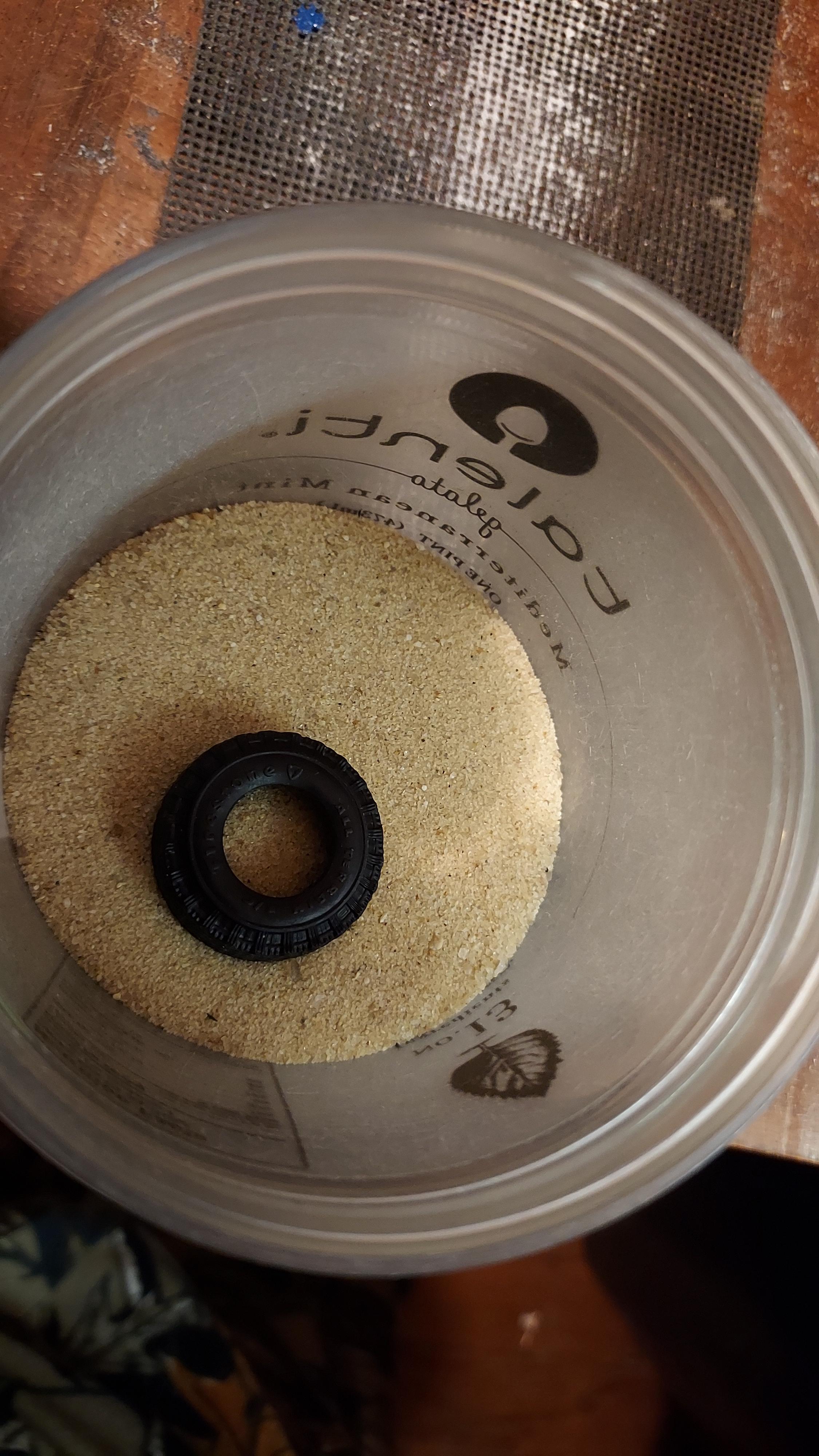

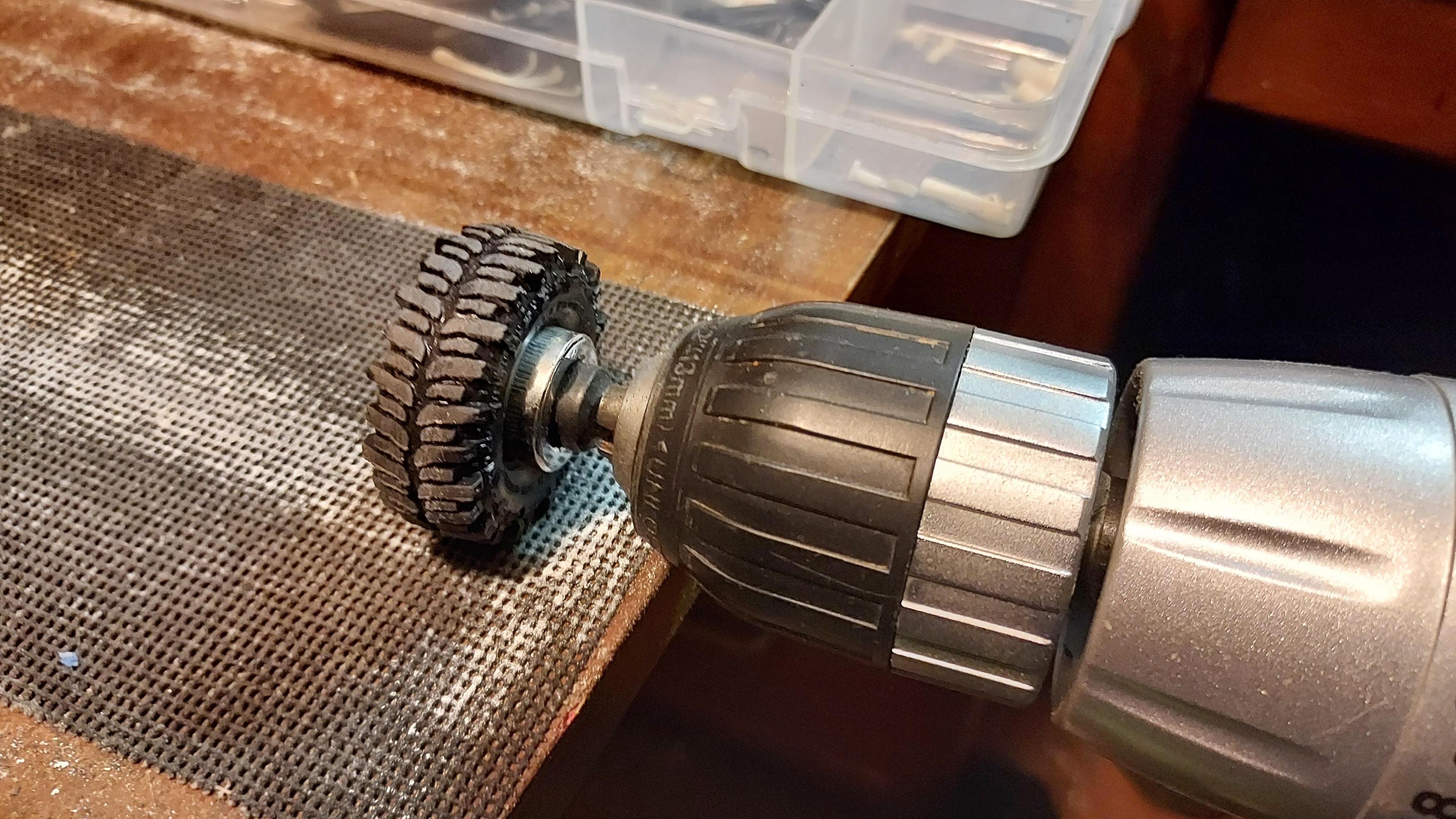

Mike C. Posted January 25, 2022 Share Posted January 25, 2022 Here's a little trick I like to do. I got a 3 pack of different size drives that allow you to use sockets on your drill. Any hardware store should have these. Now you find the socket with the correct outer diameter, attach it to your drill and spin it on your pice of sandpaper on a flat surface. Reverse the and repeat until you get the desired effect. You can even angle the drill a bit if you like. For the sidewalls, I found that these plastic ice cream containers with a screw on lit works nicely when you put some sand in with your too new looking tire. Then shake until you are satisfied. Quote Link to comment Share on other sites More sharing options...
Casey Posted January 25, 2022 Share Posted January 25, 2022 27 minutes ago, Mike C. said: I found that these plastic ice cream containers Gelato and sorbetto, to be correct. 🤤 I have saved those containers, too, as they are a great size/volume. The cleanser scrub always seems to give good results, without making the tire look like it's ben out in the elements for decades. Just be sure you buy old school cleanser, as many similar products, like Barkeepers Friend, are not nearly as aggressive. Find for vintage enameled cast iron sinks and tubs, less ideal for scrubbing model car tires. Quote Link to comment Share on other sites More sharing options...
