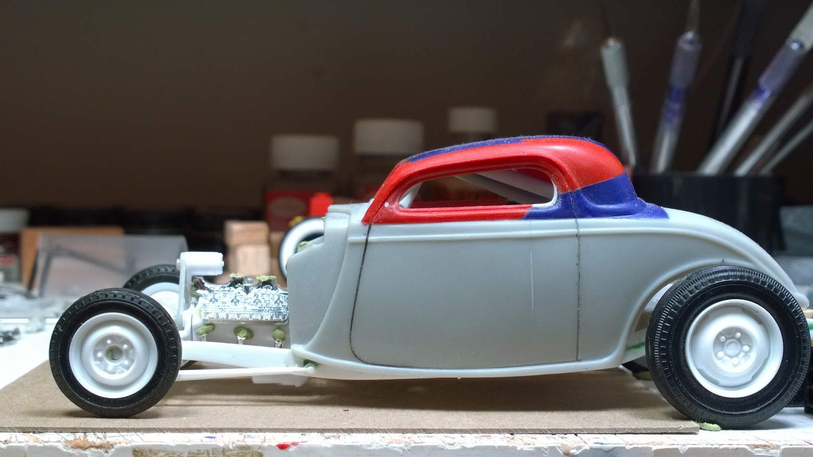

Kit Karson Posted March 3, 2017 Share Posted March 3, 2017 Kit Karson's '33 3hree Window Coupe 420c 2 Quote Link to comment Share on other sites More sharing options...

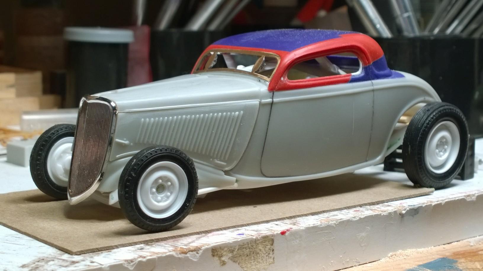

Ace-Garageguy Posted March 3, 2017 Share Posted March 3, 2017 Nice work converting the AMT 5W to a 3W. Though I'm not usually a fan of a wedge-chop, you've hit the sweet-spot with this one. What's the story on the multi-hued roof? 1 Quote Link to comment Share on other sites More sharing options...
tim boyd Posted March 3, 2017 Share Posted March 3, 2017 Sharp, sharp, sharp!!!! TIM 1 Quote Link to comment Share on other sites More sharing options...
Rocking Rodney Rat Posted March 3, 2017 Share Posted March 3, 2017 I've seen it in person and it looks even better. Throw a coat of primer on that sucker, KK!! 1 Quote Link to comment Share on other sites More sharing options...
Spex84 Posted March 3, 2017 Share Posted March 3, 2017 Slick! Love it so far.Was there much work involved in getting the '33 grille to fit the '34 hood and sides? 1 Quote Link to comment Share on other sites More sharing options...

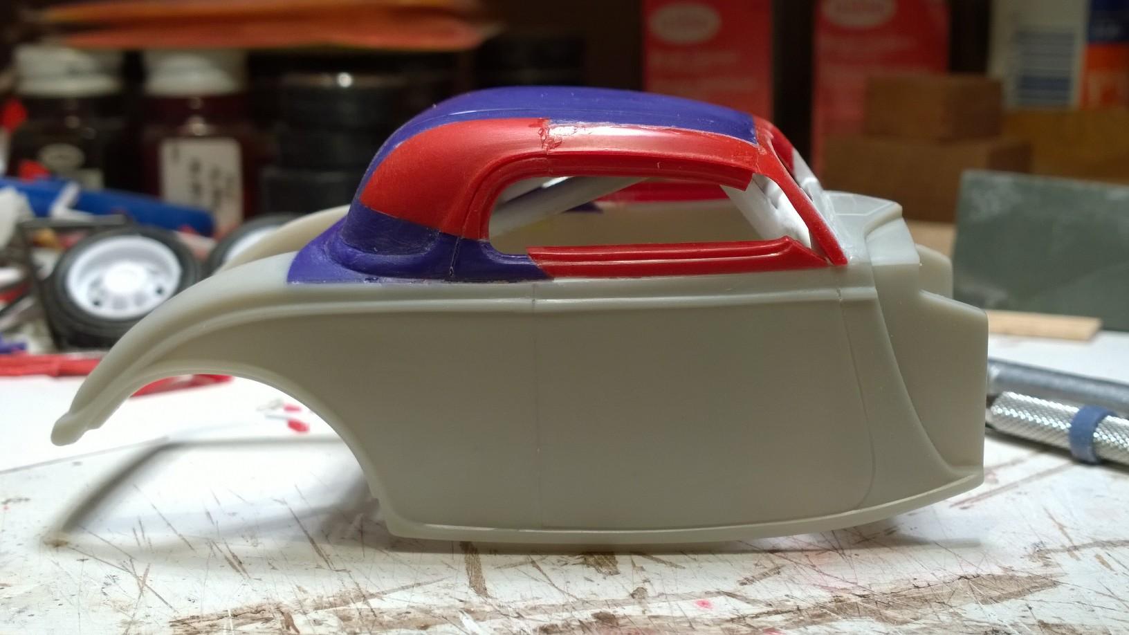

Dennis Lacy Posted March 3, 2017 Share Posted March 3, 2017 Looks awesome, bro! Glad to see it out in the wild.What's the story on the multi-hued roof?Keep an eye on this guy, Bill, it's like watching a brain surgeon at work. Maybe KK will share some roof construction photos. The work that went into it is nuts. Far beyond a simple "roof swap." 1 Quote Link to comment Share on other sites More sharing options...
Mr. Metallic Posted March 3, 2017 Share Posted March 3, 2017 Man, this is sweet. Nice to see big pics on my computer rather than the ones on my phone on facebook. I'm intrigued by the chop work, and the necessity for multiple bodies. I'm assuming that is to attain the wedge shape. Can't wait to see it all in one color to get a true feel for the design. 1 Quote Link to comment Share on other sites More sharing options...

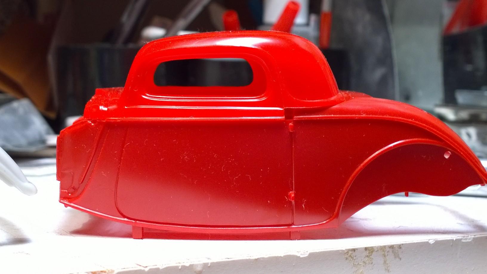

DumpyDan Posted March 3, 2017 Share Posted March 3, 2017 Just checked out the pic's you added thanks. Going back to look more 1 Quote Link to comment Share on other sites More sharing options...

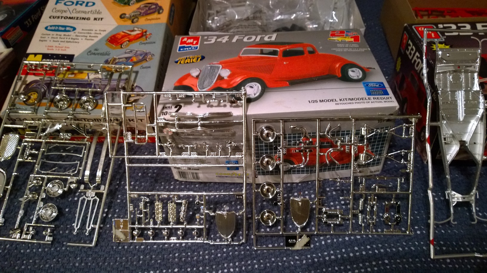

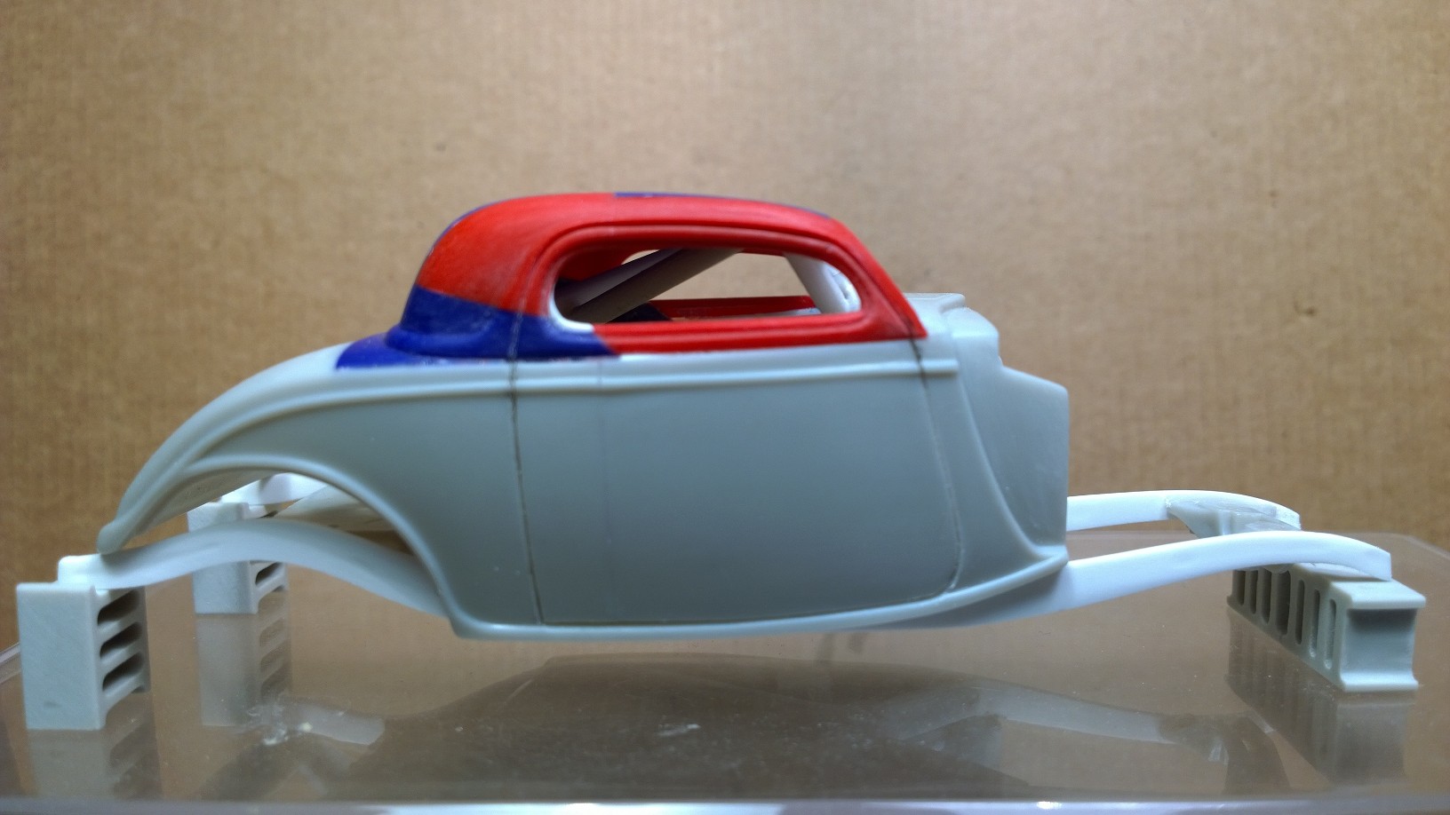

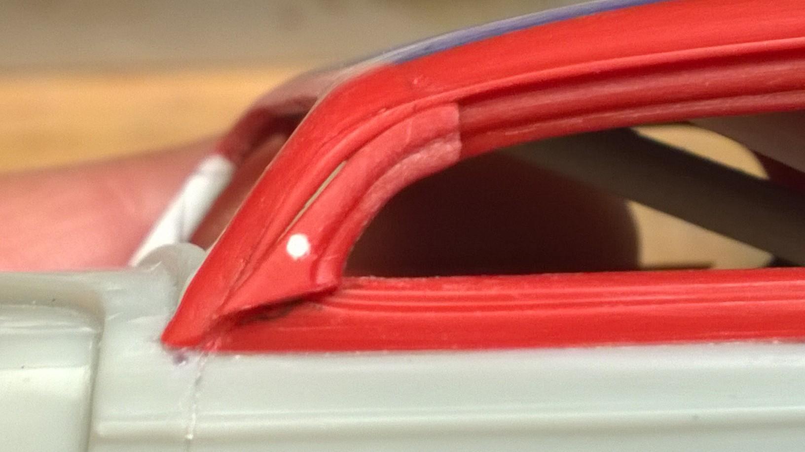

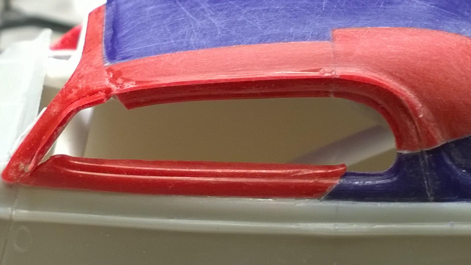

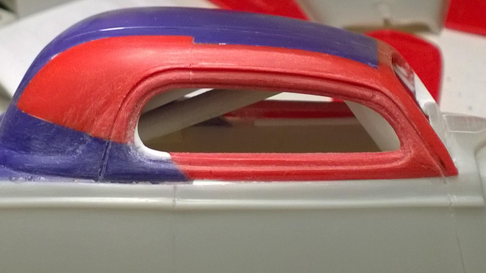

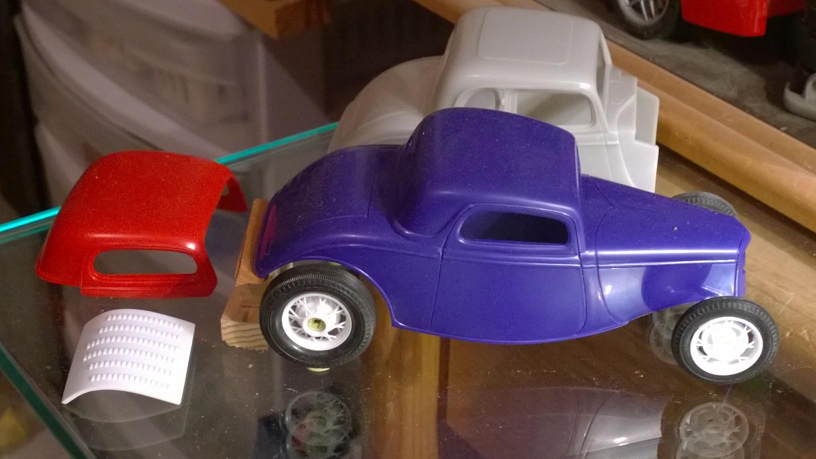

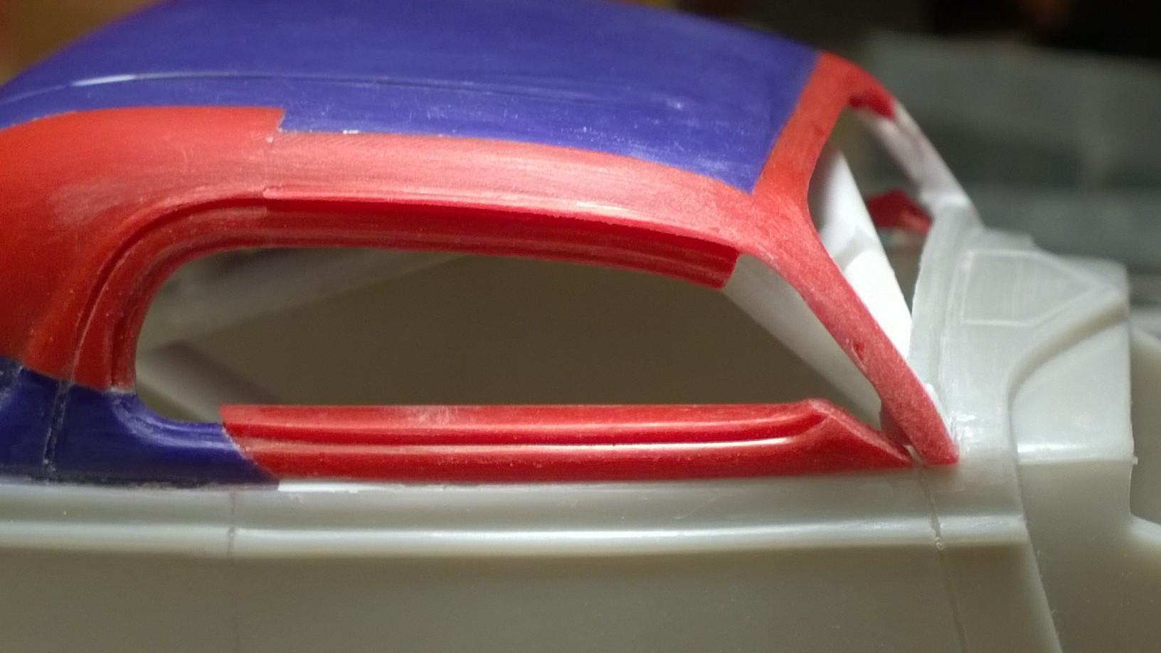

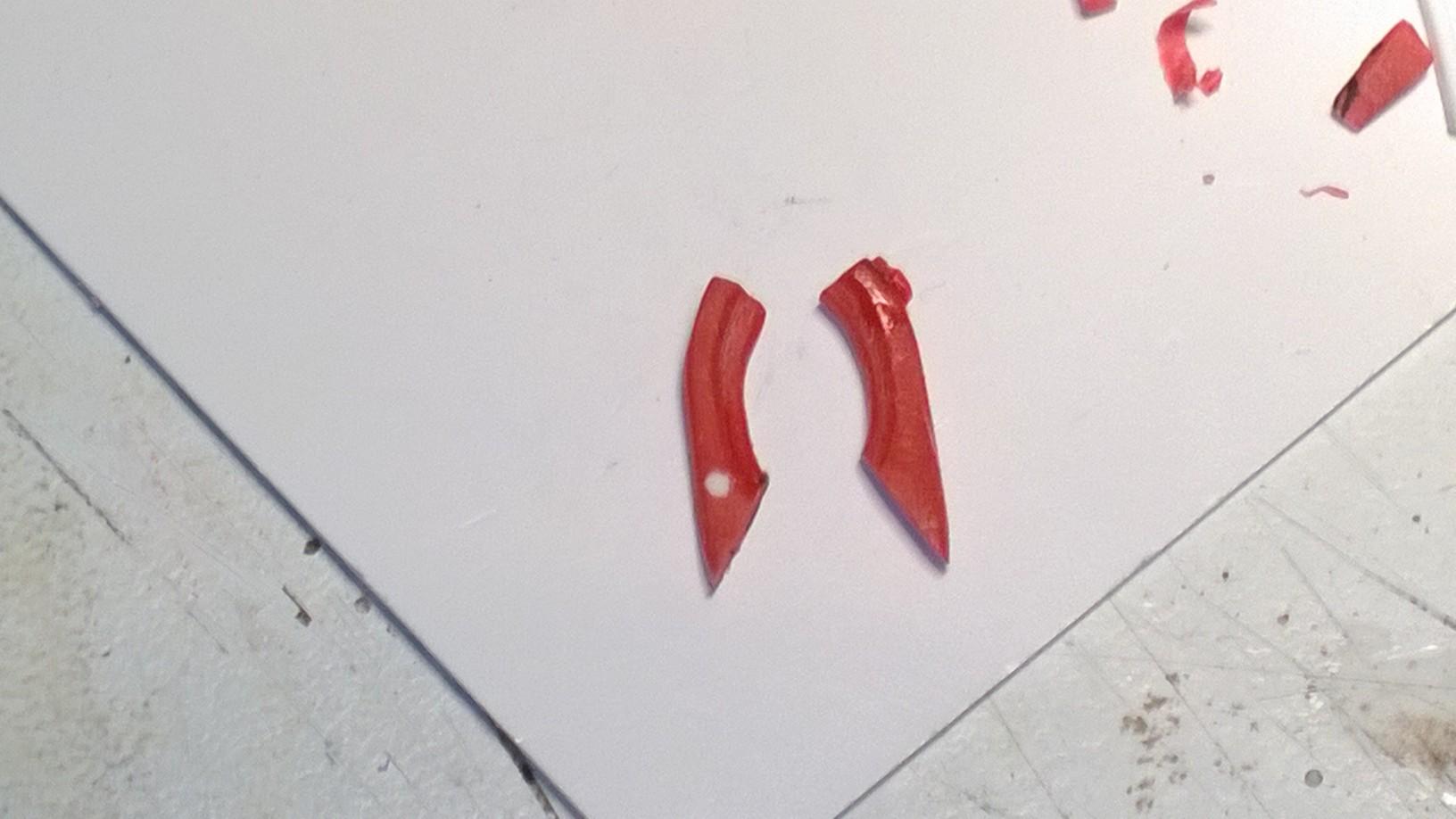

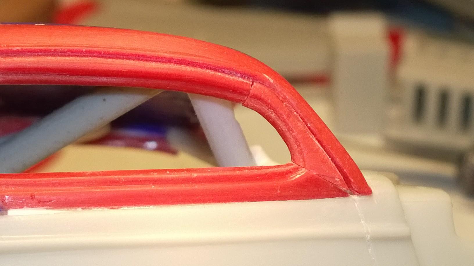

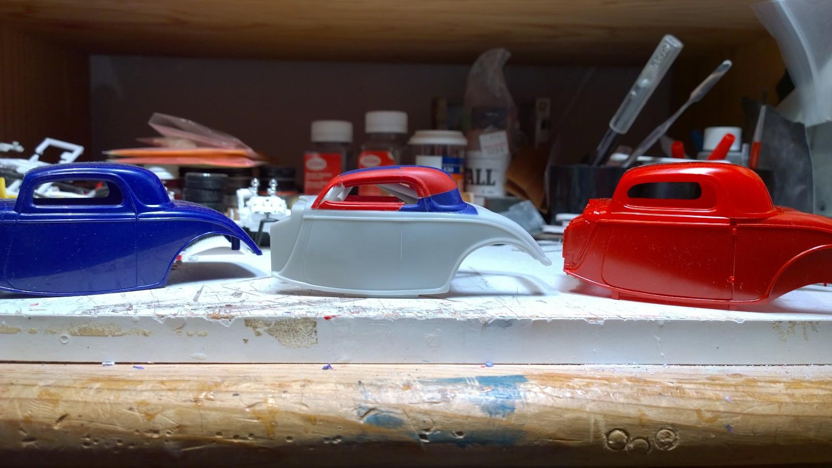

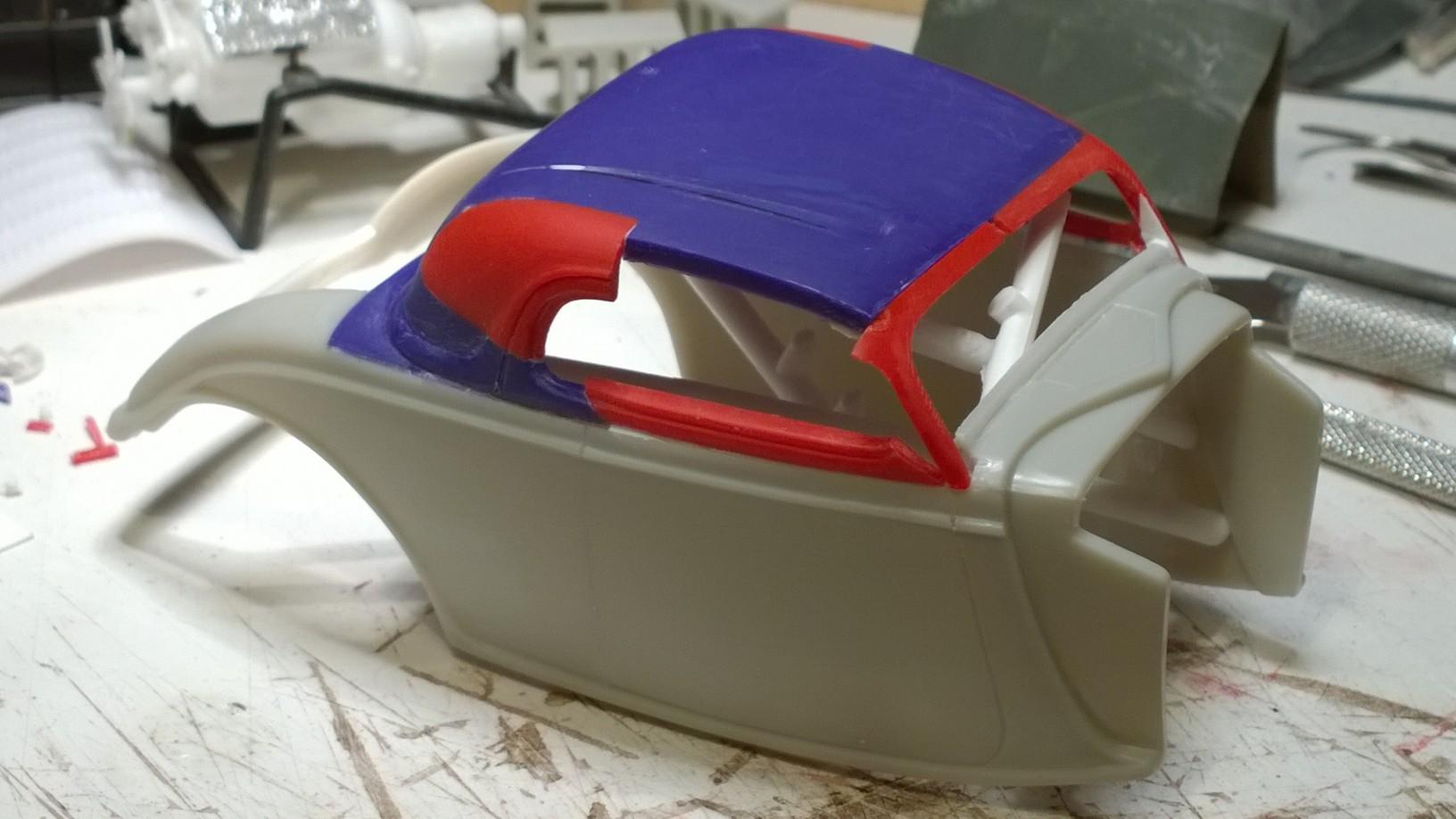

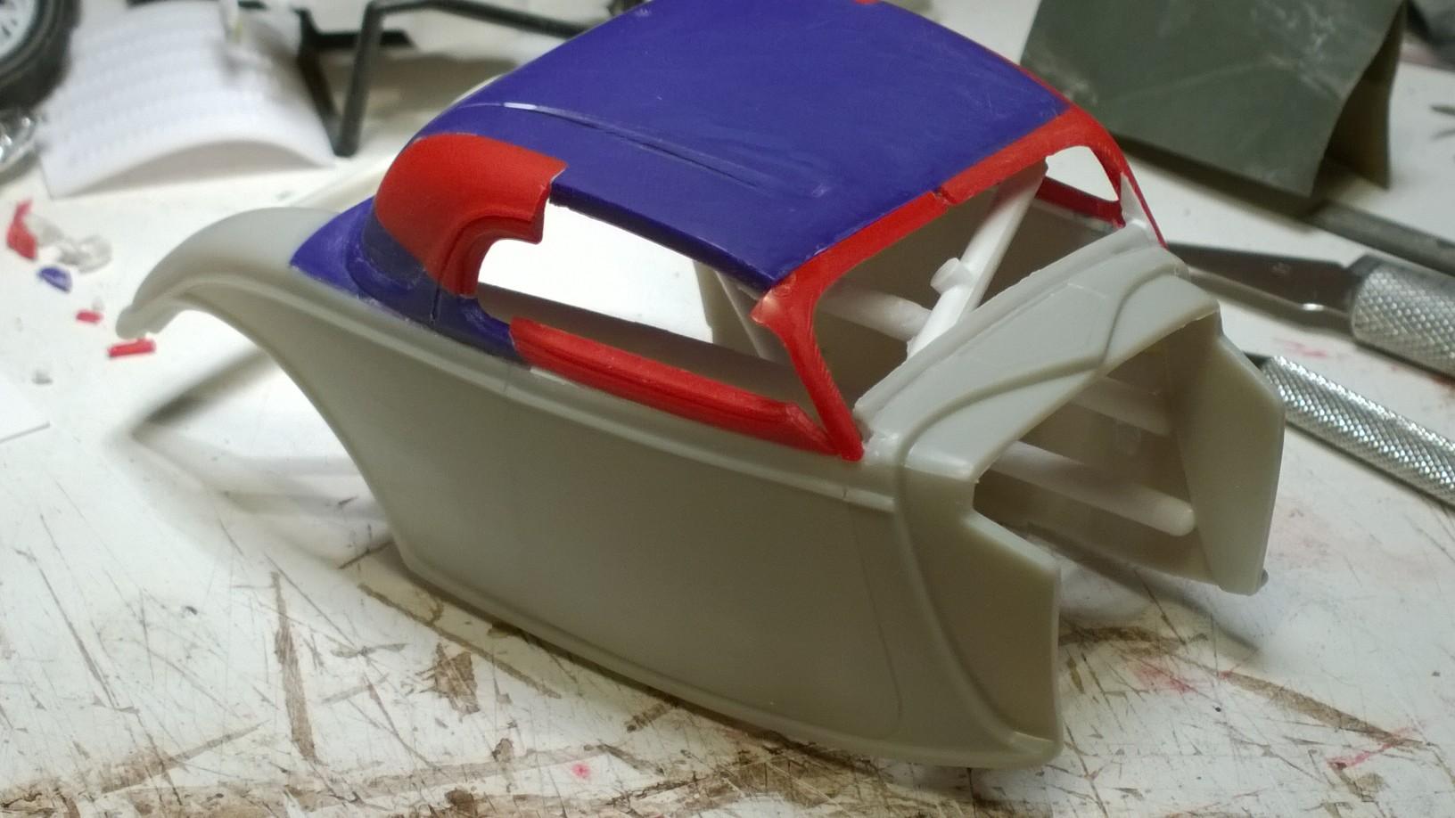

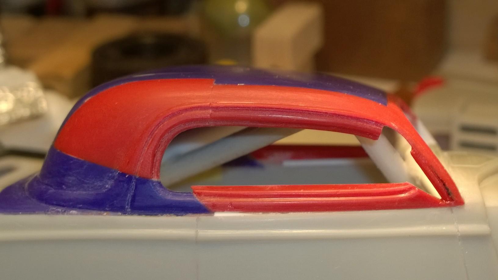

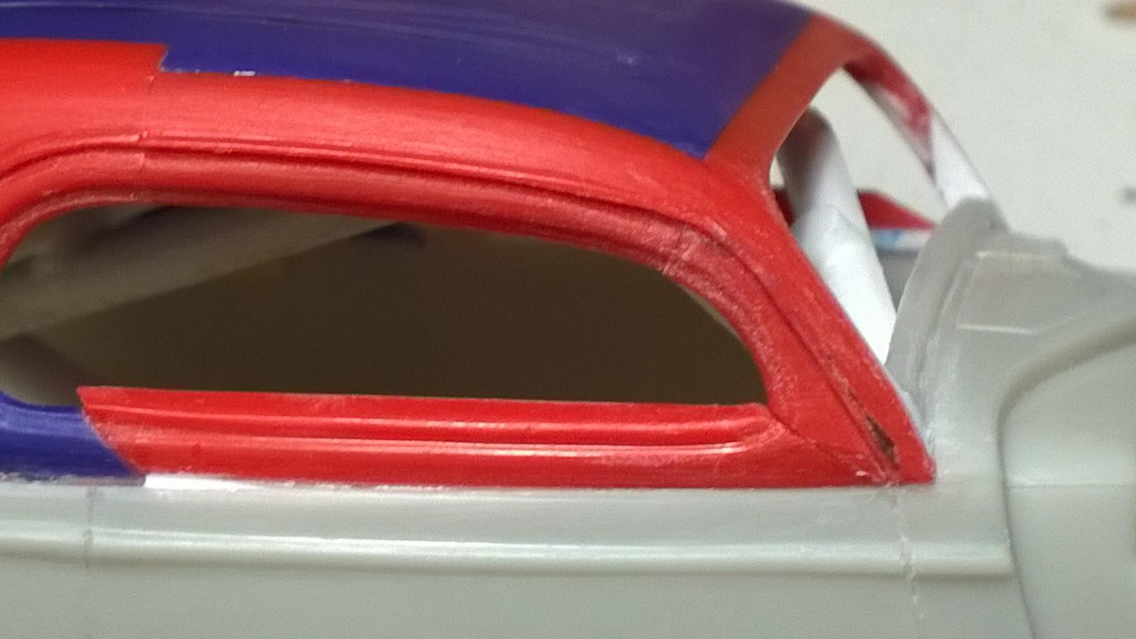

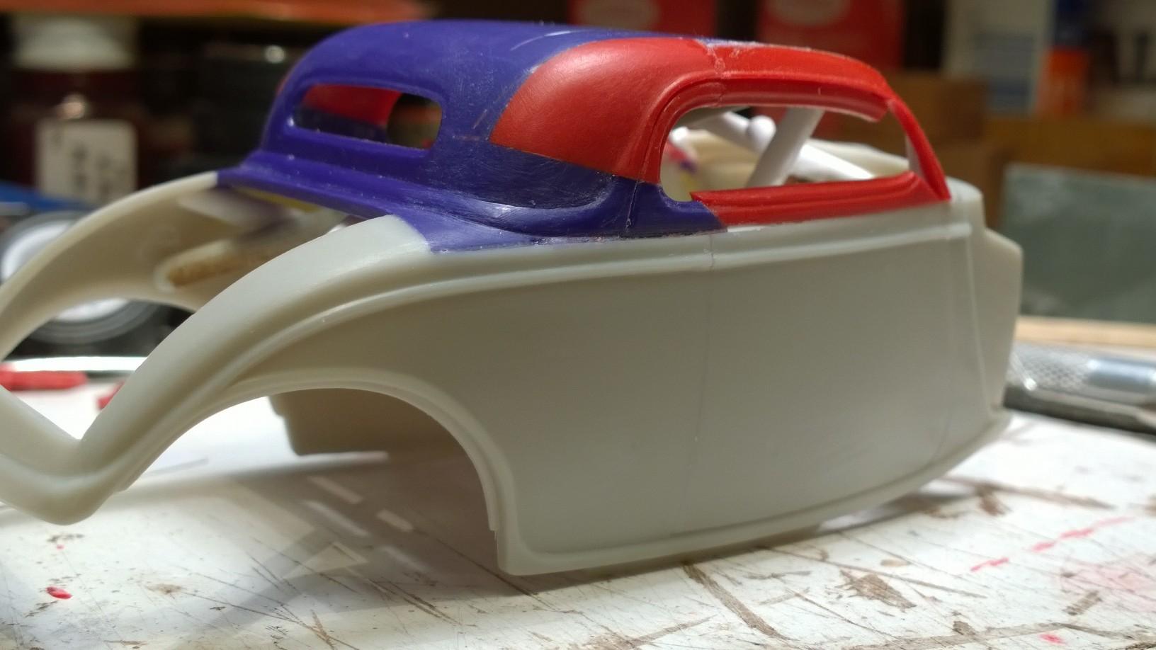

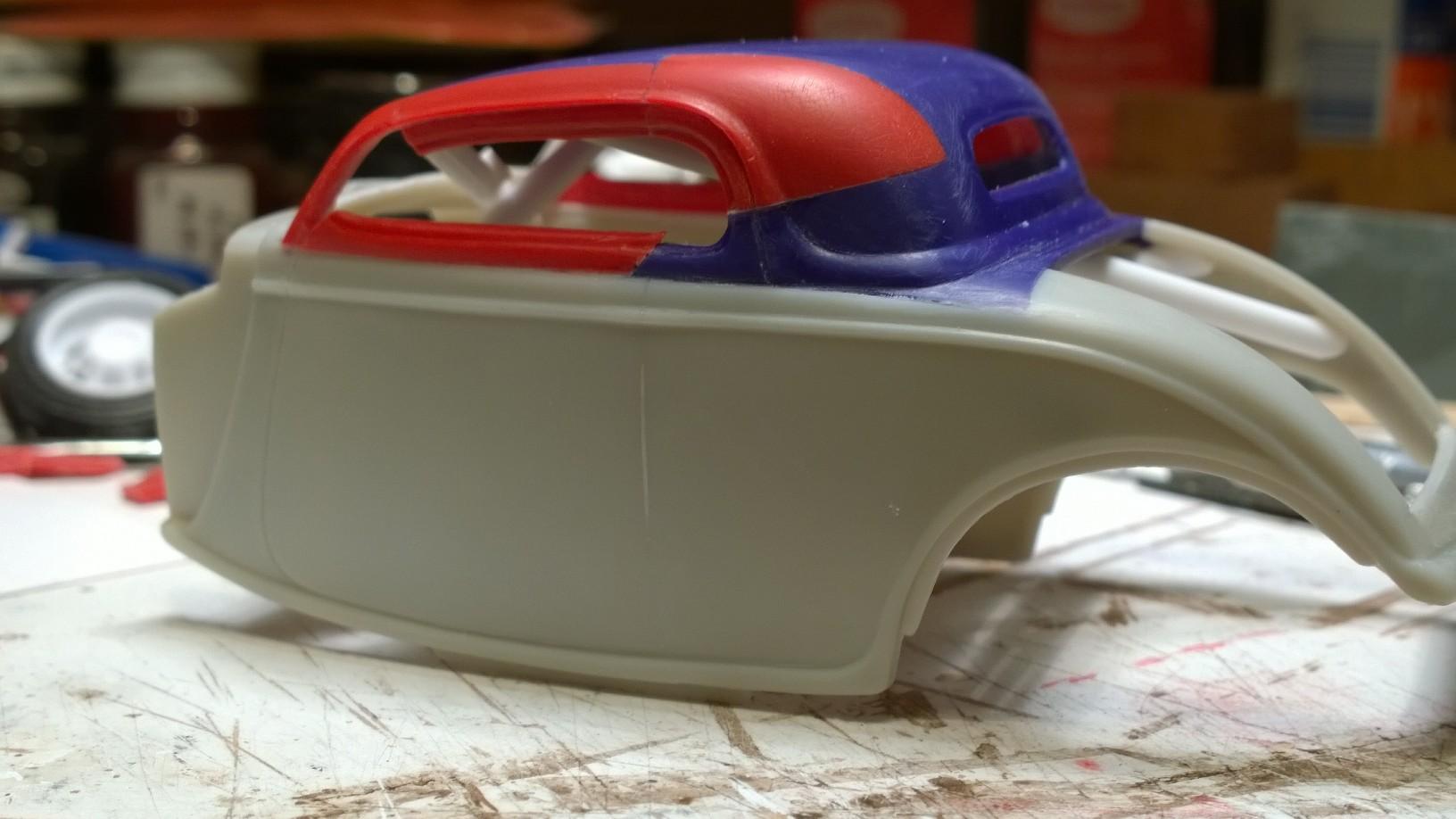

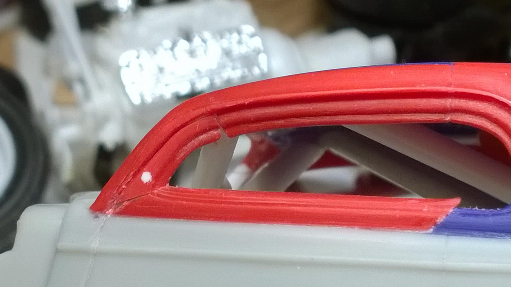

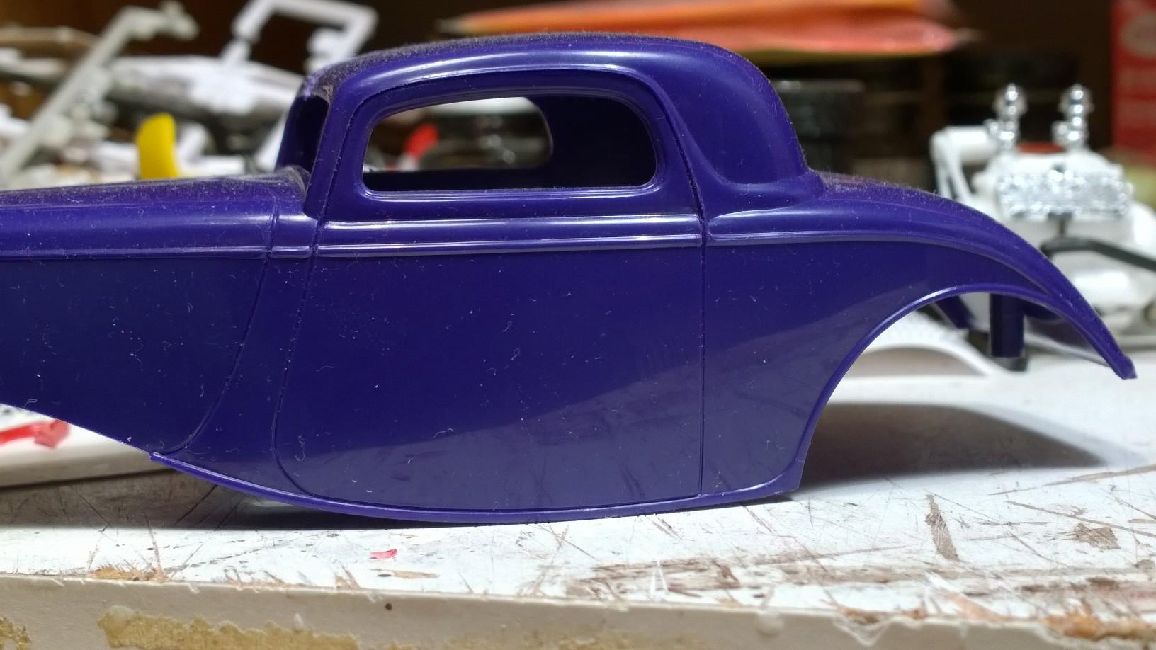

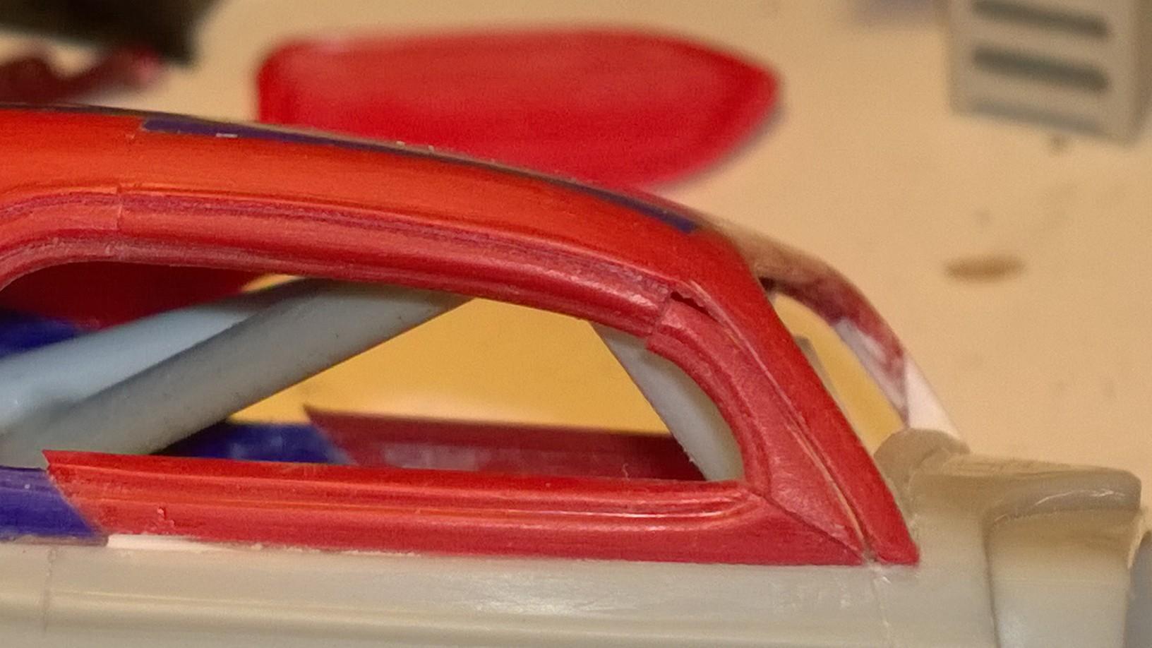

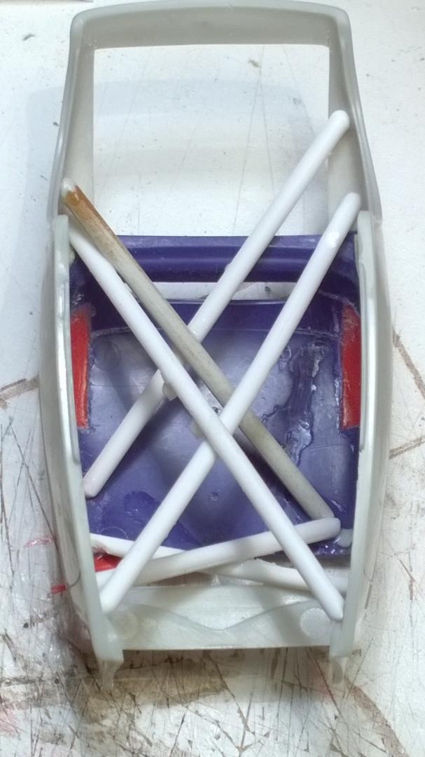

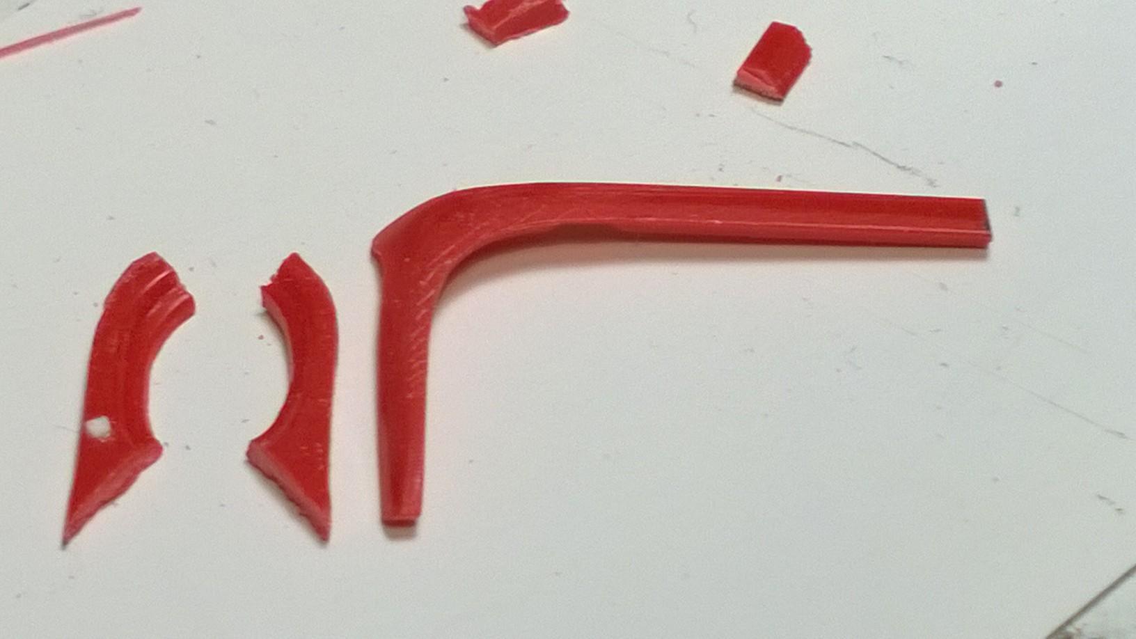

Kit Karson Posted March 3, 2017 Author Share Posted March 3, 2017 Nice work converting the AMT 5W to a 3W. Though I'm not usually a fan of a wedge-chop, you've hit the sweet-spot with this one. What's the story on the multi-hued roof? It all started with the '33/'34 Ford 3hree Window Coupes from Monogram/Revell & the AMT '34 5ive Window Coupe bodies. The Monogram greenhouse is wider and a bit too long to fit the AMT body, but the upper rear corners of the door frame (lite openings) are far more correct than the Revell Snap Kit. So, to get the right contours meant some slicing and dicing had to done to combine the varying components together to create the chopped '33 3hree window greenhouse. '33 coupe A pillar reconstruction and redoing the bracing was an integral part in assuring the body remained structurally sound during the reconstruction of the chopped top. Quote Link to comment Share on other sites More sharing options...

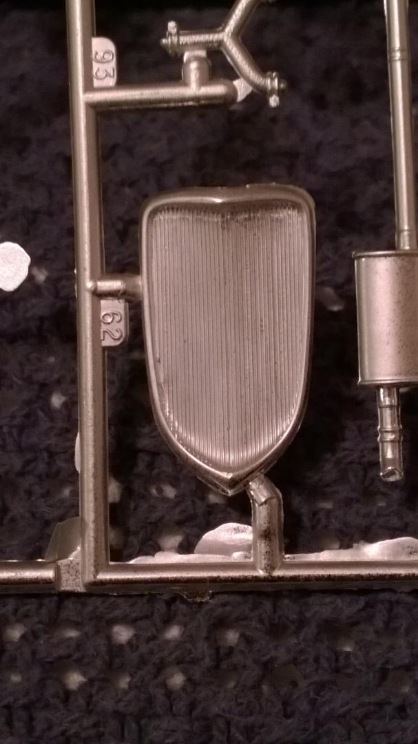

Kit Karson Posted March 3, 2017 Author Share Posted March 3, 2017 (edited) Slick! Love it so far. Was there much work involved in getting the '33 grille to fit the '34 hood and sides? The AMT '33 Ford Street Rod 2dr Sedan Grilles fit the AMT '34 Ford 5 Window Coupe without any modifications... Edited March 3, 2017 by Kit Karson 1 Quote Link to comment Share on other sites More sharing options...
Kit Karson Posted March 3, 2017 Author Share Posted March 3, 2017 Looks awesome, bro! Glad to see it out in the wild. Keep an eye on this guy, Bill, it's like watching a brain surgeon at work. Maybe KK will share some roof construction photos. The work that went into it is nuts. Far beyond a simple "roof swap." Quote Link to comment Share on other sites More sharing options...
Ace-Garageguy Posted March 3, 2017 Share Posted March 3, 2017 Lots of effort on that roof, but the final contours and proportions justify every bit of it, and you demonstrate remarkable forward vision to be able to determine exactly what needed to go where to provide the desired result. Good stuff here. 1 Quote Link to comment Share on other sites More sharing options...

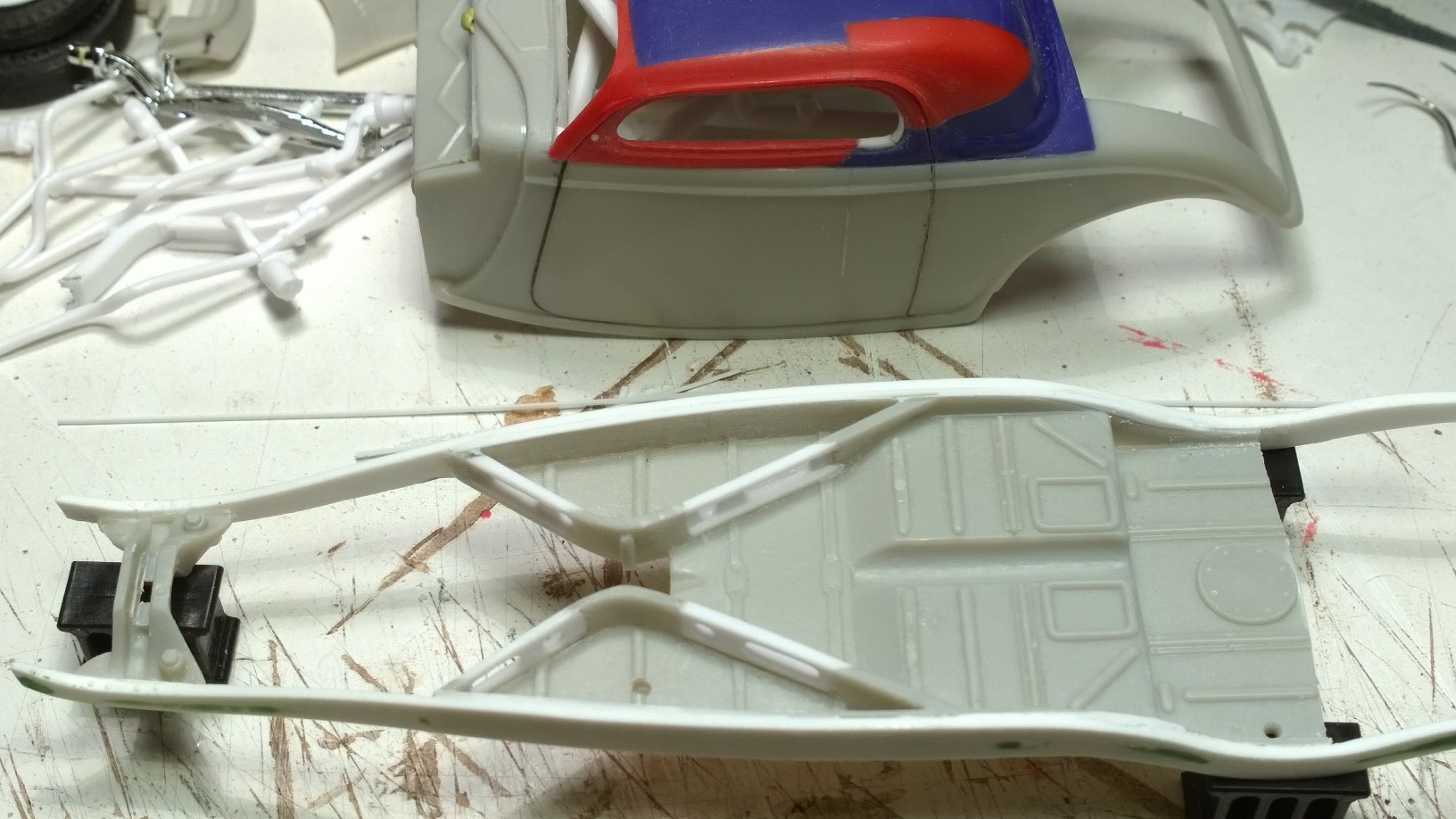

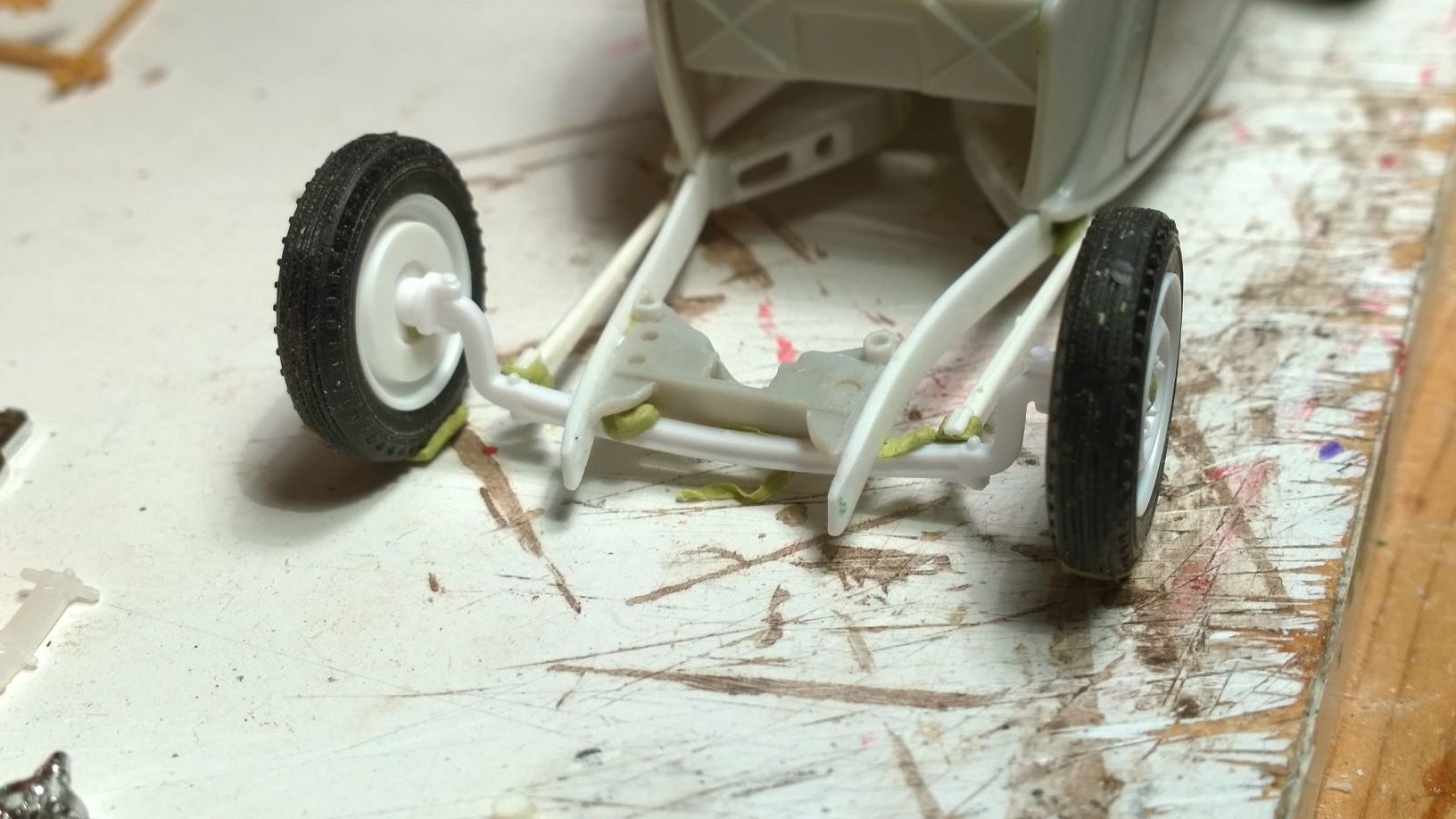

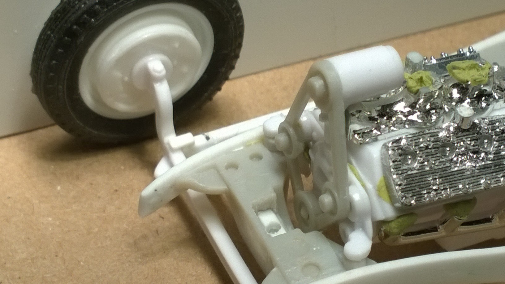

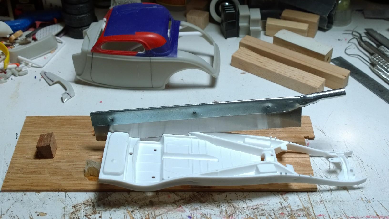

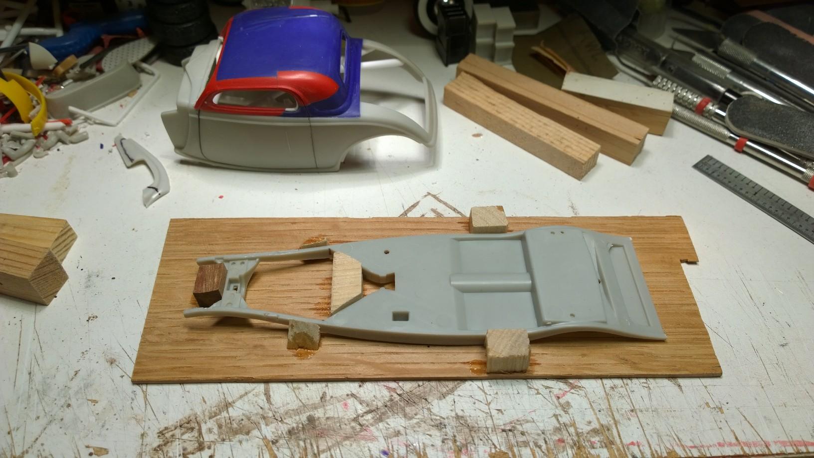

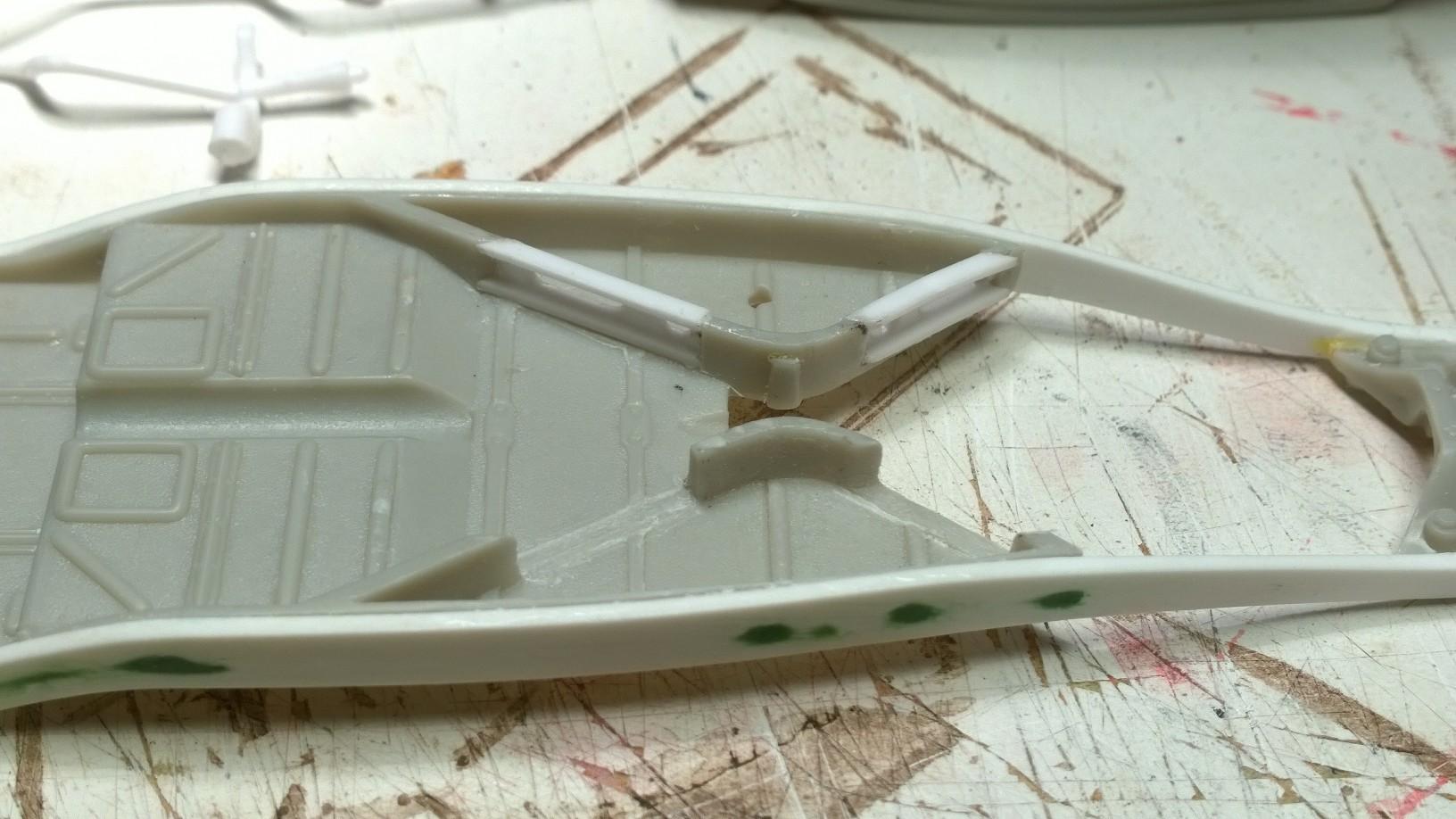

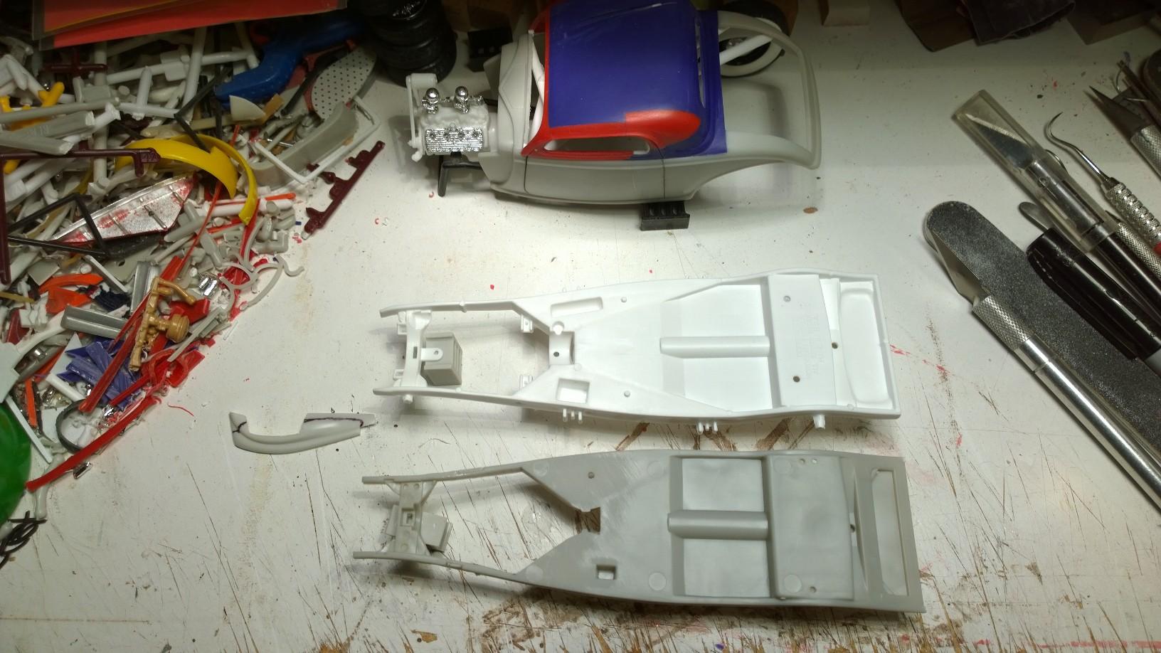

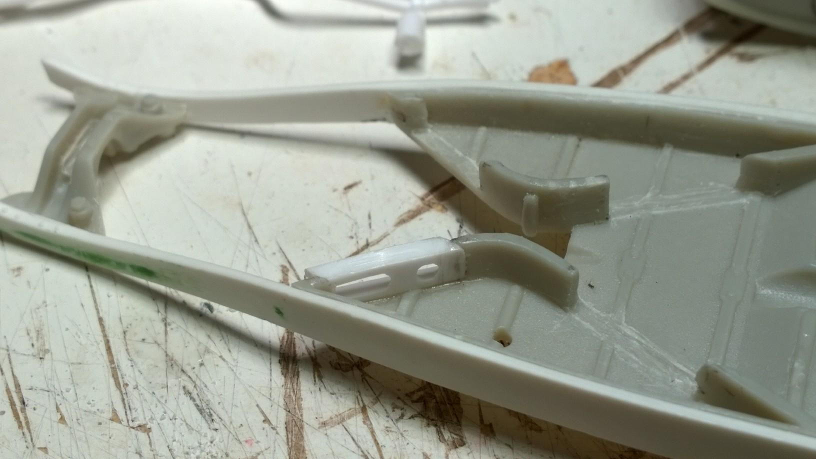

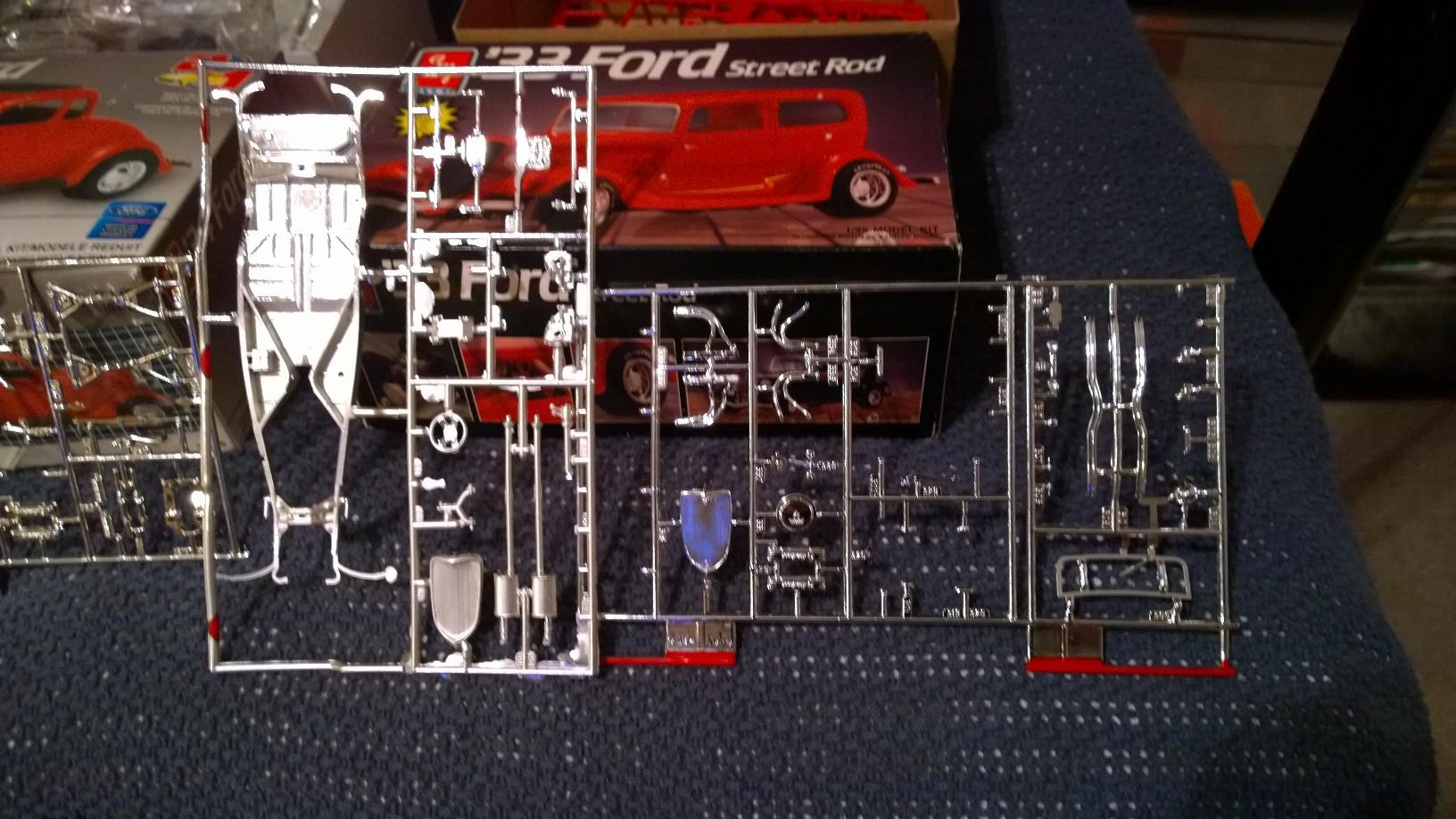

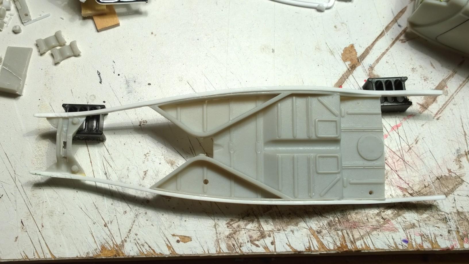

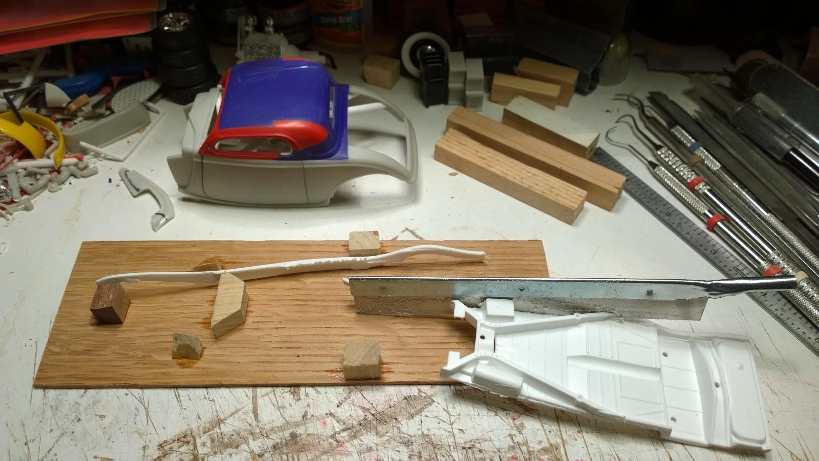

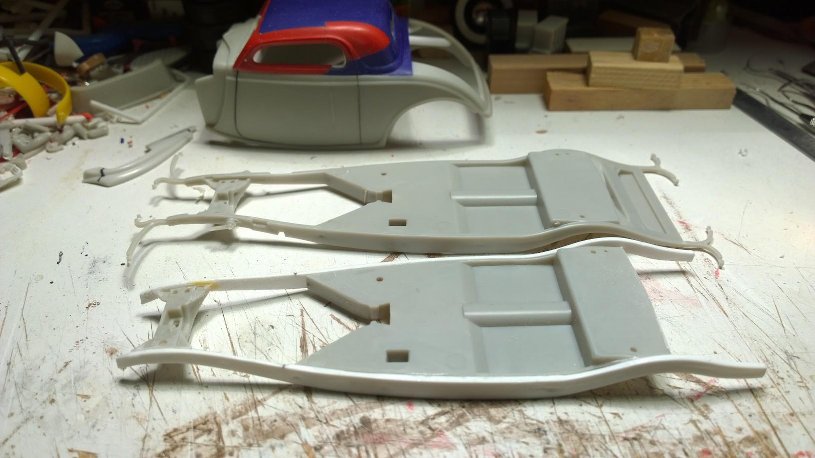

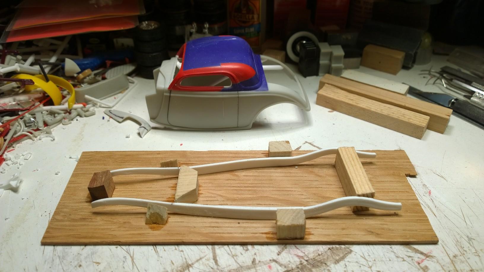

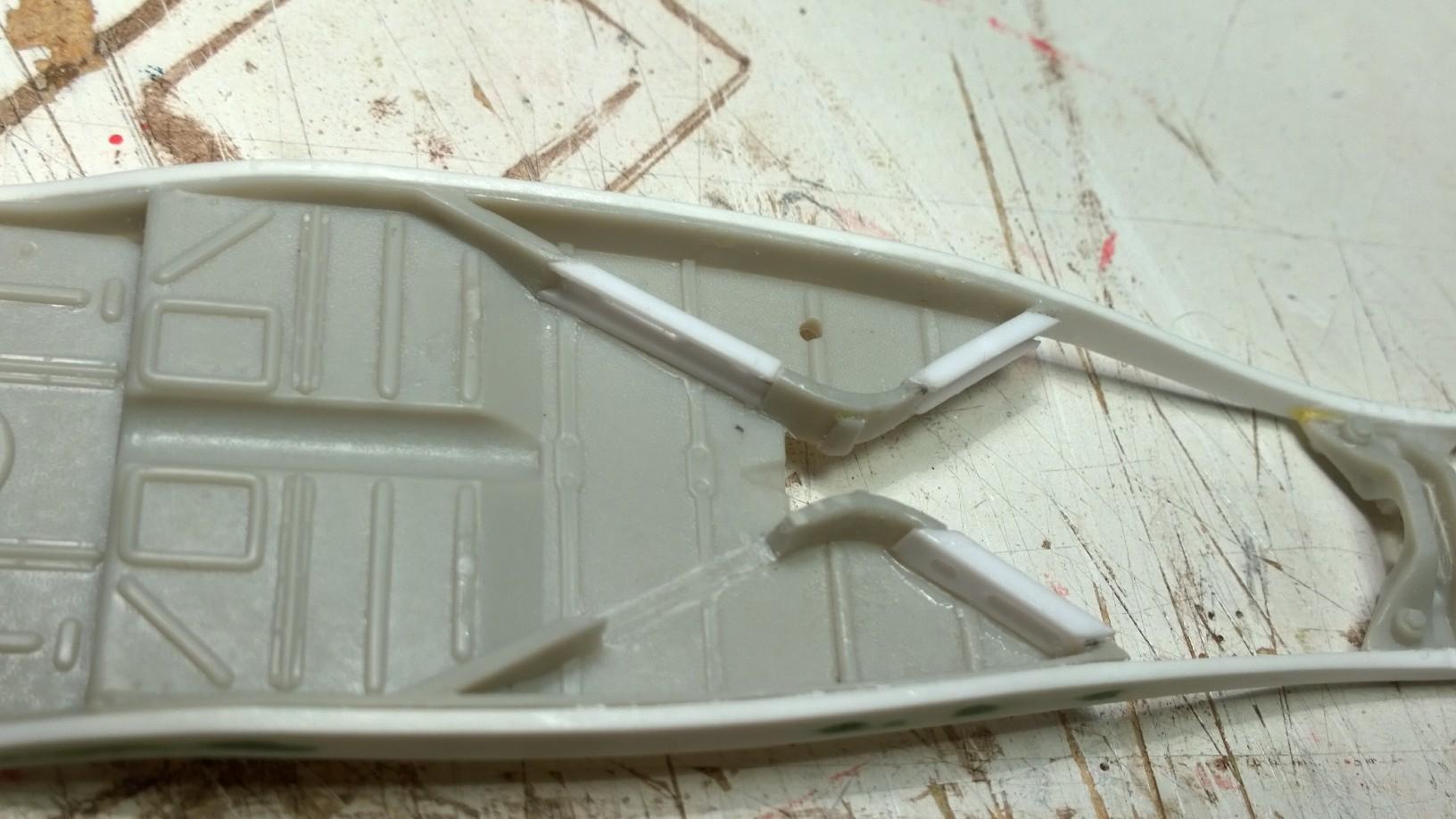

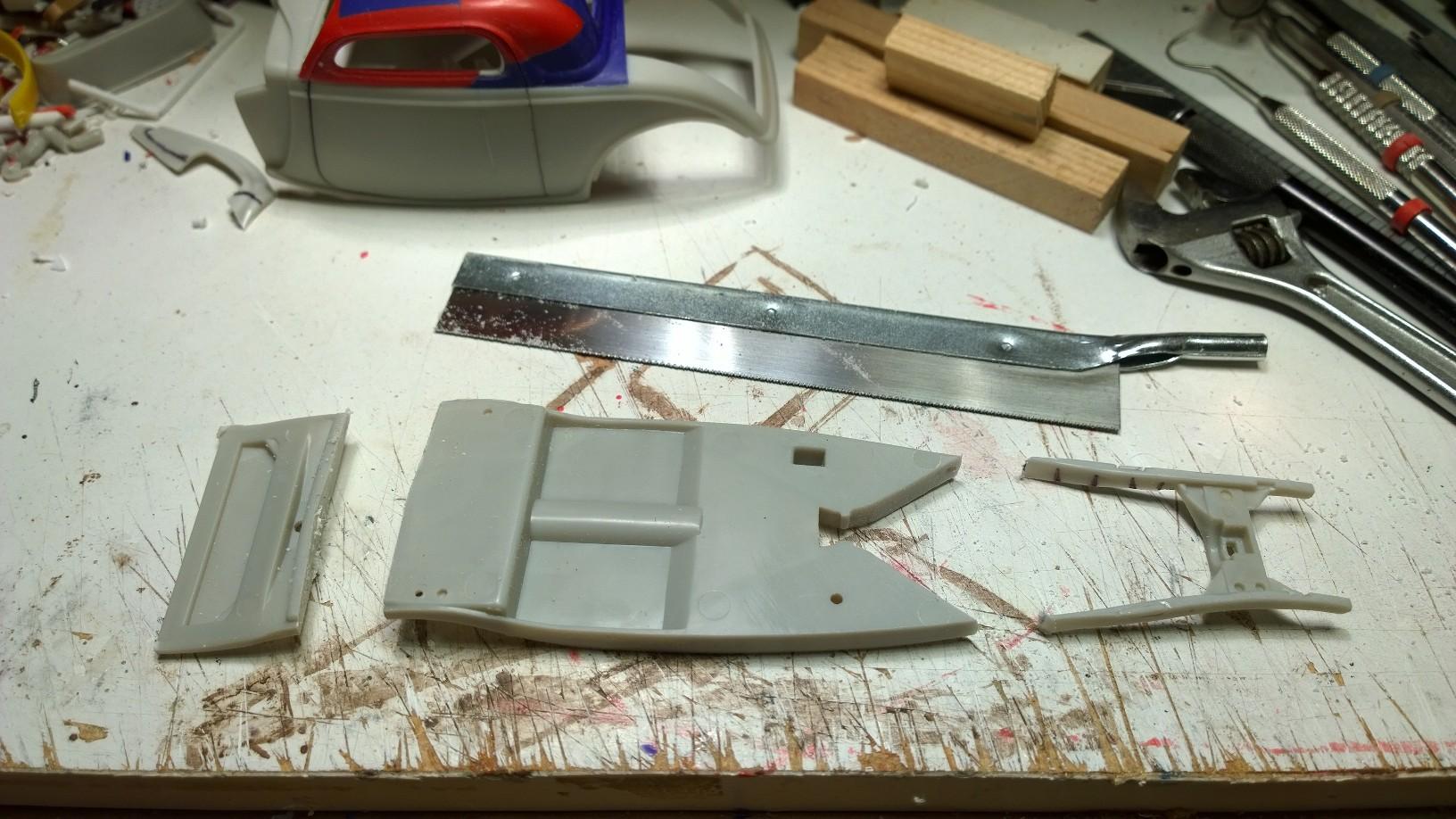

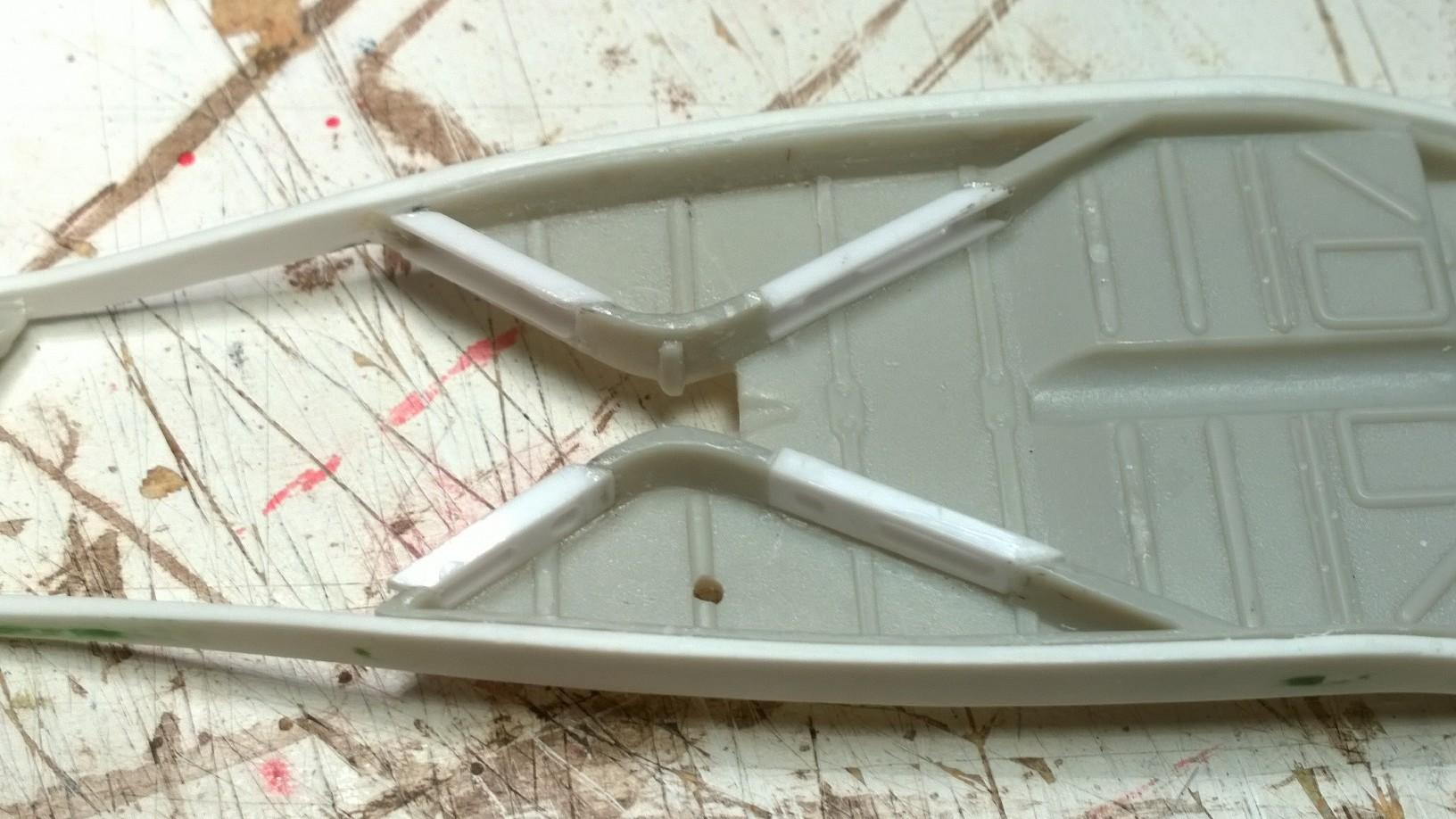

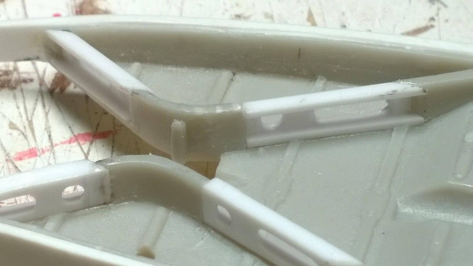

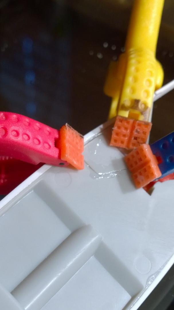

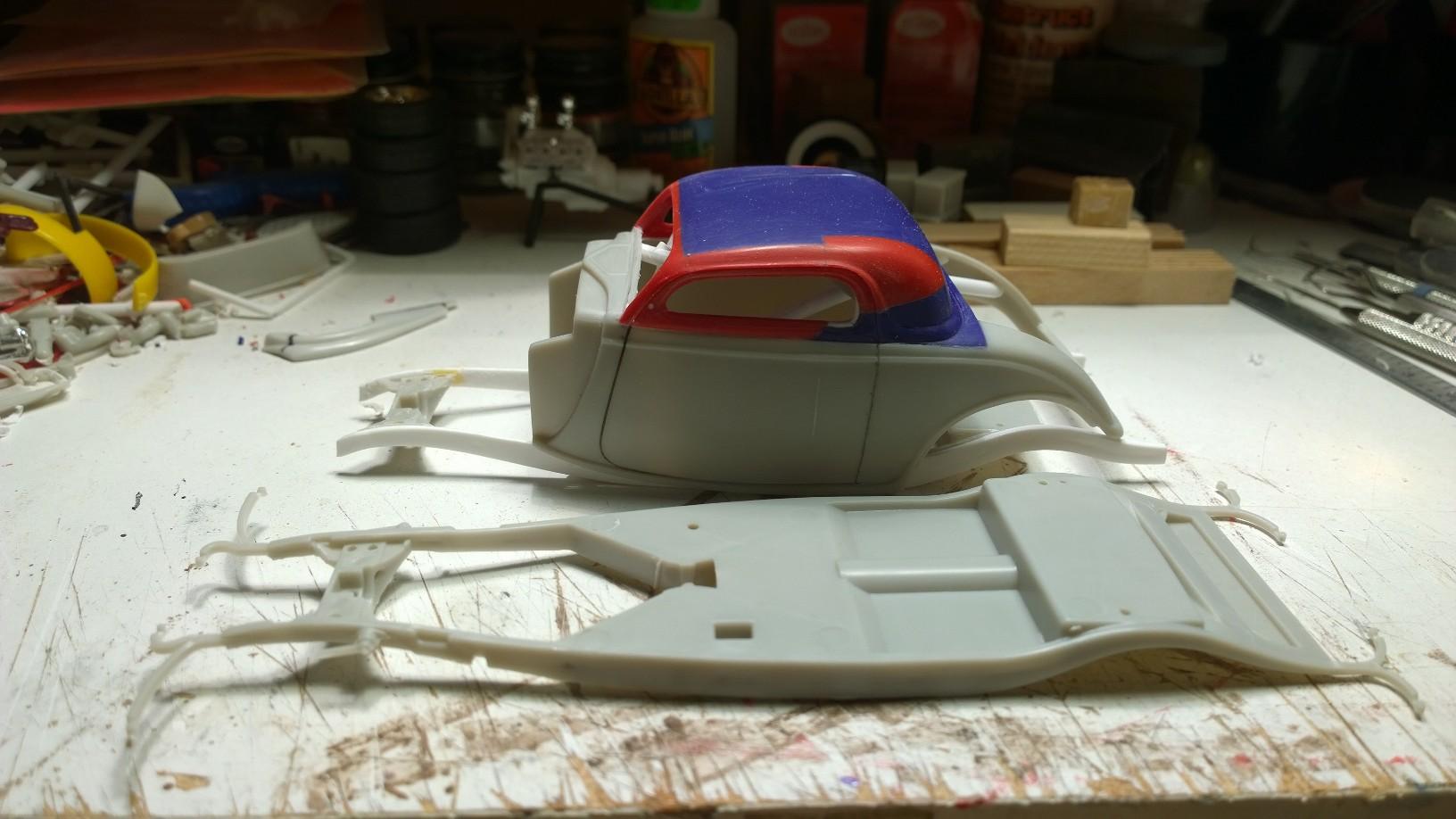

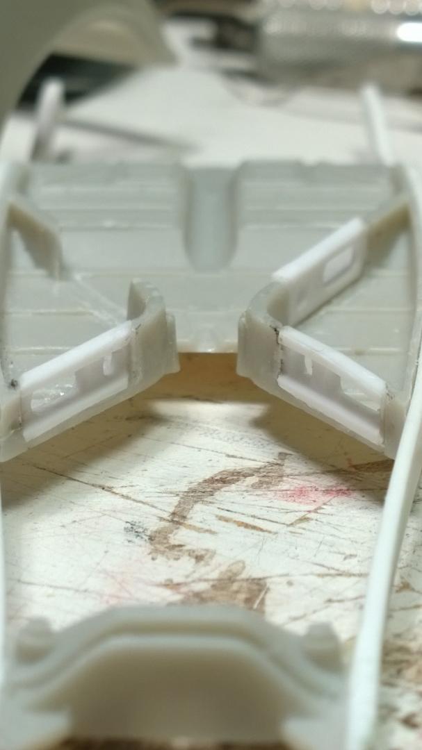

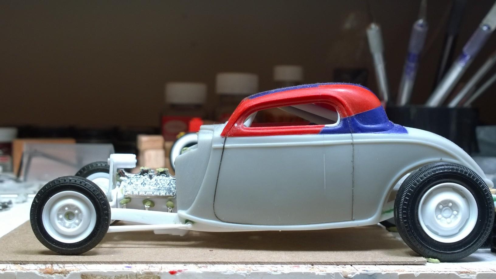

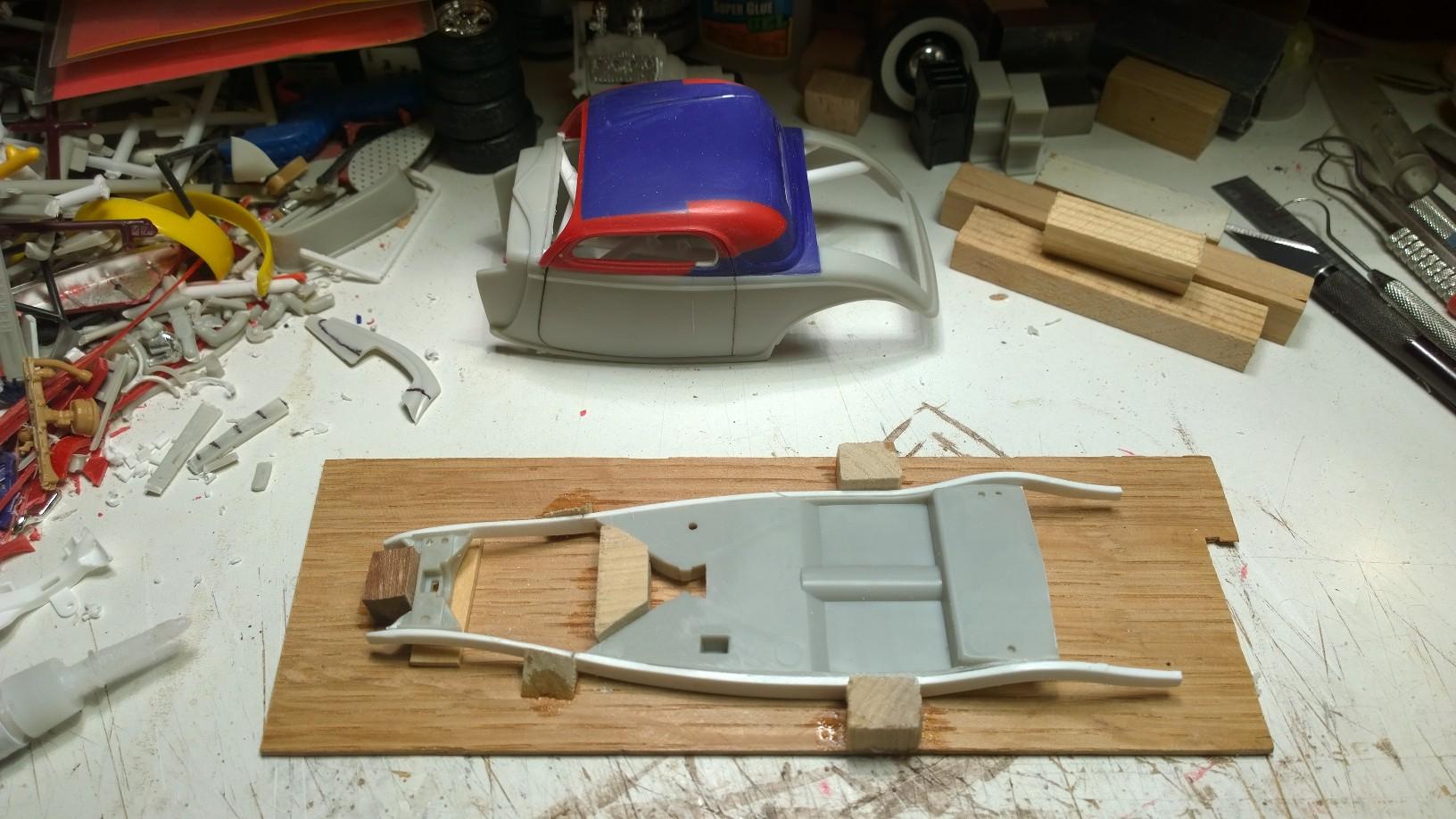

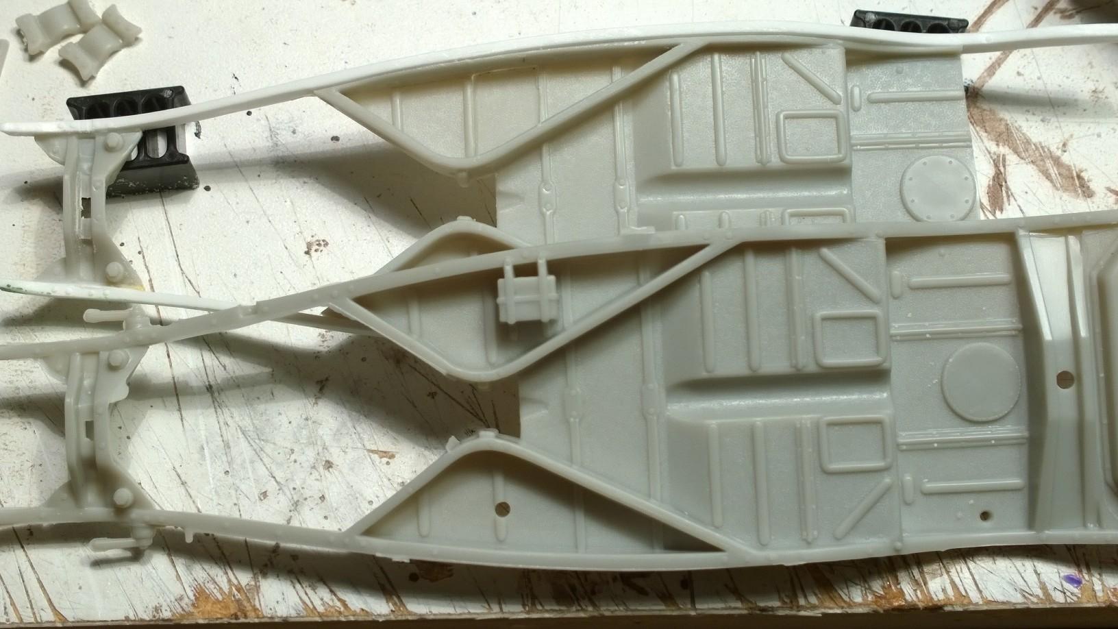

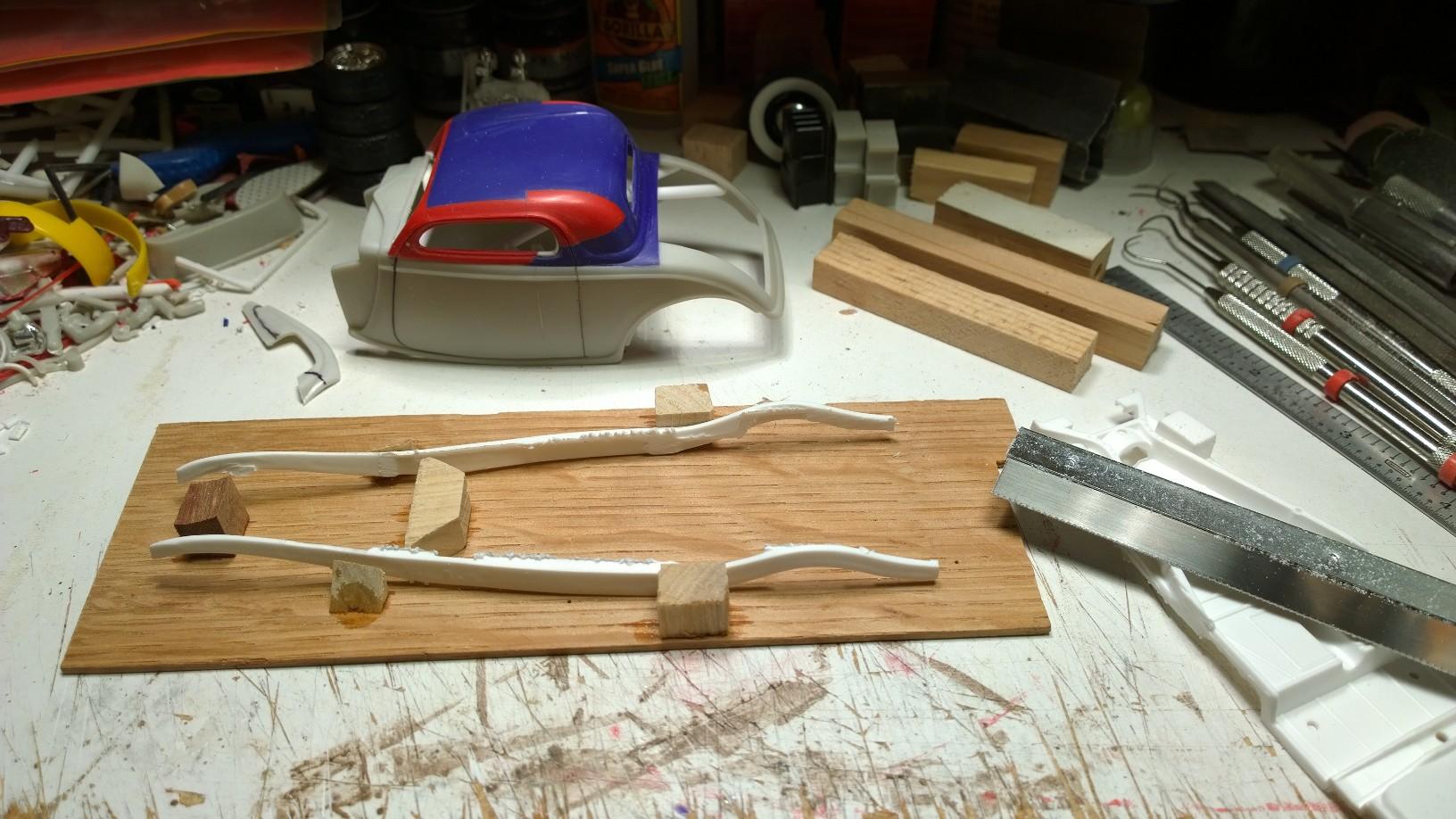

Kit Karson Posted March 3, 2017 Author Share Posted March 3, 2017 Thanks, guys! There's so much more to share with you on this build! Combining the AMT '34 5ive Window Coupe and '34-Monogram Chassis together was another major task in preparing the '33's stance. The Monogram '34 Chassis had more of a arch in the forward rails than the AMT's and offered a bit more frontend drop. Every inch counts! Then it was on to the '33 Coupe K-Member Mods by adding the Revell '40 Ford K-Member. And removing the stock battery box, too! Quote Link to comment Share on other sites More sharing options...
