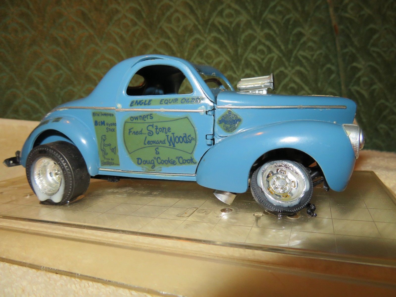

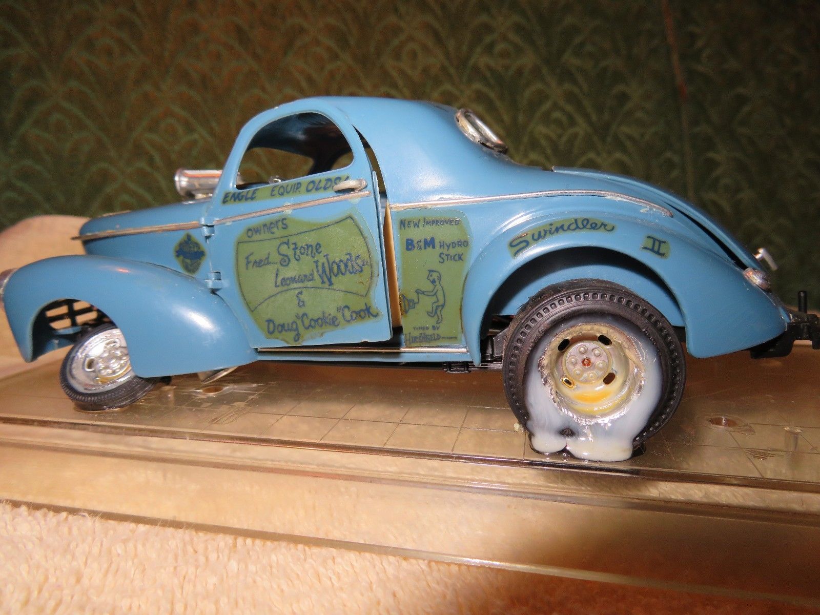

Tom Geiger Posted June 9, 2017 Posted June 9, 2017 I haven't seen any modern era tires (lets say 1990 to date) melt plastic. What I have seen is tire shrinkage. This is a Monogram 1959 Chevy convertible, built back when the kit was new. The tire is an old Surbanite snow tire from the 1980s. Note how it has shrunk on the rim. The tire on the front right has also shrunk so far as to pop off the rim. The tires on this car were all parts box pieces. Here's an ancient custom from my Olde Kustom Kollection. It was probably built in the early 1960s. See where the tire has caused a reaction with the top of the wheel well where it touches. The other side was worse. But somehow it didn't affect the rim!
John Goschke Posted June 9, 2017 Posted June 9, 2017 I haven't seen any modern era tires (lets say 1990 to date) melt plastic. What I have seen is tire shrinkage. This is a Monogram 1959 Chevy convertible, built back when the kit was new. The tire is an old Surbanite snow tire from the 1980s. Note how it has shrunk on the rim. The tire on the front right has also shrunk so far as to pop off the rim. The tires on this car were all parts box pieces. Here's an ancient custom from my Olde Kustom Kollection. It was probably built in the early 1960s. See where the tire has caused a reaction with the top of the wheel well where it touches. The other side was worse. But somehow it didn't affect the rim! Looks like that rim is white metal.
ZTony8 Posted February 4, 2018 Posted February 4, 2018 That S-W-C Willys looks like it was subject to very warm temperatures for a good while. Perhaps that exacerbated the melting problem?
1930fordpickup Posted February 4, 2018 Posted February 4, 2018 That is some major tire melt going on on that display base. I wonder if it was sitting in the sun while?

64Comet404 Posted February 4, 2018 Posted February 4, 2018 From my experience, the worst tire burn in more recent kits is from the BF Goodrich Radial TA tires in 1980's MPC kits. There is something in the chemistry that just loves to leave tire imprints right in the middle of the window glass. I have seen imprints from all manufacturers, but the old Revell kits from the 1960's seem to be the worst offenders (just like the S-W-C Willys posted above).
