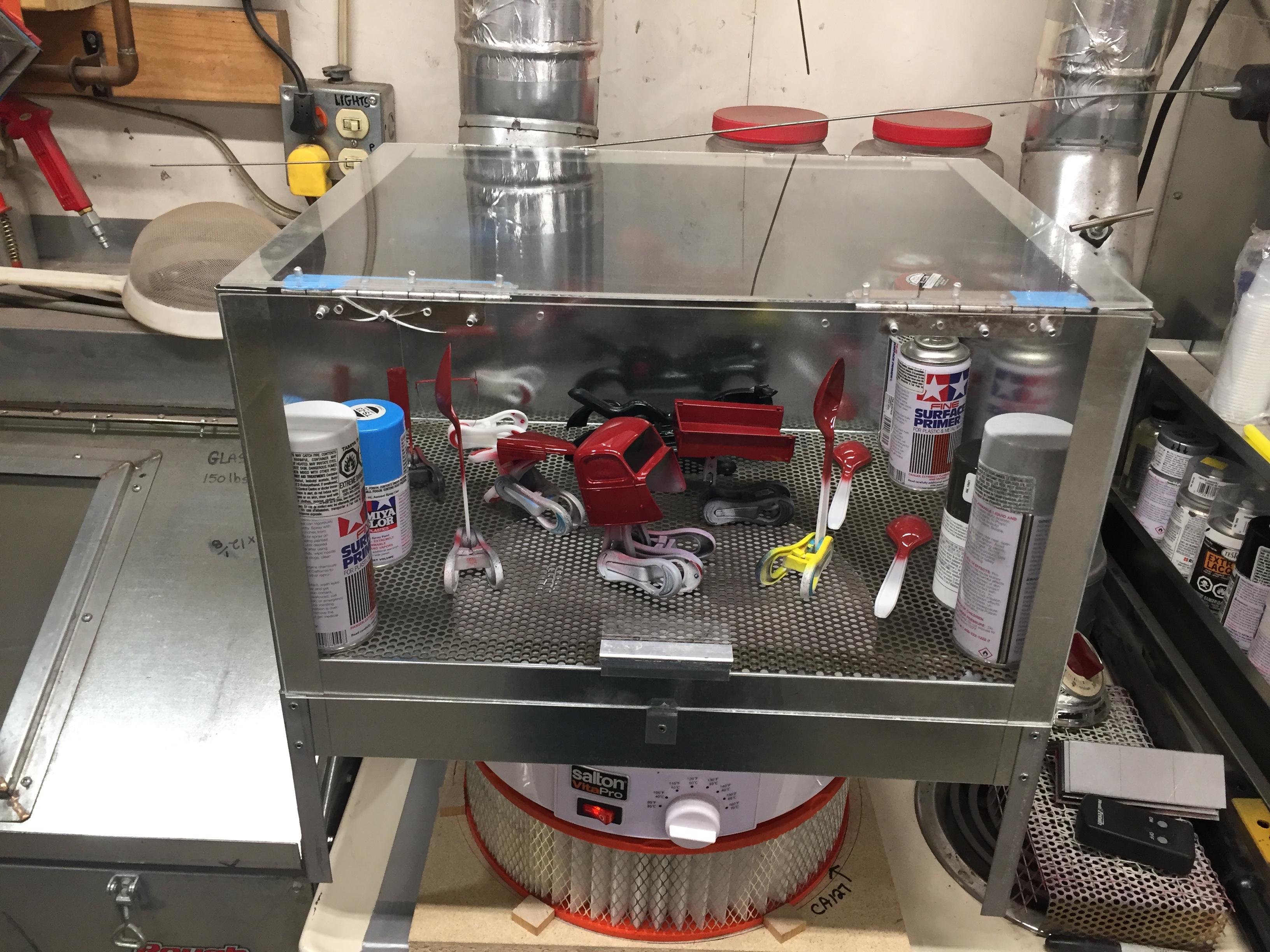

NOBLNG Posted October 26, 2019 Posted October 26, 2019 I had originally made the round extensions for my cheapo food dehydrator but found it awkward to reach down into, especially when placing a lot of parts inside. I was always worried that I would bump and smear my fresh paint job. So for the price of a box of donuts, I went to my old workplace and bent up this metal box. The plexiglass cover cost me $30 and then I went and cracked it with the first aluminum rivet (3/16 was too big, 1/8 was OK). I could have made the lid from metal or plywood but I like to watch my paint dry (it's not as boring as people claim). I have this in the garage where I create a lot of dust and smoke at times so I still want to wrap the bottom somehow with filter media to keep from sucking in contaminants.

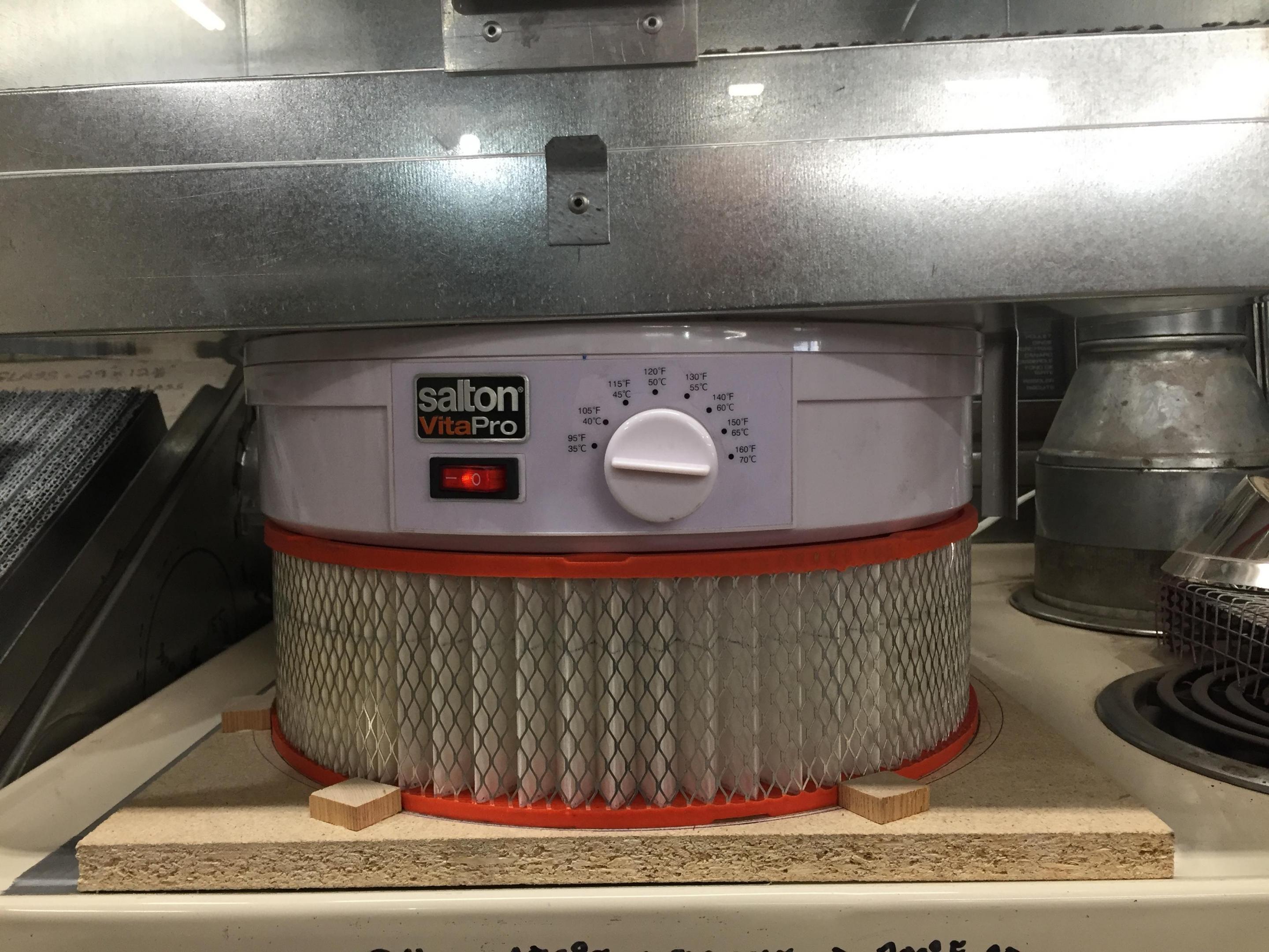

NOBLNG Posted February 24, 2020 Posted February 24, 2020 I do all my spray painting in the garage which is far from a dust free sanitary place. So I decided to add an air filter for my dehydrator. It turns out that one from a '75 Chrysler New Yorker is just the right size! I have kept an eye on it for a while to make sure the extra restriction will not cause overheating. It seems to be OK so far.
peteski Posted February 25, 2020 Posted February 25, 2020 That is a really nice paint drying setup! Does that dehydrator have a built-in fan to move the air, or just natural convection? I see that it has a thermostat, so there should be no problem with it overheating (the thermostat will shut off the heating element when the temperature goes above the set temperature).
NOBLNG Posted February 25, 2020 Posted February 25, 2020 15 minutes ago, peteski said: That is a really nice paint drying setup! Does that dehydrator have a built-in fan to move the air, or just natural convection? I see that it has a thermostat, so there should be no problem with it overheating (the thermostat will shut off the heating element when the temperature goes above the set temperature). Thanks! Yes it has a fan in it. It is a cheapo I bought on sale at Canadian Tire. It definitely doesn't move as much air as it did with no filter, but I guess if I had 6 trays stacked up and loaded with jerky...that would be a lot of restriction too.
peteski Posted February 25, 2020 Posted February 25, 2020 1 hour ago, NOBLNG said: Thanks! Yes it has a fan in it. It is a cheapo I bought on sale at Canadian Tire. It definitely doesn't move as much air as it did with no filter, but I guess if I had 6 trays stacked up and loaded with jerky...that would be a lot of restriction too. I use very cheap dehydrator (about 35 years old by now). It has no thermostat and no fan (air moved by natural convection). Temperature is controlled by adjusting the size of open slots in the lid. Works fine for me.
