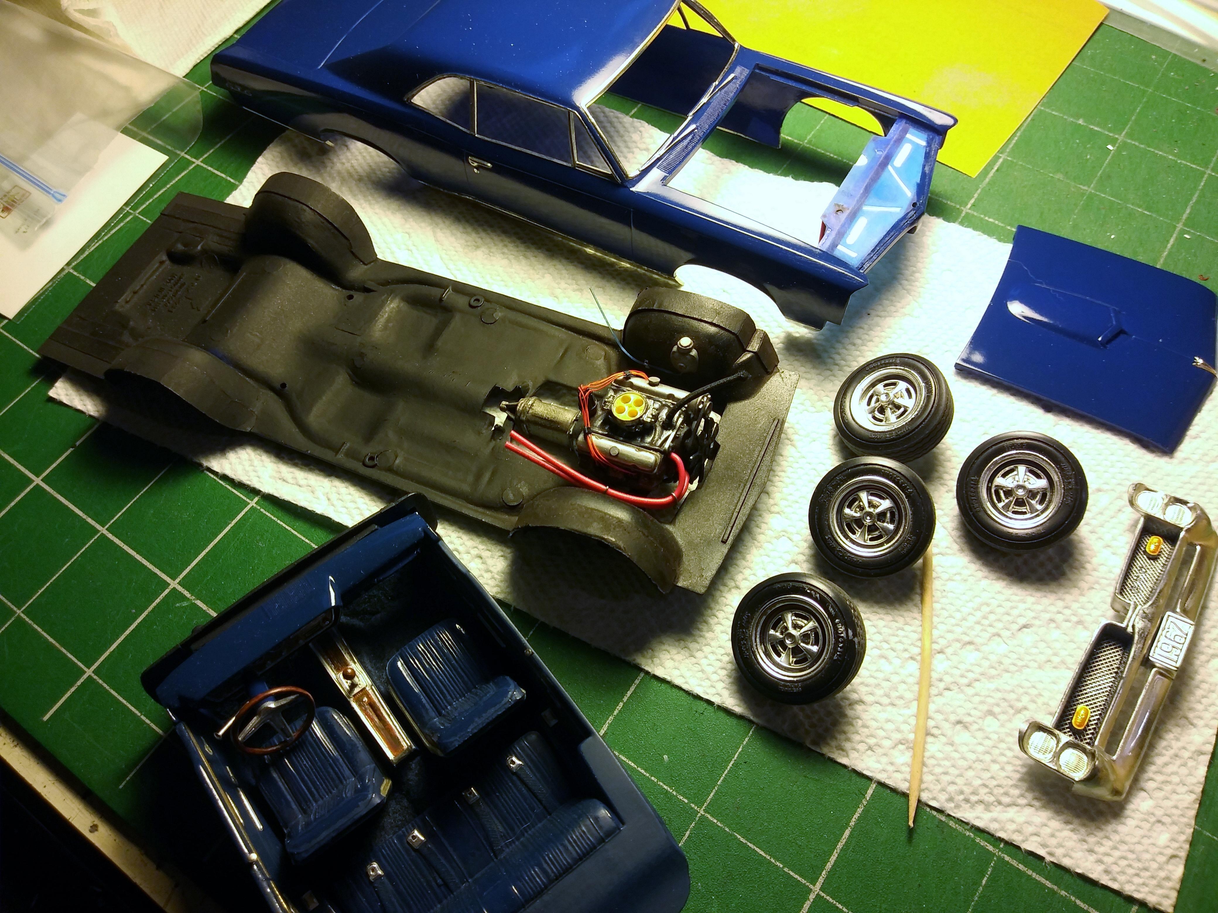

Snake45 Posted November 2, 2019 Author Posted November 2, 2019 On 10/31/2019 at 7:07 PM, Misha said: "Oh boy! Tom has an update on his project" I thought seeing the thread at the top of the list! Yet, that is our biggest issue, diversions. I haven't touched my Inca Gold Shoebox, yet it is on the workbench next to the latest diversion, the 62 Plymouth Savoy 413 Max Wedge. I will get to it this weekend with an update. Wishing all the others all the best, cheers Misha Y'all shamed me into getting back into my Monogram '66 Chevelle. Last night I got almost half the body wet-sanded. That done, the polishing should be easy, and then on to building the chassis and engine.

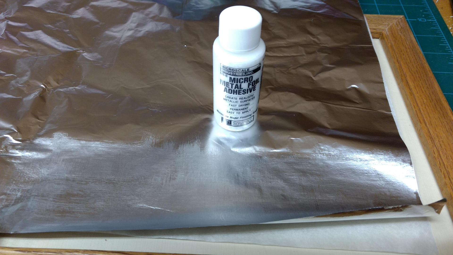

Modlbldr Posted November 9, 2019 Posted November 9, 2019 Tonight I'm making my own BMF for my projects. I should have enough foil.... Later-
Snake45 Posted November 9, 2019 Author Posted November 9, 2019 1 hour ago, Modlbldr said: Tonight I'm making my own BMF for my projects. I should have enough foil.... Later- I do that alla time. I find it's helpful to scratch up the back of the foil with a Scotchbrite pad--makes the MMFA flow out better and not bead up and leave dry spots.

OldNYJim Posted November 15, 2019 Posted November 15, 2019 On 11/8/2019 at 9:26 PM, Modlbldr said: Tonight I'm making my own BMF for my projects. I should have enough foil.... Later- That’s really interesting - what kind of foil is that?

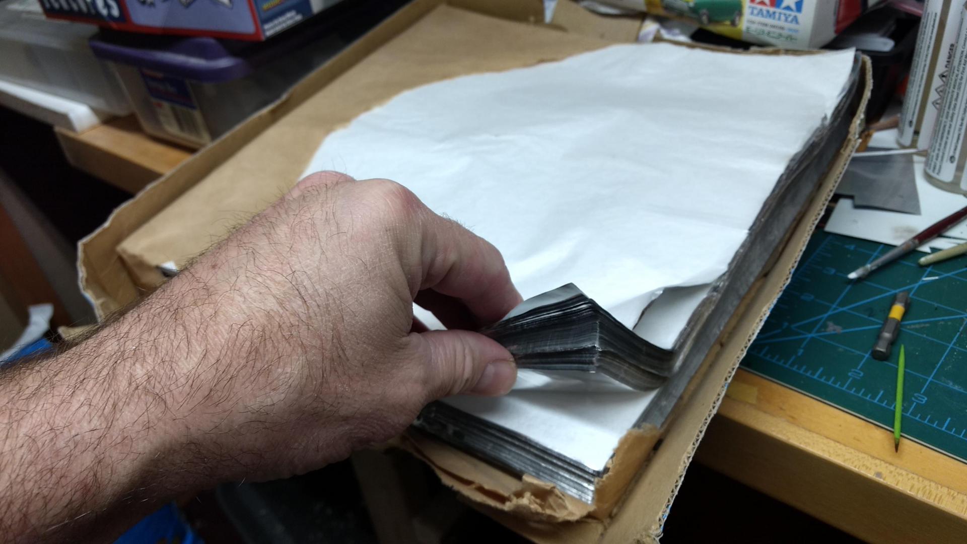

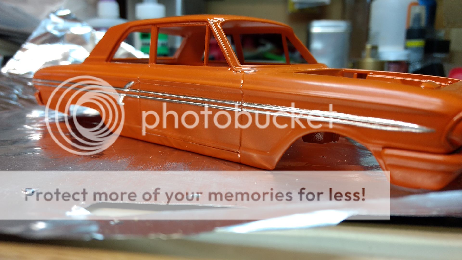

Modlbldr Posted November 16, 2019 Posted November 16, 2019 2 hours ago, CabDriver said: That’s really interesting - what kind of foil is that? CabDriver- It is a very thin foil that is used in commercial cooking. A buddy of mine works in a restaurant and they use it for wrapping potatoes to bake. He gave me the whole box probably 10 years ago and it has, what I would guess, is a thousand sheets, each divided by a thin sheet of paper. Tonight I started my foiling. Drinking a scotch ale, listening to Lucero and fighting this foil job. http:// Later-
Snake45 Posted November 16, 2019 Author Posted November 16, 2019 3 hours ago, CabDriver said: That’s really interesting - what kind of foil is that? I bought something similar--smaller sheets, smaller package--at Michael's not long ago, in the candy-wrapping section. But there's nothing particularly special about it. It seems to be identical to cheap, generic kitchen foil on a roll you can buy at any Walmart or supermarket.

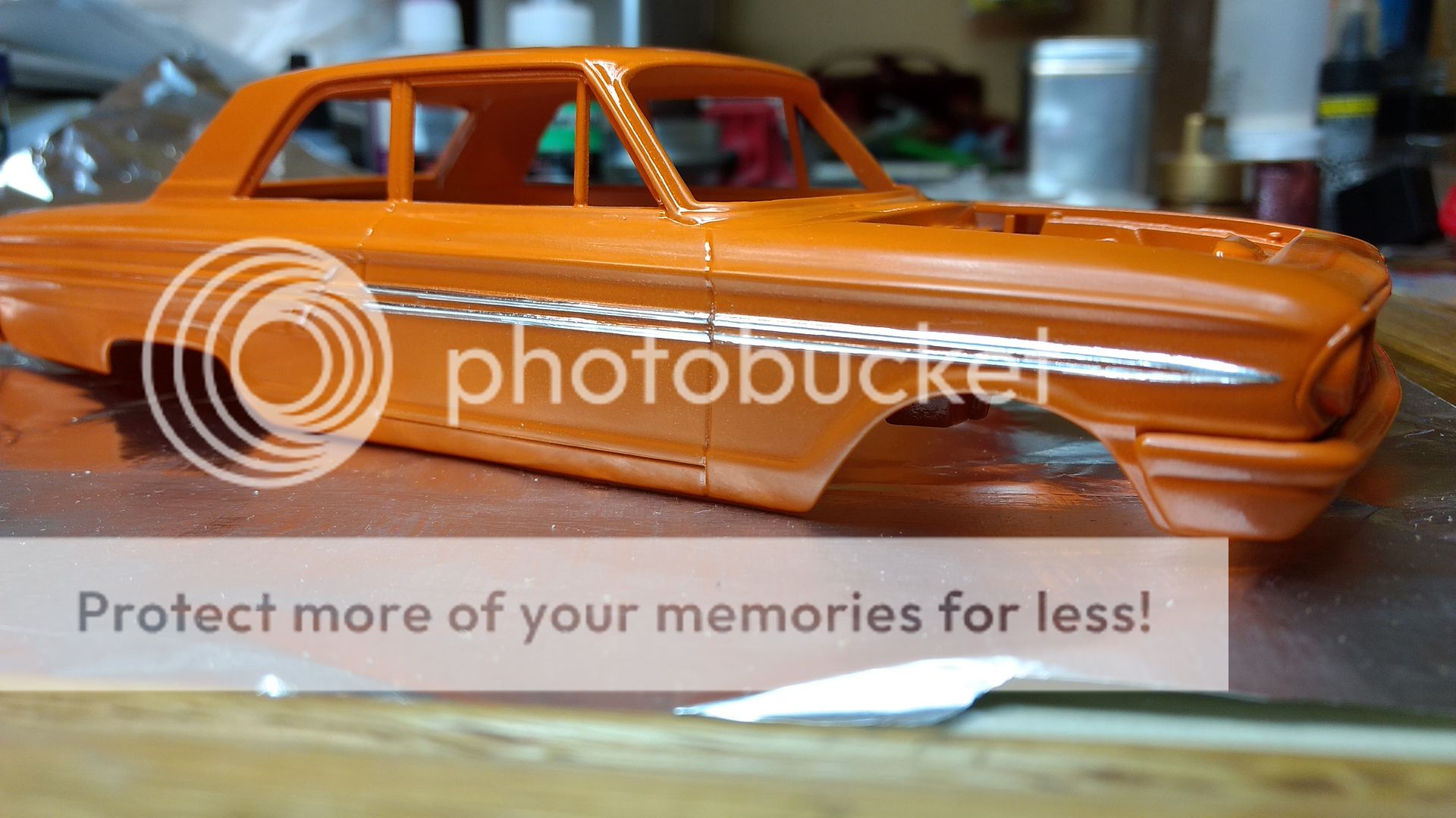

Modlbldr Posted November 16, 2019 Posted November 16, 2019 Got one side done. Time to keep.moving forward. If I'm correct, I have managed to get 5 projects completed so far this year. If like to make it seven. Later- http://
OldNYJim Posted November 16, 2019 Posted November 16, 2019 10 hours ago, Modlbldr said: CabDriver- It is a very thin foil that is used in commercial cooking. A buddy of mine works in a restaurant and they use it for wrapping potatoes to bake. He gave me the whole box probably 10 years ago and it has, what I would guess, is a thousand sheets, each divided by a thin sheet of paper. Tonight I started my foiling. Drinking a scotch ale, listening to Lucero and fighting this foil job. http:// Later- That’s really interesting!! I’ve never even heard of such a thing - thanks for the info! How does it compare to BMF? Does it work as well?
Modlbldr Posted November 16, 2019 Posted November 16, 2019 54 minutes ago, CabDriver said: That’s really interesting!! I’ve never even heard of such a thing - thanks for the info! How does it compare to BMF? Does it work as well? It is extremely thin, like BMF and once the glue sets it works just the same. I really can't tell any difference. Later-
