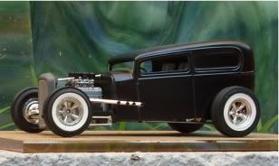

Daddyfink Posted November 27, 2018 Posted November 27, 2018 Strangely enough, this is still my favorite version

Ace-Garageguy Posted November 27, 2018 Posted November 27, 2018 Bear in mind that if you want an accurate '32 Ford, this ain't it. Besides having a frame that looks nothing like a real '32, the cowl side is also too short (in height), falling somewhere between the old AMT severely sectioned version, and Revell's series of '32s which are reasonably close to correct. NOTE: I'm NOT bashing the kit. I like it. It builds up into a really good looking model with some effort. The Switcher bodies aren't a bad fit on Revell's '32 underpinnings either, so there's a lot of potential here.

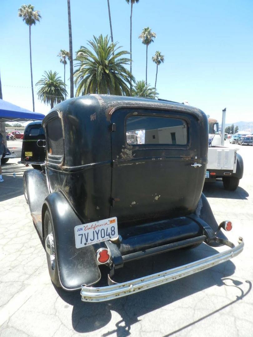

Phildaupho Posted November 27, 2018 Posted November 27, 2018 This is how the MPC body with trimmed rear fender openings fits on the Revell fenders and frame. Some trimming below rear door will be required to get the body to mate the rear fenders properly. To be more accurate the rear door needs rounded top corners and a cowl vent needs to be added.

mk11 Posted November 27, 2018 Posted November 27, 2018 (edited) 2 hours ago, Phildaupho said: To be more accurate the rear door needs rounded top corners and a cowl vent needs to be added. contrast of mpc tudor/sd, amt tudor and revell tudor bodies great reference pics on the hamb... https://www.jalopyjournal.com/forum/threads/the-new-1932-ford-sedan-delivery-thread.850255/ mike Edited November 27, 2018 by mk11
