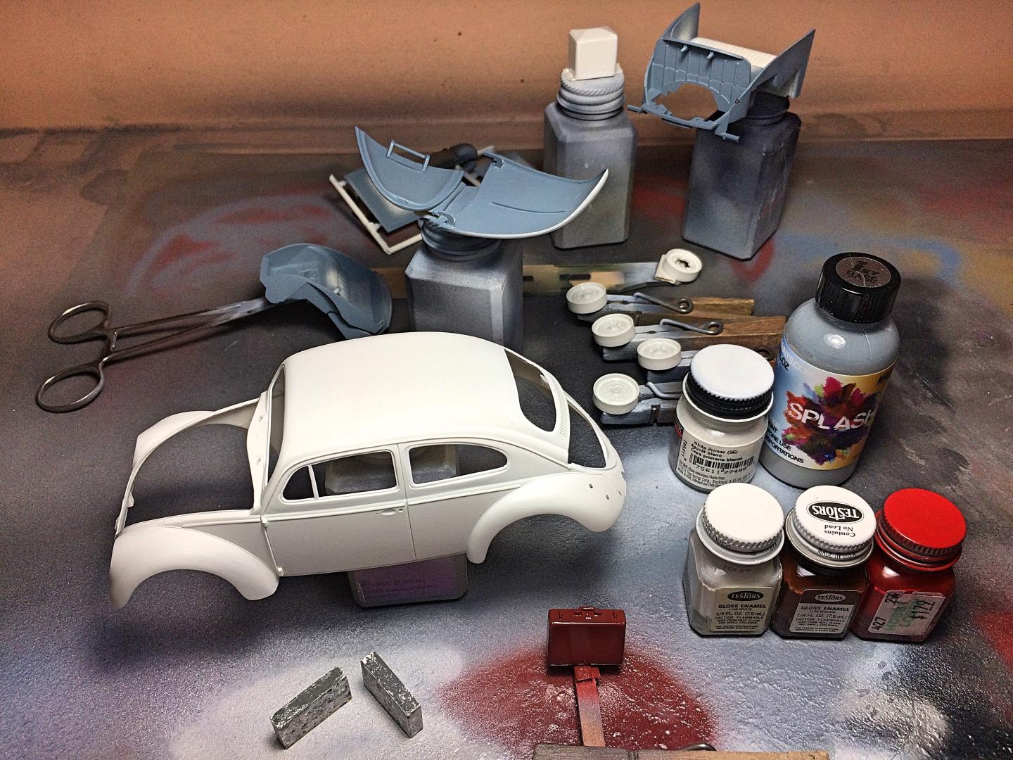

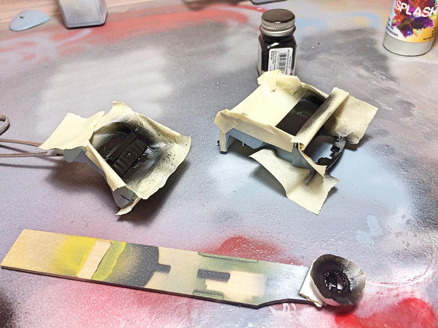

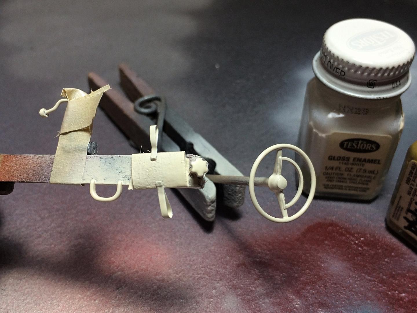

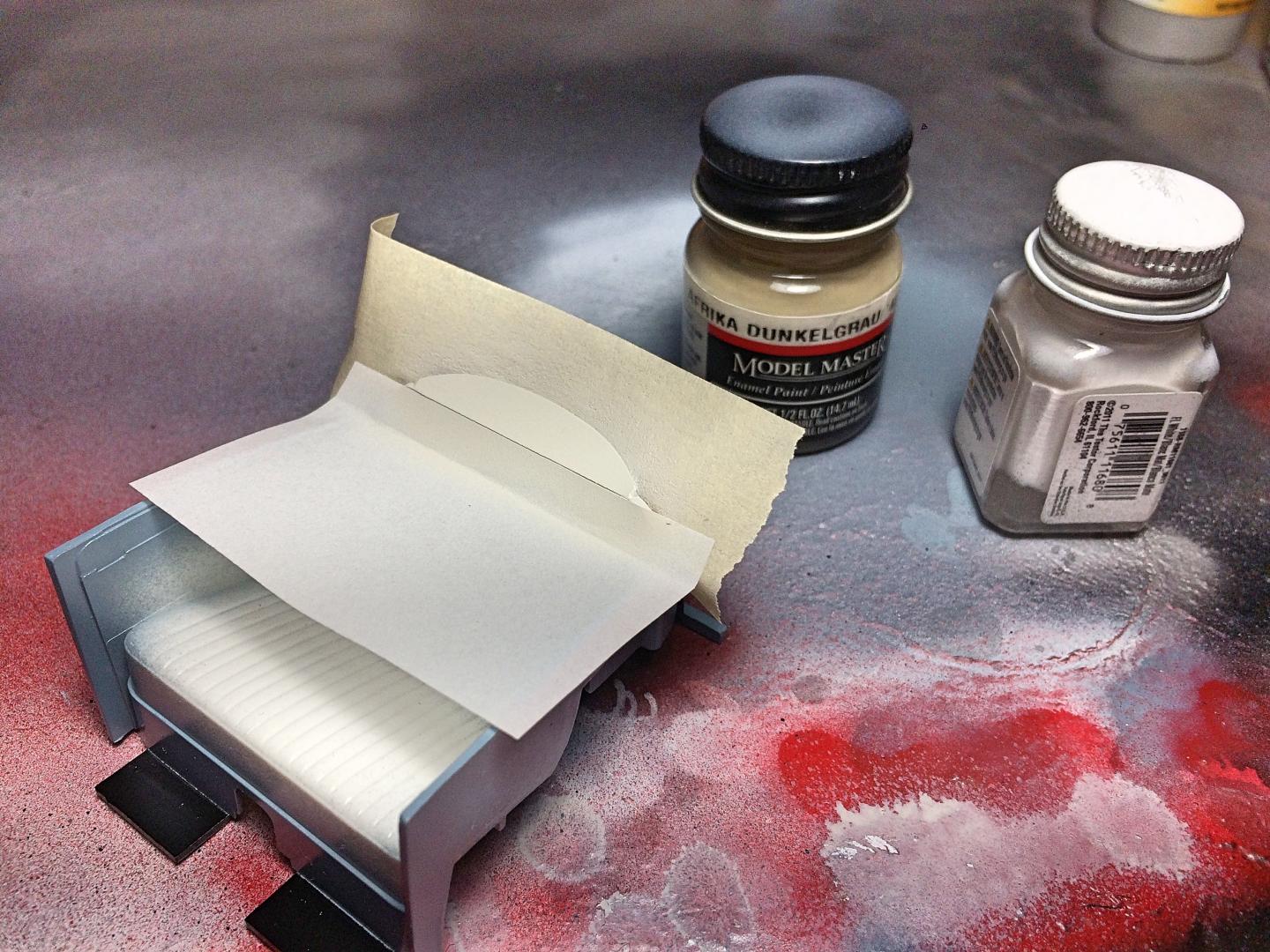

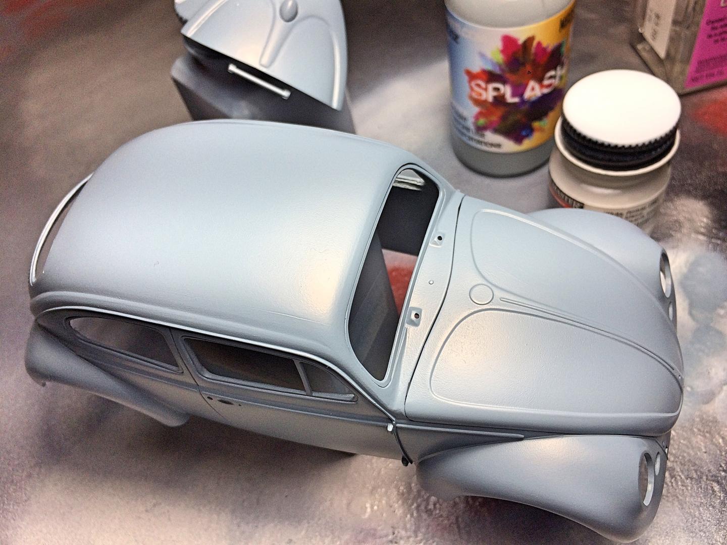

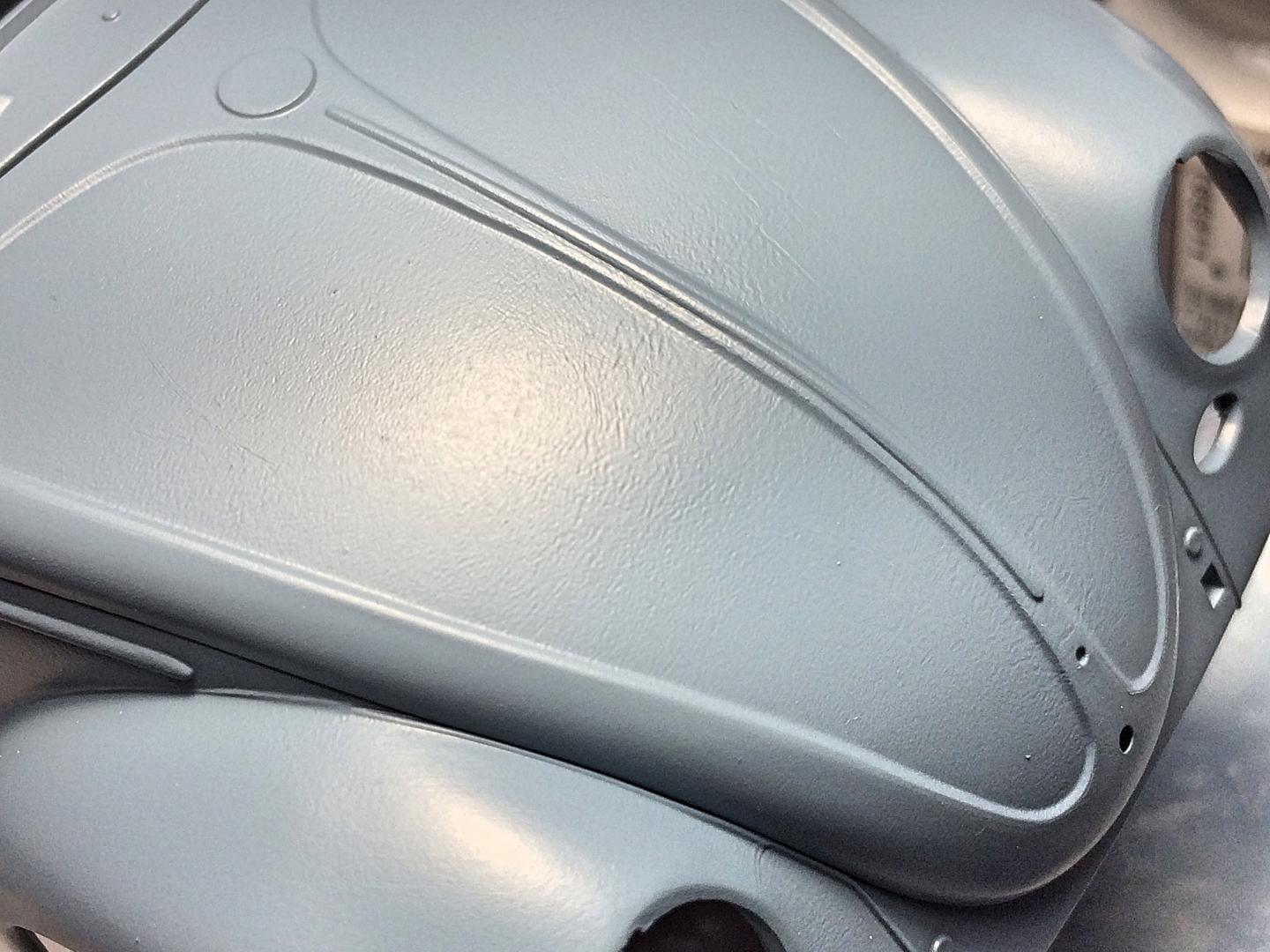

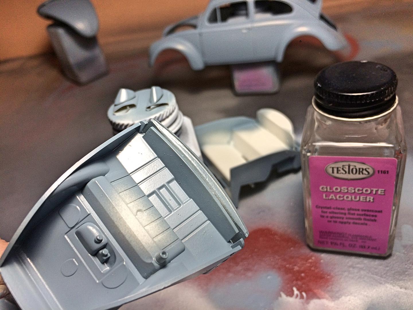

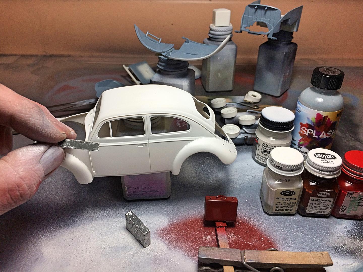

I'm using Testors white primer.  Then I'm using Splash paint for the first time.  I made tiny sanding blocks from Corian scrap, superglued two grits of sandpaper, and managed to get one side about perfect.  I mixed paint in the cup for the Samsonite suitcase, so at least I'll have a killer suitcase from this project.
I tested the Testors Glosscoat on the blue paint next to the parts, did not craze.  I'm doing several steps, painting the underside first.  So the first pass with the gloss seemed to work.  I hate the dust specks, but I was planning to stuff with gear which should hide it.

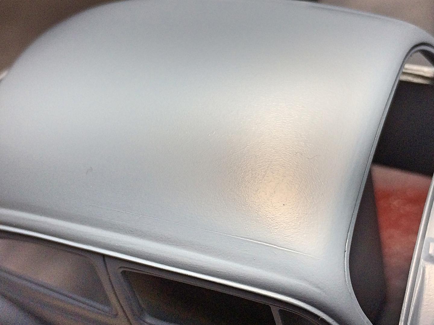

I then sprayed the Splash on the top side.  I did several passes, last one with a higher paint volume.  Then disaster, it seemed to have reacted with the primer, and for some reason where the mold lines on the roof were sanded off, it really did something weird!
At least the suitcase looks good.  ^_^
I have had that happen and think it's the heavy paint coat that makes the primer react like yours did.
I would let it dry & then sand away all the imperfections. Might have to prime again to see if the mold lines have gone away.

I didn't have the problem with lighter coats.  So lots of wet sanding is due!  My dad preferred downhill.

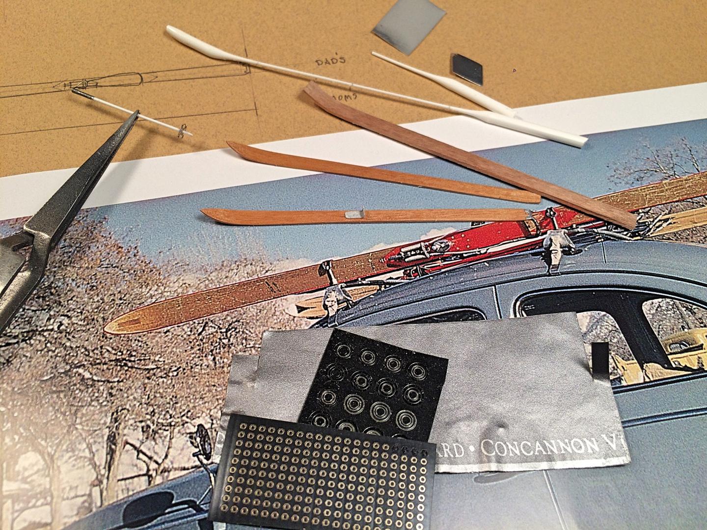

In the meantime, I started on the ski poles.

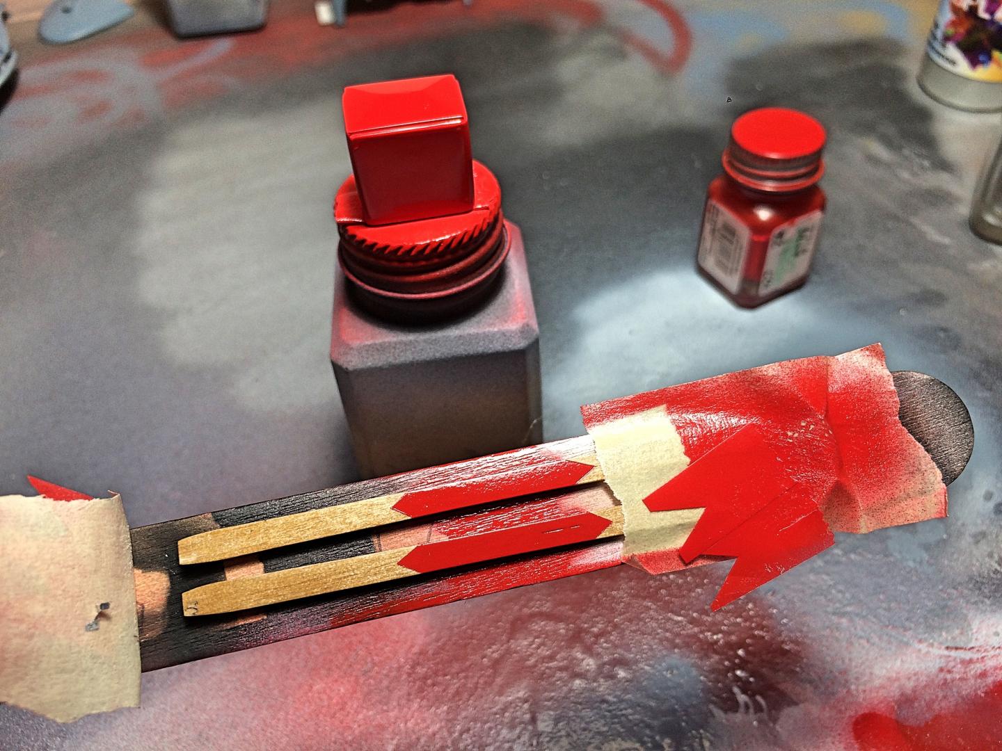

Painted the Coke cooler, and the one pair of skis has red.

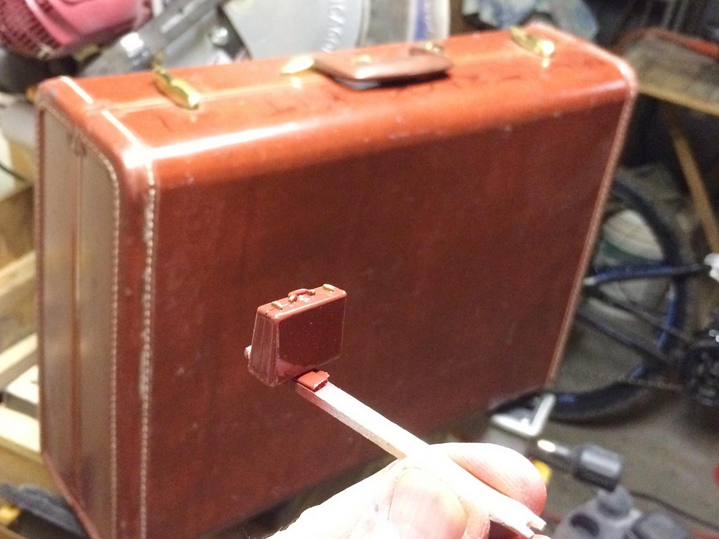

The Samsonite suitcase is done!

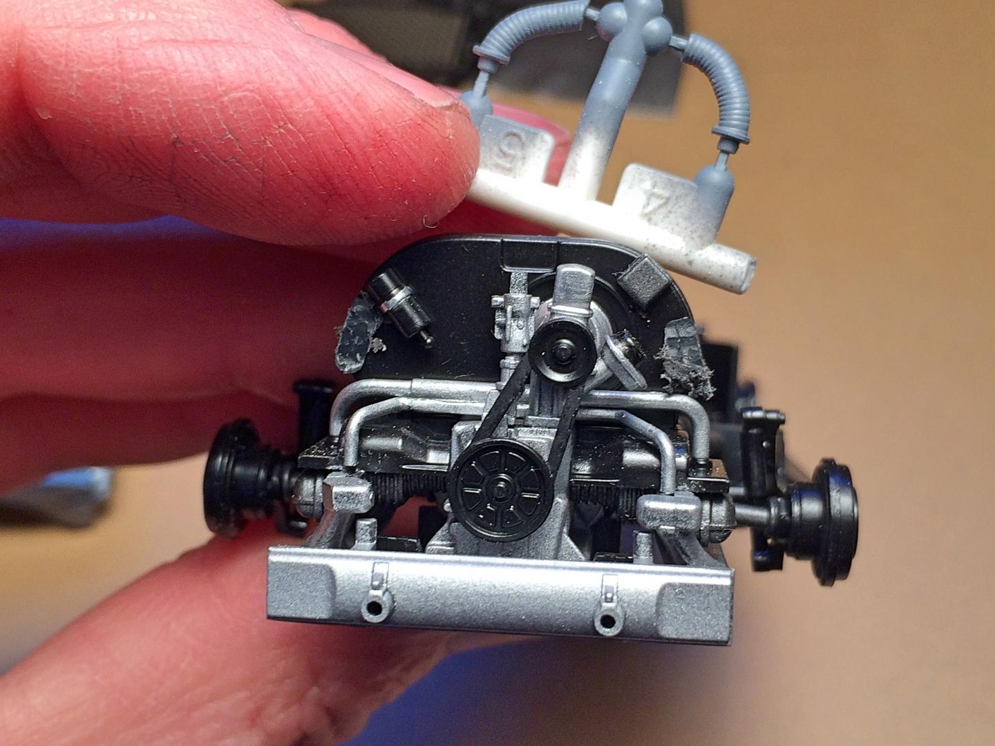

I *had to* modify the engine fan shroud, wish it wasn't assembled.  So now it's a "stale air" version.  This is after I ruined it with the Dremel.

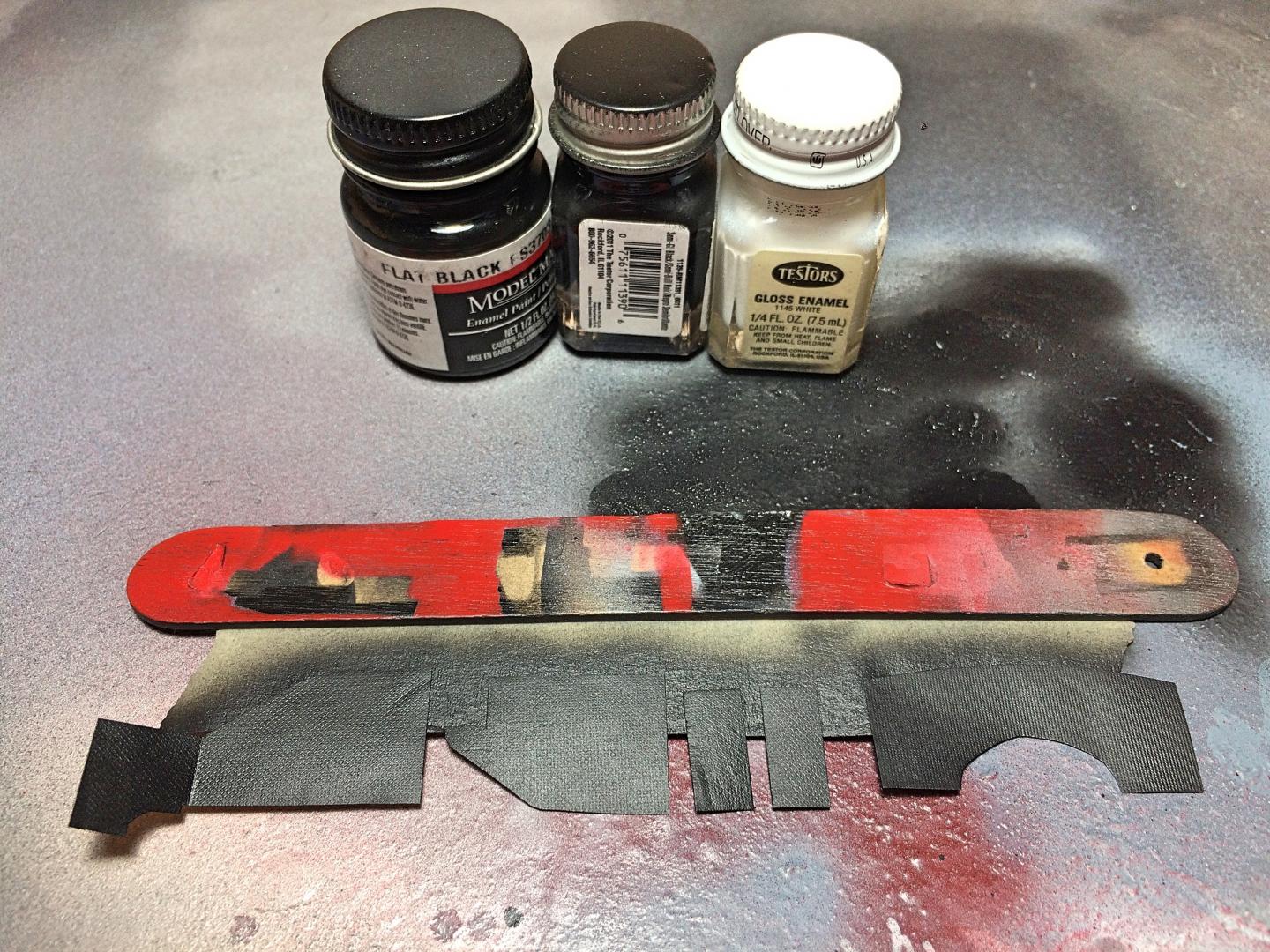

Did I say I hate brush painting?
Semi-gloss black.

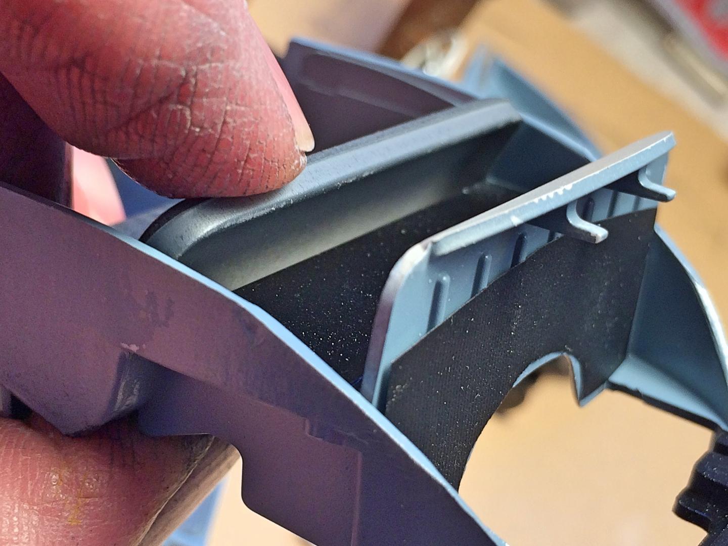

That itty bitty panel, masked with velum so the fresh black would not get tape wrecked.

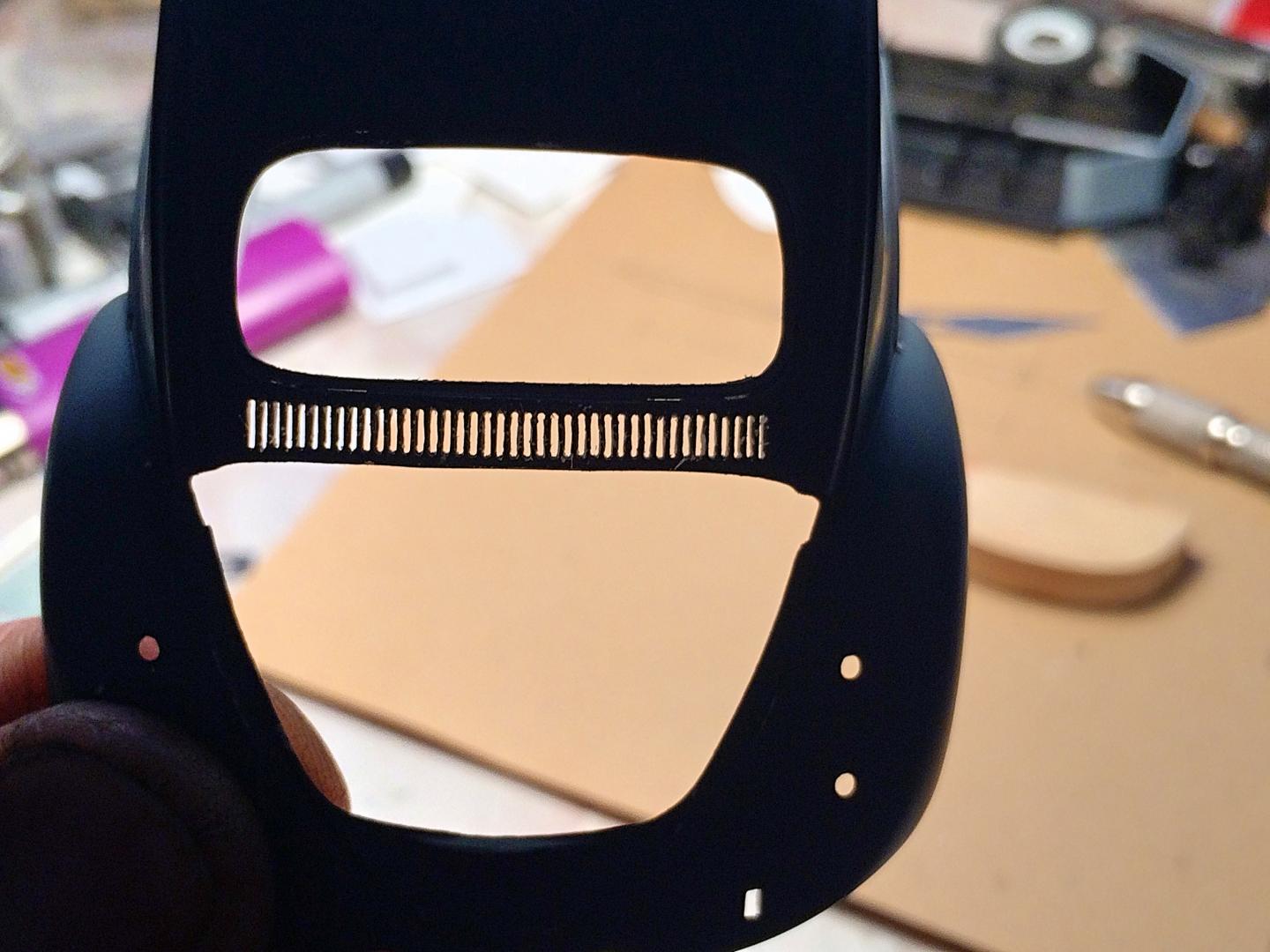

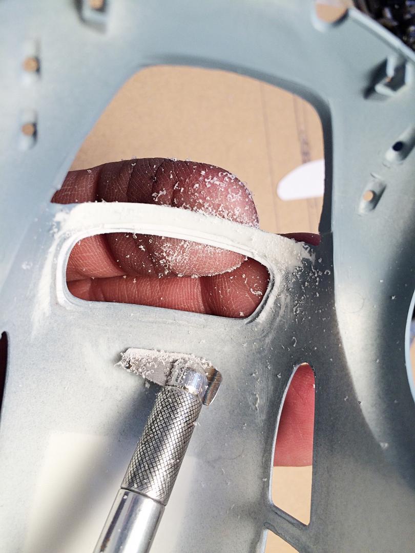

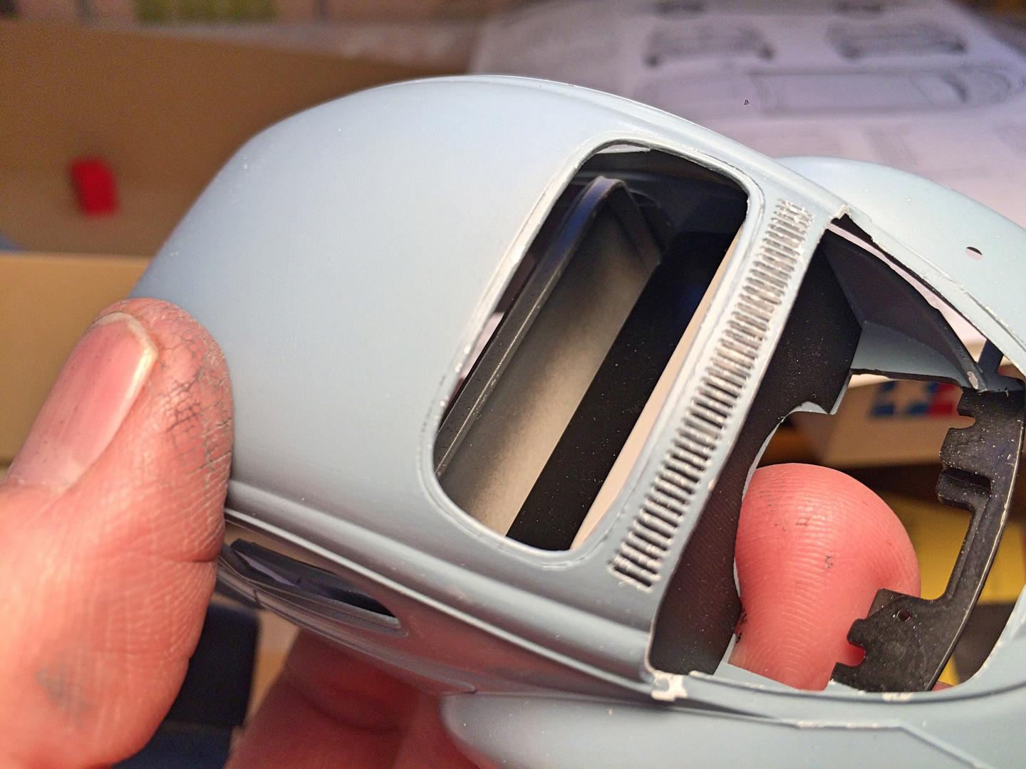

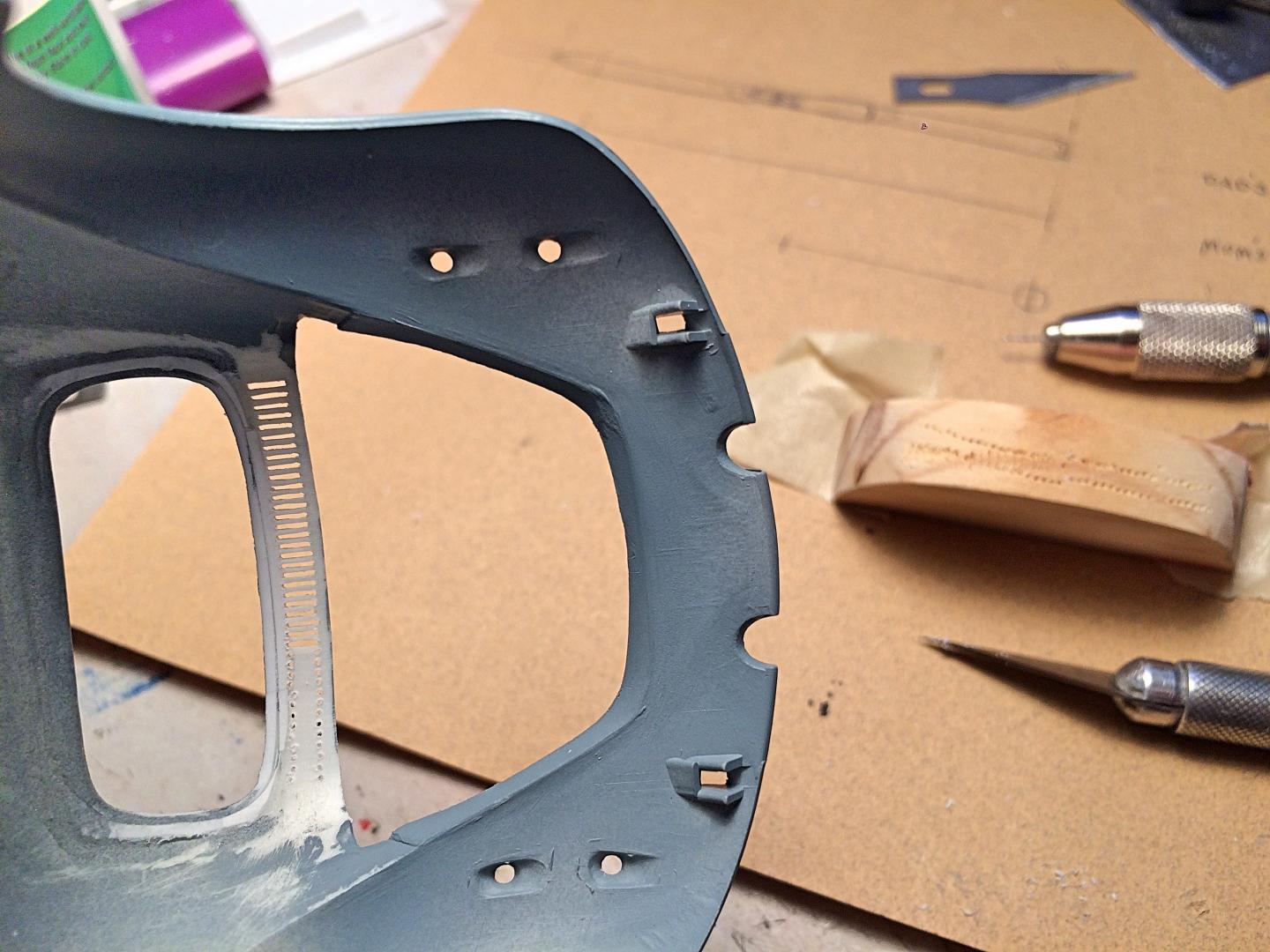

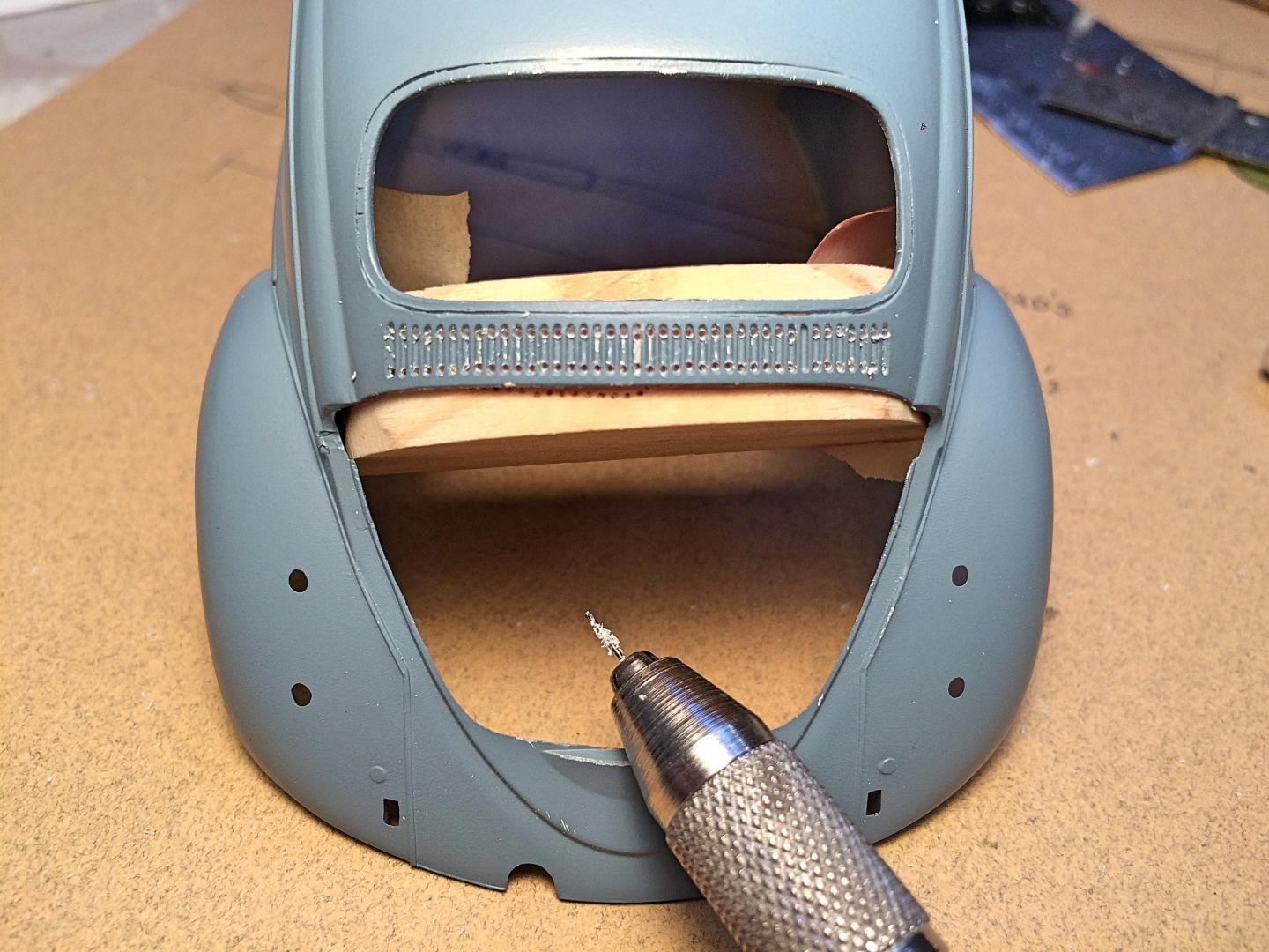

Now for my crazy moment, it's something that bugs me on most models, the grills *need to* be opened up, because again, I hate brush painting flat black in the recesses.  :rolleyes:  I started out with the Dremel, but did not get far, then a sanding stick.  Then I took an old #11 blade to the bench grinder, and then scraped dow until I could just see the slots.  I had beefed up this area when I modified the window, highly recommend if you do this.
Then I drilled each end of the 40 slots.  I made a wood block to support, using the bench disk sander to conform to the body.
I dragged through each slot to get a little deeper.  Then I put in a new #11 blade, and cut through, then flipped over and carved out each slot.
I'll go over this one more time, after my eyes reset.  It's an air-cooled engine, gotta have open slots man!

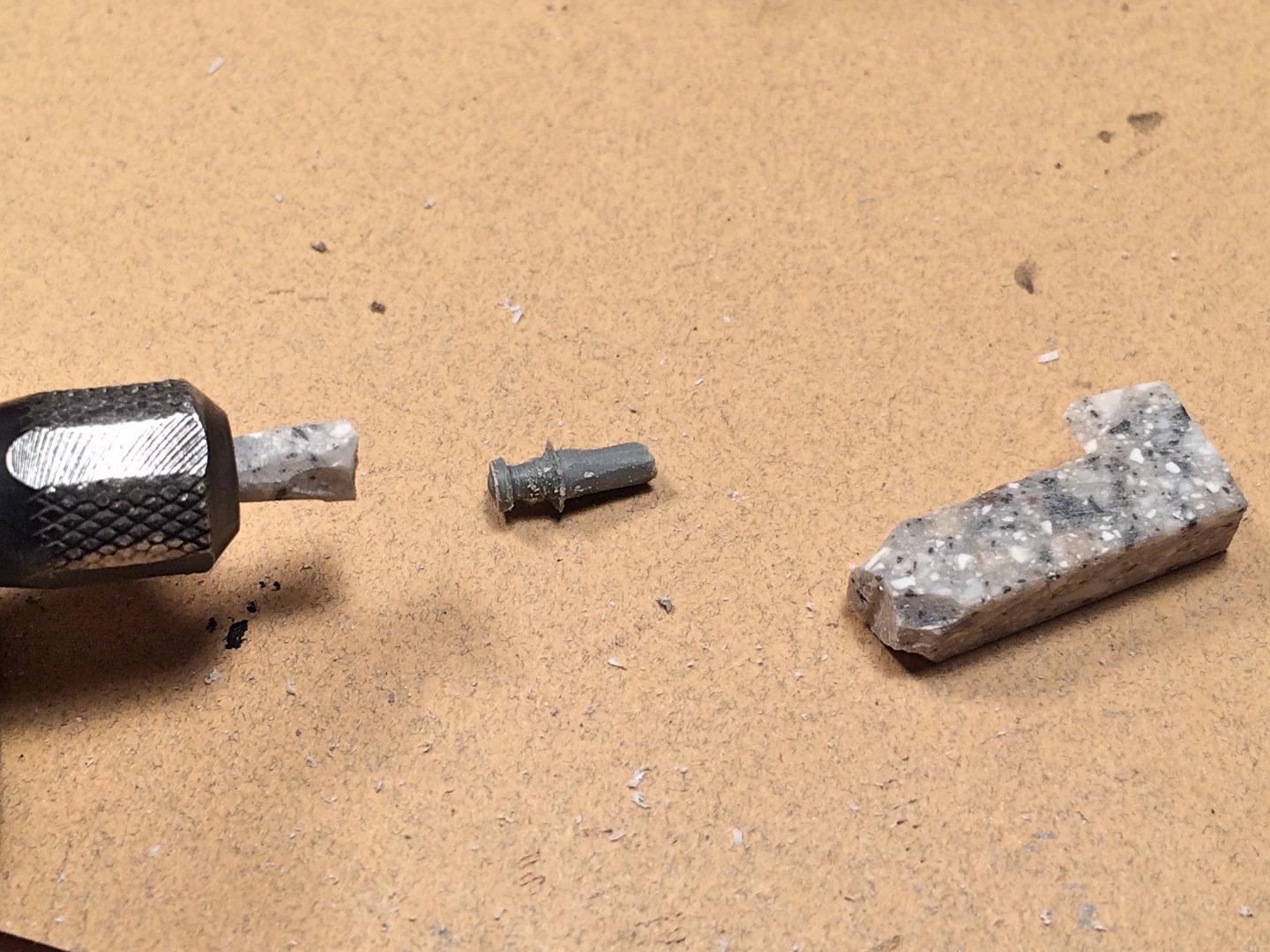

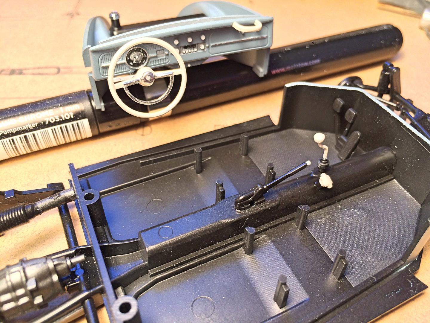

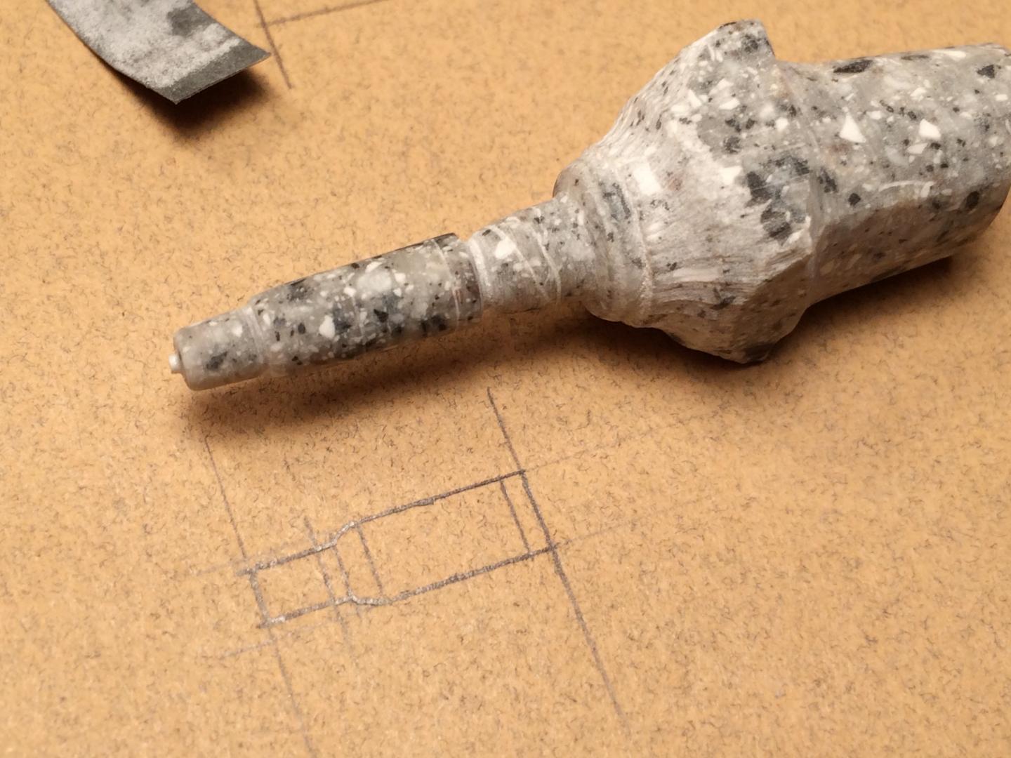

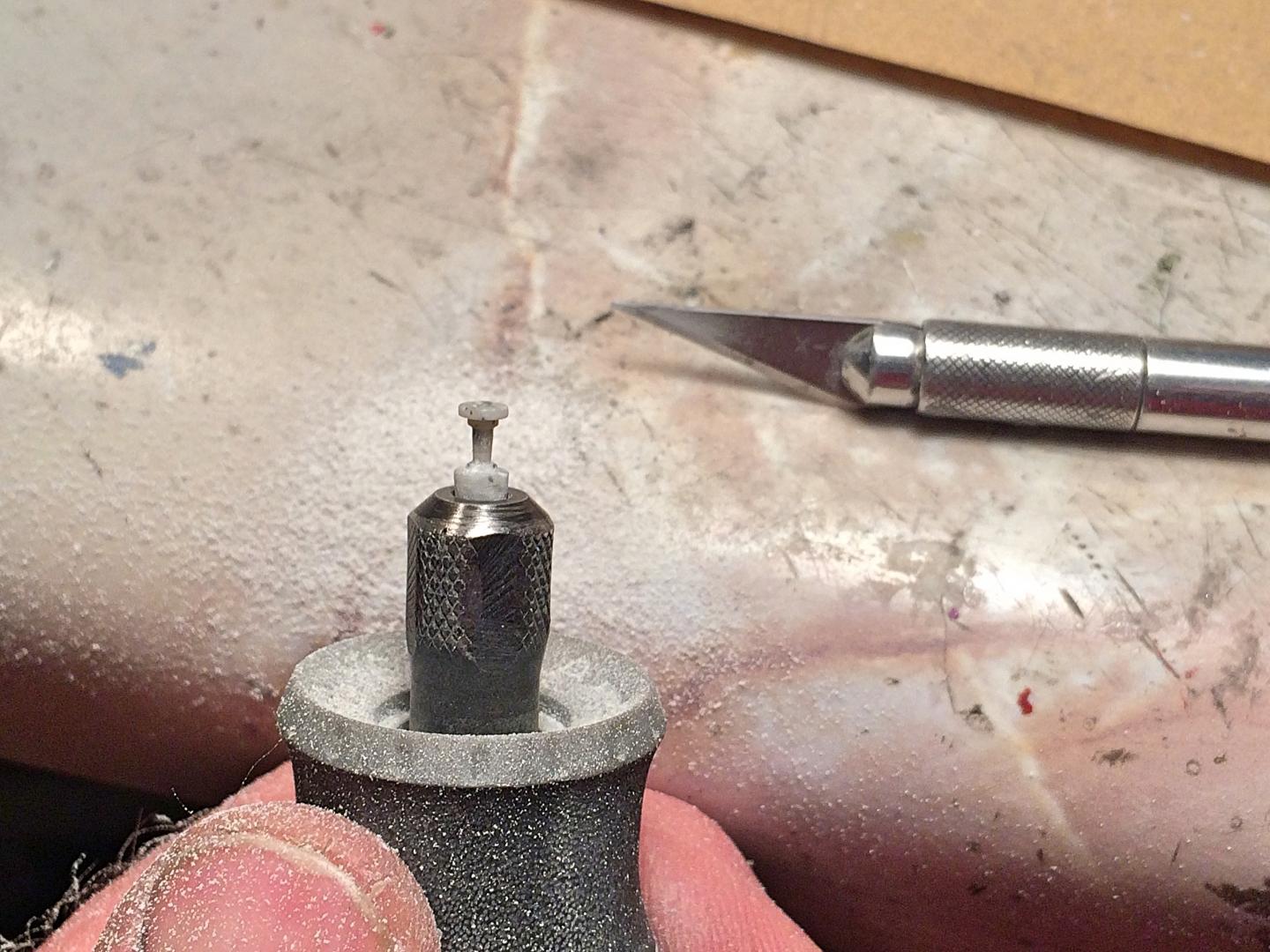

Heater control knob, have to ditch the two lever part.  Tried to use sprue, but it melted when I turned down the shaft, twice, no matter how slow I went.  So I roughed out a piece of Corian, and started with a rough file, then used an old #11 to turn it down.
Corian has a higher heat tolerance, I love the stuff.  Used steel wool to smooth before cutting off.  I used a tiny round file to make the notches.

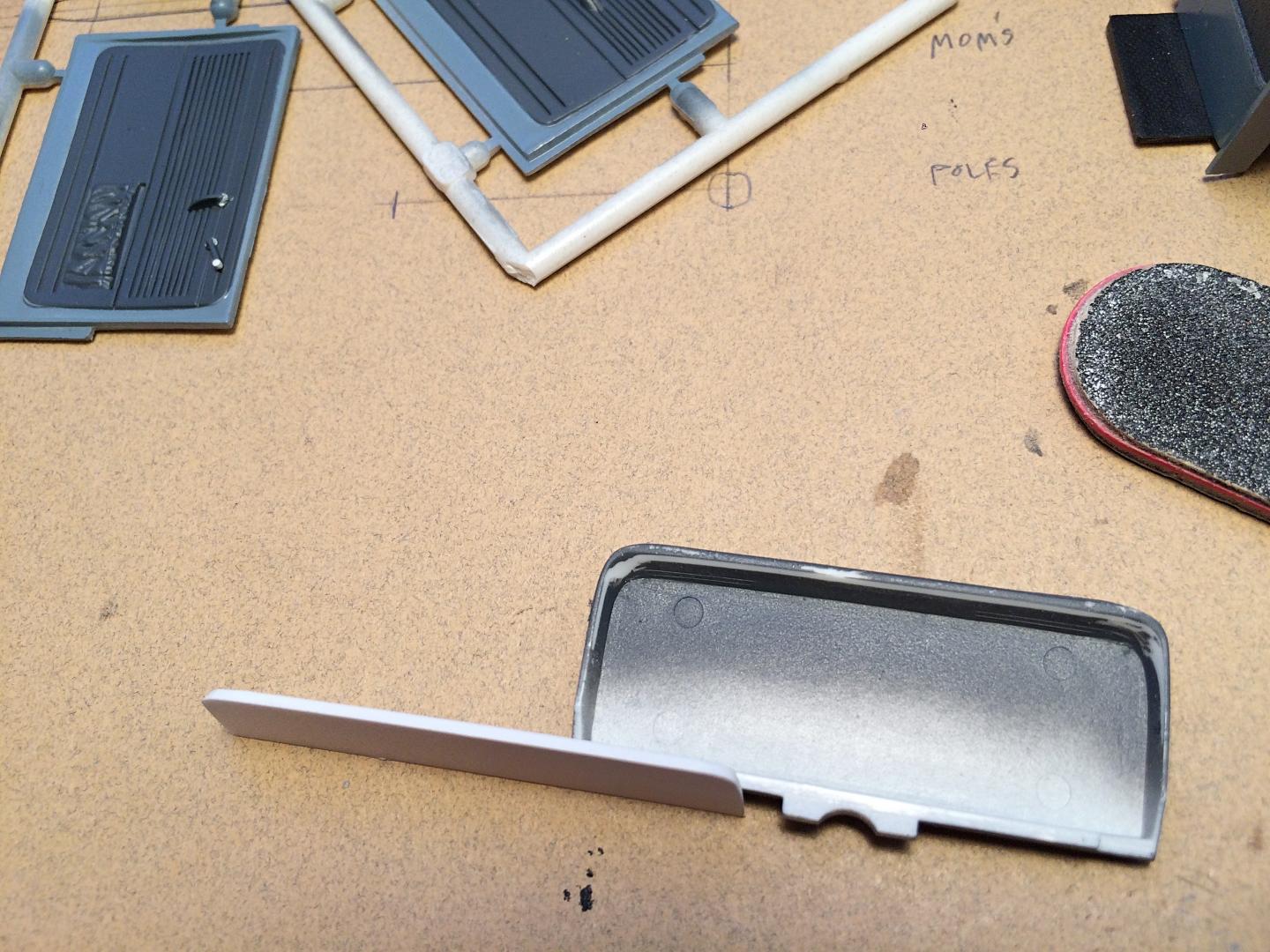

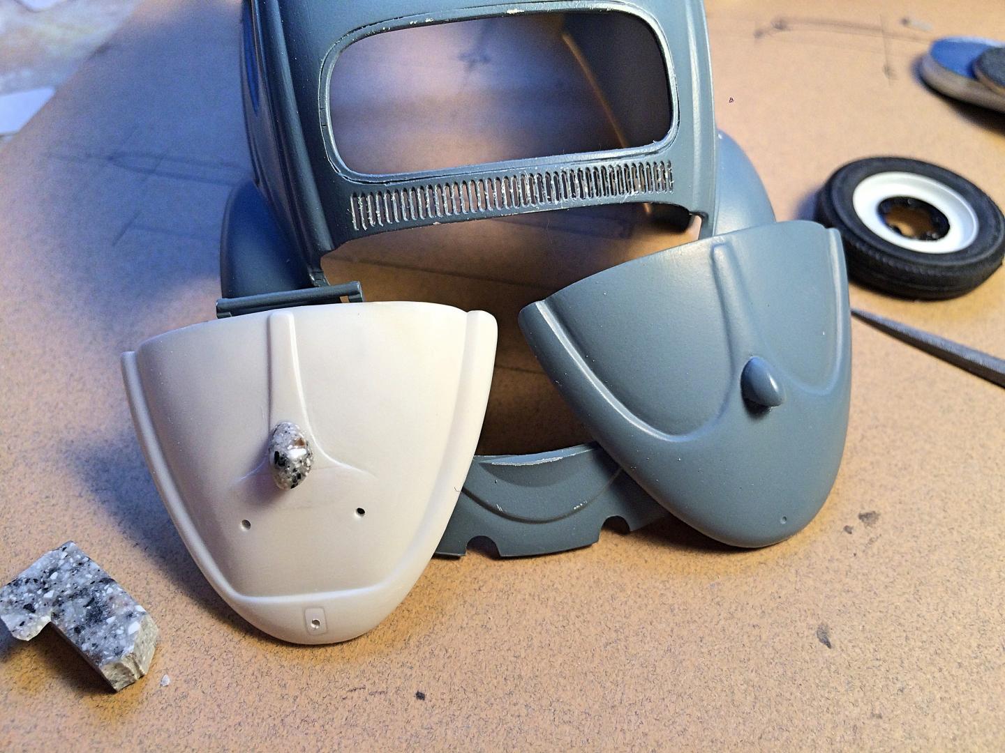

I modified the Tamiya lid, and added a light hood made from my favorite alternate material Corian.

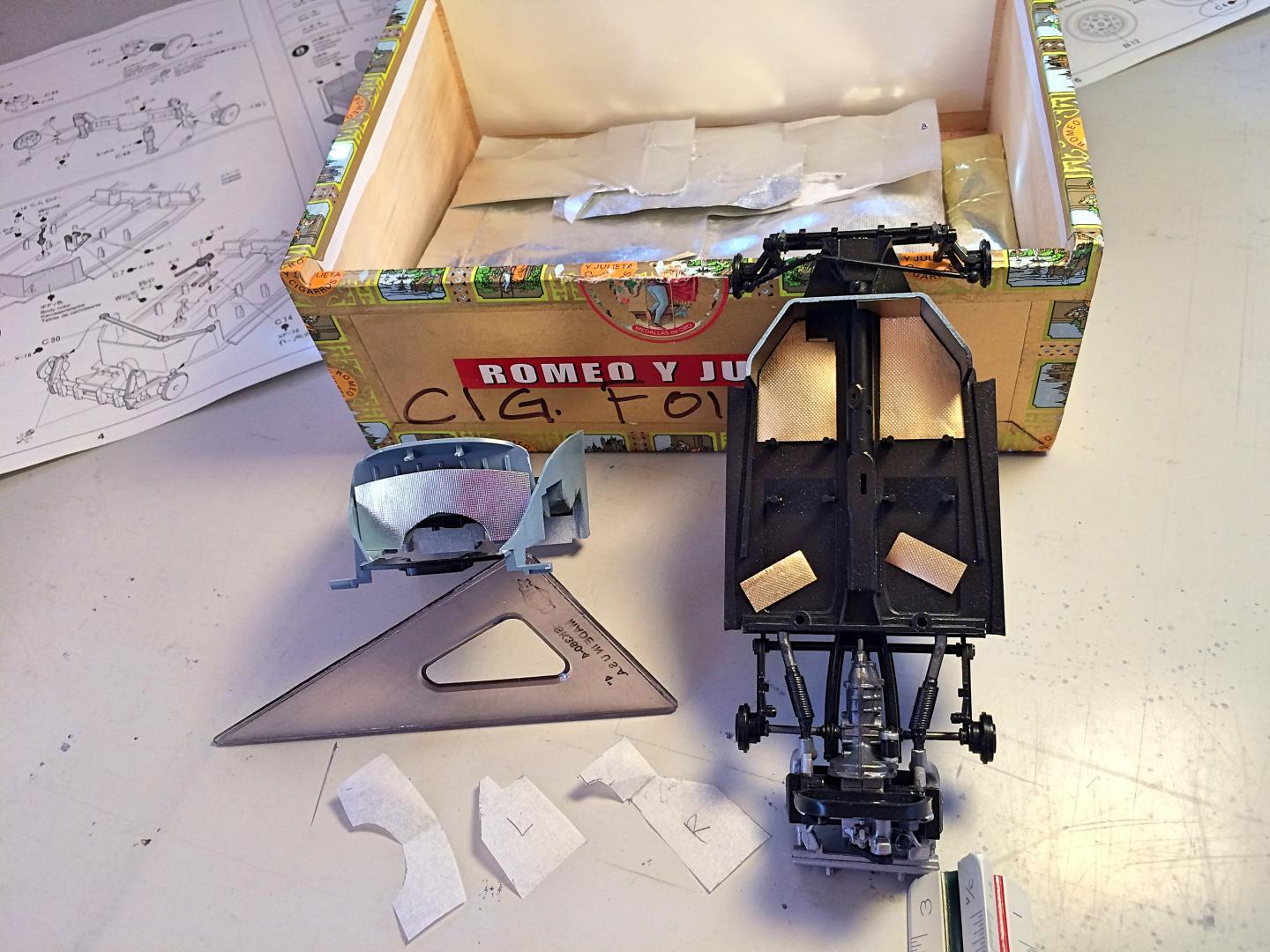

I wanted to move ahead, instead of repairing the body.  I dug through my cigarette foil stash to find a good looking pattern for rubber floor mats.  I also made an engine compartment insulation panel.  I made several drafting sketch paper patterns, I like this thin paper because you can see through it.  Then I cut the foil, then sprayed with a custom mix.
I glued the first one in with too thick a glue, so I switched to Elmers clear, should have listened to my little voice.  You can see my heater control knob.  :D  I also felt like a bull in a china shop painting the dash details, my shortcoming.

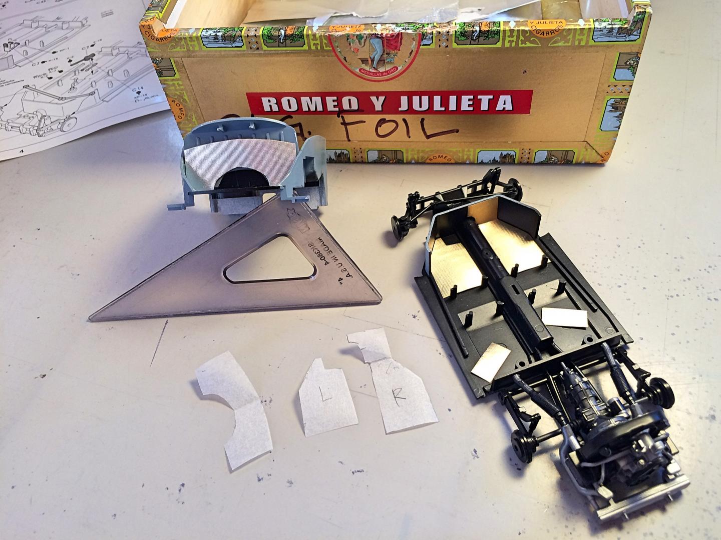

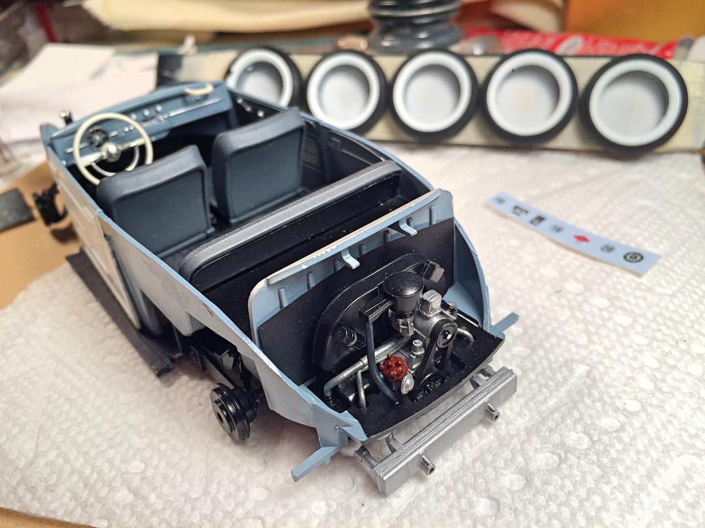

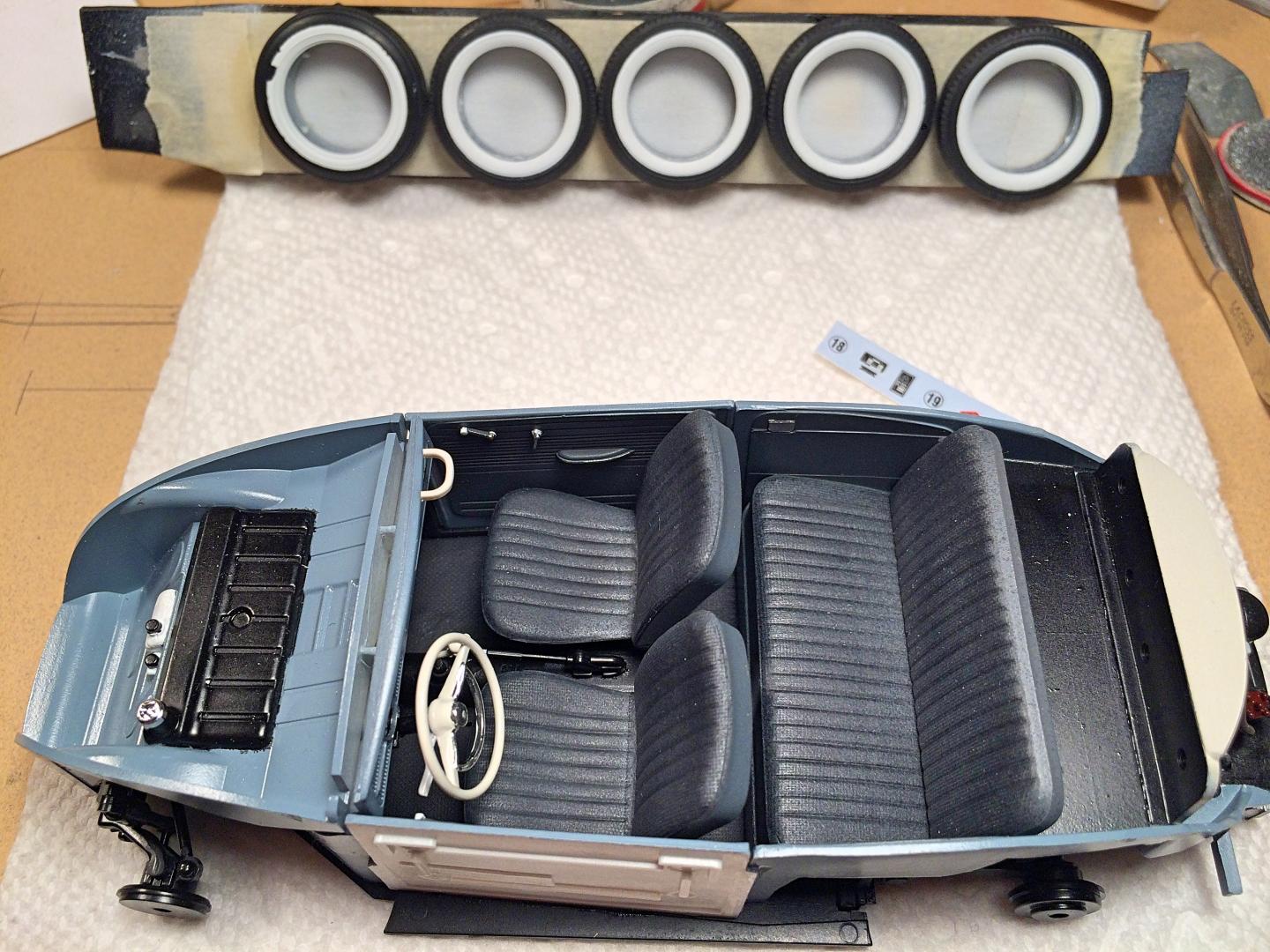

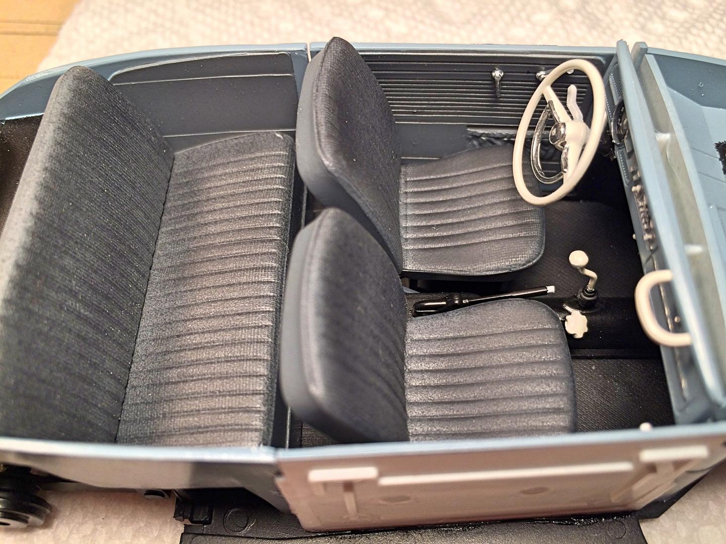

Since I don't have any pictures of the interior of this car, I took the easy route and picked a German Panzer grey.  Instead of cleaning the airbrush, I put in flat black, then sprayed through brass screen to give a fabric effect.  It's not perfect like using Scale Motorsport decals, but look at pictures and you don't see the whole surface as one pattern.
That's when I discovered something that drives me freaking nuts, and I'm annoyed that Tamiya did this, considering they have tiny crown nuts to use on the wheels if you don't put on the hubcaps!  The back seat has no back, are you kidding me?!?!? :angry:  You can see it through the back window, no?  Good thing it's really simple to make a piece with thick sheet plastic, with a bevel.  I guessed on painting semi-gloss black.  This is something anyone can do.
IMG_9236_Fotor.thumb.jpg.4455a888a618e6efdf9845899c07c1ca.jpgIMG_9237_Fotor.thumb.jpg.354bdcdde9664fe4f3491ecdb5f93c0b.jpgIMG_9238_Fotor.thumb.jpg.ed9b8923c093b20daf50d0e1ec76bd44.jpg

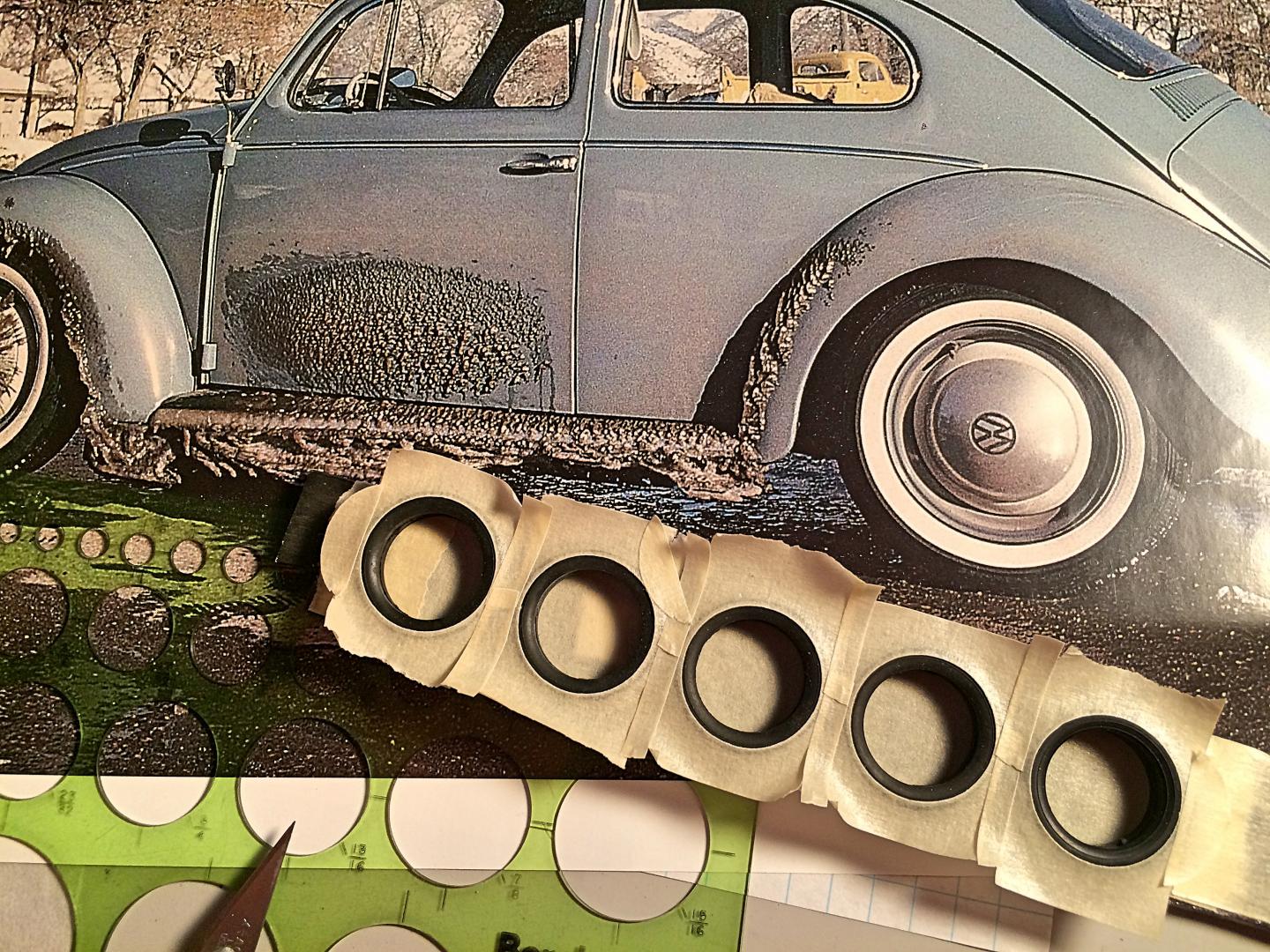

White walls, first time I have done this.  Used the drafting circle template to cut the holes in the masking tape, and carefully stuck on the washed tires.

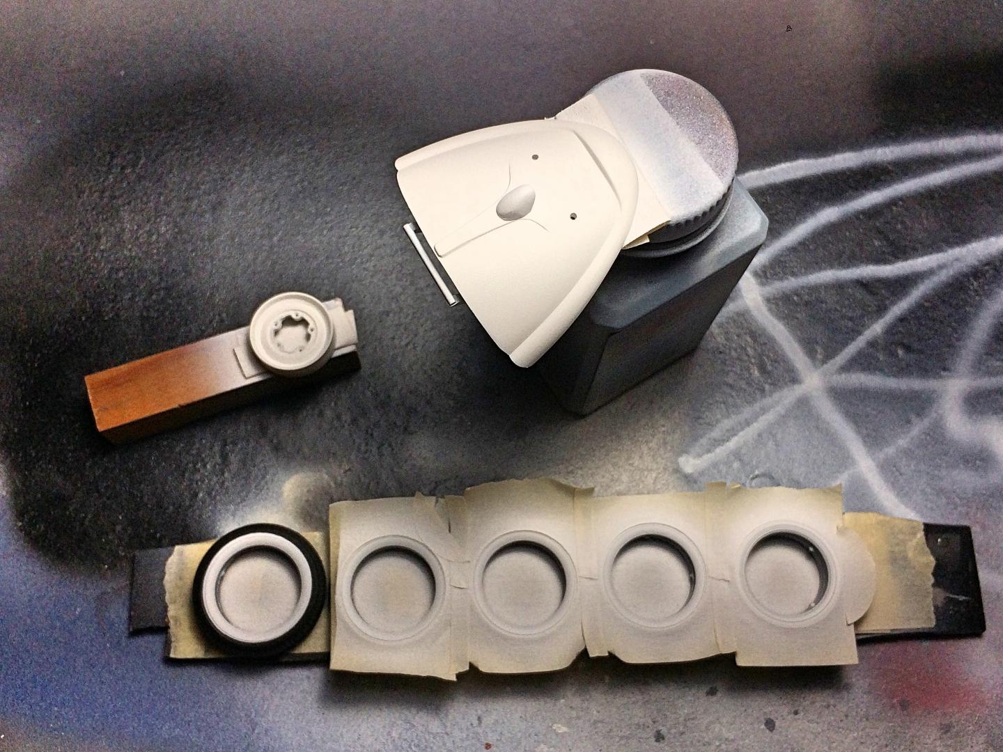

Since I had to paint the deck lid with primer, used that for the tires.  I had also seen pictures of spare wheels that were all white, and the paint had come off the resin wheel anyway.  Grrr...
Thought I was home free after removing the tape, but found the one tire that is the Tamiya came off, the Hasegawa tires are fine.  Started on assembling the chassis.  I have extra decals from a 1/24 Kubelwagen, thinking of adding to the engine compartment.  I had also drilled for plug wires before final assembly, see if I'm still sane later.
Think I can live with this.  The ash tray is a piece of polished aluminum plate.  Going to hide flaws with cargo stuff.  :P
16 hours ago, afx said:
Interior looks great, the seats in particular.
Thanks!  It's a technique I developed, and may try for doing carbon-fiber bodies instead of decals.  *might*

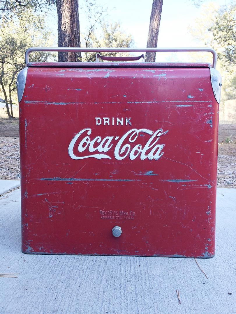

Took pictures of the cooler today, see I need to improve the lid before doing the details.

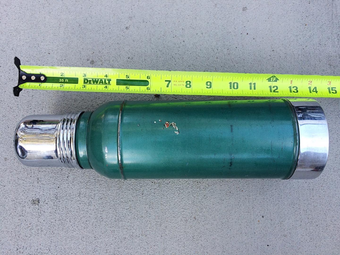

Also took pictures of this thermos.

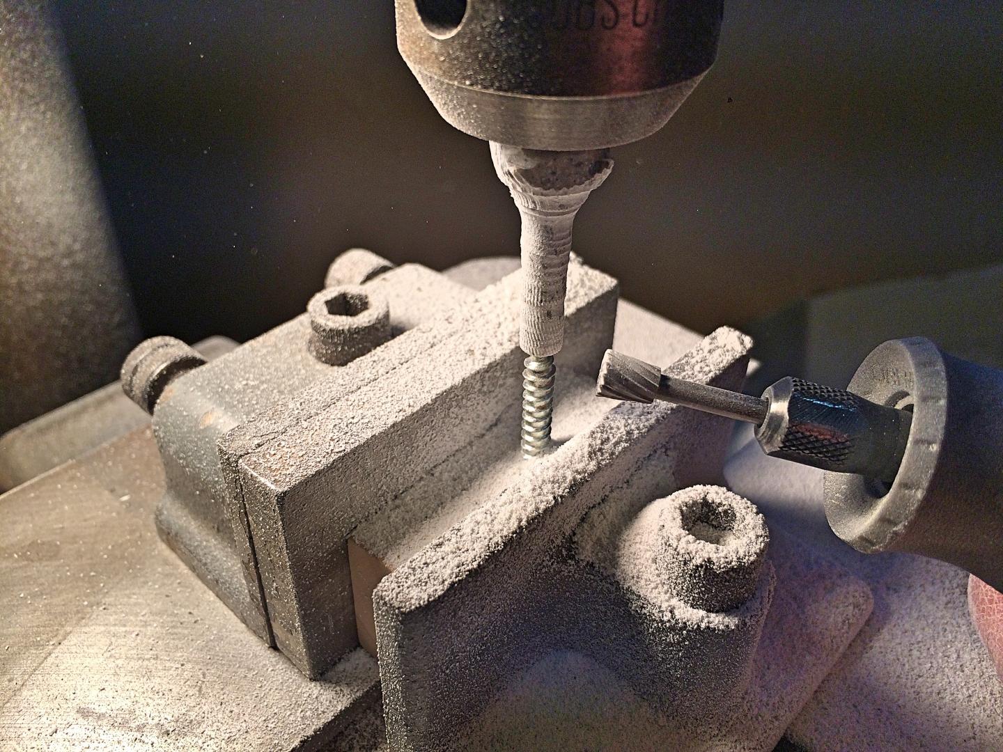

I whipped it out using the drill press, used Corian.
