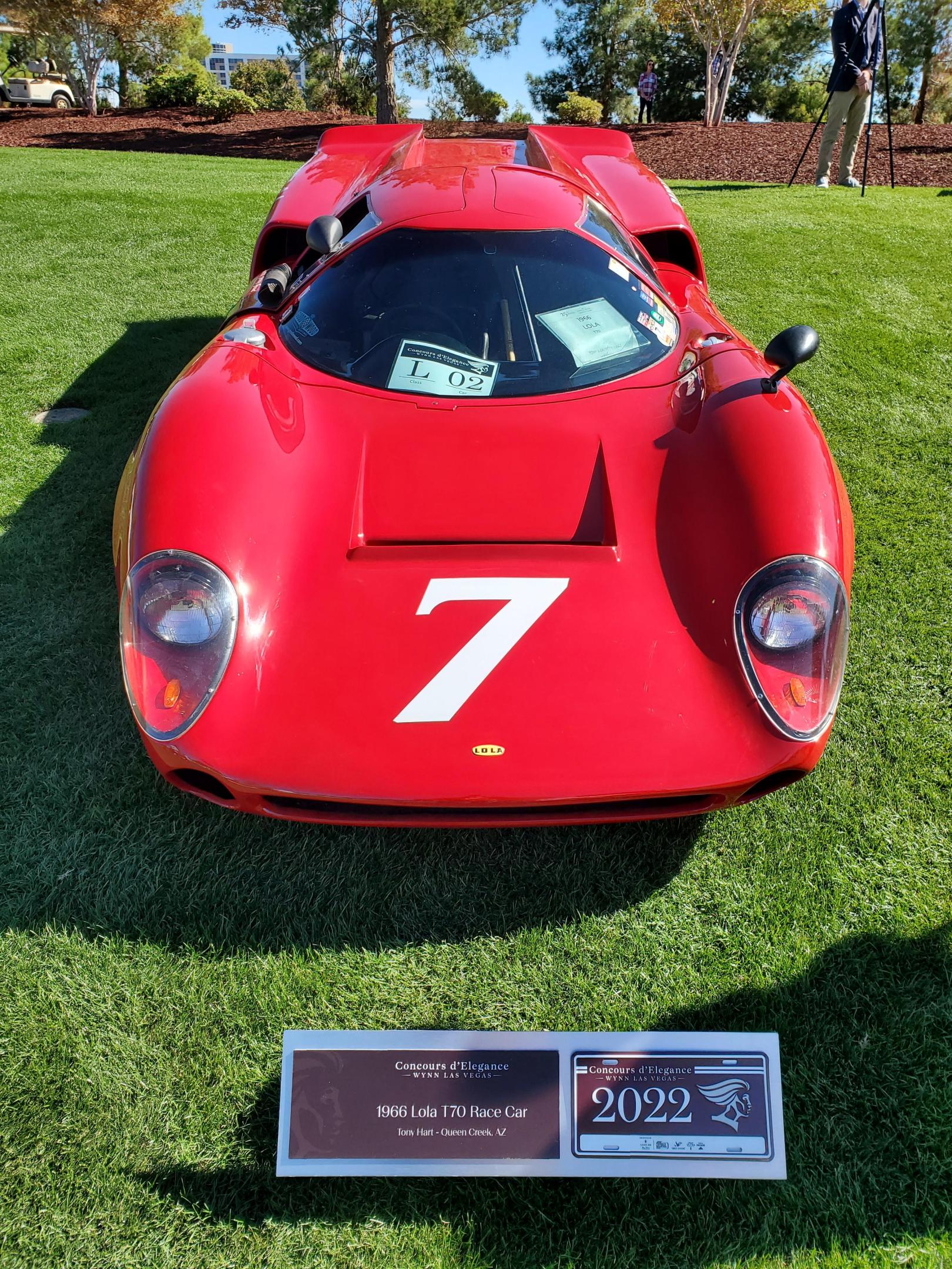

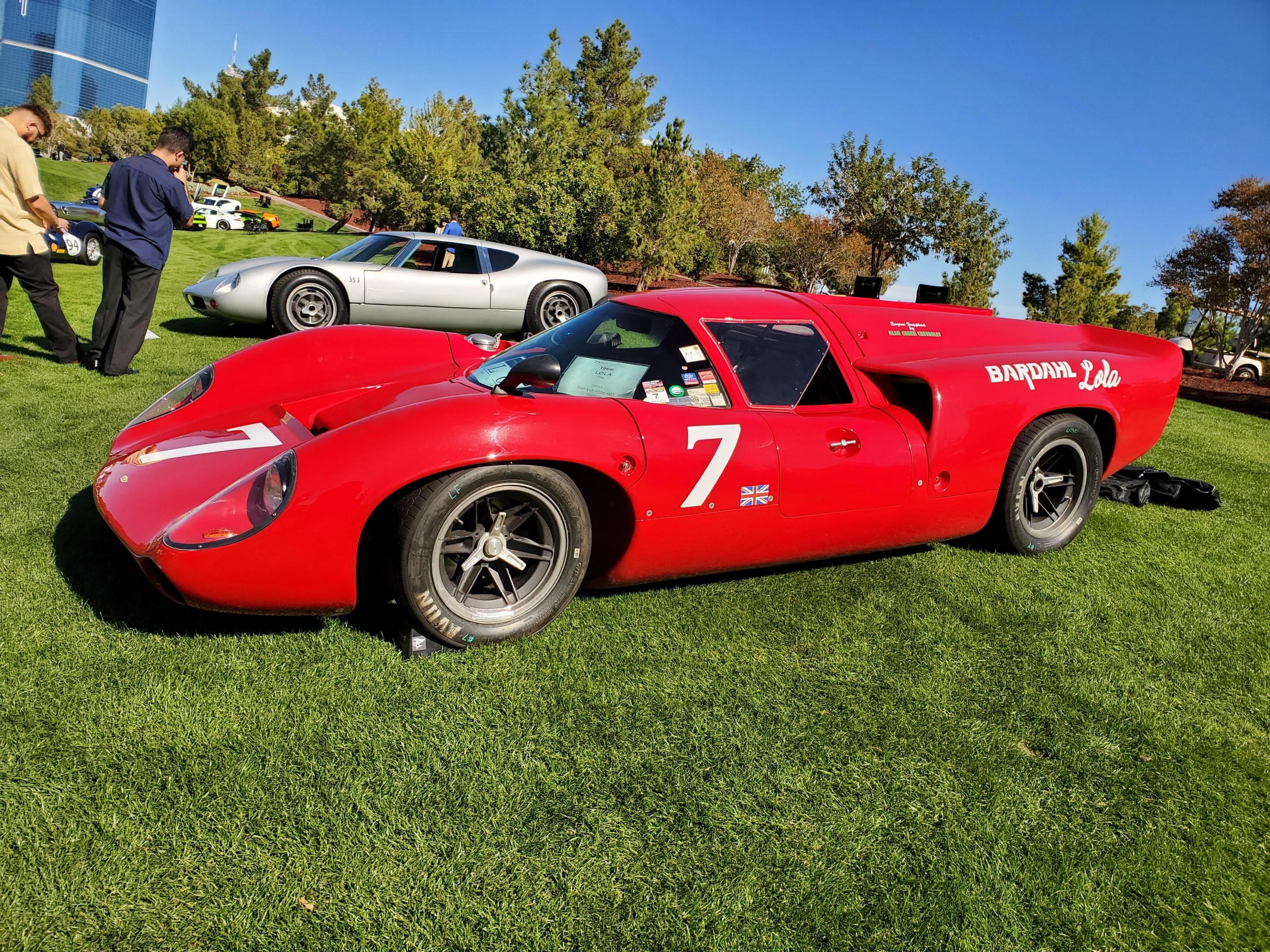

Mark, you are definitely setting a high-bar with this build. The only thing missing is the smell of racing fuel and exhaust! BTW, I was thinking of your build yesterday when I was at the Las Vegas Concours D'Elegance. I had never seen a T-70 in the flesh before. Here's a couple of pictures and a link to the other cars that were there.
Edited by ea0863
  • Like 1
Those are nice photos EMRE, thanks for sharing them!
