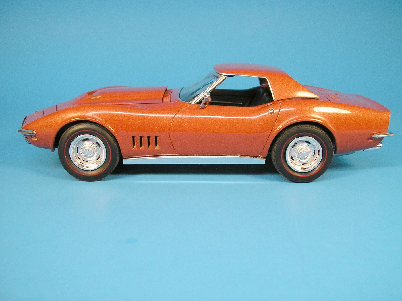

MrObsessive Posted July 28, 2019 Posted July 28, 2019 (edited) Well now she's finally all done! Hard to believe that it's been over 30 years since I first built this one and time sure does fly! I can tell you, this will be better taken care of this time around, so no more rebuilds will be necessary! Paint is '68 Corvette Bronze and I got to hand it to my paint guy.....according to pics I have of the 1:1 on my hard disc in this color, he got the match pretty much spot on! He mixed the paint in a very fine metallic so the flakes are not jumping out at you when you first view it. Tires are from the AMT parts pack redlines, and I had to tweak the wheels somewhat with some tape to make them fit a little tighter inside the tire. I did tweak the suspension somewhat as one major pet peeve I've had with Revell kits is that they always sit too high. Now the stance is the way I want it, and I can live with it. Â Here's a 1:1 for comparison as far as the color............. And now my resto of the original I did in 1988............. I decided to leave the uptop white for the time being. I do have pics showing the top in beige, but a nice bright white will do for the time being. Nice hardtop included in the kit. I decided to paint that body color as it looks better and I'm not a fan of the vinyl covered ones. I took a tip from Steve Guthenmiller and decided to try the BMF under script lettering instead of PE. Well I have to admit, I like the way this turned out, and I'll be definitely trying this again in the future! I didn't go super crazy with engine bay details, just some wiring for the engine and fuel lines. I do have the air cleaner but more often than not when shown, it'll have the air cleaner off. Thanks for looking folks! There will be other restos in the future, but I'm debating whether or not to go back to the Green Hornet Shelby. I have to redo some things on that (a bit of a setback) but OTOH, I really want to get that one done before year's end. Edited July 28, 2019 by MrObsessive

geetee66 Posted July 28, 2019 Posted July 28, 2019 1st class build. You nailed it. The stance is perfect.
oldscool Posted July 28, 2019 Posted July 28, 2019 That looks fantastic Bill. That was the last kit I finished before moving back to the wonderful state of Florida.
bbowser Posted July 28, 2019 Posted July 28, 2019 Very cool, my favorite generation. The Rallye wheels and redlines really set it off.
TooOld Posted July 28, 2019 Posted July 28, 2019 Beautiful '68 and I love that color !  It looks great with the hardtop in body color !Â

MrObsessive Posted July 28, 2019 Author Posted July 28, 2019 Just now, Classicgas said: Stunning! Color is spot on. Where is that carb from? Can you explain the foil under technique? Lee, the carb came from Fireball Model works. Certainly makes the engine instead of the plastic blob in the kit! As far as the foil, before I put on the color coats, I put BMF on each of the letters on the body. I painted it and then when it came time to rub out the paint with the polishing cloths, the paint came off easily as paint doesn't stick to foil very well. You want to trim as close to your scripts as possible because depending on how much paint you put on, you don't want the edges of the BMF showing through. I did it this way as there were Corvette letters on the PE set, but since the lettering on the body has more depth, I thought it would look more realistic doing it this way. Hope this helps!

MrObsessive Posted July 28, 2019 Author Posted July 28, 2019 3 minutes ago, Classicgas said: Thanks. Do you apply it before priming or after? Lee you want to put it on after you primer. The fewer coats you have to put over the foil the better.
