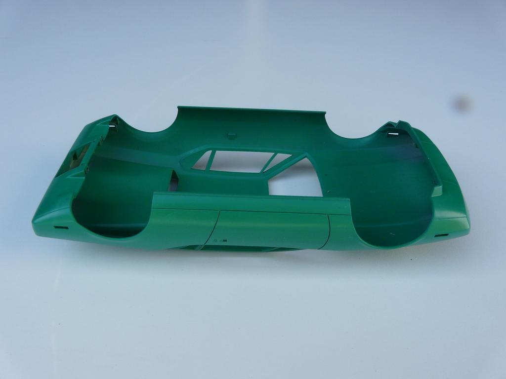

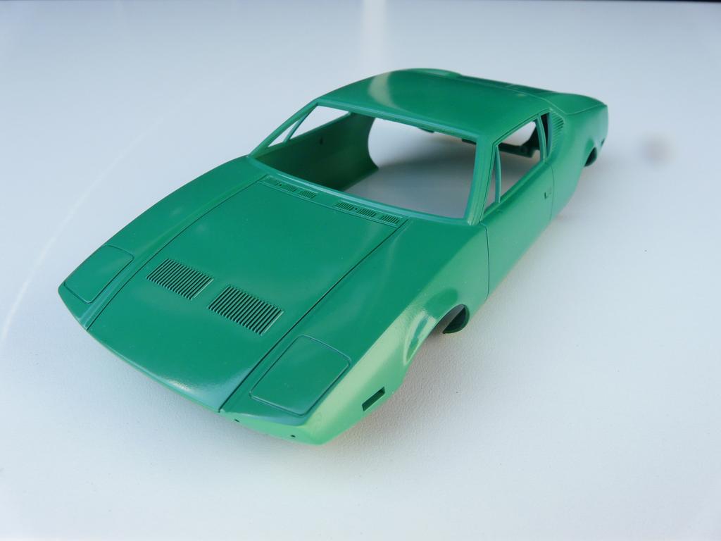

First step was to remove the moulded in grilles. This will be replaced by parts from the PE set.

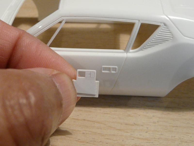

I wish someone would make PE door handles like these. I'm hoping to do Fujimi's Lotus Esprit at some point and it has handles like this too. I've made these from plastic sheet.
First coat of primer...

Great idea on making the door handles. I'll be using that when building something with this type of door handle, would also work well for a custom style build also.

This is looking like its off to a great start!!! Excellent job on those SB door handles too!!...i will be following!!!  i need to get back to my Testors pantera.

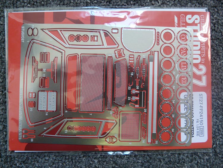

This is the Studio 27 PE set...

Its a shame that that PE set is discontinued....i need to find one.
I didn't know this was discontinued. To be fair, you're not missing much. The window trims in the PE set are not a great fit and I probably won't be using them and the grills could have probably been cut from a universal PE mesh.

I'm only interrested in the body scripts, and interior bits. I'm not one to use everything in these sets either, but i would NEVER use PE window trim..its looks about as fake as one can get. I think Acu-Stion made a set for this Pantera too, but thats Very hard to find as well.

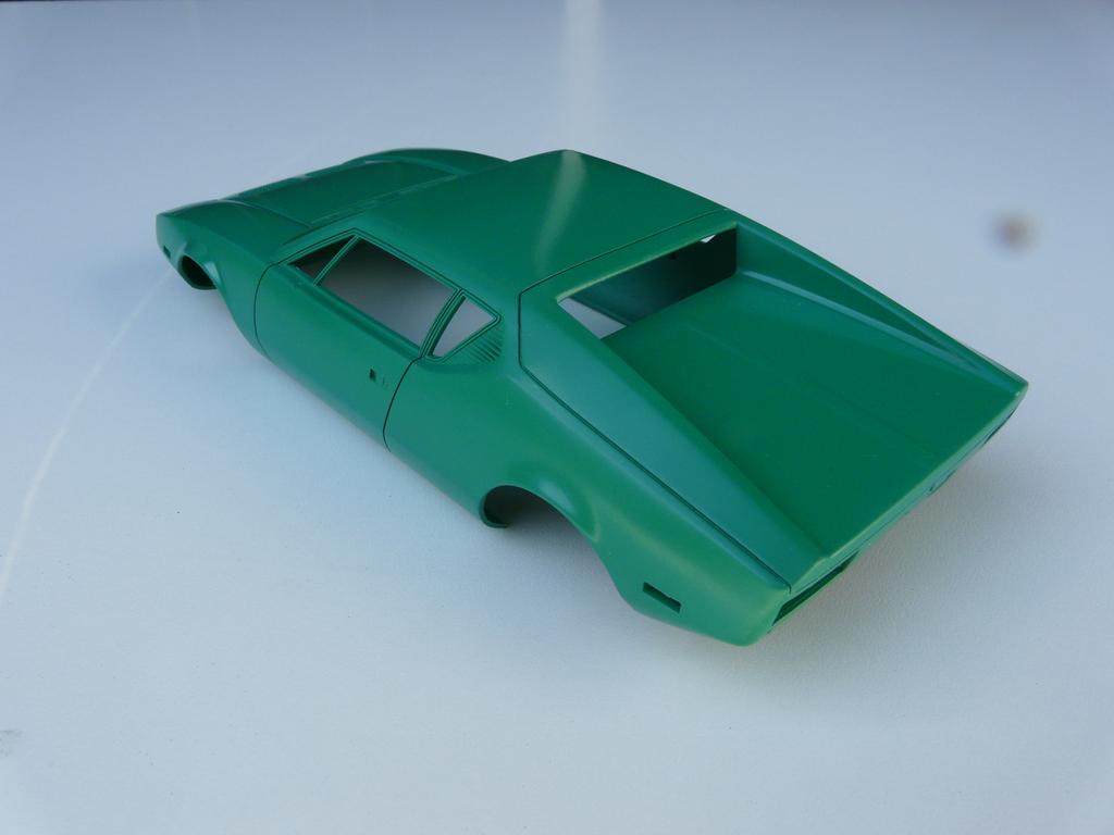

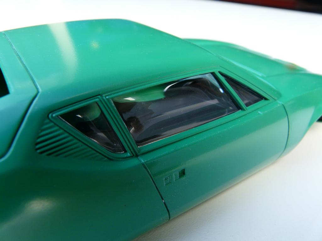

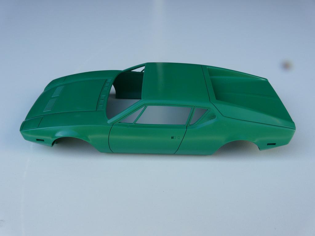

It's time to show a little more progress on this one. The colour is straight out of an acrylic spray can. it's nothing special - just a tin of Rover Java green from Halfords. It approximates to a colour I have seen on a 1:1 Pantera. The paint has had some time to dry now and, as always, I notice the initial 'wet look' gloss has disappeared. I think it will look better after polishing though.

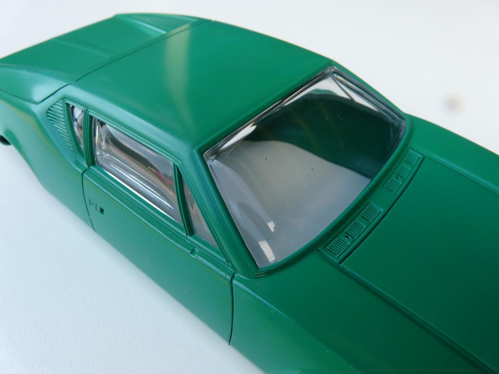

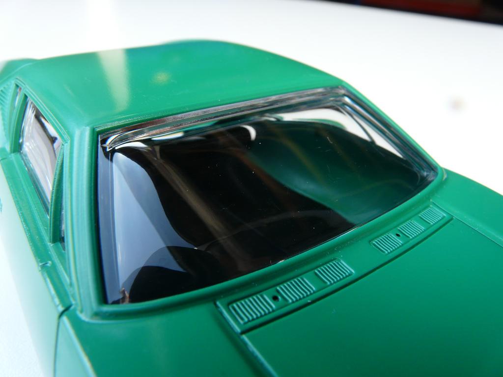

Here is where I feel this kit really lets its self down. Just look at the glass! It feels flush to the outside surface (as it should), but its so thick and distorted it looks a little bit silly.  No matter how well I do the rest of the model, this will be what will always jumps out at me.
My thoughts are to cut the windshield away from the clear panel and then thin it down with a sanding disc, making sure that its a constant thickness throughout. Then I would polish the screen back to clear. Its a lot of work and it will mean gluing the screen in on its edges against the window trim. If anyone can recommend a glue for this method of fitting a screen I'd be grateful. The side glass can be cut from a clear sheet.

18 minutes ago, beeRS said:
<--snip-->
I think I'd try to find a way to make a copy of the windshield from thinner plastic - perhaps using the original as a mold (with clay or something to back it to prevent cracking) and trying to make a thermoformed copy (vacuum-formed).   Your build looks great so far!
I have this kit too, and this is EXACTLY what i came up with for my solution too. Something else that will help with the issue, would be to paint a tint-strip accross the top of the windscreen after you cut it away from the rest of the part. For gluing it in, I'd slightly dilute canopy glue, and flow it around the inside perimeter with a brush.....works like magic!!....I would tape the windscreen in place by the A-pillars, flow the glue into the roof, and bonnet sides....when dry, remove the tape, and glue the A-pillar edges. I NEVER like to use the side glass bits....i make my own as well.
   By the way, yours is looking BRILLIANT!!!!
The side windows have to go.  For the windshield, either replace with sheet plastic or use expoxy and hold it in with clothes pins.  I don't think all my older Pantera kits have glass this bad.

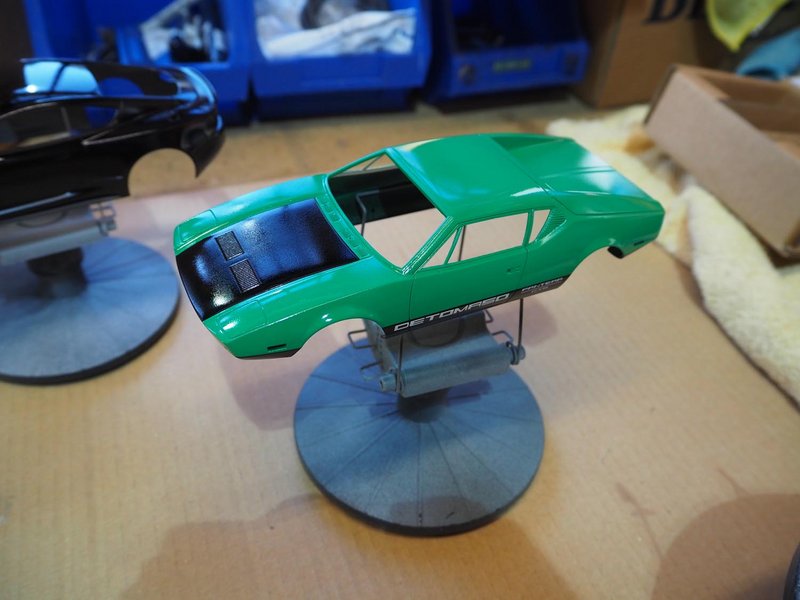

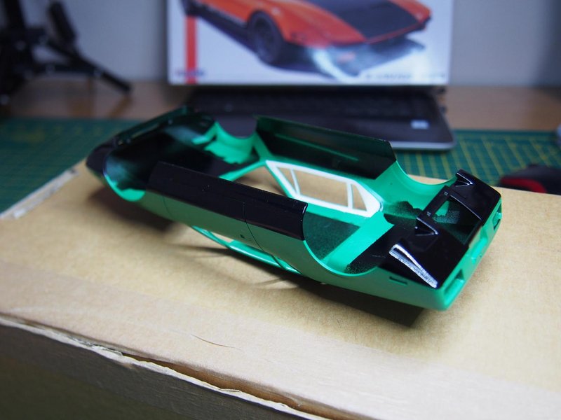

Oh dear! This is one I'd forgotten about. I was so put off by Fujimi's mile-thick glass, that I put this one back in the box and left it there for a few years. Anyway, I'm back on it now. I have a plan to thin the glass windshield and use acetate sheet to replace the side glass. Here's some progress I've made with the body.

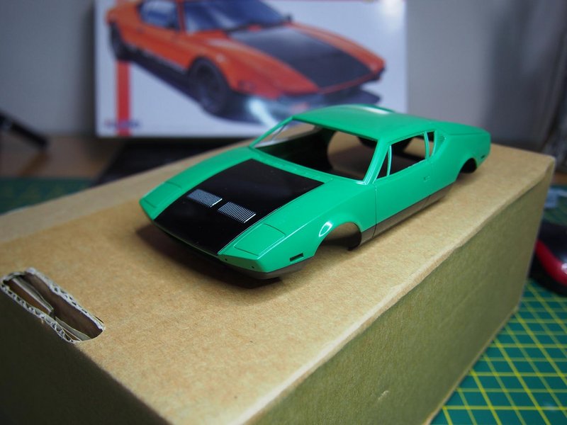

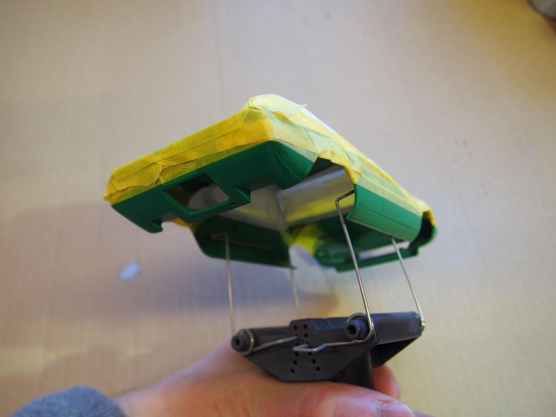

First is the masking - a job that always seems to take me twice as long as I think it should.
I applied Zero gloss black.
I've done the bottom half and the front luggage/spare wheel cover in gloss black, but not the rear engine cover. I know the engine cover is supposed to be black too on the GTS, but I just prefer it this way.
Then applied the decals and zero 2K clear coat. Mixing 2K is a chore, so I try to spray a couple of bodyshells at the same time. See if you can guess what the black one in the background is.
Let's see if I can progress a bit further with this one and not put it back in the box for another two years.
  • Like 2
