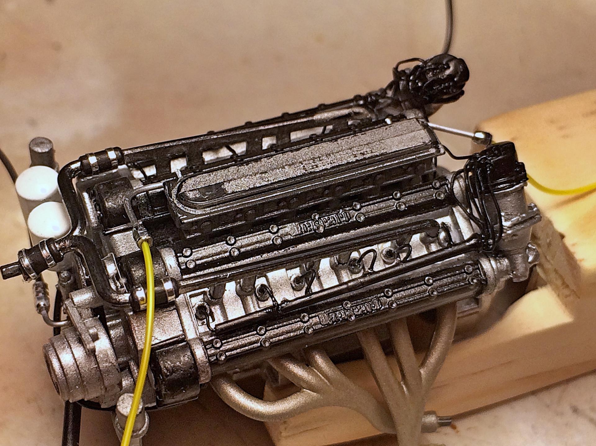

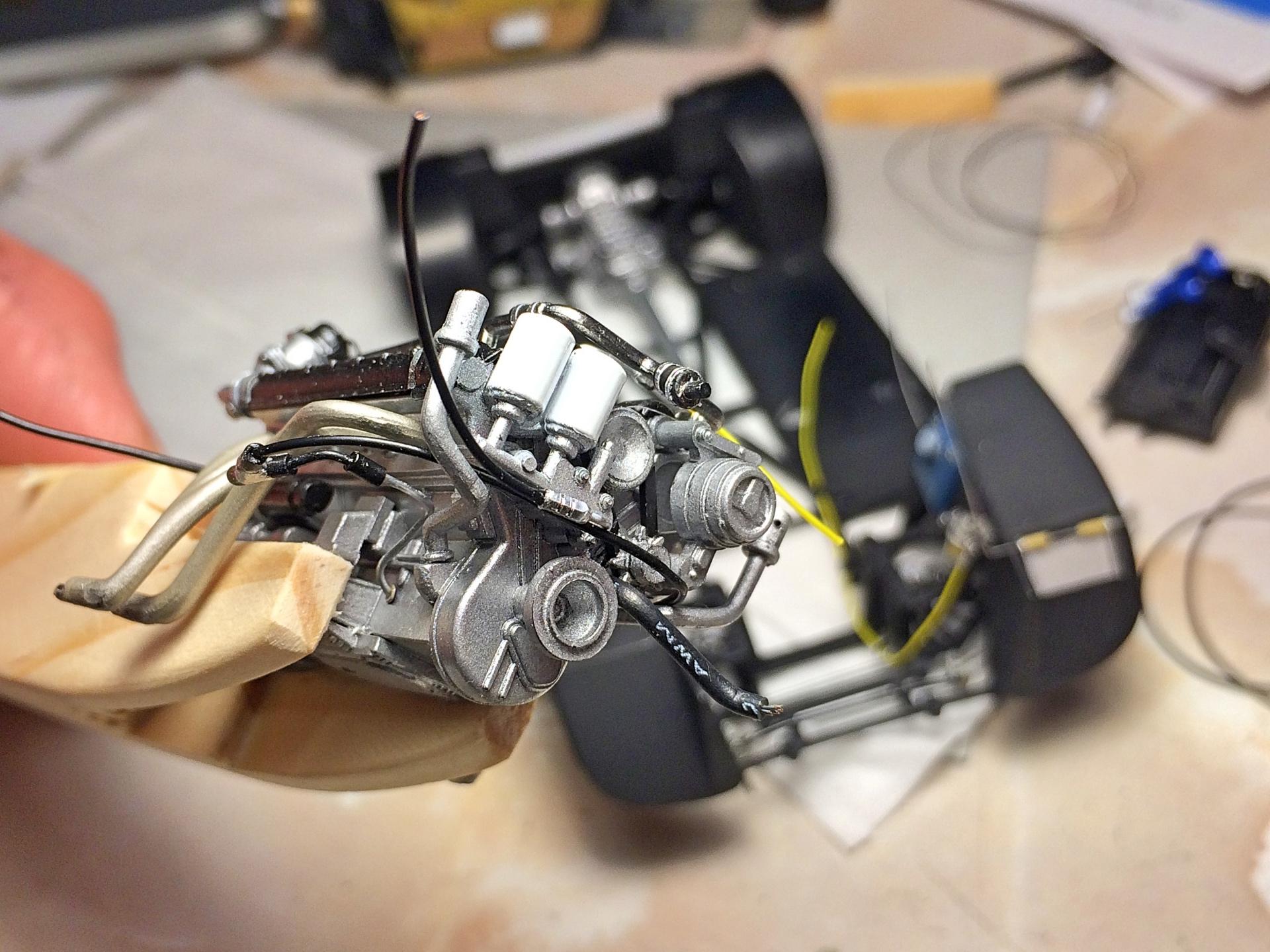

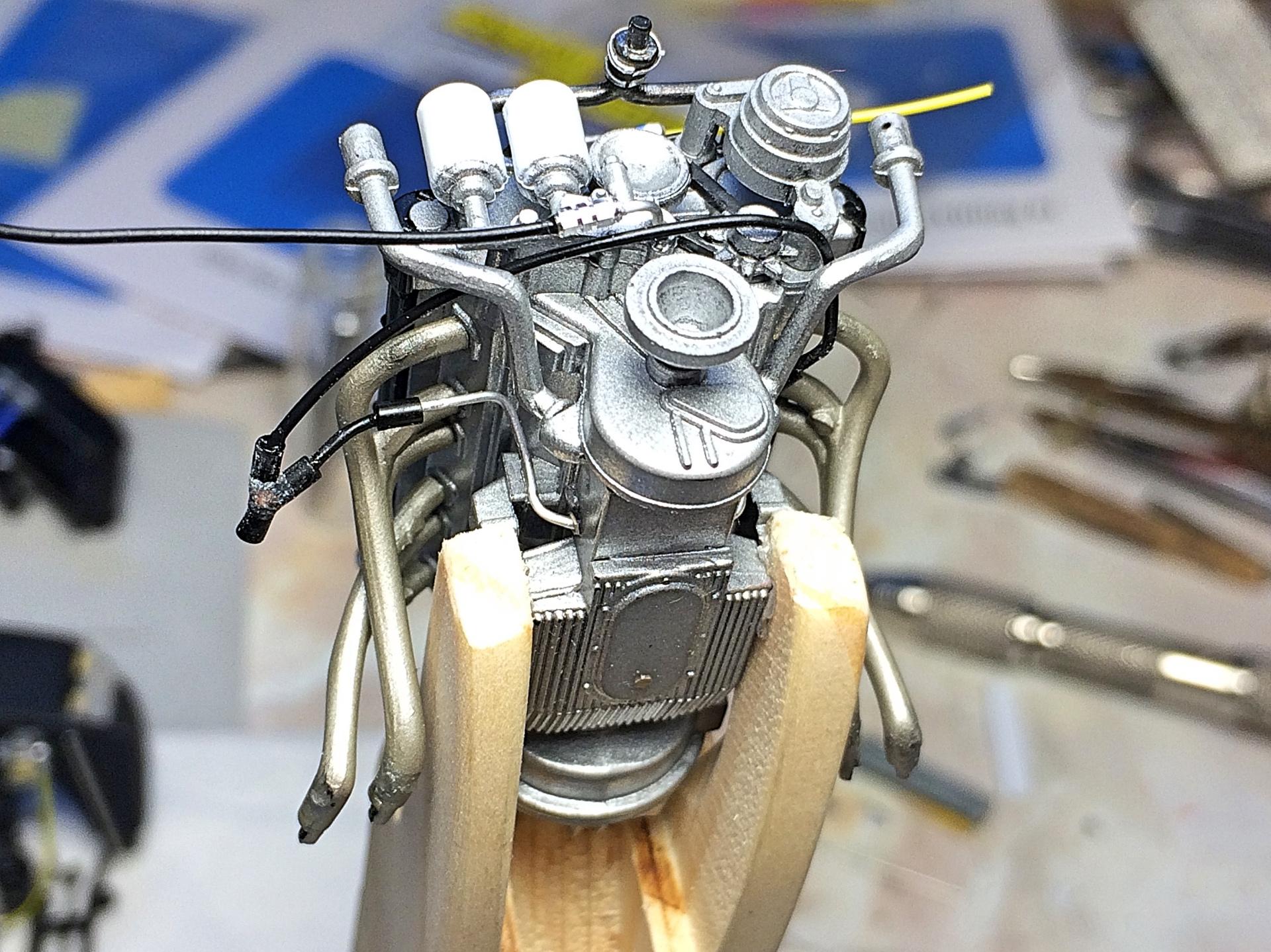

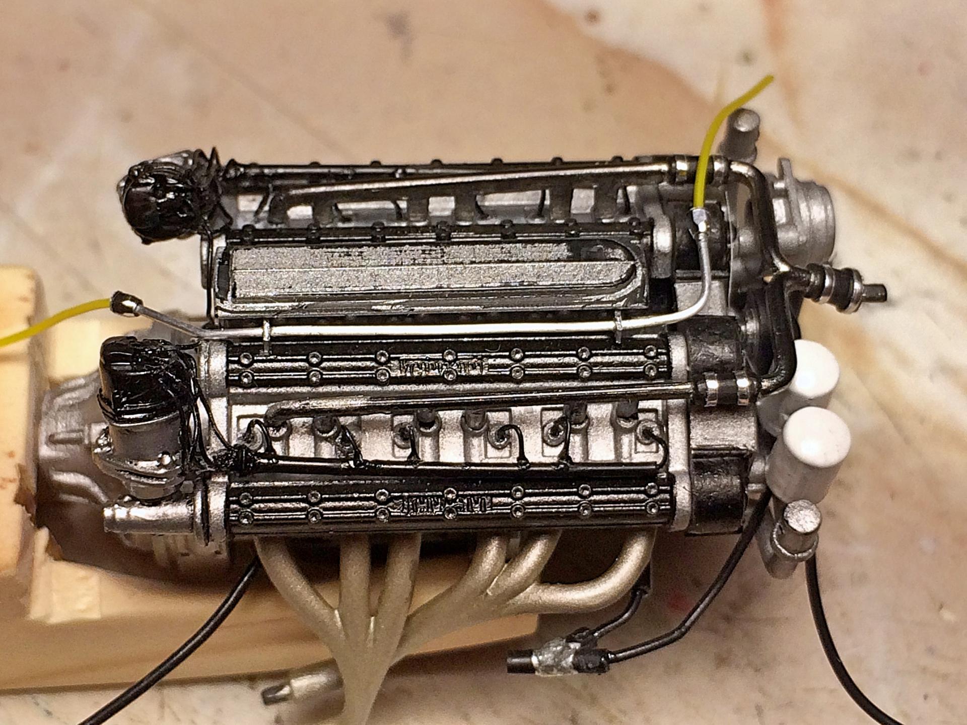

Worked on oil lines and plug wires.  Used some Detail Master fittings, Tamiya hose, misc. wire.  Needed to cut back the engine "stand", so the oil lines coming out the pan could be done.   Hard to tell that I did anything....
On 1/21/2020 at 2:14 PM, 89AKurt said:
Made an engine jig. ... Got a scrap piece of wood .., used calipers to measure, made all cuts on the table saw.  Turned a maple dowel with a slight taper for the driveshaft hole, zero slop.  Glued into notches at the front mounts with Tacky glue.  ..
Have no idea why I never thought of this before, as a means of keeping my fingerprints down to a dull roar on the oil pans and transmissions.
Took only a half century for me to figure out!  With the aluminizer type of paint, it's a requirement.  I'm still rubbing off the top of the carbs, because I needed to remove and place in the chassis for checking clearance of new parts.  Since Tacky glue was used, it's working great for this.

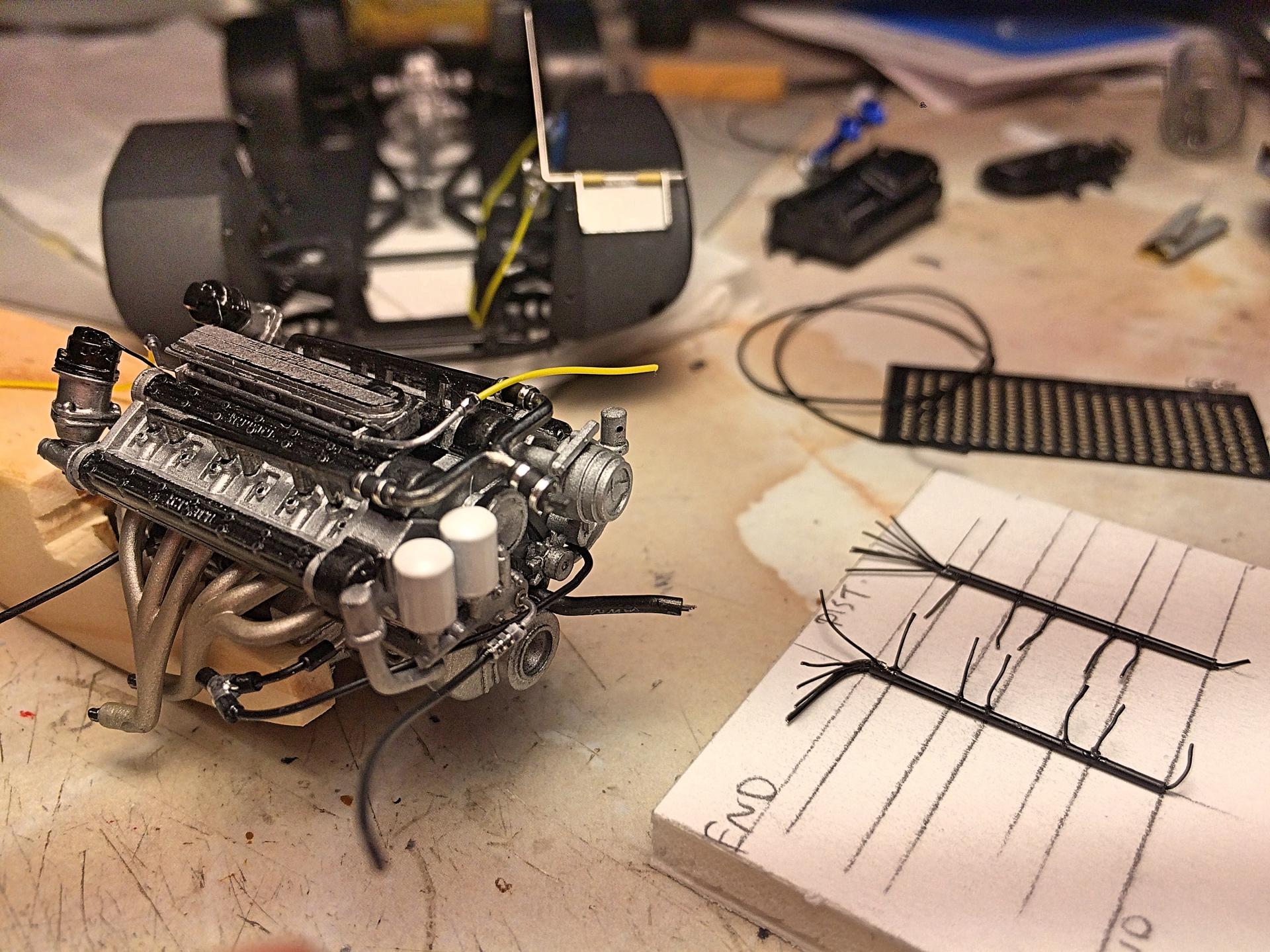

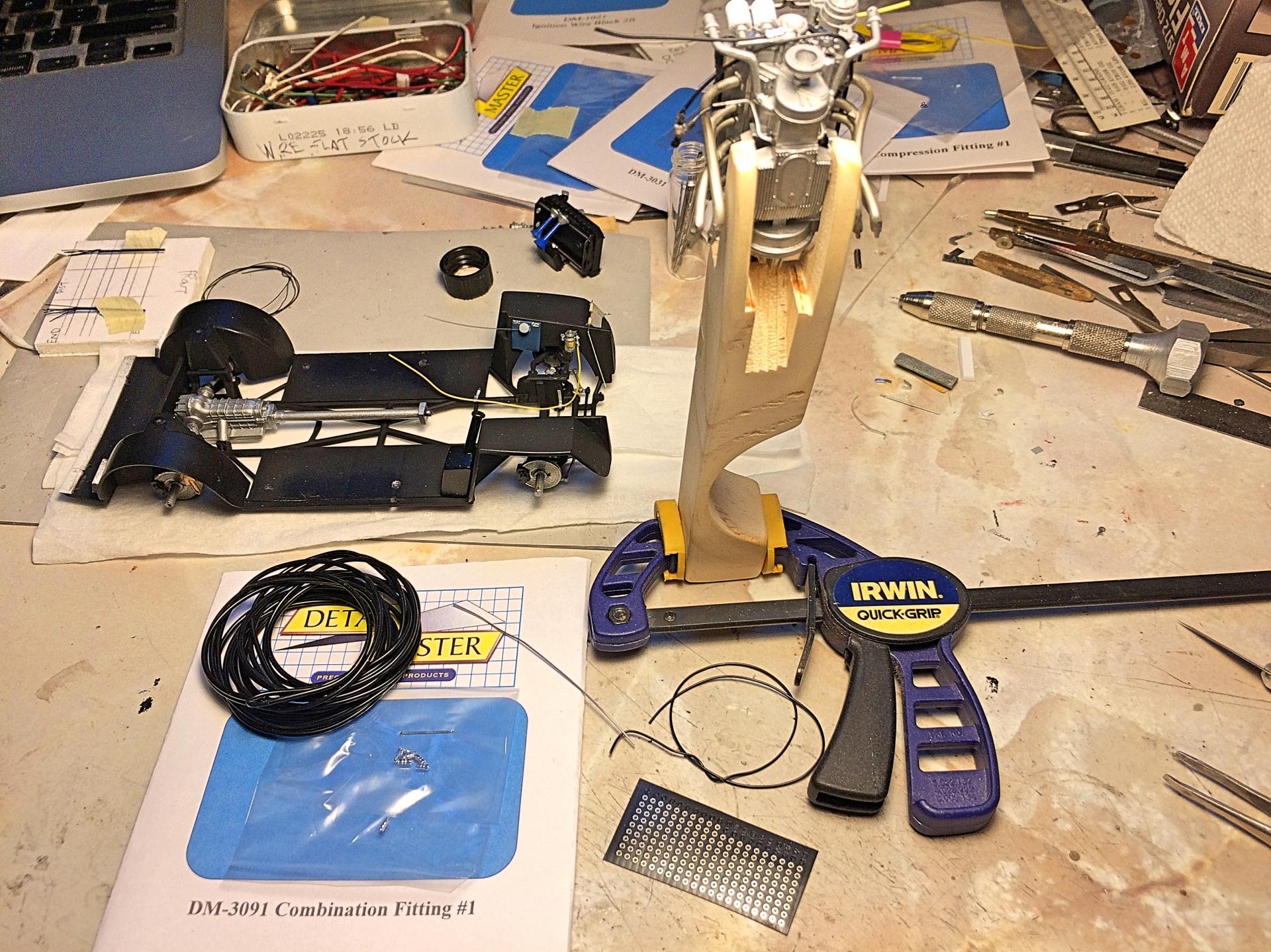

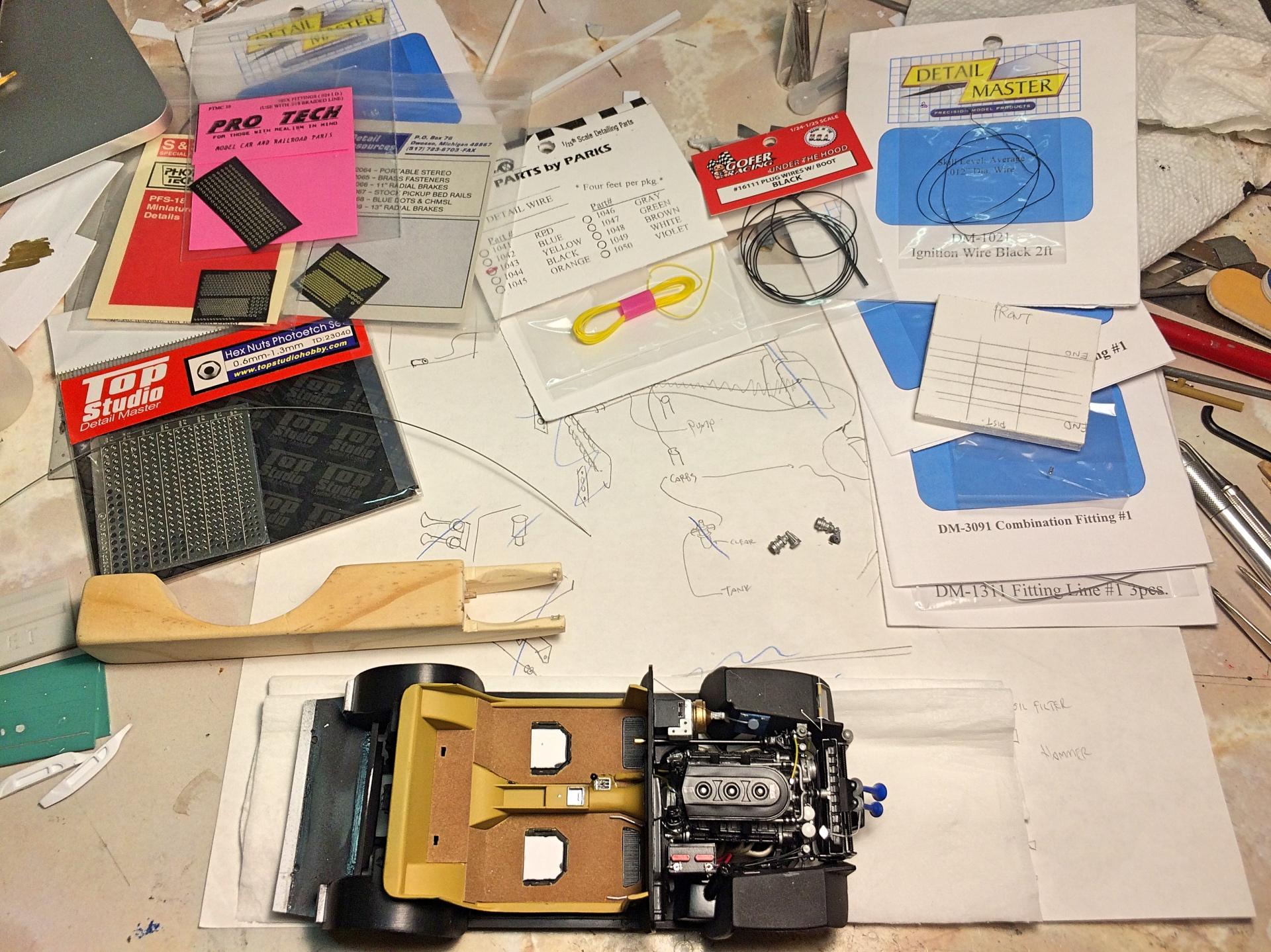

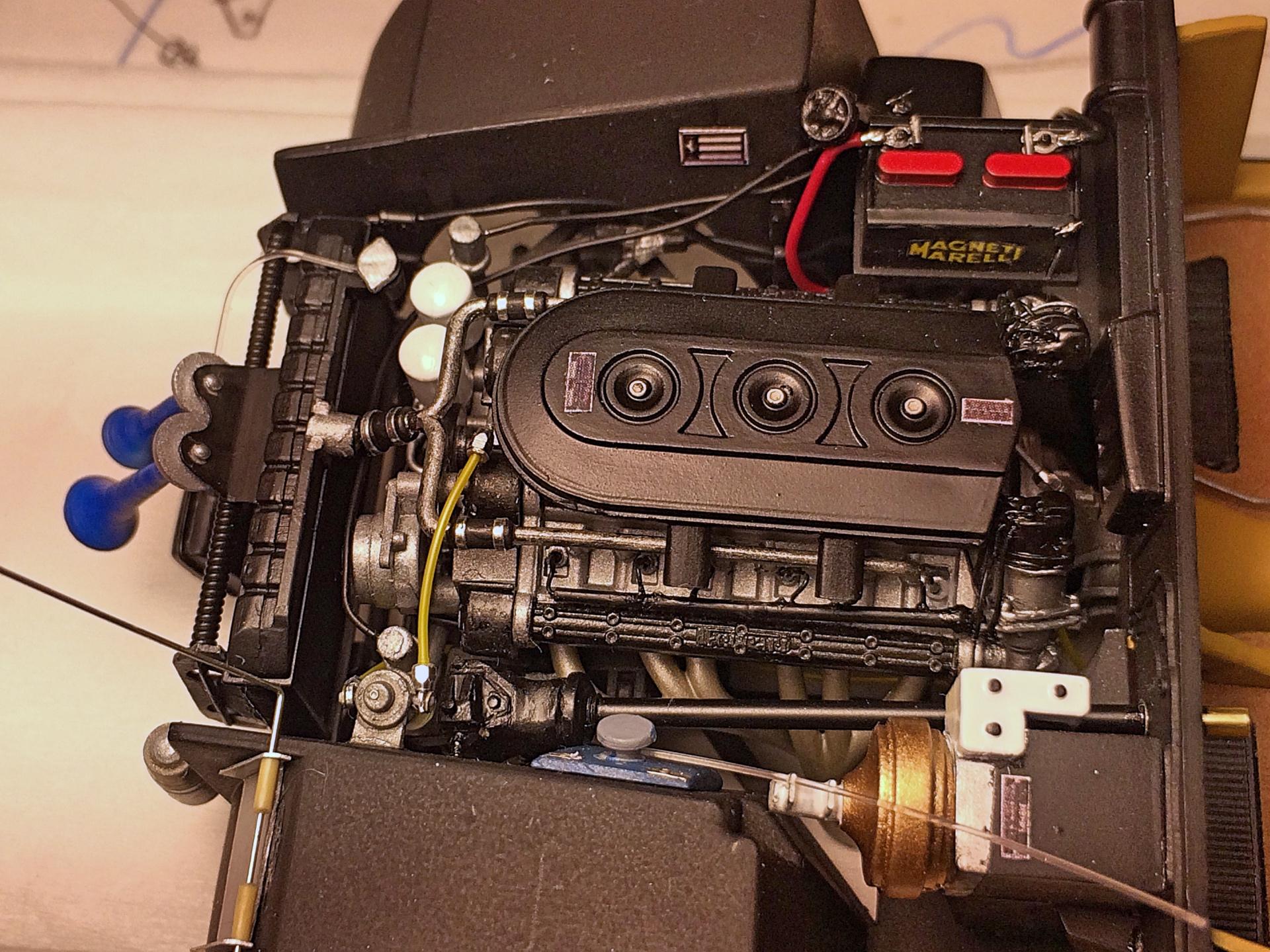

I am certified looney INSANE?  52 glue points (4 for the coils).  Each time I glued an end, must have taken 10 minutes.  Wasn't working to just glue the wire end to the 'tube' loom, so smashed the end with pliers to get some surface area.  Had oversized spark plug holes, but still needed to start at one end and get two glued in, then the other side, then back and forth one at a time, then re-glue what I broke off, then re-drill holes when they came out, then around the merry go round.  At the distributor end, wrapped fine wire around the bunch of wires, and added superglue.  The distributors were just as much of a pain, could have used just a little longer wire, so am sloppy on a few connections.  Even with the holder, rubbed off the coolant paint, so that's now ugly Testors steel.

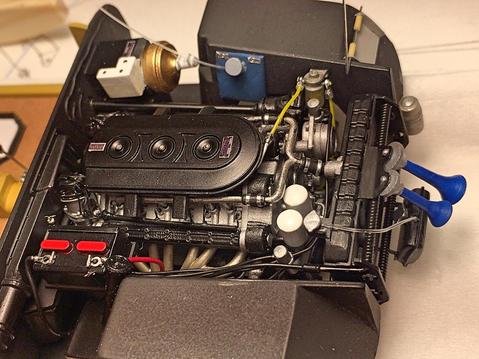

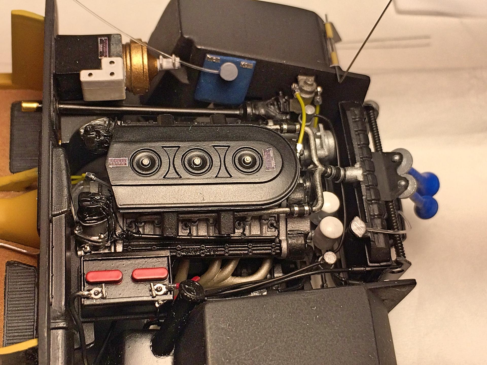

Installed the engine, and got everything hooked up.  Here are most of the detail parts used:
Like plug wires weren't enough to drive me crazy, also have oil lines, I'm sure it's not accurate, but have a loop from pump on the engine front, to the cooler, then to the dry sump tank, then to the pan with a split (I don't even know which direction of flow ?).  Have slightly smaller lines from the draft tubes to the sump tank.  Fuel lines are run, have aluminum clamps.  Battery cables added, positive to the starter, red negative to the frame.  Clear stretched sprue for the windshield washer, and the overflow tank.  My steering box was squeezed in.  The interior tub is now permanently glued in.

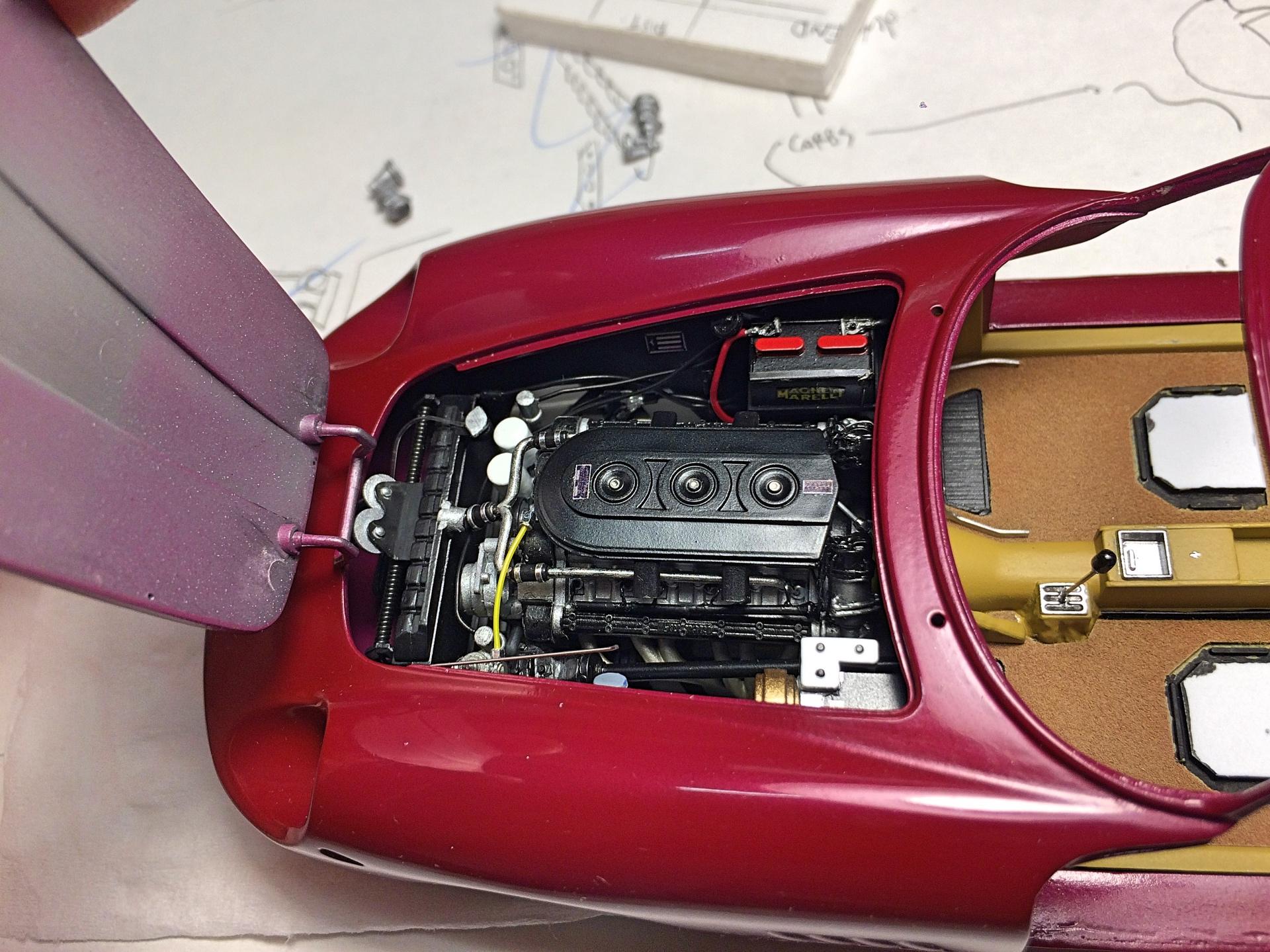

Ok, see how it looks in the body..... oh rats, horns and hinge are conflicting.

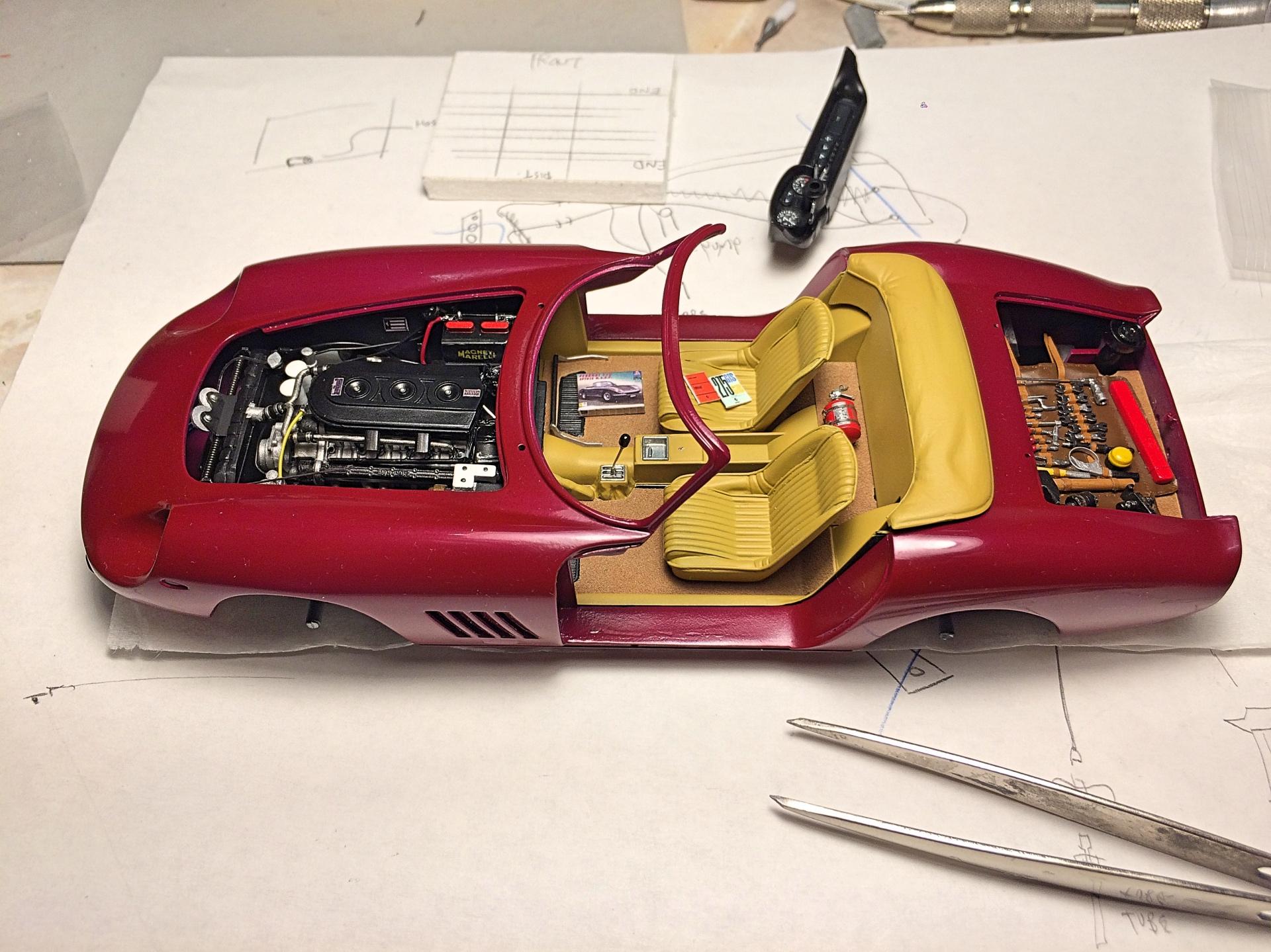

Had to see how the other parts look.  Looking pretty sexy! ?  And I'm really INSANE!
So where are the brake lines on the master cylinder? ;)
You are insane, but that engine is a thing of beauty!  And that tool kit . . . Bellissimo!
Your skills are impressive and your scratch building is nothing short of incredible. You certainly set the bar pretty high in the building world.
You would notice that.  ?  The whole brake part is inaccurate, so seemed pointless to do anything more.  But if you insist on enabling my OCD.....

Thank you!  Brake lines wouldn't show up with this angle. ?

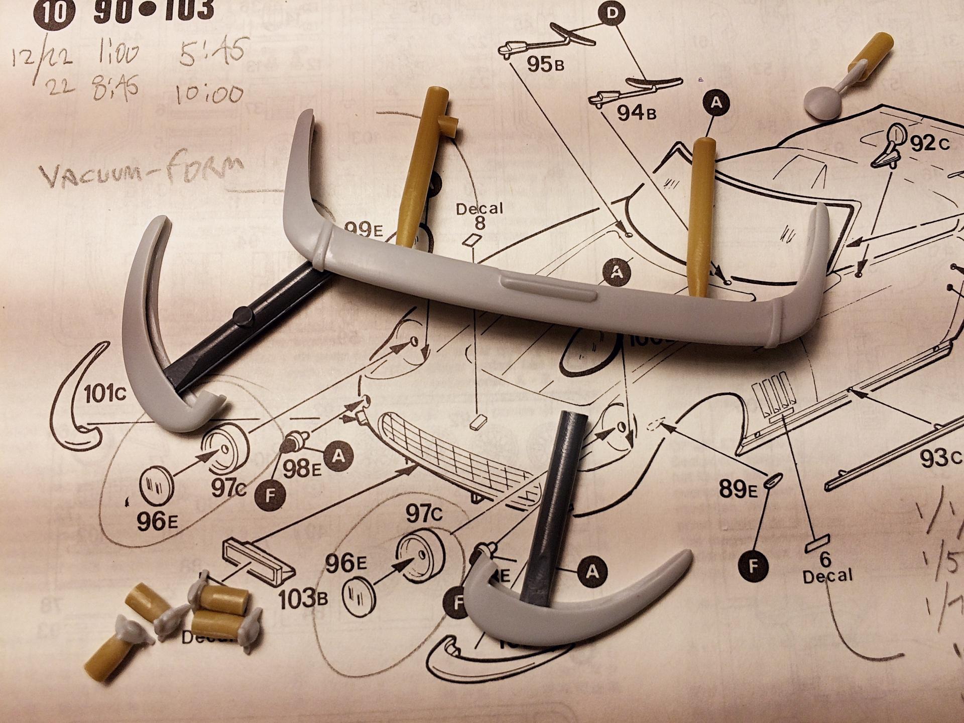

Combining 3 projects to send out parts for chrome.  Glad I decided to do the bumpers, they needed more work than expected.  The mirror needed a tiny ejection pin mark filled, that was on top, and mold line disappeared.  Spinners had two injection tabs to disappear, and the edges needed to be knocked down.  This is when patience will be required.

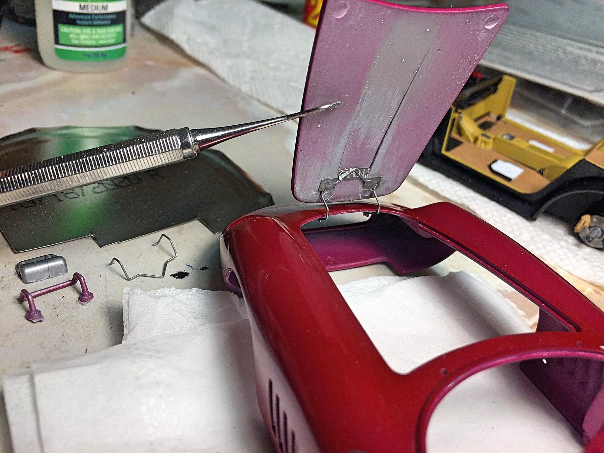

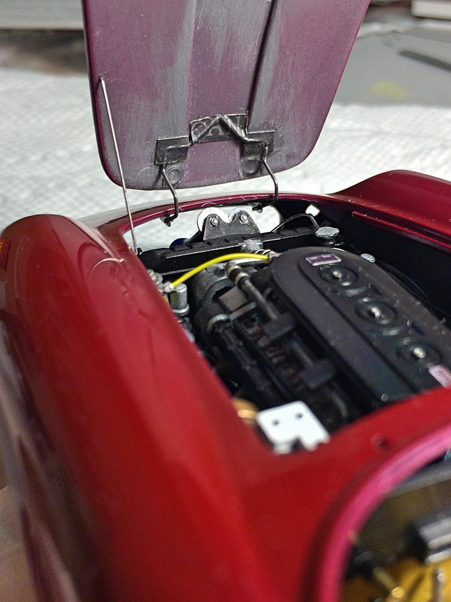

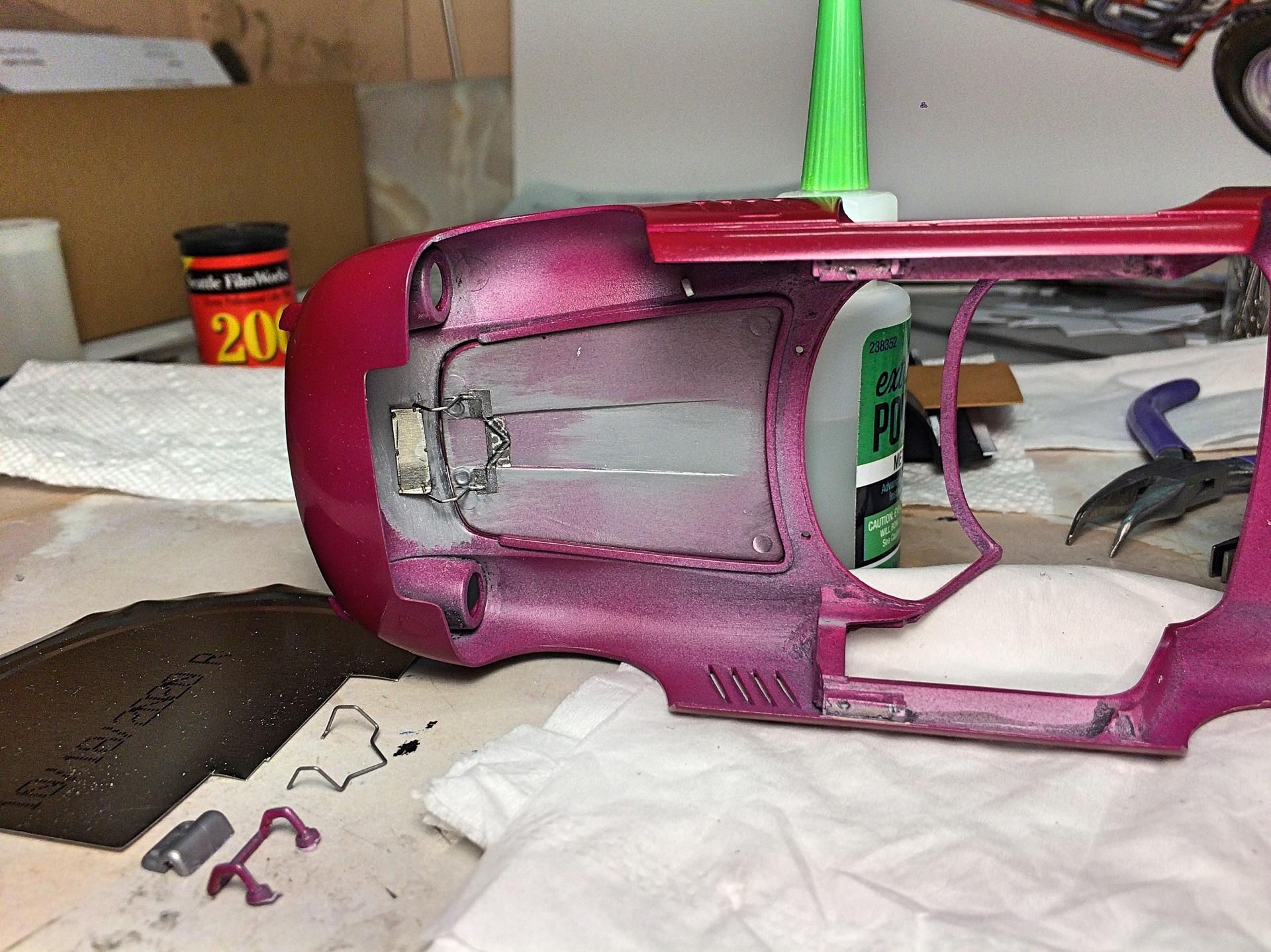

*Had to* redo the hood hinge.  The kit part is just huge to begin with, the fit was very good so had a good example to pattern after.  Took two fabrications with the wire.  Coffee can steel used for the body half.  Laid wine bottle foil over the wire to reinforce.  Took some adjustment of the wire to get it to fit.
The prop rod works great, won't need to hold up with a toothpick.
