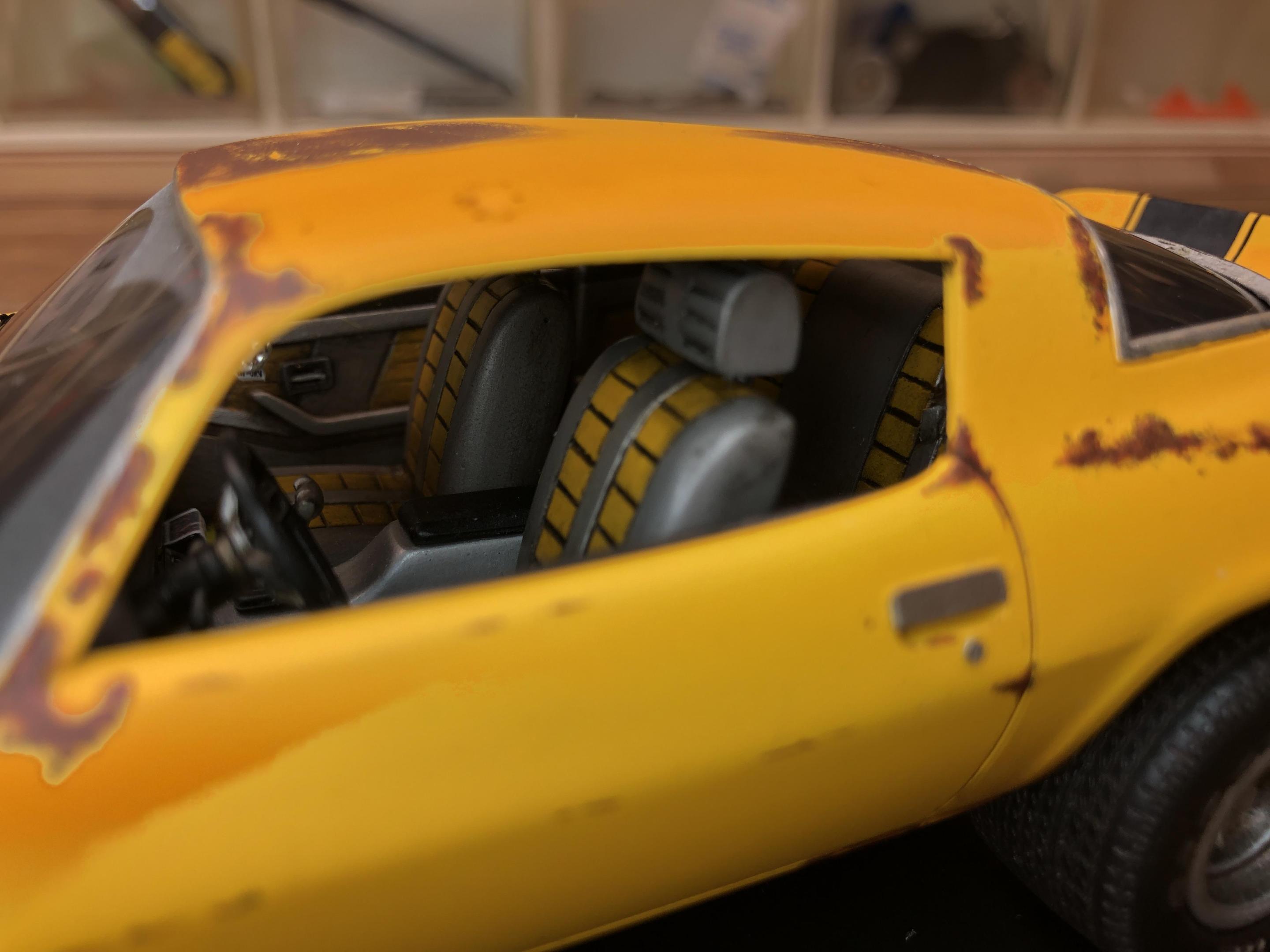

RockinRoller Posted October 26, 2019 Author Posted October 26, 2019 (edited) 18 hours ago, Deathgoblin said: Awesome! I'll "Bee" watching this build. Don't forget the little disco ball and the little "bee-yotch" air freshener. Made the Bee-Otch air-refreshener as a photoetched part and I made decals for it. The disco-ball will be a small pearl I guess. Made the whole interior also with Yellow/Silver and carpet... will make mor photos soon! 7 hours ago, bisc63 said: Who made the '76 Camaro, MPC? Regardless, this is a neat build! Edited October 26, 2019 by RockinRoller

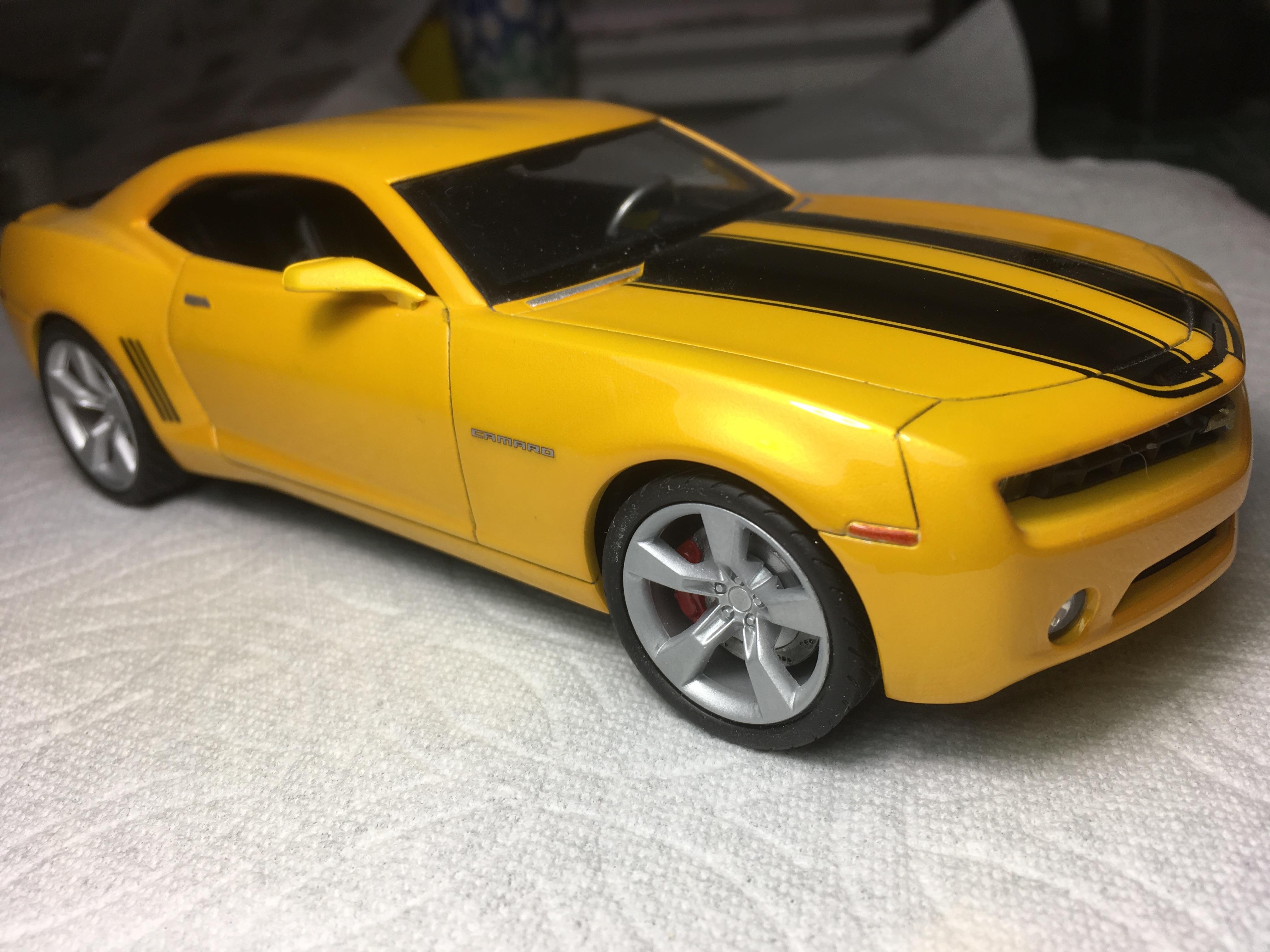

Brudda Posted October 26, 2019 Posted October 26, 2019 Tried to do the bumblebee with the new camaro. Yours is much more fun !!!

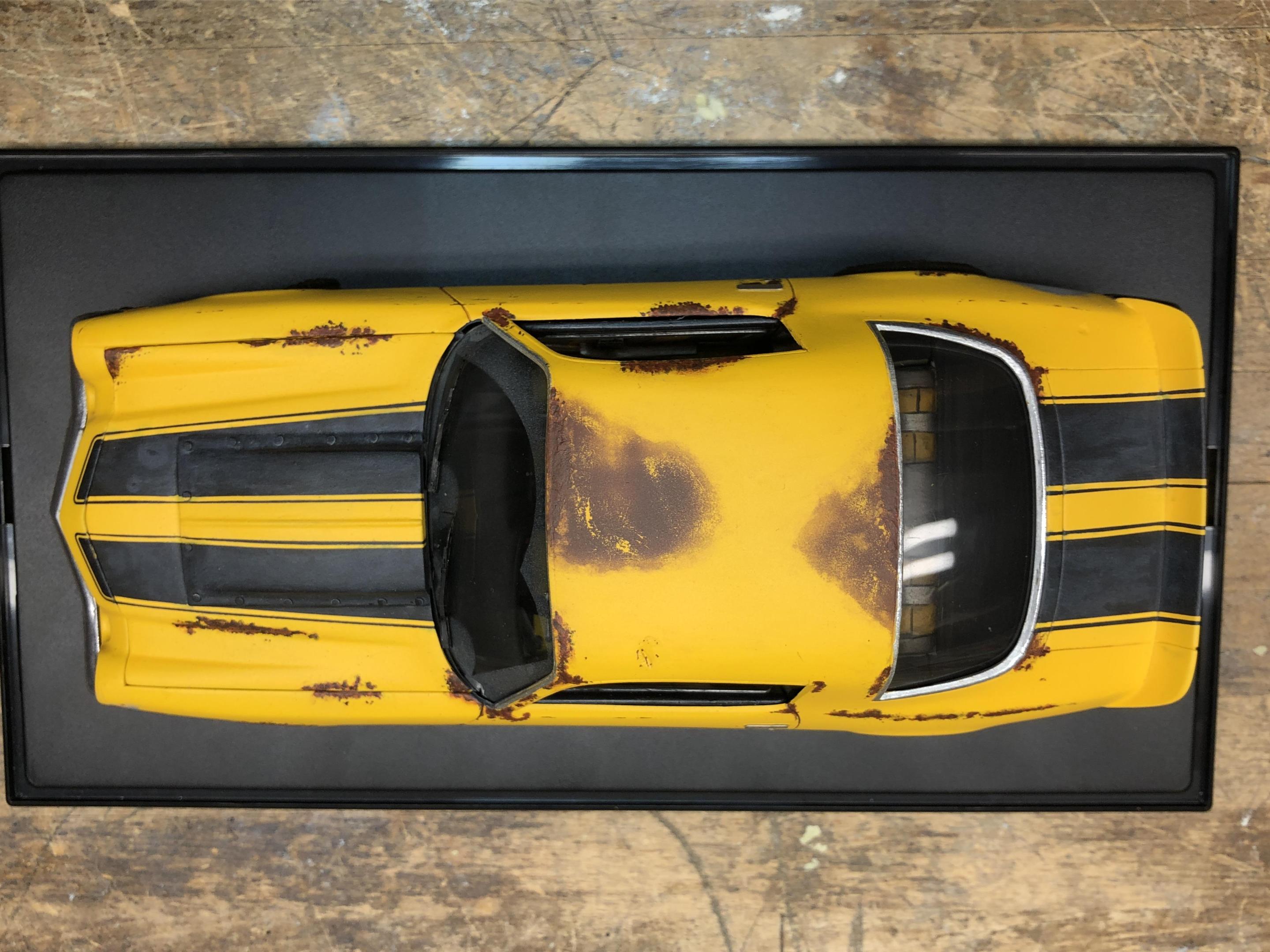

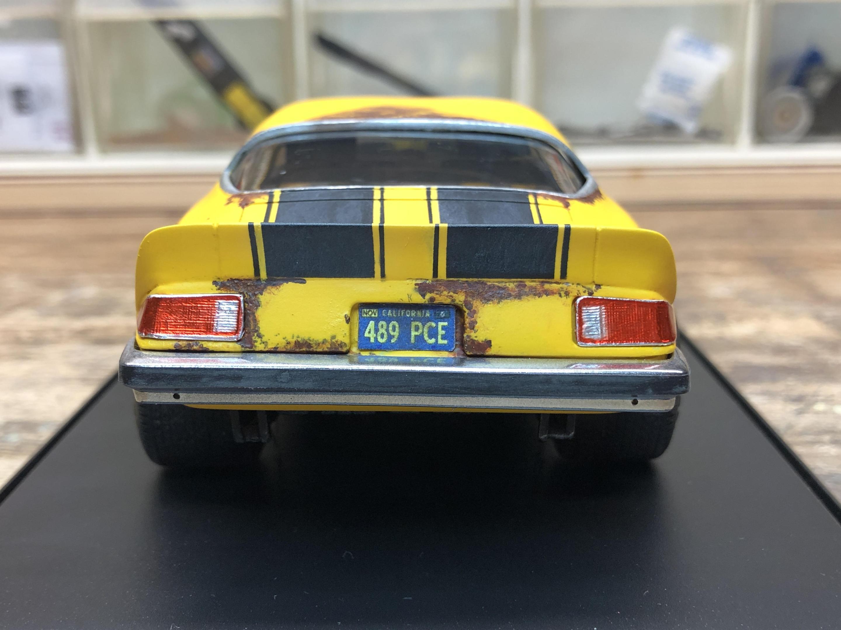

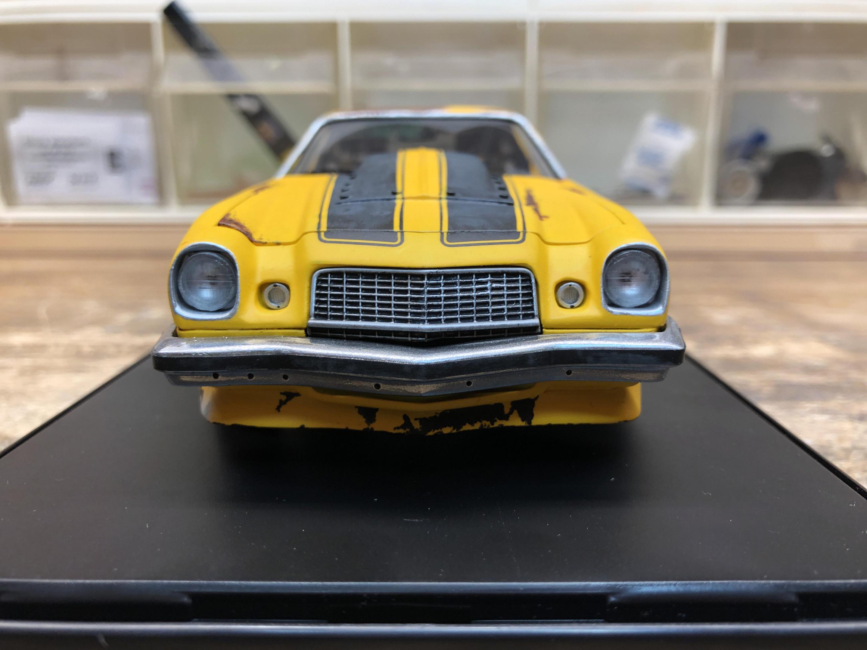

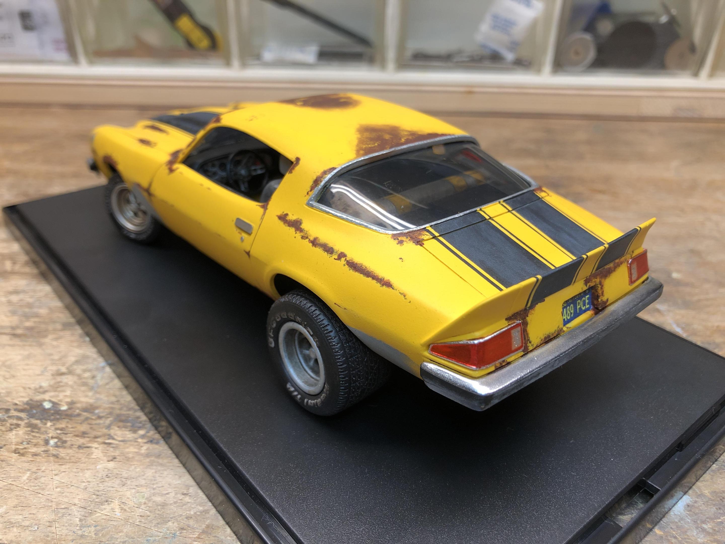

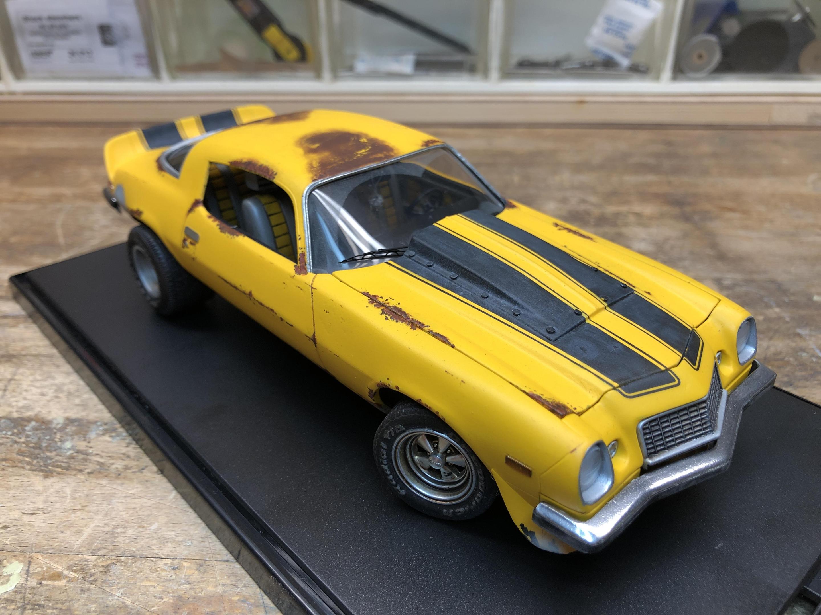

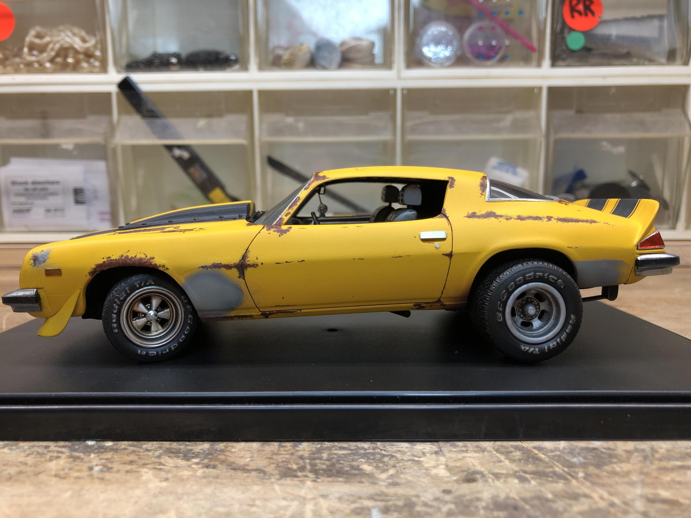

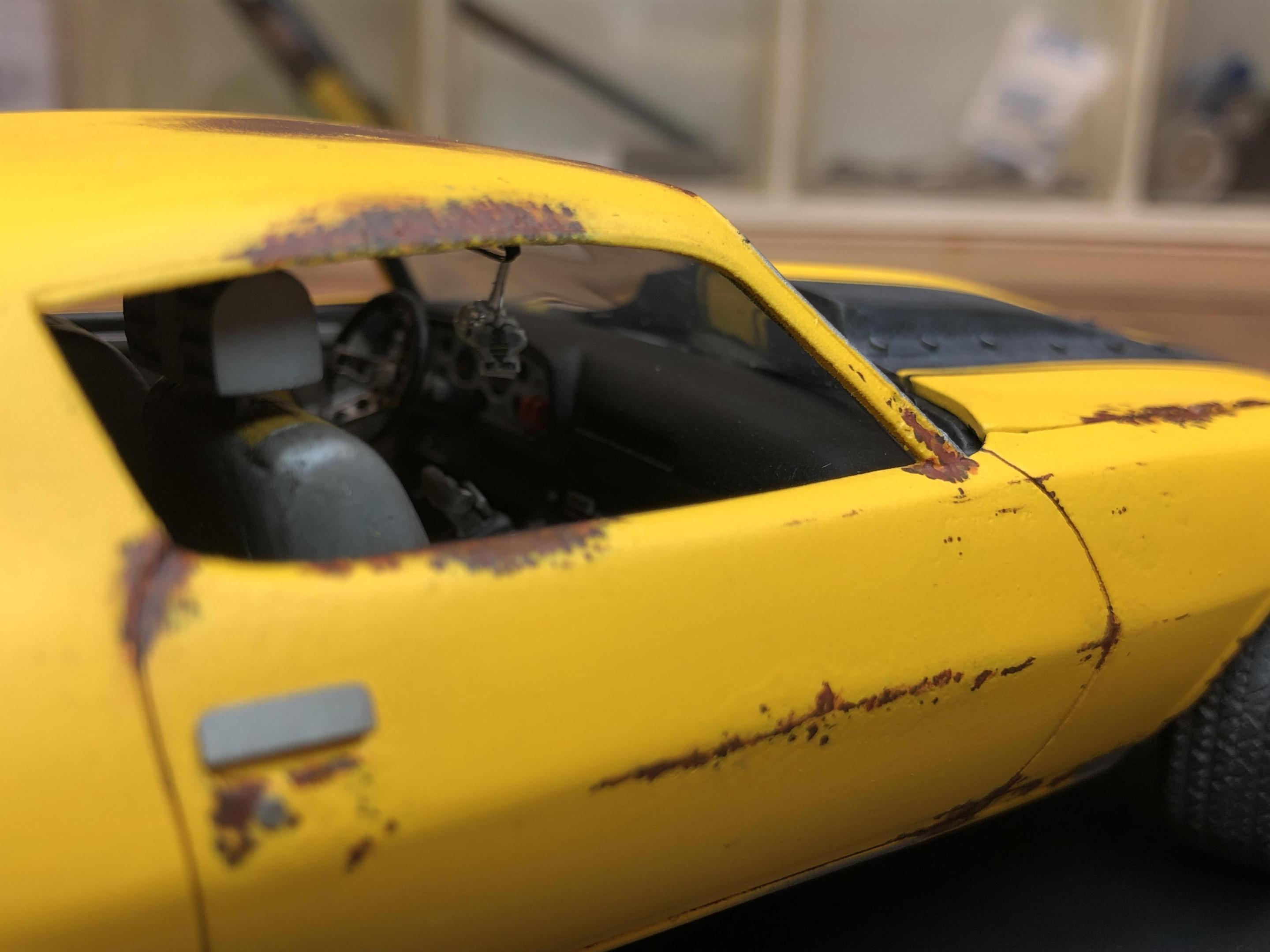

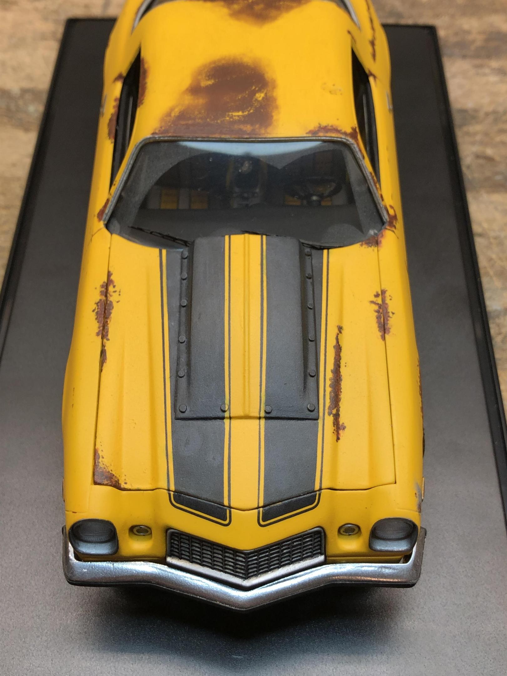

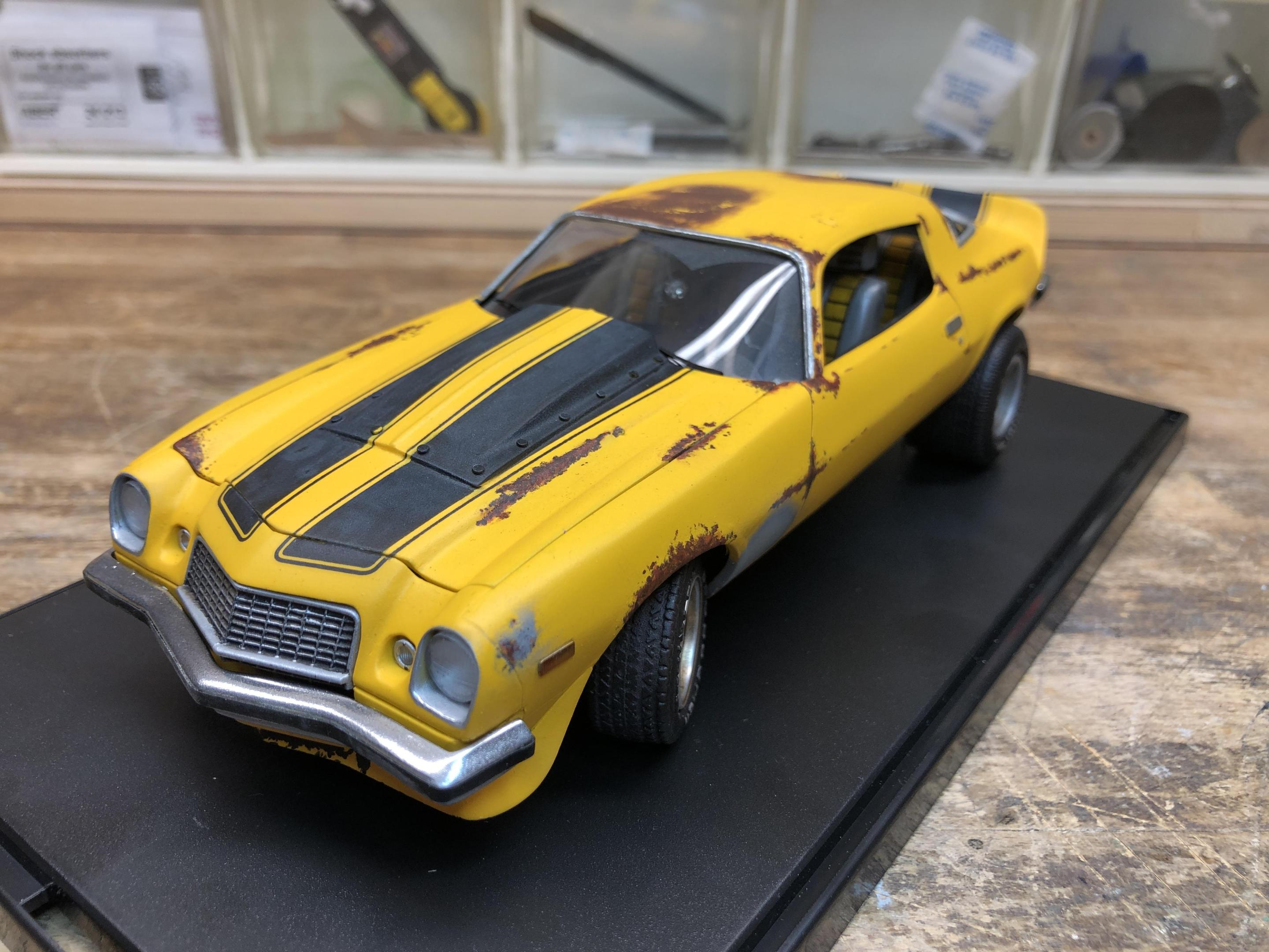

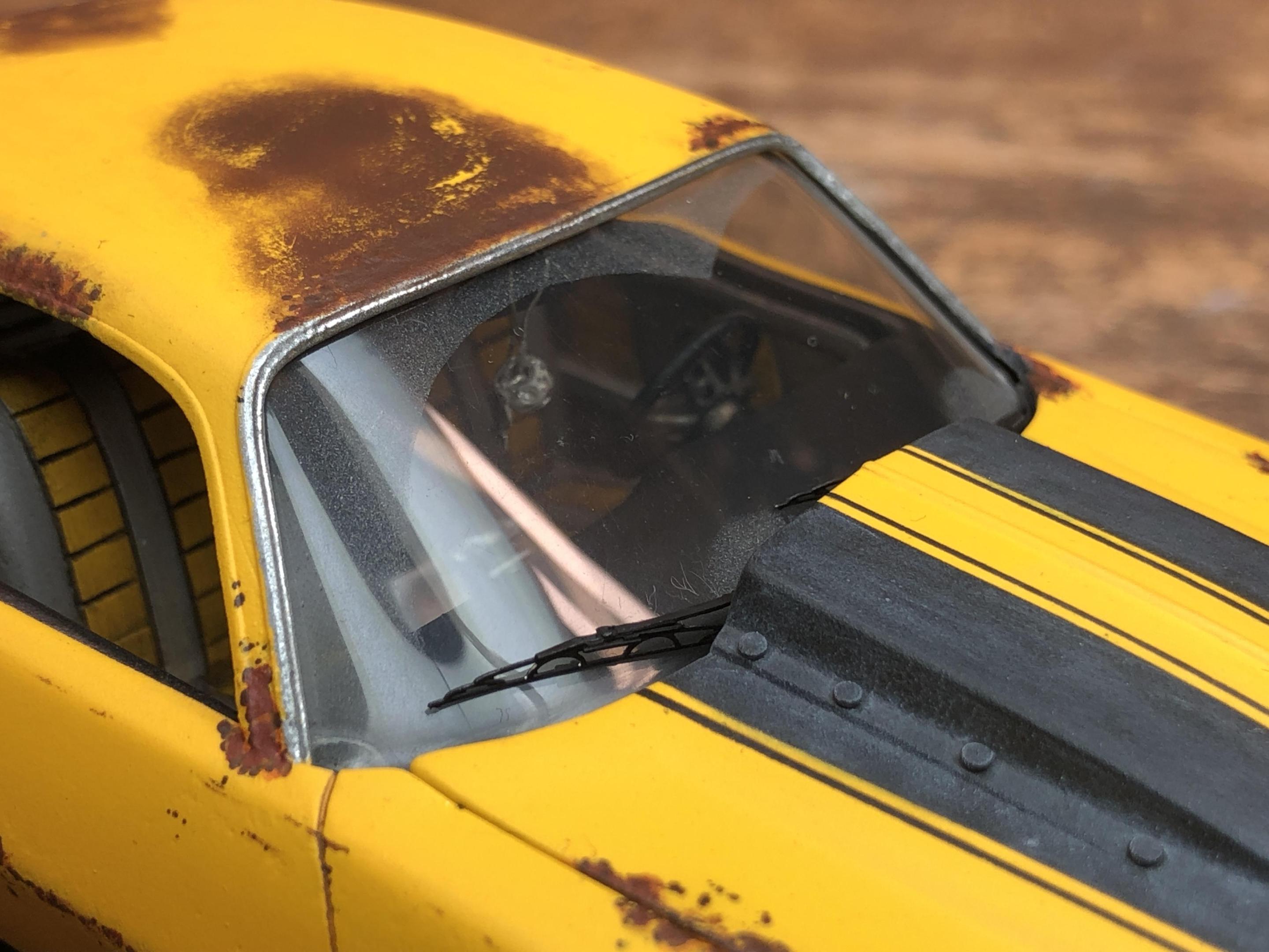

RockinRoller Posted January 29, 2023 Author Posted January 29, 2023 (edited) Done - started in 2009 (I guess) January 2023 its done... OK... still missing the driver side mirror. But I will find one. Started with an mexican AMT 1976 Camaro Kit from Ebay without T-Tops! Undercarriage is from the 70 1/2 Camaro. Interior custommade from sheet, selfmade decals (printed by Decalprint.de) selfmade PE-parts for bee otch refresher. Bumpers shortened, rubber bumpers are black electrician-tape (Coroplast) secured with second-glue, rear tires are cutted viny BF_Goodrich tires - widened by glueing two-together an cast them in resin. Taillights made from two pieces - foiled with bare-metal foil and airbrushed with Tamiya clear paints. Tamiya primer, paints and Mr.Hobby /Gunze Topcoat. Stripes are airbrushed by myself. Rust and weathering by AK-rust set... sealed with Gunze topcoat-flat. Try to replicate every piece of weahthering as correct as possible. Use white pigments for weathering the stripes and create the DVD-shaped imprints on the hood. Greetings Oliver Edited January 29, 2023 by RockinRoller 5

RockinRoller Posted February 2, 2024 Author Posted February 2, 2024 Thank you all very much... it looks better when you see it with the natural eye in a normal distance! To be onest it was not easy to "polish a turd" (quote - junkjard-owner in the movie Christine)... these kits are a hell to work with... thick material, all softener long gone from plastic, lack of detail... I´m nt 100% satisfied with it, but it was the best I could do to it. That´s my honest feelings about that build. Got the missing sideview mirror from a friend now... so it can be completed soon! Thanks again! Oliver
