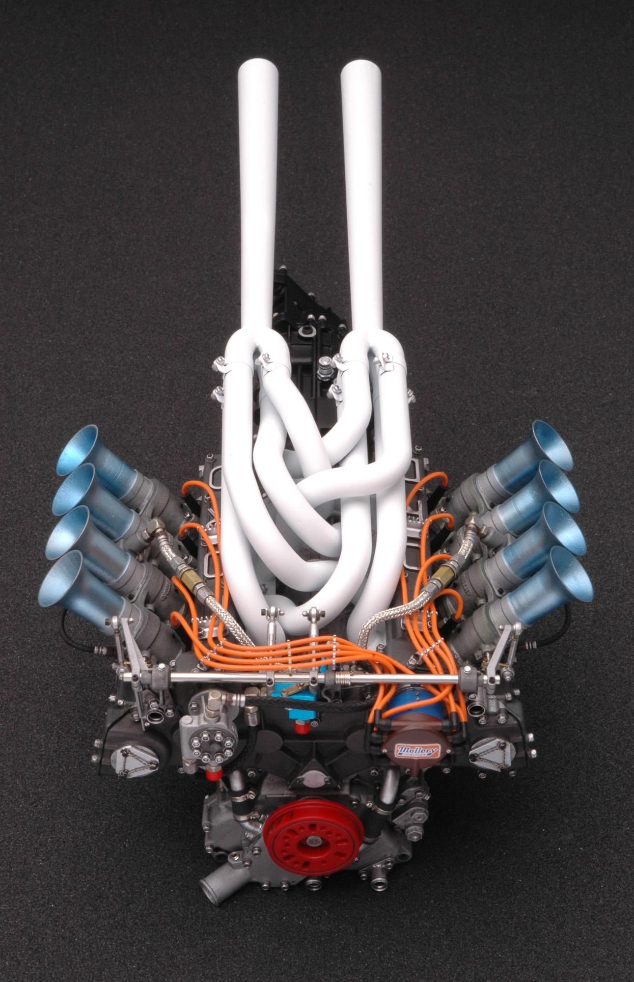

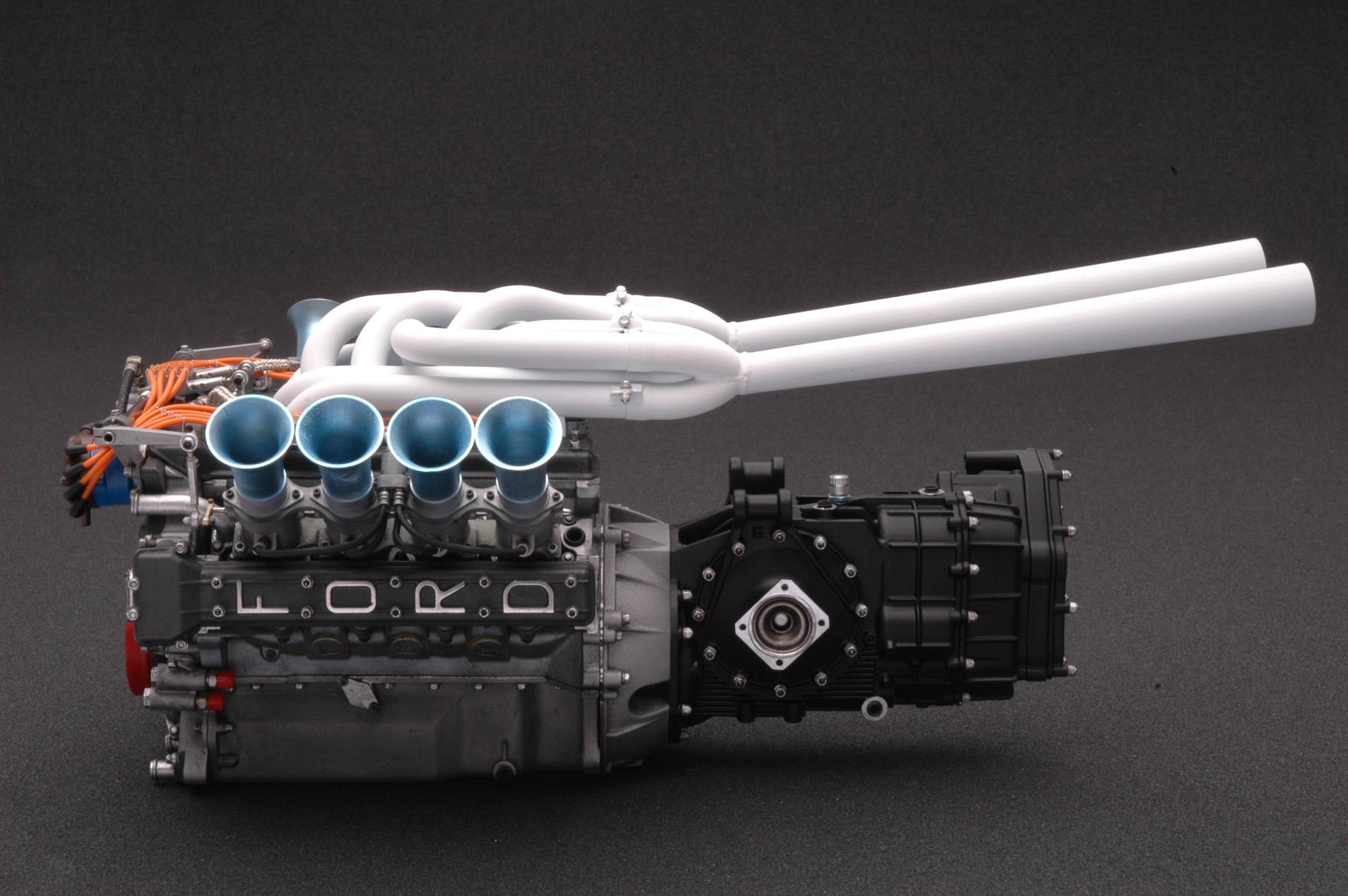

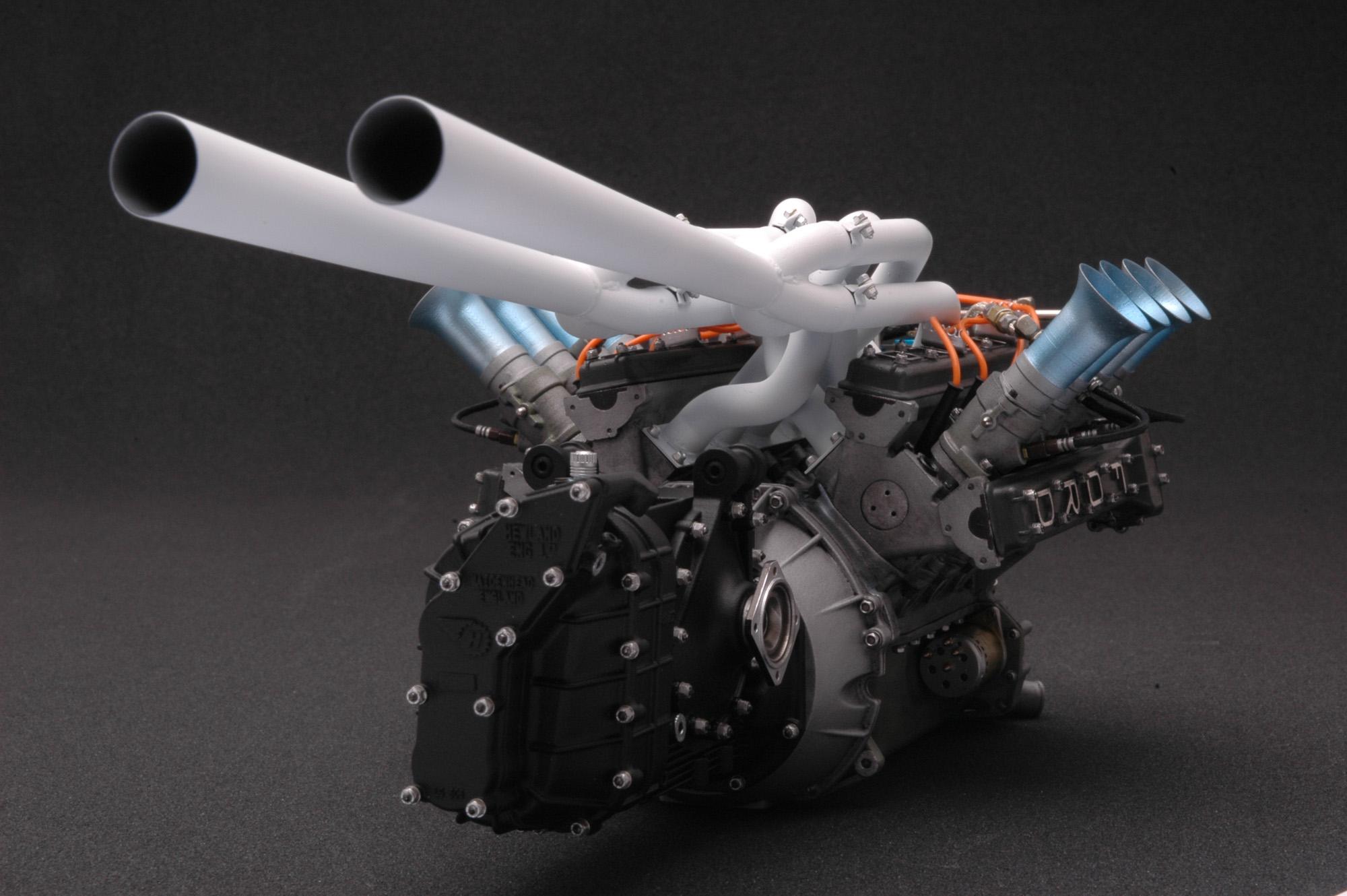

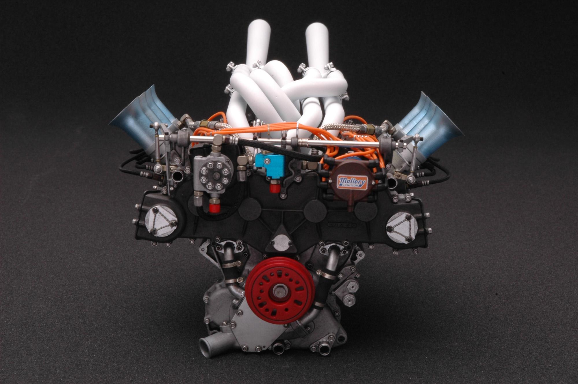

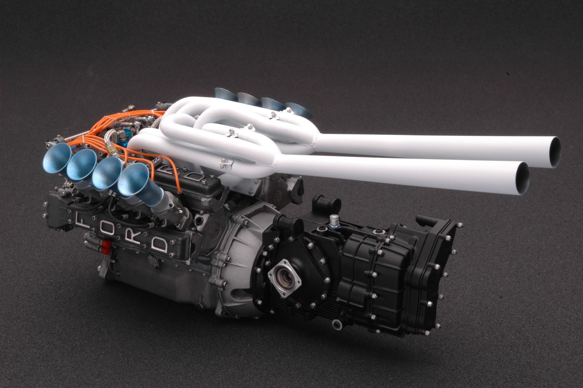

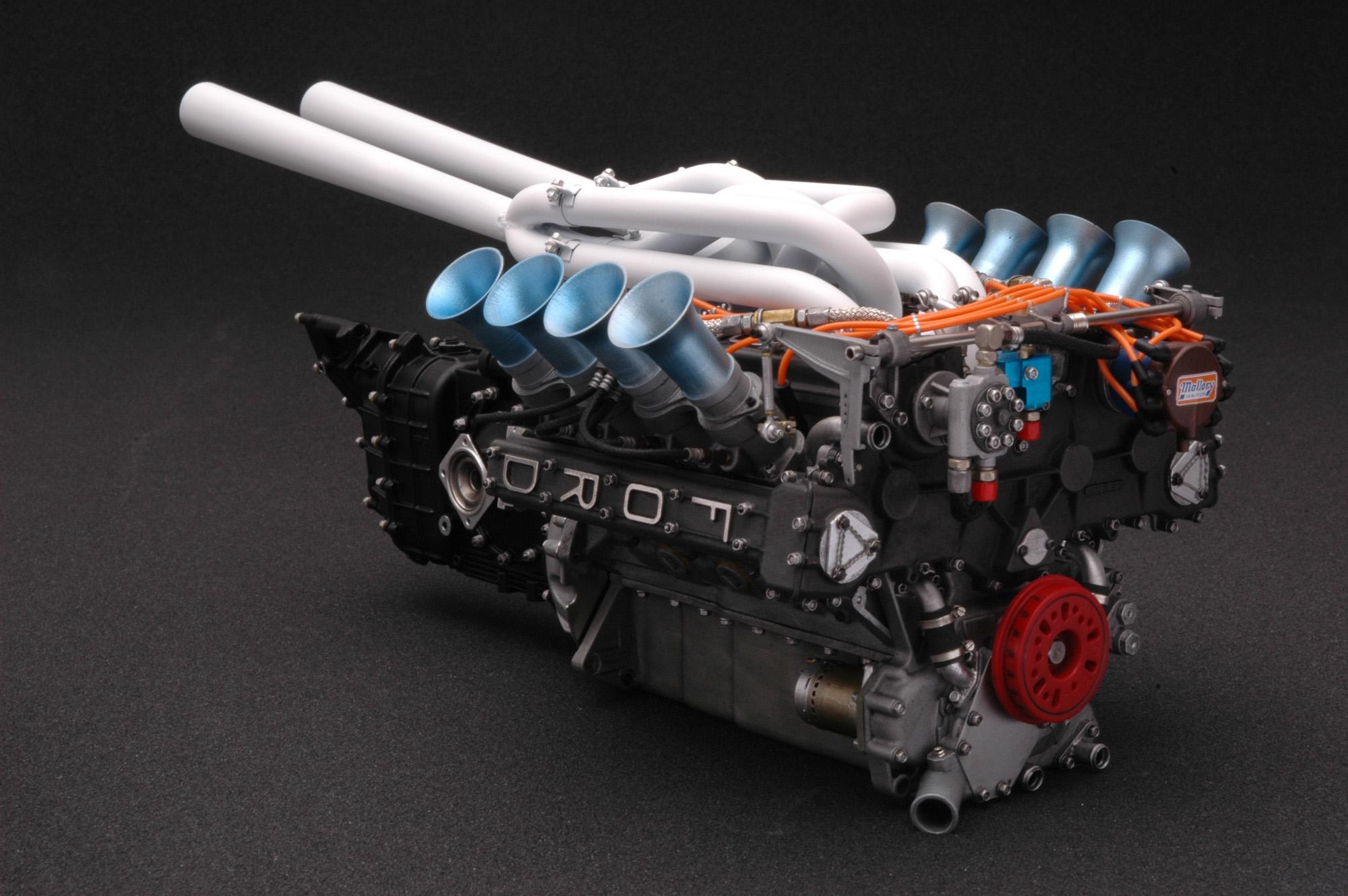

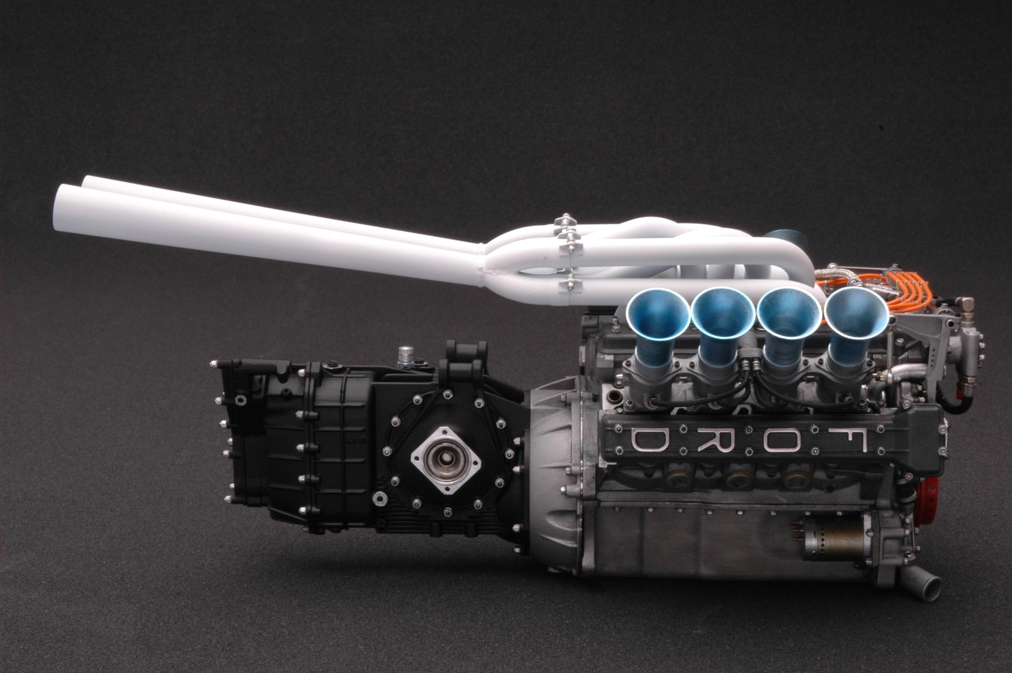

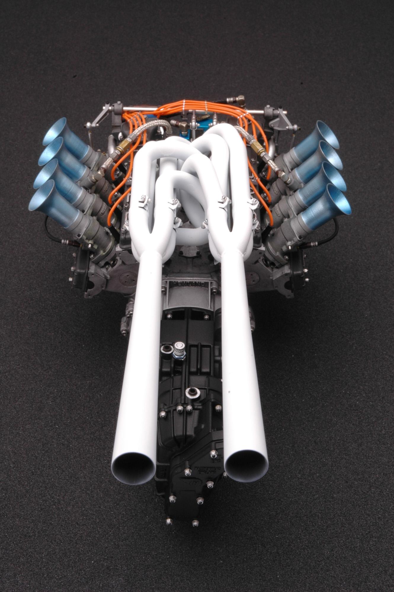

I just finished one of my long-run projects, another 1/8 scale engine model  - the 1965 Ford V8 DOHC competition engine, also known as the Indy.
It's a special machine, an important part of racing history in my opinion and thankfully one with a complete handbook available.
First of all I want to thank John for doing a superb job on most of the CAD drawings, I did the auxiliaries and the Hewland gearbox.
As usual this is a full scratch build about 22cm long using 3d printed parts mostly, some of them molded in silicone and cast in resin; the whole project took about six years.
For now I'll post pics of the finished model and add some WIP pics later.
I've heard several people say that a 1/8 model kit of the Indy was available some time ago,
if anyone has info or even pics of that it would be really great to hear about it.
Alright, here are the pics, I hope you enjoy them!

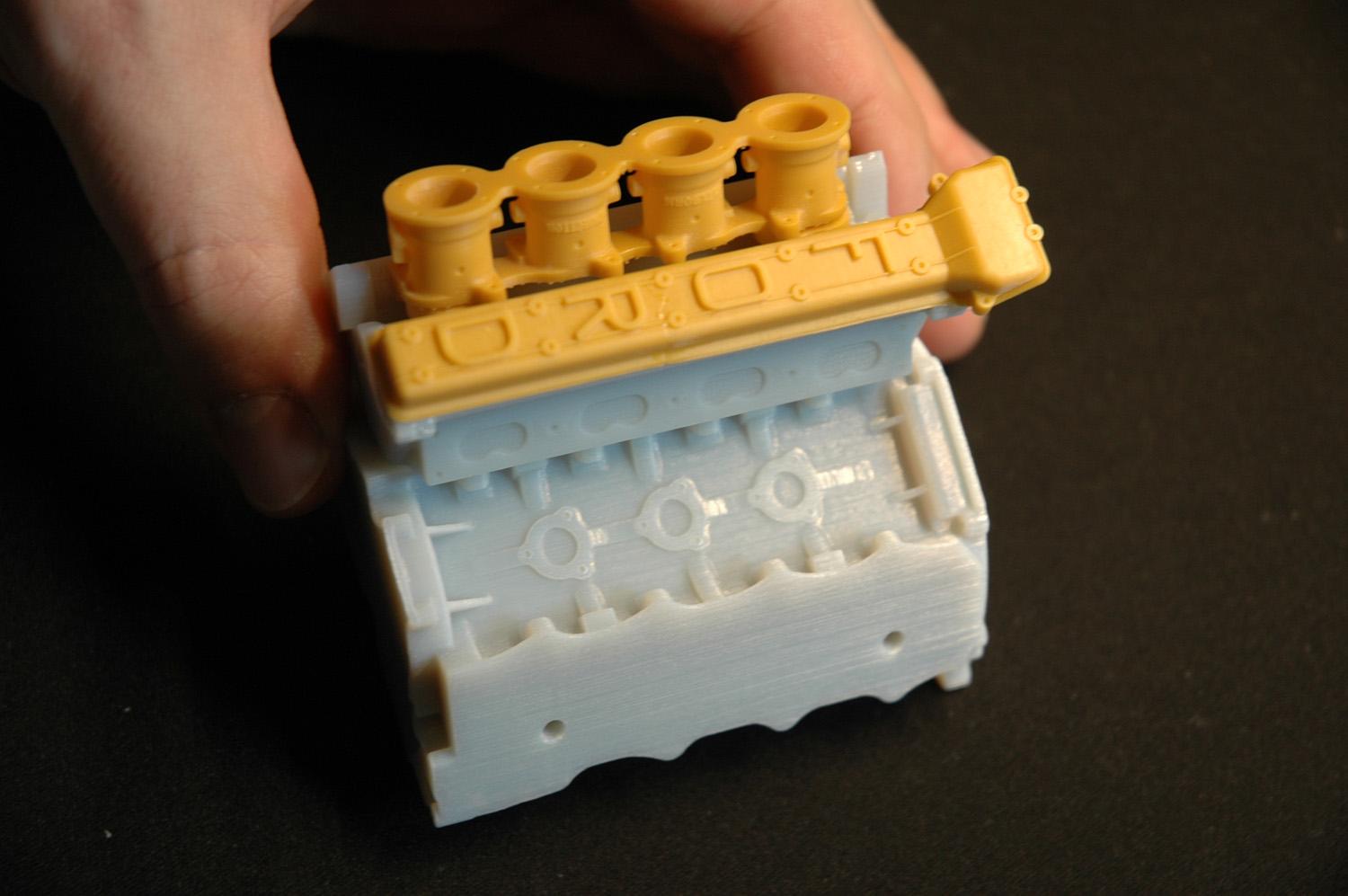

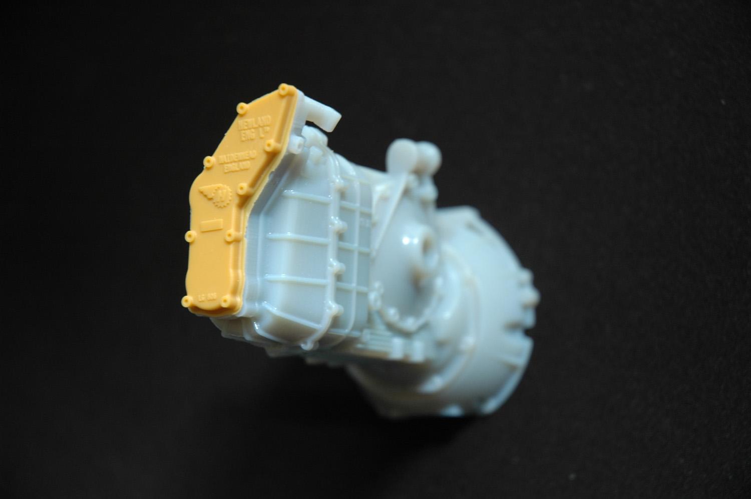

Now for a little "making of": the following three pics show the test fitting of the first printed parts. You can easily see the quality differ from the Objet/Stratasys parts to the Asiga parts (the yellow ones). Those blue parts need a lot of sanding and primer.

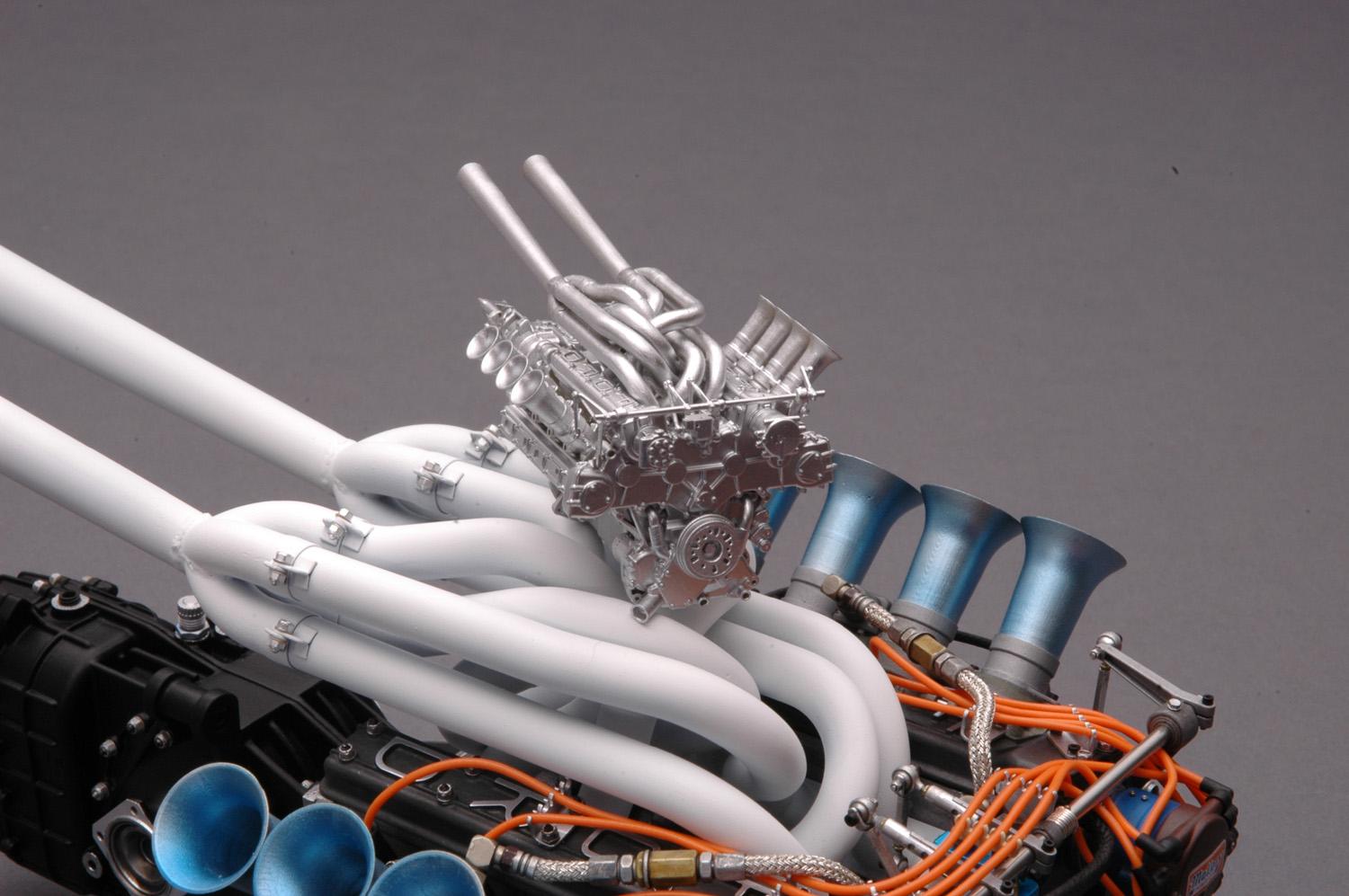

Here are some of the auxiliaries, ready for assembly, and a pic of all the stuff that went into the engine front.
