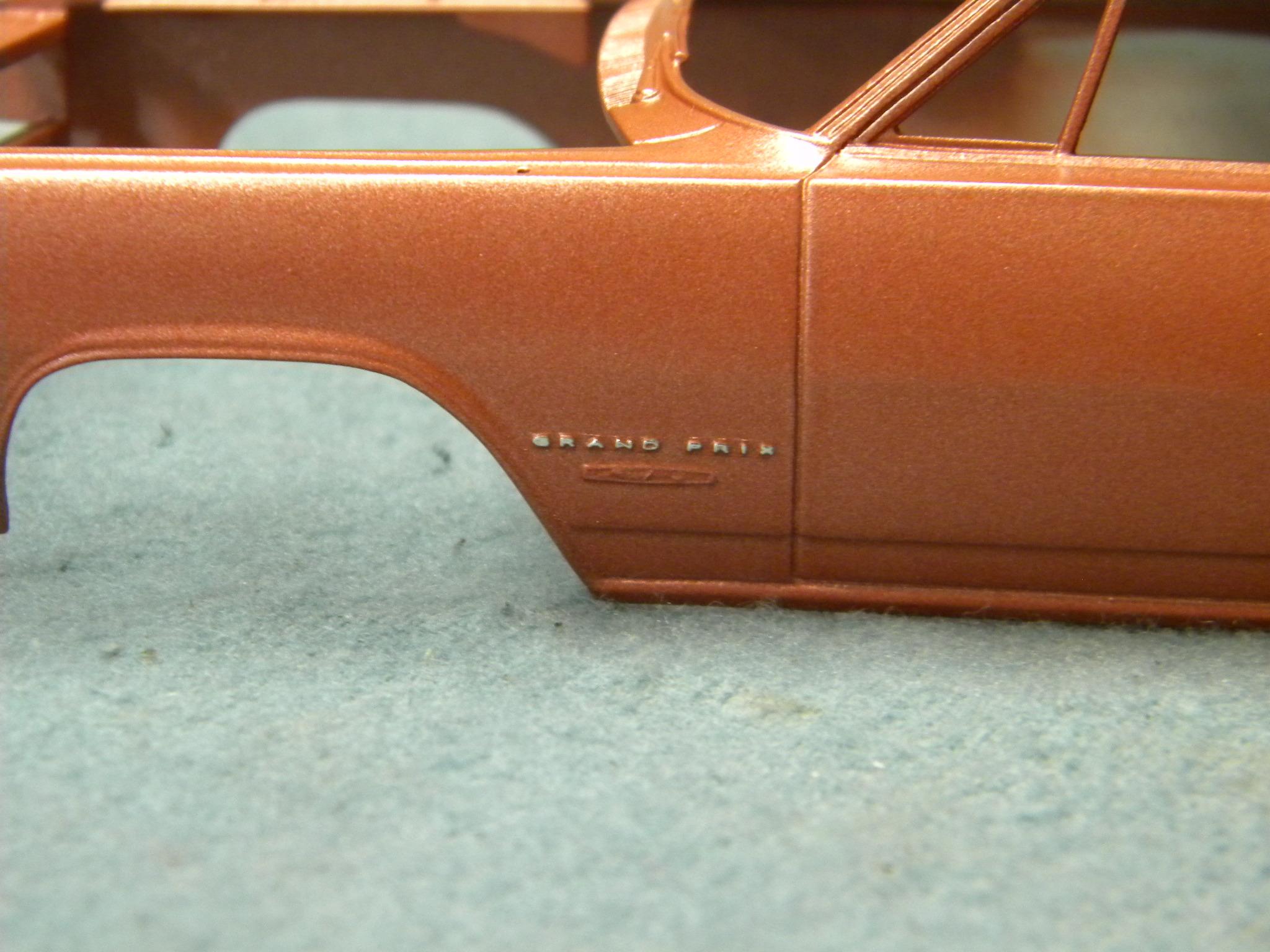

StevenGuthmiller Posted May 30, 2020 Author Posted May 30, 2020 3 hours ago, slusher said: Beautiful color Steve! Thank you Carl! Steve
beeRS Posted May 30, 2020 Posted May 30, 2020 Sunfire Red looks ace, as does that foilwork. This going to be real special!

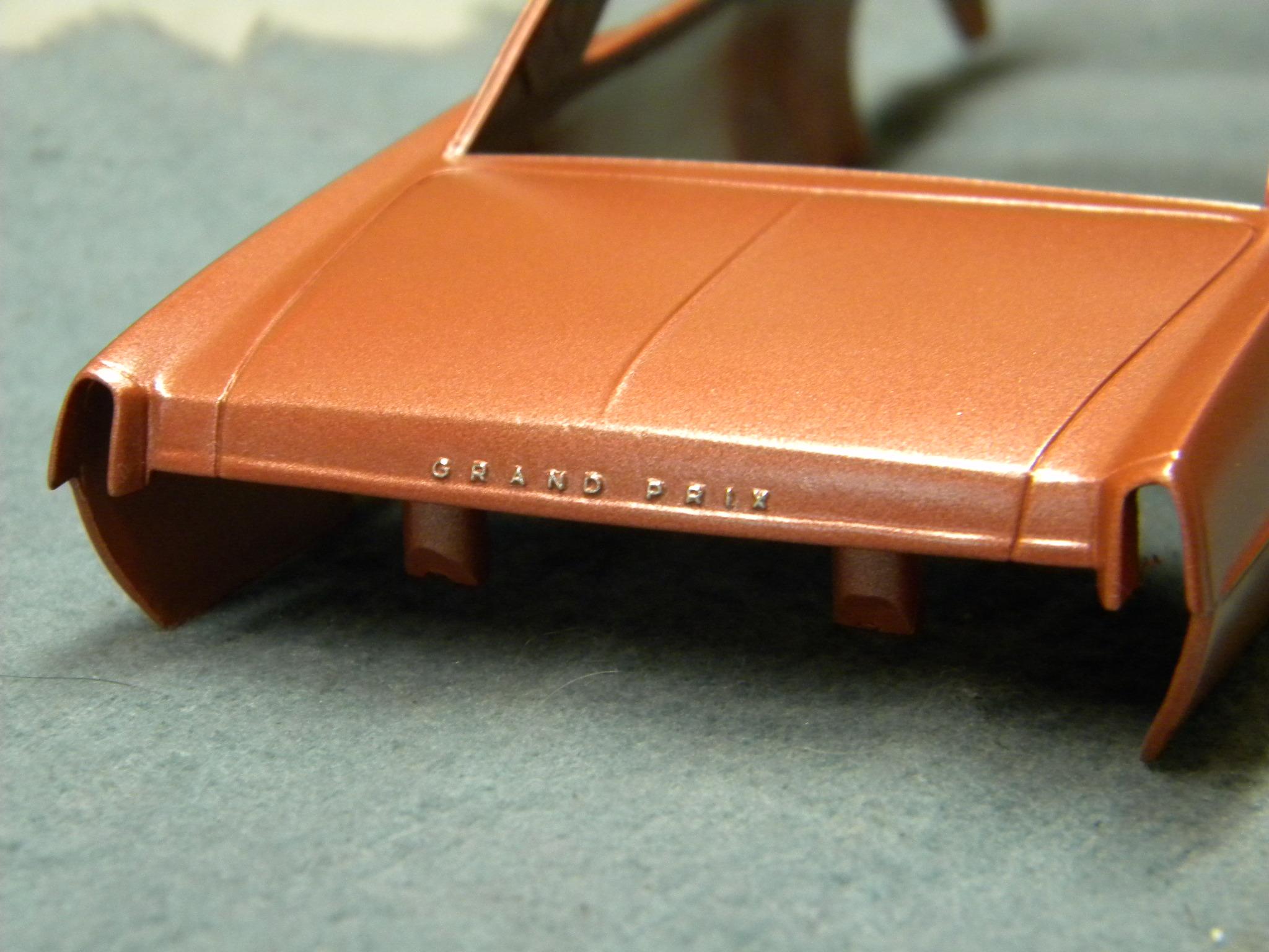

StevenGuthmiller Posted May 30, 2020 Author Posted May 30, 2020 7 hours ago, beeRS said: Sunfire Red looks ace, as does that foilwork. This going to be real special! Thanks Sonny! Last night I applied the first coat of Duplicolor clear. Today I foiled and detailed the G/P badges on the front quarters as well as the hood badge, followed by another coat of clear. Over the next 36 hours, I will apply another 2 or 3 coats of clear and then it should be ready to polish and foil. Steve

StevenGuthmiller Posted May 31, 2020 Author Posted May 31, 2020 Thanks everyone! Spent a little time doing some interior stuff this afternoon and will hopefully get one more clear coat on the body tonight. 1 hour ago, gotnitro? said: The sunfire red is already getting a depth and richness to it! Do you shoot your duplicolor clear right from the can or airbrush I shoot it right out of the can. The fan spray nozzle on Duplicolor cans spray so well that I really don't believe that I could do a better job with an airbrush. Steve

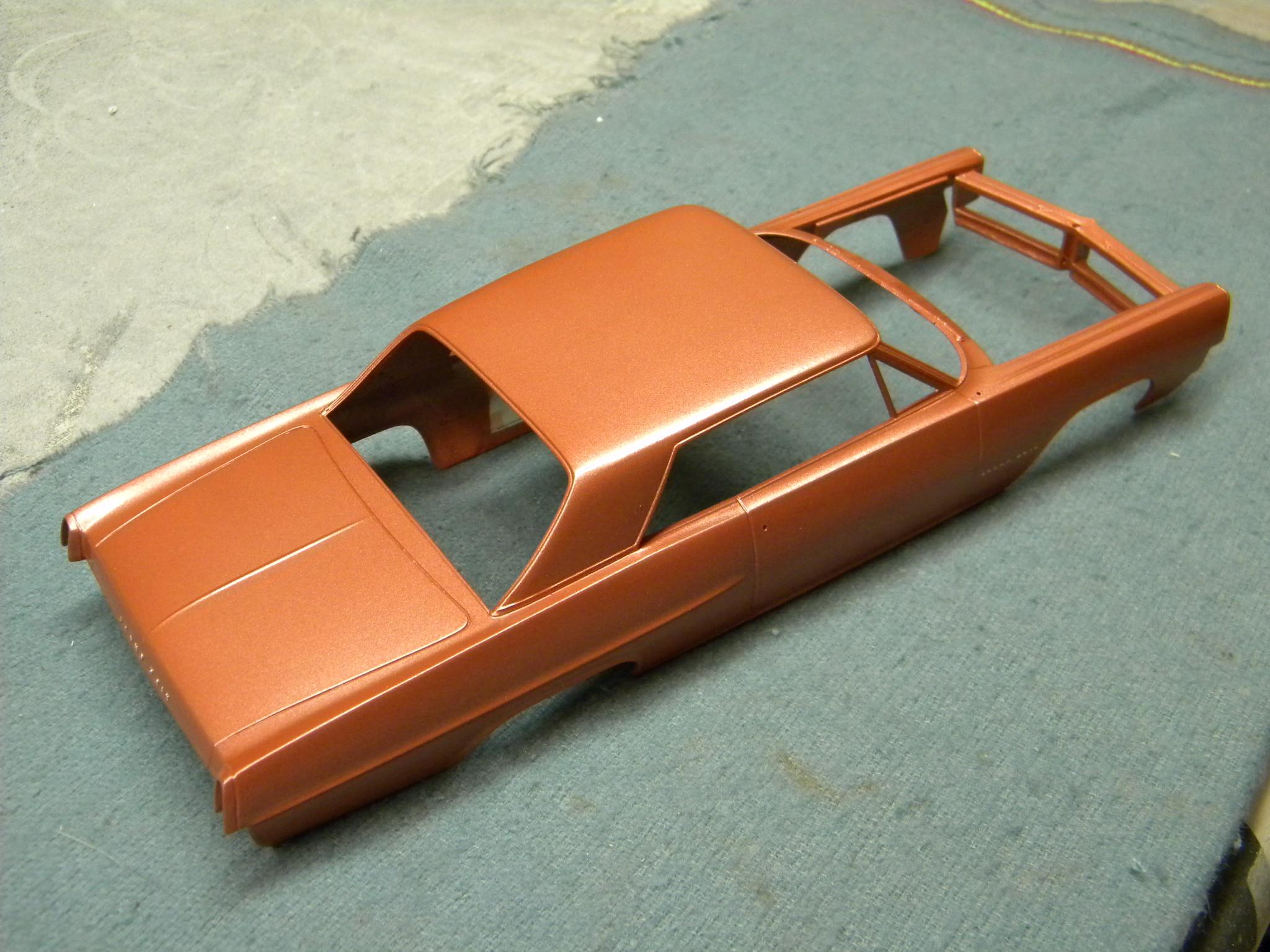

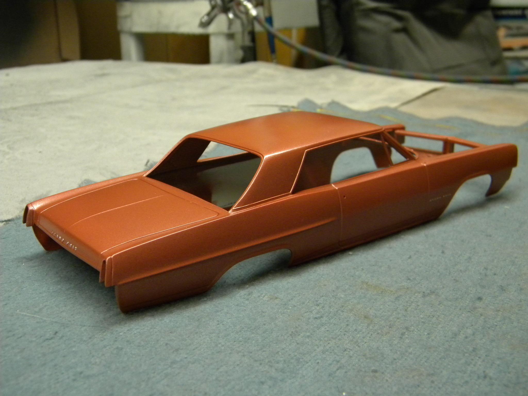

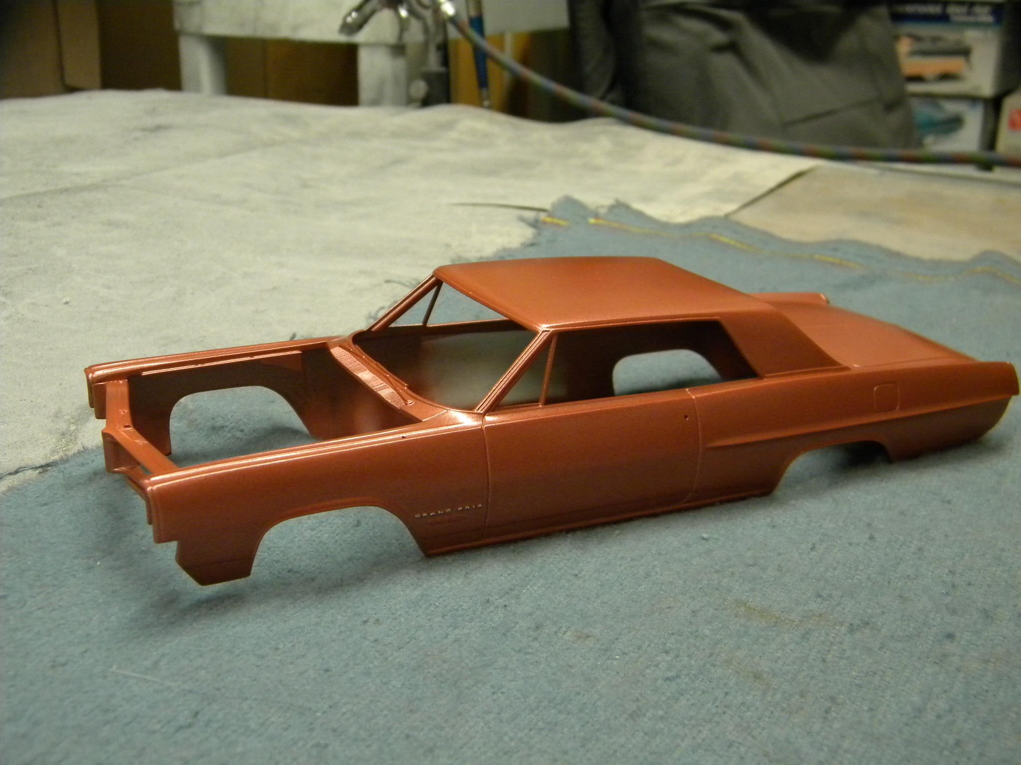

StevenGuthmiller Posted May 31, 2020 Author Posted May 31, 2020 7 hours ago, Scott8950 said: Steve that foil work is absolutely impressive. Im sure it takes a little practice to get it down but you've clearly mastered it. The car is looking great. Thanks Scott! I finished up the clear coats today. I have to say that I'm not entirely happy with the paint job. I used my smaller Badger airbrush for the final color coat because I wanted to open it up to get a wetter coat. My PS-290 does a marvelous job of covering a wide area, but it goes on in lighter coats. Unfortunately, I wound up with some color variation if you look squarely down at the roof, trunk lid and hood, due to the overlap of the passes. This was not evident at all in the color coats until the clear started to go on. I should have given the body another light coat with the PS-290, but I didn't see any issue until clear began to go on. I will not make this mistake again. Anyway, it's not a major problem, but you know how little things like this can bug a guy. The issue is almost completely imperceptible in full sunlight, but if you are looking for it, you can see it in unnatural light. Now the question is, leave it, or completely strip it and start over? I hate to think of starting over. These photos illustrate what I'm talking about. What do you guys think? Bad enough to do over, or good enough to leave alone? Steve
Bucky Posted May 31, 2020 Posted May 31, 2020 So many considerations here, Steve. You've done a lot of great foil work on this one, that would be sad to lose. Also, who's to say the same problem won't show up, again. I've never thought about it, but could you shoot more color over the clear coat you've already done, and go from there?
Geno Posted May 31, 2020 Posted May 31, 2020 (edited) Steve, I'd leave it alone. I've seen new 1:1 cars waaaay worse than that from the factory. That looks nearly imperceptible to me. And absolutely beautiful.? Edited May 31, 2020 by Geno
StevenGuthmiller Posted May 31, 2020 Author Posted May 31, 2020 24 minutes ago, Bucky said: So many considerations here, Steve. You've done a lot of great foil work on this one, that would be sad to lose. Also, who's to say the same problem won't show up, again. I've never thought about it, but could you shoot more color over the clear coat you've already done, and go from there? Thanks Keith. The foil work is the very least of my worries. I've done that so often that I can do it in my sleep! It is possible to shoot color over the clear, but by the time I shot another coat of color over the clear and then added sufficient clear coats over it again, there would be no definition of detail left whatsoever. I thought about just repainting the hood and masking off for repainting the top and trunk lid only, but decided that the likelihood of a color match would be virtually zero. And as you said, there's really no guarantee that something similar wouldn't happen on the second go around, although I am extremely confident that if I had used the PS-290 air brush, this would not have happened in the first place. As I said, I will not make the same mistake again. I should have known better! The only real options are to leave it as is, or to admit defeat and do a complete strip and repaint. Steve
StevenGuthmiller Posted May 31, 2020 Author Posted May 31, 2020 38 minutes ago, Geno said: Steve, I'd leave it alone. I've seen new 1:1 cars waaaay worse than that from the factory. That looks nearly imperceptible to me. And absolutely beautiful.? I appreciate your vote of confidence Gene! My only issue is that I would probably have been taking this build to a couple of shows within the next year or so, and as always, was hoping for perfection. But, I guess that I should know better. There really is no such thing as perfection, at least not with my projects. Steve

StevenGuthmiller Posted June 1, 2020 Author Posted June 1, 2020 Okay guys, I appreciate all of your help. My wife reminded me, as some of you have, that if I don't strip and repaint, all that I will do for the next 2 years is piss and moan about how I should have re-painted it! So I ordered another bottle of paint from "Scale Finishes", (just to be safe) and into the pond it went! No turning back now! I guess at this point, if I have nothing else, I do have time. With any luck, the Super Clean won't destroy all of my body work. '64 Grand Prix paint job part 2 coming up. Steve
Can-Con Posted June 1, 2020 Posted June 1, 2020 Well Steve. Since you've already decided to repaint it might I suggest sanding off the wipers and replacing them with photo etched ones? I didn't bother doing that on mine but I'm not putting all the extra details into it you are either. Your car deserves them though. I think I would have just misted in a light coat of red on the horizontal surfaces, just thick enough to blend everything in and shoot another coat of clear. But that's just me. I've also been known to paint and strip a car 3 or 4 times before I'm happy with it.
Bills72sj Posted June 1, 2020 Posted June 1, 2020 2 hours ago, StevenGuthmiller said: Okay guys, I appreciate all of your help. My wife reminded me, as some of you have, that if I don't strip and repaint, all that I will do for the next 2 years is piss and moan about how I should have re-painted it! So I ordered another bottle of paint from "Scale Finishes", (just to be safe) and into the pond it went! No turning back now! I guess at this point, if I have nothing else, I do have time. With any luck, the Super Clean won't destroy all of my body work. '64 Grand Prix paint job part 2 coming up. Steve Do to your admirably high standards. A do over is the best course of action.
StevenGuthmiller Posted June 1, 2020 Author Posted June 1, 2020 (edited) 11 hours ago, Can-Con said: I think I would have just misted in a light coat of red on the horizontal surfaces, just thick enough to blend everything in and shoot another coat of clear. Unfortunately, I never use just one coat of clear for anything. Steve Edited June 1, 2020 by StevenGuthmiller
1972coronet Posted June 1, 2020 Posted June 1, 2020 Have you considered Tamiya pink primer instead of grey ? Not sure if it's compatible with Scale Finishes colour coats ---- maybe even a light coat of a non-metallic bronze or copper before applying colour coats ?
StevenGuthmiller Posted June 1, 2020 Author Posted June 1, 2020 8 hours ago, 1972coronet said: Have you considered Tamiya pink primer instead of grey ? Not sure if it's compatible with Scale Finishes colour coats ---- maybe even a light coat of a non-metallic bronze or copper before applying colour coats ? I didn't use gray primer on this one, I used white. I think next time around, I might give it a shot of one of the Duplicolor darker reds before the Sunfire Red to darken it up a bit. Steve
