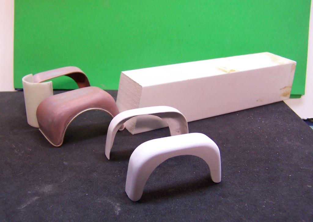

Here's what Renshape can do.  Front fenders are carved from it.  Some rear fenders from the block of porch railing stock shown here.  The latter is not quite as dense and takes a bit more primer to fill but it still works the same.

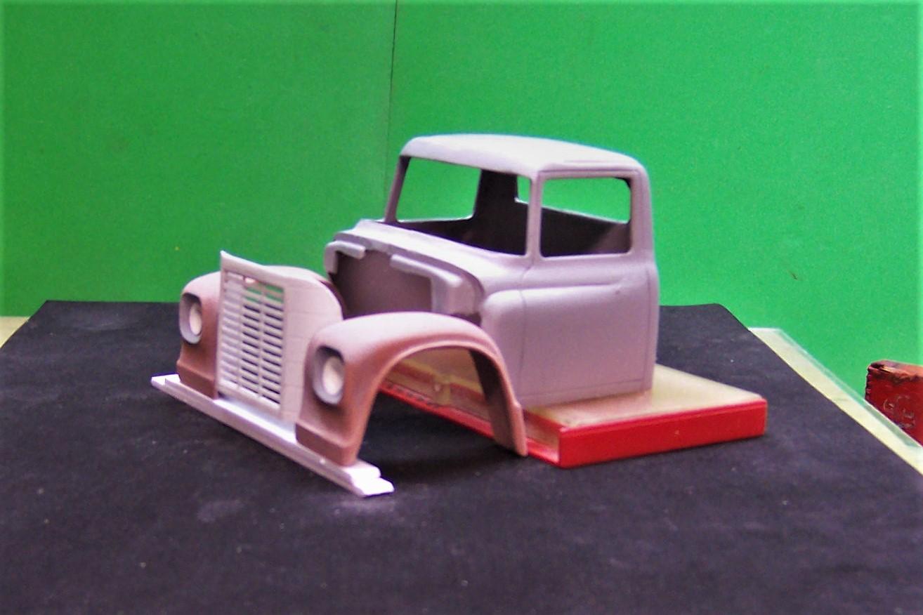

Here is another example of carving for fenders using Renshape.  This time for an International Loadstar.   Same as with the Reo and Maxim.  Fender profile printed out first onto a flat blank of Renshape and rough sanded.  Final shaping with a Dremel, some files and sandpaper.  Be prepared for a lot of dust, though, when using the Dremel, or even when hand sanding.    A minimum of primer/filler prepares the surface for paint.  Really great stuff!
