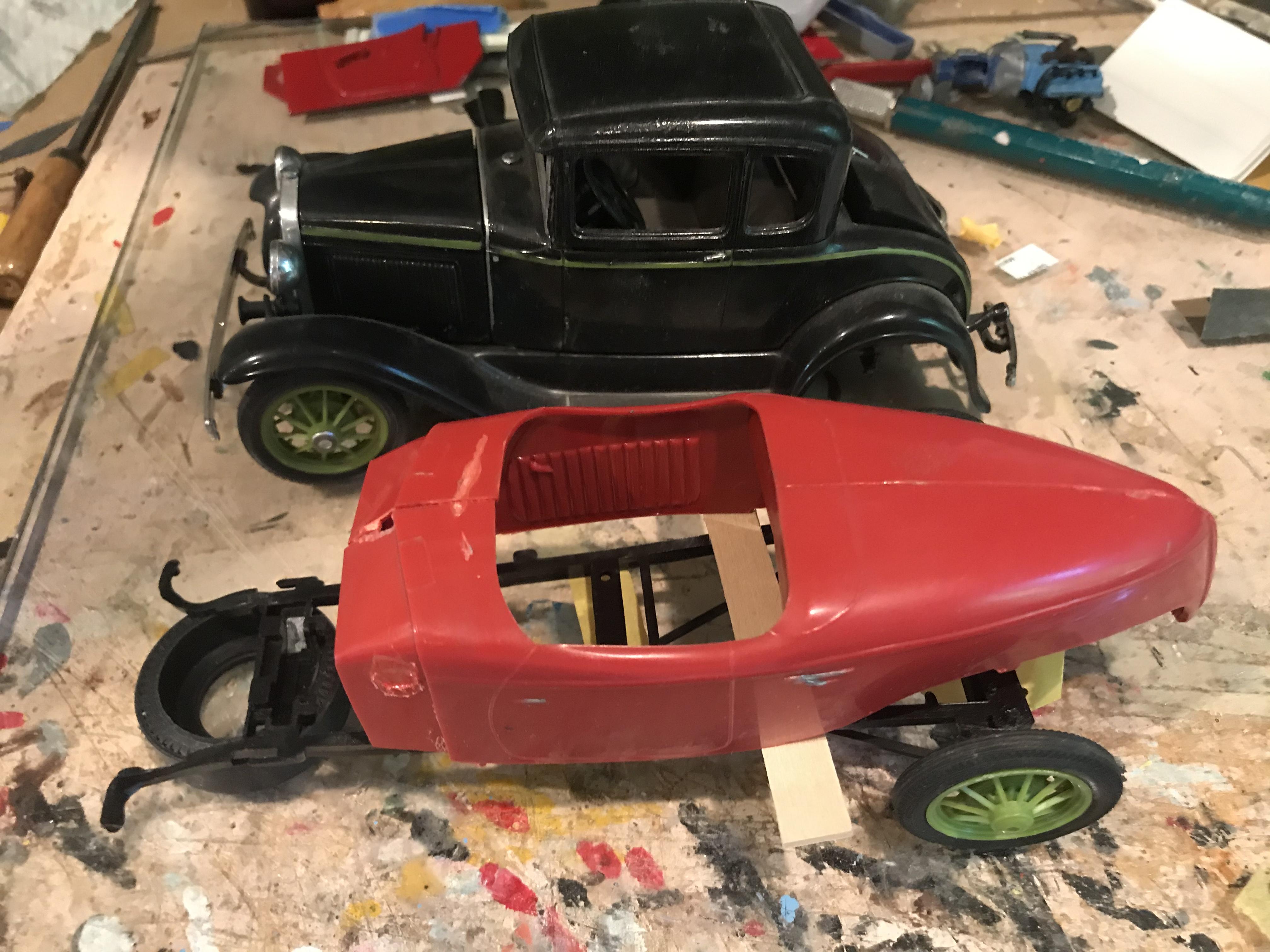

Then last week I opened up a box of old built up parts cars.. and there was an Auburn with the required tail!  The kit has been around for eons, originally a Pyro tool with two part body.  I quickly pulled it apart to fiddle a bit. Now I wish I had taken photos of this donor car intact!

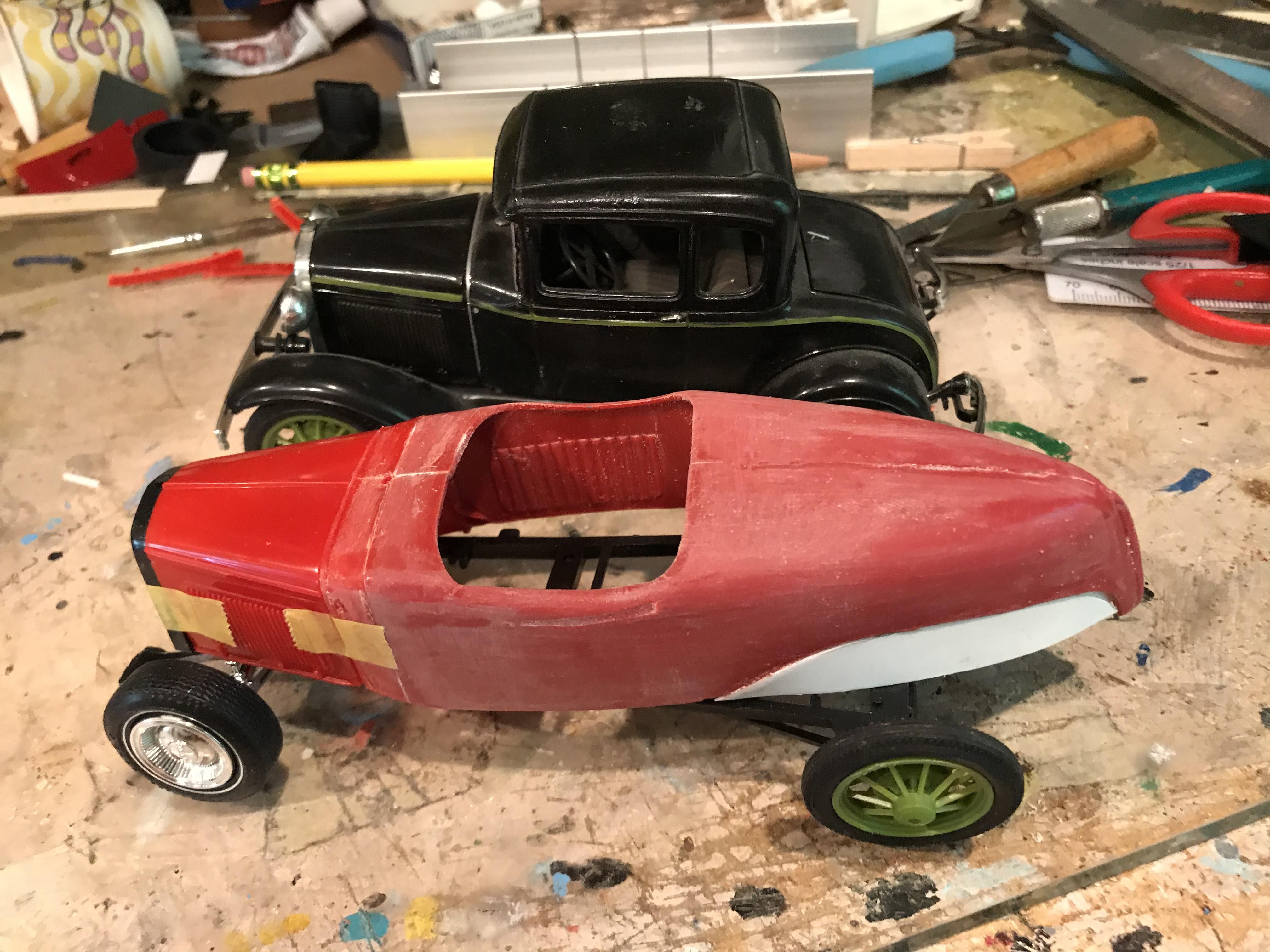

Here is the Auburn body sitting on a Model A frame. Although the Auburn was a large car, it sized out fairly well next to a Monogram Model A.

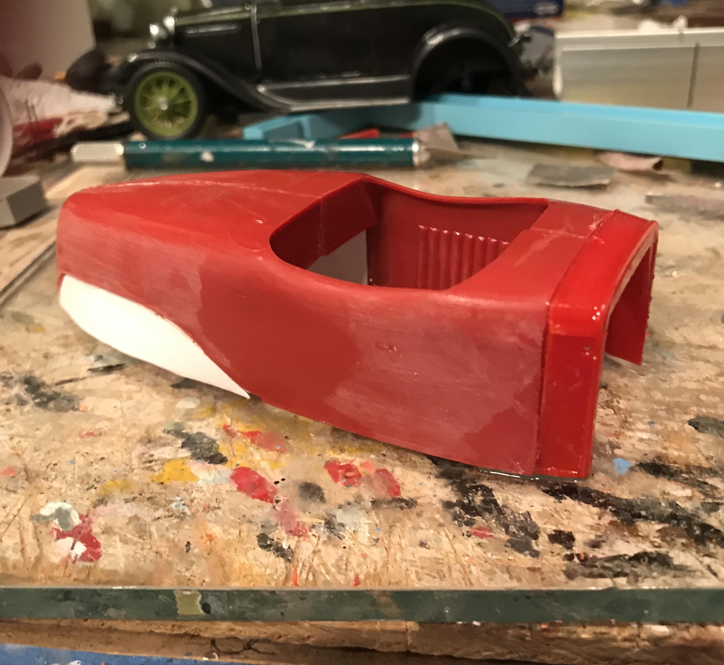

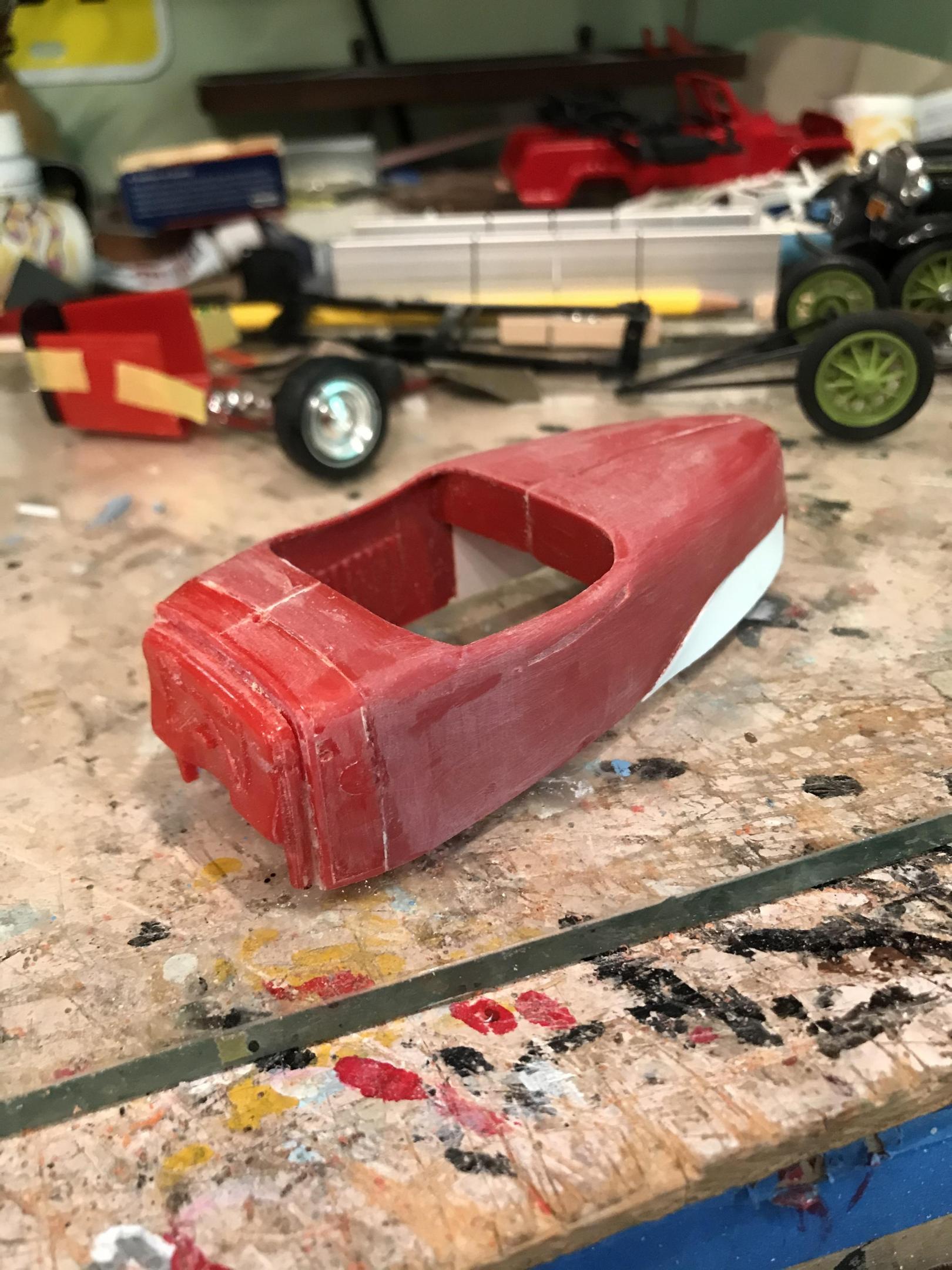

And here we are today!  I have cut the Auburn cowl and Model A cowl to a point where they both matched at a taper point. They are glued together and the Model A firewall fits, along with the hood.
The body had a taper at the rear where the skirts were in the Auburn. There are two layers of sheet plastic here, one spanning the opening on the inside of the body, and a second one cut to match the opening.
Now onward to shaping and putty.

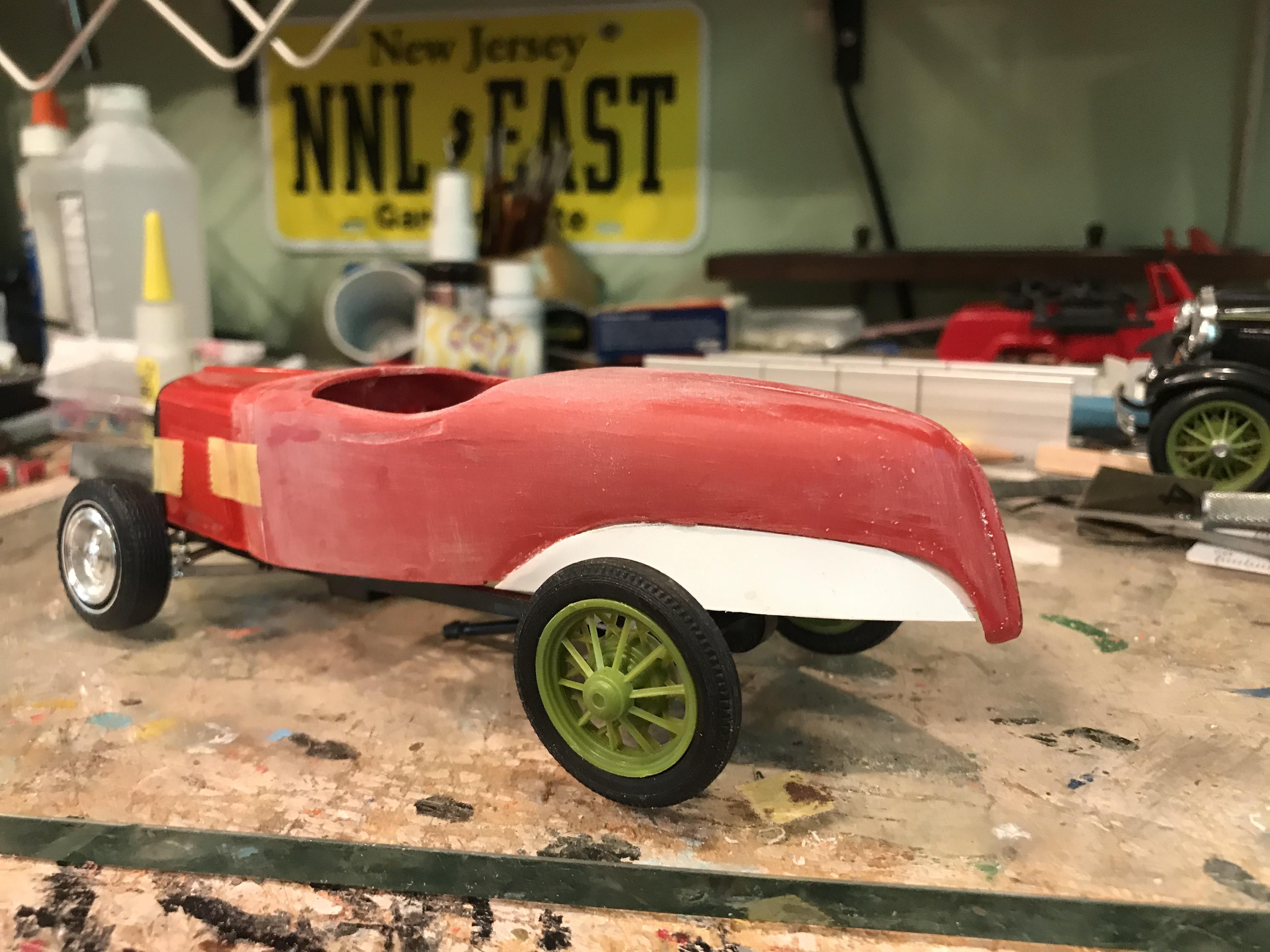

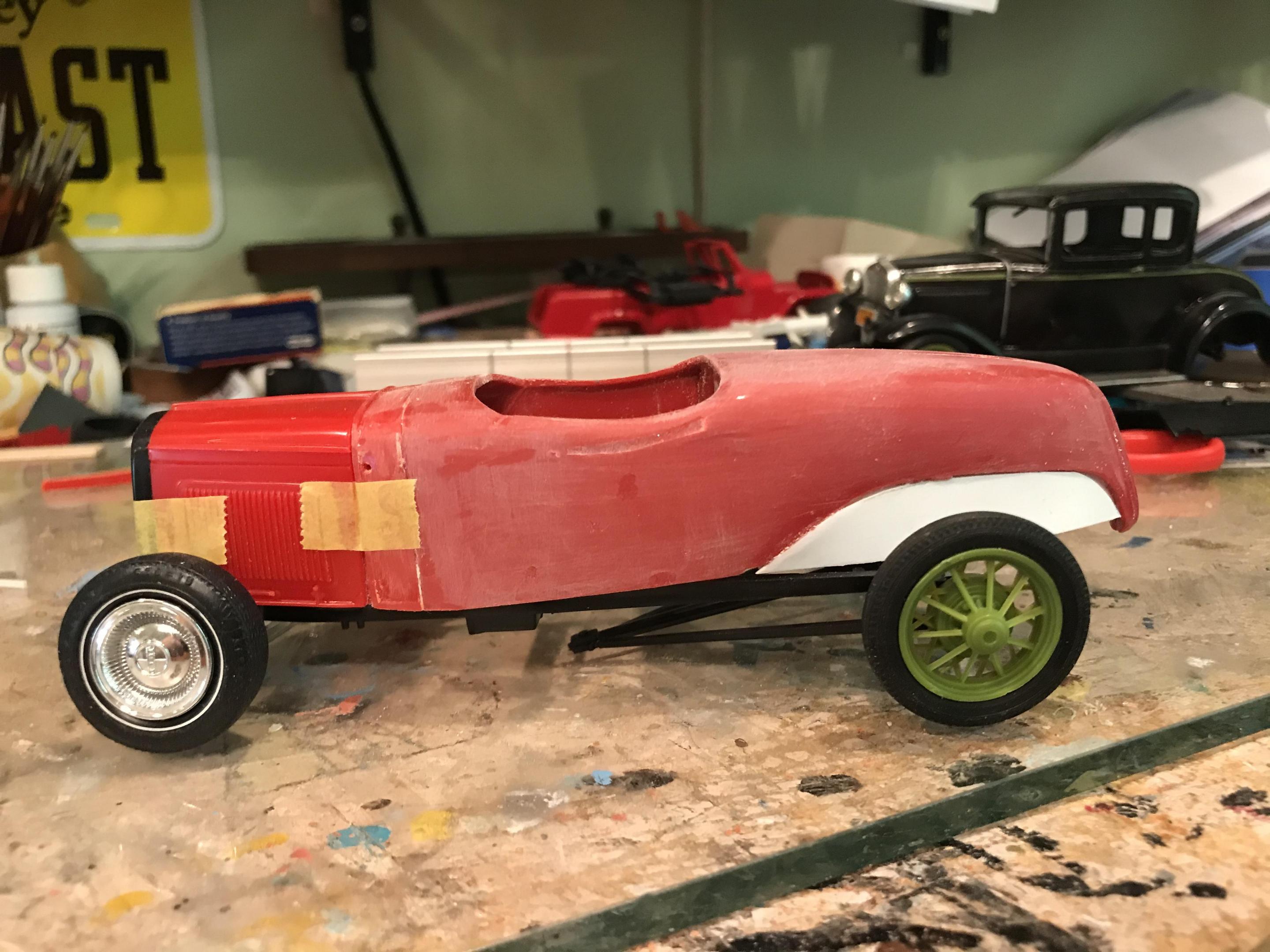

Chugging right along... Here we are after some sanding and addition of the Model A firewall
6BC744A7-5DB4-48E0-A332-B0D065E4A41F.thumb.jpeg.c9e648d250dde32d2d962ce912613be0.jpeg50BAFAFE-ECB0-4C37-97F1-2A180550E6B5.thumb.jpeg.8a1f36e35b3c01db10ede5071c25a513.jpeg6AAA9469-35D4-4F0A-B39E-4DA5C744A734.thumb.jpeg.4e264f822c2b2b7a399709a1deaef02c.jpeg6D6CDF89-DFF7-4F13-A846-253BC41A809F.thumb.jpeg.1f17a14a5976381b444b50dd0c15af69.jpeg

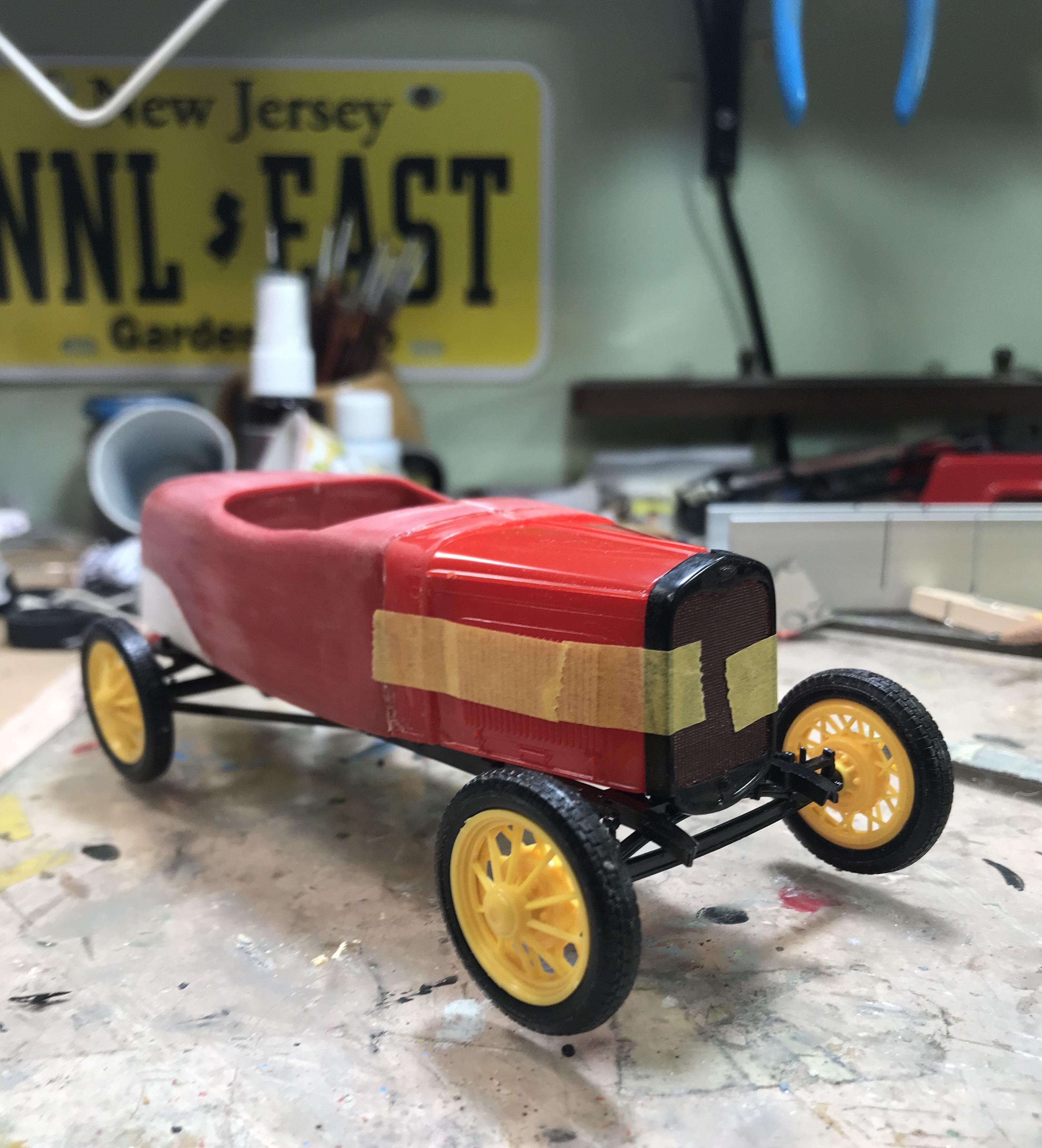

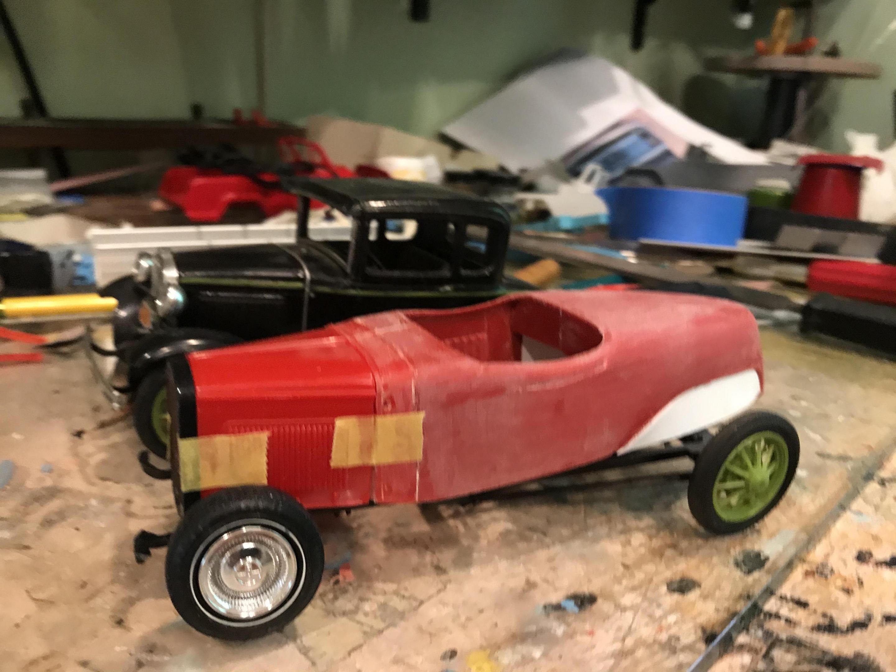

and up on wheels... forgive the front tires, just a mock-up!
The tail is a bit longer than I’d like but other proportions seem to line up.  I believe I will build up a chassis and fabricate the rest the of it..  interior etc before I do any putty or finishing work on the body.

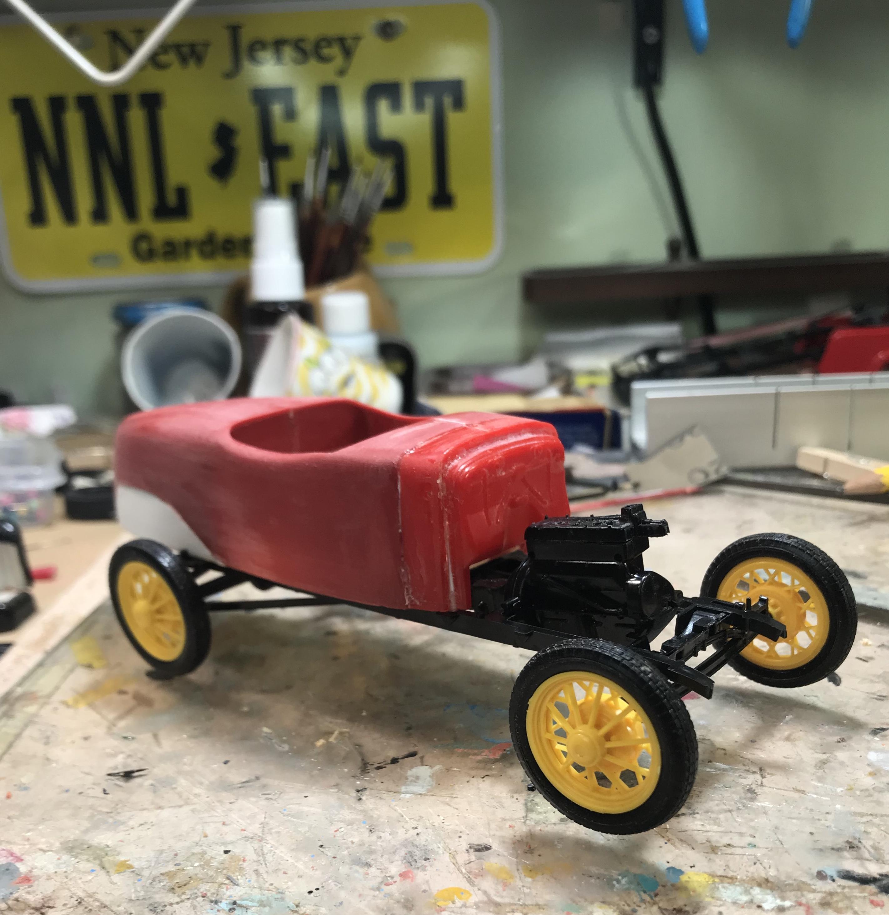

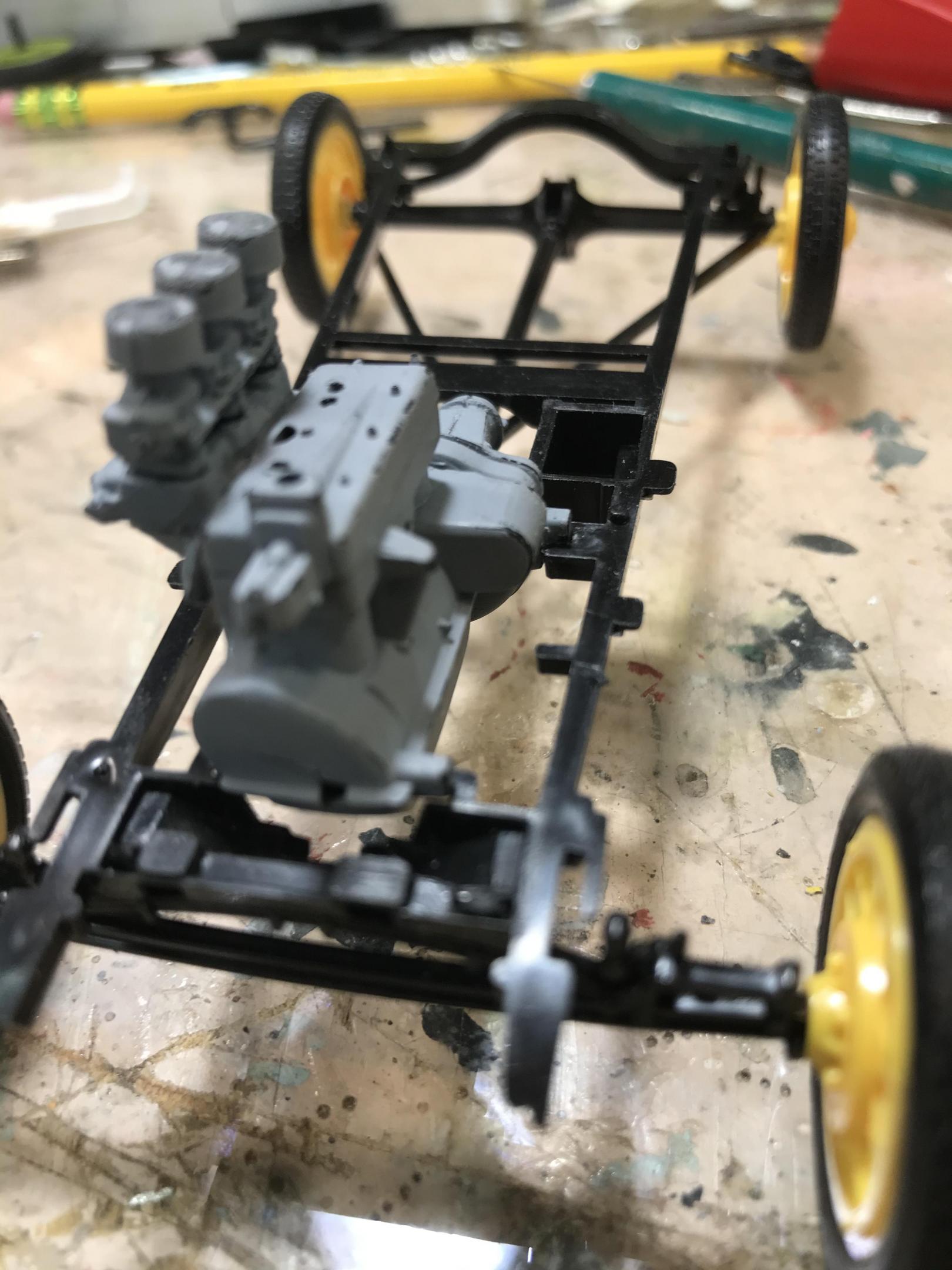

Today I assembled  chassis and engine to get this up on wheels and to make sure everything fits and works.
What you don’t see in these photos is that a wood floor has been fit, as well as some interior panels including rear panel behind the seat.
The classic Model A nose sits well and right where it should be!

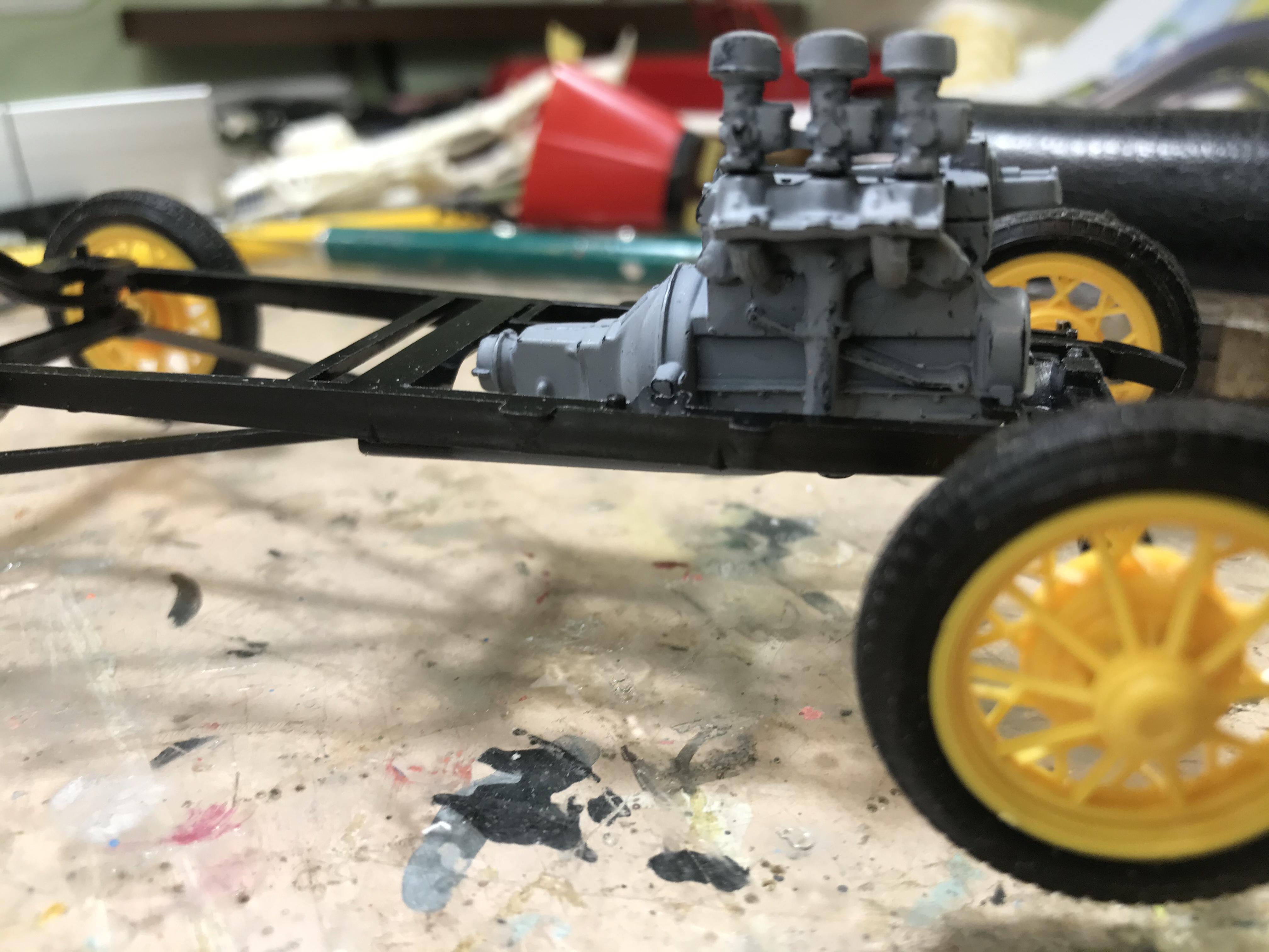

I wanted to use the Monogram kit’s four cylinder partly because the V8 in this series is too new to qualify for TROG.  I also saw vintage speed equipment on the real cars so I had the bug to hop it up. I didn’t know of any kits, especially compatible with the 1/24 kit.  Nor did I want to order and wait for anything aftermarket if even available. I saw this project surely heading down that road to over complicatous!
I definitely wanted to lose the kit’s downdraft carburetor.  I had a wild idea of multiple carburetors and thought two would be the max. Then I found pix on the Internet of a hopped up pickup with three carbs on it!  I pulled out the triple carb unit and manifold that went to the V8 in this kit, and I found a better exhaust manifold.
I spent some time with the photos, the mentioned parts, glue and putty and here’s where I wound up. Not sure how realistic it is, hoping convincing enough for a home welded hop up.
It’s  just mocked up and not glued in the pictures so it’s a little crooked
I love the whole TROG genre of cars.I have built a few myself inspired by this race series. Are you going to lengthen the chassis? IMHO the current status seems too short for the body length. Great idea using the Auburn boat tail section on the Henry "A" body. I'll be watching carefully from here in Ohio.
Darn you Tom!   ?   Now you have me looking at lengthening the chassis.  I just finished assembling this one, but have plenty of spares, so I will look at it.  The 1:1 examples I show in this thread have long tails behind the wheels, but I agree this one would look less like a UPS Truck with the rear wheels back a bit further.
