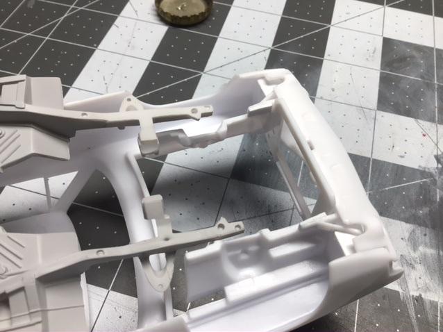

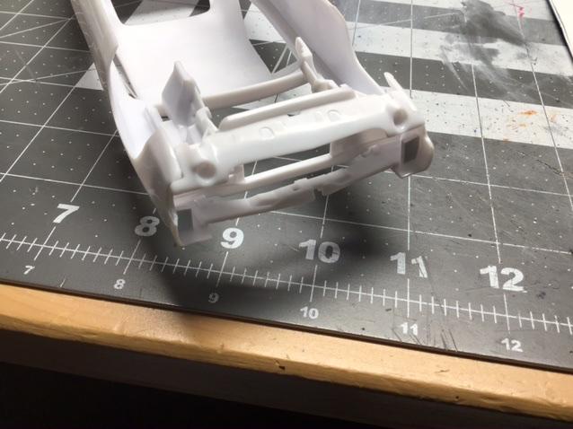

NOBLNG Posted September 13, 2020 Share Posted September 13, 2020 Well I might as well start a build thread on this even though it was supposed to be just a quick motivational build. One of my first annoyances was the fact that the front end is very poorly designed. The grill and bumper are in one piece and there is nothing to keep it from being pushed too far into the nose. The lower valence has absolutely no locating points at all and doesn’t really fit nicely where it should go.? Other than that, it looks like a pretty nice kit...so far. Quote Link to comment Share on other sites More sharing options...

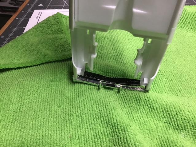

NOBLNG Posted September 13, 2020 Author Share Posted September 13, 2020 First I glued a couple of stop Brackets inside the fenders to locate the grill. I also separated the bumper support brackets from the frame and glued it in place along with the radiator support and that annoying front valence. I will paint this all as unit with the body after a little filler. Quote Link to comment Share on other sites More sharing options...

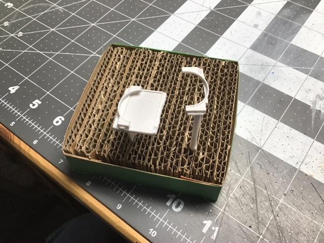

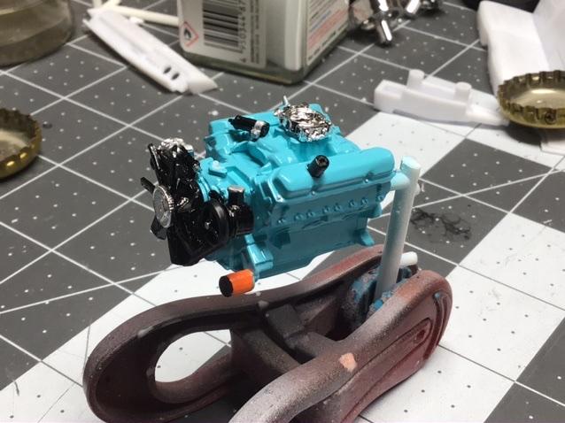

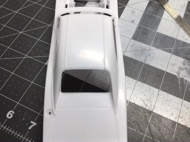

NOBLNG Posted September 13, 2020 Author Share Posted September 13, 2020 (edited) The radiator shroud will interfere with getting the chassis and engine assembly into place, so I cut the bottom half off of it so it can be installed later. I also got the motor mostly finished, and a start on the vinyl top...so much for a quick build! ? Thanks for looking, comments welcome. Greg. Edited September 13, 2020 by NOBLNG Quote Link to comment Share on other sites More sharing options...

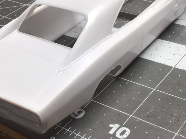

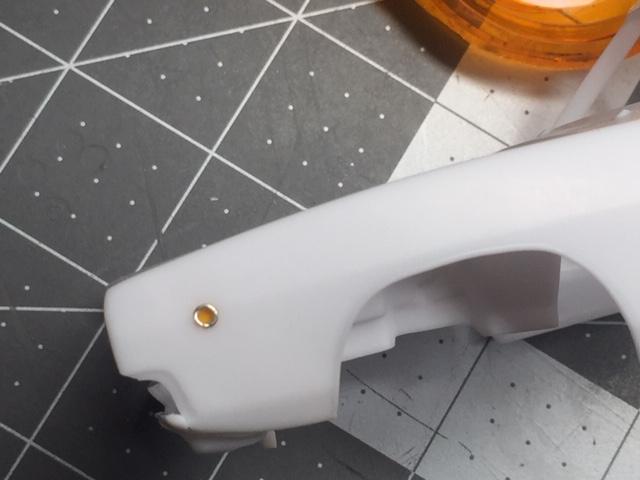

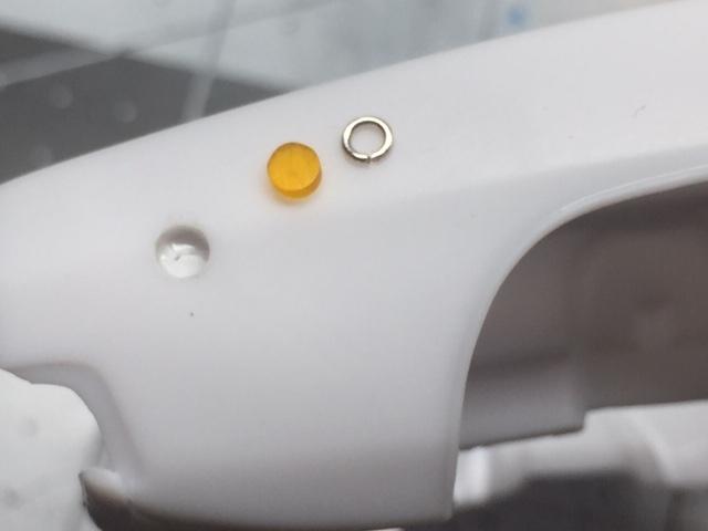

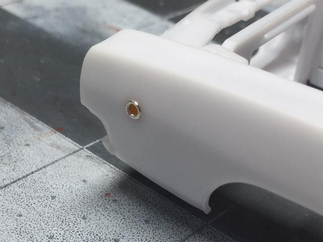

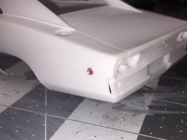

NOBLNG Posted September 20, 2020 Author Share Posted September 20, 2020 (edited) This kit just has decals for the side Marker lights. I decided to make some real ones. I glued a small chunk of a busted amber lens I found to a piece of sprue and turned it down in my drill. I drilled a .098” hole in the fender and glued a piece of thin styrene on the inside for backing. I was going to paint the edge of the amber with silver sharpie or molotow, leaving it a little thicker than the fender. While laying in bed last night, I came up with an idea for a better bezel. I wrapped a piece of .020” wire around a .058” drill bit and snipped off some wraps with my nippers. By chance this fits almost perfectly in the .098” hole, so I filed the amber down so it sits just below the surface, leaving the bezel just proud of the surface. A pinhole in the backing allows me to push it out, to be re-installed after paint. The rears should be easier, since I have clear red sprue to use. Edited January 5, 2023 by NOBLNG Quote Link to comment Share on other sites More sharing options...

espo Posted September 20, 2020 Share Posted September 20, 2020 Great idea, very realistic looking. Quote Link to comment Share on other sites More sharing options...
NOBLNG Posted September 20, 2020 Author Share Posted September 20, 2020 Thanks. Beats the heck out of the decals I think! Quote Link to comment Share on other sites More sharing options...

StevenGuthmiller Posted September 20, 2020 Share Posted September 20, 2020 2 hours ago, NOBLNG said: This kit just has decals for the side Marker lights. I decided to make some real ones. I glued a small chunk of a busted amber lens I found to a piece of sprue and turned it down in my drill. I drilled a .098” hole in the fender and glued a piece of thin styrene inside for backing. I was going to paint the edge of the amber with silver sharpie or molotow, leaving it a little thicker than the fender. While laying in bed last night, I came up with an idea for a better bezel. I wrapped a piece of .020” wire around a .058” drill bit and snipped off some wraps with my nippers. By chance this fits almost perfectly in the .098” hole, so I filed the amber down so it sits just below the surface, leaving the bezel just proud of the surface. A pinhole in the backing allows me to push it out, to be re-installed after paint. The rears should be easier, since I have clear red sprue to use. Very nice idea, and very good execution. I'm considering something similar for my current '68 Coronet project. I'll probably steal this! If I may, just be certain that your lens doesn't fit to tight so as to allow for the thickness of the paint. You really don't want to have to re-drill the holes in the body after all of the paint work is finished. Steve Quote Link to comment Share on other sites More sharing options...
NOBLNG Posted September 20, 2020 Author Share Posted September 20, 2020 (edited) 2 hours ago, StevenGuthmiller said: Very nice idea, and very good execution. I'm considering something similar for my current '68 Coronet project. I'll probably steal this! If I may, just be certain that your lens doesn't fit to tight so as to allow for the thickness of the paint. You really don't want to have to re-drill the holes in the body after all of the paint work is finished. Steve Thanks all. The lens fit quite loose actually but the bezel will cover it. And by all means, feel free to steal it...I’d be honoured! ? Maybe I should have put this in the tips and tricks section. Edited September 20, 2020 by NOBLNG Quote Link to comment Share on other sites More sharing options...

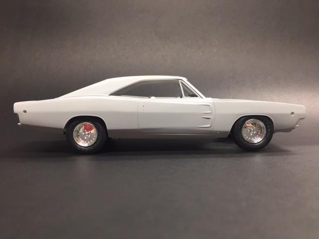

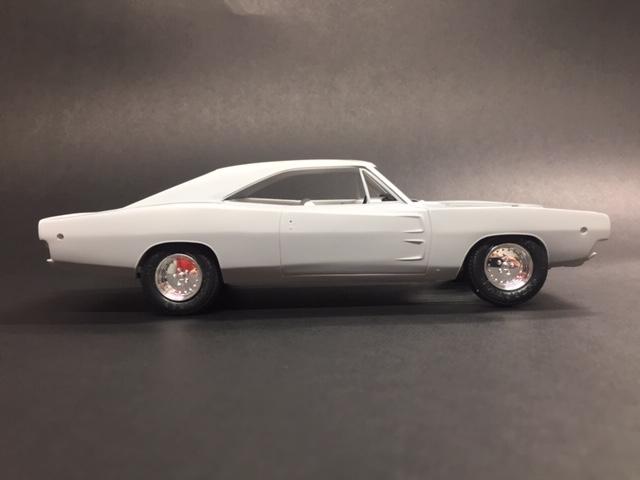

NOBLNG Posted September 22, 2020 Author Share Posted September 22, 2020 I found these centerlines and tires in my parts box. I don’t recall what they might be from, but I think they look OK. The kit tires always seem to look a bit small to me. I figured I better get the stance right before painting everything. I think I finally got it right in the third pic. Comments welcome. Quote Link to comment Share on other sites More sharing options...

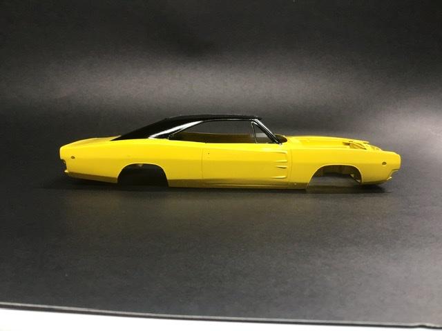

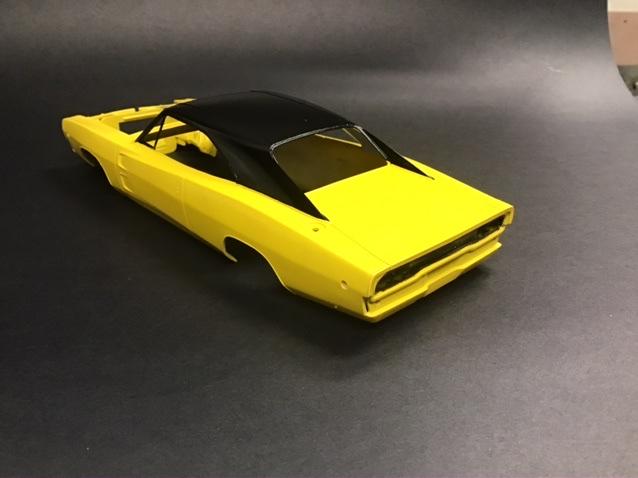

NOBLNG Posted September 26, 2020 Author Share Posted September 26, 2020 Got some paint on it. Quote Link to comment Share on other sites More sharing options...
