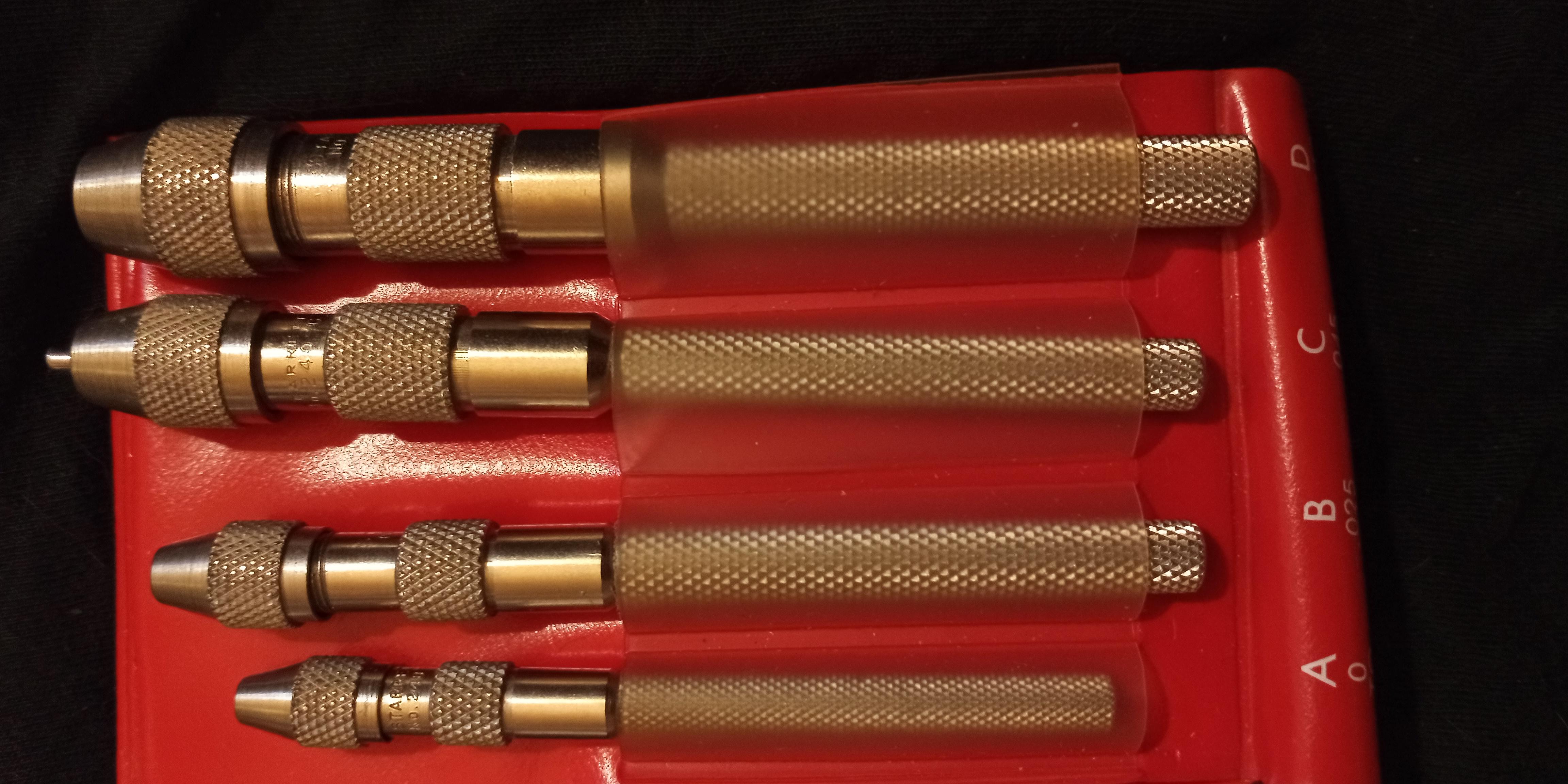

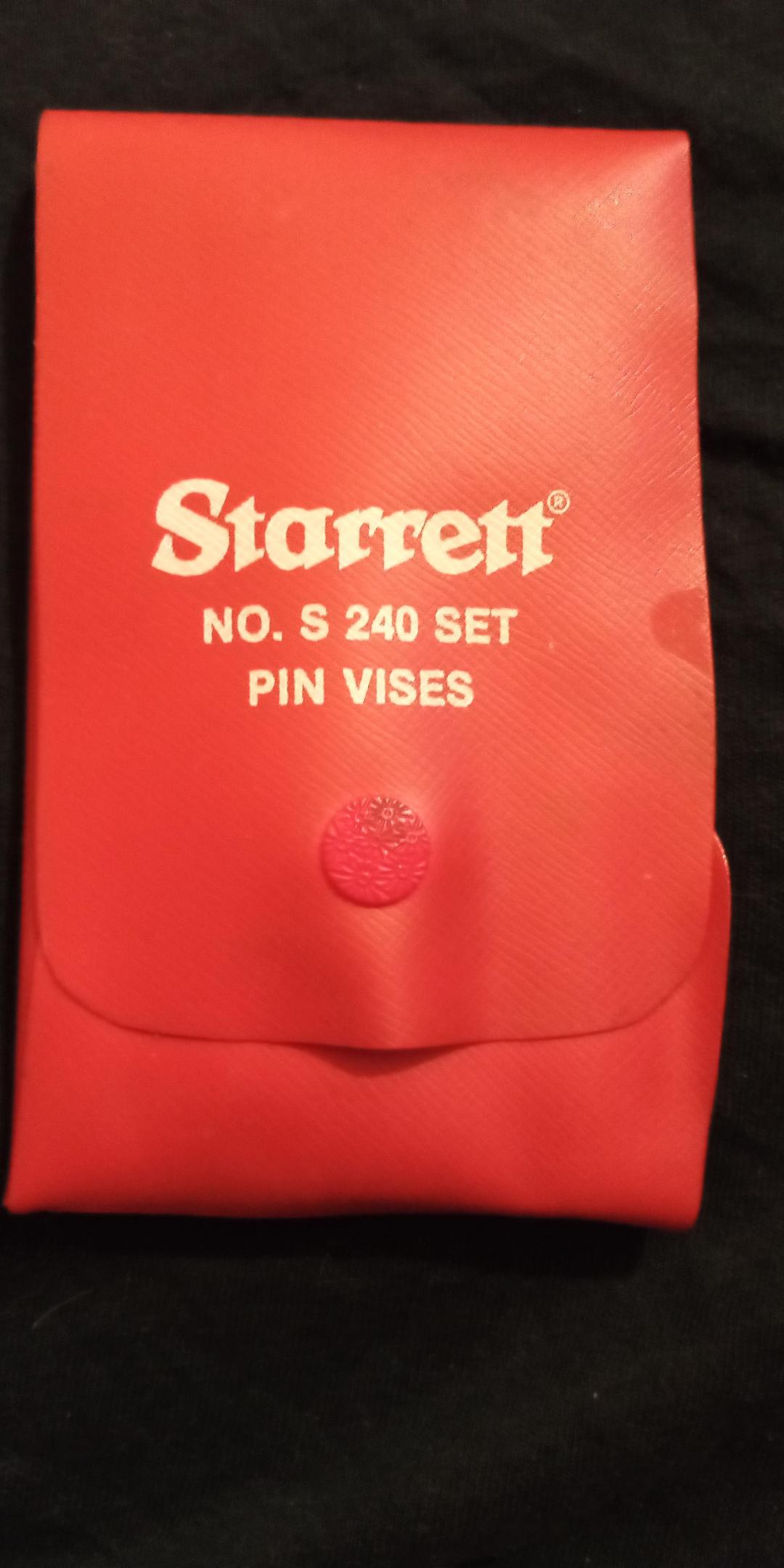

Deuces ll Posted September 20, 2020 Posted September 20, 2020 Here's the pin vise set I use.... These are the best money can buy...

NOBLNG Posted September 22, 2020 Posted September 22, 2020 (edited) On 9/20/2020 at 8:51 AM, Deuces ll said: Here's the pin vise set I use.... These are the best money can buy... Those look really nice! I bought a cheap set of chinese(?) ones from my local hobby shop. Only one holds the bit straight and they are all poorly threaded and hard to tighten. Edited April 30, 2022 by NOBLNG
Deuces ll Posted September 22, 2020 Posted September 22, 2020 The ones I have in that red pouch have a ground shank so they fit in a R-8 collet for a Bridgeport milling machine....
