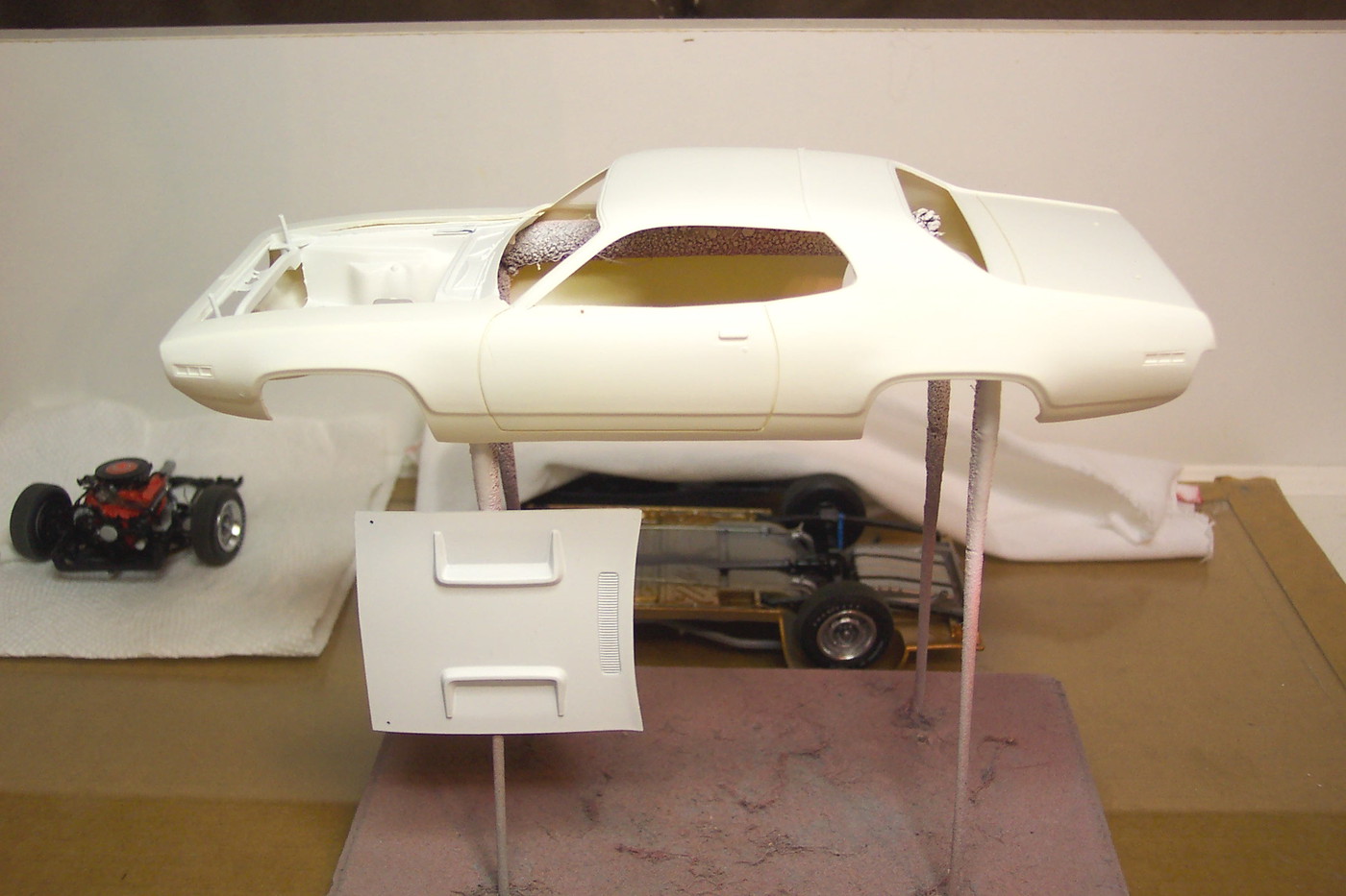

TooOld Posted December 4, 2020 Author Posted December 4, 2020 20 hours ago, StevenGuthmiller said: I painted over the magnets on my '64 with no adverse affects. The magnets appear to be strong enough to function very well regardless. Although on my project, they only had a single coat of paint over them. My local Hobby Lobby carries K&S products. I'll definitely check to see what they carry for metal strips the next time I'm in. I'll also check on the smaller magnets that you used. Mine are 1/8th inch, by 1/32nd. Steve I'd be okay with the two magnets going to the hood , but I only used one magnet on the bottom of the hinge and it just barely holds everything up now . Next time it's two on top and two on the bottom . Sprayed two coats of primer yesterday . Before that I used some clear sealer I bought a while ago at the body supply house , don't know if it will stop any bleed-thru but thought I'd give it a try . Plan on spraying the color today . Boy I forgot how ugly that yellow plastic was , looks much better now ! A small thing but I also mounted the engine to the sub-frame .

72 Charger Posted December 8, 2020 Posted December 8, 2020 Love the colour. That yellow plastic is horrid
TooOld Posted December 10, 2020 Author Posted December 10, 2020 On 12/5/2020 at 11:06 AM, Biggu said: This is a fabulous build.................. Mark Worman would be proud ! Thanks Jeff ! On 12/8/2020 at 10:41 AM, 72 Charger said: Love the colour. That yellow plastic is horrid Thanks Dave ! Yes the yellow plastic is ugly , this is my first kit molded that color .

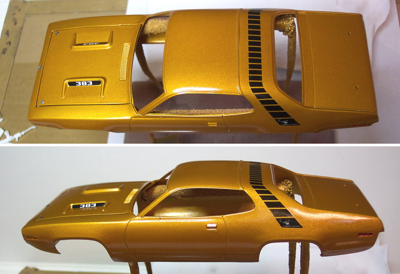

TooOld Posted December 10, 2020 Author Posted December 10, 2020 (edited) Painted the side markers , applied the decals , and cleared it ! Next is to mask everything and spray the vinyl top . I also finished the chassis . I pre-fit this about a dozen times into the body so I have my fingers crossed it will go one more time . Edited December 10, 2020 by TooOld
1972coronet Posted December 10, 2020 Posted December 10, 2020 Man alive , that GY8 looks GREAT ! I also like the de facto 'N97' Noise Reduction Package exhaust ( California models ) . Not sure if that was AMT's idea , or if it was a goof (the Street Machine version has the exhaust with the "Bazooka Tips" , in addition to the Ramcharger bonnet ) . Now that I've got a set of the 1971 Plymouth Deluxe Wheel Covers , I'm going to start work on my 1971 Road Runner --- it's going to be painted GY3 Curious Yellow .
Dragonhawk1066 Posted December 10, 2020 Posted December 10, 2020 The details on this are outstanding!! And I love the color!

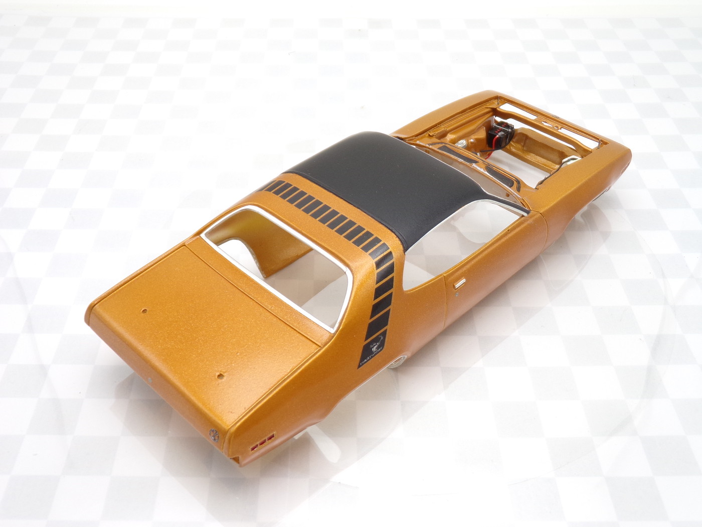

TooOld Posted December 11, 2020 Author Posted December 11, 2020 (edited) Thanks guys ! This is my first attempt at a vinyl top and I decided to use the black spray paint from a mile away technique described here on the forum . First step was to mask everything completely so no overspray would get on the gold paint . Then I grabbed my favorite can of generic flat black and sprayed a light mist coat from about 18" away , let it dry for 15-20 minutes then sprayed another mist coat . When that dried I had a nice smooth finish , obviously my cheap paint wasn't cheap enough ! After some thought I grabbed a can of Tamiya TS-14 Black and tried again . To my pleasant surprise this time it worked ! A couple more light coats and then a light coat of Tamiya TS-79 Semi-Gloss Clear finished it off . The texture looks good when the light hits it and it's not way out of scale . I'm definitely going to try another vinyl top soon , with a little practice I think it can only get better ! Edited December 11, 2020 by TooOld
afx Posted December 11, 2020 Posted December 11, 2020 Vinyl top looks great and helps balance out the gold paint.
