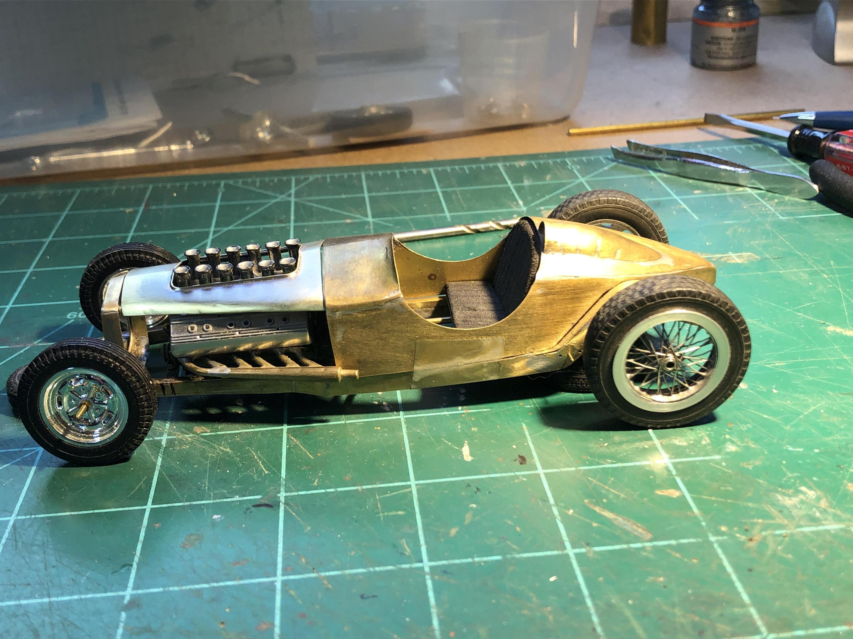

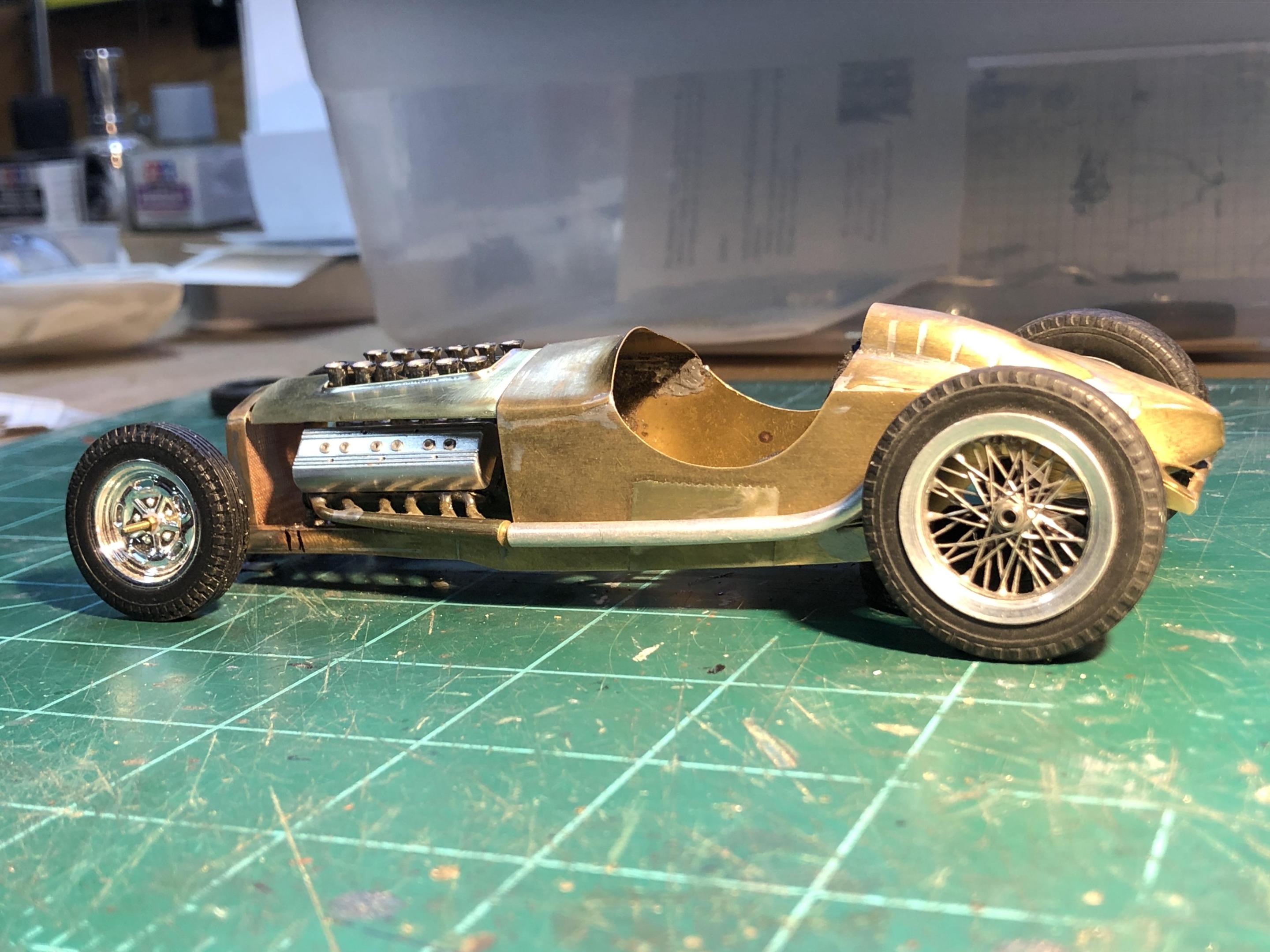

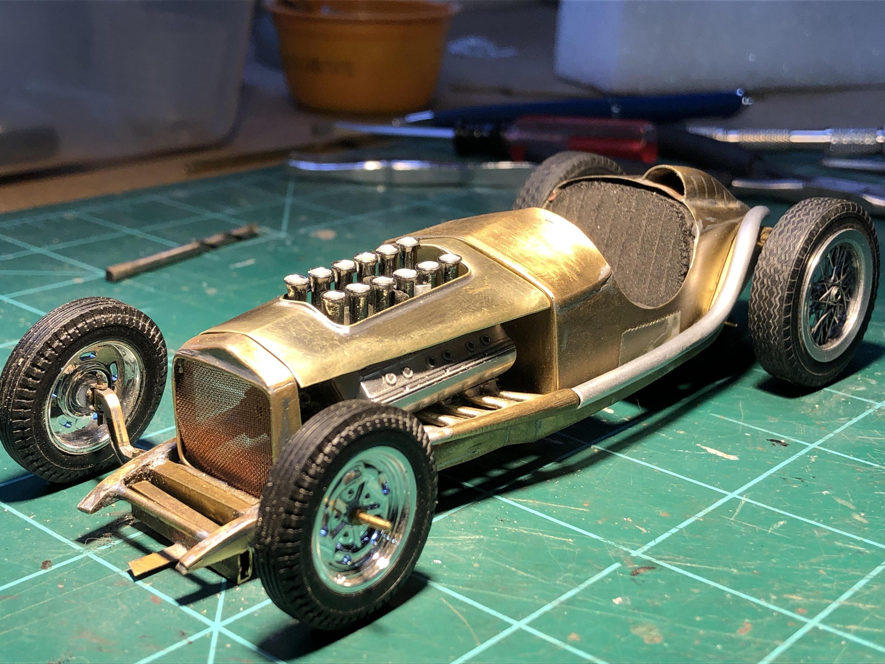

Time flies when you’re having fun!  Not!  It’s hard to believe that when I took what was supposed to be a fairly short break from my favorite hobby to get some things done on my wife’s honey do list, it would be over nine months before I had a chance to return to my model car bench. Well that’s how long it’s been, but yesterday, I was finally able to open this box and refresh my memory as to what I was working on when I put it away last February.  I know I had just about wrapped up the rear suspension, and started on the front.  I made a new front axle, but the rest of the front suspension still needs to be made.  I will be making quarter elliptical leaf springs, wishbones, new dropped spindles, tie rod, rod ends,… I’m planning to make four new wire wheels, and most likely drum brakes.
Before getting started on all that though, I decided to go ahead and poke a hole in the hood for the velocity stacks to breath through.  I also decided to install new motor mounts that would raise the engine about 3/64”, which is pretty close to 1” in scale.  It gave me some much needed ground clearance, which allowed me to adjust the stance a little bit.  I also like the way the velocity stacks look better now.  Before this build is done, I intend to machine twelve new aluminum velocity stacks to replace the ones in these pics.
I really hope I will be able to stay with this build now and see it through to completion, although I expect it will be some time before I can call it done.  In the mean time, I promise to check in from time to time and post some updates as I make significant progress.  Thanks for looking! I hope you enjoy!  F11B1B46-F6F9-44E0-96A1-2F475F98FBC7.thumb.jpeg.47decdcf600d354d0bb1b103e40b987b.jpegB1E053DC-3856-471C-BFE0-063EB64ED9A7.thumb.jpeg.2cee051d3e7492f488ec8afb02754ef4.jpegED5925C4-0782-496D-BF50-BD4755474554.thumb.jpeg.234308167c849daa180aa11853dd552d.jpeg

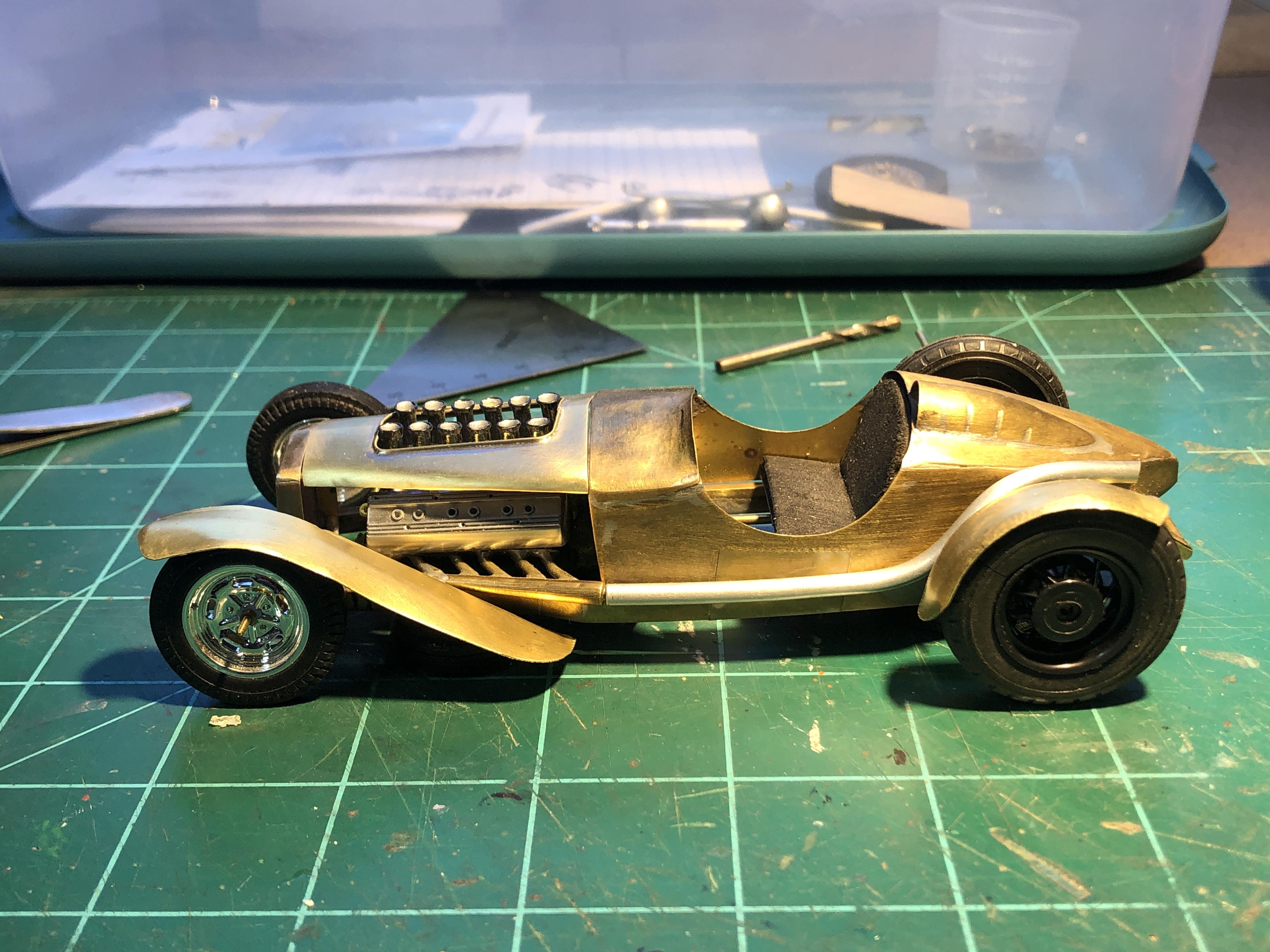

  • 2 weeks later...
11 hours ago, AmericanMuscleFan said:
Nice!  I really like them, they give a completely different look and I really like how they fit this concept.  They are not too massive, just right in my opinion.... ?
Thank you very much Francis!  Much of the styling on this build is borrowed from the 31 Alfa Romeo Monza.  Sort of an Americanized version of that classic sports car, hot rodded up a little.  This was just a quick and dirty mock up to see how I like the fenders.  They still need quite a bit of tweaking and finishing, but I think it will be worth my time.

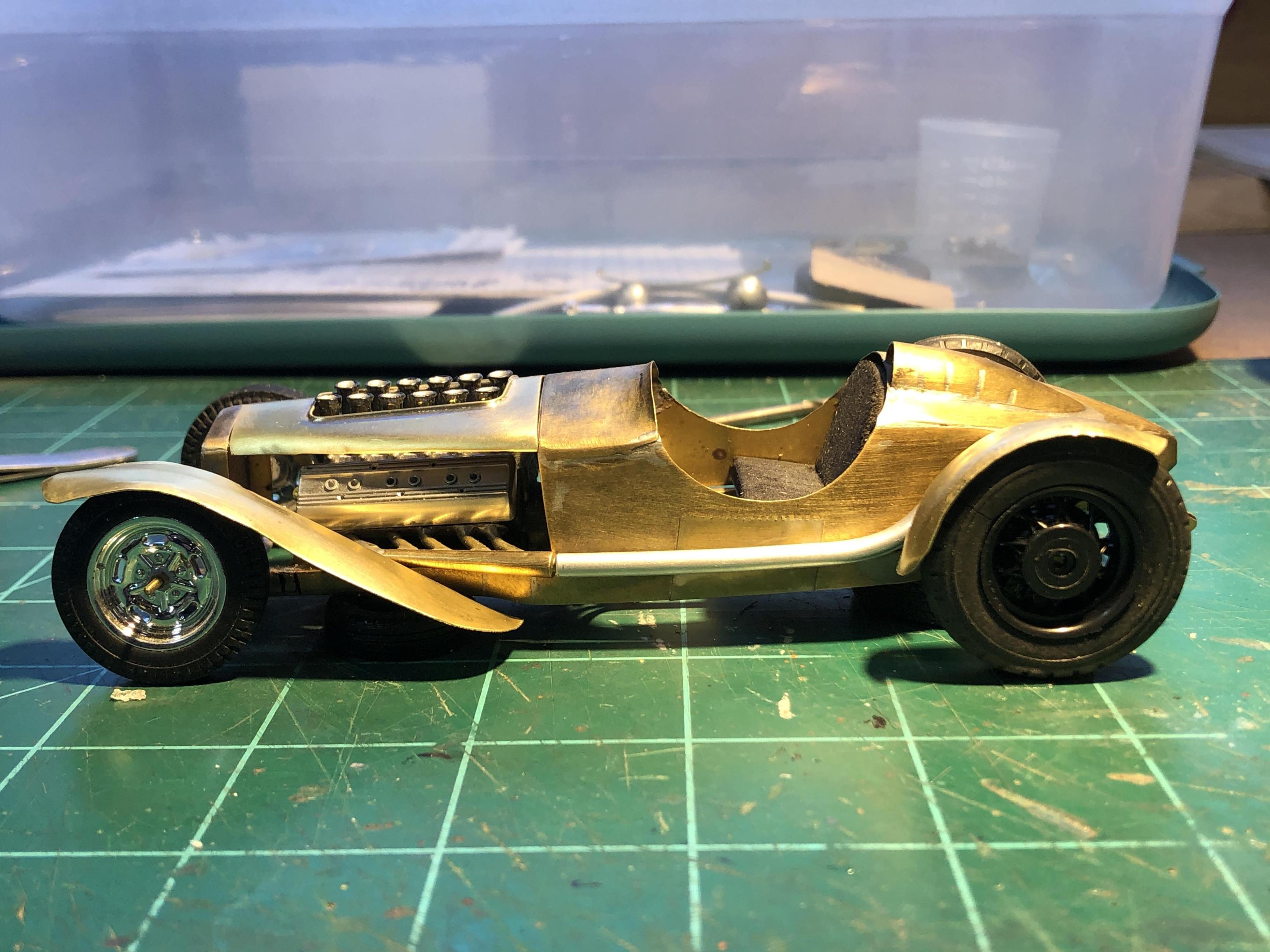

TS
ps.  Here is another shot, after a little more work on the front fender.
