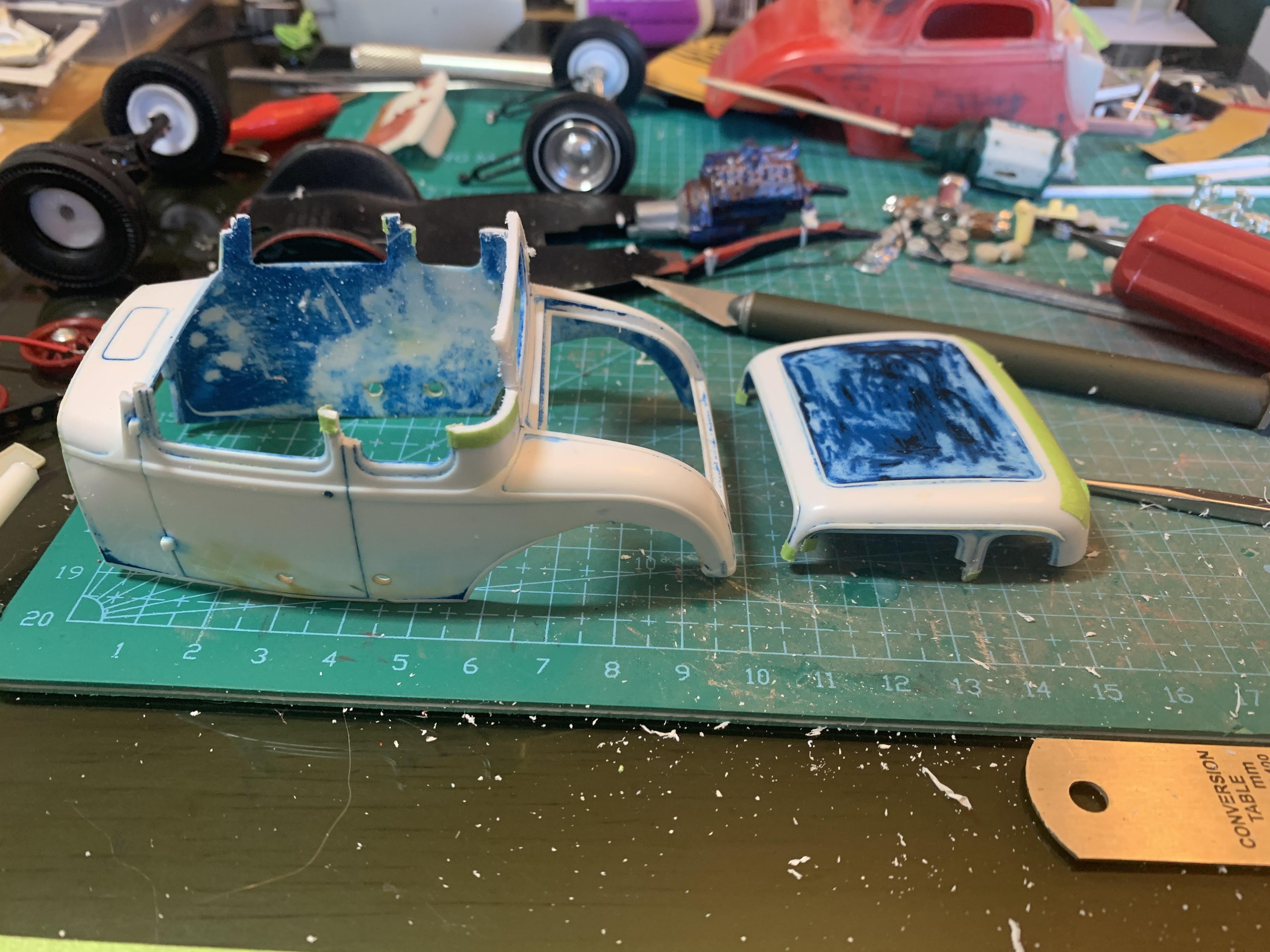

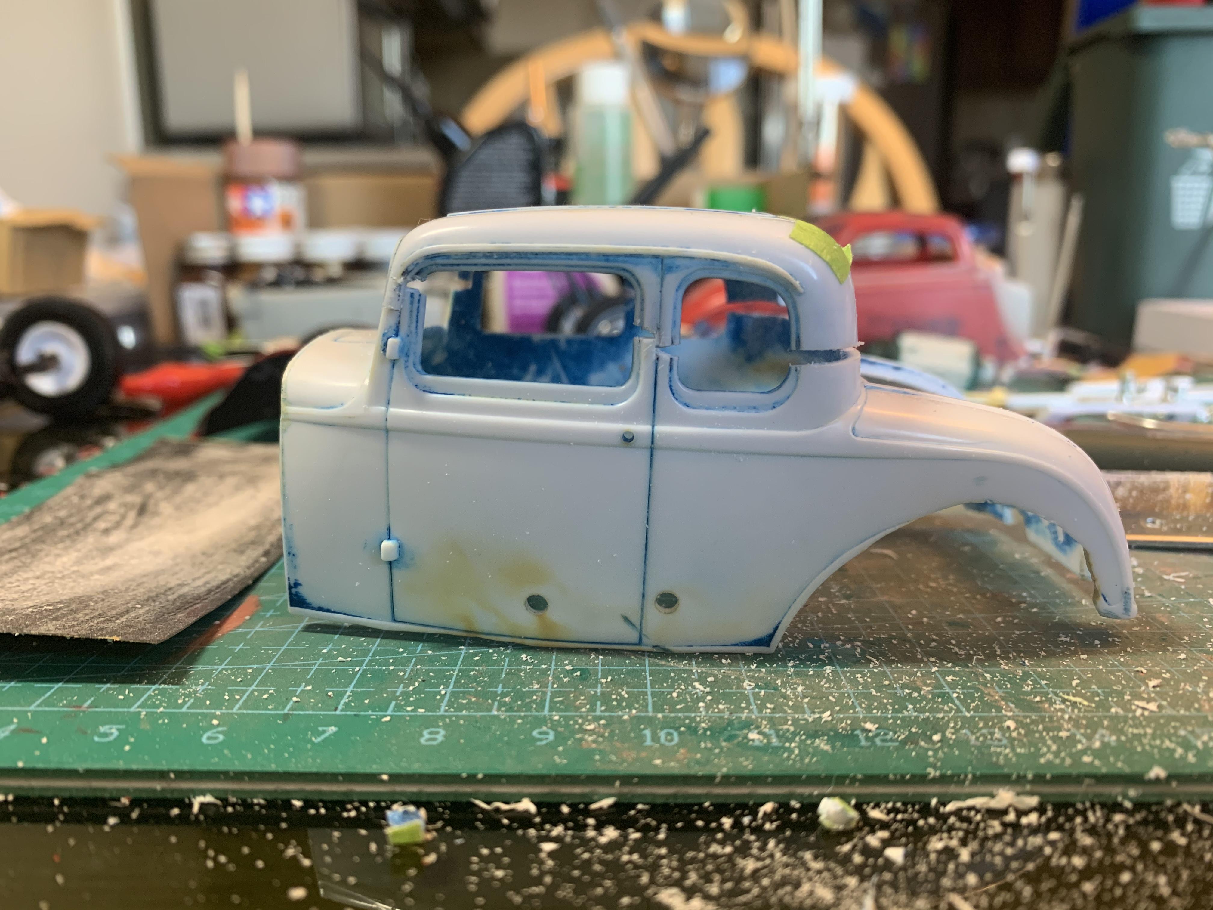

'32 Chopped 5 Window Cut & Paste - printed out a picture of the un-chopped body to get an idea of how deep the chop could be...
'32 Chopped 5 Window Back Lite Cuts #1
'32 Chopped 5 Window Back Lite Cuts #2
Second Cut the A Pillar
Third Cut the C Pillar to the Back Lite but not all the way through until the other side has been cut to the same point
1277178597_ThirdCuttheCPillartotheBackLiteContinued.jpg.3174e53e878d4fca4a1d2071eae47e79.jpg
Third Cut the C Pillar to the Back Lite Continued
First Cut the B Pillar
Finish the Back Cuts
Blacken the C Pillar Cuts for Sanding to Create a Flat Even Surface
Check your progress to make sure you do not remove too much material
Sand the Surfaces to Make Them Flat Even
Slowly Sand Down the C Pillar
Test Fitting again took out one more inch...
'32 5W Chop Job - Step Cut the A Pillars Right & Left
1150310971_325WChopJob-StepCuttheAPillarsRightLeft.jpg.695c7b835695d5b3b80adb2c8fe279bf.jpg
'32 5W Chop Job - Step Seven Set Alignment Blocks to the inside of the Pillars
'32 5W Chop Job - Step Seven Back Lite Opening
'32 5W Chop Job - Step Seven Windshield Opening
'32 5W Chop Job - Step Seven Left Inside after the all of the seams have been glued with CA, the Alignment Blocks can be removed.
'32 5W Chop Job - Step Seven Right Side
'32 5W Chop Job - Step Seven Left Side

Here's the key to the success of a step-cut chop:
Alignment - Door Jambs/Seams - Temporary Alignment Blocks
Interlocking Parts - Fine tuning - Measuring, Filing & Sanding - Less Body Filler
Surface Tension - Increased Friction & Gluing Surface

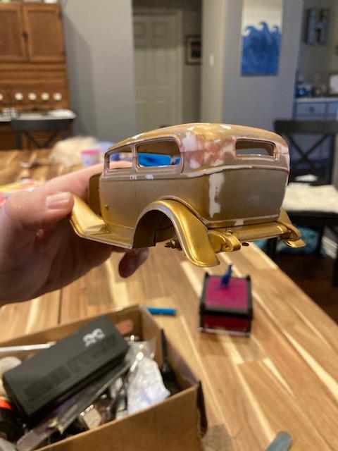

Well, I chopped a 32 sedan BEFORE I read this thread, some really good tips I could have used.. hahaha..  but here it is..  I cut too much off the B pillars so it ended up being a 'wedge' chop, but it looks good. Randomly, and purely unintentional, the Orange Crate windshield frame fits perfectly in the opening.
The trouble I'm having is filling the seams and not obscuring the details around the windows and lining up the door lines.  I did have to put a relief cut behind the A pillar, then notch the front to lean it back to meet the roof.
It's not great, but it's not terrible, I may end up building this car. Thinking about a drag sedan with parts from the Revell Stone Woods & Cook Willys.

I have cut a lot of tops over the last 60+ years and can testify that cutting them apart is the easy part .Skillfully re-assembling those pieces is a whole other thing with the restoring those pillars and posts the most tricky.
