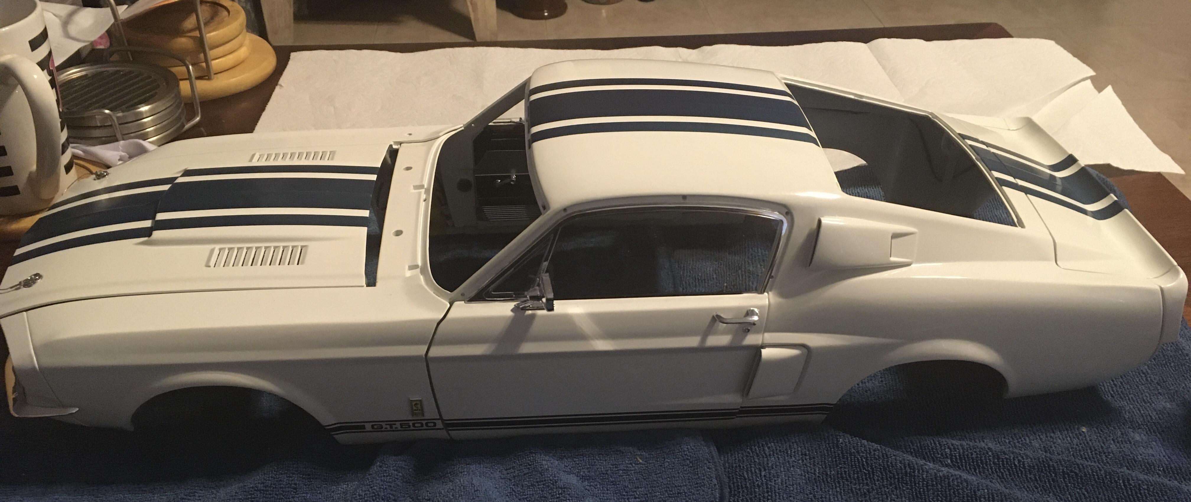

I actually finished this over the Christmas week while I was off, so this in effect is the only build I've gotten done for 2020. I had the parts for everything during the middle of '19, but with moving to a new house and finally getting motivated to start building again after being here for six months, I figure it was time to finally keep going on this and get it done.
If I have to rate this kit as far as difficulty, I can only say this is NOT for beginners. I have to add that you will need more than the little screwdriver they give you to get this together and there are times you'll need epoxy/superglue as the screw/snap together assembly IMO is not permanent enough.

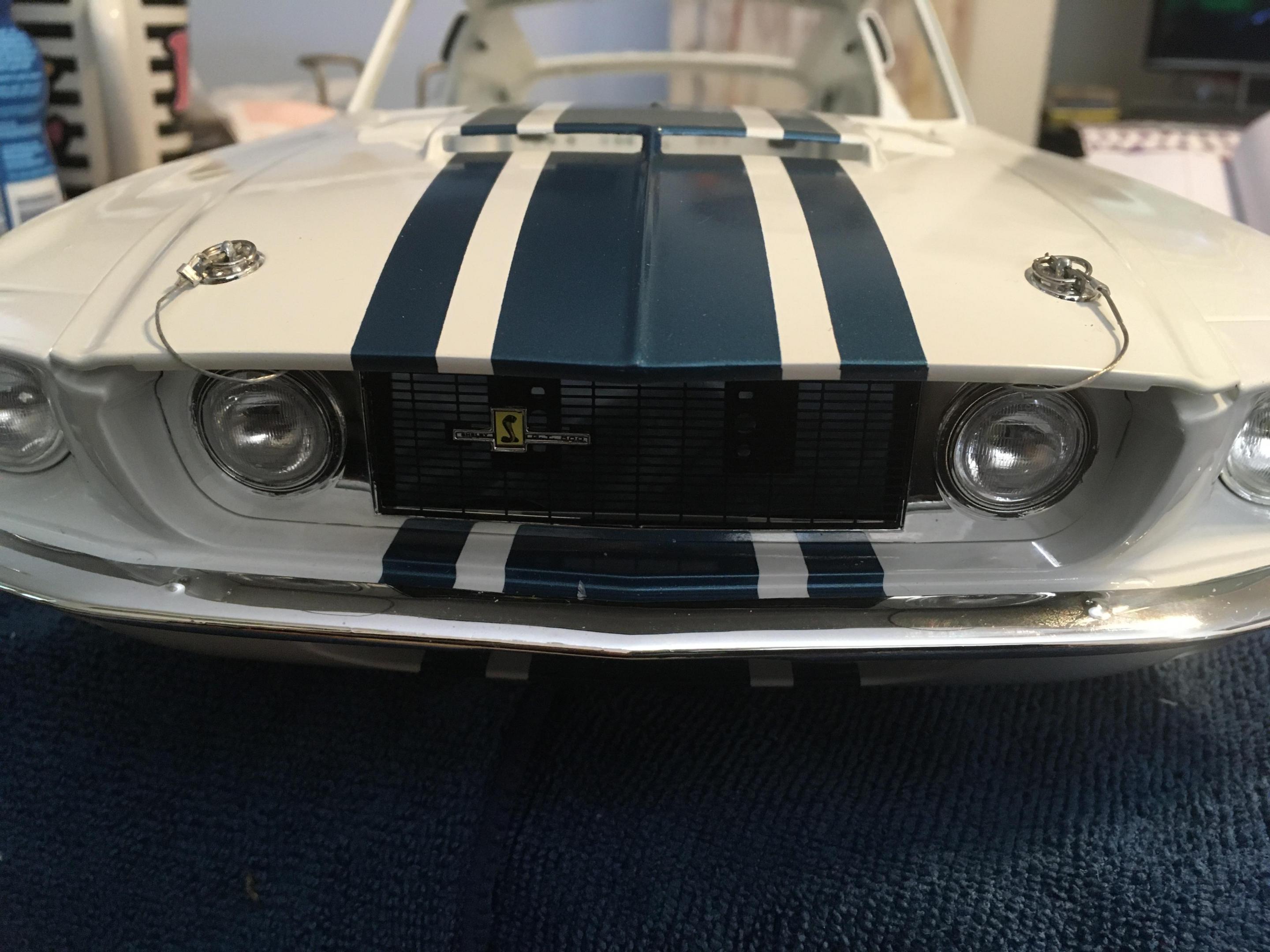

One area that needs attention is how the doors fit. While the assembly is pretty straight forward, one problem I see is how the doors at the leading edge stick out just a wee bit too much for me. One needs to thin out the inner door panels a bit at the A pillars as I believe the dash is a bit too wide and it's butting against the doors making them not quite flush.
All in all, a very nice kit for those of you that want to spend the money, and PLEASE make sure you have space to display it as it IS HUGE.
My lighting is not the best due to the type of lights I have in the house so I had to use the flash on the camera. I'd like to take outside pics, but due to the sheer size and WEIGHT of this thing, I'm not crazy about carrying it down a flight of stairs and heaven forbid it falls. If I do take this to a show, it'll literally be a one time deal as carrying this around is seriously no joke.
As you can see, I didn't go super crazy with details. Originally, I was going to add fuel/brake lines, but my better sense told me to leave that alone as I really don't want to have to turn this over to take pics. I could get a mirror to display the underside, but building this was more an effort to get back into building and to blow off the cobwebs of not being much into building for the better part of a year.
I will say there's more detail that DeAgostini could have added for the money, but in their defense I do believe that this is one of their early efforts and later kits I've seen do have more detail. If this is a must have kit for you, I say take the plunge and get one as some of their other kits have sold out already and there's no guarantee they'll make 'em again. The Jaguar E-Type comes to mind as that was one I wanted, but I waited too long and now it's discontinued. BTW, for those of you that missed the thread of the build-up......it is here.
Thanks for looking!
