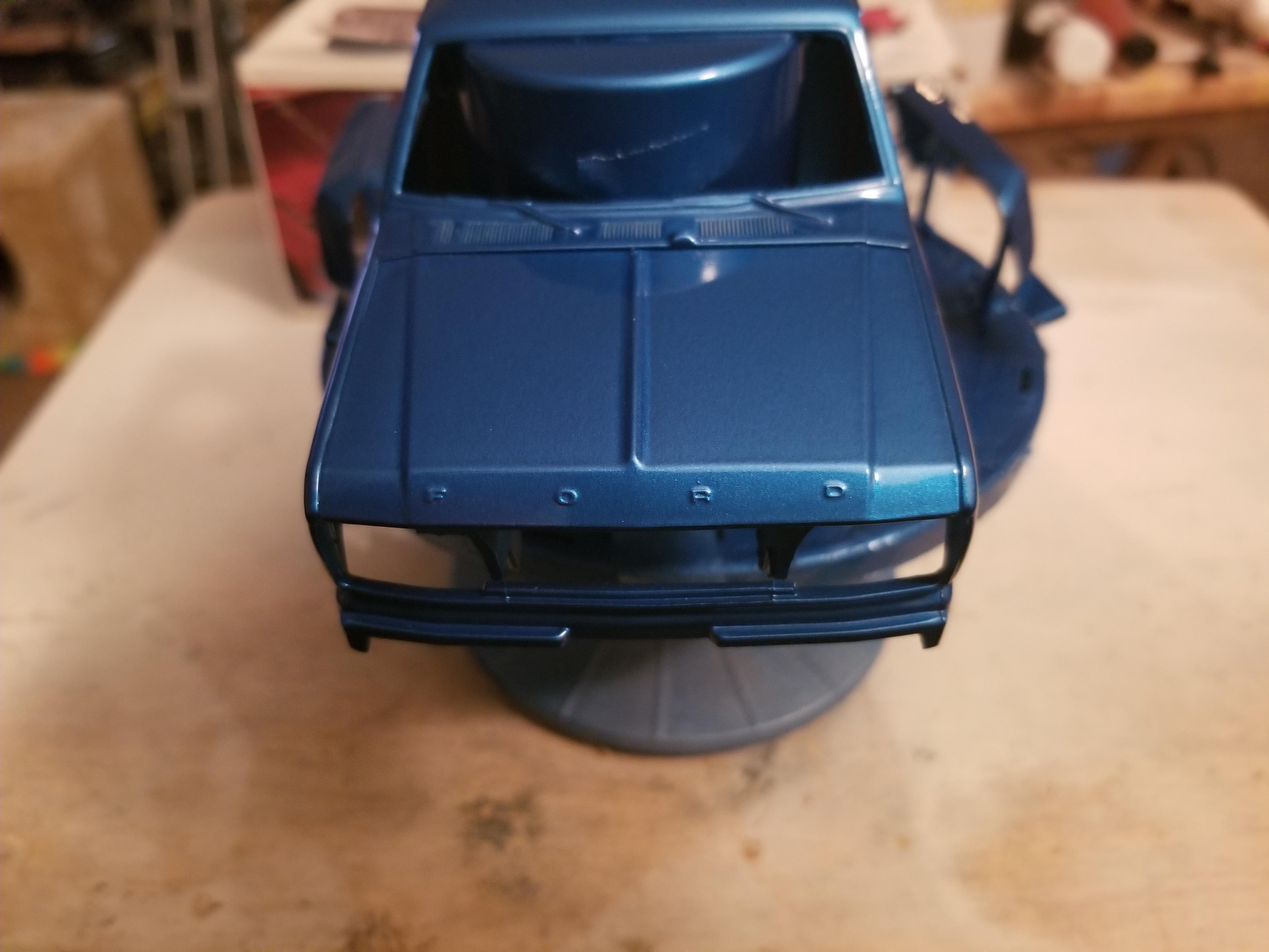

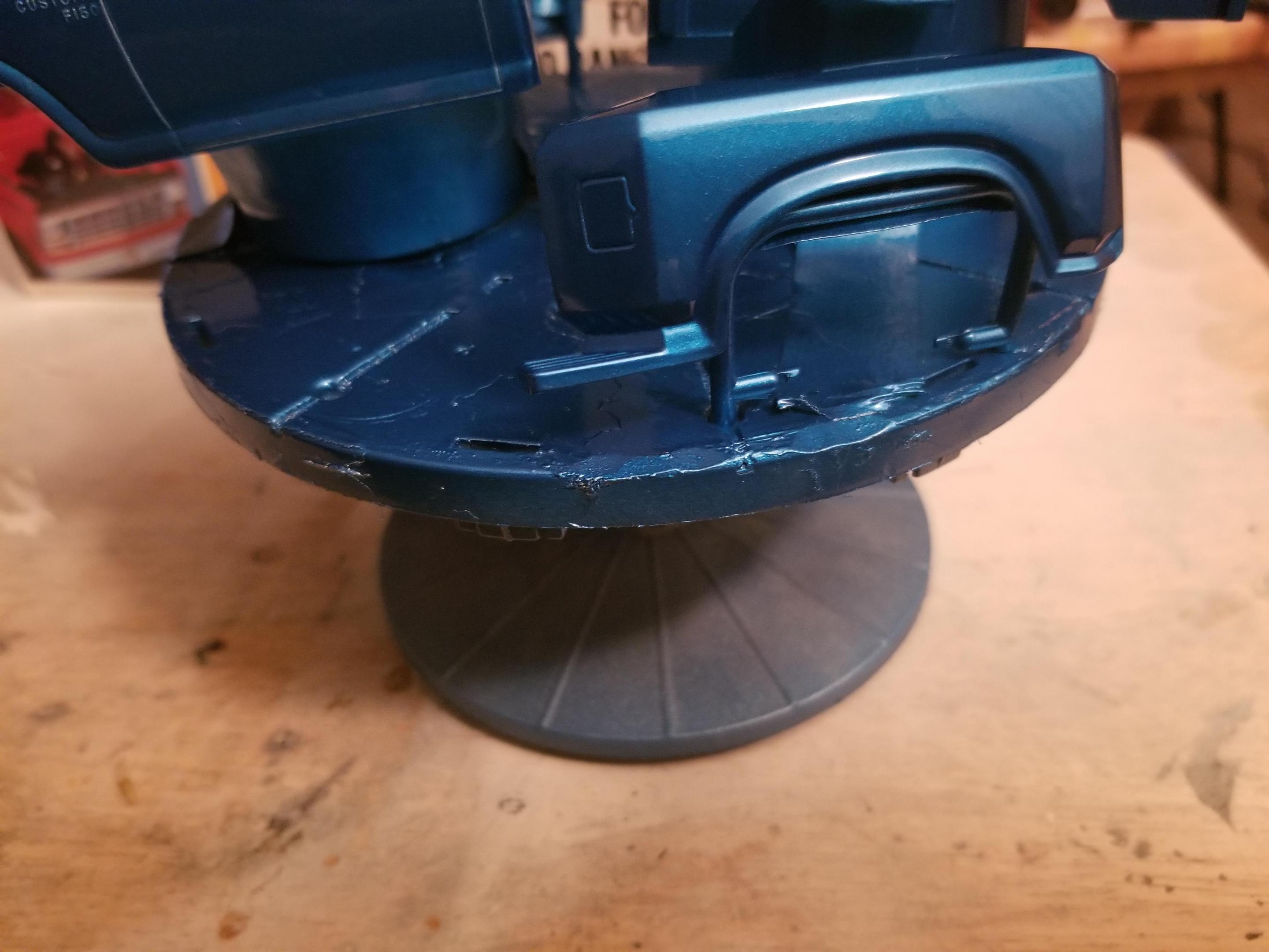

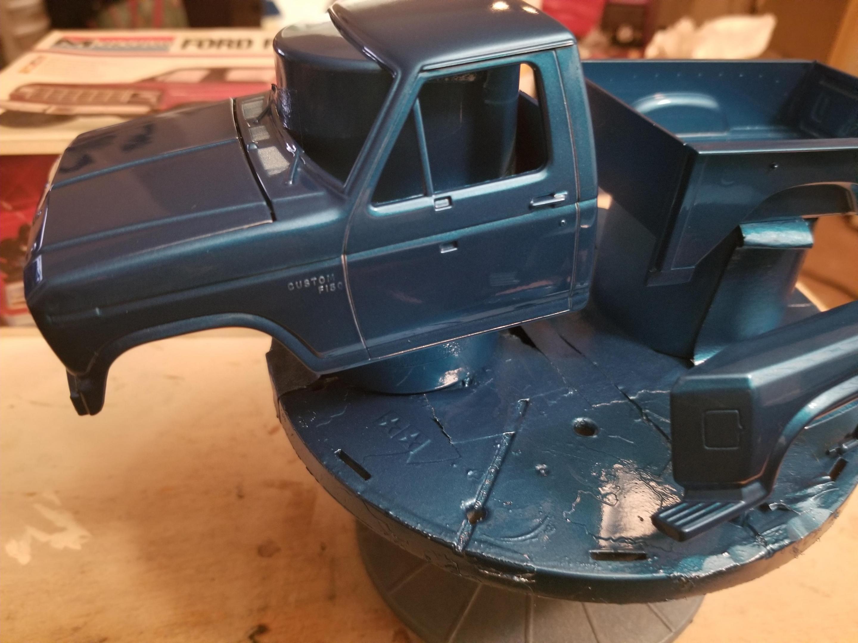

youpey Posted February 23, 2021 Author Posted February 23, 2021 (edited) Here are a couple of pictures. I think this might actually be the best paint job i have ever done. I did 1 coat of silver, 1 thin coat of the blue, then one gloss coat of the blue, then a clear coat. I did not polish or compound the paint at this point and i can see reflections in it. Its hard for me to show in pictures but here is what i took. The blue is tamiya ts54, light metallic blue and tamiya ts13 for the clear. The silver is tamiya ts76 mica silver. there is nothing else done to it at this point, just let the paint dry. i need to do the door lines and such in a dark color, but otherwise i am really happy with this paint job. i dont say that very often. in fact, i dont think i have ever said it Edited February 23, 2021 by youpey
