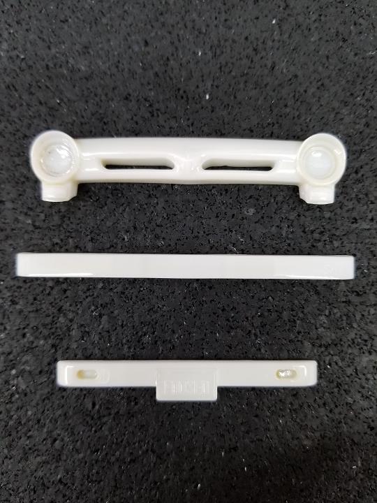

I tried the Dawn Power Dissolver and didn't have any luck.  I'll try the bleach method tomorrow since the wife has some on hand.

Well, any acid or alkaline solution will dissolve the thin layer of aluminum "chrome", and Coke contains Phosphoric Acid.

It removed the metalization, but the shiny clear undercoat is still on the plastic.  But maybe that was your goal.
Just looking to have a good surface to paint.
