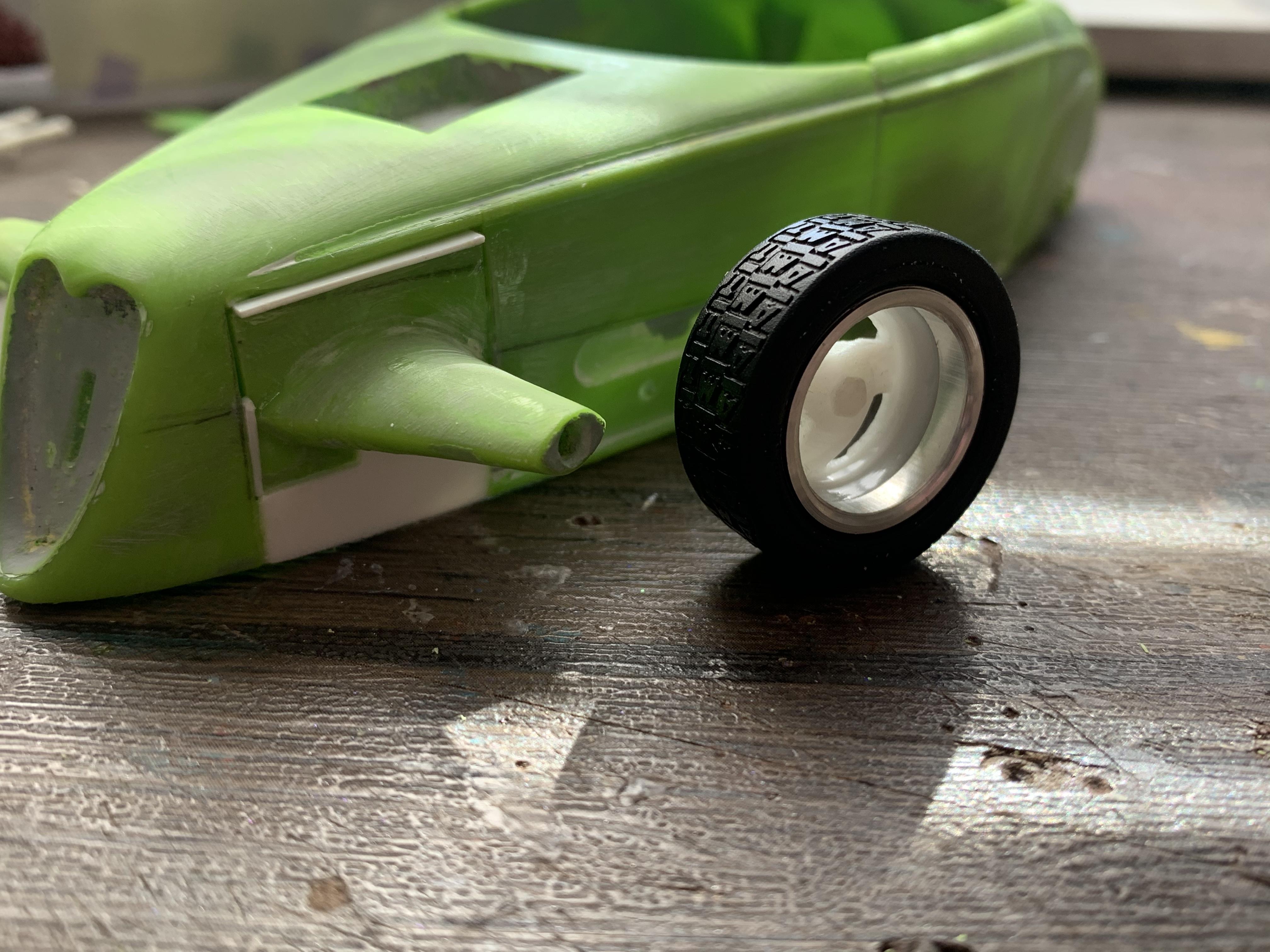

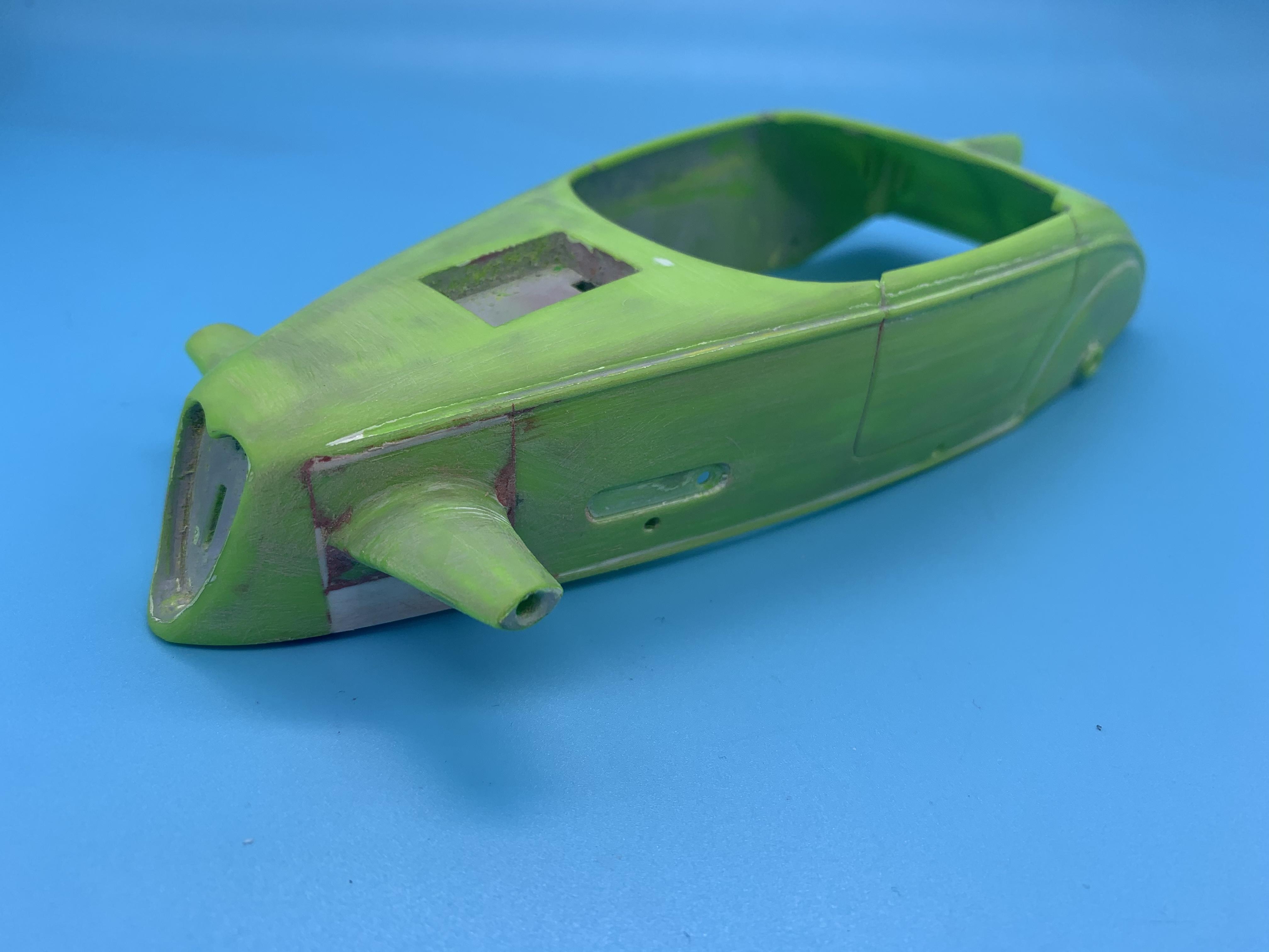

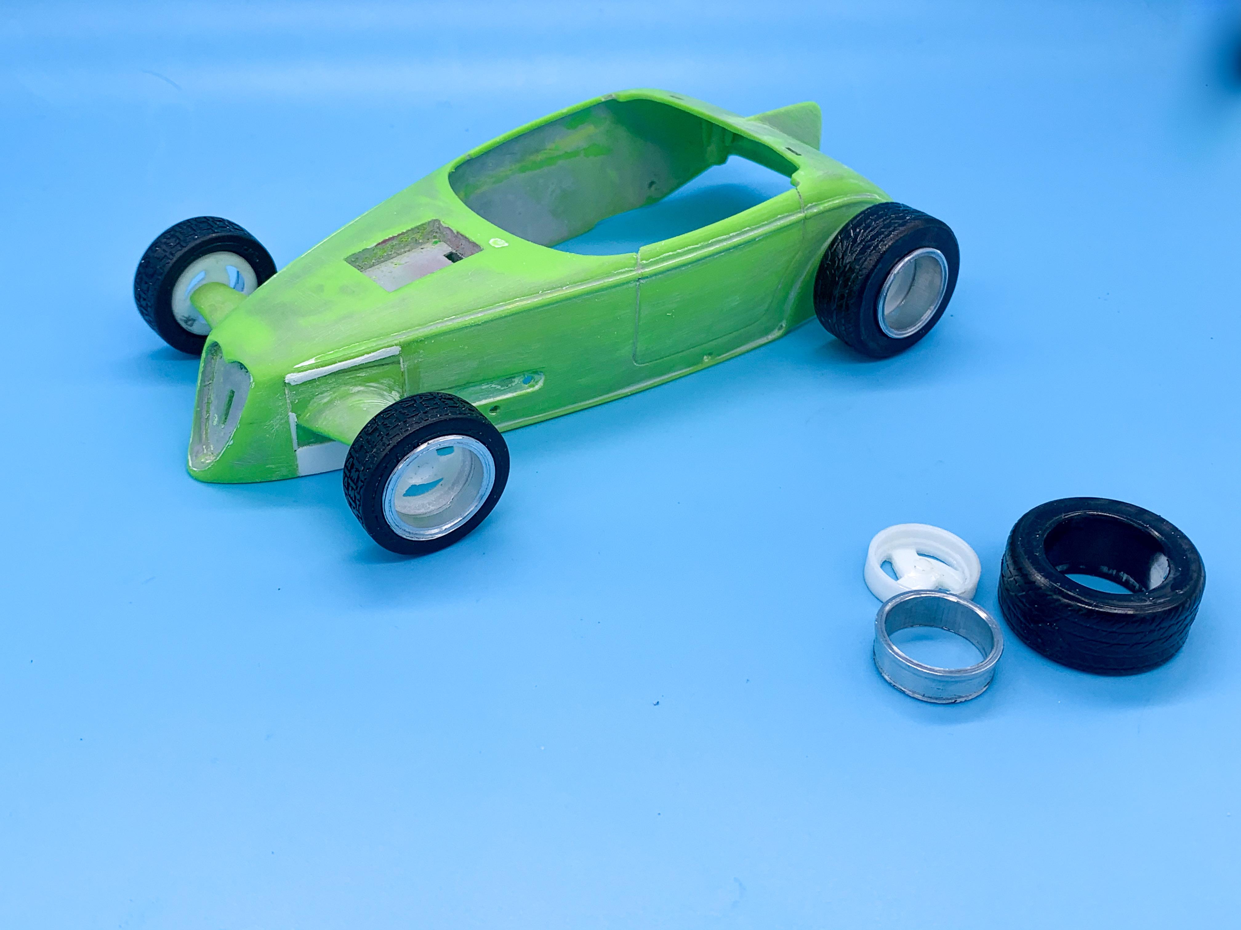

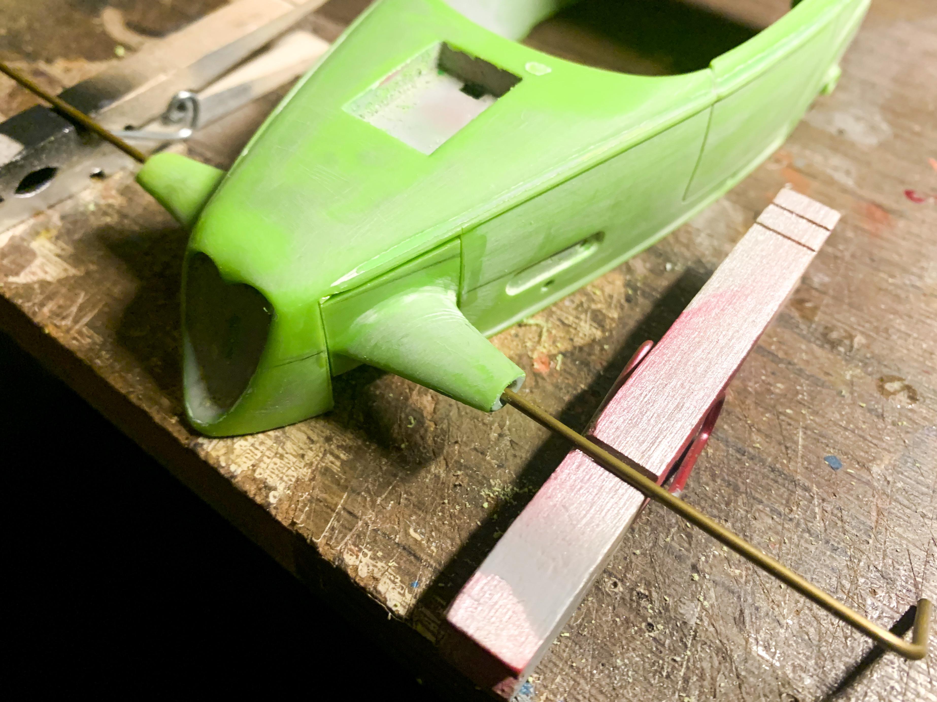

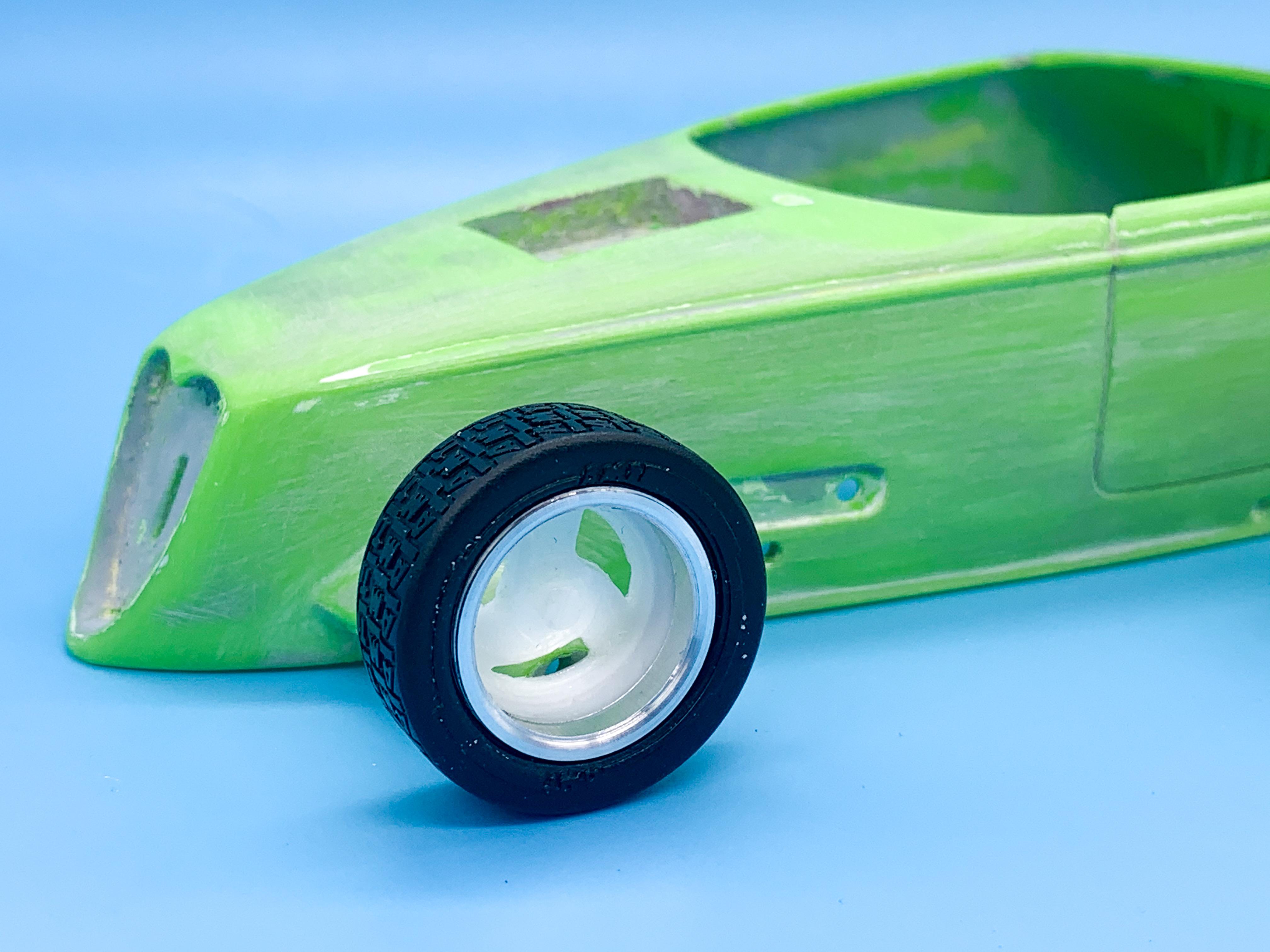

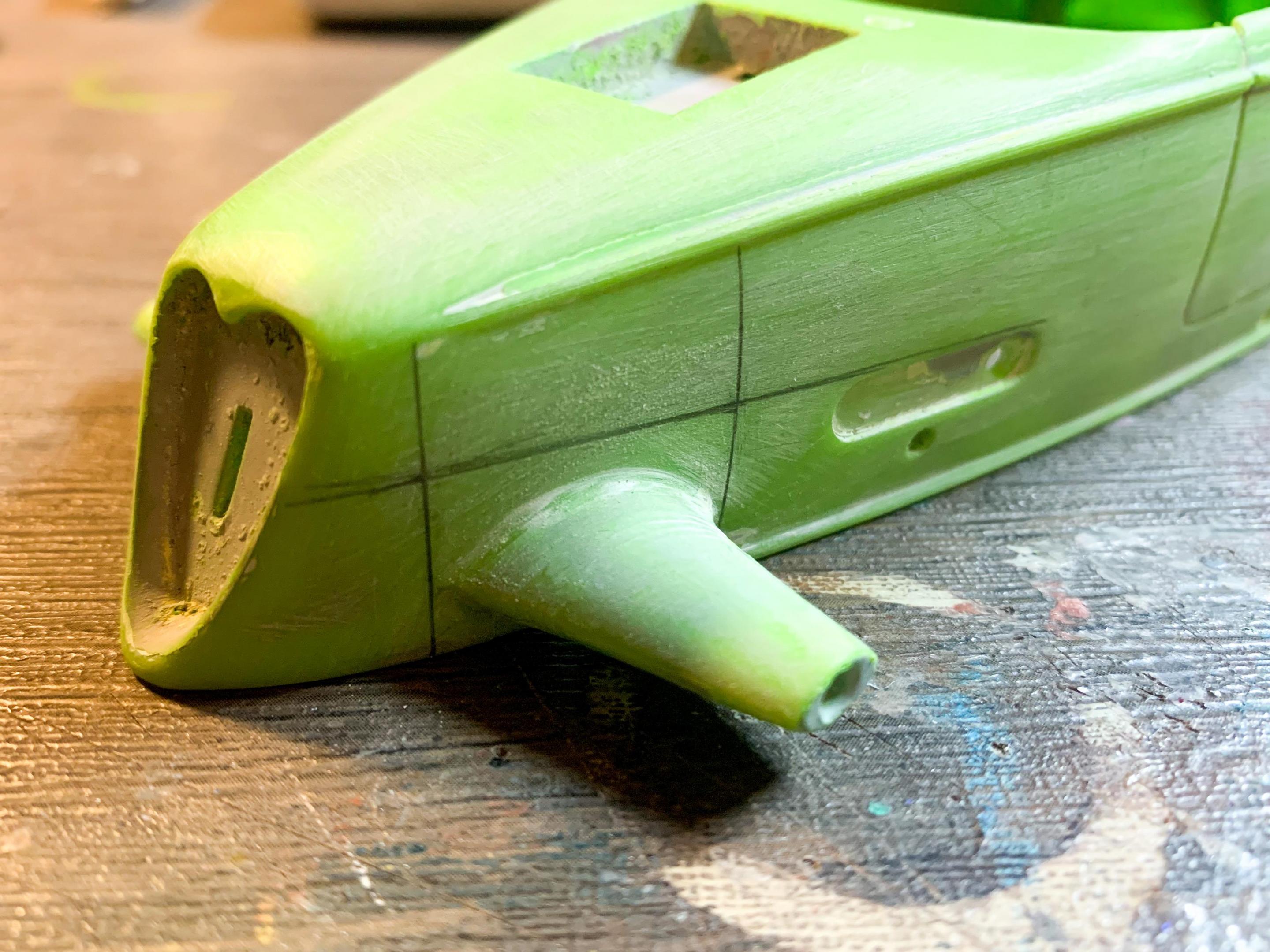

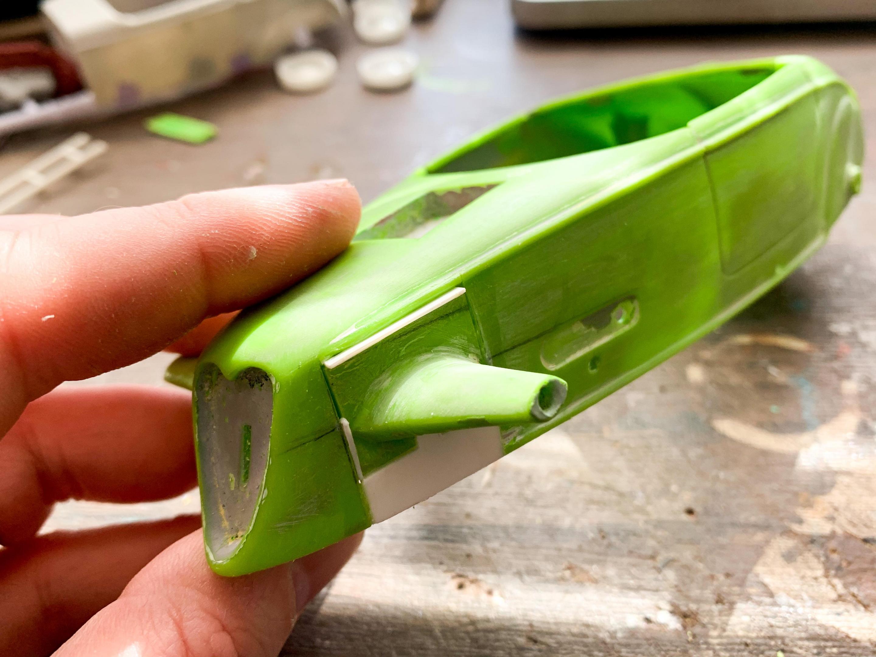

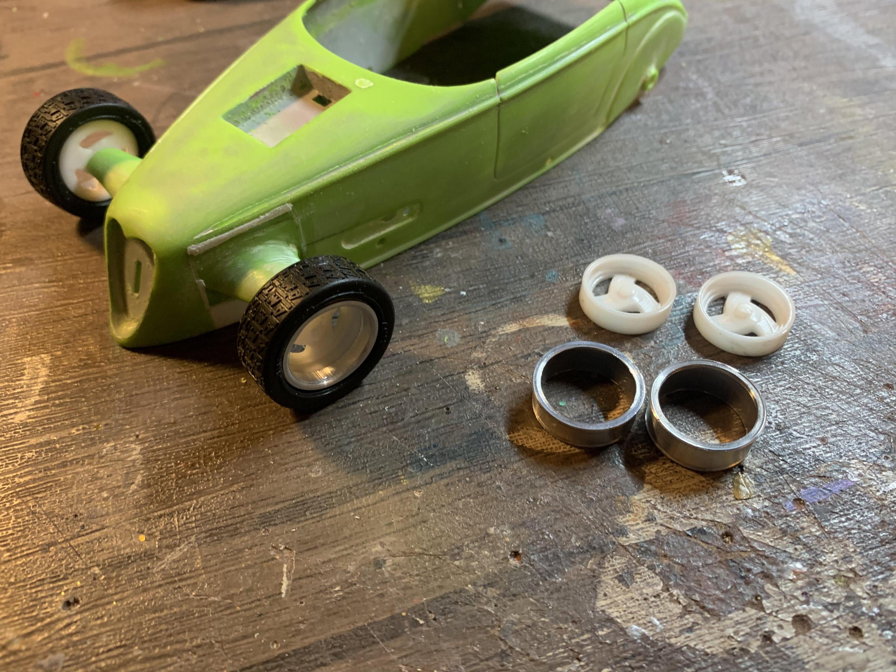

OldNYJim Posted March 22, 2021 Posted March 22, 2021 (edited) I’ve had this AMT Rod-Rageous slammer for a couple of years now, and kept pulling it out and trying a paint job on it, then kinda changing my mind, then getting it nearly done but the kit stance and wheels were horrible and so on and so forth. So, trying this thing at least a third time (with some better tools and a better plan...) This is the kit as it comes (probably my fastest ever build! ?) Kinda dorky and weird - and I got stuck for a year or so trying to think what I could do for wheels to improve it, and settled on a nice set of directional Boyd tri-spokes from the Aluma-Coupe kit. I mocked up one with rim that I machined...now we’re talking! I get get on board with that! Made another three - I’ll keep the AMT treaded tires for the front but switch in some more conventional ones for the rear. I really wanted to get the nose way down in the ground, and couldn’t figure out a better way than hacking it all apart and moving those wishbones up a bunch...so here goes: Sliced and diced and tacked back into place with a rudimentary jig to keep everything aligned: Adding some material to replace the kerf losses from the saw, and to fill the gaps: And now it should sit something like this: Way better! I’ll actually have the tail end about where nature (AMT) intended, but getting the nose down will help a bunch I think! A little filler to level out all the seams: And a blast of primer to see what all needs fixing before paint! Got a really fun paint idea for this one, once I get my head around how to achieve it...more soon! Edited March 22, 2021 by CabDriver

r60man Posted March 23, 2021 Posted March 23, 2021 Lowering really transforms the look entirely. I would hate to come across a speed bump while driving that! Fun stuff, great work!

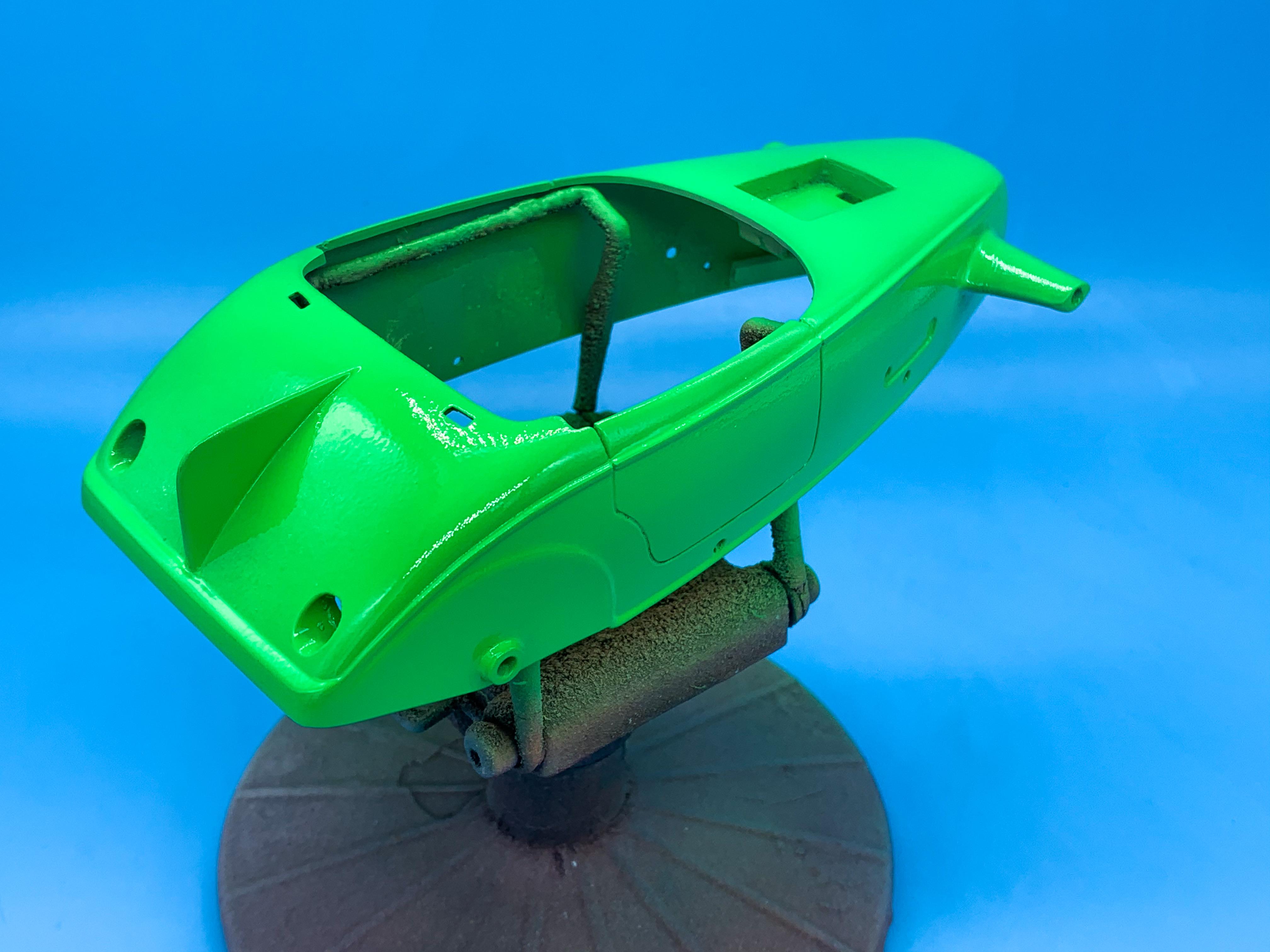

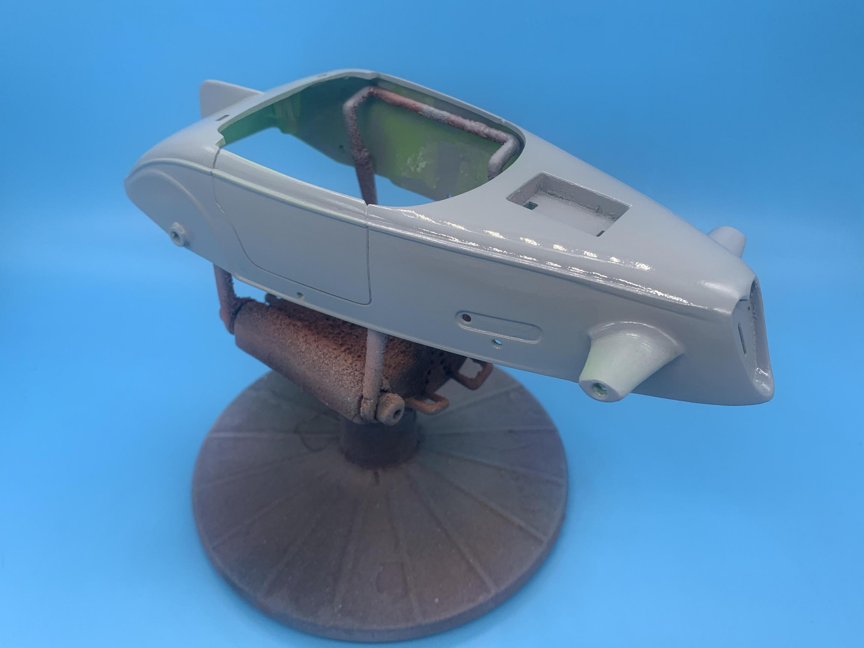

OldNYJim Posted March 23, 2021 Author Posted March 23, 2021 (edited) Thanks everyone! 2 hours ago, r60man said: Lowering really transforms the look entirely. I would hate to come across a speed bump while driving that! Fun stuff, great work! I’d hate to have to steer the thing - no idea how they intend for the steering to work? I’m pretending this thing has in-board disk brakes and some kind of arrangement like a Bobcat to make it turn, but who knows. I’m also pretending there’s an air ride system hidden under the body there ?? Got some base color laid down right before bed last night - sure went to a lot of effort to make this neon green slammer into a slightly different neon green slammer ?? Been trying to figure out a cool idea I had for the paintjob - excited to get home and start masking and airbrushing...more soon! Edited March 23, 2021 by CabDriver

Spex84 Posted March 24, 2021 Posted March 24, 2021 Cool! It's definitely looking better. One thing I wish I'd been early enough to this thread to suggest...would be moving the front wheel "wings" forward a scale 6" or more, so that the front tires are even with the front of the grille, or even projecting a little beyond it. Kit-stock, the wheelbase looks a tad short.

David G. Posted April 4, 2021 Posted April 4, 2021 Lowering the front suspension is certainly an improvement. I'm interested to see what you do with the rest of it. My first thought was that those front "wishbones" looked like submarine diving planes, more so now that they're midline. That, along with the "rudder" on the rear deck lid, I might have put a bubble on top and tried to make it a mini-sub. David G.

NOBLNG Posted April 16, 2021 Posted April 16, 2021 Looking good so far, ? A nice gloss on there should really make it pop.
