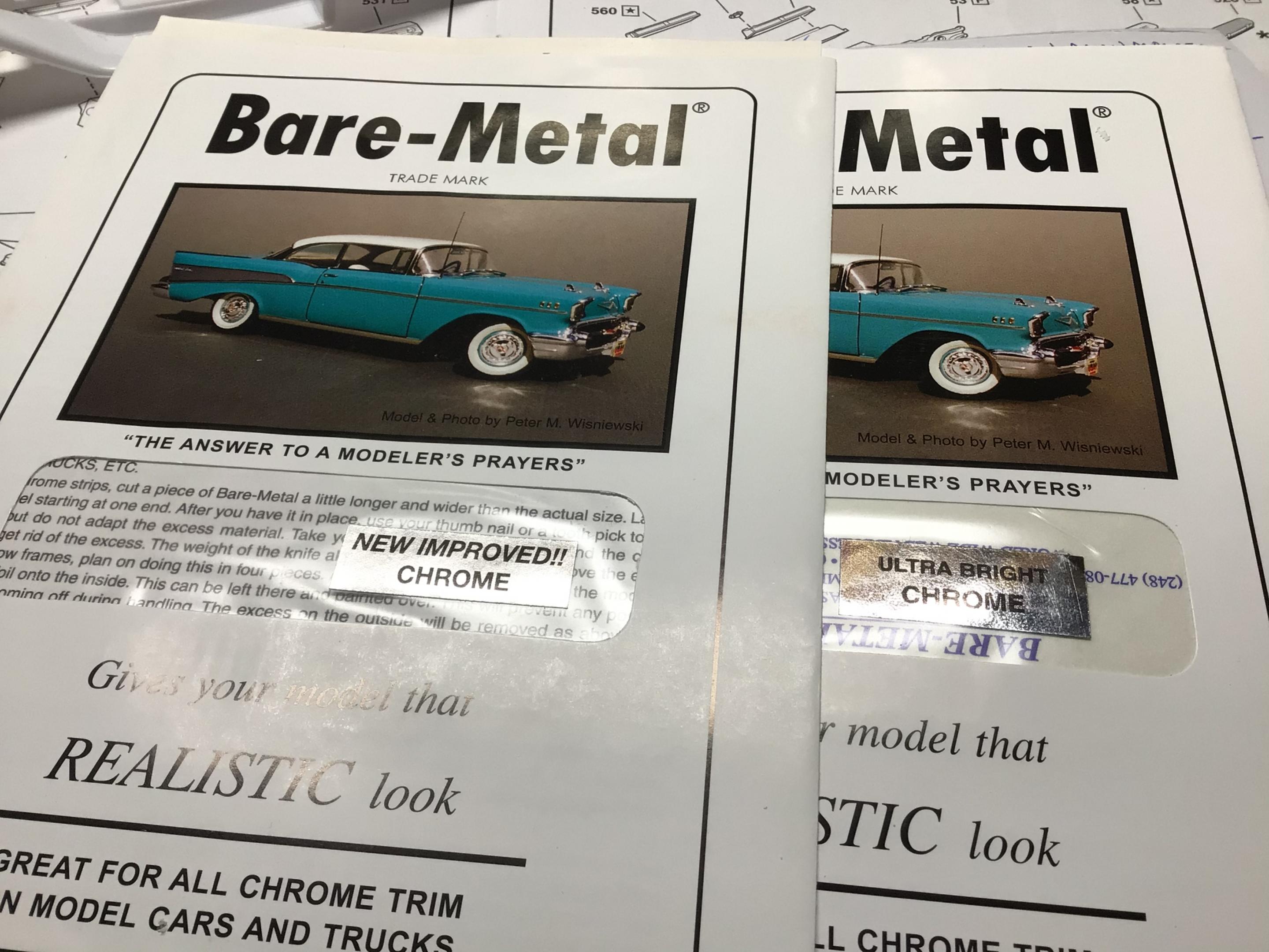

Got all the BMF on the roof window trim and wasn't at all satisfied with the results so after 2 days I scraped it all off. I kinda thought maybe the reason was the fairly old foil so ordered and received a perfect new sheet. So I started today on the rear window trim and the foil just slides off. As much as I think this will wind up being a pretty nice build of a cool model I'm about to toss it back in the box and forget about it for a while.
3 hours ago, Zippi said:
That's what I was thinking Chaz.  Maybe a little scuffing up is all it would take.
I had the same issue recently with BMF and tried scuffing up the parts, but no difference. I was thinking the BMF adhesive was no good.
I did not have any luck getting their “ultra bright chrome” to stick. The “new improved!! chrome” worked.
Edited by NOBLNG
I recently used the Ultra Bright BMF and it was pretty awful. Nothing like the older ordinary stuff. Terrible adhesion and really brittle.
That car is beautiful though! Great job ?
Edited by Rockford
Thanks for the input guys. I thought the same about it being too slick but I have never had the issue before. I did scuff it up and results were better. I do agree about the Ultra...it's not good at all. I still think the adhesive is not as good now as it was on the older BMF.

Update:  This foil sucks.  I roughed up the area, cleaned it and the foil just doesn't stick. I emailed the vendor, hopefully I can get another sheet and it will work. I have a bit of the older foil and will try it again.  I just gotta get this model finished.....I'm about done with it (and I don't mean done as in finished).
Mike, where did you order the bmf from? I ordered some from micro mark and it did not stick very well either. I then ordered some from the actual guy that makes the stuff and it worked, but not as good as it did a few years ago. Have you looked into the new testors paint pens? A guy at short track models forum showed me some of his work using the pen and it really looks good. If I can find a silver testors pen, I'm going to try that on my next build. i hate using bmf even when it sticks. all that trimming is maddening.

Unfortunately, I've heard a lot of bad things about the recent batches of foil. I got a sheet in 2-3 months ago but haven't used it yet,  I hope it's OK. I still had enough of my last sheet to do the '68 Chevelle, and might have enough left for my next build too, the AMT '71 Duster. After that it's onto the new stuff and cross my fingers it sticks, lol. I have heard that when the foil doesn't stick very well, using something like Elmers or Mod Podge or anything else that can be brushed on to the surface where the BMF will be applied and dries clear, is known to help a lot.

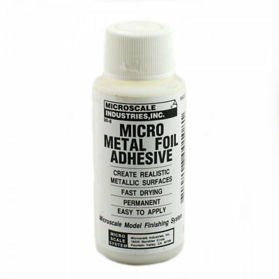

Seems like there was a special adhesive for those who used regular kitchen foil to replicate chrome trim.  I wonder if you could run a bead of that along the trim lines beforehand.  A quick Google search gave me this, although there seems to be at least one more variant (same bottle, blue print).  Maybe one of our more informed members can chime in...
Thanks Monty, that looks like a useful product.  If I can't get a replacement I will definately look into it.
