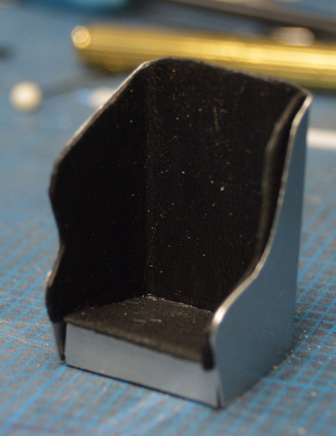

Straightliner59 Posted June 10, 2021 Share Posted June 10, 2021 (edited) I picked up a couple of square feet of bookbinding leather. The stuff I bought is referred to as 1.5 oz. leather. The "sheet" I got averages right at .015" thick. I was looking for something to use for the upholstery in my Supermodified. My idea was to use basic leather-tooling techniques to create an upholstery pattern. For the test, I used the brass strip and ball-peen hammer in the photo. I merely eyeballed the pattern for the test. There are several areas with a finer grain than pictured, that I can work with. I really think it has some promise! Edited June 10, 2021 by Straightliner59 Quote Link to comment Share on other sites More sharing options...

Straightliner59 Posted June 14, 2021 Author Share Posted June 14, 2021 I used a paper pattern to cut out the leather for the seat. Once those were dry-fitted and I was happy with them, I diluted some tacky glue with water, and soaked the leather pieces in it for a few minutes. The fit is excellent, and it's all staying in place. Next, I will peel it from the seat, and begin tapping my pattern into it. Not sure when I'll get to that step, as I am working on several other aspects of this project, as well. Quote Link to comment Share on other sites More sharing options...

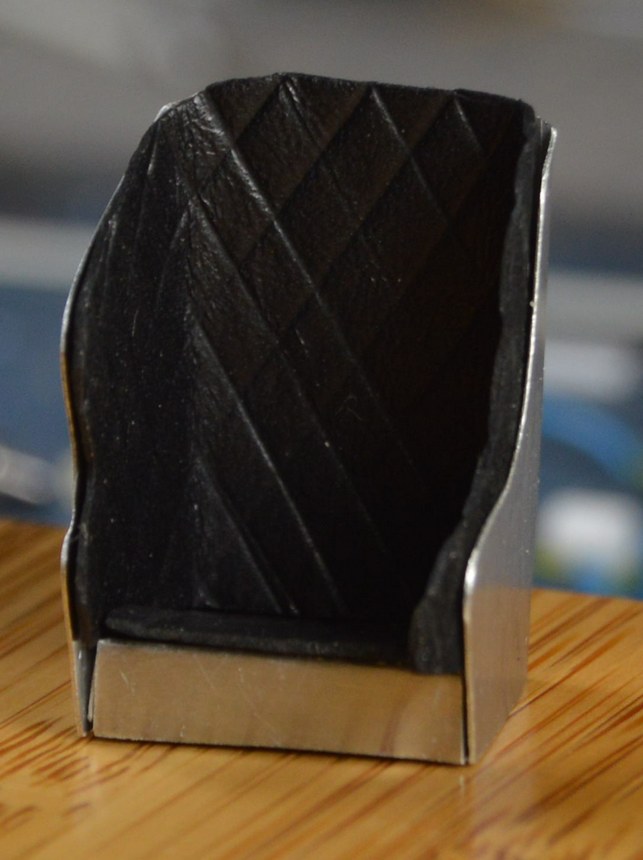

Straightliner59 Posted June 19, 2021 Author Share Posted June 19, 2021 I finally got around to embossing this thing. Not bad for a first attempt! Quote Link to comment Share on other sites More sharing options...

Bainford Posted June 20, 2021 Share Posted June 20, 2021 4 hours ago, Straightliner59 said: I finally got around to embossing this thing. Not bad for a first attempt! Yes sir, I’d say you’re on to something. Nice work. This shows real promise. There’s a lot of possibilities with this stuff; door cards, convertible boots, tonneau covers, to name a few. I’m intrigued buy your method of soaking the leather in the glue solution. Did this have an effect on the final appearance of of the ‘pretty side’ when all was dry? How well did the leather pieces stay together when prying it away from the seat frame? Quote Link to comment Share on other sites More sharing options...
Straightliner59 Posted June 20, 2021 Author Share Posted June 20, 2021 1 hour ago, Bainford said: Yes sir, I’d say you’re on to something. Nice work. This shows real promise. There’s a lot of possibilities with this stuff; door cards, convertible boots, tonneau covers, to name a few. I’m intrigued buy your method of soaking the leather in the glue solution. Did this have an effect on the final appearance of of the ‘pretty side’ when all was dry? How well did the leather pieces stay together when prying it away from the seat frame? Trevor, thanks for your comments. I used Alene's Tacky Glue, diluted with water. While it was still damp, I conformed it to the seat pan. When I got back around to it, it peeled right out. I laid the pattern out on the same paper I used to cut the leather, marked it, dampenedit, again and tapped the pattern in! The leather needed no cleanup, as the glue dries clear, and semigloss. Quote Link to comment Share on other sites More sharing options...
