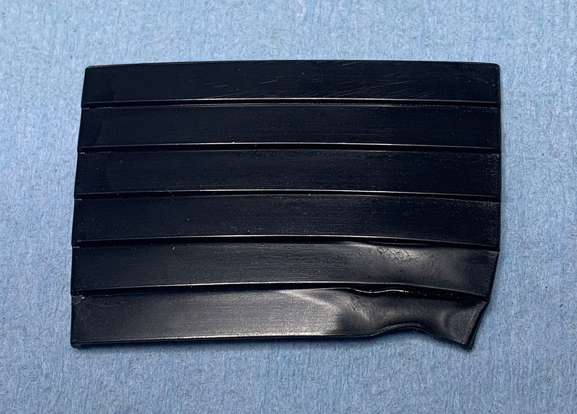

The louvers sat higher than their original position so ended up sanding the 2 bottom risers down a couple millimetres, now they're closer to the actual profile. There is a slight warp in the part so I'm thinking I can use a heat gun to soften it up so all 4 corners lay perfectly flat. I did snap one of the louvers trying to bend it by hand (mistake number one). The warp wouldn't have been an issue if the part was just glued in place.

I have a BIG problem, however. That slight warp in the rear louvers that I thought I could heat up and flatten out...
I discovered that styrene melts real quick (mistake number two).
I posted a request in the Wanted section on this forum. I tried contacting Hasegawa Japan using Google Translate, the American distributor Stevens International twice and the Canadian distributor Lightspeed Global who were the only ones to get back to me. They said they would contact the manufacturer to see if the part is available.
Anyone have an extra set of louvers they'd be willing to sell?
Edited by 70 Sting
Yikes!!  If your stuck and can't get new you may be able to make a new rear louver panel.  I don't know what the side profile looks like but from that picture is looks like just overlapped rectangular pieces.  Just a thought.
@Beans I did try playing around with some polystyrene thinking I could remake the lower 3 sections as they were the only ones affected. It looked pretty crude to say the least.
There is a slight curve to the louvers which match the body contours, a small gap in between each one and they sit upon 2 stepped risers on either side. A little much for my caveman skills.
On the plus side, Lightspeed Global got back to me this morning. The part is available, however due to the pandemic it will be consolidated with other orders and sent by boat in 3 to 4 months. Plenty of time for me to screw up something else. ?

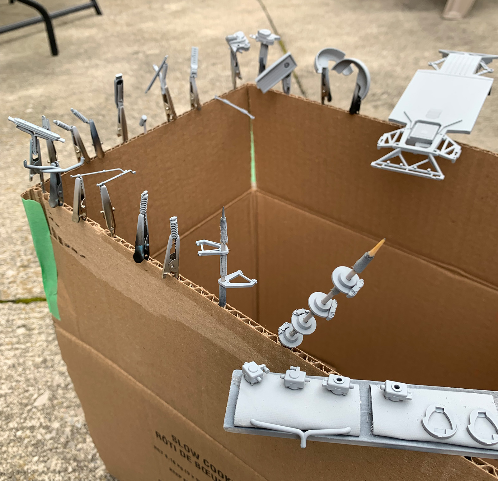

All remaining parts have been primed. I tried using gaffers tape to help hold parts with no obvious gripping/hiding places for the alligator clips as it is stickier than traditional, cheap masking and leaves no residue behind. It held on to the smaller parts pretty well and did't let go under airbrush pressure.
