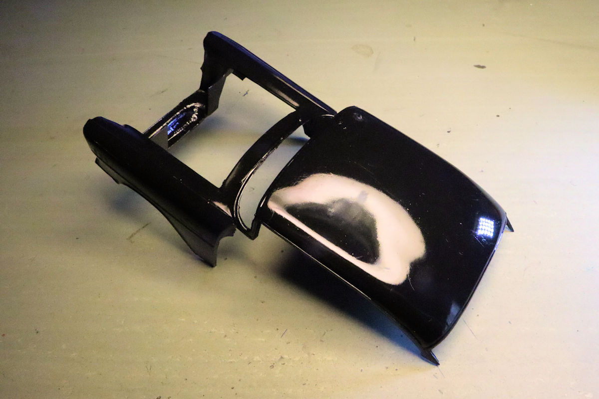

David G. Posted July 8, 2021 Posted July 8, 2021 (edited) I'm also posting this in the build thread to increase the odds of getting an answer. OK, I have a bit of a problem. In anticipation of applying a clear coat to this model I masked off all the flat black trim. I did a test on a couple of the smaller parts to check compatibility and it looked great. So I thought I was good to go and decided to start with the smaller nose clip and this happened. The coat (Tamiya TS-13) laid down unevenly with a couple of rough patches. I applied two or three more coats and things improved a little but not by much. I don't use clear coat often but I have used it before. I know that sometimes it will lay down looking like it has soft fisheyes but will almost always even itself out in about 10 or 20 minutes. This one didn't. And the rough patch; there were two, one on each of the two blue areas. The one on the right smoothed out after a couple of coats but the left side one stayed rough. Prior to painting, I cleaned the entire car in the same manner using Novus Plastic Clean and Shine. Followed of course, by a thorough buffing with a soft polishing cloth. I've never had any problem painting over Novus polish until now. I think I can smooth and polish the nose piece after it cures but I'm understandably reluctant to shoot the body. So it's masked... and waiting. Waiting until I find a solution to whatever this problem is or I decide to unmask it and proceed to final assembly. So, um... Help? I would appreciate any observations or suggestions. Thanks so much, David G. Edited July 17, 2021 by David G. Information Update

David G. Posted July 8, 2021 Author Posted July 8, 2021 On 7/8/2021 at 9:37 PM, MrMiles said: the only time i have personally experienced this was when painting on incompatible types of paint. one was a acrylic and the other was enamel. however, its odd that half of the same piece had the reaction. im interested to see what others say Expand On 7/8/2021 at 9:42 PM, Tom Geiger said: You didn’t identify the paint under the clear. It may be the Novis Polish. I’ve never had an issue with Tamiya Clear. Expand Miles and Tom, thanks for your response. The only paint on the part in question is the orange, Tamiya TS-12. The blue is actually the color molded plastic. All of it, including the test pieces, were cleaned with Novus. I even did a test on a scrap body using the exact process I planned for the Ford. I washed the scrap body with dish soap and running water, allowed it to dry, then cleaned it with Novus and buffed it, When I sprayed it with the clear coat, it first showed a little unevenness which leveled out in about 20 minutes. Aside from the scratches and other flaws in the plastic itself, smooth and shiny. Which is why I'm so dumbfounded. On 7/8/2021 at 9:42 PM, Claude Thibodeau said: Hi David! Well, never had such reaction with the TS-13, even when applying MANY coats in one session. The only suspect, IMHO, would be your use ov Novus clean and shine. The "shine" part might be the culprit. If you had a bad can, your first parts would have presented the same outcome. Even if is a pain in the neck, washing your remaining parts with a damp cloth treated with a drop of dishwasher soap might do the trick, without soaking your masking job. Finally, as you may know, it is counter-indicated to make successive TS-13 application in a short span, such as the next day or the day after. They recommend waiting 30 days (!?!) before a second coating. So, it's all in one day, or a loooooong delay between clear sessions. It sounds extreme, but I paid the price for defying this common wisdom among Tamya's users. Never again. Good luck! CT Expand Hi Claude. I thought about washing it again but I am a little concerned about what may happen to the decals if they get wet. Regarding the multiple coats, they were all laid down within about an hour and a half so they should have bonded well with each other. Thanks for all the responses. I'm still not sure what path I'll take with this yet but I sure don't want to take a chance at ruining it at this late stage. It won't do any harm to let sit with overnight with the masking while I sleep on it and see what other suggestions I receive. Thanks again, David G.

Tom Geiger Posted July 9, 2021 Posted July 9, 2021 On 7/8/2021 at 10:36 PM, David G. said: The only paint on the part in question is the orange, Tamiya TS-12. The blue is actually the color molded plastic. All of it, including the test pieces, were cleaned with Novus. Expand This could be your problem.. clear on bare plastic. The Tamiya clear is designed to be sprayed over their paints. The absence of primer / paint coats may be the issue.
David G. Posted July 10, 2021 Author Posted July 10, 2021 Thank you all for your input, I gained quite a bit of knowledge from the responses I received. It seems to me that this issue was most likely a combination of some crazing of the plastic and me applying too thick of a coat with some possible interaction with the Novus polish. I've decided that rather than risk any more issues, I'm just going to repair the finish on the nose clip as best I can and proceed with final assembly. Thanks again, David G.
