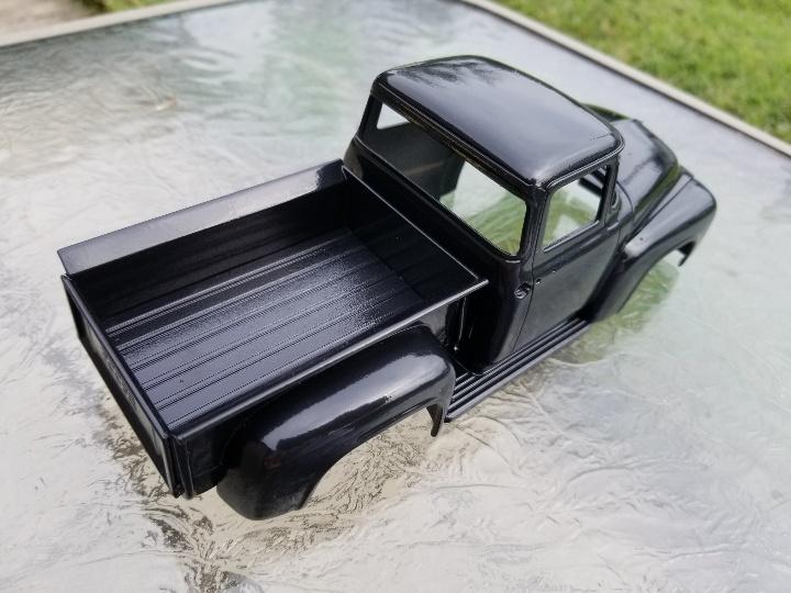

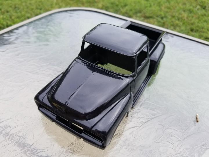

Zippi Posted September 6, 2021 Posted September 6, 2021 I painted my 56 body outside in the sun. The temp was 79 and the humidity was around 67%. Two days later I shot it with clear lacquer and the temp was around 72 and the humidity was about 62%. Seem to work ok. I'm still struggling with painting and figuring out the right temp and humidity. I'm getting better at it. Trying to get a few bodies painted for the winter builds.
peteski Posted September 6, 2021 Posted September 6, 2021 The dew point is the key (the temperature at which dew forms from the ambient air). See https://www.calculator.net/dew-point-calculator.html In both instances the dew point was in high 50s - low 60s. But as I mentioned, there are other things to consider (like how fast the paint's solvent evaporates, and that varies with the paint types and brands). The solvent evaporation rate is also directly dependent on the ambient air temperature -- that throws yet another wrench in the works. I don't think there is any specific magic formula (other than spraying when the dew point is in the high 50s or lower (which means the air is dry). 1
Zippi Posted September 6, 2021 Posted September 6, 2021 I'd say you are correct Peter. It seems to come out a little different every time I paint.
