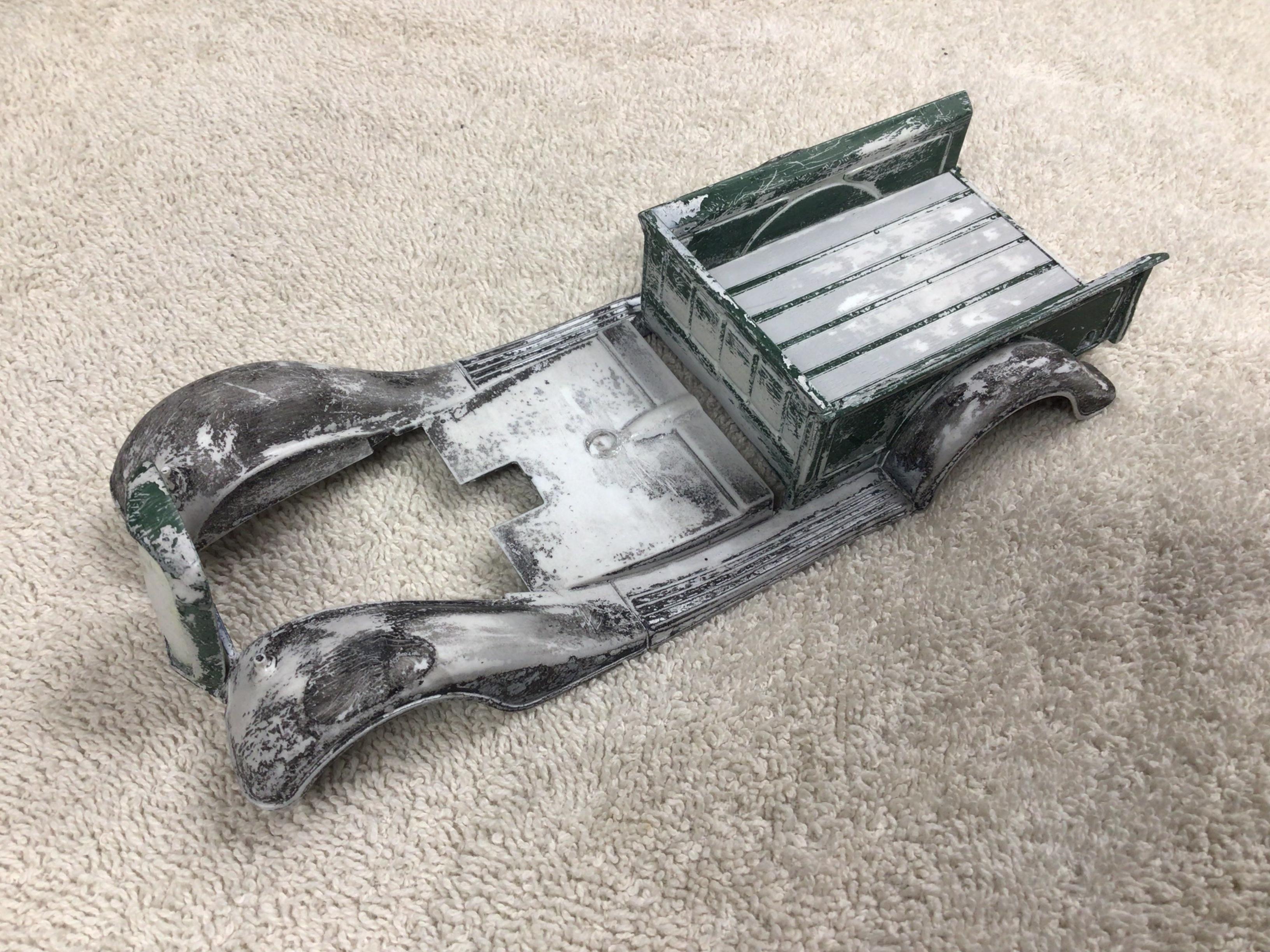

StevenGuthmiller Posted November 12, 2021 Posted November 12, 2021 1 hour ago, 69NovaYenko said: Haven't had an opportunity to use Super Clean but, I have tried Purple Power and was not impressed with its stripping power. Super Clean is better. Trust me. I've used them both. 1 hour ago, 69NovaYenko said: Wow.. StevenGuthmiller I`ve never seen paint come off like that before..its like a snake shedding it skin. That's about 4 coats of color and 5 coats of clear, all automotive lacquers. As I said, with the right primer underneath, you can strip pretty much anything with Super Clean. Steve
