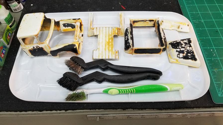

Zippi Posted December 16, 2021 Author Posted December 16, 2021 Well.....I had the body parts in the Purple Pond for a few days and that wasn't working. I switched to Easy-Off and that worked a little better but only took a little more off. I've been scrubbing the parts with various brushed and I'm not having much luck. I was scrubbing the parts with the brushes every day then switched to a few times a day. Not sure what it's going to take to get all the paint off. Guess I'll put the parts back into the Purple Pond til after the holidays and hope that works.
Cool Hand Posted December 16, 2021 Posted December 16, 2021 (edited) Try placing the body parts in a zip lock bag and spray alot of oven cleaner into the bag then seal and leave it for a couple days. Also helps to move the parts around in the sealed bag to keep them constantly coated with the cleaner. Edited December 16, 2021 by Cool Hand
Zippi Posted December 16, 2021 Author Posted December 16, 2021 7 minutes ago, Cool Hand said: Try placing the body parts in a zip lock bag and spray alot of oven cleaner into the bag then seal and leave it for a couple days. Also helps to move the parts around in the sealed bag to keep them constantly coated with the cleaner. Thank's for the reply Luke. I did have the parts in a big zip lock bag to start off with. After a couple days I took the parts out of the bag where I could scrub them with a brush.
Zippi Posted December 16, 2021 Author Posted December 16, 2021 Ok....I'll give the Easy-Off one more shot in a zip lock bag. It may not look like it but I soaked the parts with Easy-Off. 1
gotnitro? Posted December 16, 2021 Posted December 16, 2021 If that doesn't work, I've used DOT 3 brake fluid before to strip paint . Over night soak then wash w dish detergent. Worth a shot 1
Zippi Posted December 16, 2021 Author Posted December 16, 2021 6 minutes ago, gotnitro? said: If that doesn't work, I've used DOT 3 brake fluid before to strip paint . Over night soak then wash w dish detergent. Worth a shot Thank's Jeff. If this doesn't work, for the money I'm spending it would be cheaper for me to pick up another kit at HL for $14.95 when they have their 40% off. 2

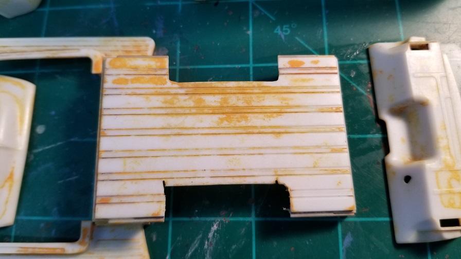

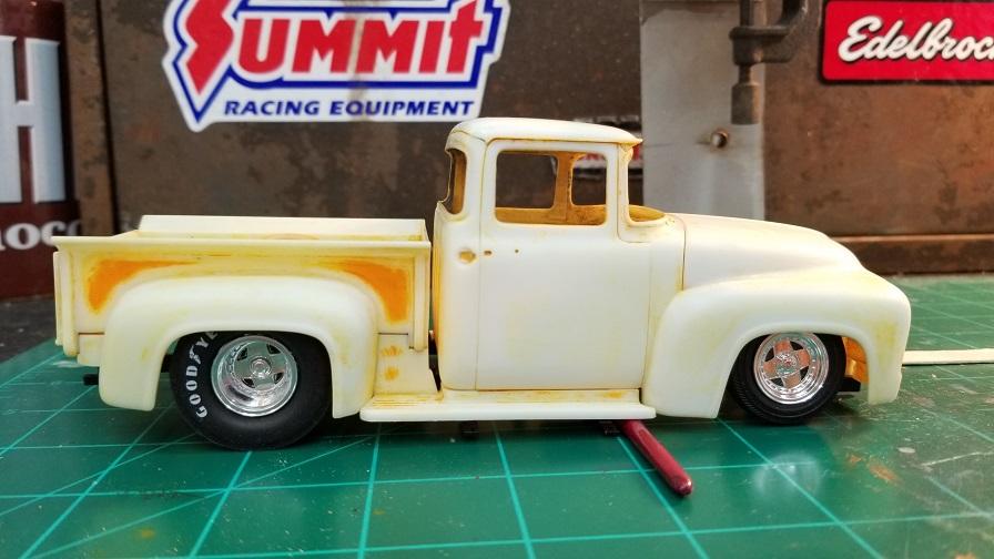

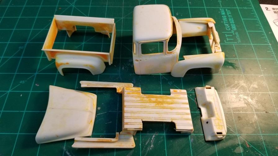

Zippi Posted December 19, 2021 Author Posted December 19, 2021 Just pulled the body parts out of the Purple Pond. Parts were in there for a couple days. Got most of the heavy paint off and I think this is as good as it's going to get. A good sanding and clean up and I think it's going to be ok. 1
Zippi Posted December 19, 2021 Author Posted December 19, 2021 The plastic feels a little soft so I re-assembled everything to make sure it still fit's ok and it seems fine. 1

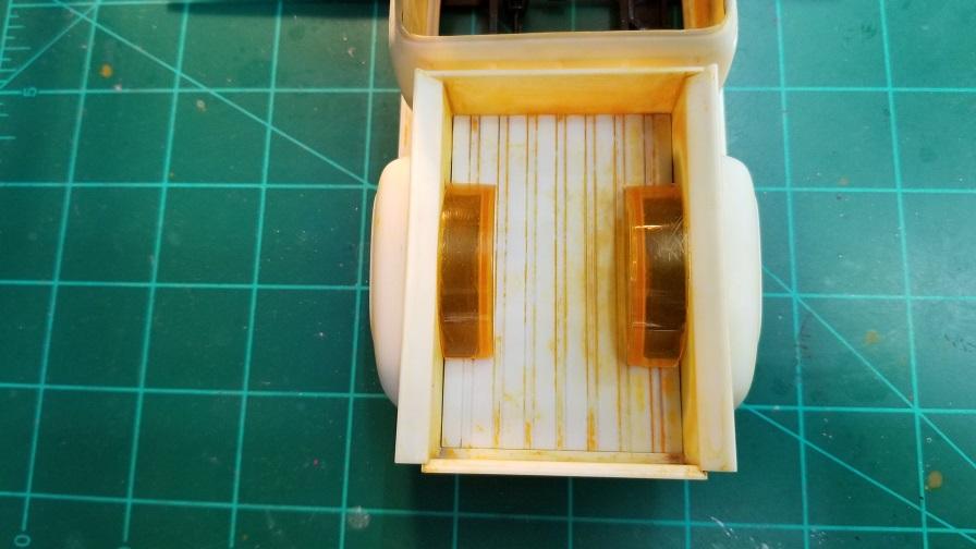

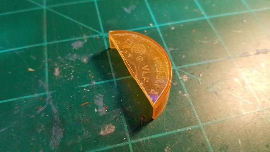

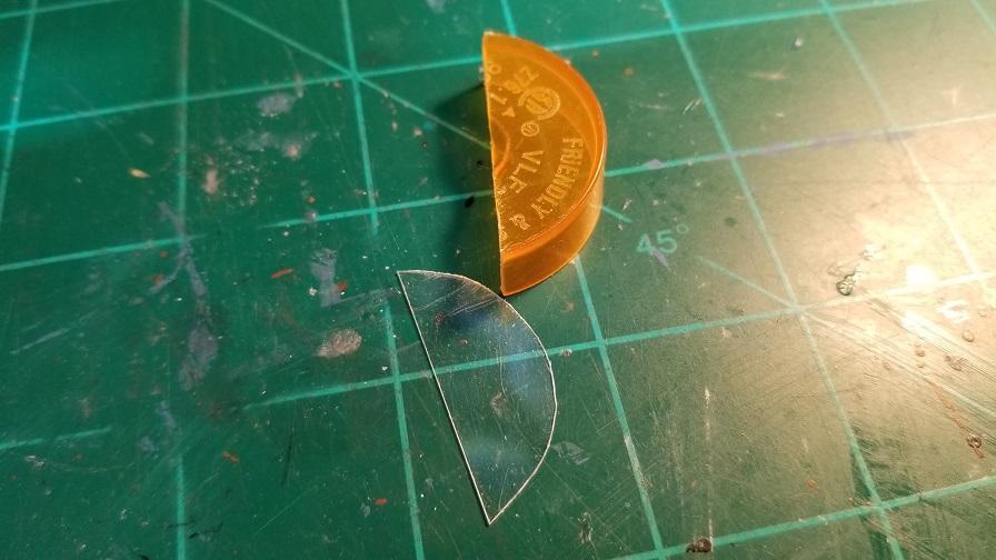

Zippi Posted December 20, 2021 Author Posted December 20, 2021 (edited) Made change to the tubs this morning. I decided I didn't like the embossed letters in the plastic from the bottom of the pill bottles so I cut some .010 thick Evergreen Polystyrene sheet and glued them on using Mod Podge. We'll see how it turns out. Edited December 20, 2021 by Zippi 1

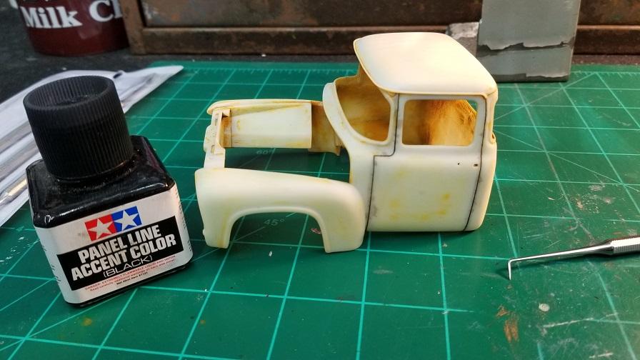

Zippi Posted December 20, 2021 Author Posted December 20, 2021 I've tried a couple times before using a worn out #11 blade to scribe panel line and I always seem to hack up the body as the blade always slips out of the line. I got a new scribe and thought I'd give it a try. Never slipped out once but not sure if I got it deep enough. I guess I'll find out once I get some paint on the body. 1
Zippi Posted December 21, 2021 Author Posted December 21, 2021 27 minutes ago, NOBLNG said: Looking good Bob. Tubs look very nice. Thank's Greg. Hope they turn out ok once I shoot some paint on them.

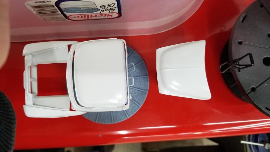

Zippi Posted December 21, 2021 Author Posted December 21, 2021 I got the flat white paint on this afternoon. The body was pretty rough after sanding and scrapping trying to get all the old paint off but all in all I'm pleased with the outcome. The tubs don't look as good as I was hoping for. First time for this type of mod so I'll take it I guess.
Cool Hand Posted December 22, 2021 Posted December 22, 2021 Nice recovery with the paint Bob. Tubs look the part and suit purpose.
Steve H Posted December 22, 2021 Posted December 22, 2021 Hi Bob, this is coming along great! Anything with tubs piques my interest. That latest mock up stance is still killer. Glad you were able to strip the paint successfully. Just a thought for the tubs, if it’s not too late. Take your favourite sanding stick to the edge of the tub that is still protruding and knock it down flush with the piece you added. It looks good as is, but that might give a smoother look? Either way this is super fun watching come together, you’re doing a great job sir. Sounds like you are enjoying stepping outside your comfort zone. Cheers, Steve
Zippi Posted December 22, 2021 Author Posted December 22, 2021 1 hour ago, Cool Hand said: Nice recovery with the paint Bob. Tubs look the part and suit purpose. Thanks Luke. 24 minutes ago, Steve H said: Hi Bob, this is coming along great! Anything with tubs piques my interest. That latest mock up stance is still killer. Glad you were able to strip the paint successfully. Just a thought for the tubs, if it’s not too late. Take your favourite sanding stick to the edge of the tub that is still protruding and knock it down flush with the piece you added. It looks good as is, but that might give a smoother look? Either way this is super fun watching come together, you’re doing a great job sir. Sounds like you are enjoying stepping outside your comfort zone. Cheers, Steve Thanks Steve. Yeah its probably to late. Don't want to mess up what I have already. I now know what not to do next time around. This has been a fun build so far. Still need to narrow the rear axle and relocate the shocks and I think I'm home free.
Zippi Posted December 23, 2021 Author Posted December 23, 2021 Temp got up to 54° today so I had the green light to do some painting. I had it up to 70° in the garage. I got my 60 Ranchero painted and I got the Pearl Clear on the 56. The pearl clear did not say gloss so I was assuming it would have more of a matt finish. It came out a little to shiny for what I was going for. I'll skip the wet sanding and just polish it but it may still come out to shiny. 1
TransAmMike Posted December 24, 2021 Posted December 24, 2021 Looks just fine shiny like it is Buddy?
Zippi Posted December 24, 2021 Author Posted December 24, 2021 24 minutes ago, TransAmMike said: Looks just fine shiny like it is Buddy? Thanks Buddy. Just wish it was more of a Matt finish.
