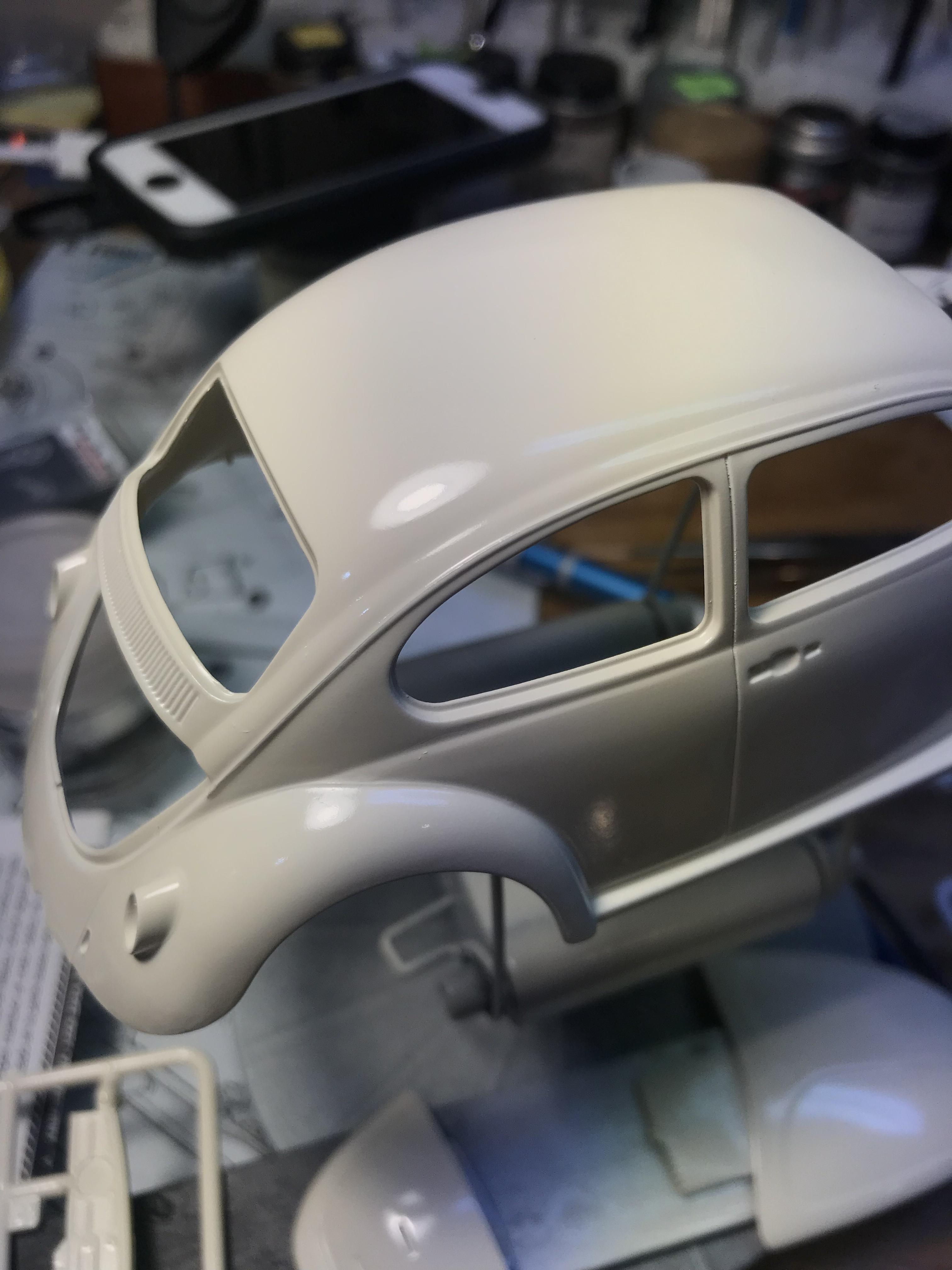

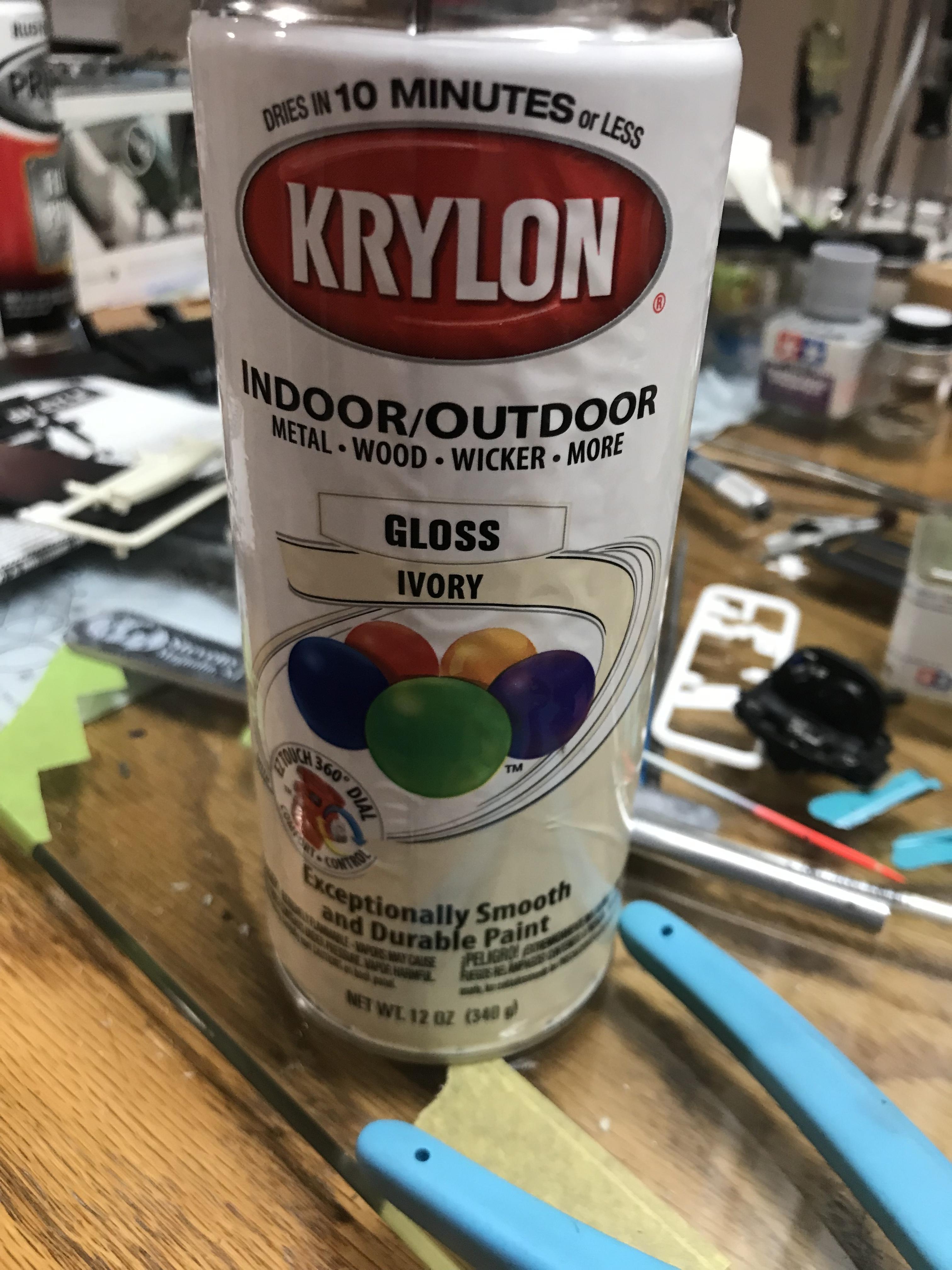

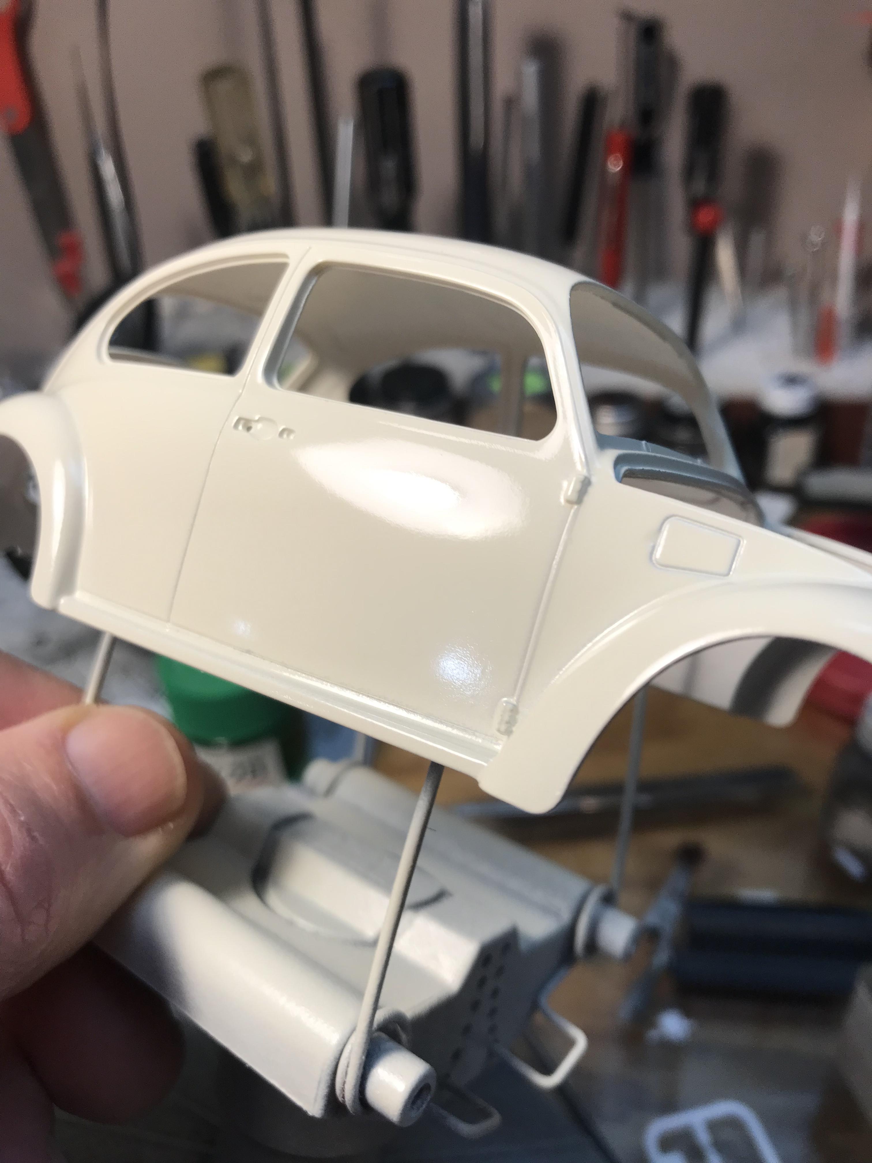

steveracer Posted January 5, 2022 Posted January 5, 2022 Those were the good old days! Adventure is king. Glad to see that you had an “adventure” in rallying. And thanks for the shout out. You may see some rally models on here soon. anyhoo. To stay on or off topic. I sprayed this with an old can of rust oleum ivory (but not 2x) with that crummy nozzle today. One dust and one wet coat. It’s shrinking. But I want to preserve the details with low build up.

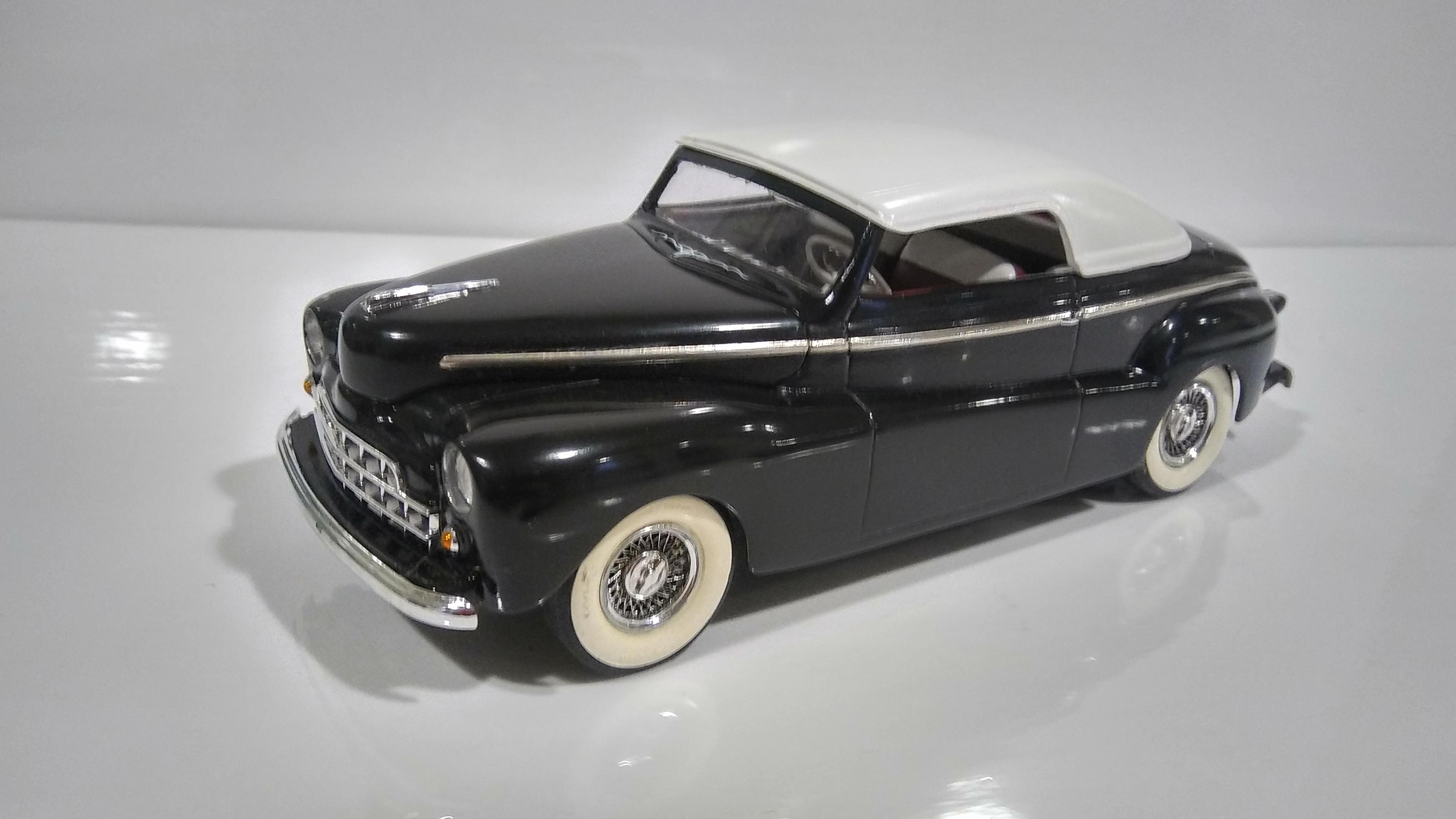

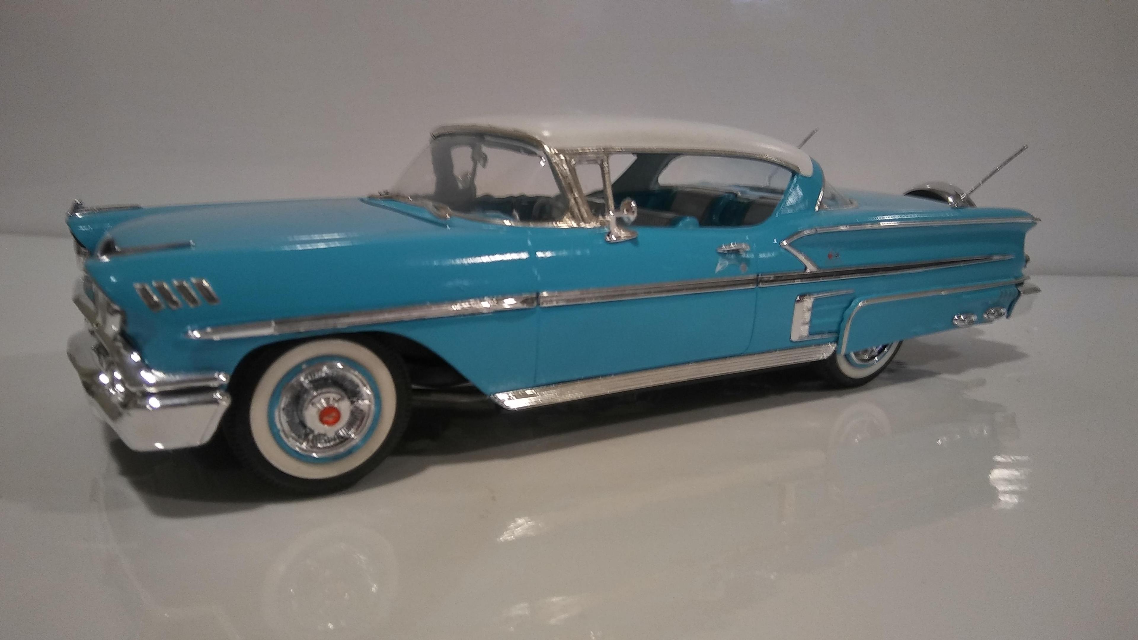

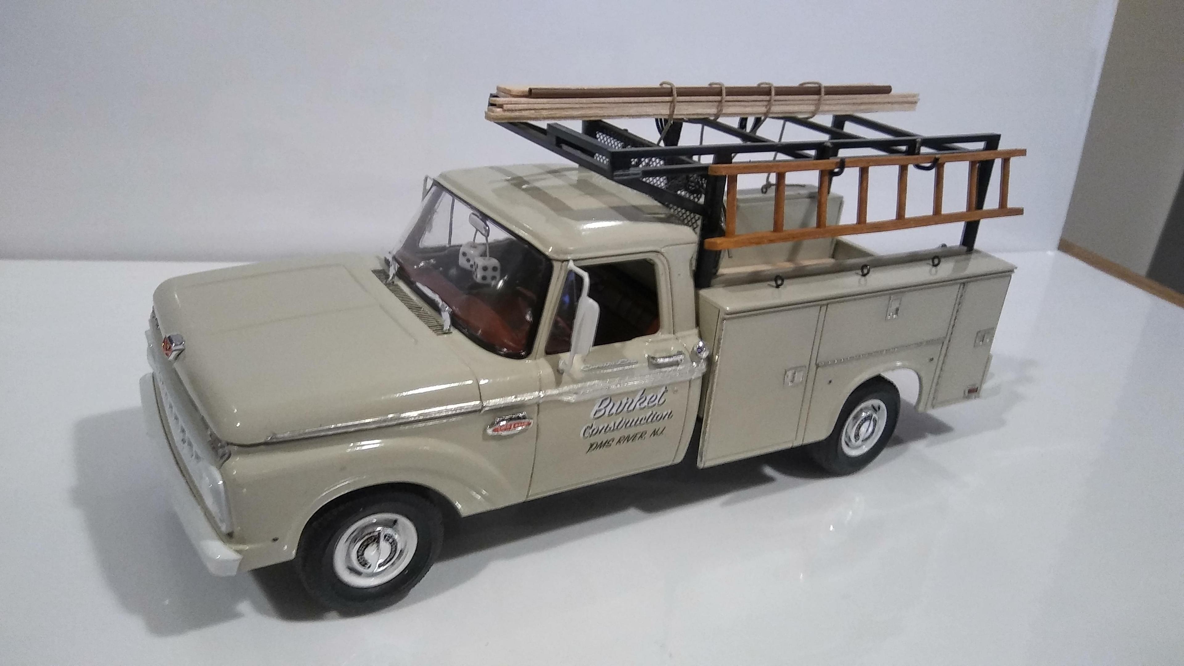

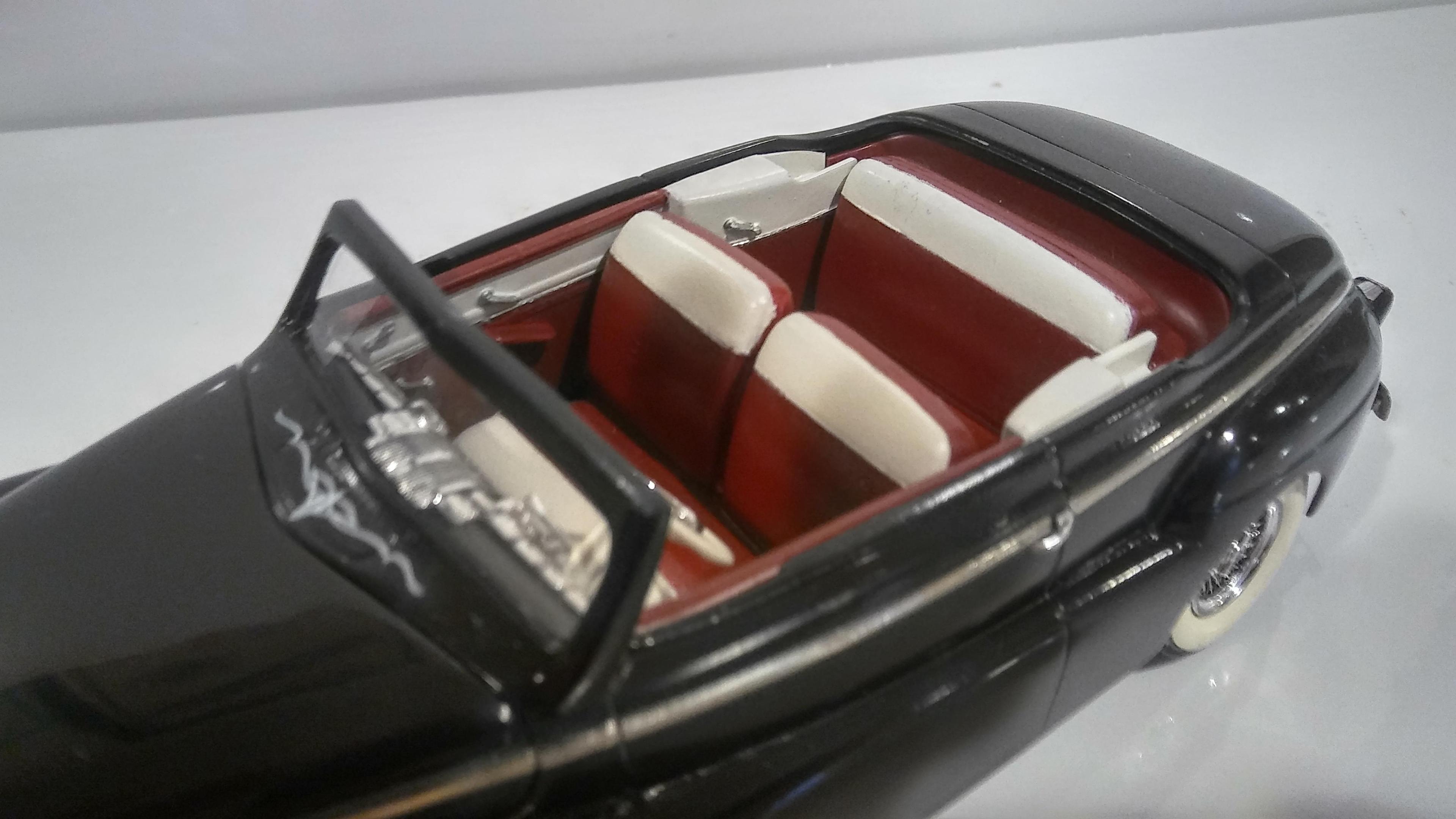

Chuckyg1 Posted January 6, 2022 Posted January 6, 2022 I've used 2x without issue. These 3 & 3 more were painted with 2x, gloss & primer. The '48 interior is 2x also 2

Zippi Posted January 7, 2022 Posted January 7, 2022 On 1/4/2022 at 7:01 PM, steveracer said: Those were the good old days! Adventure is king. Glad to see that you had an “adventure” in rallying. And thanks for the shout out. You may see some rally models on here soon. anyhoo. To stay on or off topic. I sprayed this with an old can of rust oleum ivory (but not 2x) with that crummy nozzle today. One dust and one wet coat. It’s shrinking. But I want to preserve the details with low build up. The paint on your VW looks really nice. You say you painted it with Rust-Oleum but the pic of the Ivory paint can is Krylon.
deuces wild Posted January 7, 2022 Posted January 7, 2022 16 hours ago, Chuckyg1 said: I've used 2x without issue. These 3 & 3 more were painted with 2x, gloss & primer. The '48 interior is 2x also Nice builds Chuck!... Do you have more pictures of the Ford utility pickup???? Please post them if ya got'em... Thanks bud!....? 1
Chuckyg1 Posted January 7, 2022 Posted January 7, 2022 3 hours ago, deuces wild said: Nice builds Chuck!... Do you have more pictures of the Ford utility pickup???? Please post them if ya got'em... Thanks bud!....? Thanks Guido. I posted the truck about a year ago under glass if you want to search for it. Beleove it was listed as 65 ford utility truck. If you can't find, I'll add some pics tomorrow afternoon. At work right now.
steveracer Posted January 7, 2022 Posted January 7, 2022 6 hours ago, Zippi said: The paint on your VW looks really nice. You say you painted it with Rust-Oleum but the pic of the Ivory paint can is Krylon. LOL! Old age is catching up with me! Apparently the can is Krylon, and I can't tell the difference. Good Catch Zippi.
deuces wild Posted January 7, 2022 Posted January 7, 2022 5 hours ago, Chuckyg1 said: Thanks Guido. I posted the truck about a year ago under glass if you want to search for it. Beleove it was listed as 65 ford utility truck. If you can't find, I'll add some pics tomorrow afternoon. At work right now. Thank you sir!.....?
BlackSheep214 Posted January 7, 2022 Posted January 7, 2022 On 1/6/2022 at 2:52 PM, Chuckyg1 said: I've used 2x without issue. These 3 & 3 more were painted with 2x, gloss & primer. The '48 interior is 2x also Those are simply gorgeous!
