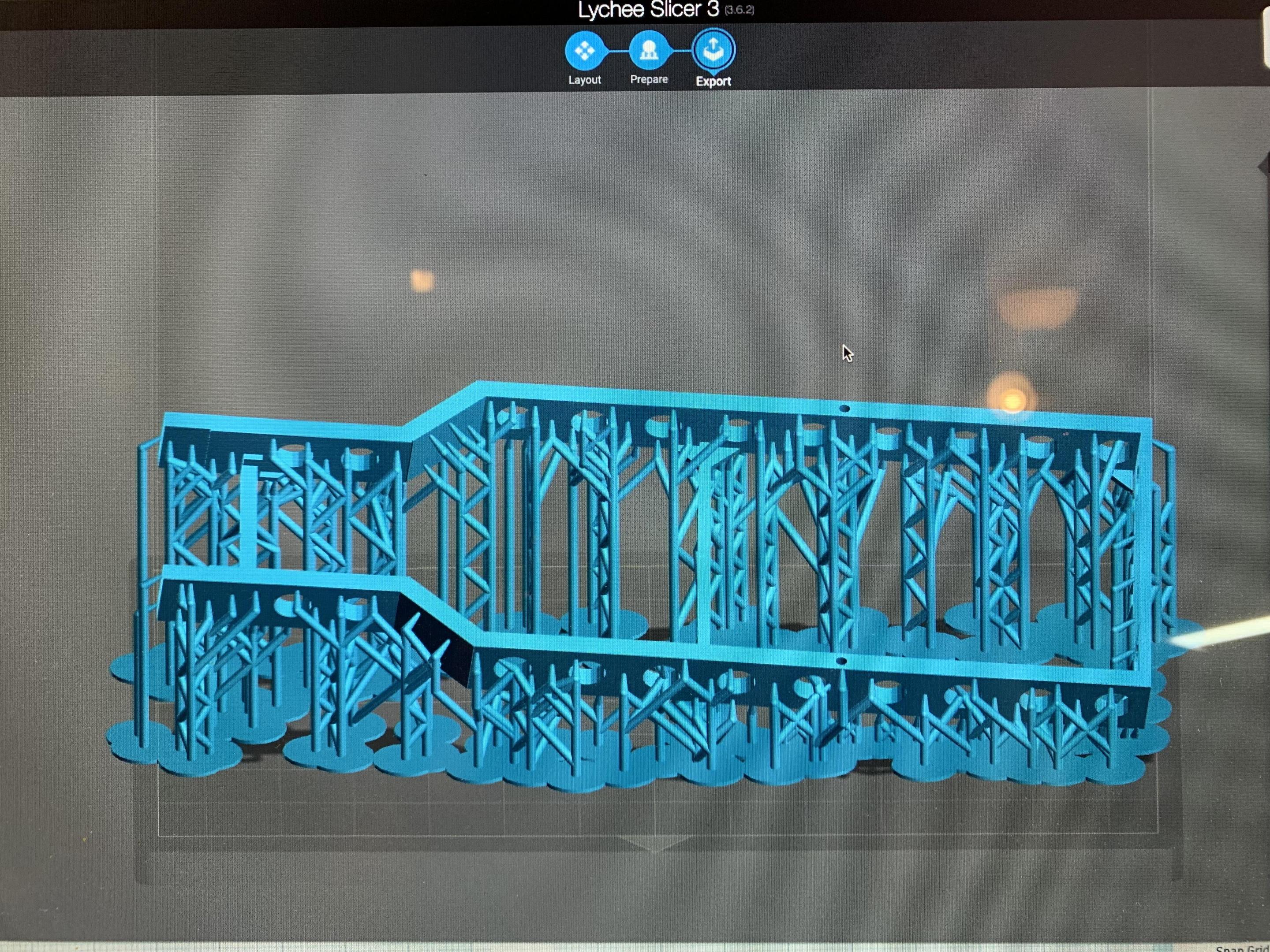

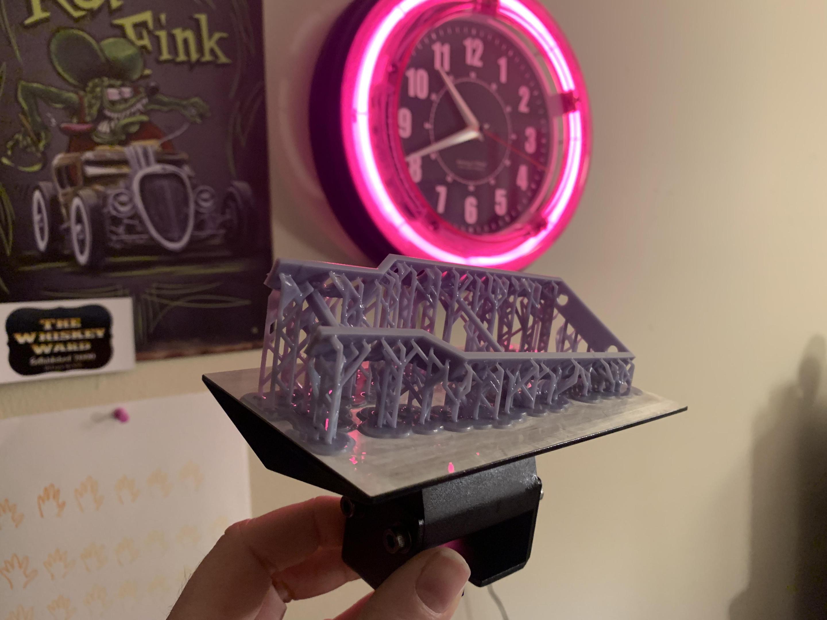

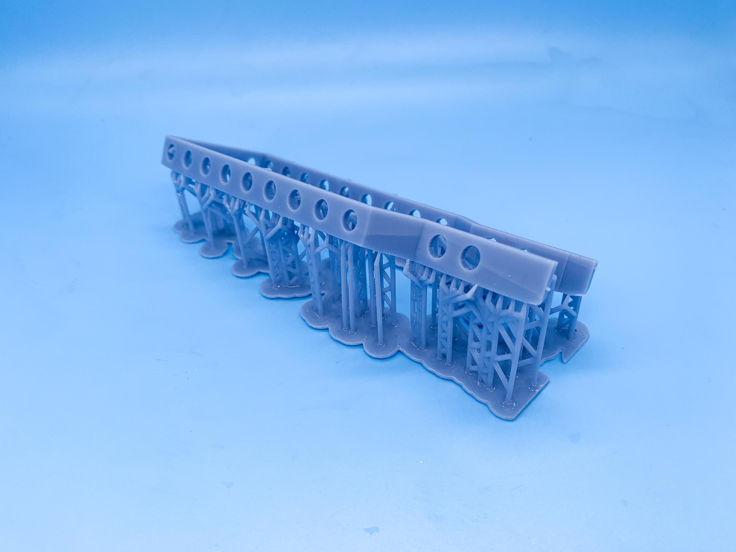

All the supports that the software adds look crazy - and I’m not sure if it’s even necessary to use quite so many, but they stop the resin from sagging or the part not printing correctly so I let it add all that it thought it needed:

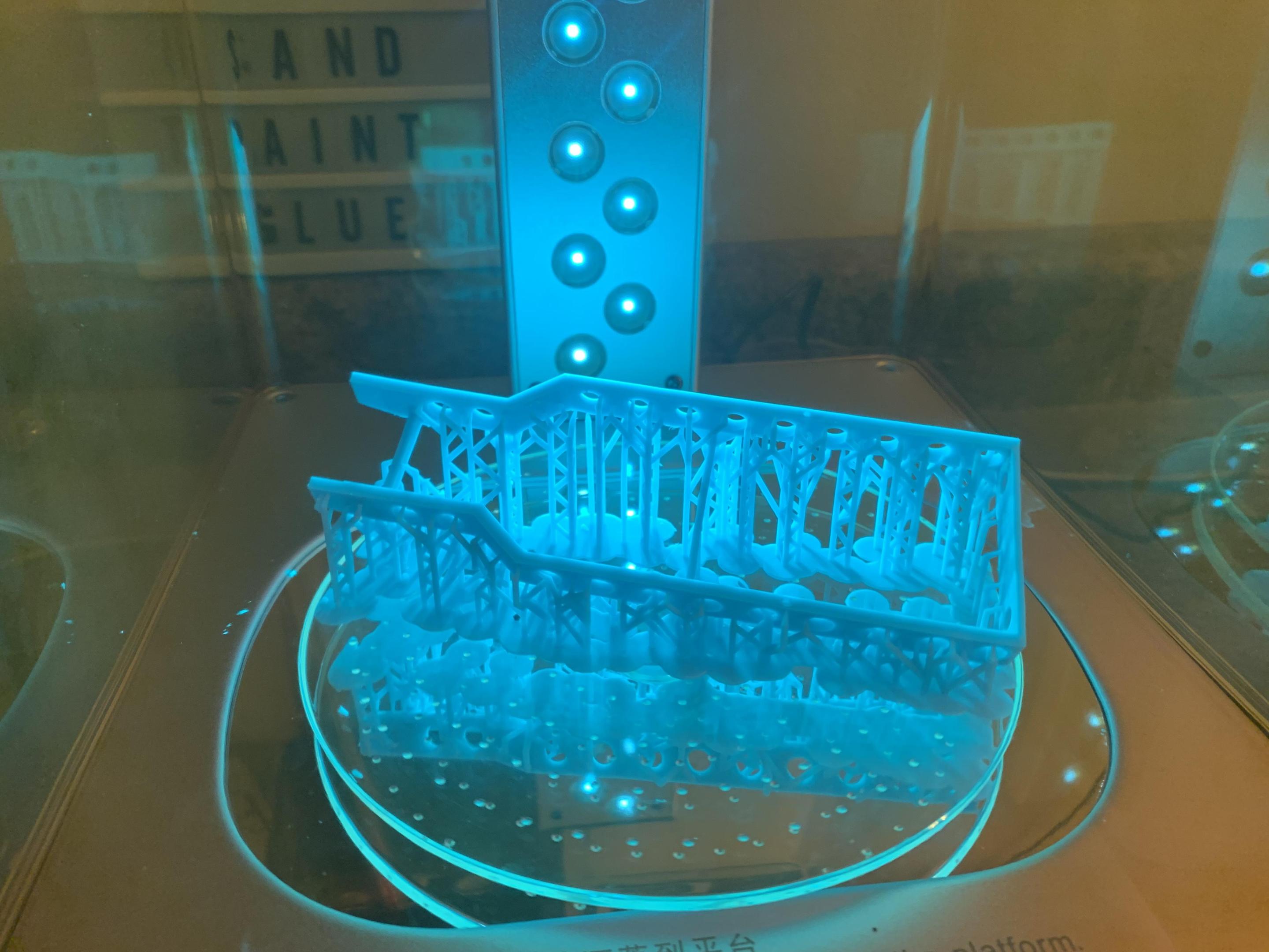

Four hours printing later:
Cleaned the parts in 99% alcohol and then cured with UV light:
Now I gotta snip all this extra stuff off:
Then, after some cleanup…a frame!

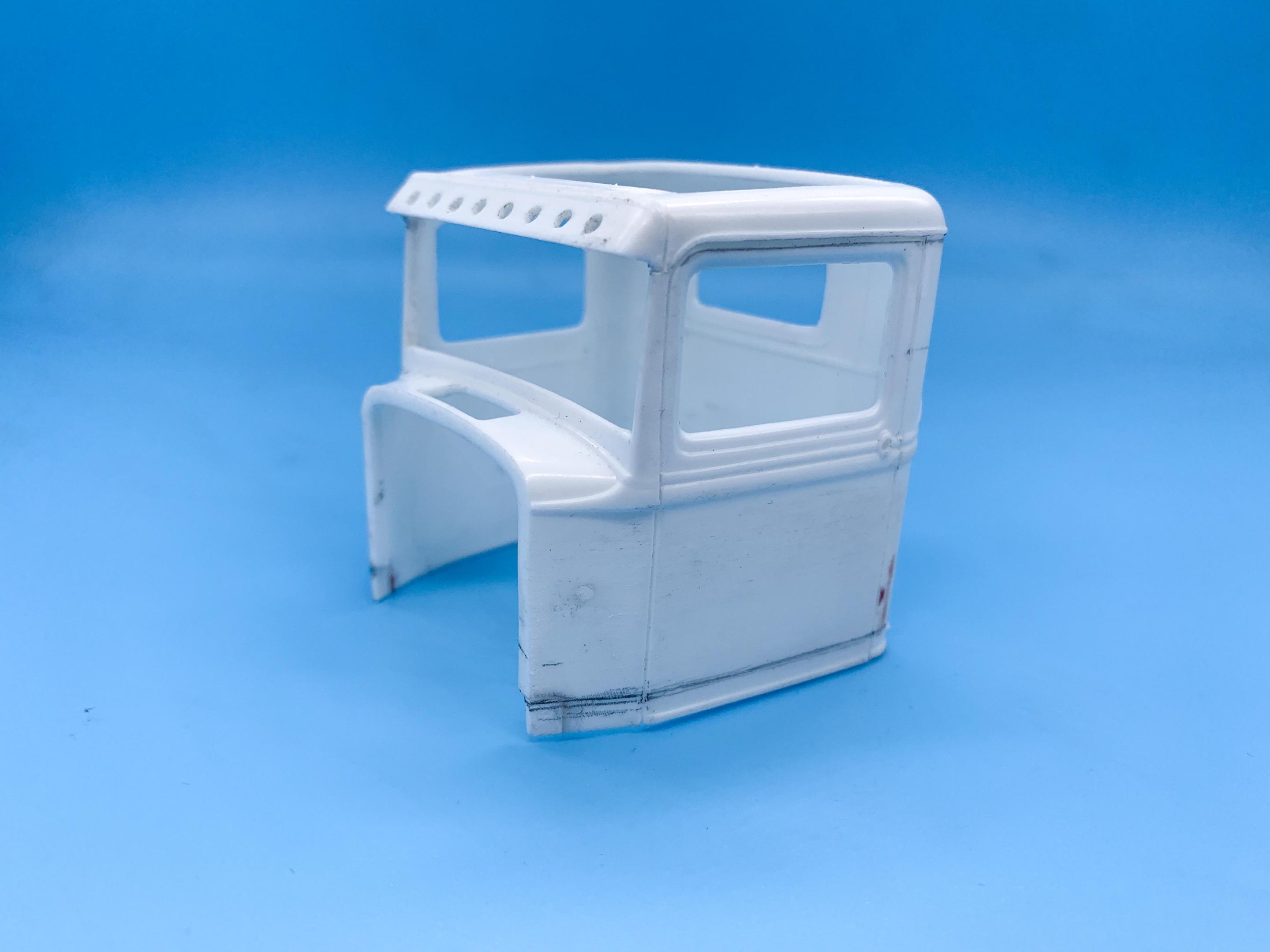

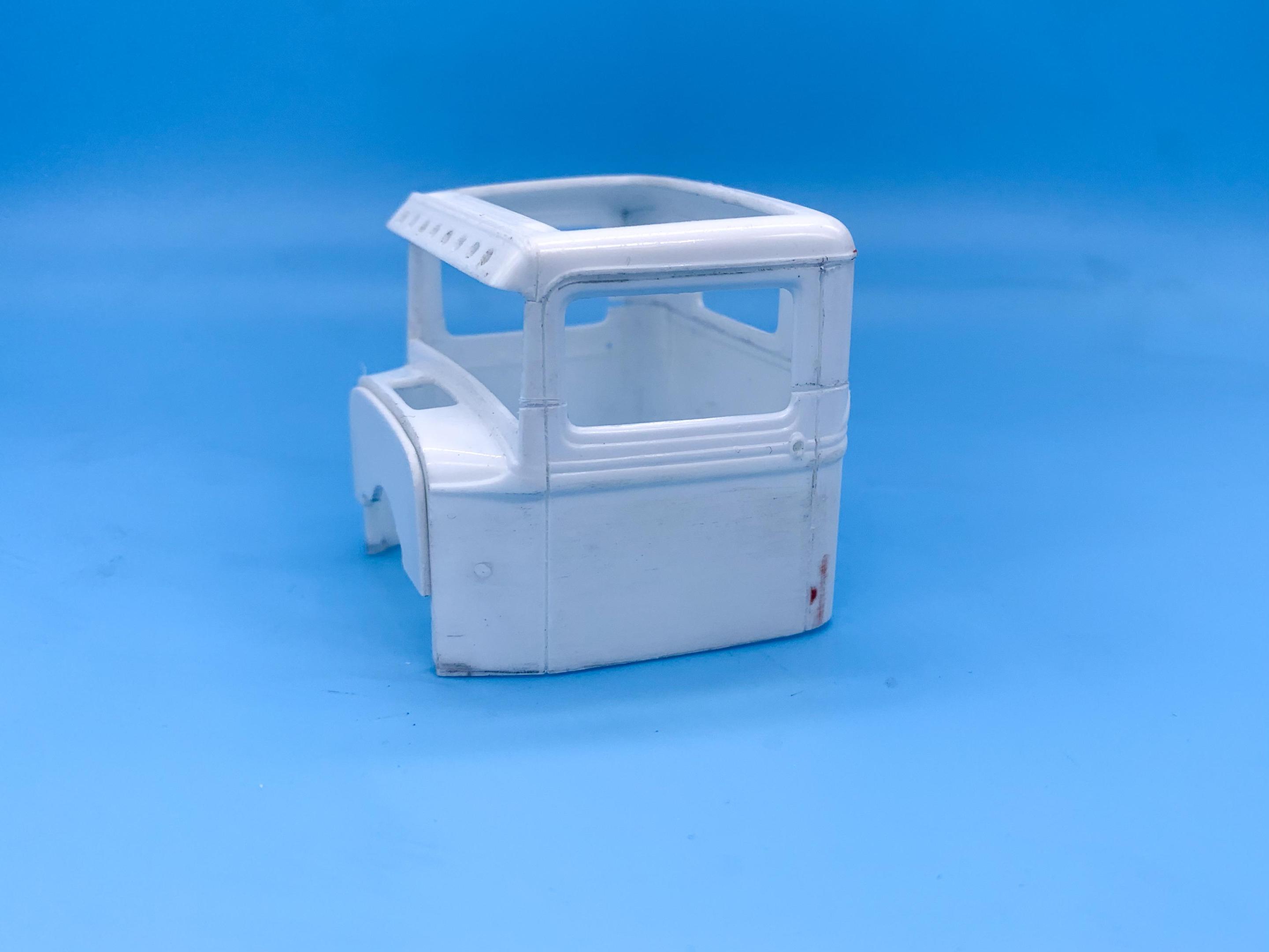

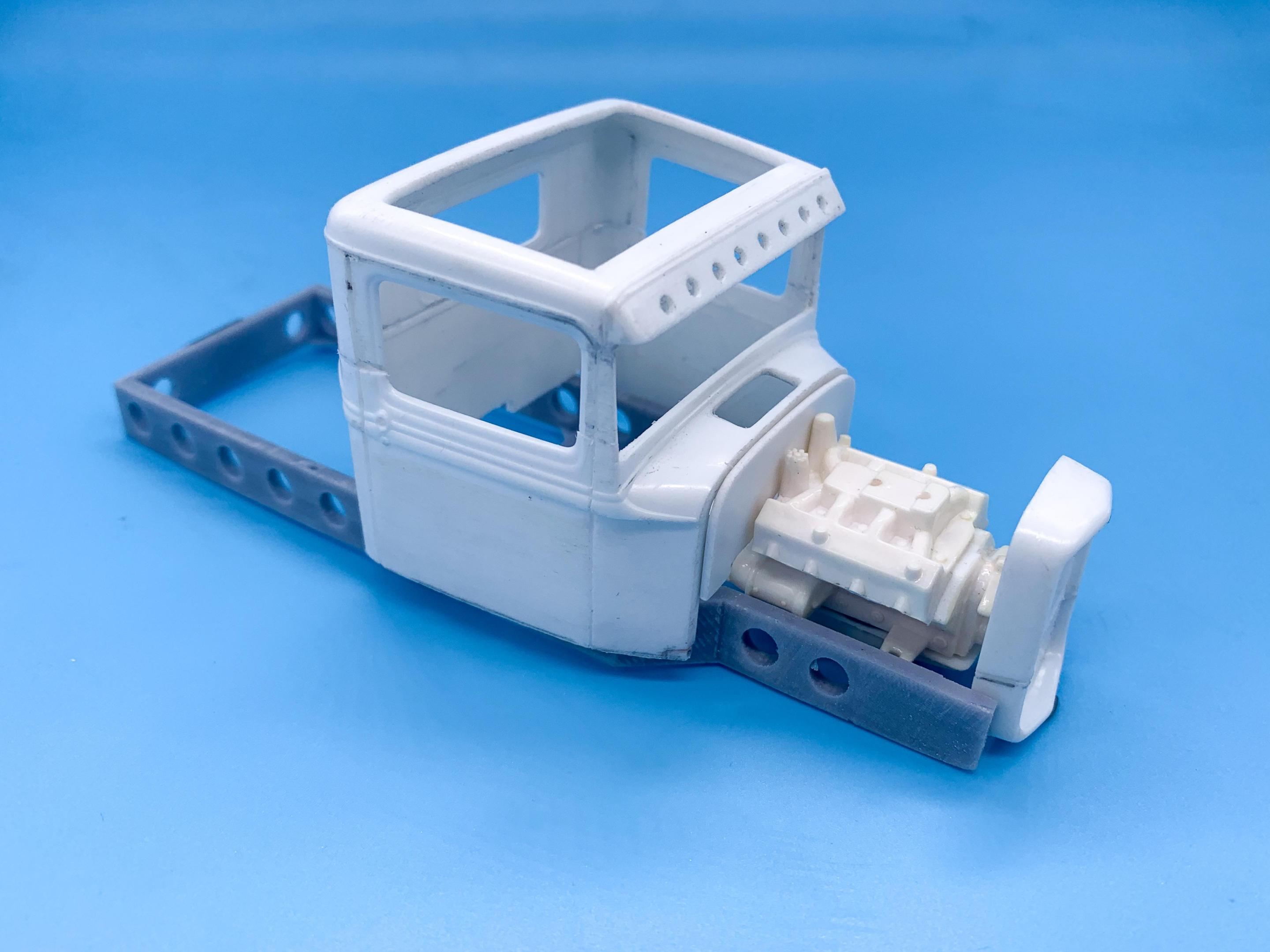

As you can see from that body, whilst the printer was running I started hacking that apart and getting the proportions a little closer to what I’d imagined - took a couple of scale inches out of the bottom of the doors and a little out of the roof too.
Before:
And after!

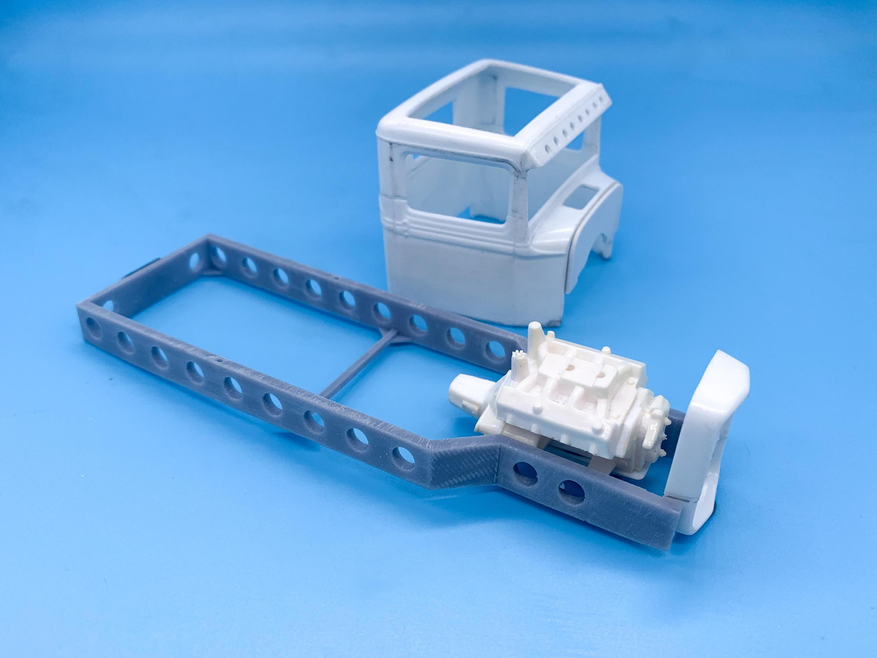

The body is just tacked together right now so I can check all the measurements and make the joints nice before gluing it back together, but it looks like I imagined in my head now…
Going with a 390 FE motor as a hat-tip to the Mysterion (but only ONE of them in this case):

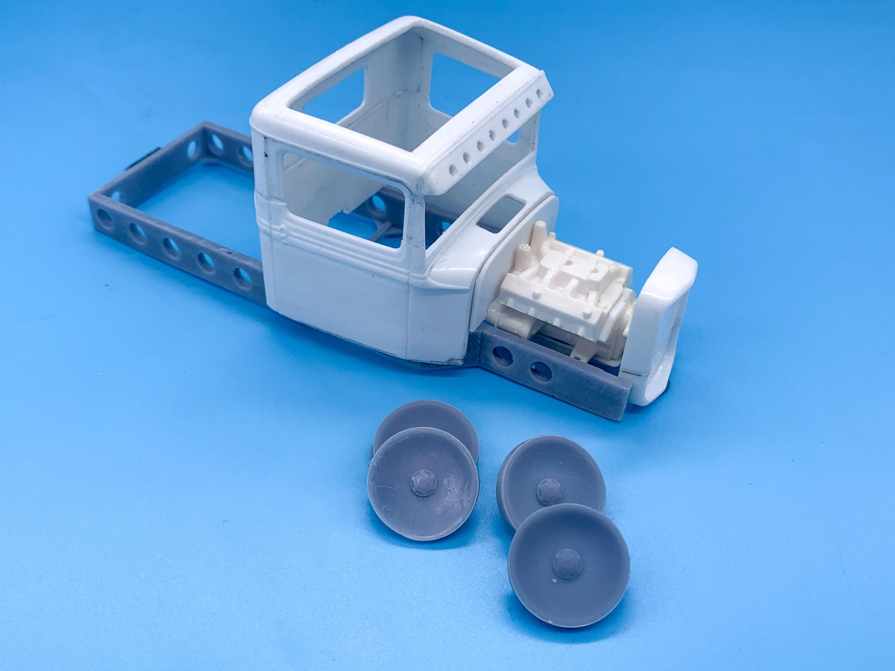

And a shot with the body on the frame:
I’m excited already!

17 hours ago, CabDriver said:
?Four hours printing later:
Great job on the frame. Everything is looking good, but try removing the supports before curing. They are much easier to remove when they haven't been cured.
  • Like 1
  • Thanks 1
You’re absolutely right, Mr Britches!  I knew that was the recommended way to do that, and have been snipping before curing generally, but I was nervous about tweaking the frame or knocking it out of alignment somehow or something…in this case I cleaned, cured, snipped and re-cured - seemed to work ok (although I know that curing too long makes parts brittle too so I’m going to be cautious with the frame.

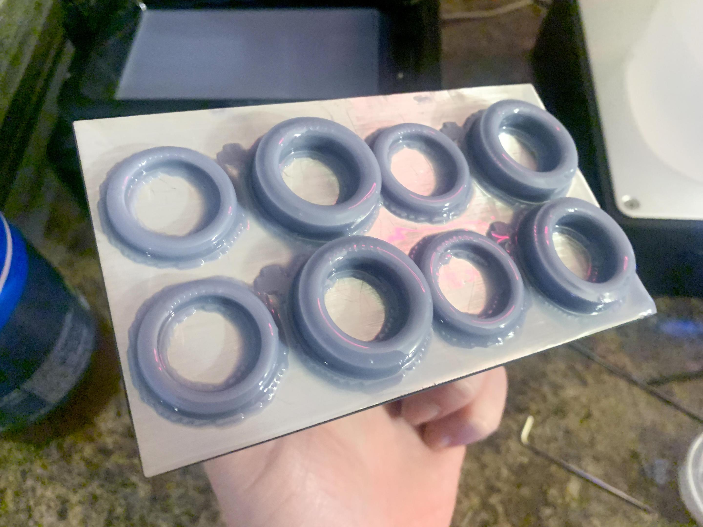

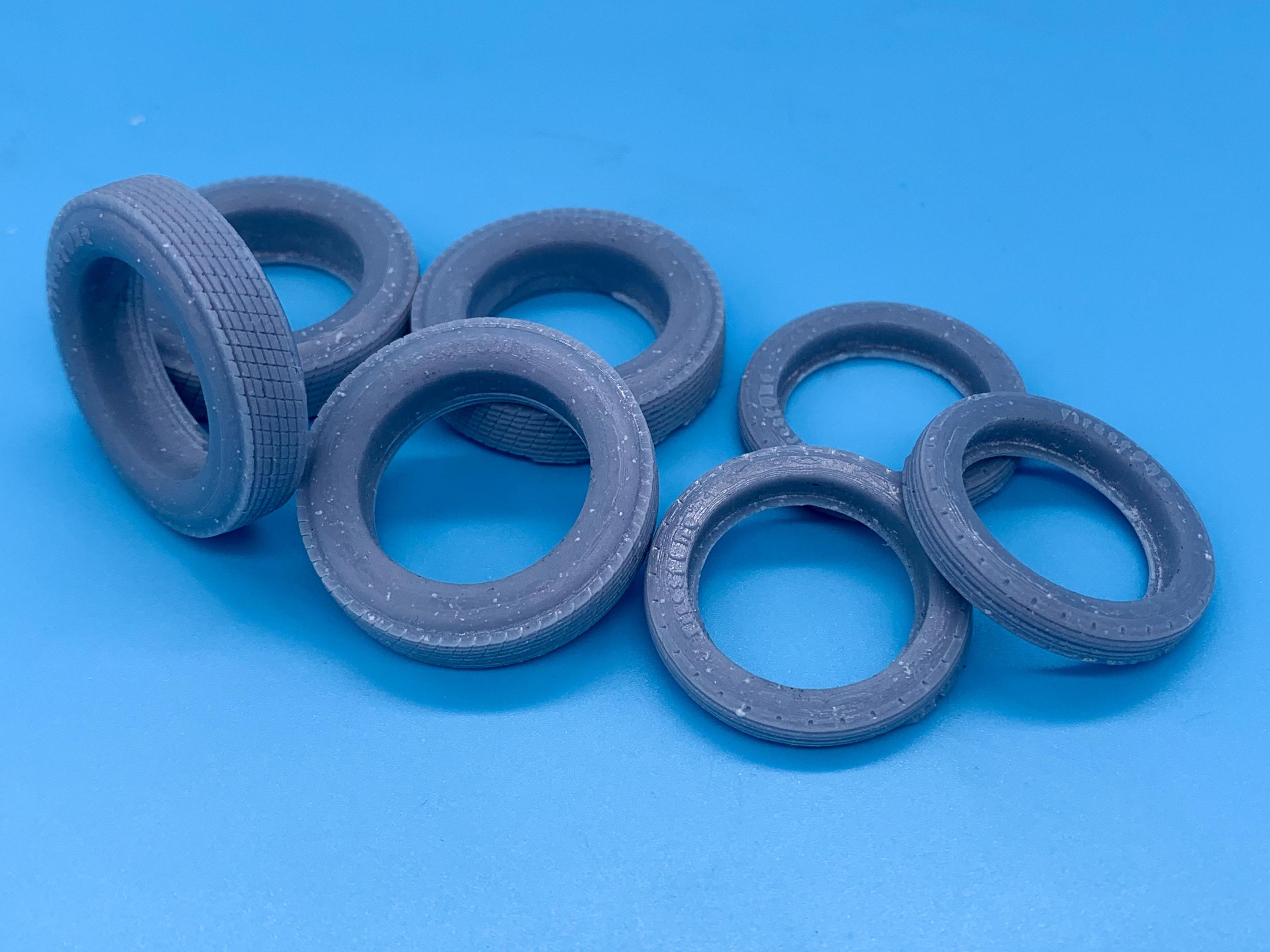

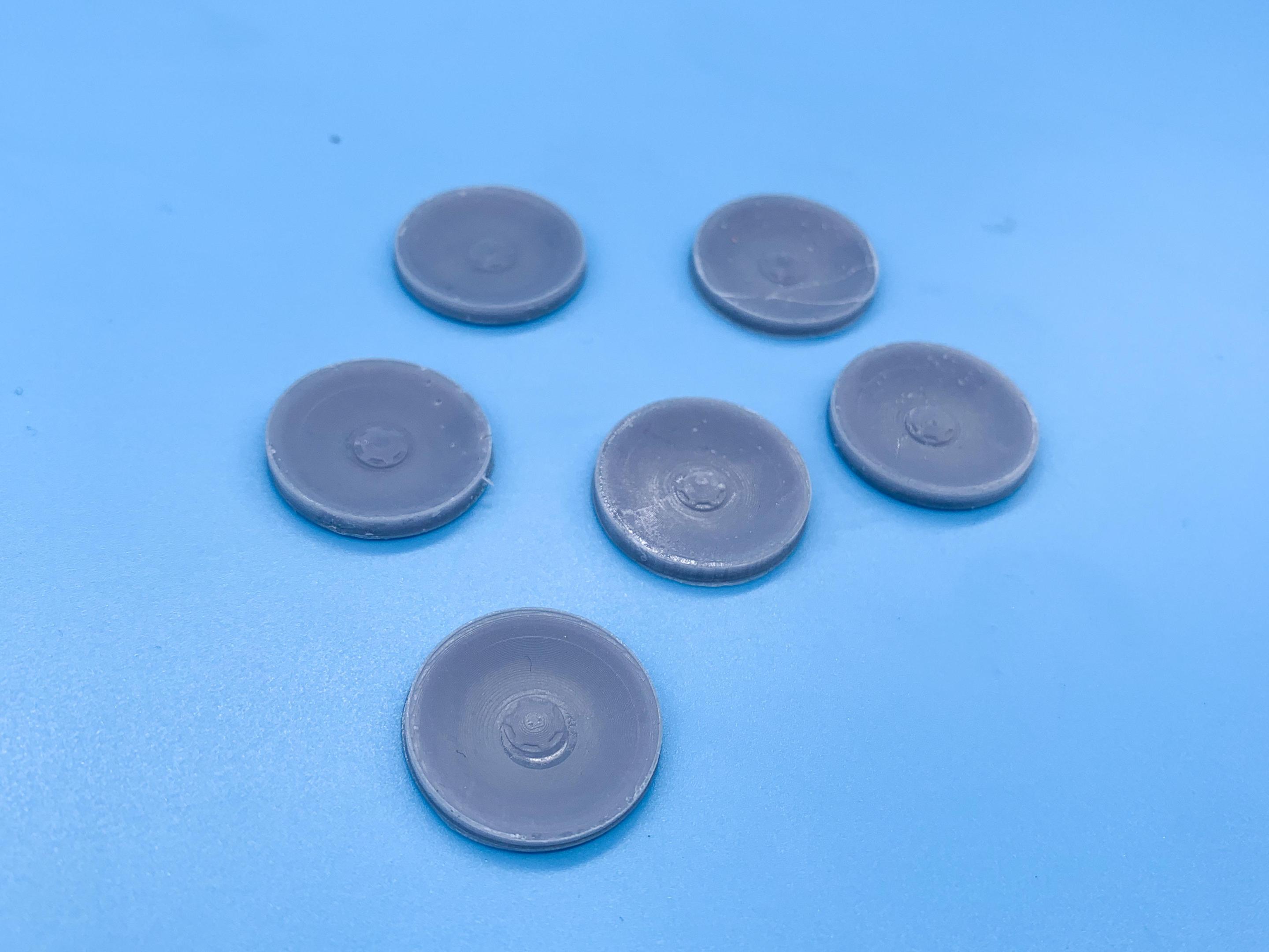

Speaking of the frame, one of the tweaks I made before printing the final version was to take some depth out of the bottom edge - I noticed some rippling in the print so I removed just enough from the design so I could build it back up with strips of styrene sheet and have something I was more comfortable working with to get it all straight and level before paint.  I also spent the best part of today messing with printing wheels and tires…got the wheels done after a couple of attempts:
They need a little cleanup still but between all my various tries I’ve definitely got 4 usable ones now…tires I’m still messing with but getting better, gradually…here’s another batch fresh out of the oven:
I used a couple of the failed prints to do a quick mock-up…I have some larger resin tires that I might like better but these are nicely detailed anyway:

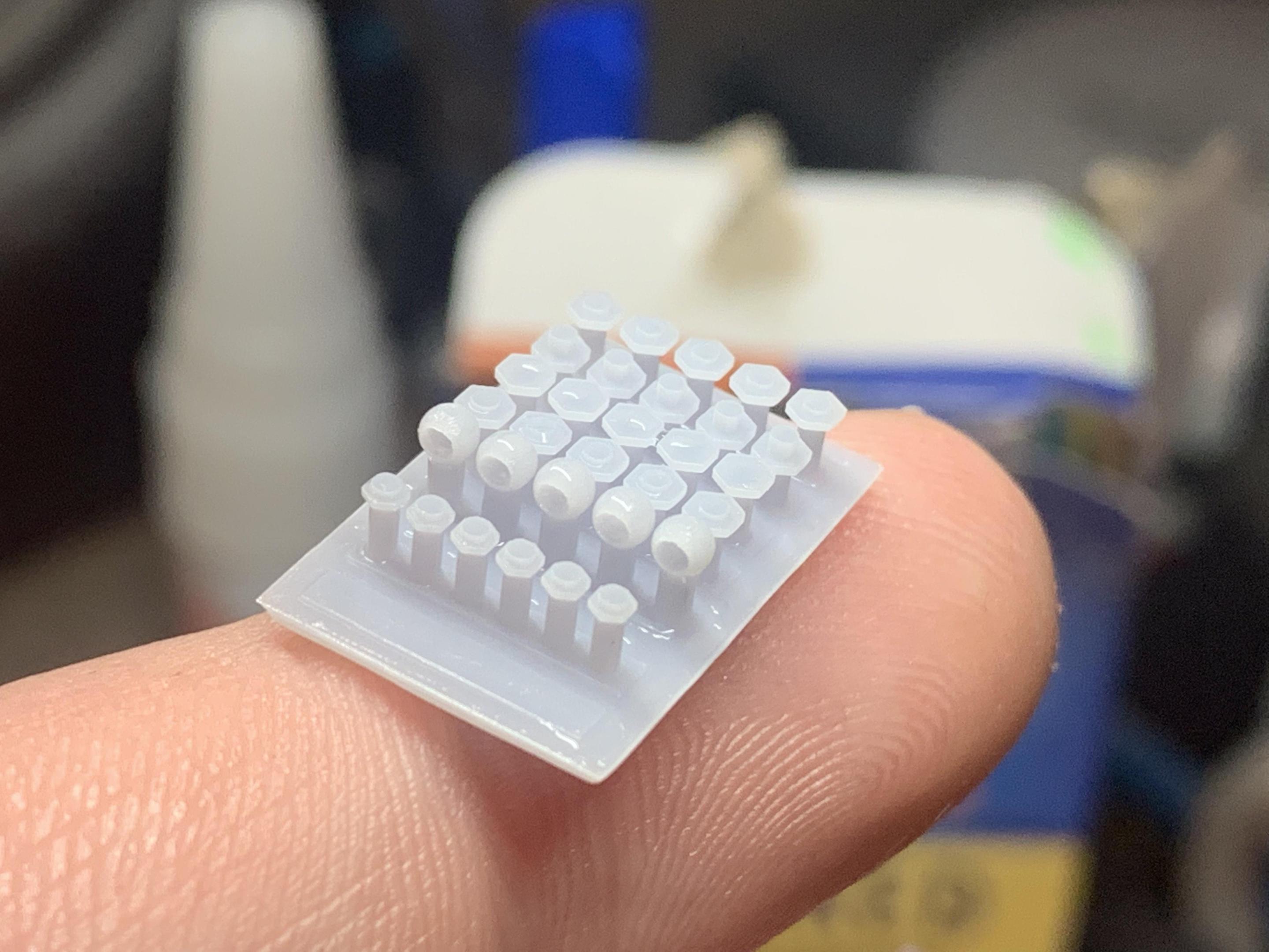

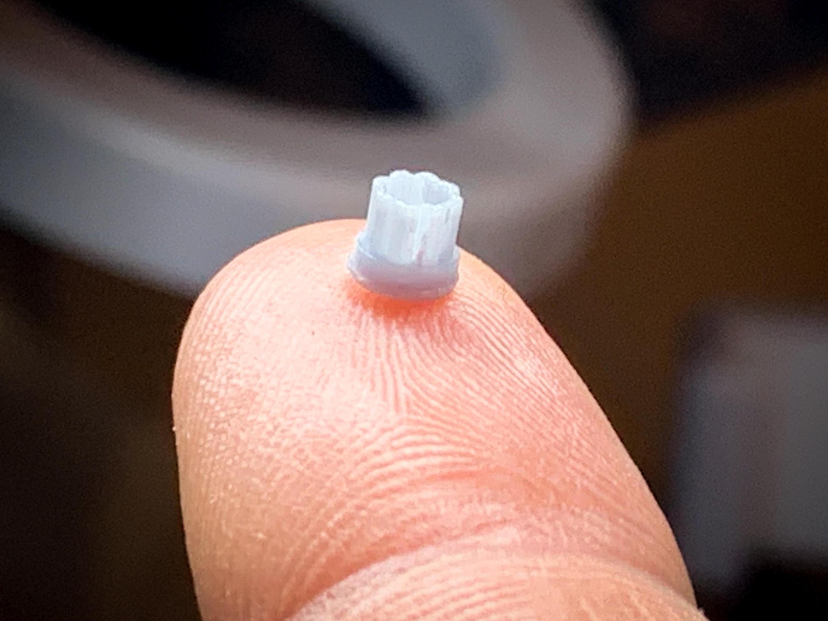

And after a whole day of trying to get some tires that I was happy with, I just wanted to print some easy stuff so I did some tiny bolts I’d designed that I wanted to try for detailing purposes further down the line…

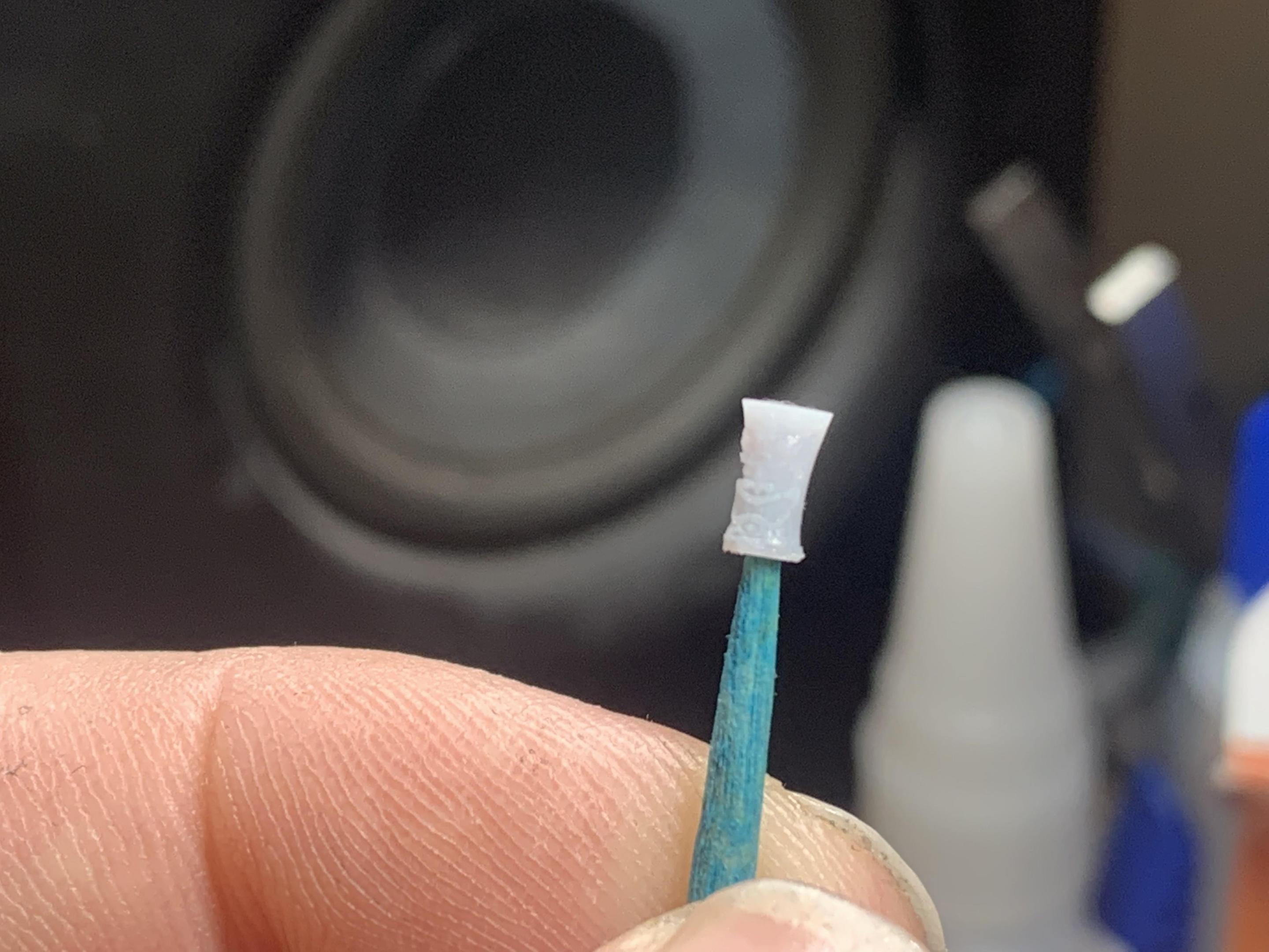

Some bigger bolts and track rod ends:
A tiki shifter which is really hard to see but looks like it came out nice in real life…

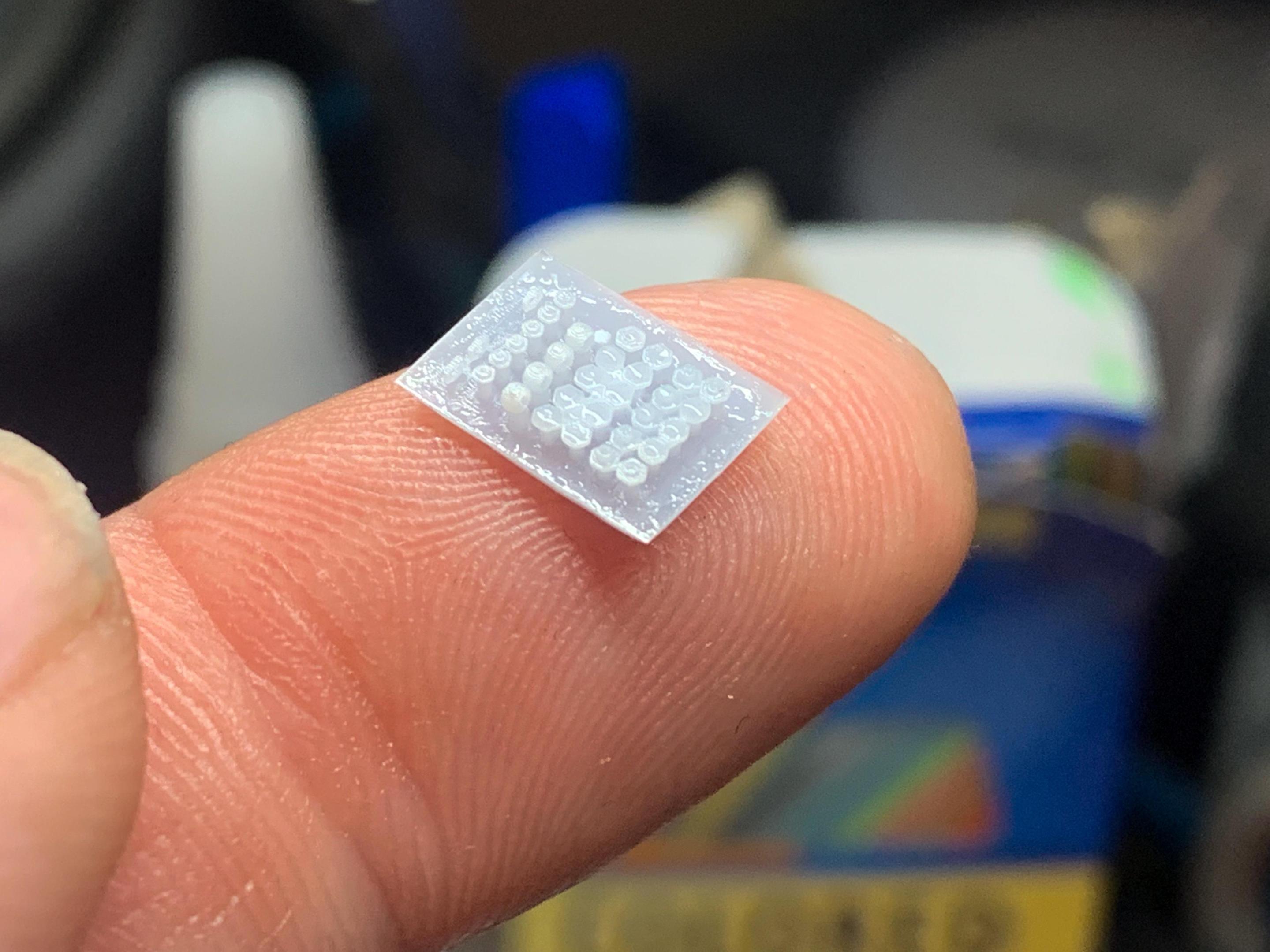

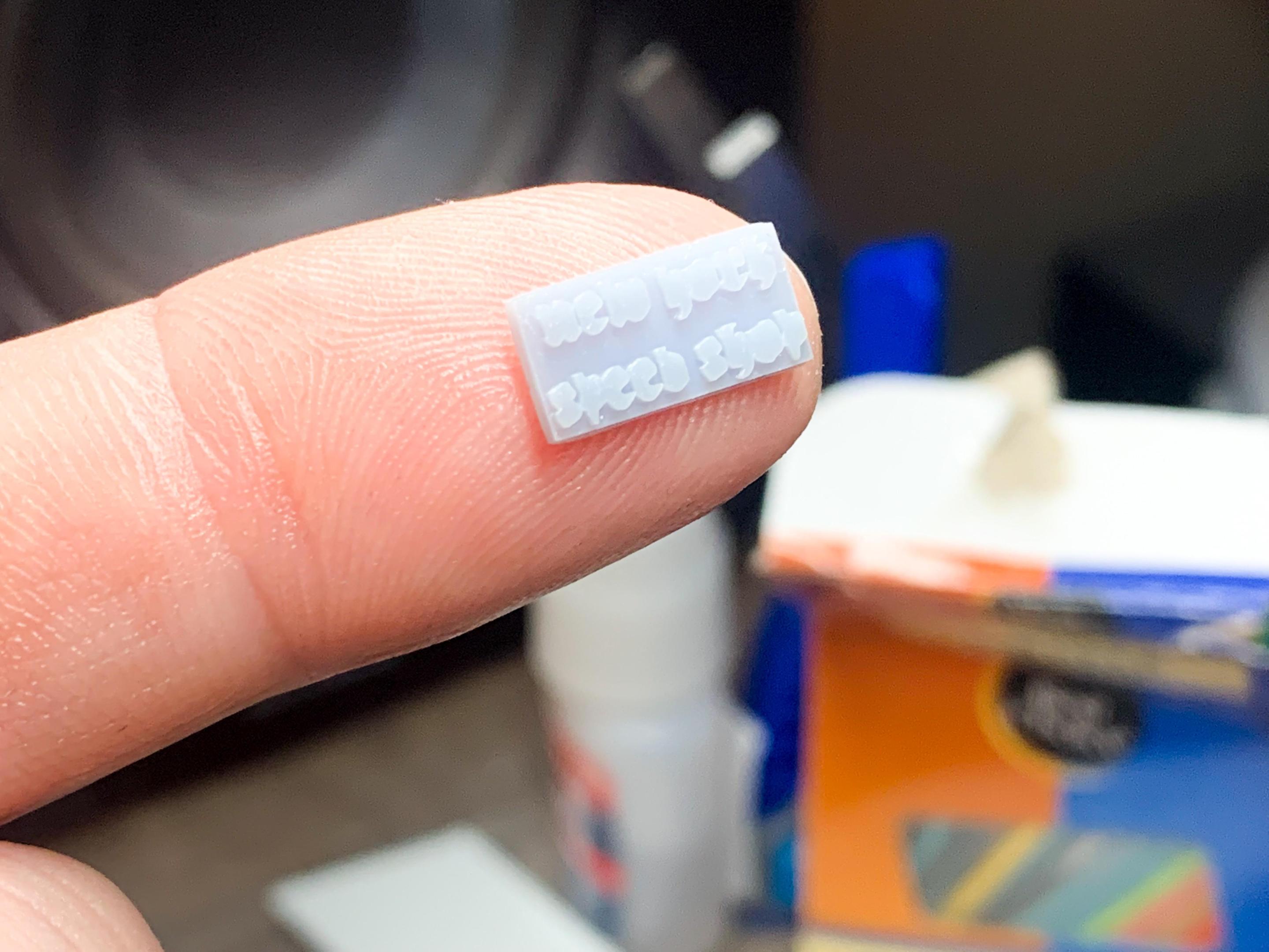

And another experiment with making 3D club plaques (which I’m going to mess with some more so I can figure out making actual embossed custom license plates rather than just using flat decals):

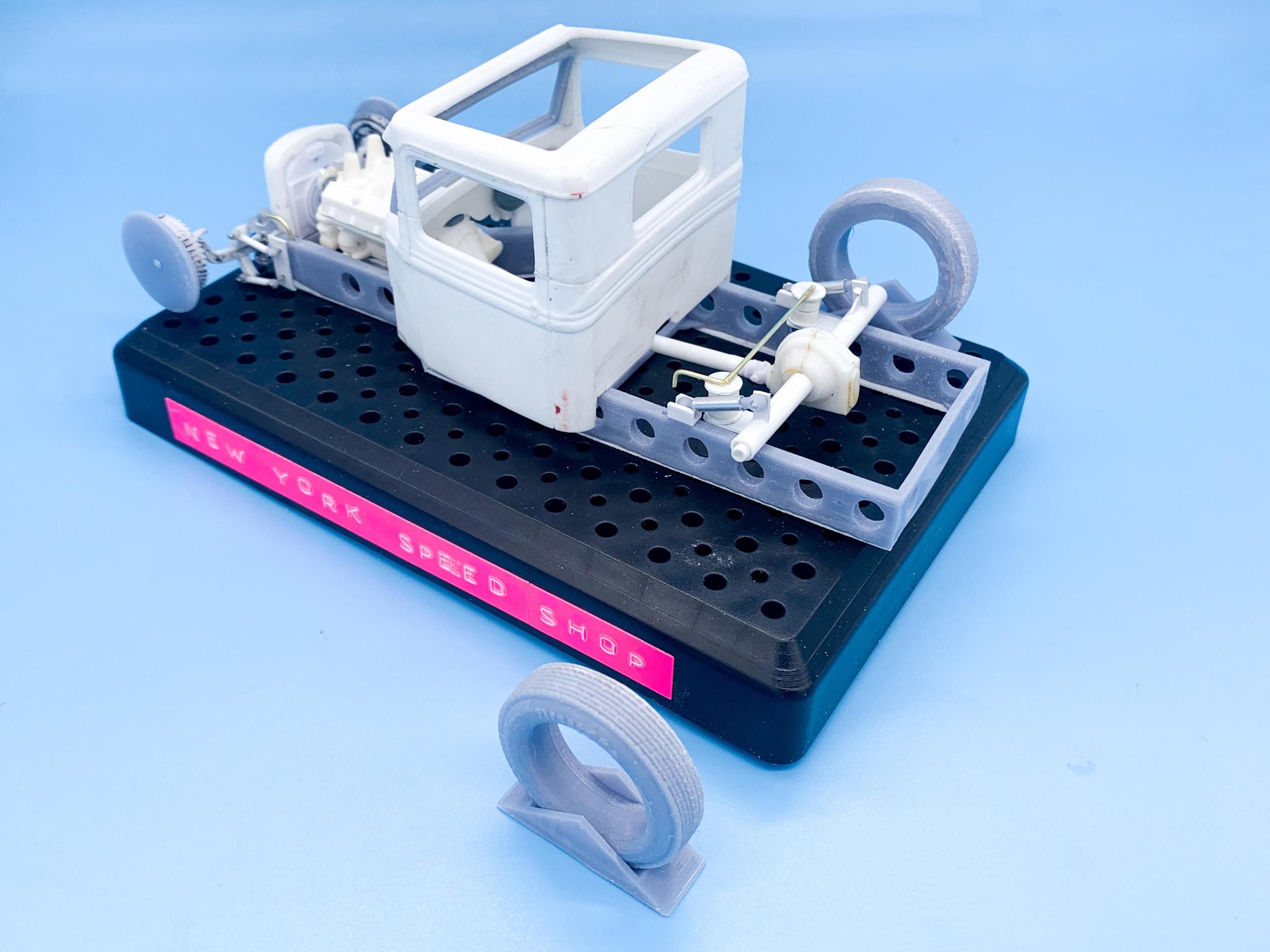

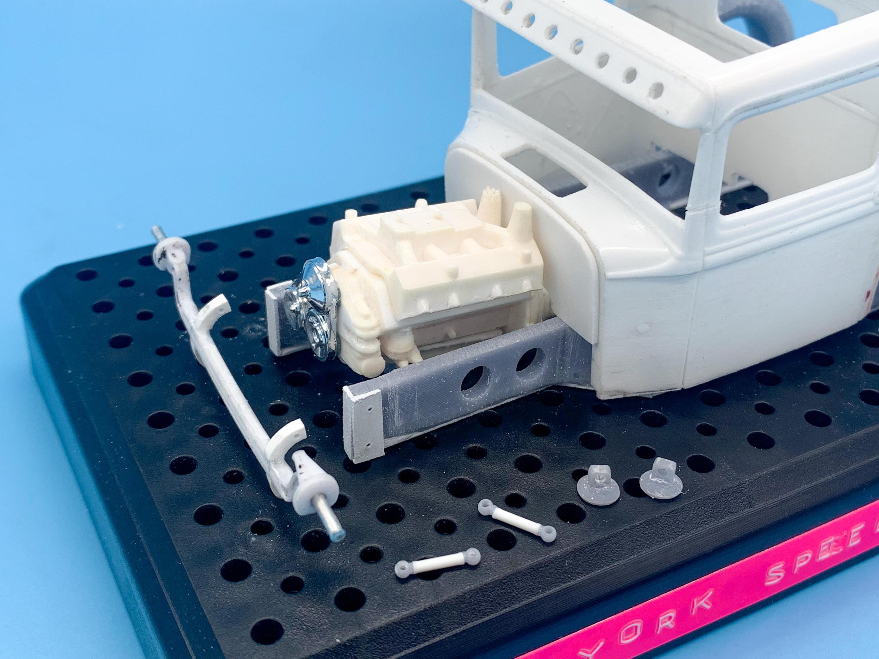

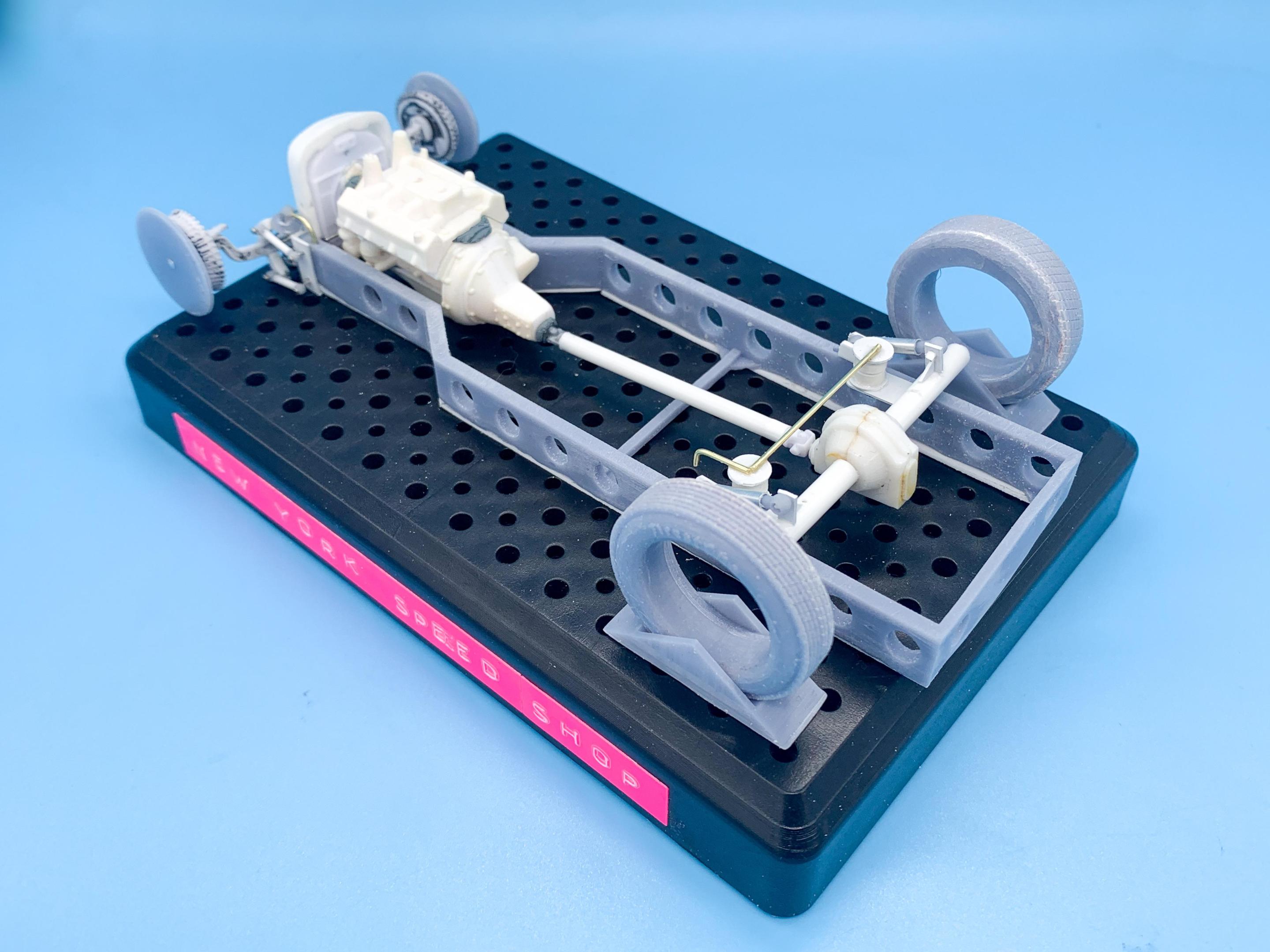

A little more progress today - got a good set of those nice tires printed and cleaned up…printed some extras whilst I (mostly) had them printing how I wanted:

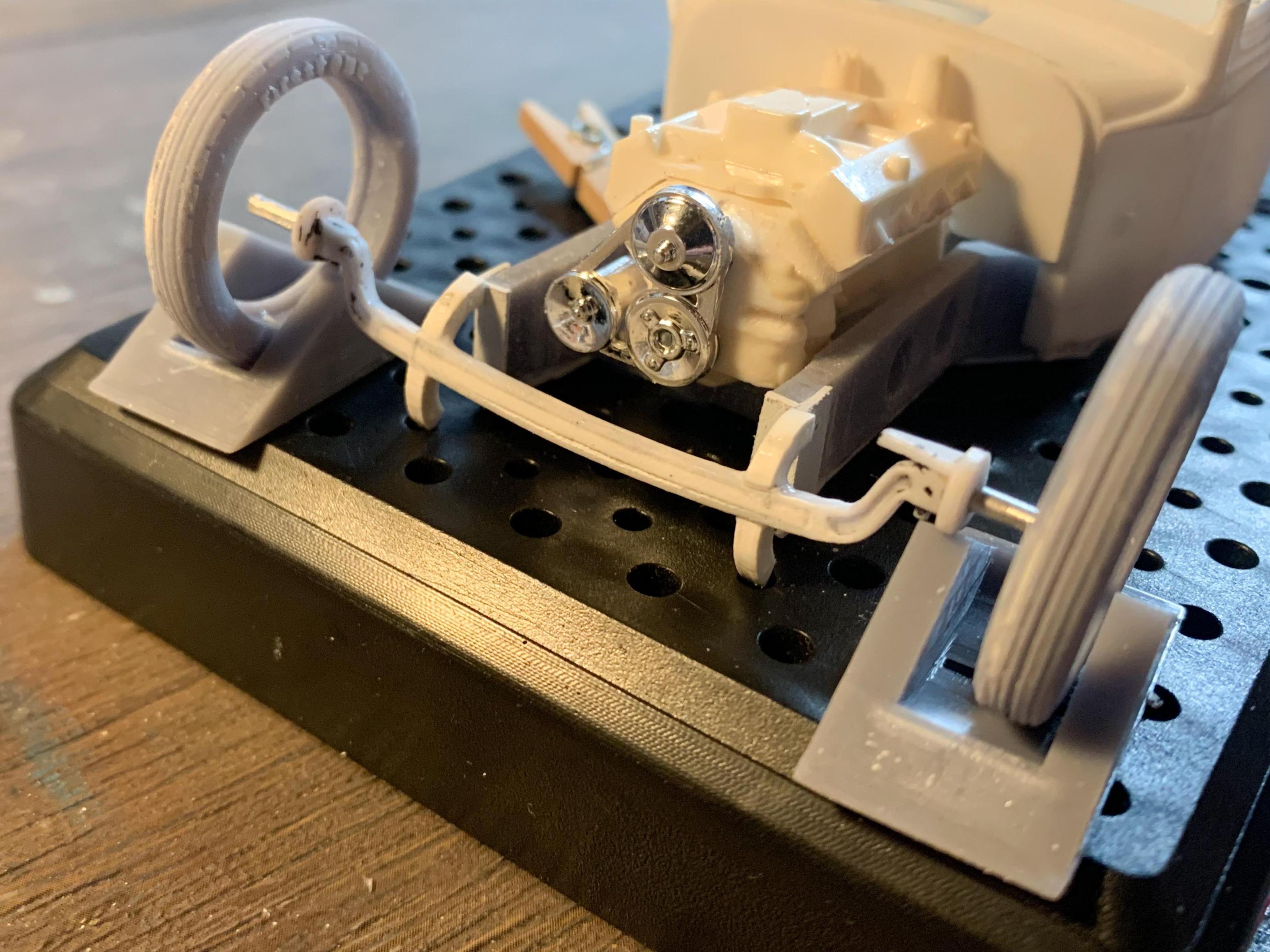

Started work on the front end - modified a Revell 29 kit axle for the suspension setup I have planned:
Made some linkages and some pieces to scratchbuild some shocks this coming week:
And, after battling wheels rolling off the bench all weekend, I finally got smart and make some chocks to hold them in place for mock-ups (not totally relevant to this project but I’m pleased with the idea ?)
Not a bunch of progress for an entire afternoon in the shop, but small steps…more soon!

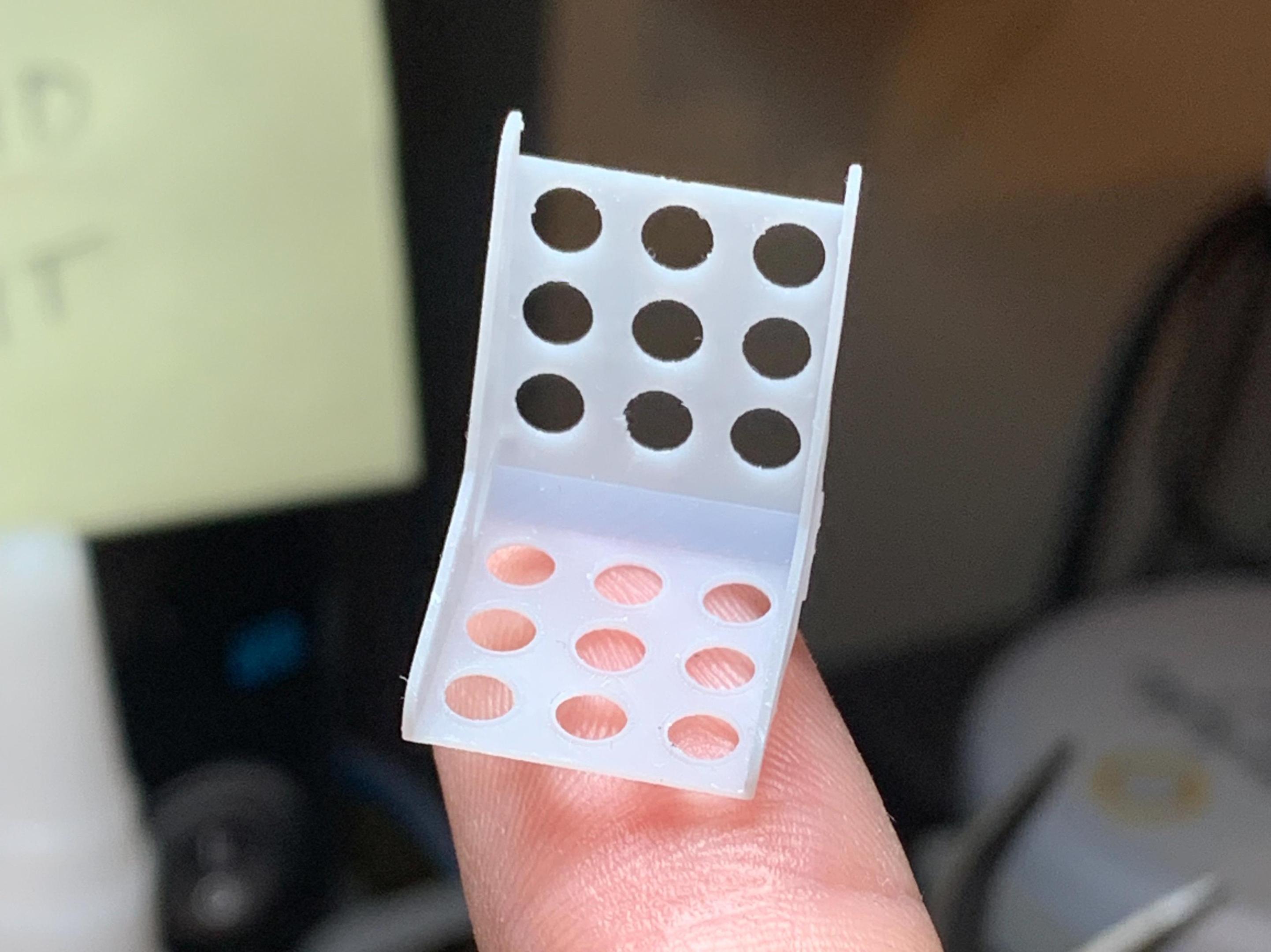

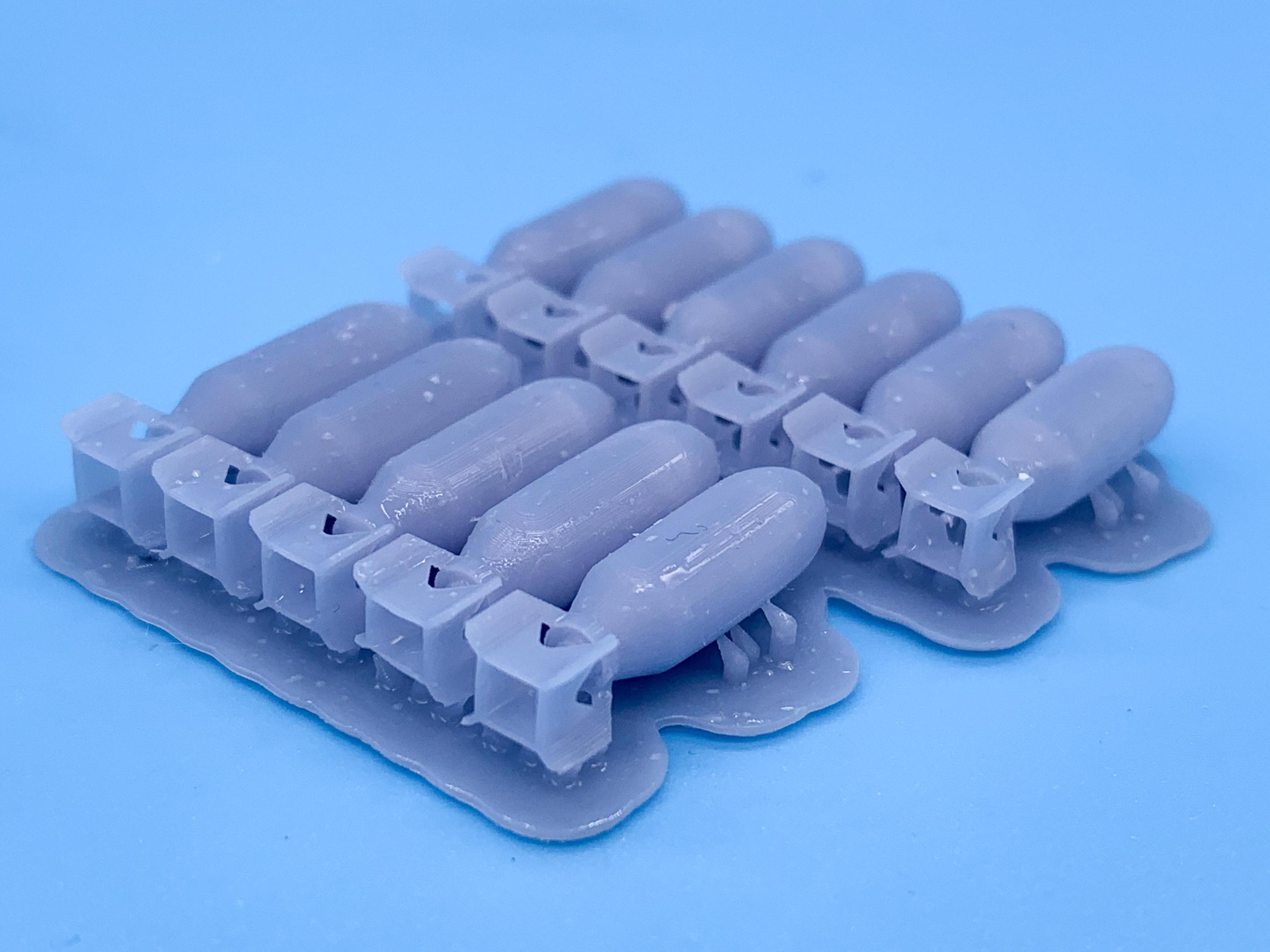

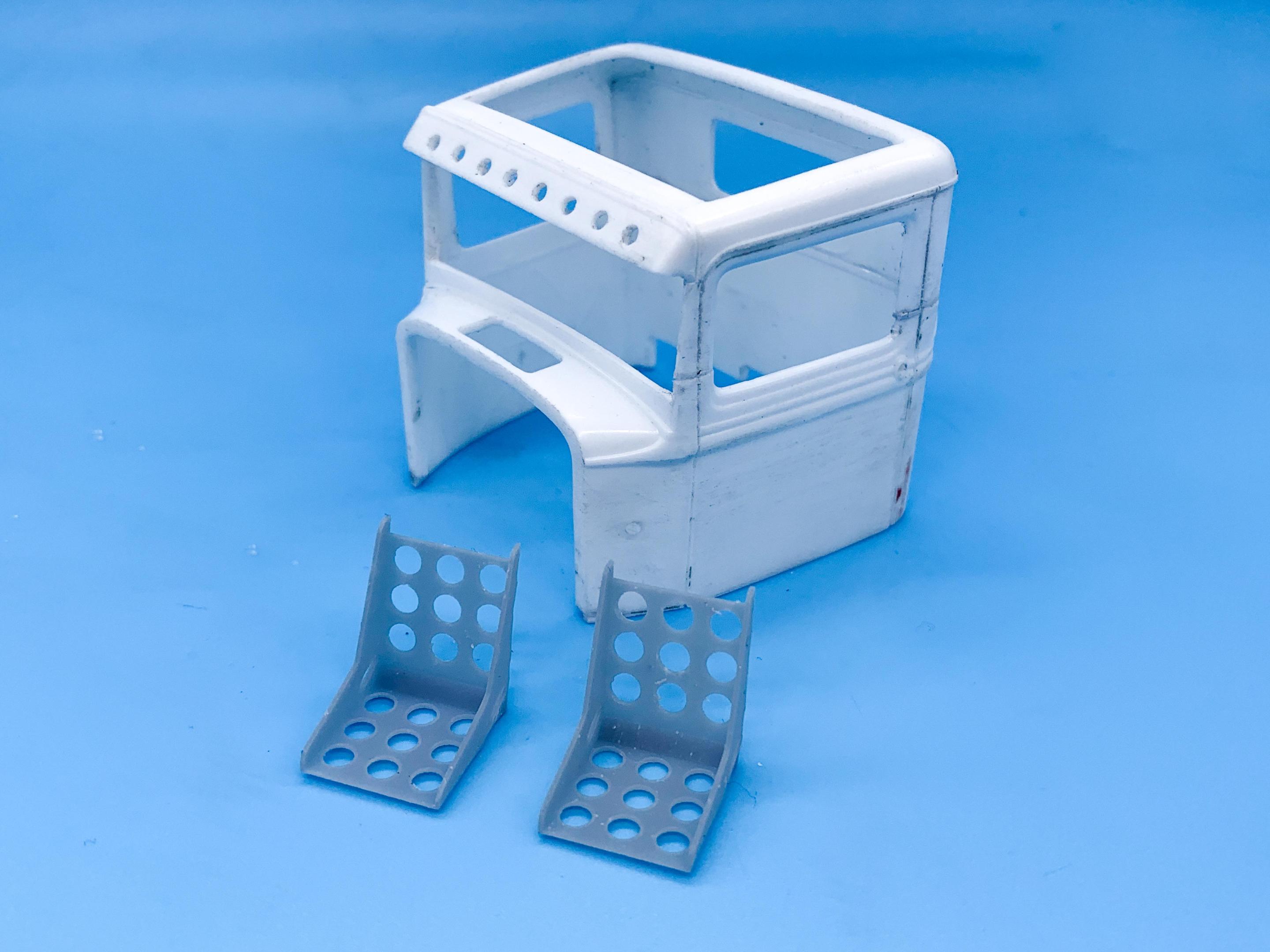

Tiny bit of midweek-progress…I wanted to go with bomber seats for this one, so designed some earlier in the week (with matching cushion, because these things look uncomfortable ?):
And tried printing a set tonight:
Came out ok - I was mostly concerned that the printer would struggle printing something with such a thin wall to it but it did great!  Ready for cleanup and paint!
Didn’t try a cushion yet - I added some leather texture to those which I’m almost certain won’t show up when they’re painted, but I can probably re-introduce a little roughness with the airbrush…
Just a tiny update, but those two seats took me two evenings to get done…more soon!

@Spex84 - tires are hard!  It’s finding a spot for the supports without ruining the tread.  I’m still experimenting tho…

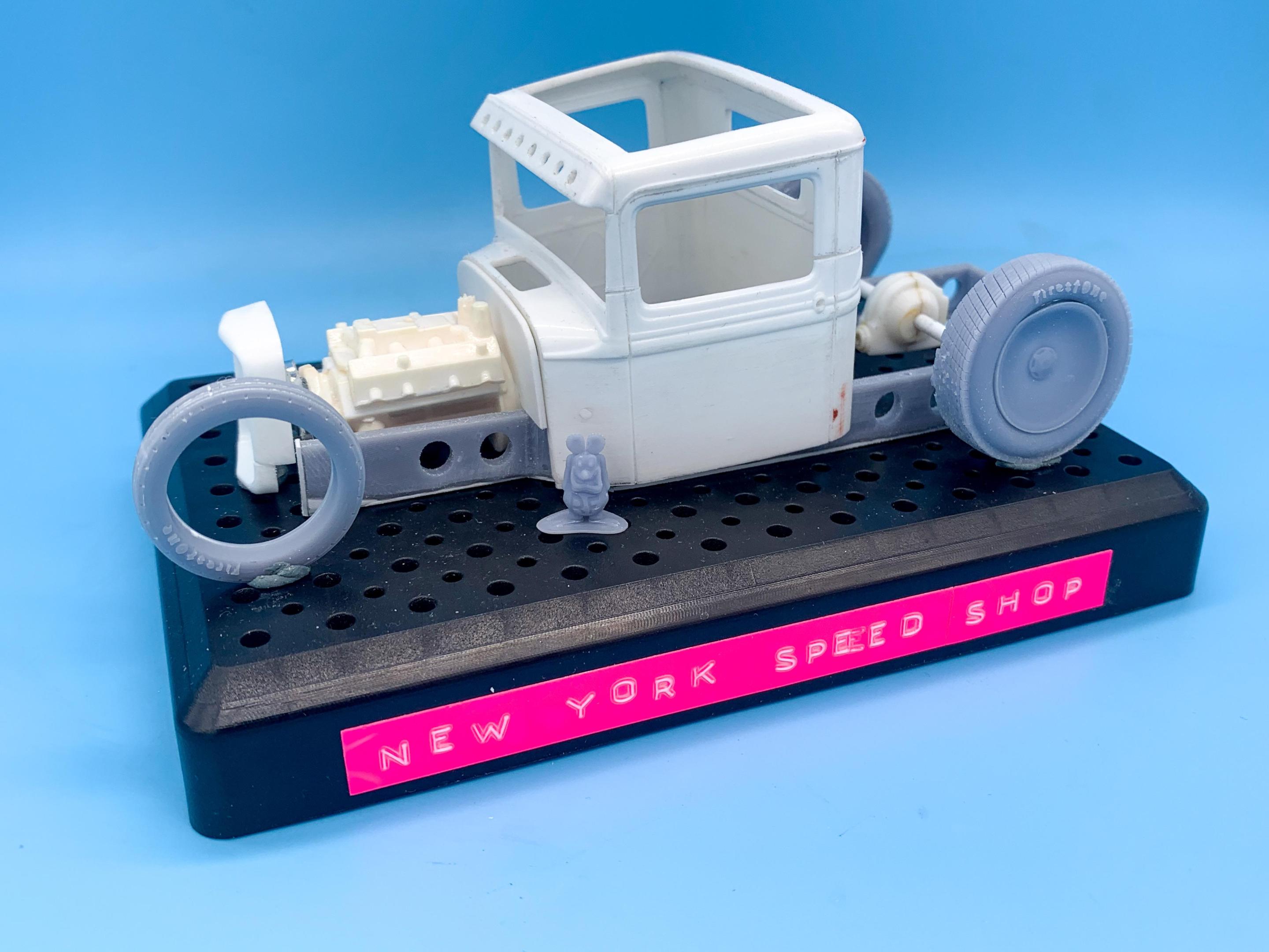

A little more progress this weekend…
Got the front end mostly figured out (although need to make steering linkages)
And, as you can see, got that weird funky Ed Roth rear suspension design mostly mocked up too; the Mysterion has a little air shock that looks like it damps and allows for variable rear ride height (maybe?) so I’ll machine a little part that’s similar for mine too, which will attach to that rod that’s just hanging out there in space right now:
Not sure how well this setup would work in real life…good thing I won’t ever have to really drive it!
I’d like to use an FE engine but the AMT kit parts aren’t amazing - but I do like that trans, whatever it is (any ideas anyone?).  Considering slicing that off and mating it to a Revell Deuce FE instead and backdating that somewhat to look more like a 390 Thunderbird mill…but in the meantime, I’m trying to figure out a ‘pre-drilled’ printed distributor design that I can use instead of drilling out kit parts.  Not quite there yet, but got a simpler design with a single hole to print ok at least:
Still need to experiment with that some more.

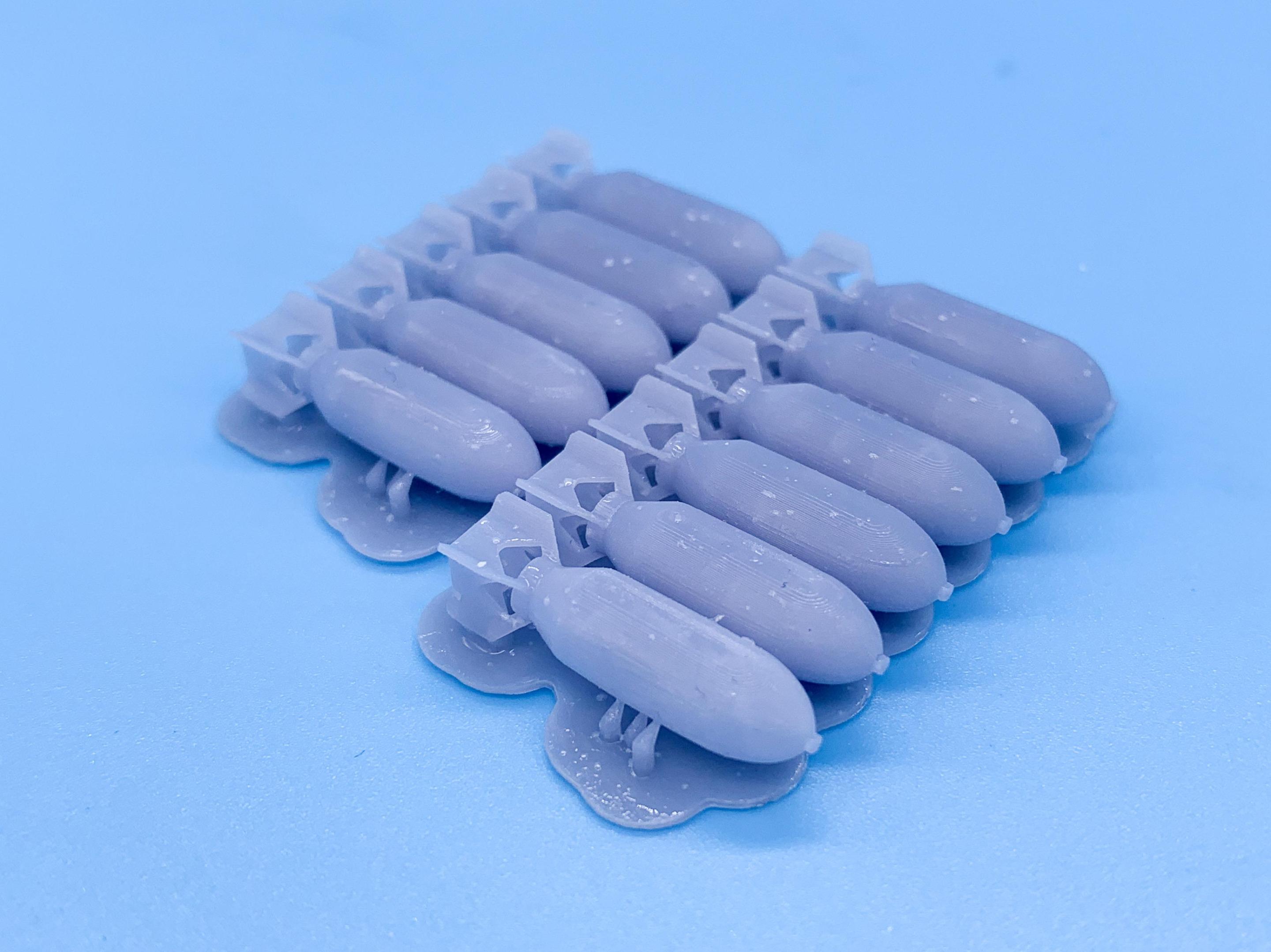

Also on my mind: gas tanks.  I want something with a decent size, and something more interesting than just a fuel cell or a Moon tank…maybe something made out of a bomb?
Printed these in 1:72 scale so they’re WAY too small, but the printer handled those little fins on the back just fine, which is reassuring…
