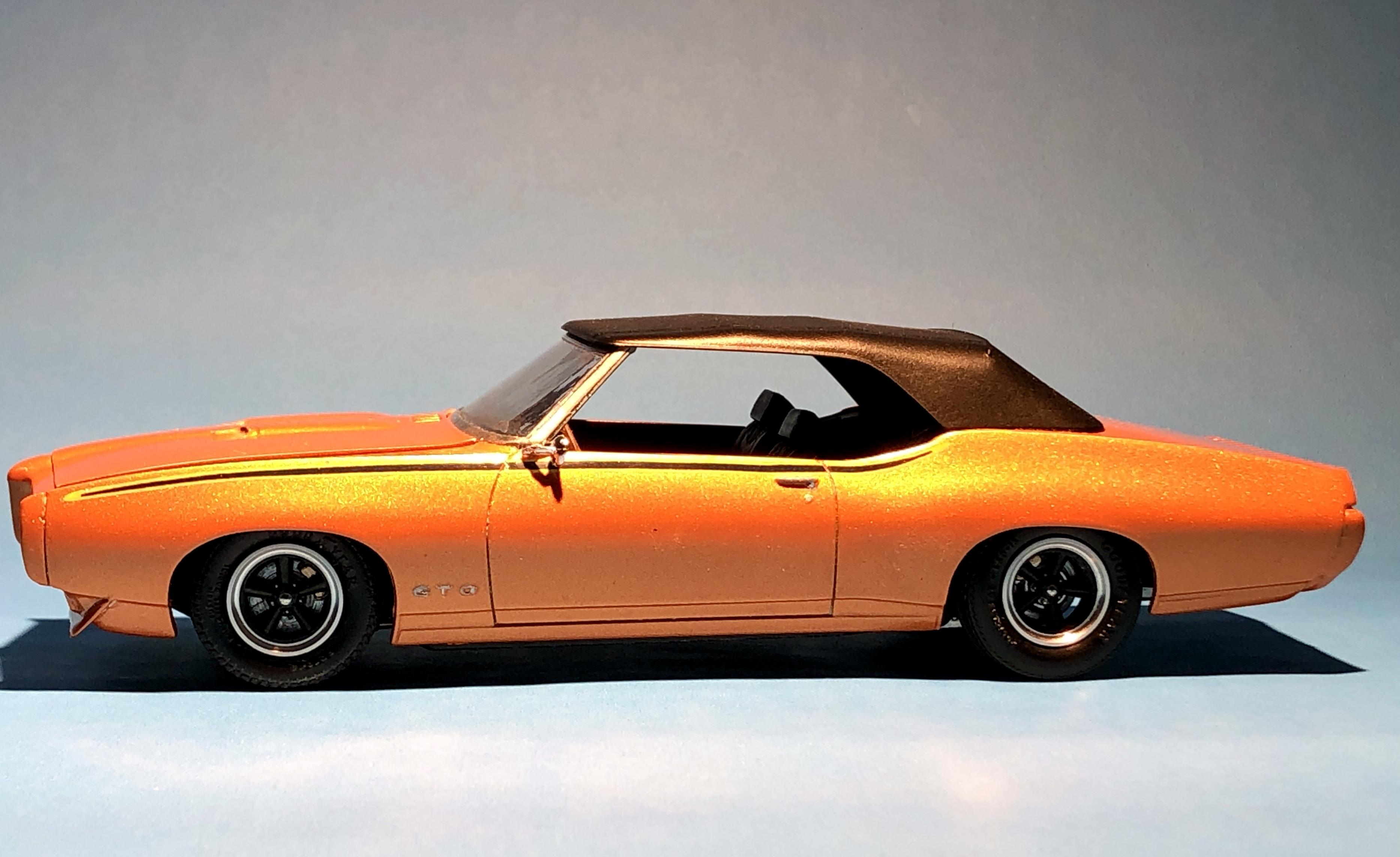

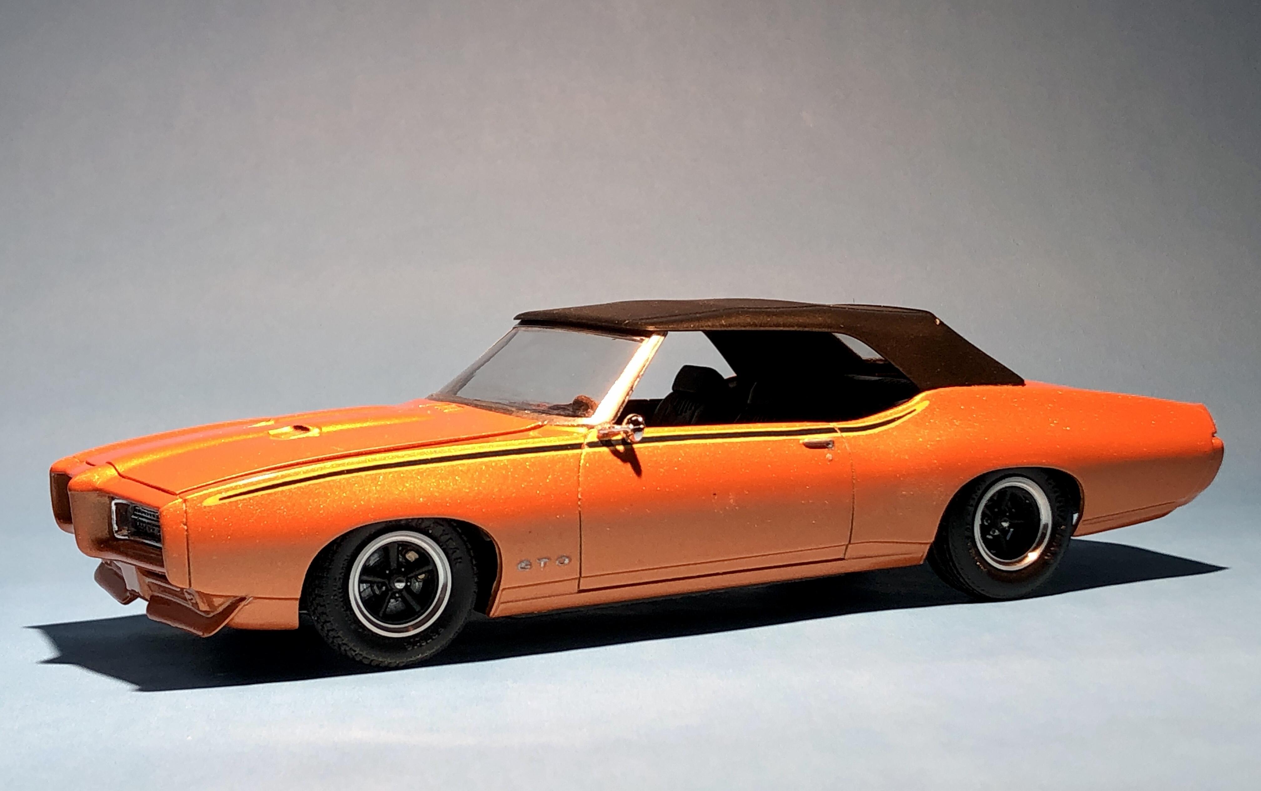

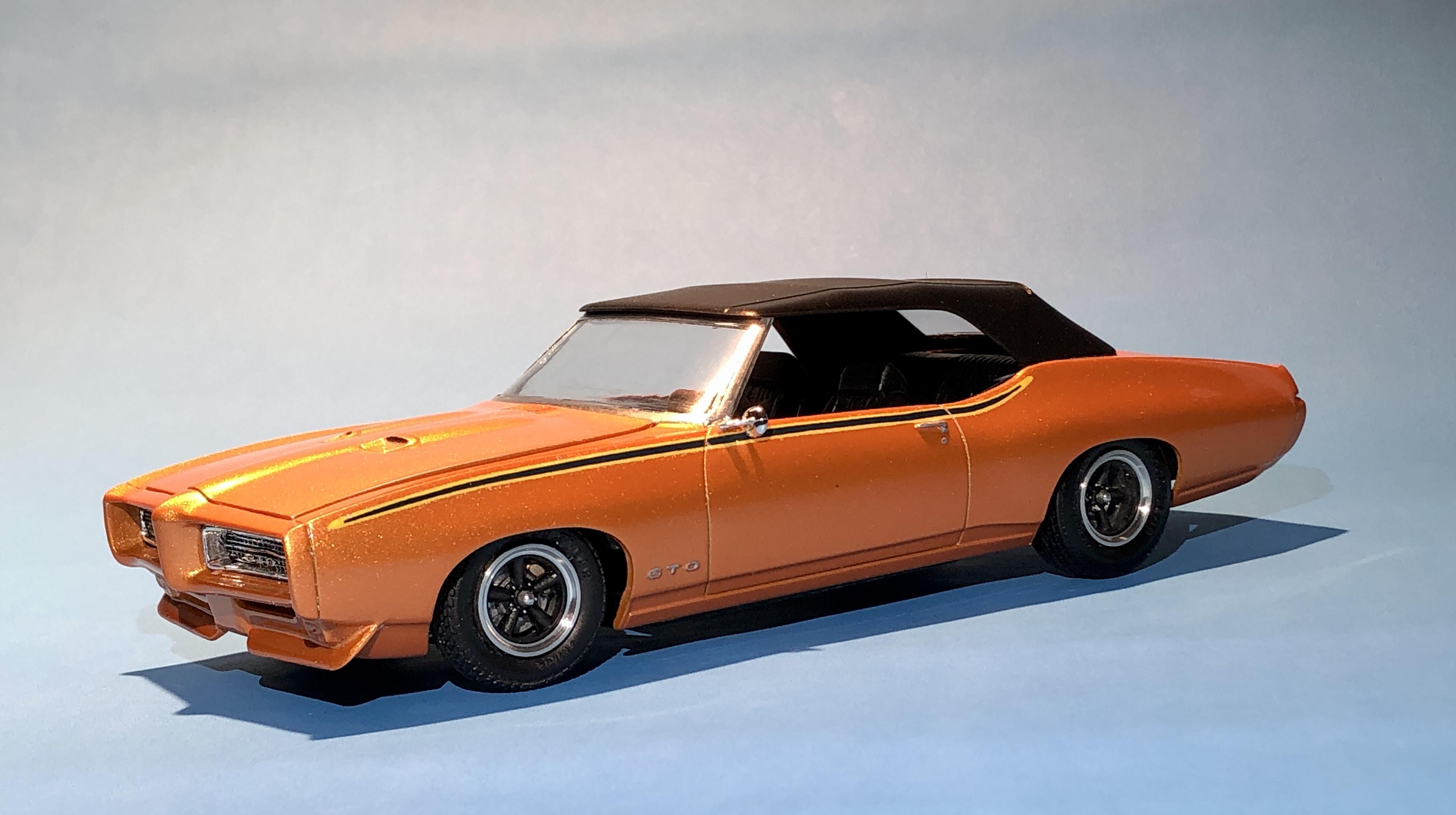

foghorn62 Posted March 2, 2022 Posted March 2, 2022 Took over fifty three years, but I’m finally able to call this one done. Started with a MPC 69 GTO Convertible screw bottom kit. Found a chassis and engine bay parts pack for a Revell 68 Chevelle on EBay, and it fit perfectly. Up top and windshield frame from a Revell 72 Olds 442 kit, also fit perfectly. Pontiac 400 and interior are original MPC parts. Wheels are 3D printed centers, with Dancing Bear turned outer rings, and scratch made aluminum inners. Paint is Wicked Pearl Orange water base, Wicked Gold, Cosmic Sparkle, and a dash of ground dry pearl, with three thin coats of House of Color clear urethane. 1

foghorn62 Posted March 3, 2022 Author Posted March 3, 2022 16 minutes ago, bisc63 said: Great show-car flake job! Nice model. Thanks Rusty! Believe it or not, there is no flake in it. There is however a ton of pearl that really makes it sparkle under the lights! TS 1
