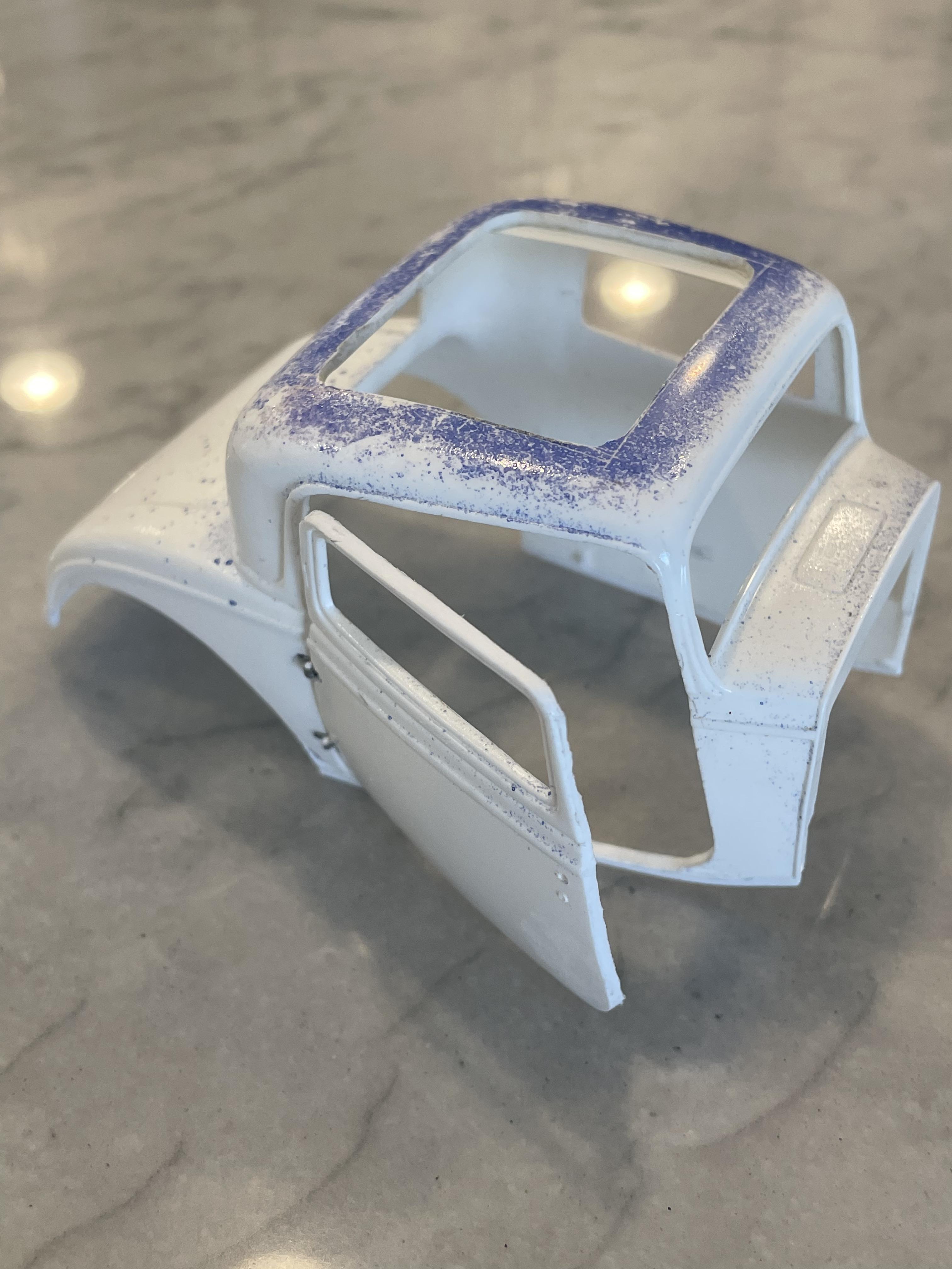

Marc Weller Posted October 20, 2022 Author Share Posted October 20, 2022 Wow !! I left a message with House of Kolor and they called me back almost immediately. They recommend prepping the body with Spray Away glass cleaner and shooting an initial extremely light tack coat before trying t get the gloss to flow. I confess to being a little heavy handed with my initial coats so maybe this is my problem. Also watched a YouTube about repairing fisheyes but, to tell the truth, I subscribe to the old adage that the enemy of good is better !! Quote Link to comment Share on other sites More sharing options...

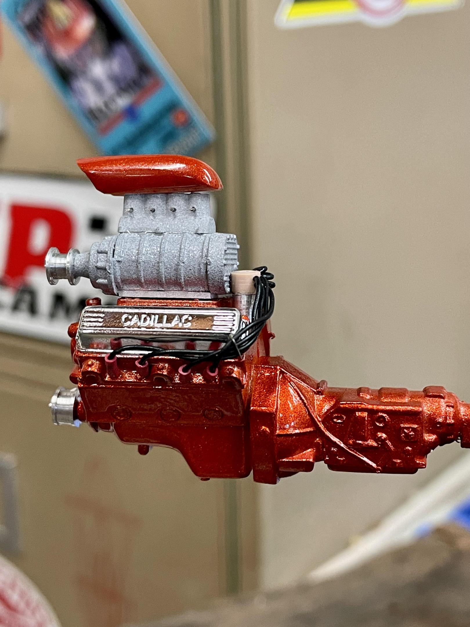

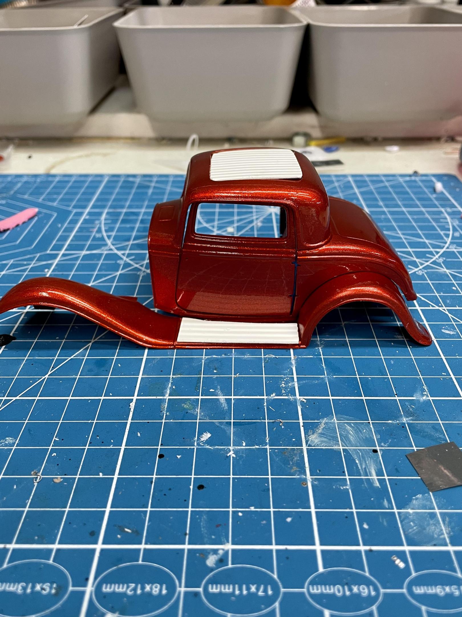

Marc Weller Posted October 21, 2022 Author Share Posted October 21, 2022 Making progress. Motor just needs fuel lines and linkage, body now has color. Getting there but it is gonna be tight for 11/5 2 Quote Link to comment Share on other sites More sharing options...
bill-e-boy Posted October 21, 2022 Share Posted October 21, 2022 Looking good Nothing like a bit of pressure lol Quote Link to comment Share on other sites More sharing options...
Zippi Posted October 21, 2022 Share Posted October 21, 2022 That Caddy engine is looking mighty fine. Quote Link to comment Share on other sites More sharing options...
slusher Posted October 22, 2022 Share Posted October 22, 2022 Paint and engine looks fantastic! Quote Link to comment Share on other sites More sharing options...

espo Posted October 22, 2022 Share Posted October 22, 2022 The paint looks great. I like the color match on the engine. What sort of finish did you use on the supercharger and injectors? Quote Link to comment Share on other sites More sharing options...

Marc Weller Posted October 22, 2022 Author Share Posted October 22, 2022 1 hour ago, espo said: The paint looks great. I like the color match on the engine. What sort of finish did you use on the supercharger and injectors? Glad you asked. I came up with this years ago. I modified one of the needles on my Pasche airbrush so it would spatter consistently. I also use a low air pressure setting. Step one, spatter white lacquer primer to get the texture, then spatter light grey enamel, then spatter slightly darker grey enamel, then finally super light dusting of chrome silver enamel. That's it. Looks like a bare casting. 2 Quote Link to comment Share on other sites More sharing options...

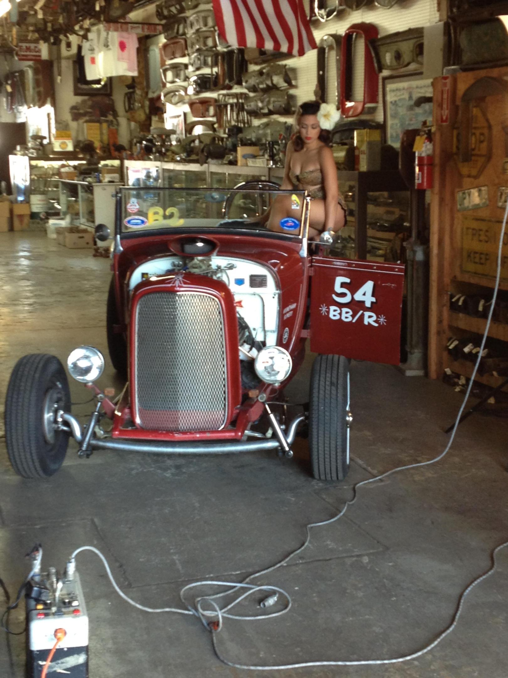

Marc Weller Posted October 22, 2022 Author Share Posted October 22, 2022 45 minutes ago, ea0863 said: It's so interesting, the things one learns about the motoring industry - and even history in general, just building models! One article I found suggested the West Coast vibe was largely influenced by racing (especially on the Salt Flats), while East Coast was more for sport and track racing. In any event, your build is coming out great! Here's the east coast style insert on my '29. Please try to ignore the girl Quote Link to comment Share on other sites More sharing options...
ea0863 Posted October 22, 2022 Share Posted October 22, 2022 2 minutes ago, Marc Weller said: Here's the east coast style insert on my '29. Please try to ignore the girl Where's the car again? 1 Quote Link to comment Share on other sites More sharing options...

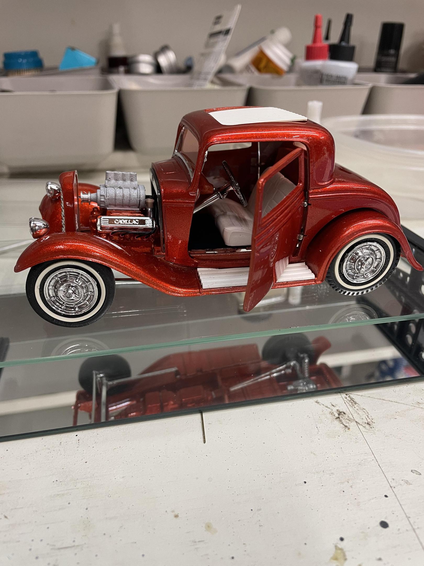

Marc Weller Posted November 2, 2022 Author Share Posted November 2, 2022 It’s not done but my to do list is getting shorter!!! 3 Quote Link to comment Share on other sites More sharing options...
ea0863 Posted November 2, 2022 Share Posted November 2, 2022 So much coolness all in one car! Thanks for giving us the blow-by-blow on the build, I'm certainly learning a lot! Quote Link to comment Share on other sites More sharing options...
CabDriver Posted November 2, 2022 Share Posted November 2, 2022 On 10/22/2022 at 11:40 AM, Marc Weller said: Please try to ignore the girl No 🤪 GREAT looking build - love everything about it! Great color, sits nice, good engine choice - great work! Quote Link to comment Share on other sites More sharing options...
NOBLNG Posted November 2, 2022 Share Posted November 2, 2022 She’s a real beauty Marc!👍 Quote Link to comment Share on other sites More sharing options...
Joe Nunes Posted November 2, 2022 Share Posted November 2, 2022 I really like this model, Mark. 👍👍 Everything works so well together…comes off like eye-candy! Joe Quote Link to comment Share on other sites More sharing options...
Marc Weller Posted November 2, 2022 Author Share Posted November 2, 2022 Thanks everybody. I plan on being done by tomorrow. I haven’t put this much into a project for years. Quote Link to comment Share on other sites More sharing options...
slusher Posted November 3, 2022 Share Posted November 3, 2022 Beautiful,! Quote Link to comment Share on other sites More sharing options...
Bullybeef Posted November 3, 2022 Share Posted November 3, 2022 On 11/1/2022 at 9:01 PM, Marc Weller said: It’s not done but my to do list is getting shorter!!! That right there is the epitome of an east coast build! You sir have nailed it. Quote Link to comment Share on other sites More sharing options...

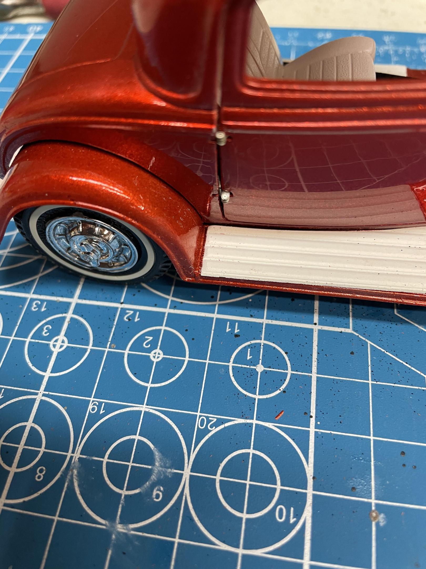

Bobjernigan3 Posted November 7, 2022 Share Posted November 7, 2022 On 8/9/2022 at 6:02 PM, Marc Weller said: I'm really challenging myself on this one. Model Car Garage photo etched external hinges are not easy to assemble having 6 tiny pieces per hinge !!! I was astonished when I was able to get them to work on the first attempt. I have many hours in getting this passenger side door opened and hinged and I really can't say I'm looking forward to the driver's side !! Quote Link to comment Share on other sites More sharing options...
