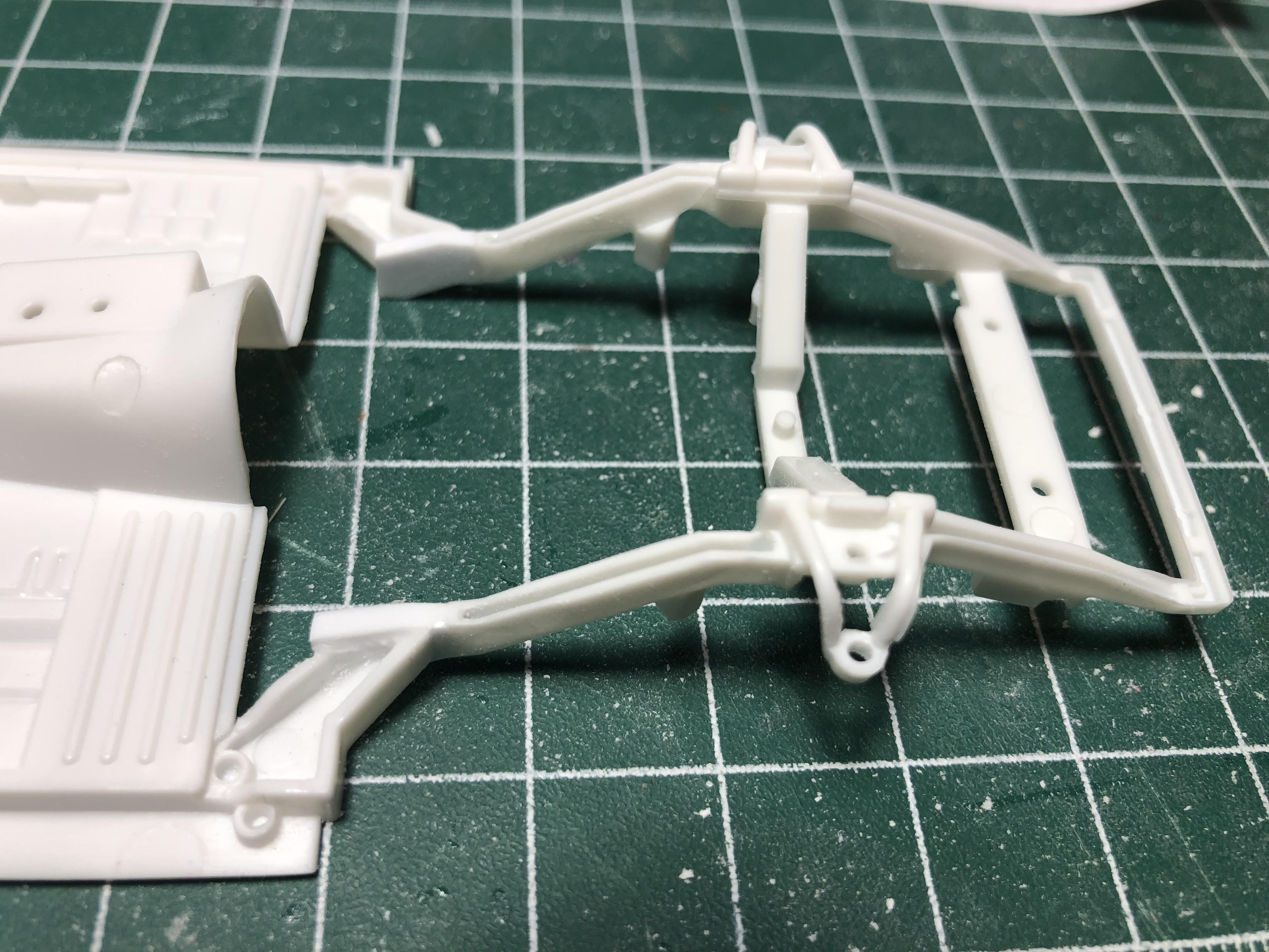

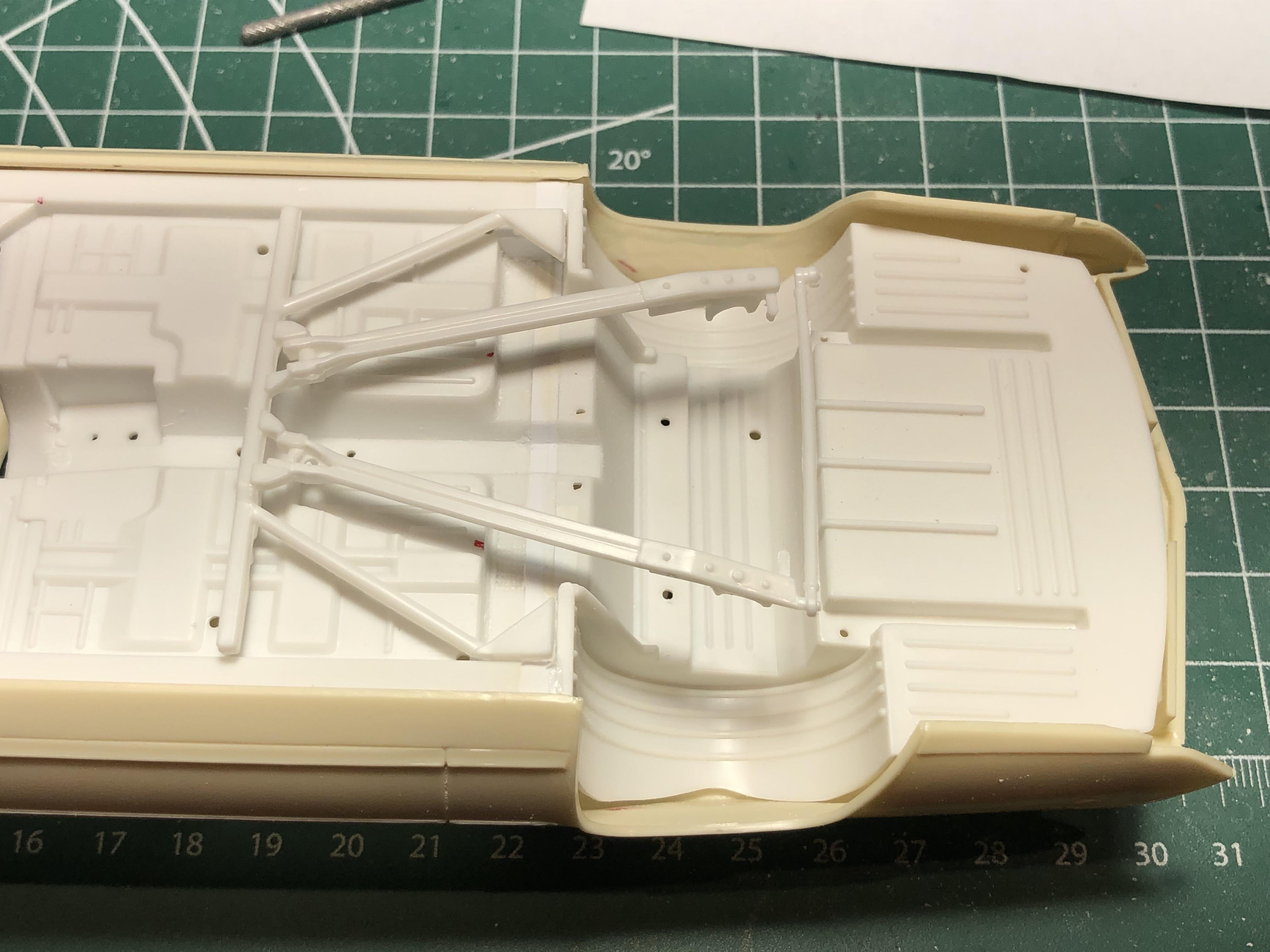

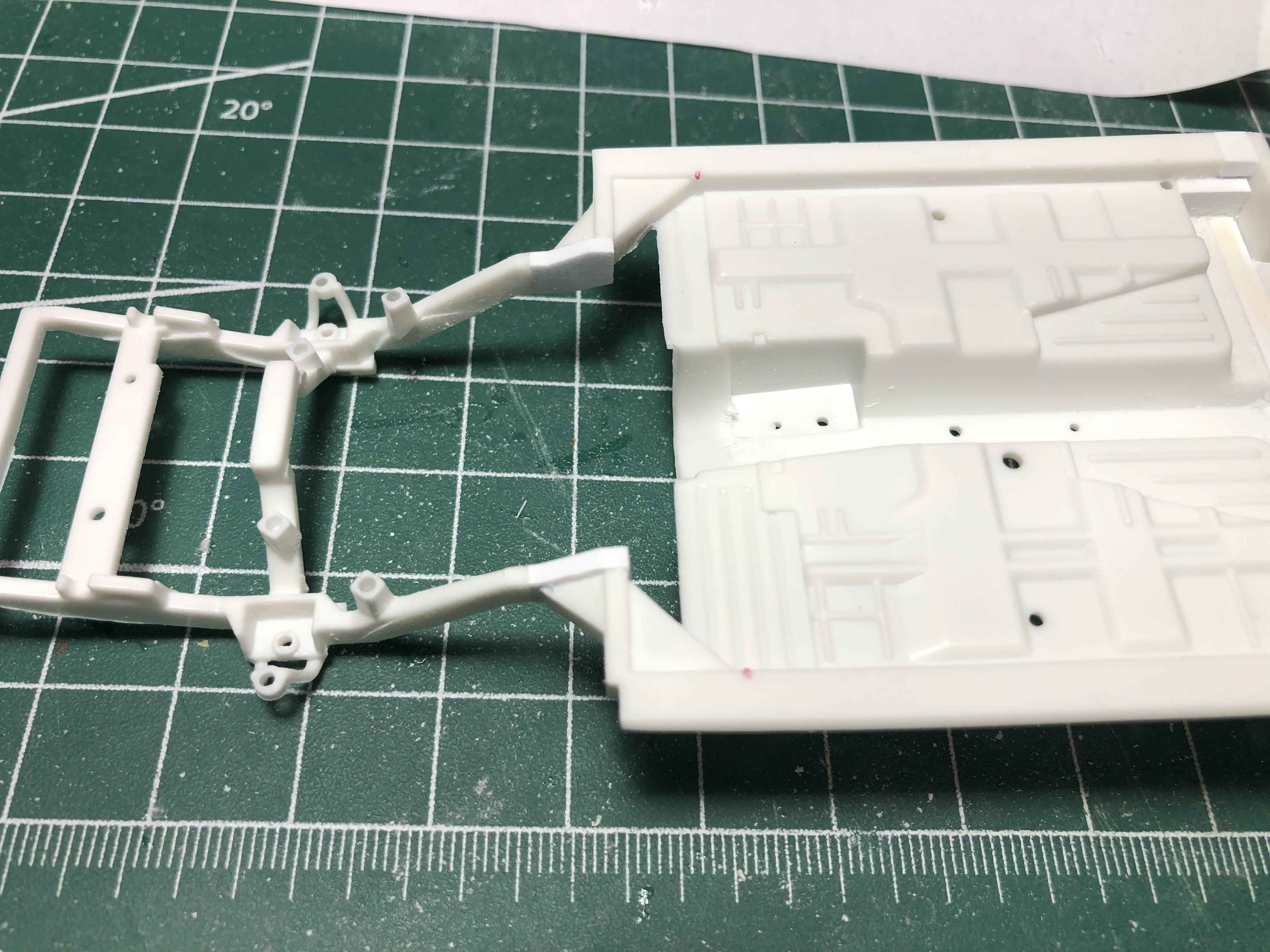

I got the chassis narrowed and glued some “stops” inside the body to set the chassis in place. Once the chassis was in place, I did a mock up and realized the that the firewall could come forward about 3 scale inches. Time to get slicing and dicing…

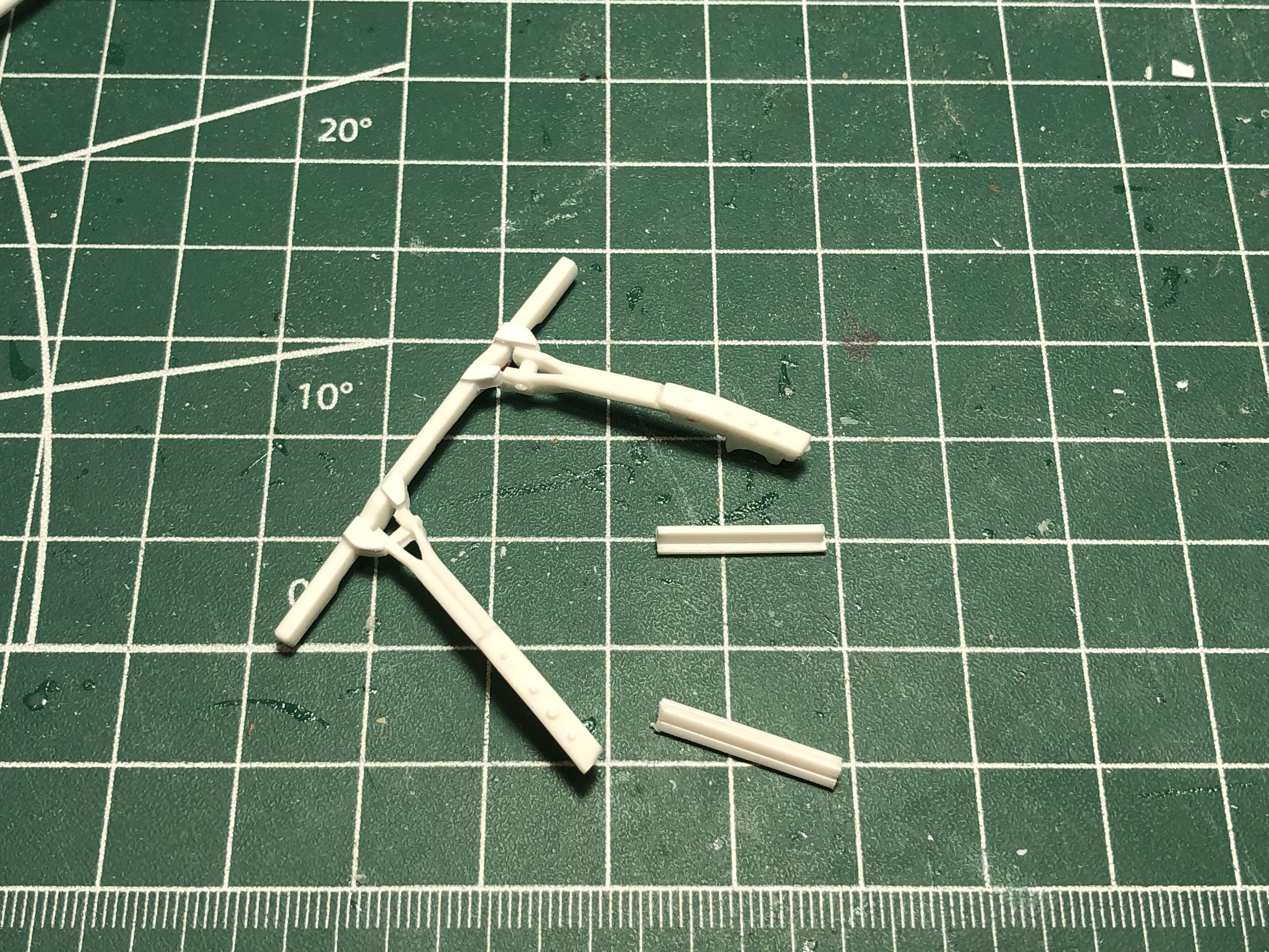

I was initially going to cut at the front of the chassis just behind the firewall, but decided it would be better at the back. I will explain that in a moment.
so, back of chassis cut off, added 3mm’s

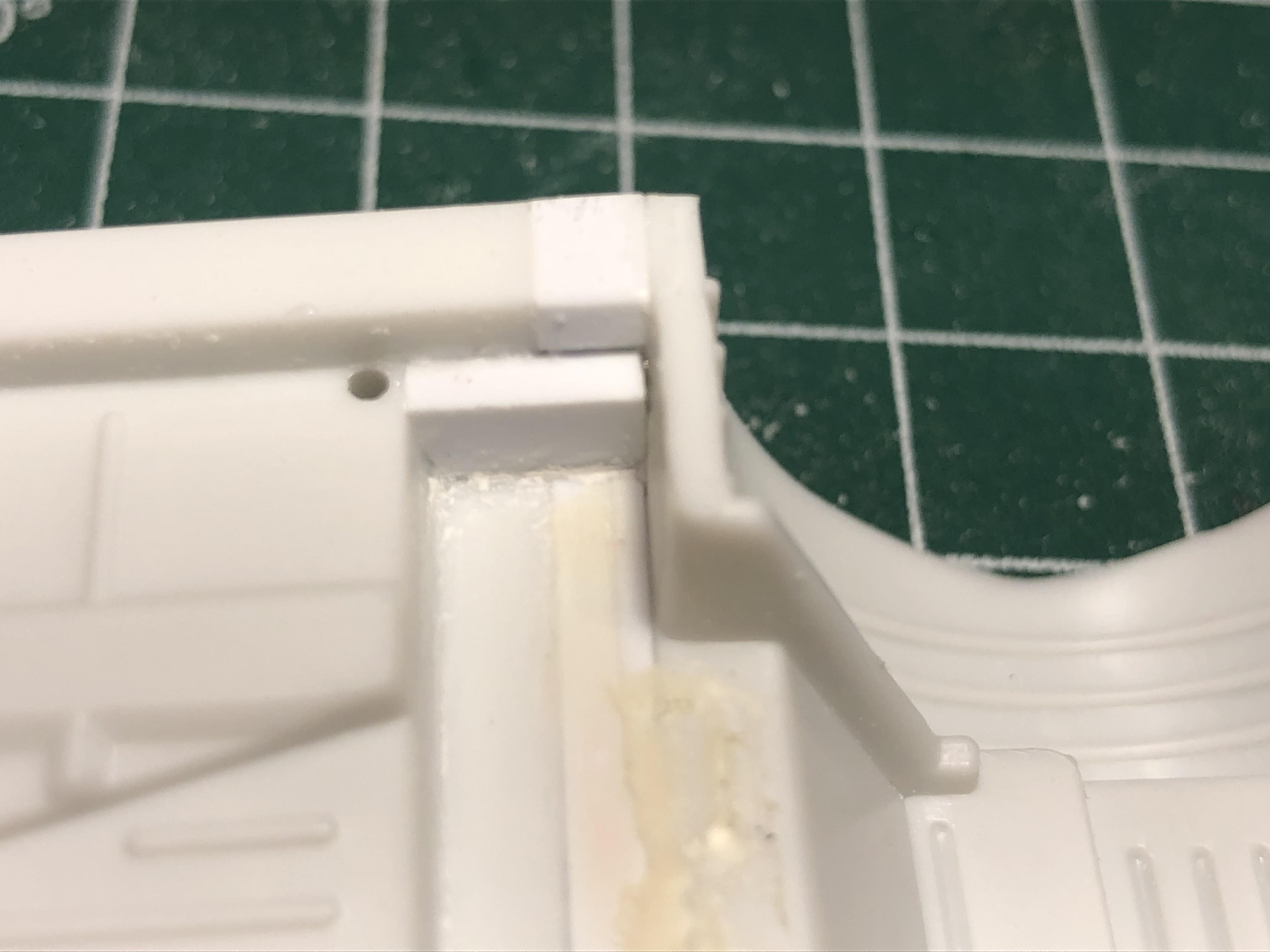

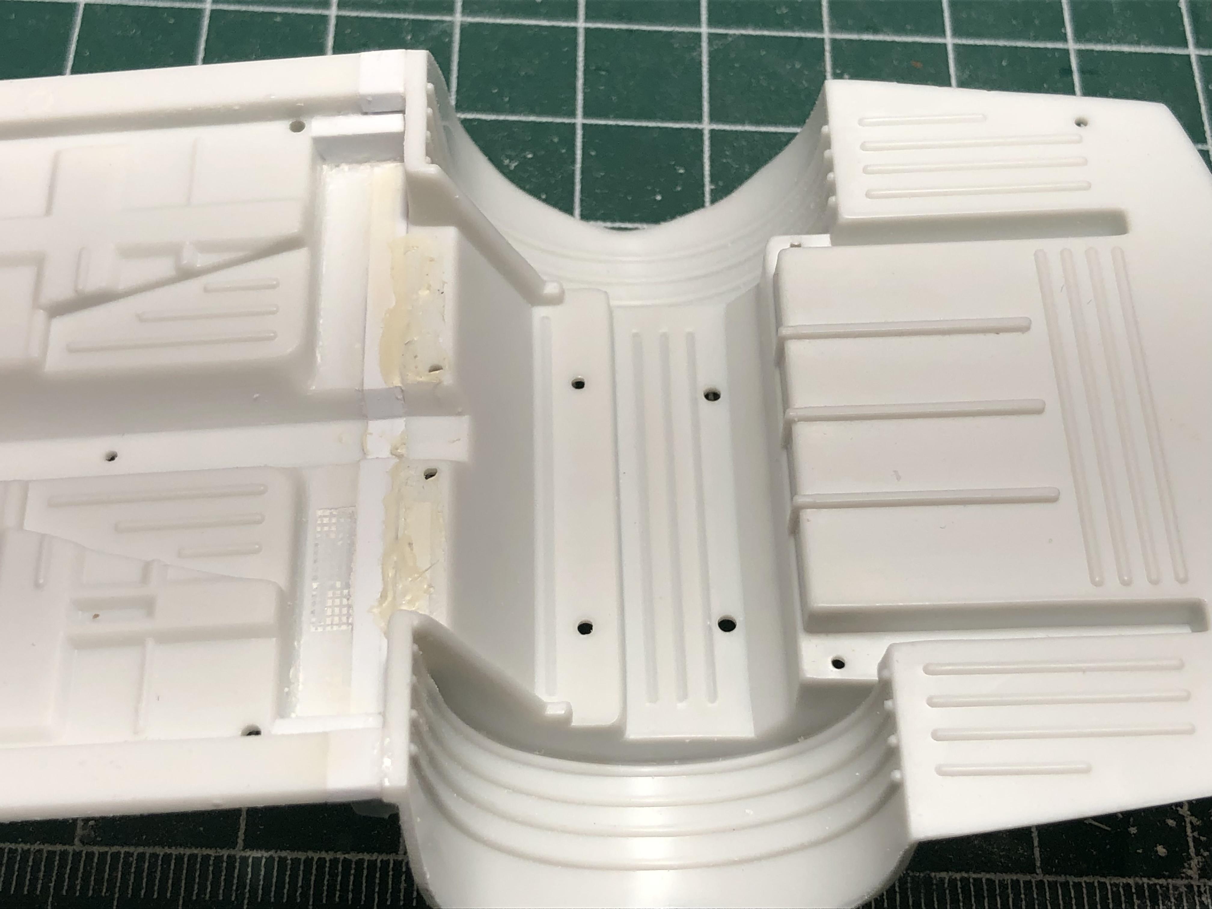

The reason I liked cutting the back, was that there was more opportunity to strengthen the joint. Chassis back in one piece…
This is the area that allowed the extra strength.
The other benefit of doing the joint at the back, is that this mess doesn’t need to be cleaned up, as it will be covered by a speaker box later..

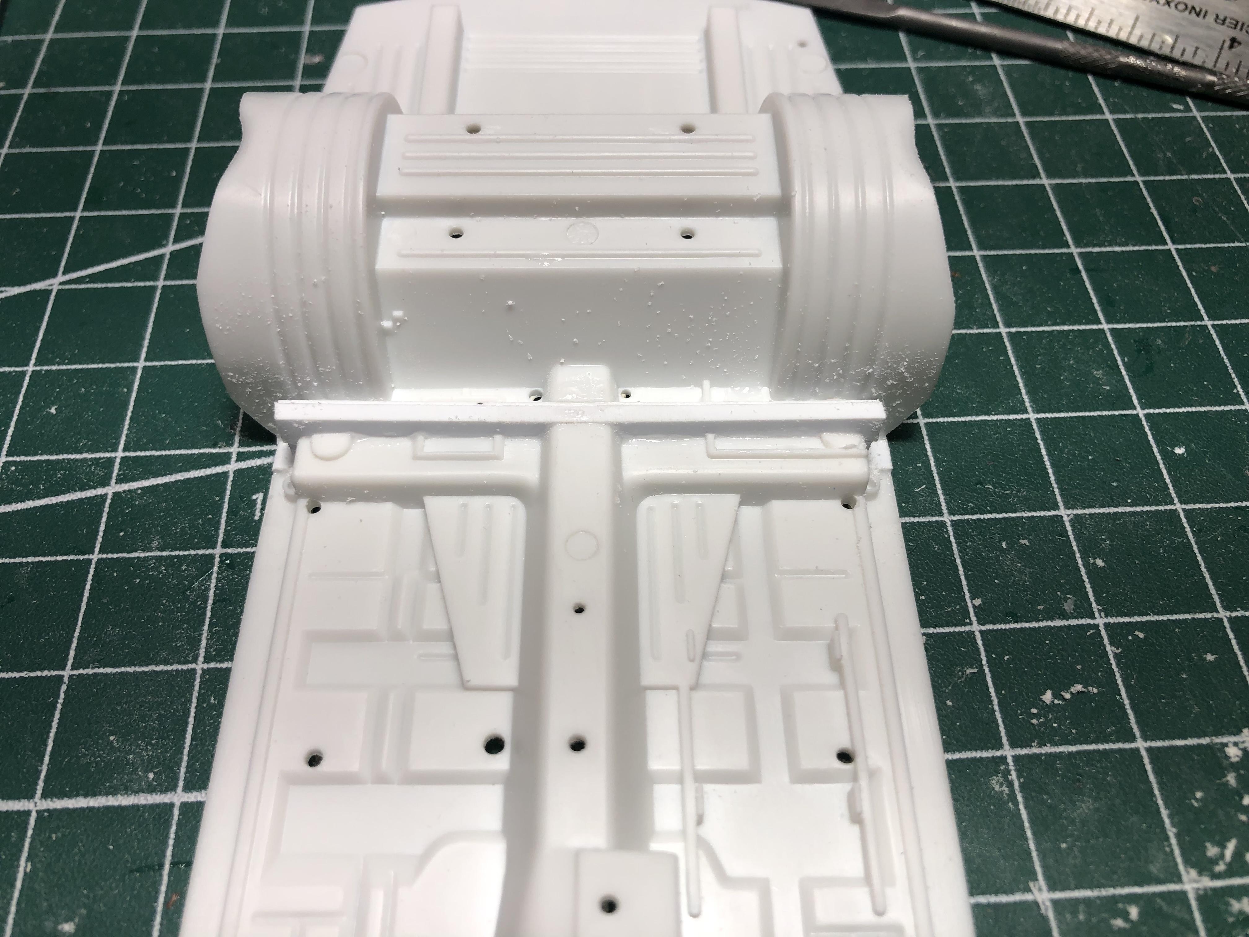

On to the front. I still need to add 8mm’s to the wheel base. So….. cut off the front
add the 8mm’s, also the front clip needed to be come up about 5mm’s. Here it is back together…
I still need to clean things up a bit, but I now have the basic height and length of the chassis set. Next will be figuring out ride height, and engine placement. I know that both the front and rear suspension need lowering still.
Thanks for having a look.

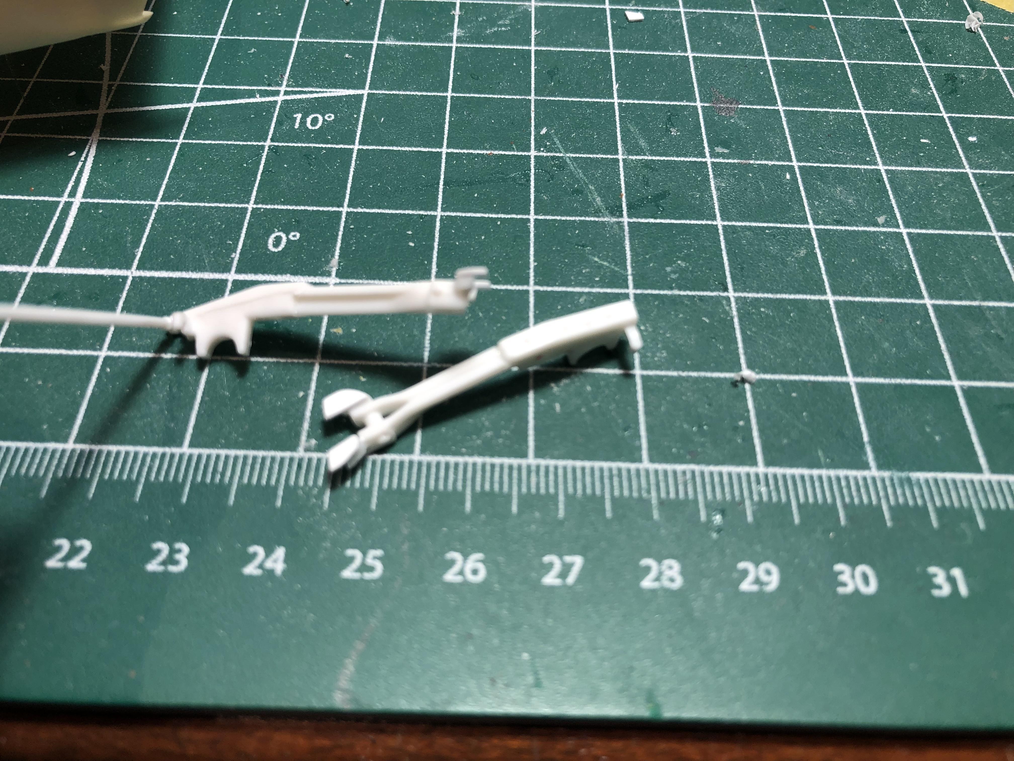

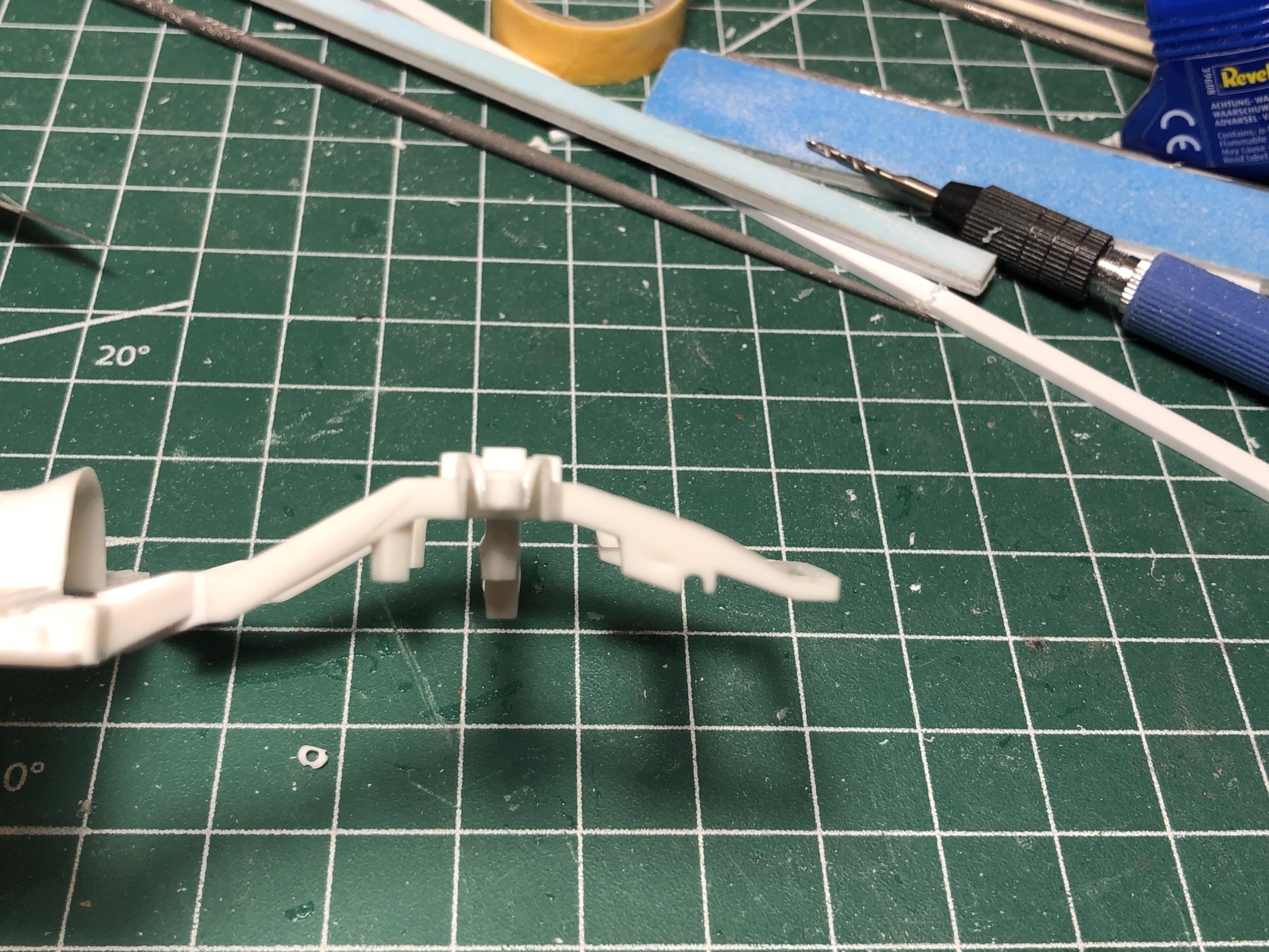

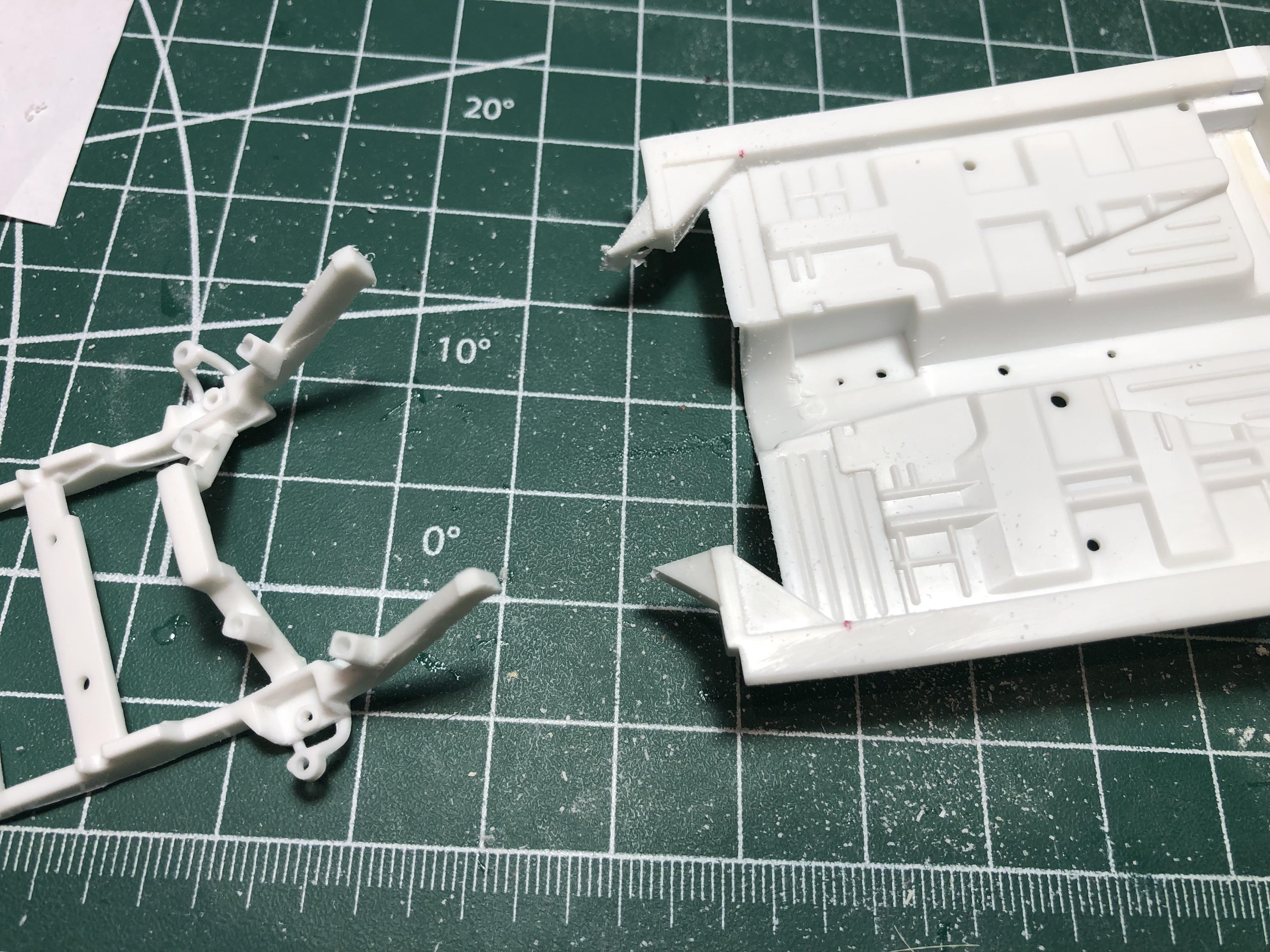

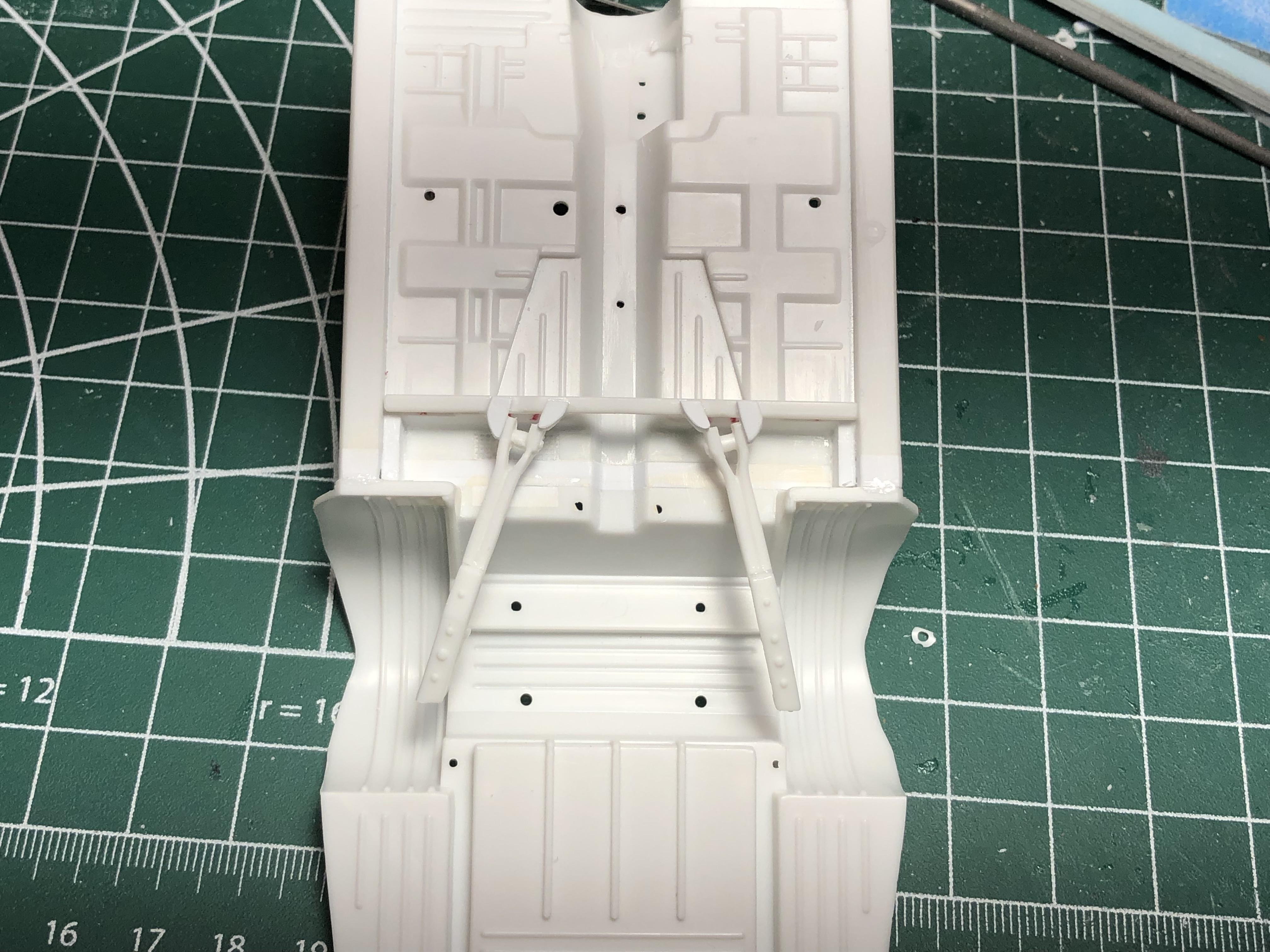

Got a bit more work done on the chassis. First up, rear suspension…
Started with this…50EC2F81-98A0-4A79-BF36-98AD19D7BFC2.thumb.jpeg.20ce49c503bf5dc8398fc091ed712ec6.jpeg
I cut the truck arms free and shortened them
2ED0DF12-5B20-474B-AFAA-EE1227DBE501.thumb.jpeg.53c41451ebdc431f1b6b613773fea1c7.jpegre-attached them to the cross member
After that, we end up with something like this…
Still some fine tuning to do, but happy how it came together so far.

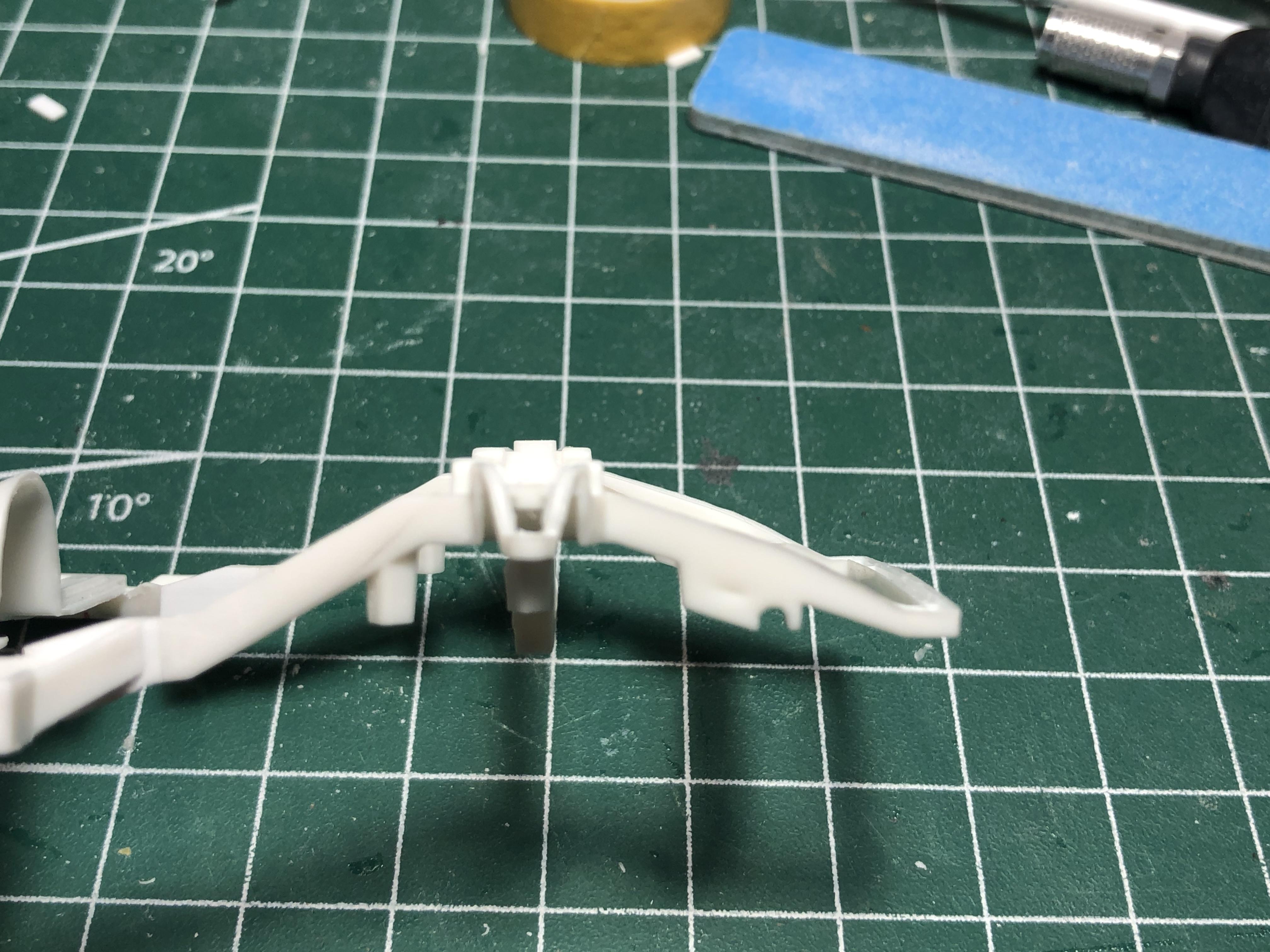

Front suspension was much easier. Before…
I added some rod with centre drilled on the top where the spindles mount, then cut/sanded away the bottom. Added the same amount to the lower A arm. The end result is another 1.5” drop.
I still have some tinkering to do on both ends, especially the front. However, I’m not going to do more refining until I finalize my wheel tire choice, and that could be a couple weeks away or more. Having said that both are very close to the correct ride height , front will probably come down a scosh more.

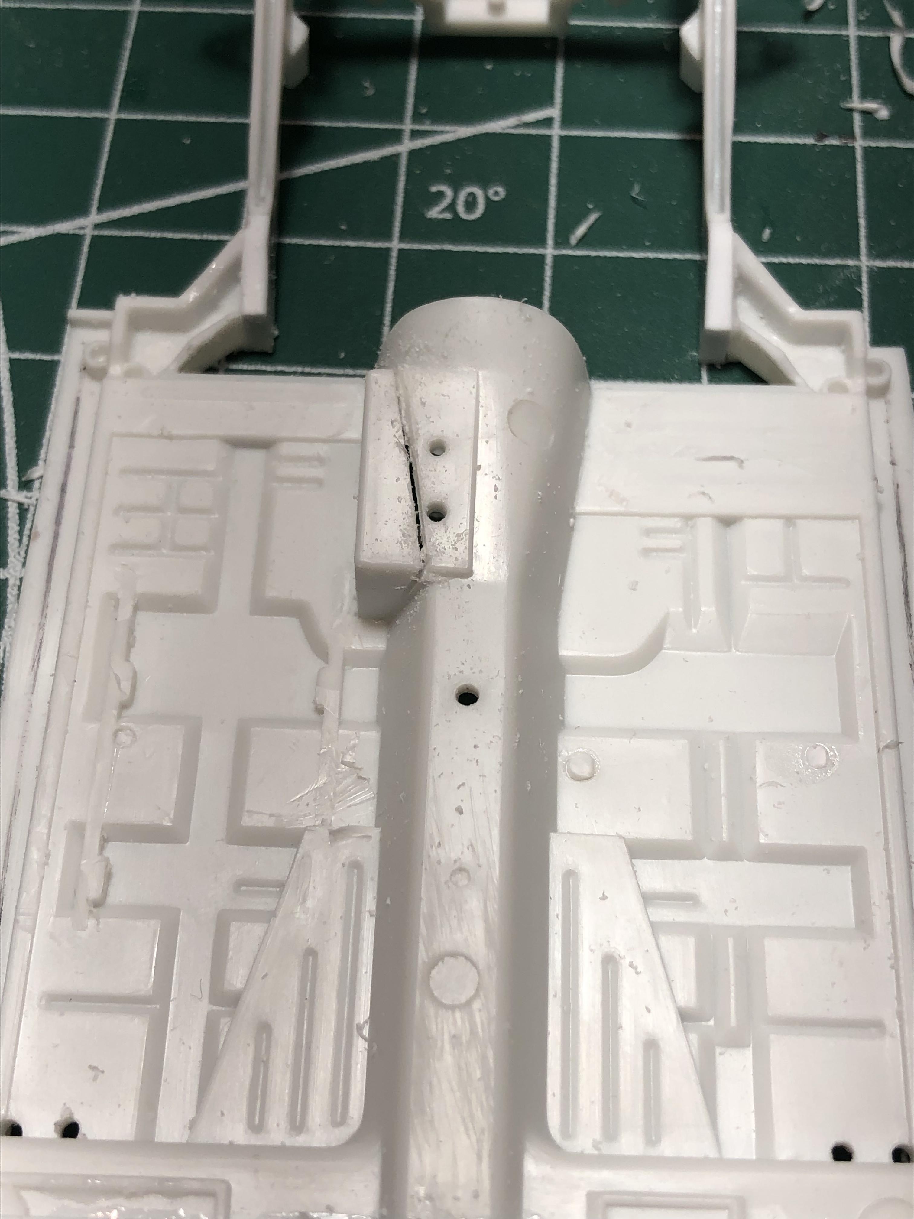

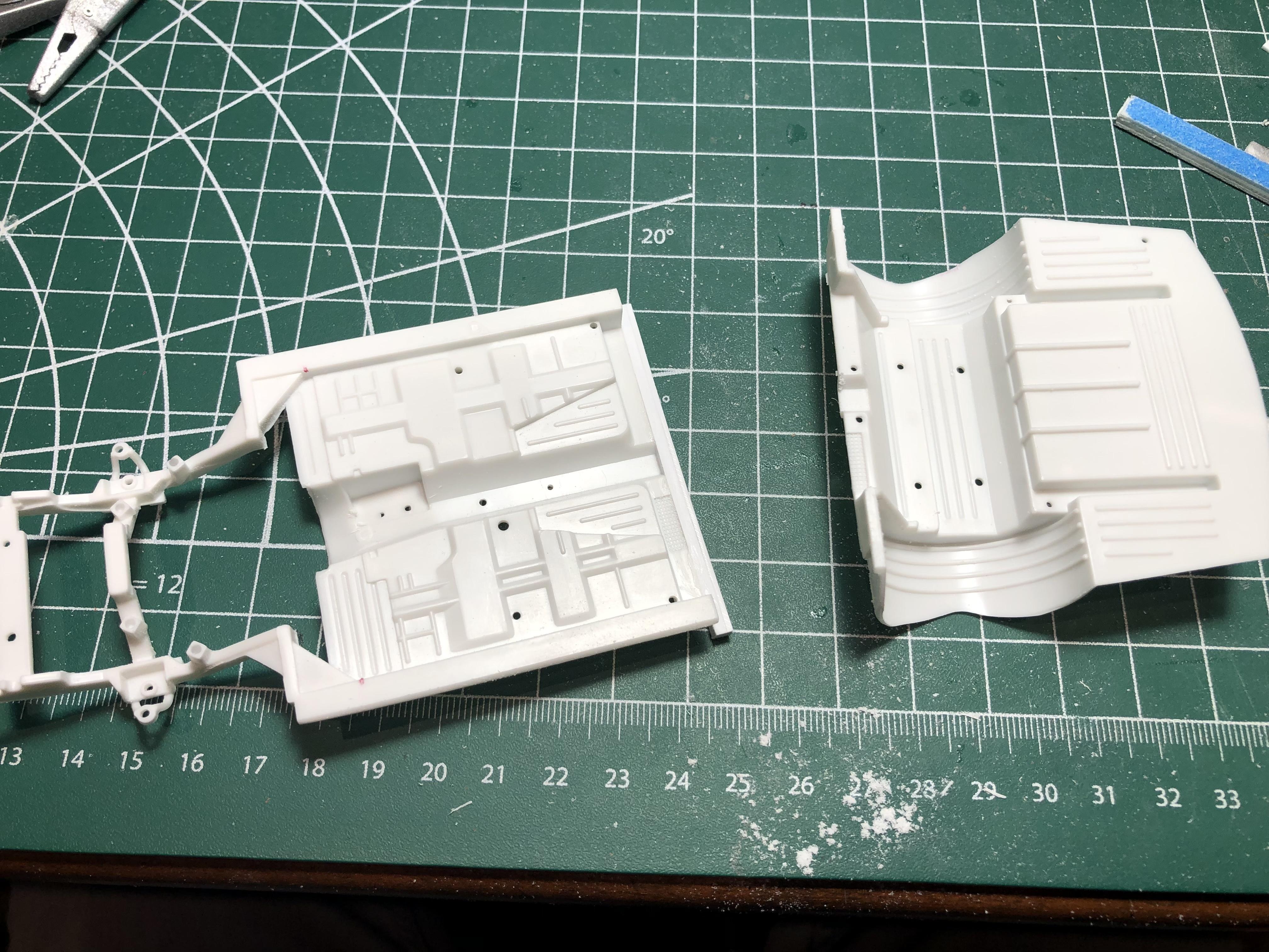

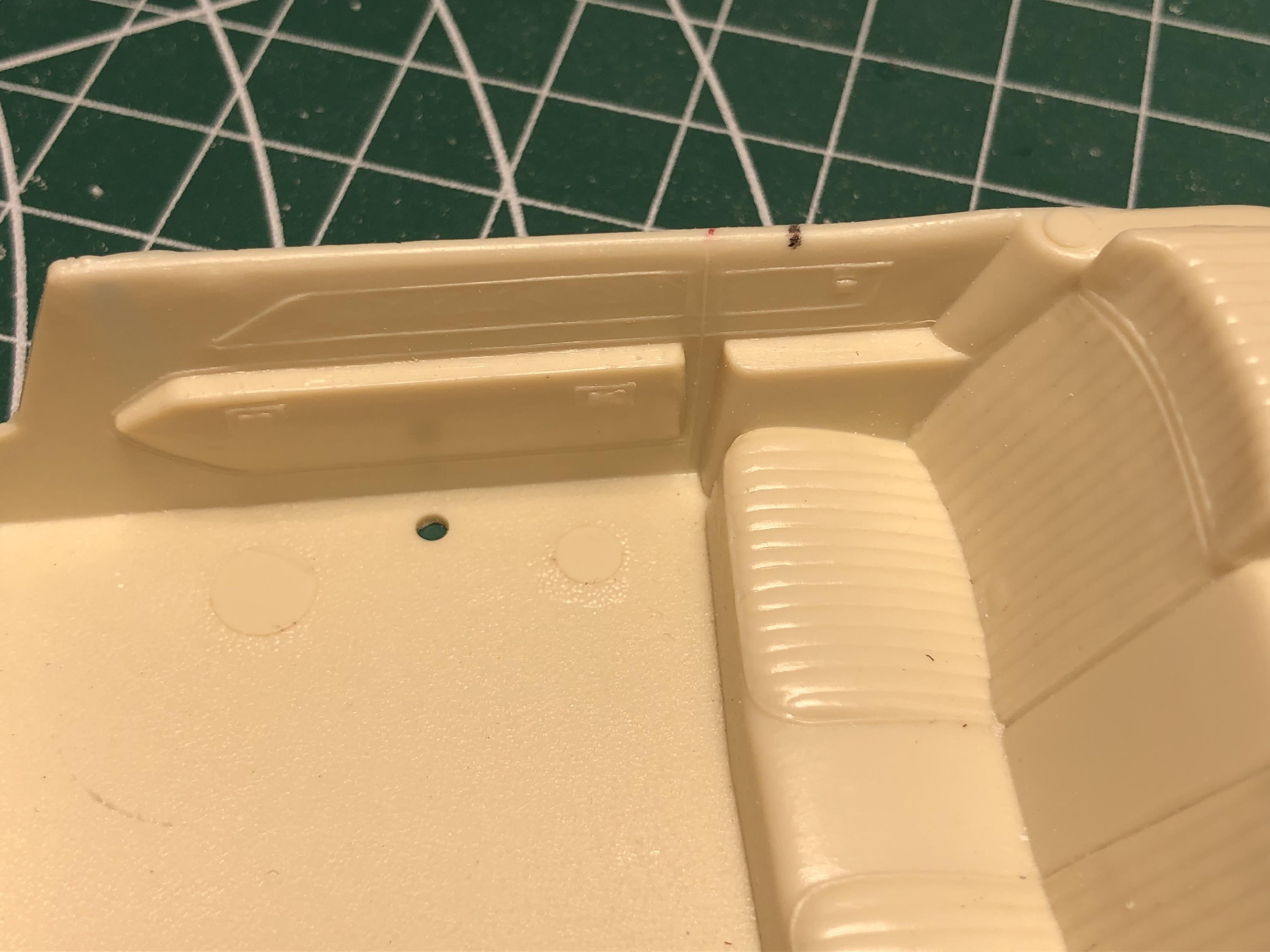

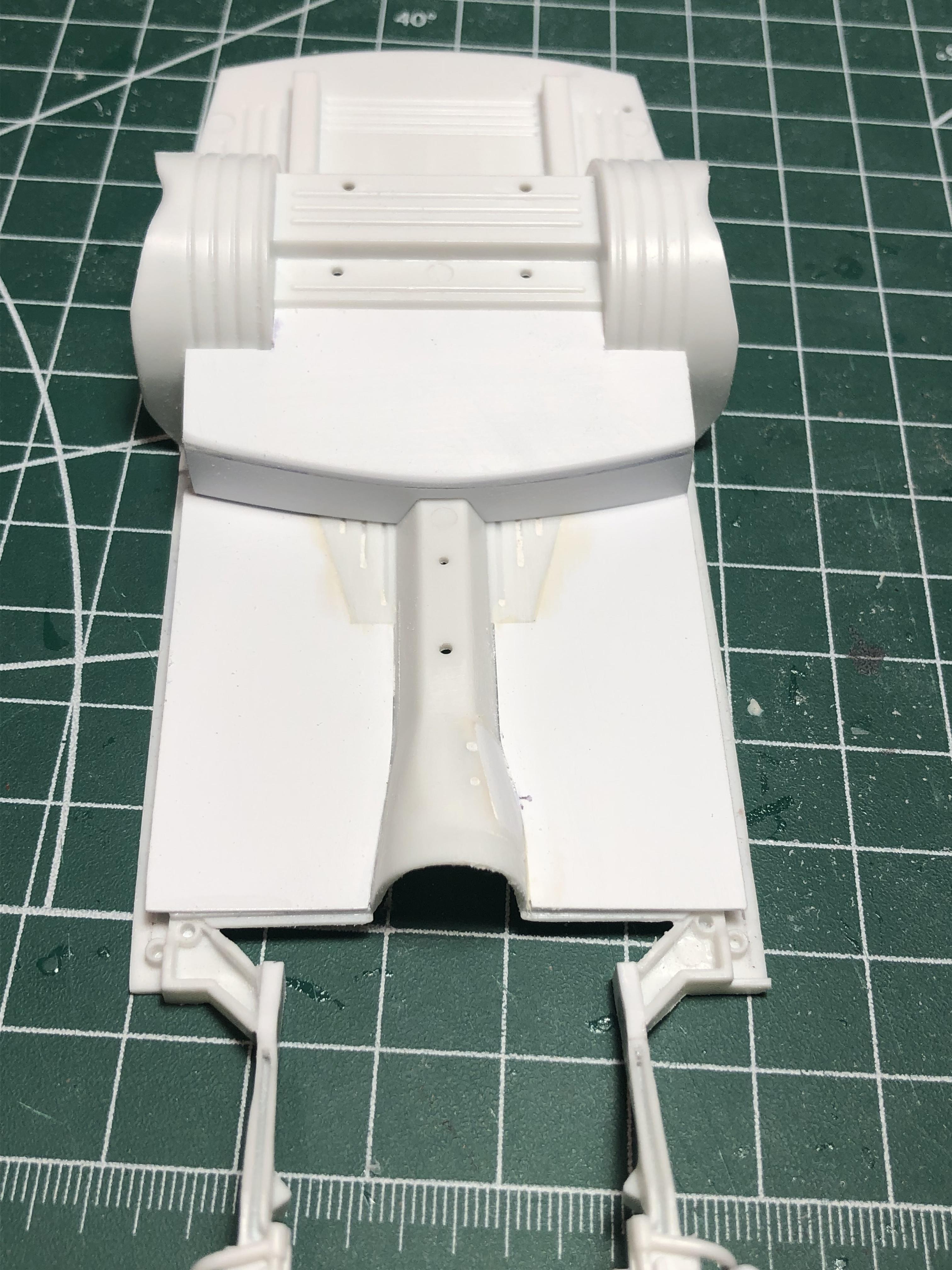

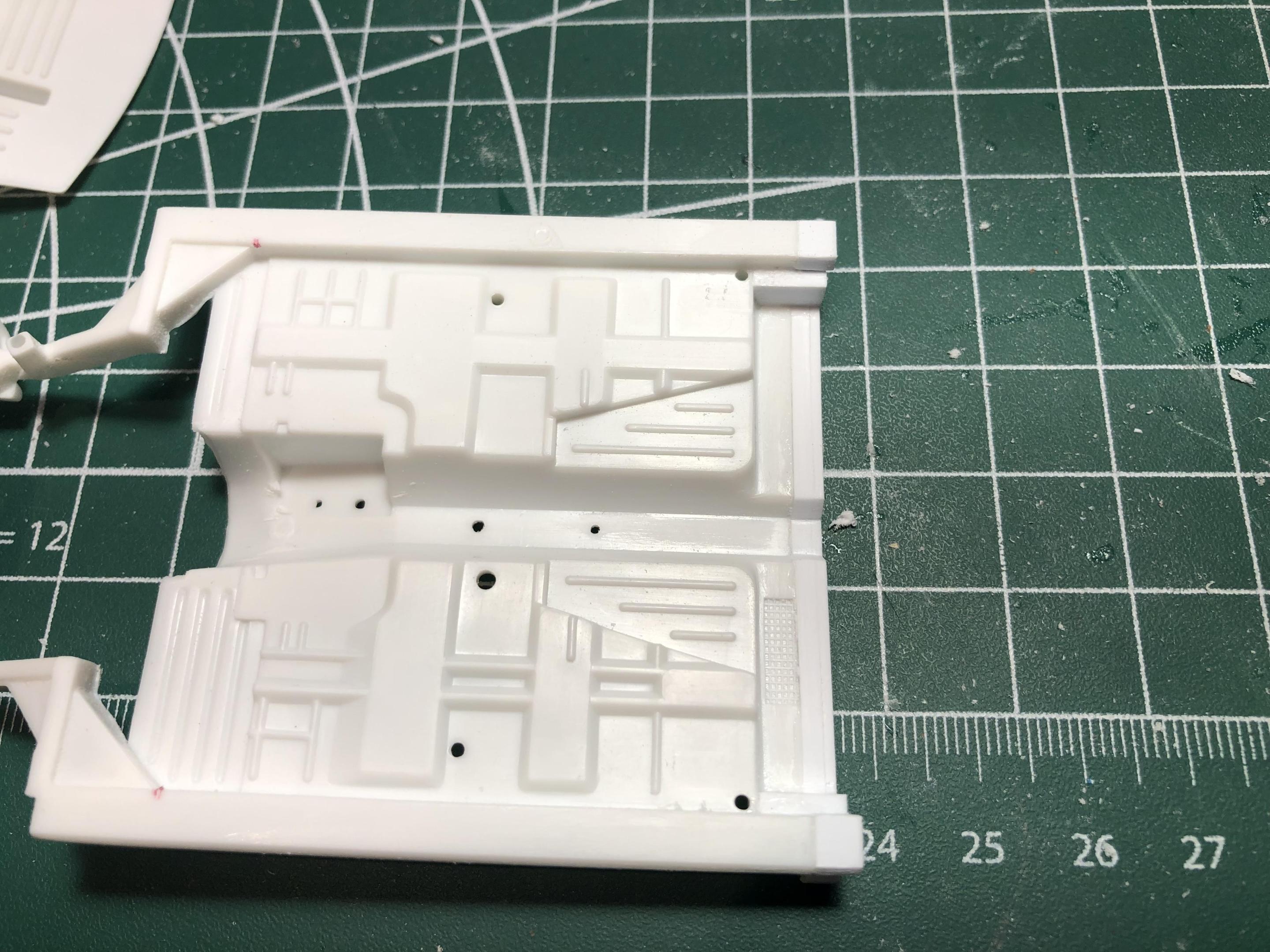

Started planning the interior and how best to tackle it. The original thought was to heavily modify the kit tub, completely reworking the door panels, seats…. well, the whole thing. So after more head scratching, I decided it was definitely going to be easier to build a “platform” interior. I want to create a “modern” interior, but I really want to incorporate the “stock” dash. So, after another dive into the stash and parts bins, I have started to gather some parts to work with.
Here’s the kit tub,  the red dot is the door opening on the inside, the black is where the door actual opening is on the body…

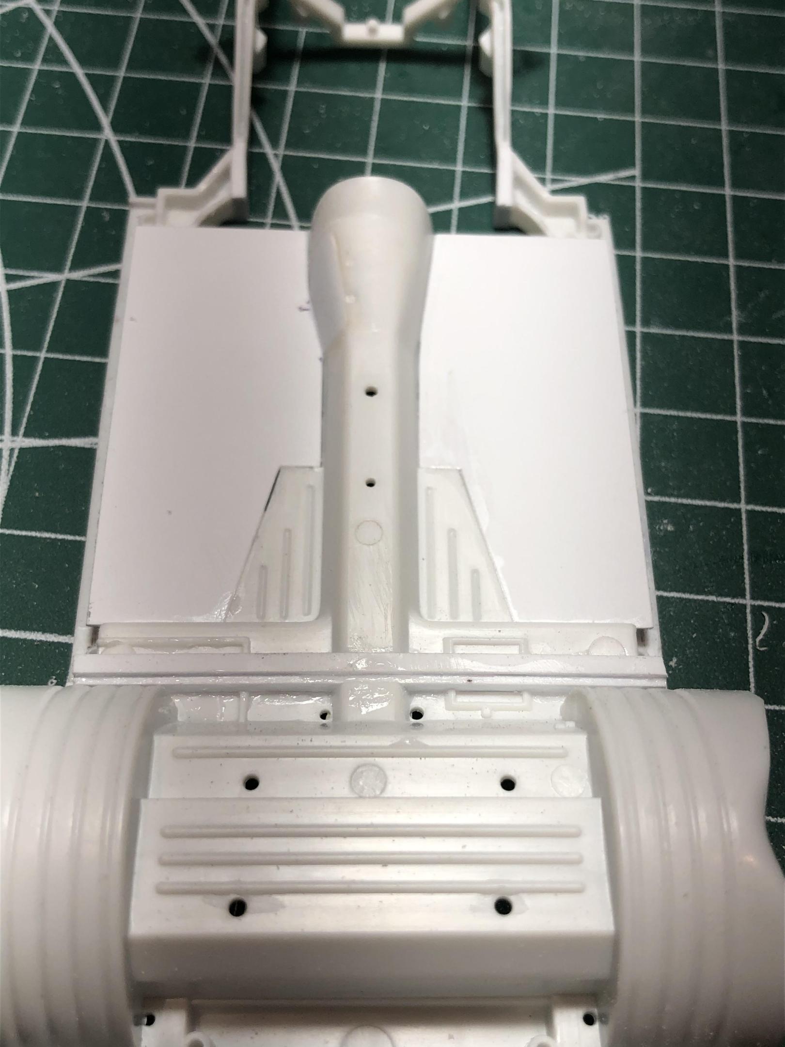

I removed the shifter bulge on the trans tunnel, then used sheet styrene for a new floor. This will get flocked later.
Fabbed up a speaker enclosure behind the seats…

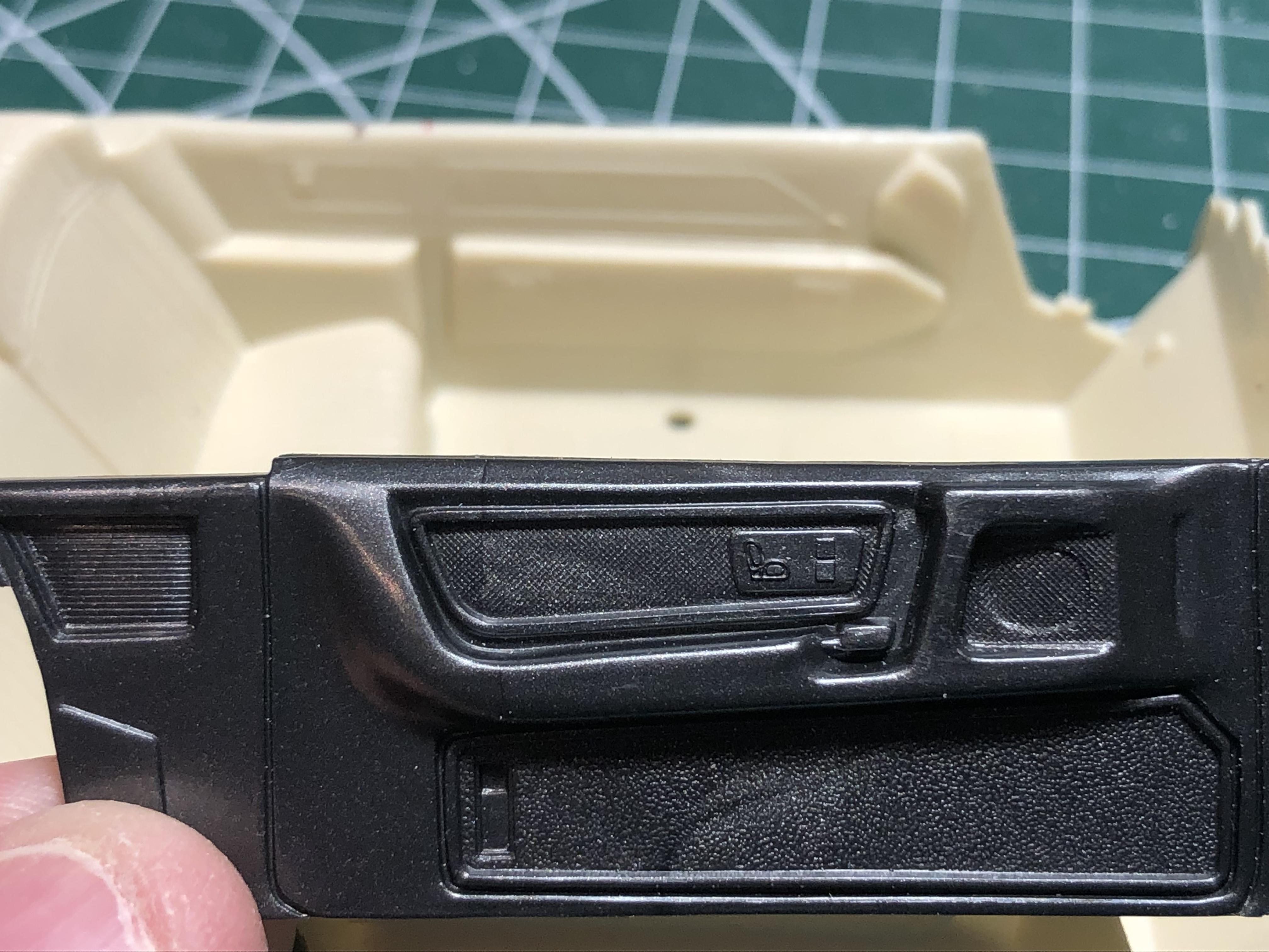

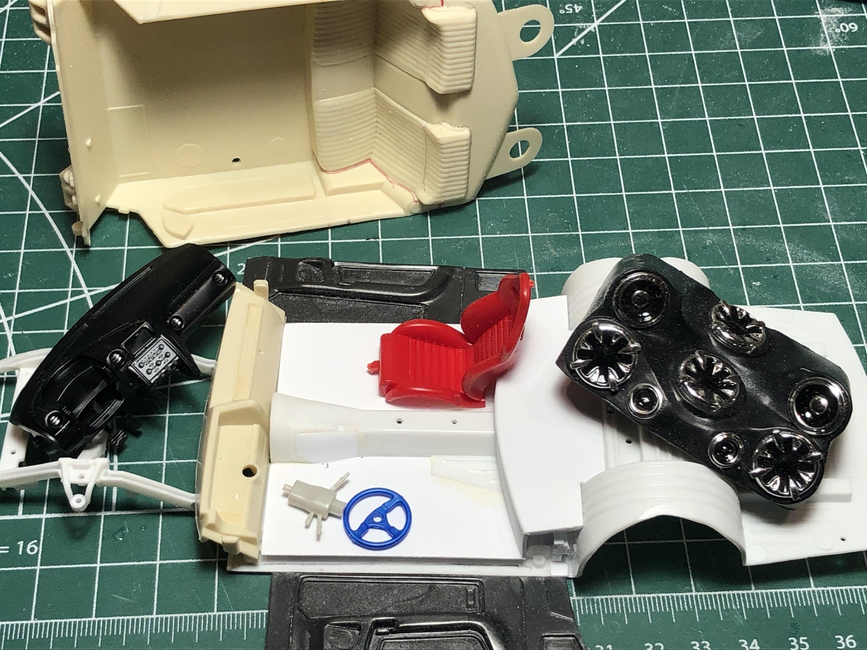

I really like the door cards from the Lincoln pro street kit, so I will modify these.  I will have the interior and exterior door opening line up when done. There is a “step” along the top to remove, and a curve along the length that needs to be straightened out. Obviously they will need other work done to so the dash fits etc.
Here are some of the other parts I’m considering. Seats from a Ferrari, I will use some speakers from the sub box on my enclosure. I also decided to go with paddle shifters on this one, something new and different for me. I have some from a kit, (not shown) but I’m going to see if I can make my own.  Still working out the dash, the plan is to incorporate the centre of the black dash with the kit dash. This will be the trickiest part for me.
Still a bit more planning to do, but the interior is starting to come together, at least in my head…
More soon!

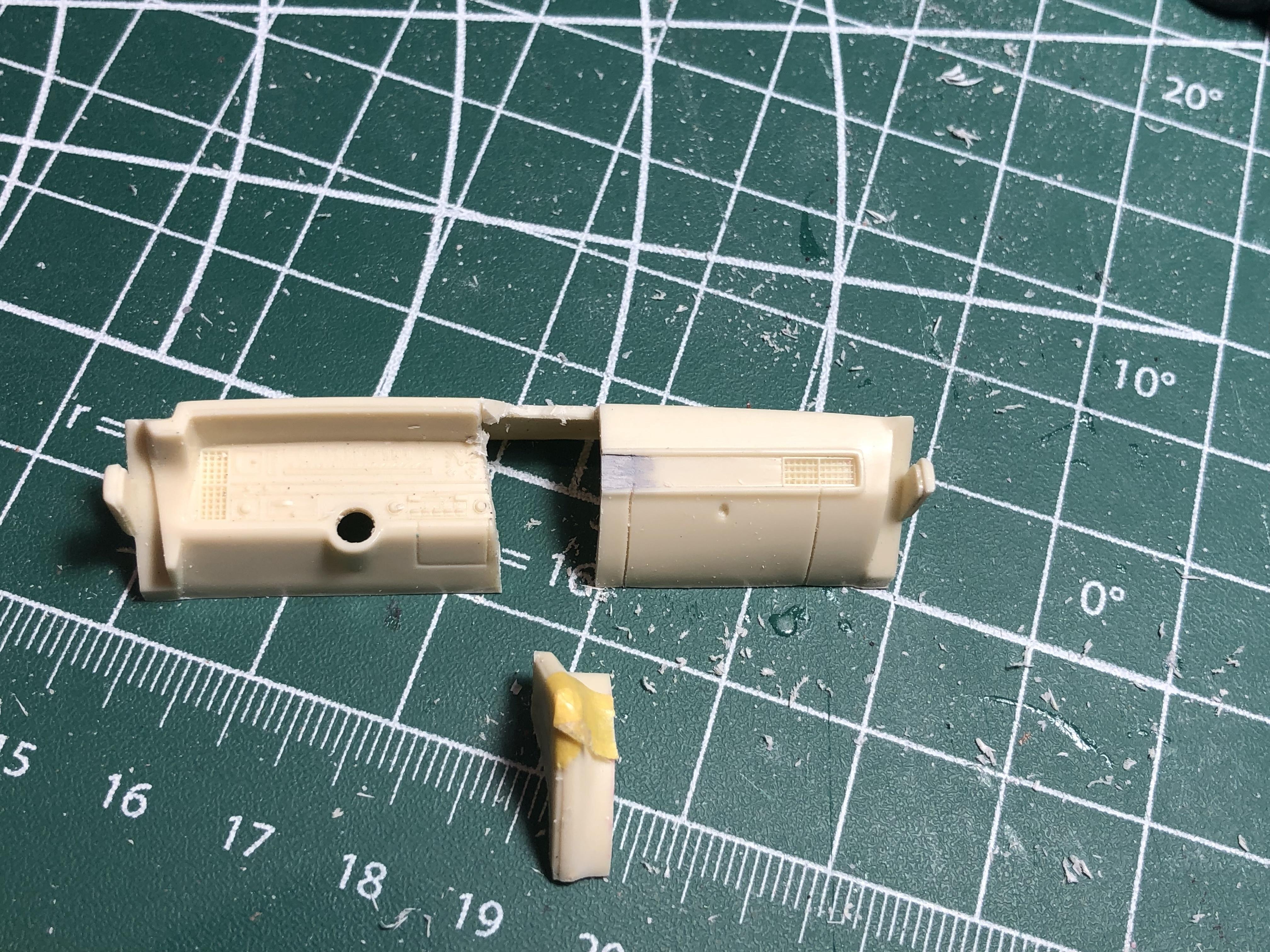

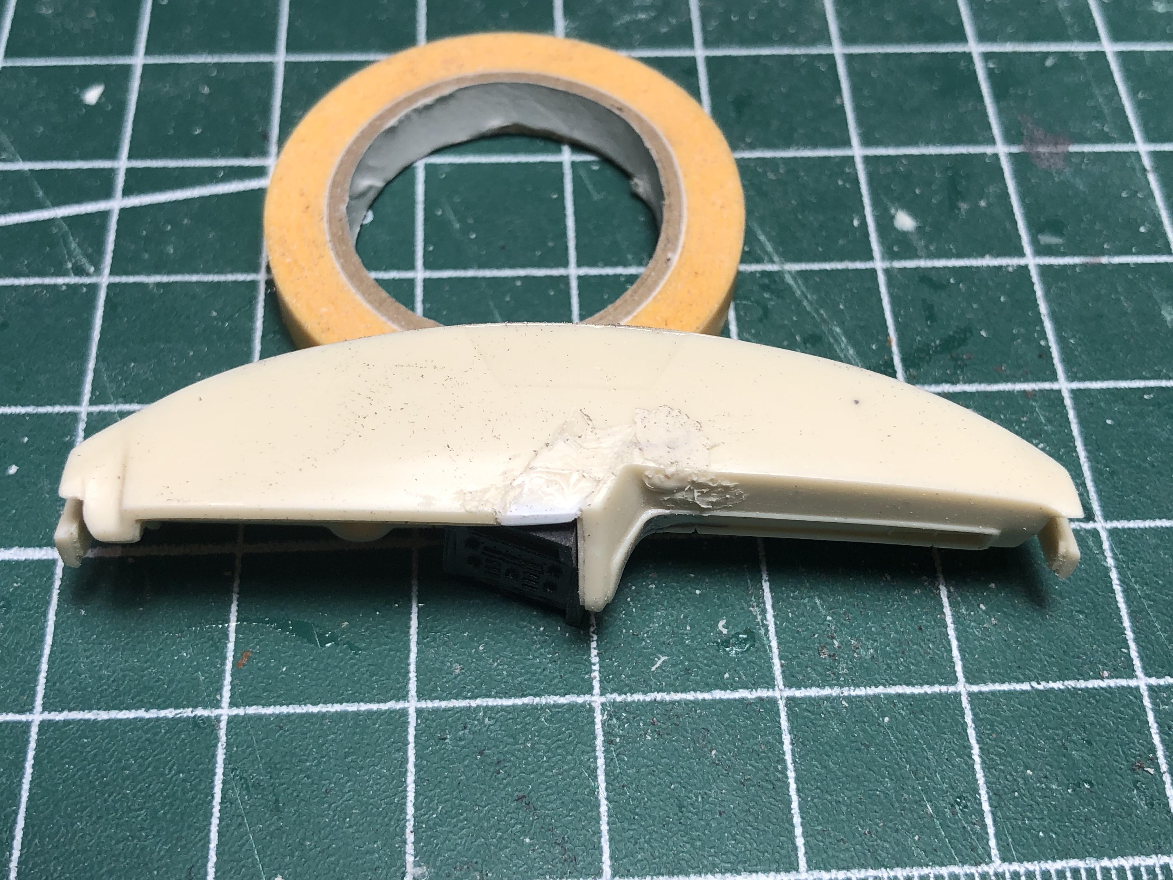

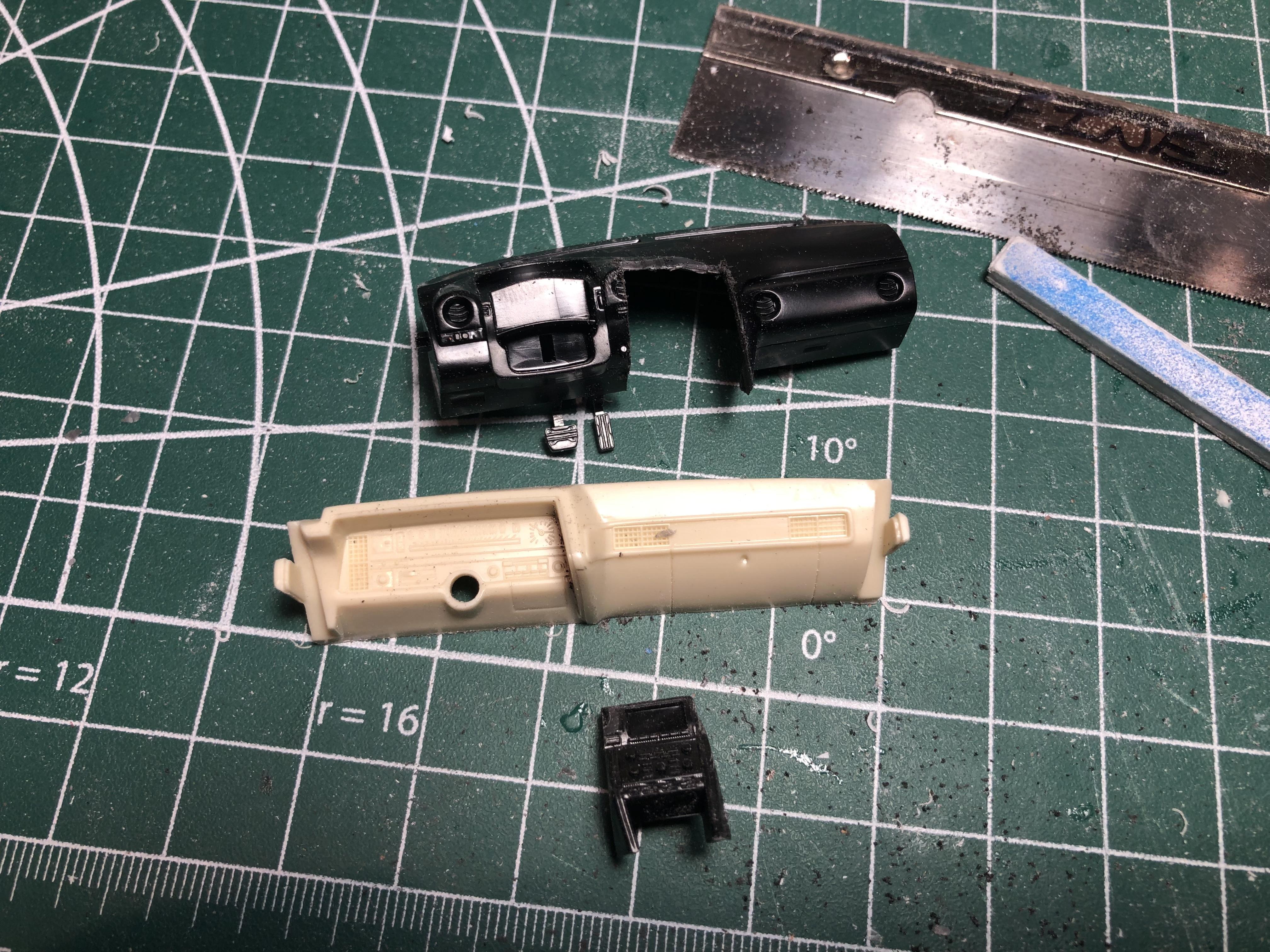

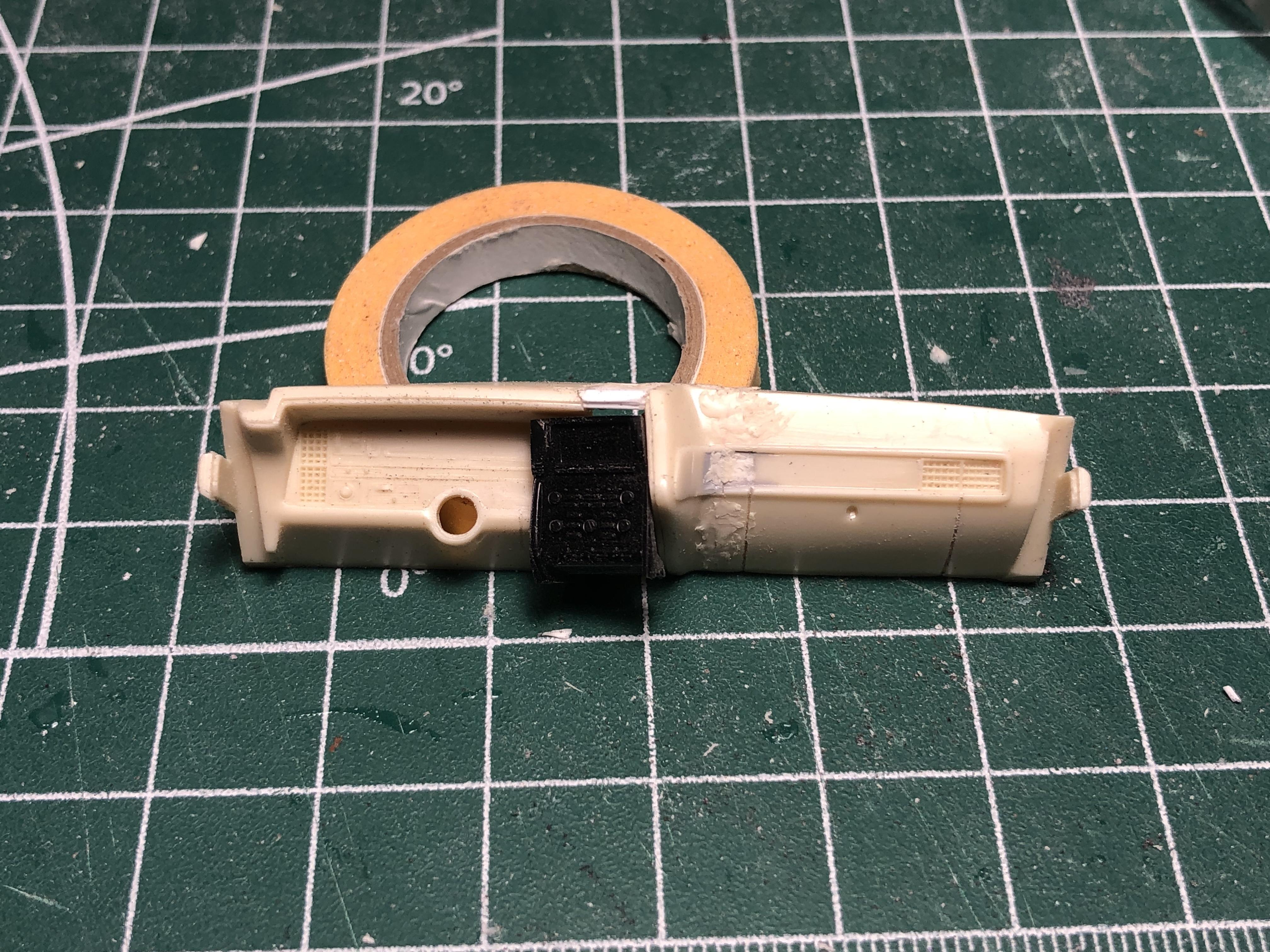

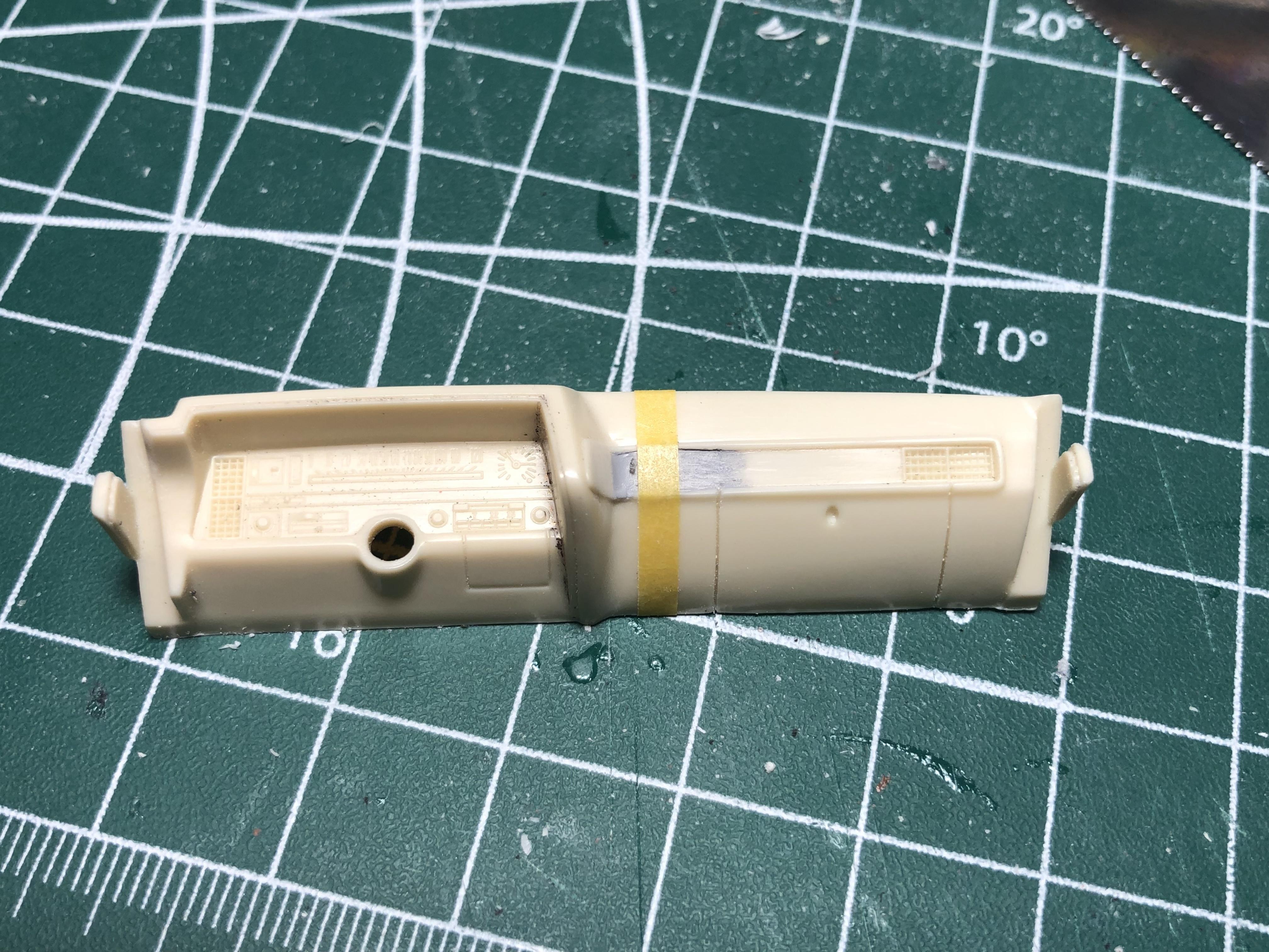

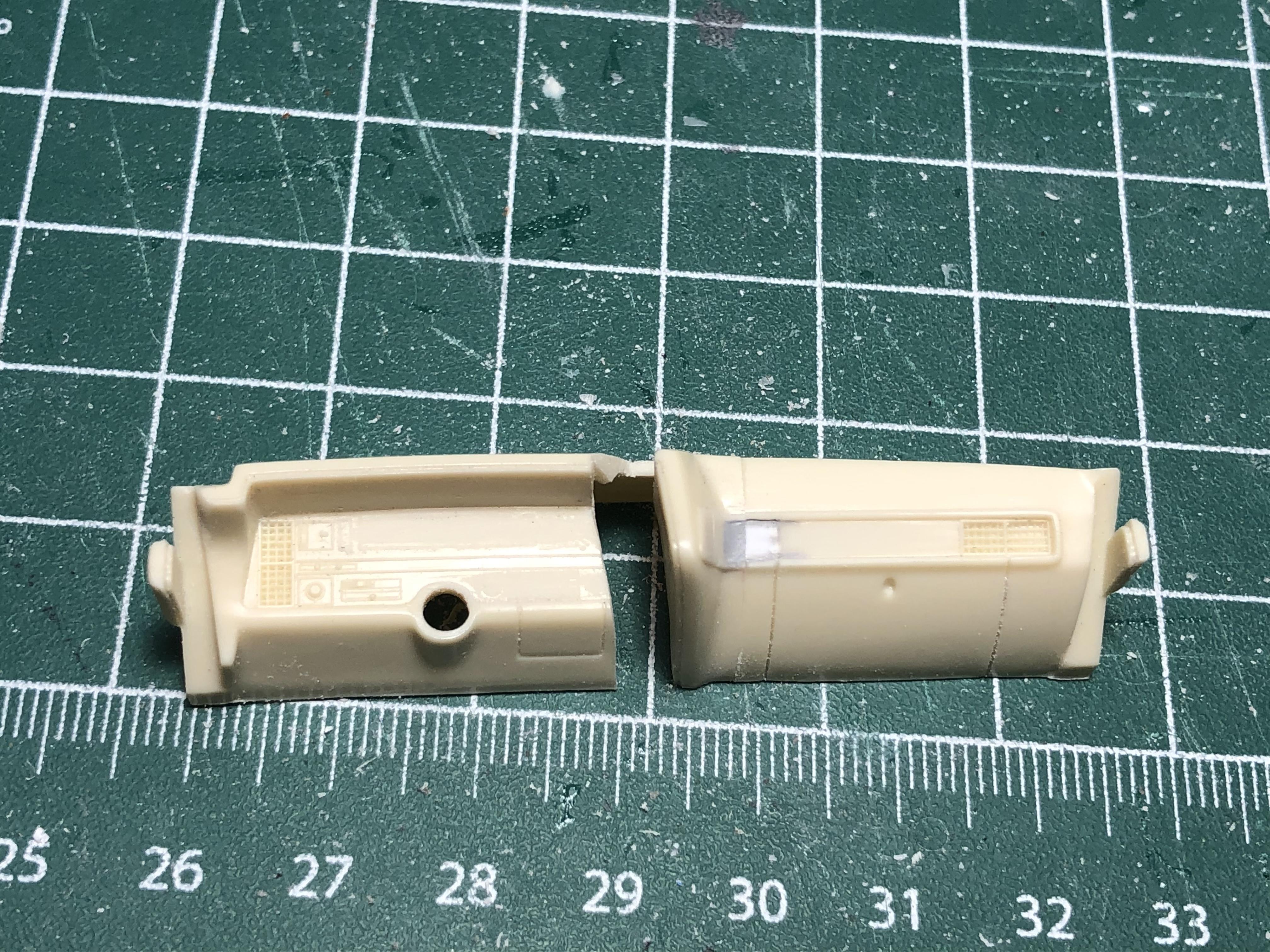

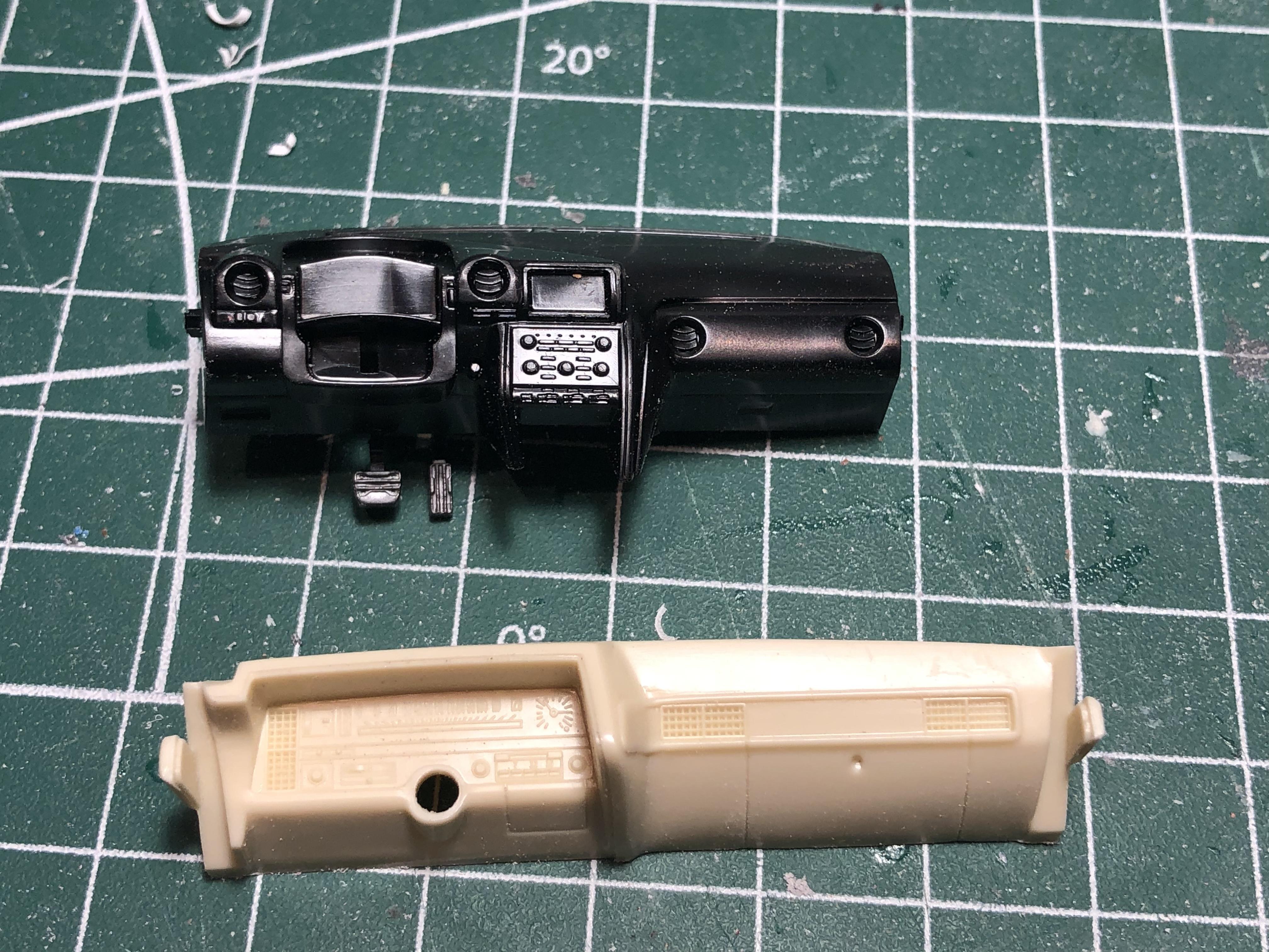

Today was dash surgery day
Again the plan is to blend the modern dash with nav screen to the “stock” Caddy dash.
first, I wanted to save the beautiful centre heat vents for possible re-use later.

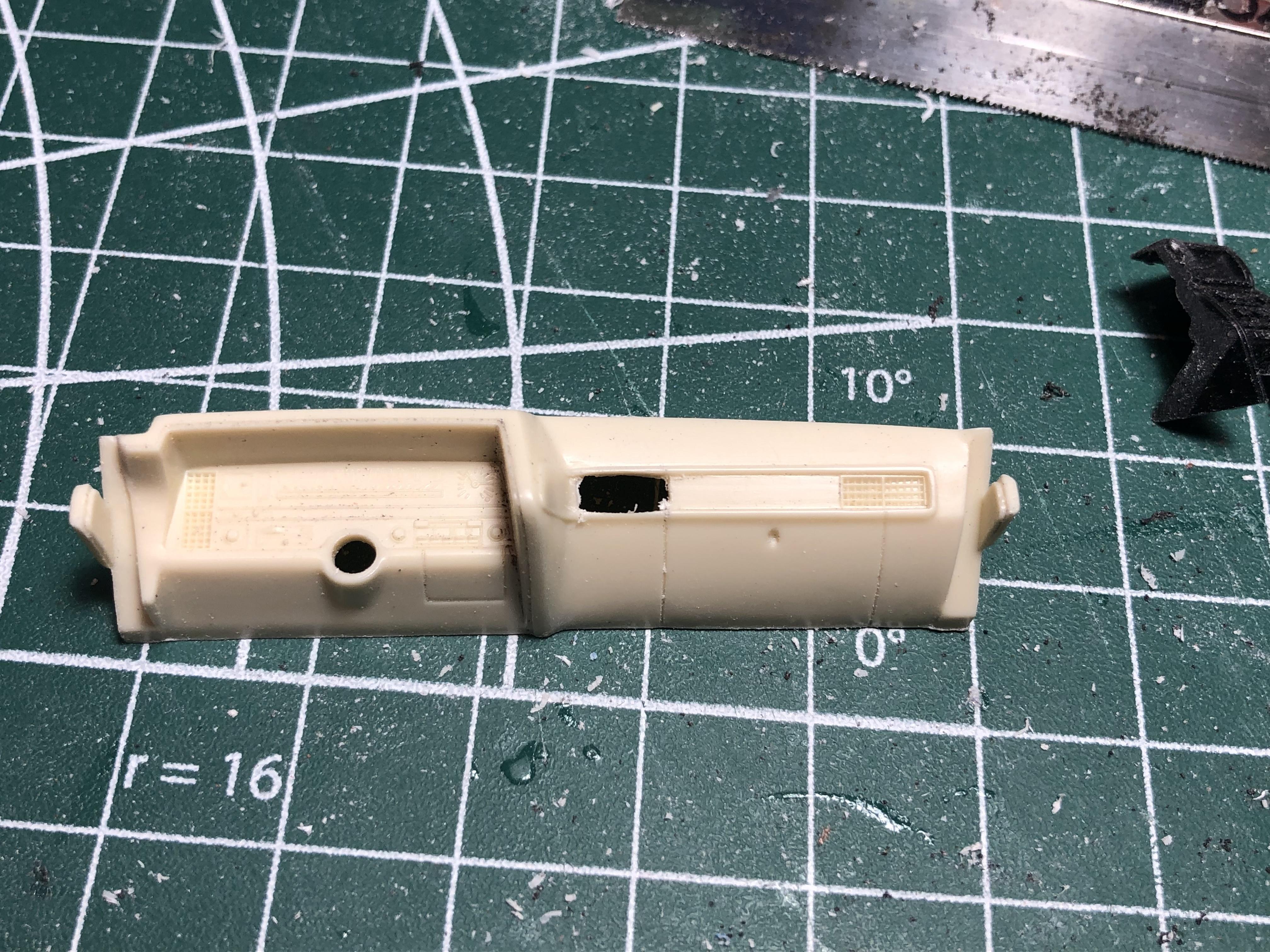

Then prep for two parallel cuts to remove about 3.5 mm from the centre of the Caddy dash, and remove the right side of dash.
Then re-attach the “wing” back to the dash.

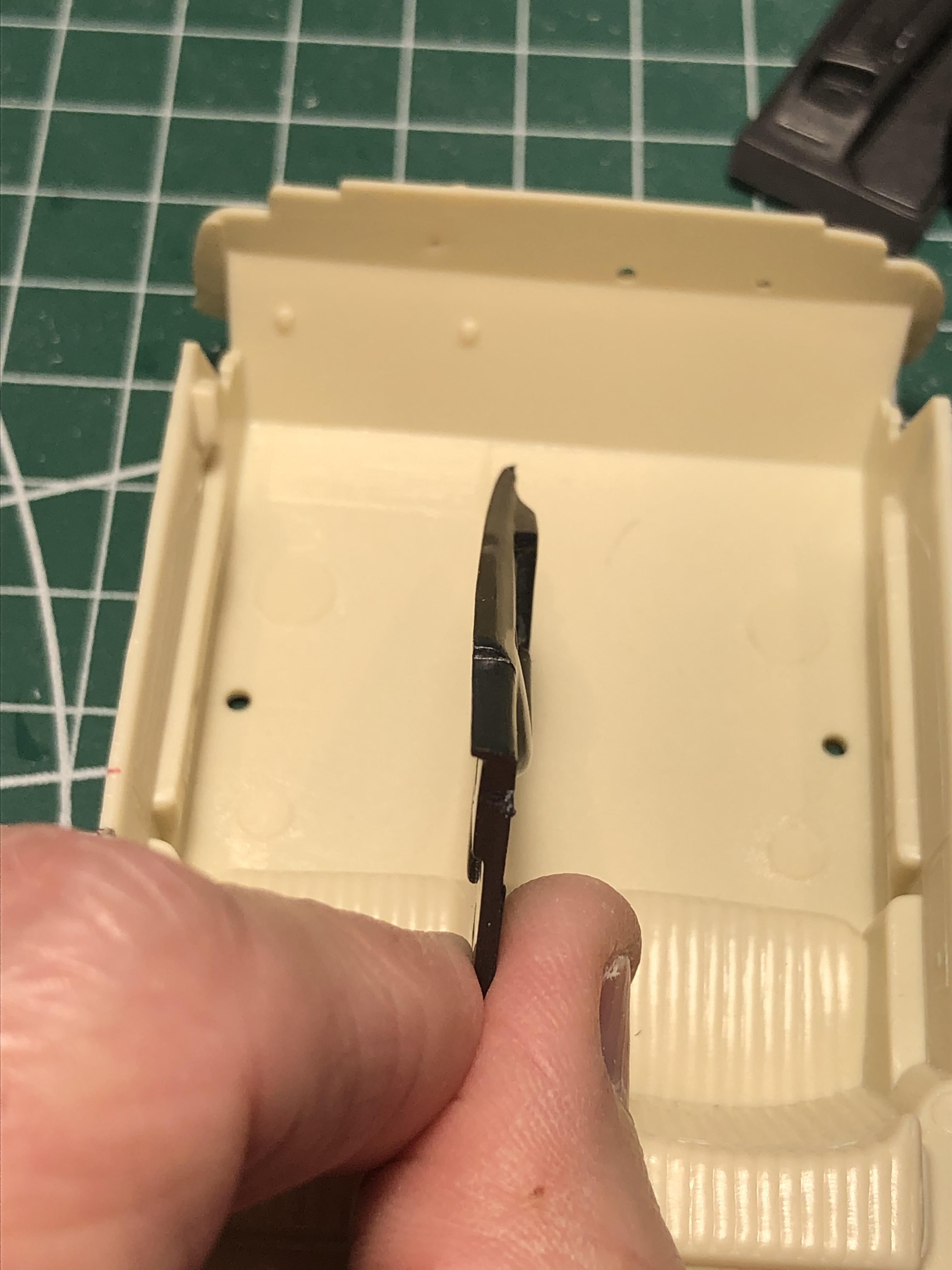

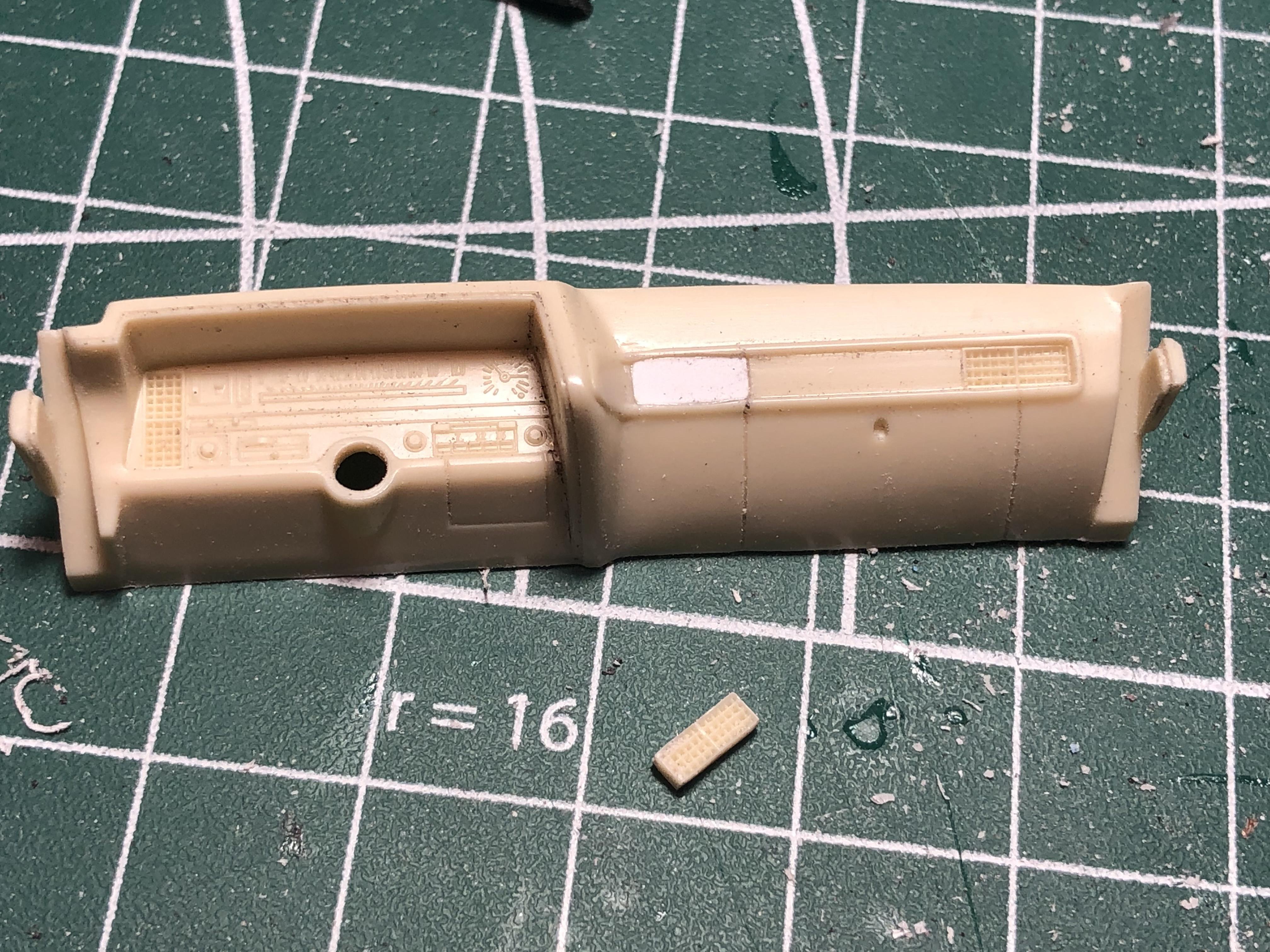

Add filler piece…
Then a quick mock with the new centre piece
I still have LOTS of cleanup and fine tuning to do, but so far I think it will work ok. I probably could have gone another 1mm wider, but I was worried that it might look too wide. Hoping to have this cleaned up tomorrow. More soon.
Cheers, Steve
