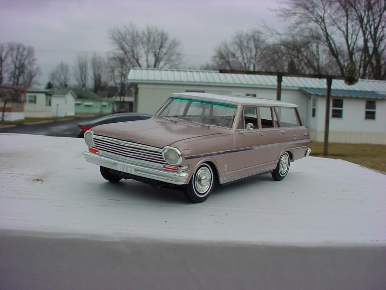

Well I learned how to lay paint by a man who did so to provide for his family. My late father was a paint expert who worked for IH/Navistar for 30 years in which 28 years in the paint department. So with that being said I dont lay paint on thick when painting any models. I'm fairly sure I am not the only one that has had the tacky rust-o;ium paint issues.  IH's Metallic emerald green paint was a pita according to him as it always had issues in one way or another. This '63 Nova wagon was painted with all Krylon short cuts paints. Rose gold, gloss white, Clear coat, Flat black chassis

Looks great!  The Short Cuts sprays aren't like typical "big can" Krylon sprays, they are more like Testors and Pactra used to be, straight hobby enamels.

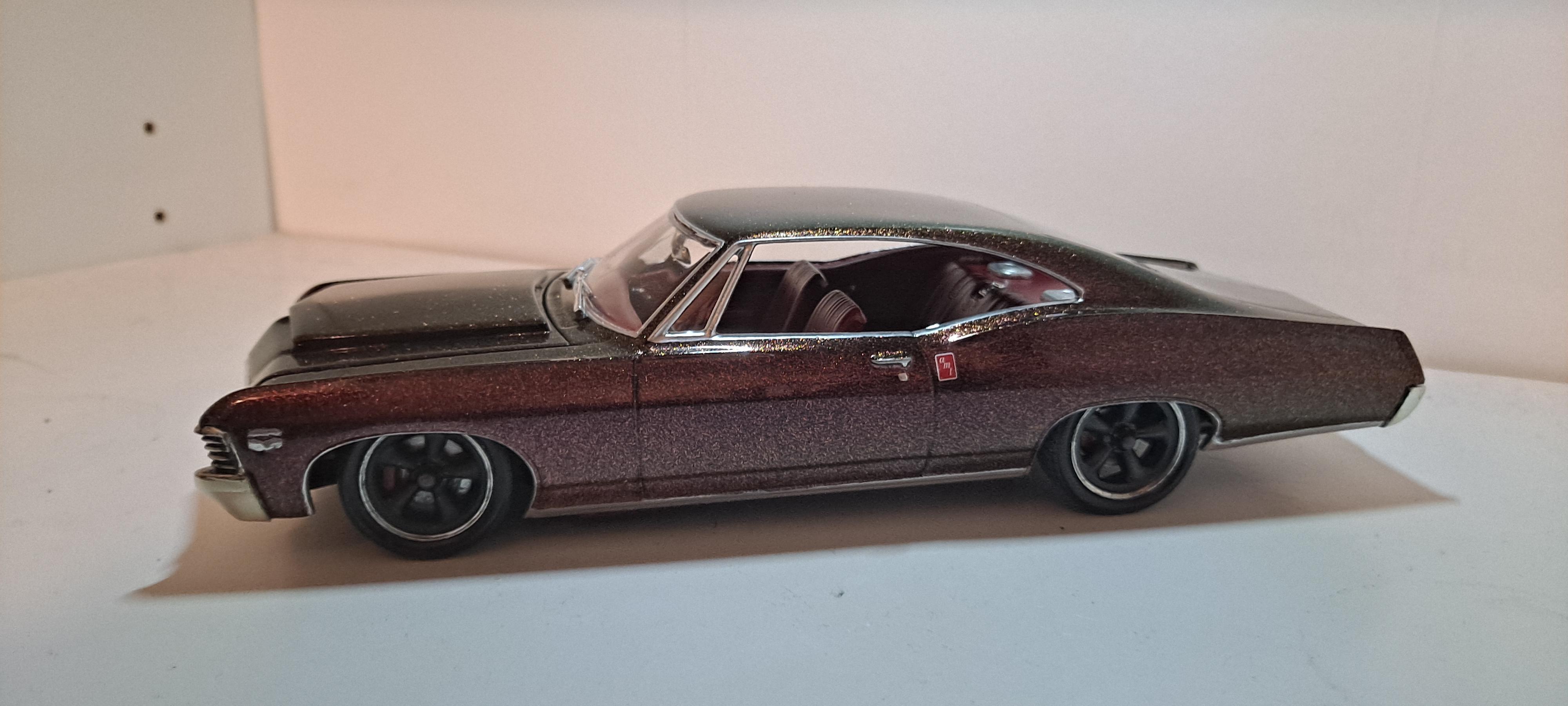

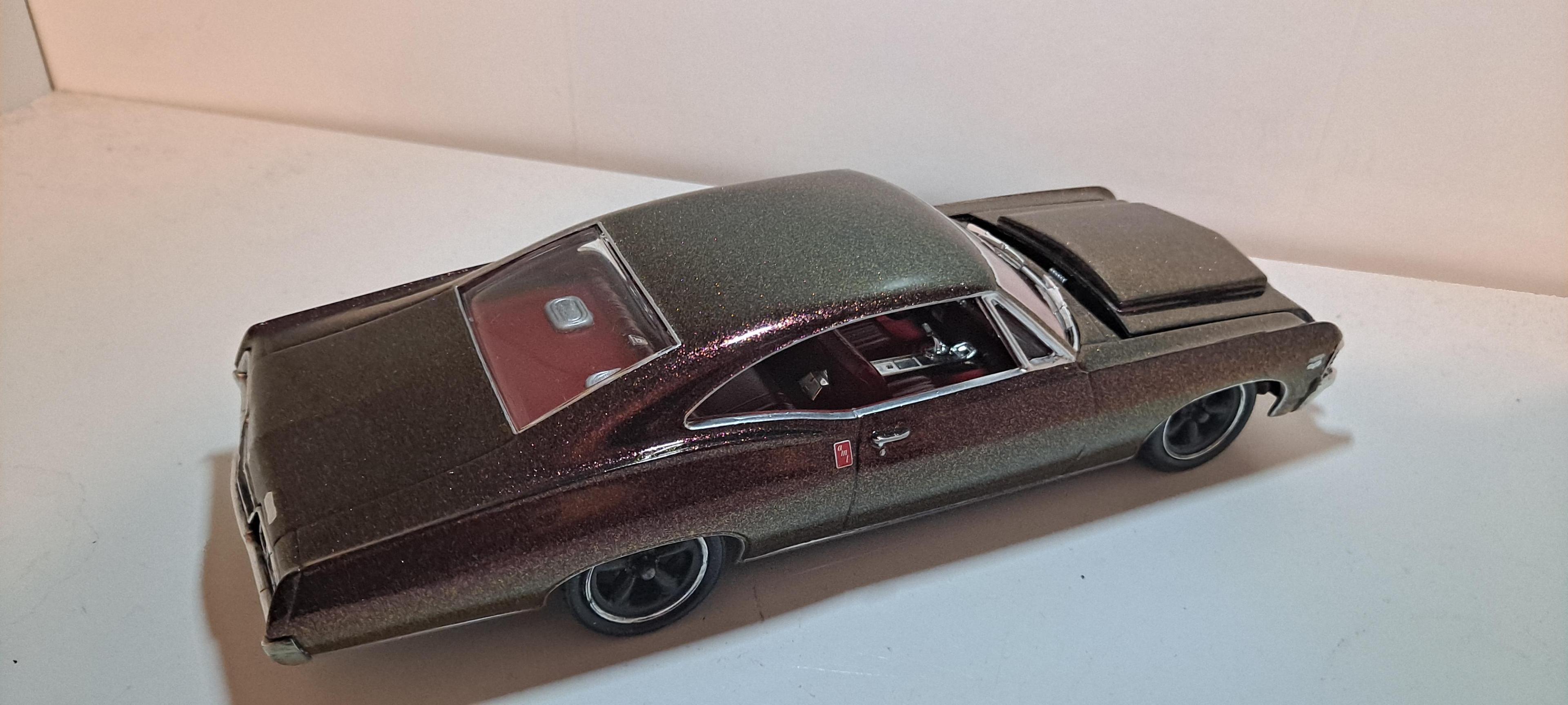

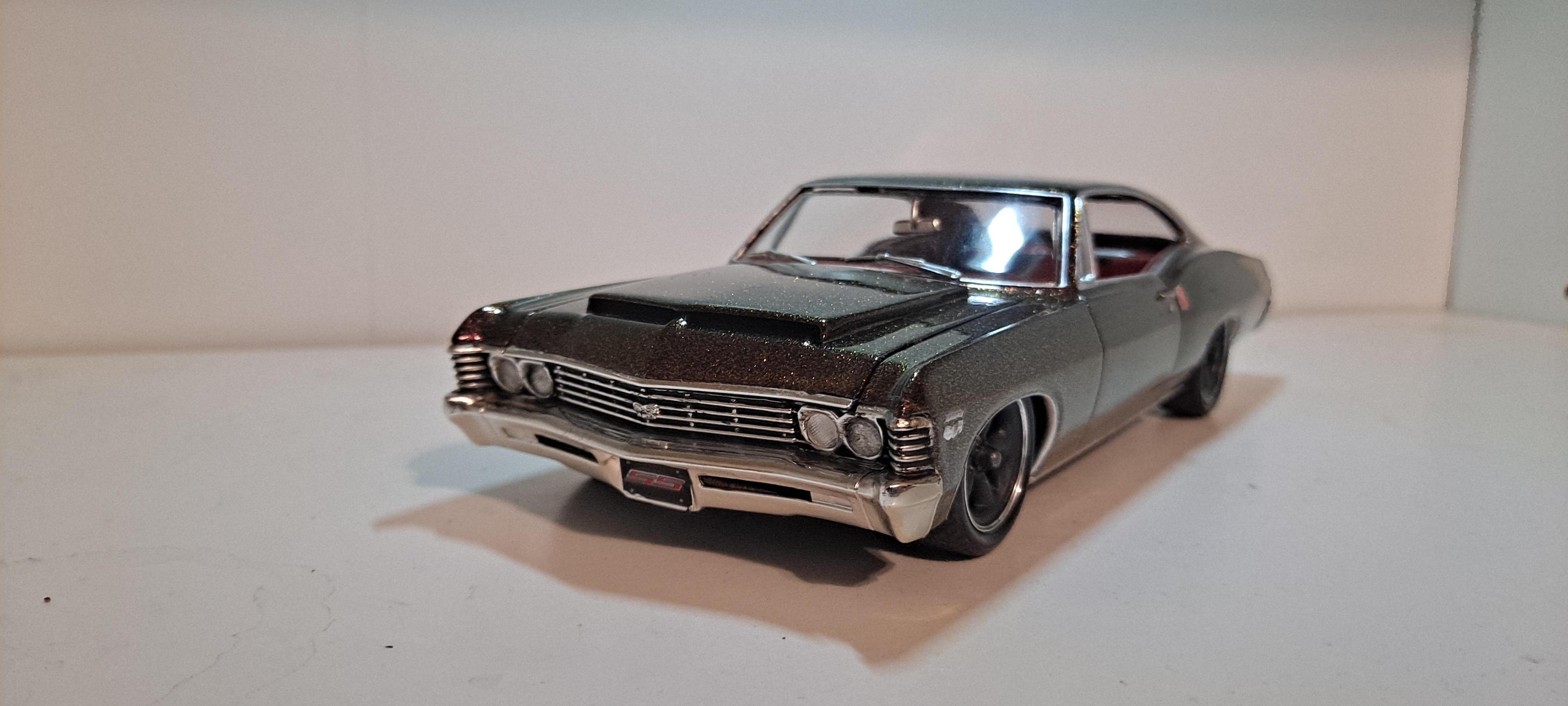

In fact, heres my most recent finished build, using True Value brand Grey primer underneath, Home Depot brand Flat and Gloss Black, followed by a coat of Rustoleum Color Shift Pink Champagne cleared with Pledge. The interior used Rustoluem Painters Touch Flat Pimento Red over the bare plastic.
Using budget rattle cans and mixing brands underneath can be done, as long as the primer coat is good enough and doesn't craze the plastic. Thats what matters in the end.
20230121_015133.jpg.7acf3e7c1cf7b72549787c67885196fb.thumb.jpg.3383f13a10775f83e0539574ee9fce3b.jpg
20230121_015151.jpg.c73dac093f555c4294fdba719b43ad37.thumb.jpg.e93eb494ec77ecc6bd09ef90f35f9461.jpg
20230121_015136.jpg.39ea5350834ca92d8cee51a533122ac1.thumb.jpg.c0cd9920581a00a80fff5f37a545c6fa.jpg
BTW, Rustoluem's clears are all abysmal too! Fogging, running, bubbling, you name it!
