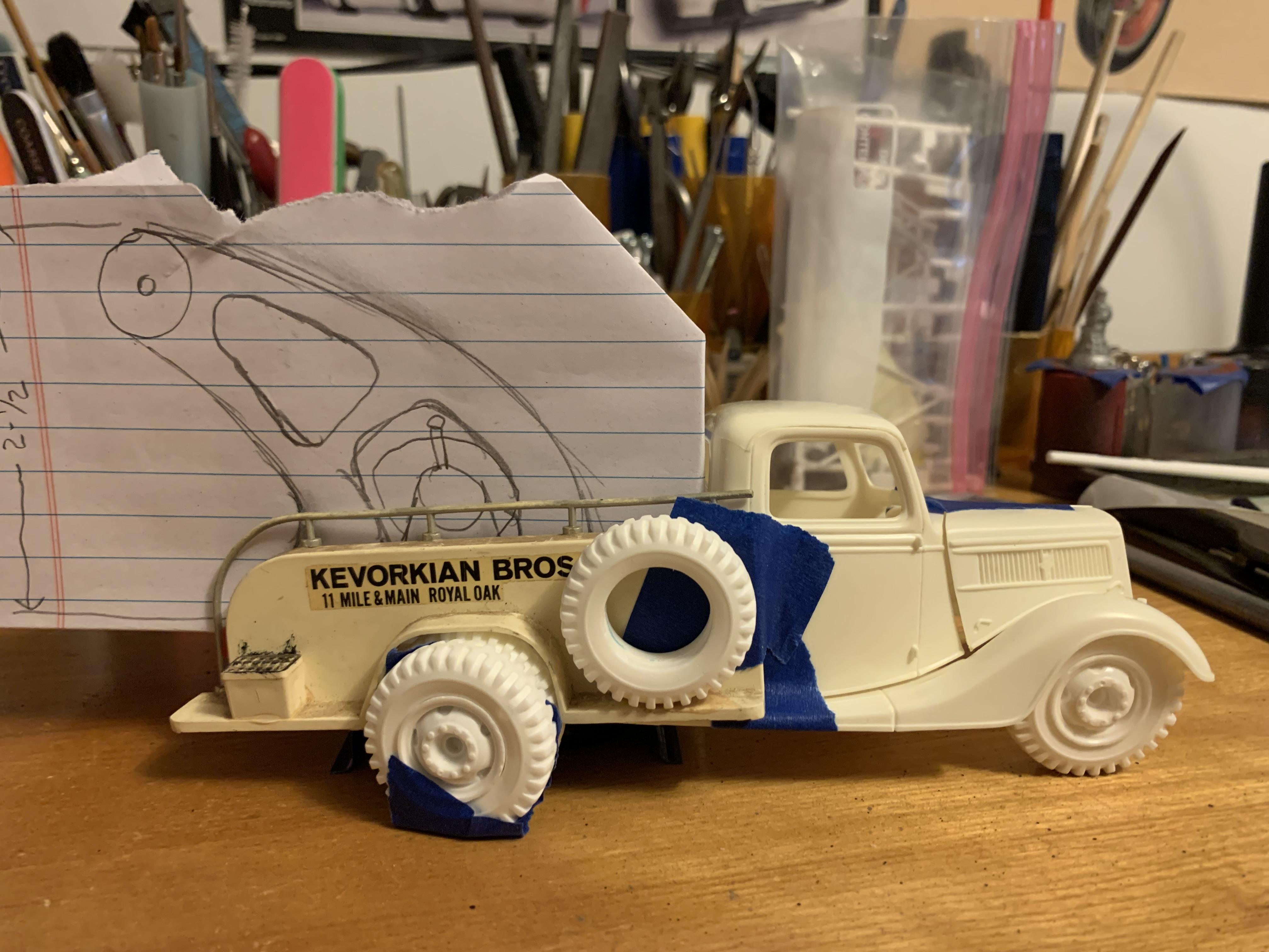

Inspired by another forum member's art deco tow boom, I decided to build a tow truck myself. I wanted the tires to be military tires, and contacted someone on the forum to cast some for me, as well as the required wheels. The rear will have dual tires, and I replaced the stock diff case with something a bit beefier. I finally decided on a bit more modern engine, so went with the firepower hemi from the 53 Stude, and grafted on a Muncie rock crusher trans and bell housing from the 39 Chevy. I just received a package of "watch part" gears which are recasts of old parts. This provided some of the winch gears. The winch drum is two wheels with the axle hubs removed, and glued together. The old tow truck sides I had received in a parts swap years ago, but had no plans for until now. I suspect some surgery will be needed on the hood sides to clear the hemi, and the tow truck sides will be shortened. Oh, yes, it will be weathered. Lots more to do, more pix when I get more done!

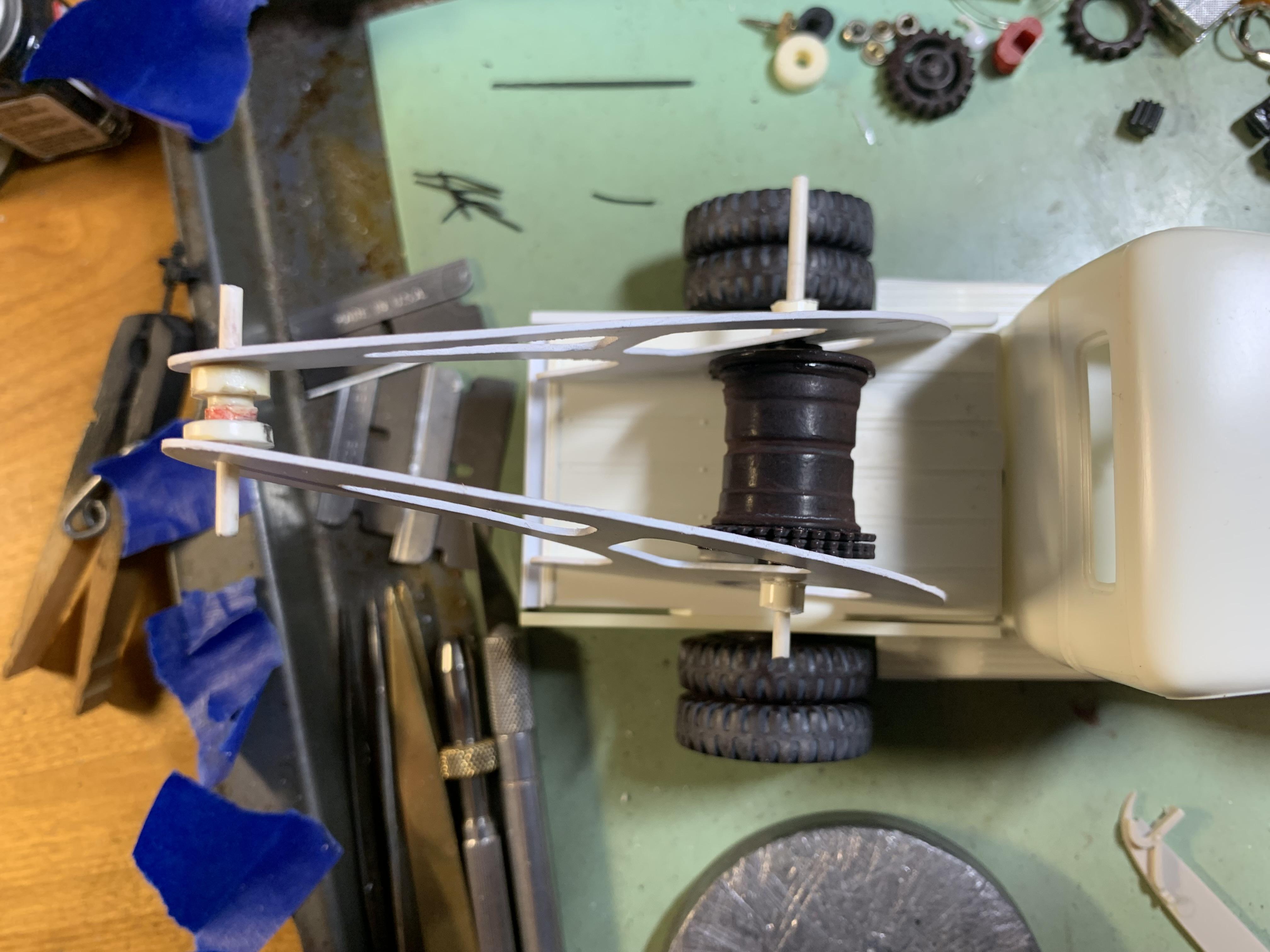

Wheels and tires weathered, and chassis up on all six- no glue, just test fitting and positioning, also engine weathered and positioned.

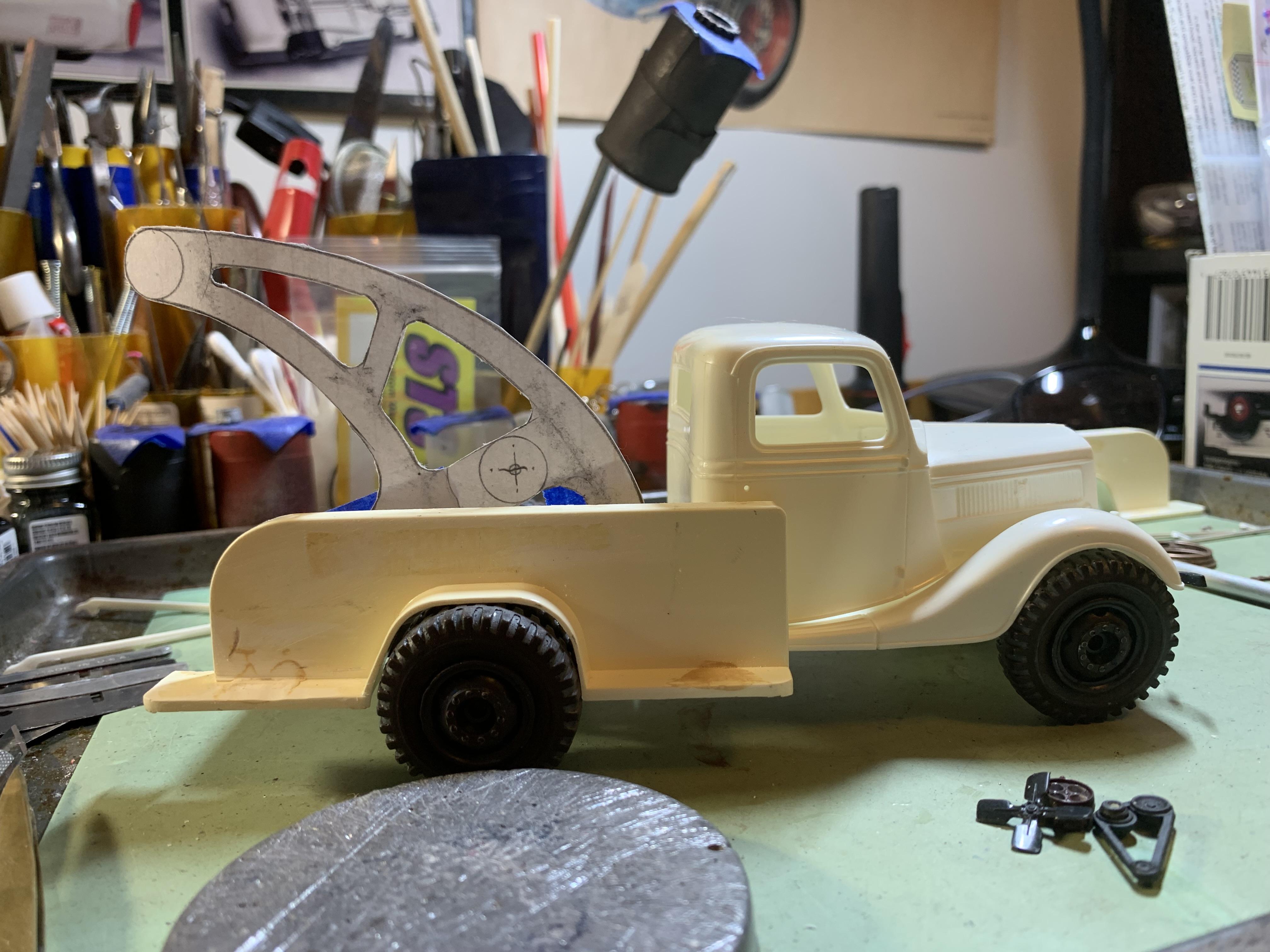

Got more done, so here are more pix! Chassis is now painted but not yet weathered. Drew up a better proportioned and more accurate sketch of the tow boom and included where the winch drum will be in relation to it. Pics include the tow boom sketch only, and also with the rear sides in place. However, the sides should come up to the running boards of the fender and bed piece and should not rest on the tires. Also, the sides will be shortened to end just behind the cab.

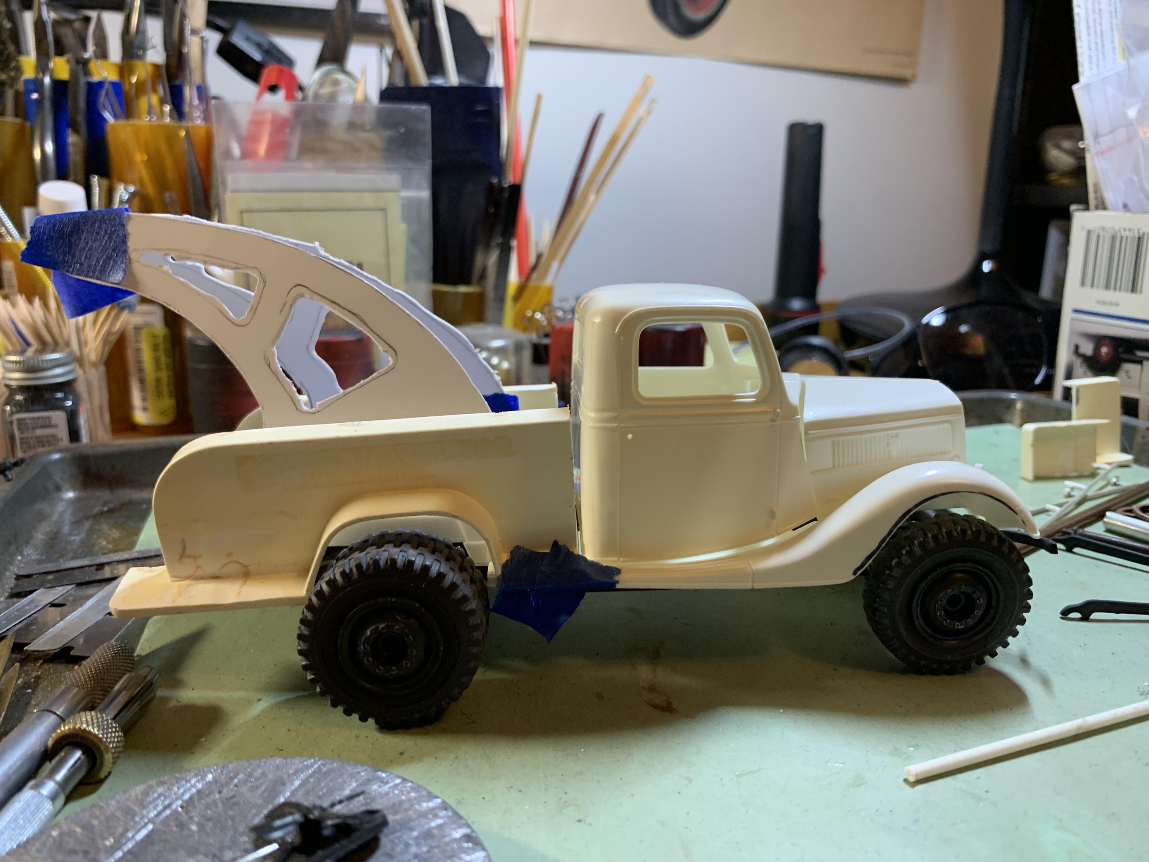

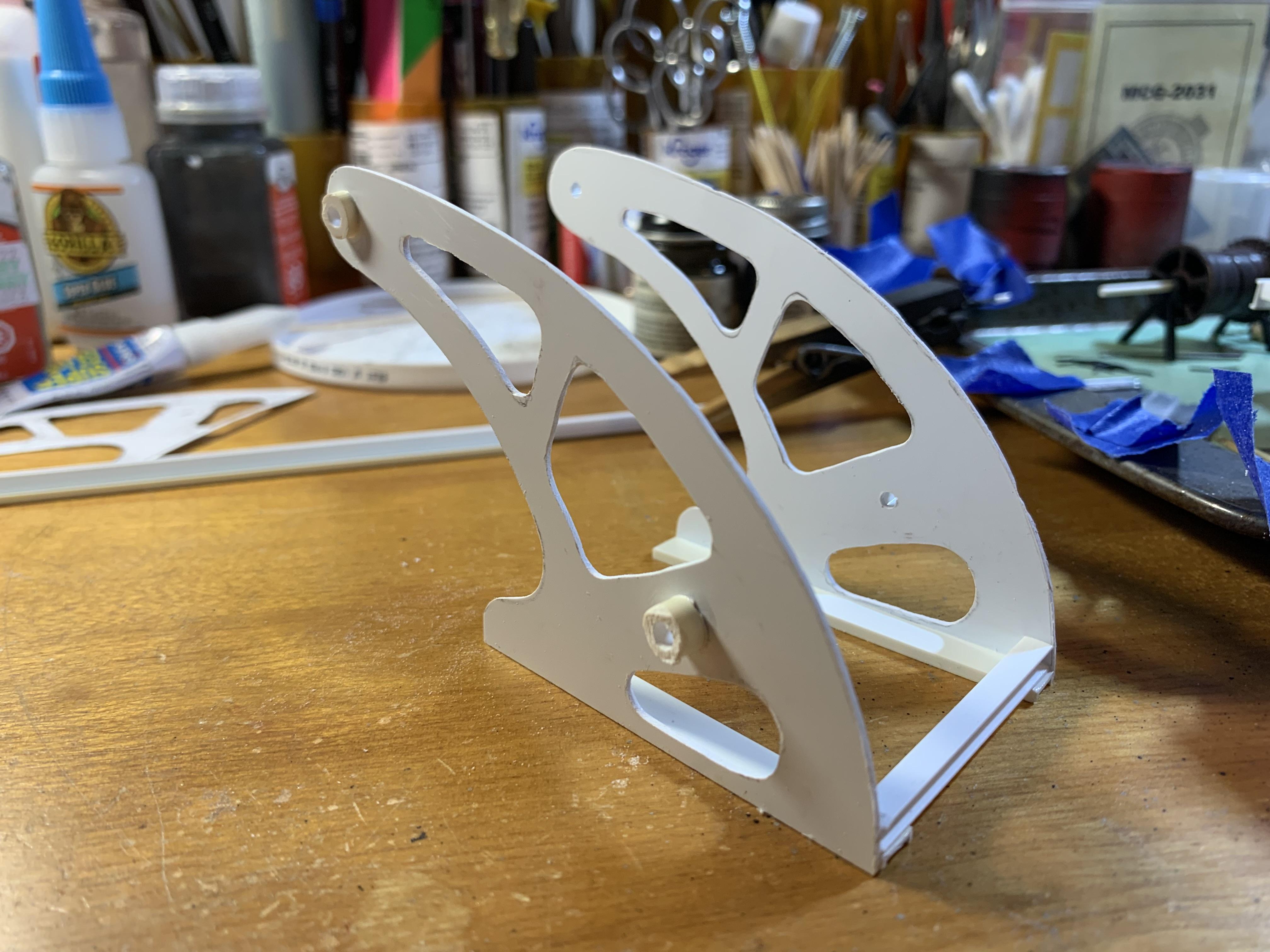

More progress- front fender radii enlarged to clear the tires, rear sides trimmed, and boom sides have been cut out and the right side nearly finished. Also weathered the chassis, and the wheels and tires are permanently mounted.
